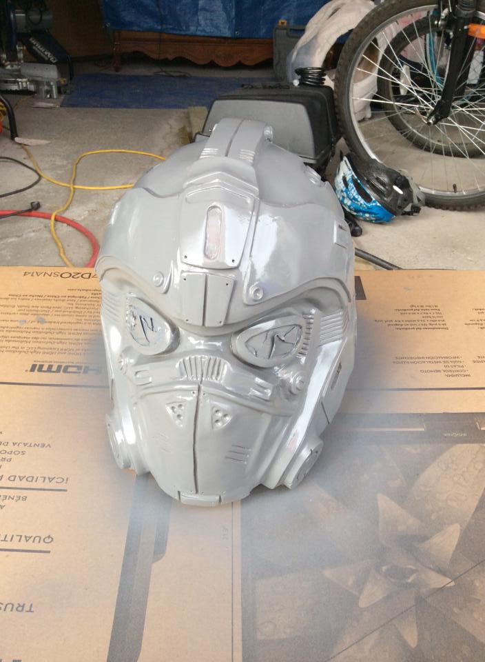

Hi all,

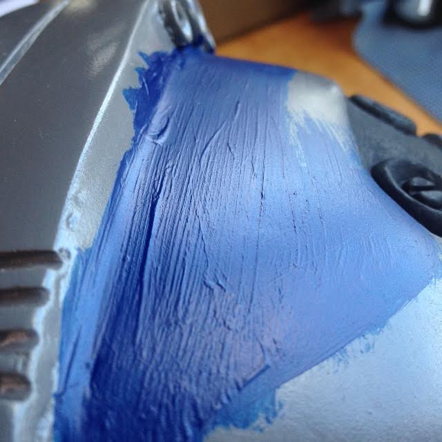

I've made a few costumes over the years but have used spray paint mostly. I made a clayton carmine helmet below and decided to paint it by hand with acrylics. However, I find the paint is not going on smooth. Its bumpy, has ridges. Almost like its not filling in properly. Its hard to get a picture of it. I've been debating sanding it down and trying an airbrush. (Got one for my birthday, just haven't gotten around to playing with it yet.. )

What kind of acrylic paint are you using? There is a nearly endless variety of acrylic paints... If it's coming straight out of a tube, you should probably thin it with an acrylic medium, or just water. Or look for something that comes in a squeeze bottle (liquitex medium viscosity or golden fluid acrylics are two US brands). I love games workshop paint too, but it's very expensive... not feasible for the whole mask, but it has some nice bold colors for smaller details.
ah I see your problem :) looks like you're putting it on too thick, I always dilute my acrylics with a dash of water for painting!
