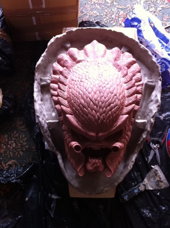

Measurements were approx
12.5 inches wide
22 inches length ( to mandibles )
across the width eye level was 8.5
These will of course shrink with the latex, so i am not sure if there are any bios to fit , but HEZ did express a interest in reworking his P2 hero to a larger bio to fit this mask specifically when i provide latex cured measurements.
That is the only down side to me doing a silicone one for me, if at a later date i decide to do a p2 suit, no bio will fit for me, but so be it . :)

Made this extra strong, due to moving overseas next year, the front took 1.25 bags of plaster i think they 25kilo bags.
and thats my moms garage floor :cool:
Nice, those pictures actually help in answering alot for me. Wasn't sure how to cut the 2 halves and include the 'wedges' in the mould. Also the mandibles plaster casting also will help. Thanks for posting the info and pictures in this thread- will help alot - can't find straight up answers like these wthout searching for hours and hours through the forum.
That is still one bad-ass sculpt - better than the original film sculpt if you ask me, its got more character to it and is more defined. One question though, what are you going to using to cast the mandibles?
mandibles will be cast i latex like the masks. :D ( apart from mine which wil be silicone )
