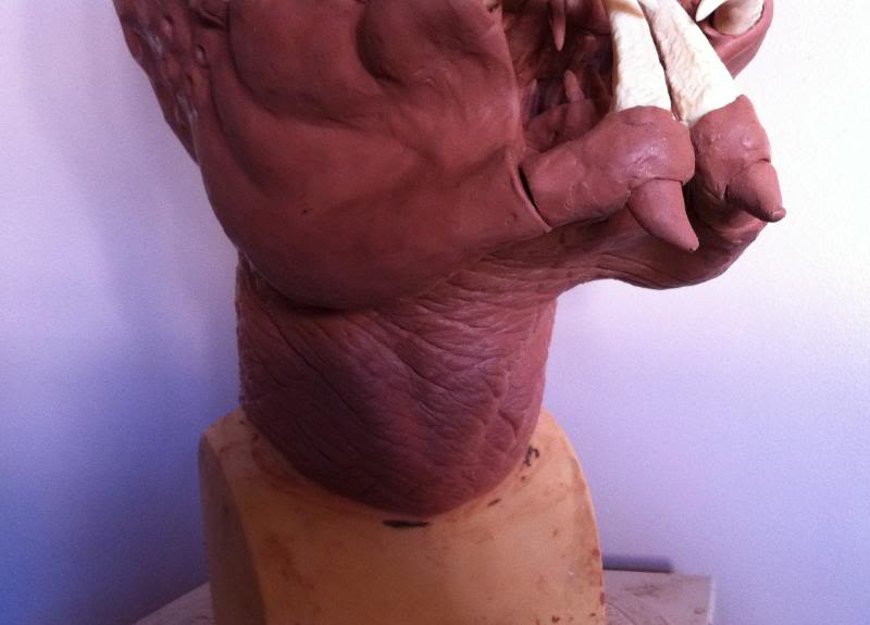

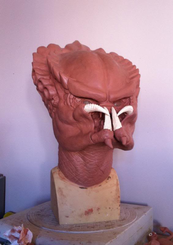

Well finally got alittle time to again work on this ( being ill has its benefits ) i have added some shape to the preds neck, and done the heavy detailing on the neck, i will do the finer details next, then probably move on to finish all the dreadholes, before then finalising the crowns curve and detailing it.
Cheers guys, the texture im doing a different way, i usually use white spirits ( but they make the house stink ............so mrs surps says :D ) so this time i decided to try the stuff i use for thinning the silicone paints, CLEAN IT 11 SUPER CITRUS SPRAY, it smells of ............well surprise...... citrus hehe. it sems to work well, but does leave the clay very soft for a good few hours.
not sure if thats helpful to anyone hehe.
