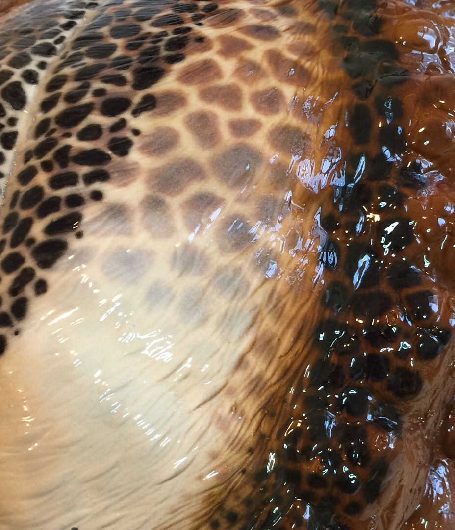

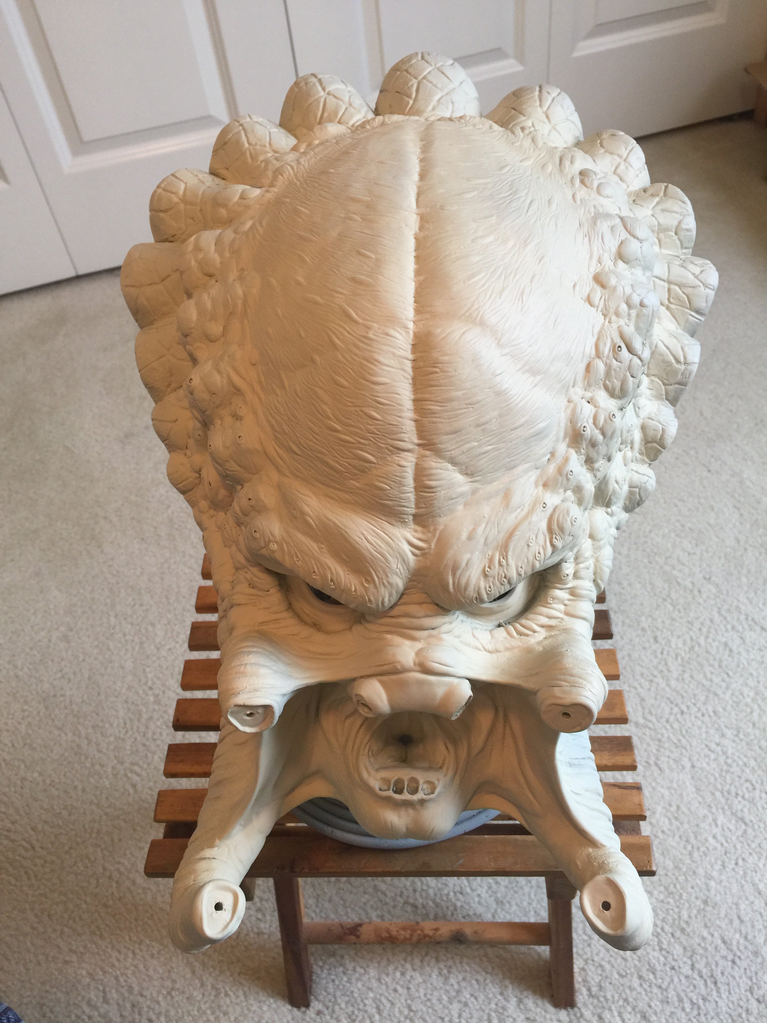

I'm in the process of finalizing my P1 bust (1/1) and getting it ready for paint. I've seen plenty of different styles of painting the P1, and on the spots do people paint them by hand or airbrush them? Personally I think the airbrushed spots look more natural with the slightly soft edges, but painting by hand would give you more control. I saw this example online, and it looks like the spots are done by hand and not airbrushed because the edges are so clean. Opinions? Suggestions?
That's 1 of Jimmy's paint ups, cant remember his user name. He used both airbrush and hand painted spots on his paint ups
Thanks for that information on the picture. I'm not sure about a stencil on my bust since it's an older Howard's version. There's a pretty good surface texture that might give me trouble. Most likely I'll just do them by hand.

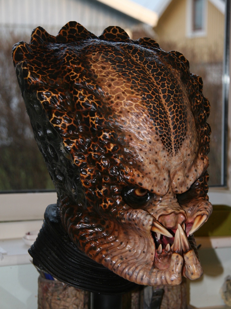

My spots are coming along. It's all 100% airbrush. Mostly FW inks and Golden airbrush colors. I can't believe how many go into one of these things! Here's a shot in progress. Still some cleanup to do on the forehead spots and many more spots to go......
Very nice work my friend. Look forward to it finished. Yeah the spots take the most time for sure. All pays off in the end (y)
