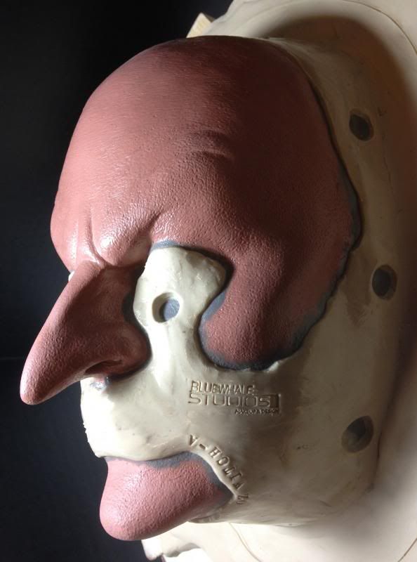

silicone piece before application
sculpture

Question; Might I ask what the shallow circular holes are, on the side of the lifecast positive/etc?

As far as the shallow circles, these are contact points for my negative mold. These ensure that there is a good tight fit with no rocking of the molds and this is essential for getting a good, clean edge which is crucial for creating seamless makeups.
I use Platsil Gel 10 silicone with Super Baldies encapsulating plastic so I can blend the edges into nothing on the skin. Even up close, if the edge is created properly, it cannot be seen by the eye.
