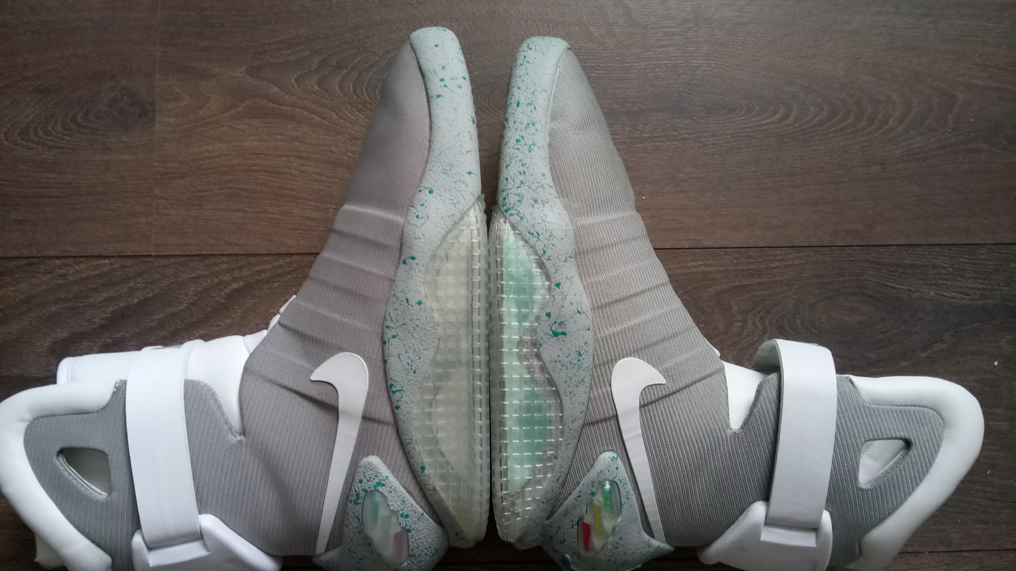

Are these half sizes actually larger than the normal size? I'd be curious to see 10 and 10.5 sole to sole.

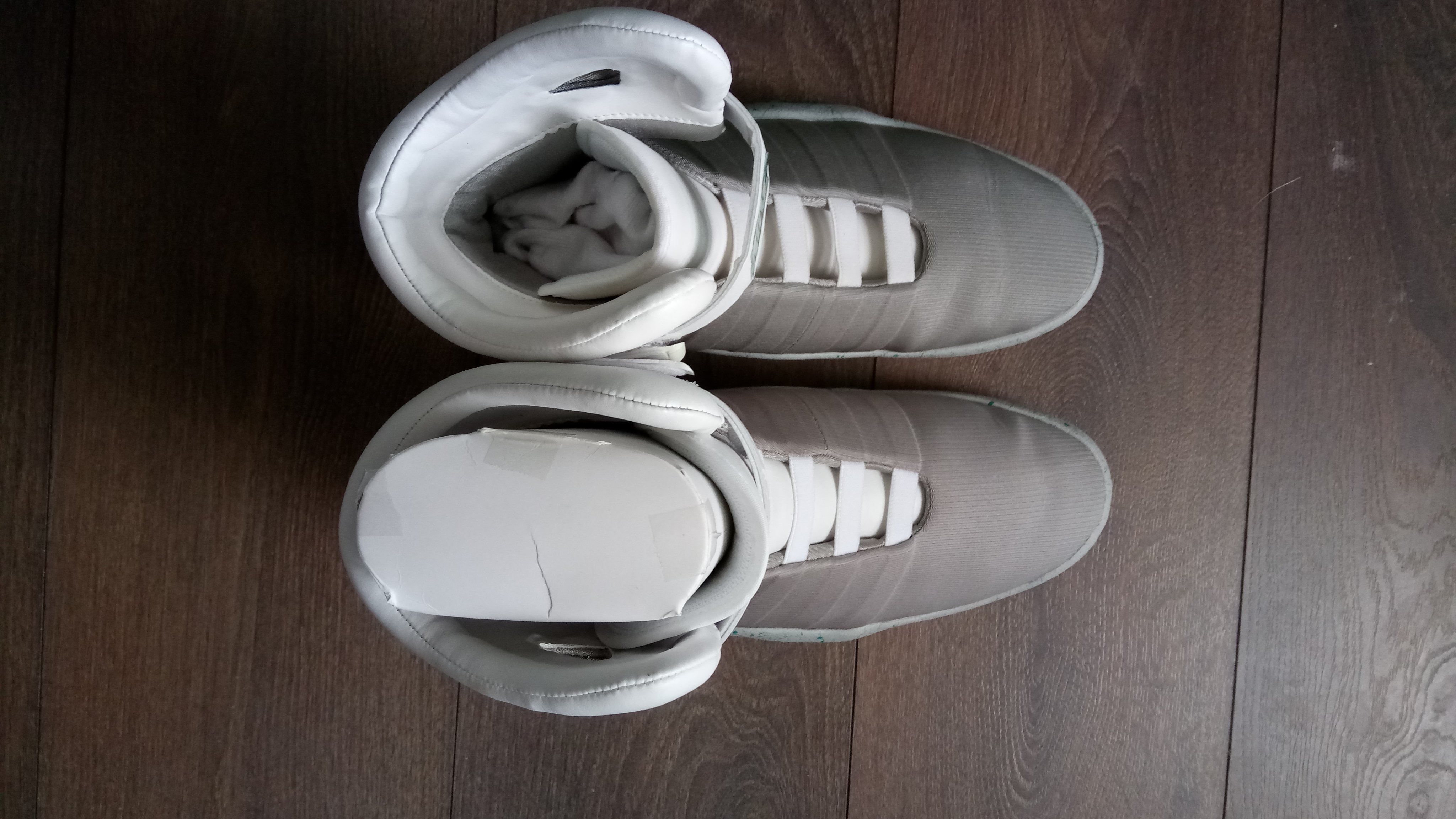

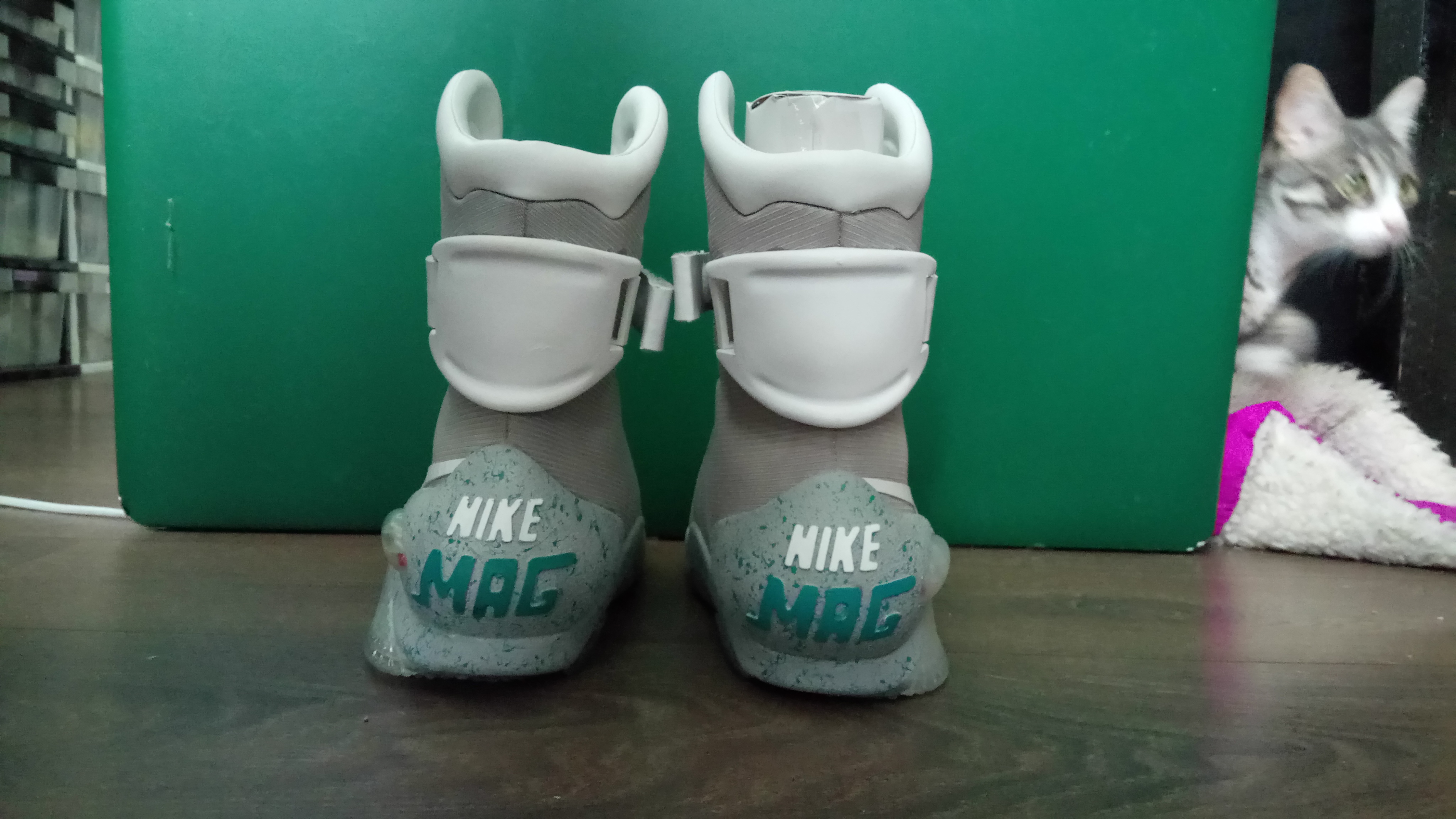

Sorry for the delay, was totally exhausted from work yesterday. Here are some photos of my V3 size 10 (which I replaced the sole on) next to my V3.1 size 10.5. There is actually a slight size difference, seems about right for a half size, not enough to be a full size up. Even in the height. And my cats LOVE the MAGs, every time I get them out one of them comes to investigate.....
