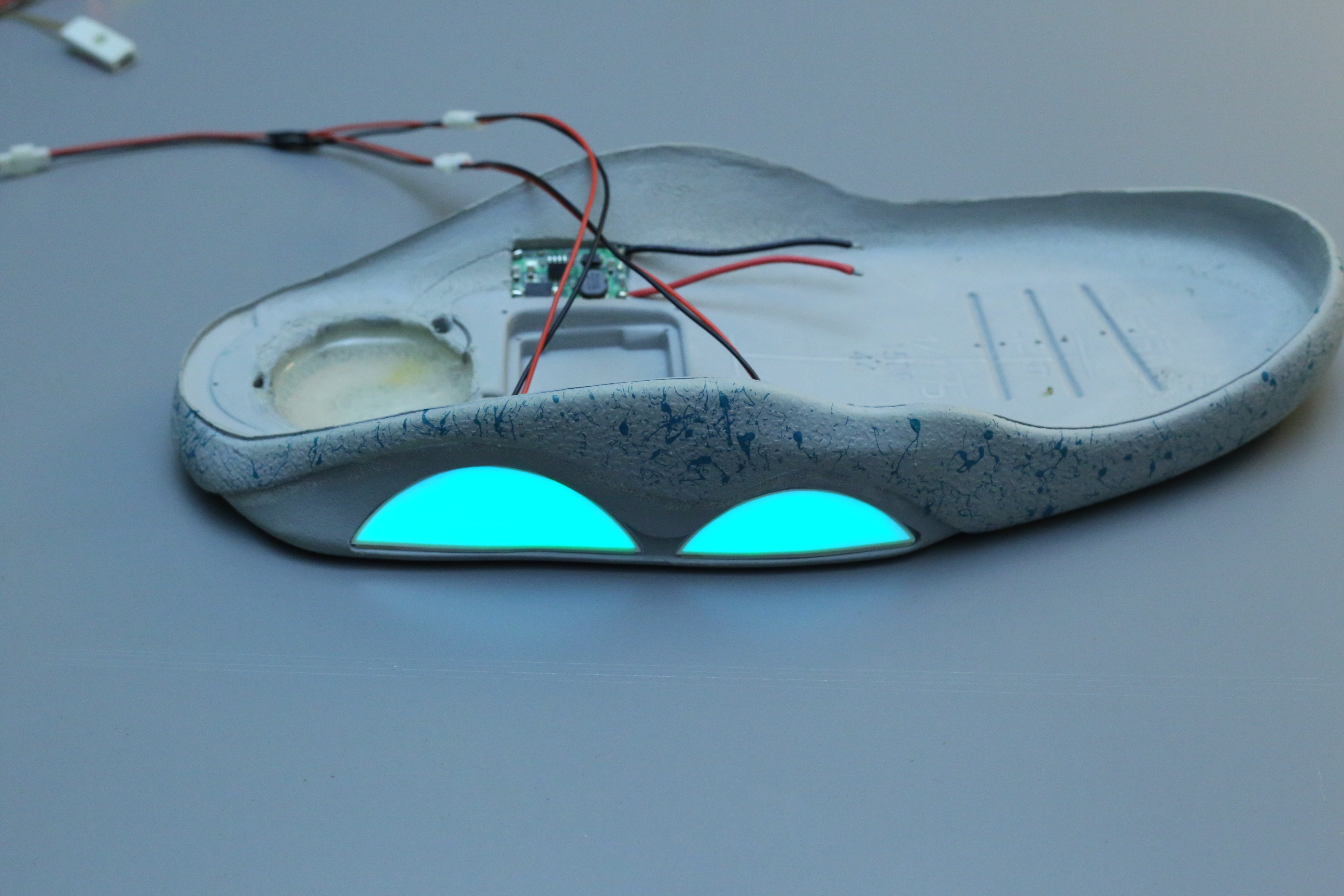

Wireless charging board/coil. If anyone has shoes that are ready and need EL panels, and want to try these PM me. I don't think it will completely stop the issues either, but I have people messaging me wanting their shoes repaired that have only been worn a few times. So, I also doubt it will be a bulletproof fix, but start eliminating issues one at a time with these shoes...eventually they'll be solid. These are more of just a little test then some final solution.
You are certainly leading the field in creating better parts for these. Well done. I need to work on my copper tape idea to replace the wires and see if I can get that to work.

It's already there, but yes. I buried the coil in flexible adhesive. It works.

Did anyone try supporting the entire EL panel with a hard substance like carbon fibre so it can't be bent? I'm sure I saw a pic of it on here ages ago. Meant to try it for my 3.1's but done enough work on the first sole swap.
I don't think so. The problem is the EL panel will bend one way but shoes require the panel be bent in a way that the sheet will fail from delamination. This is why the 2 part idea might be best.
