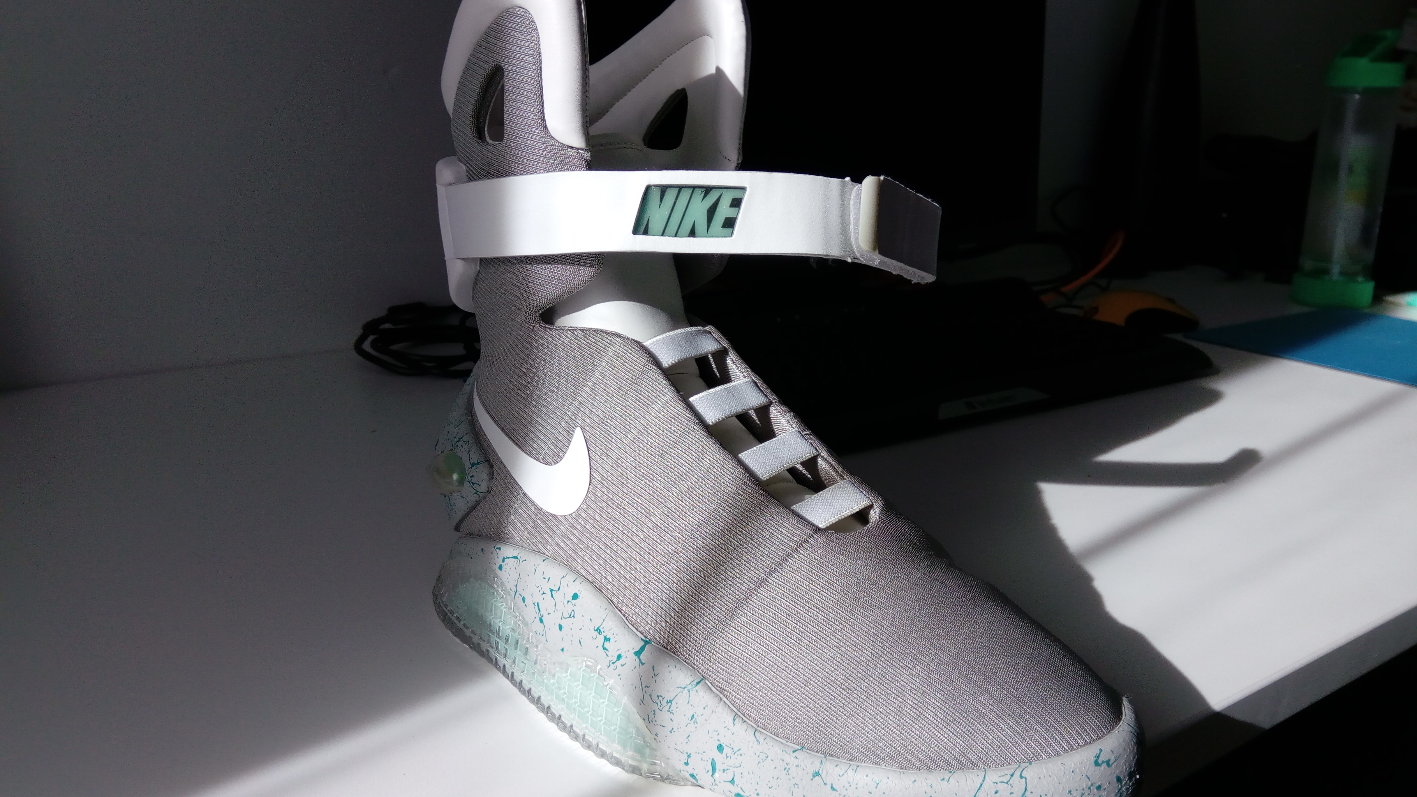

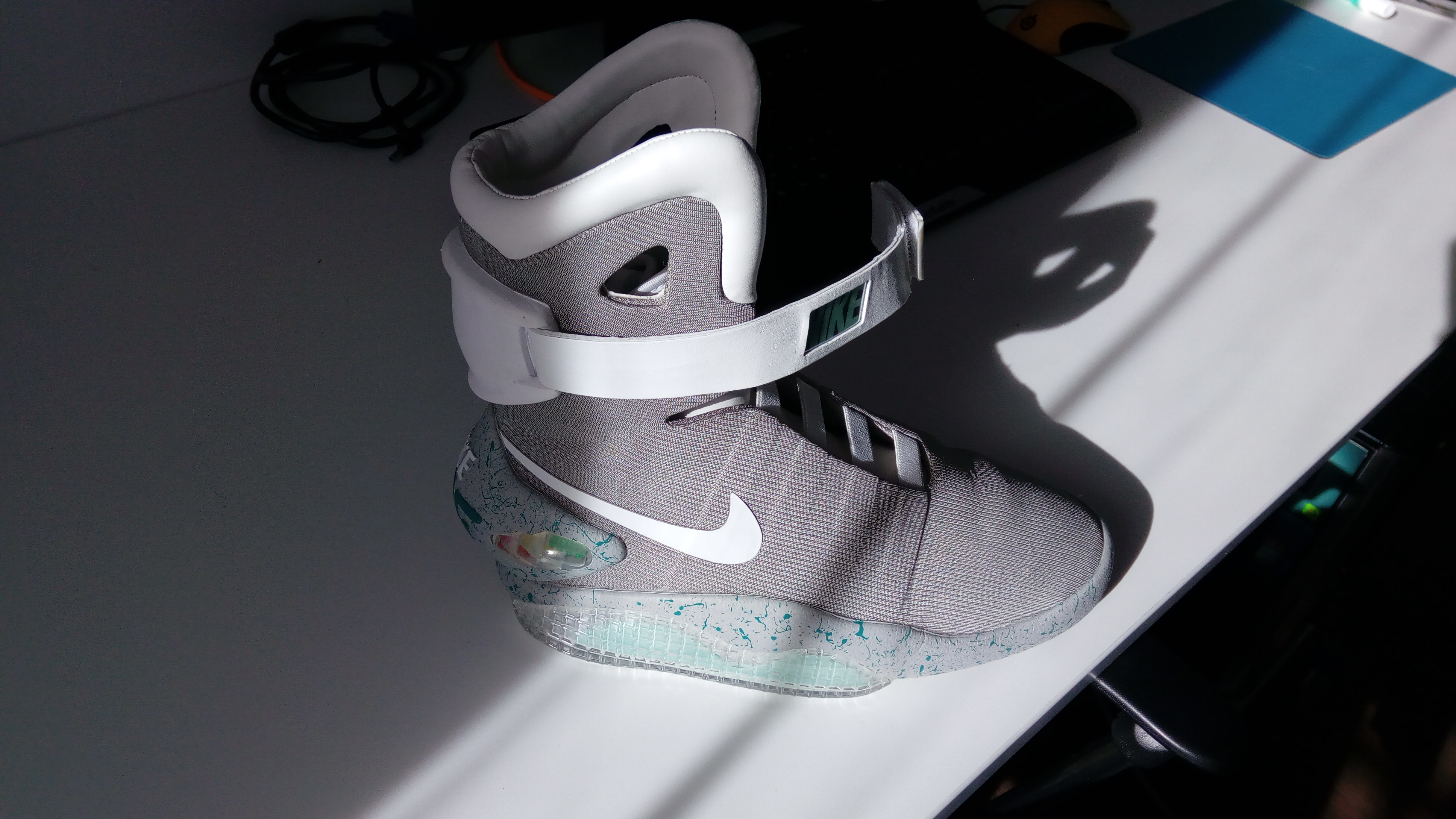

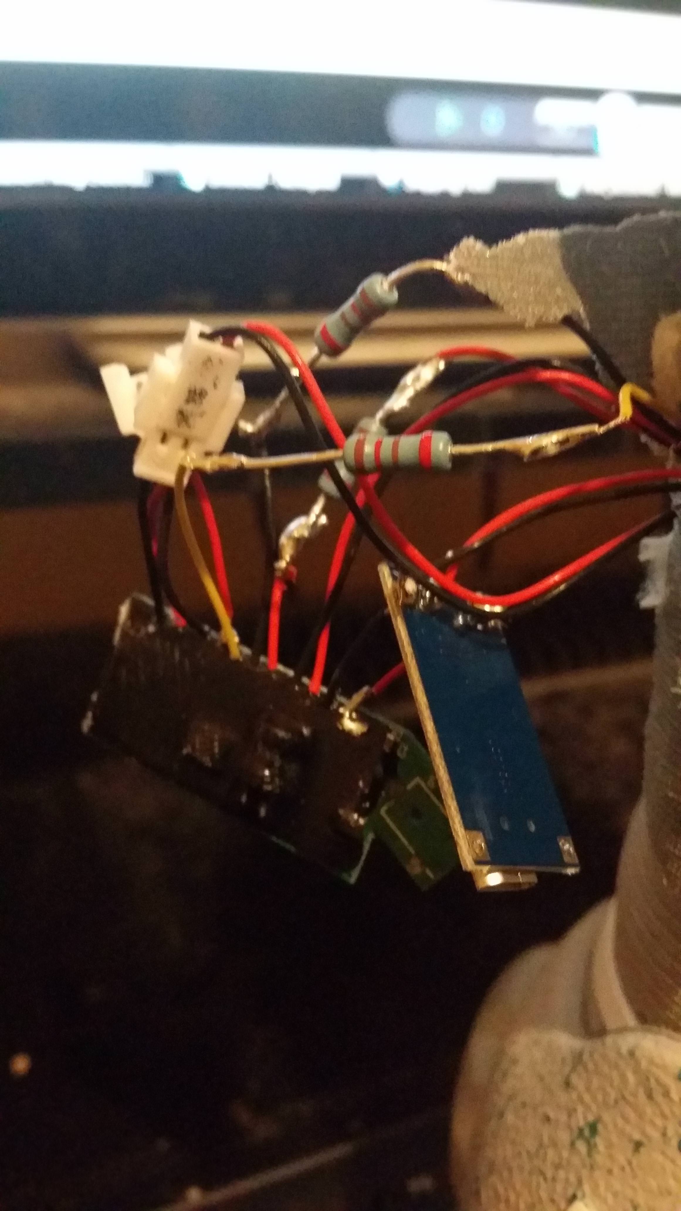

At cavx, i just followed Jedyfire's turorial, but instead of just doing half the buckle, i did all of it.
Btw i used 120 ohmm resistors, but i recommend 100 ohmm because these are ok but i actually like em a lil brighter. Im pretty sure that when i add the clear polish they will look more defined.
cavx, looks good - just remember the part of the side pieces that go under the sole (i think it would be extra to what you have here) are very thin compared to the side wall on the original soles. Hope these photos help.
In your photo it doesn't look like you cut the part off. I was hoping you had some good news here.
@cavx, looks good - just remember the part of the side pieces that go under the sole (i think it would be extra to what you have here) are very thin compared to the side wall on the original soles. Hope these photos help.

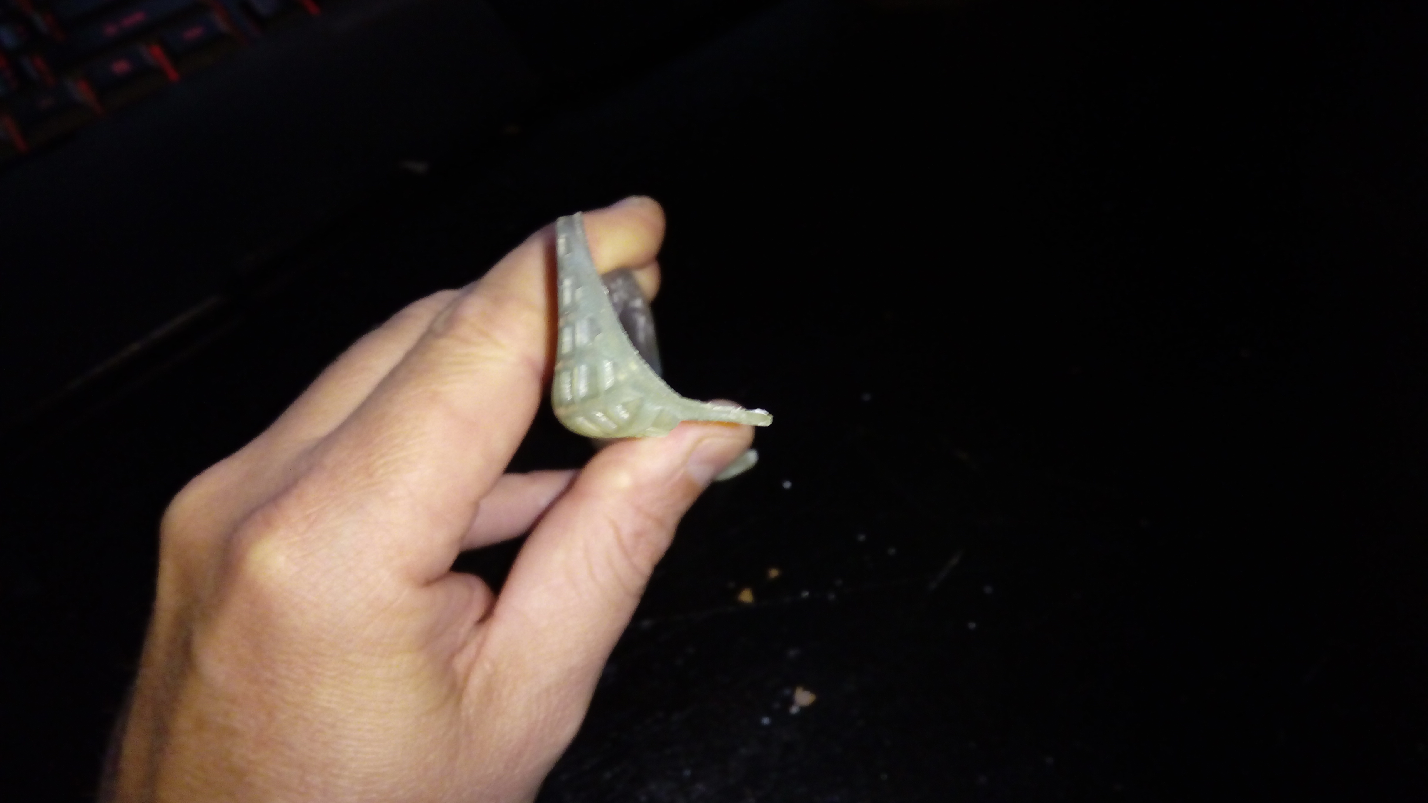

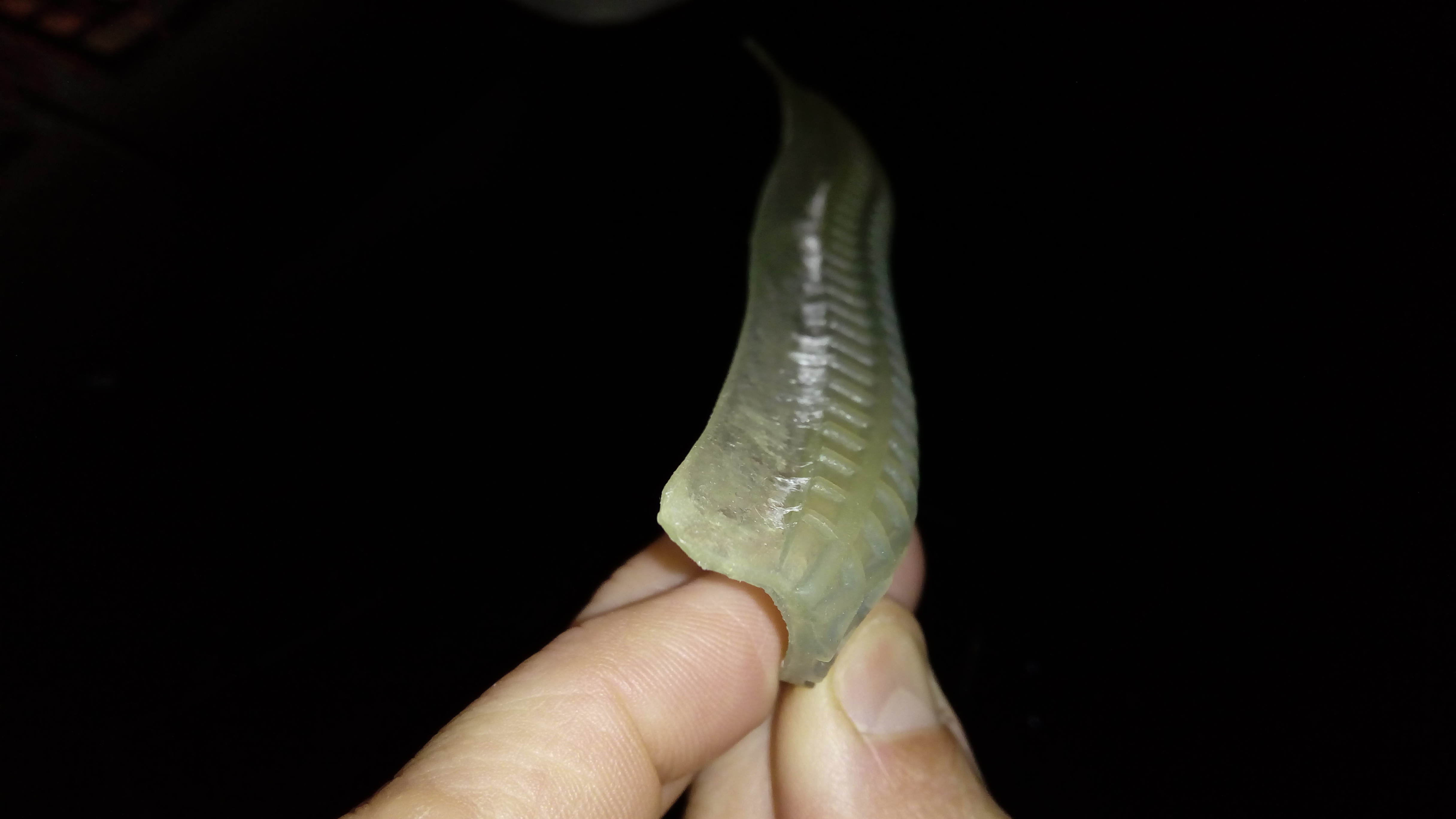

Maybe I rushed this or maybe I need to bond the waffle to the profile before I thermo form it.
As you can see in this image, some of the waffle broke off during trimming.
2nd attempt came out much better but still not perfect. I think bonding the waffle flat is going to get the best results.
So rather than hack up the 3rd piece of waffle, i thought I'd just use the scraps. I'll let this set up for a few days and see how it goes then.
The product used to fuse these together is Weldon #3 and it unfortunately attacks the surface destroying the glassy smooth finish of the Perspex. This means that the surface will transfer to the mold and therefore every cast part will have this clouded finish as well. Won't get to the Laser Cutter to at least Tuesday next week.

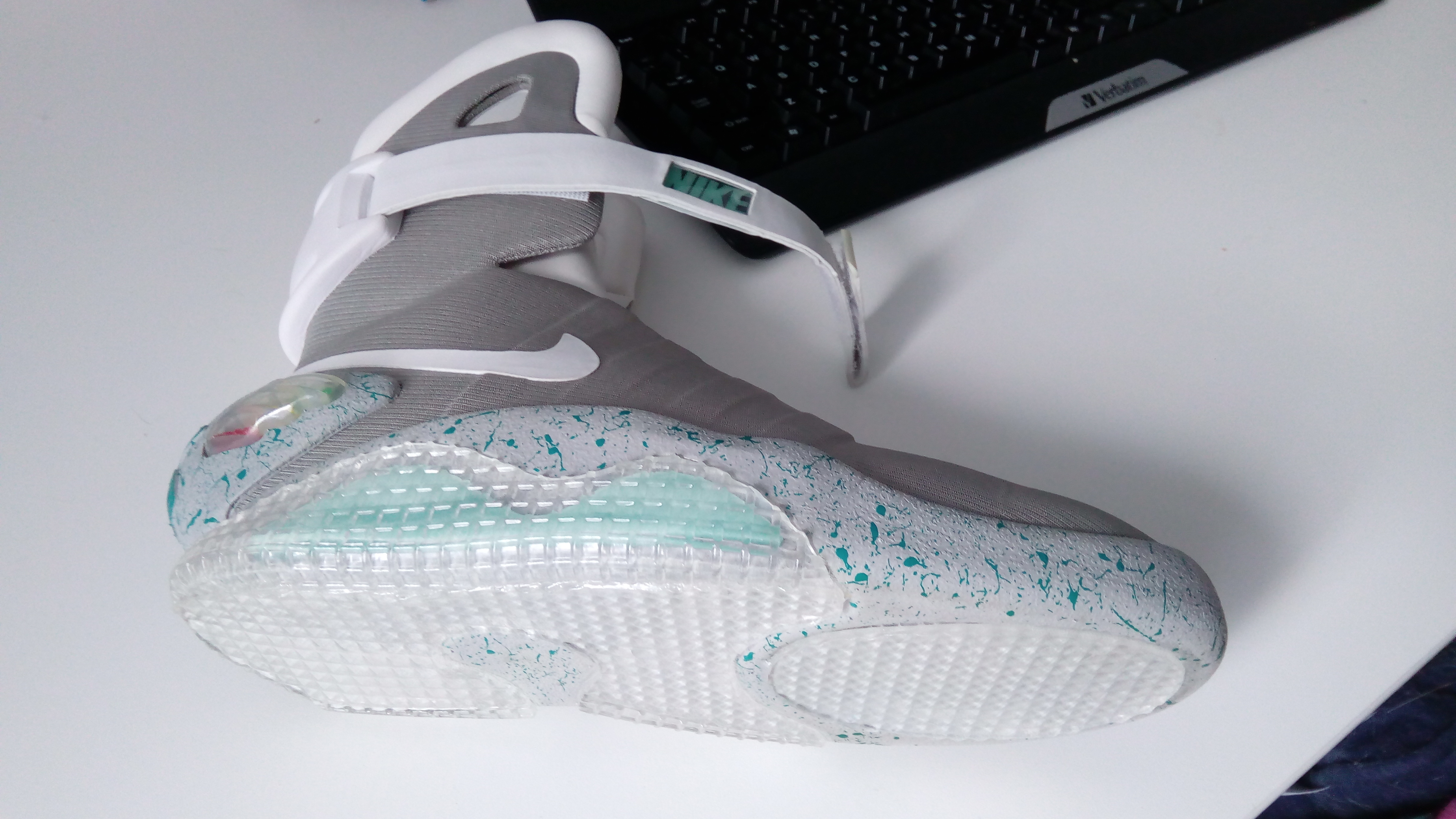

If it would make life easier I could post you my removed soles for US 10 size.
The pyramid mat's a little worn down (though probably not as much as yours) but you might get a better impression at least for the side pieces.

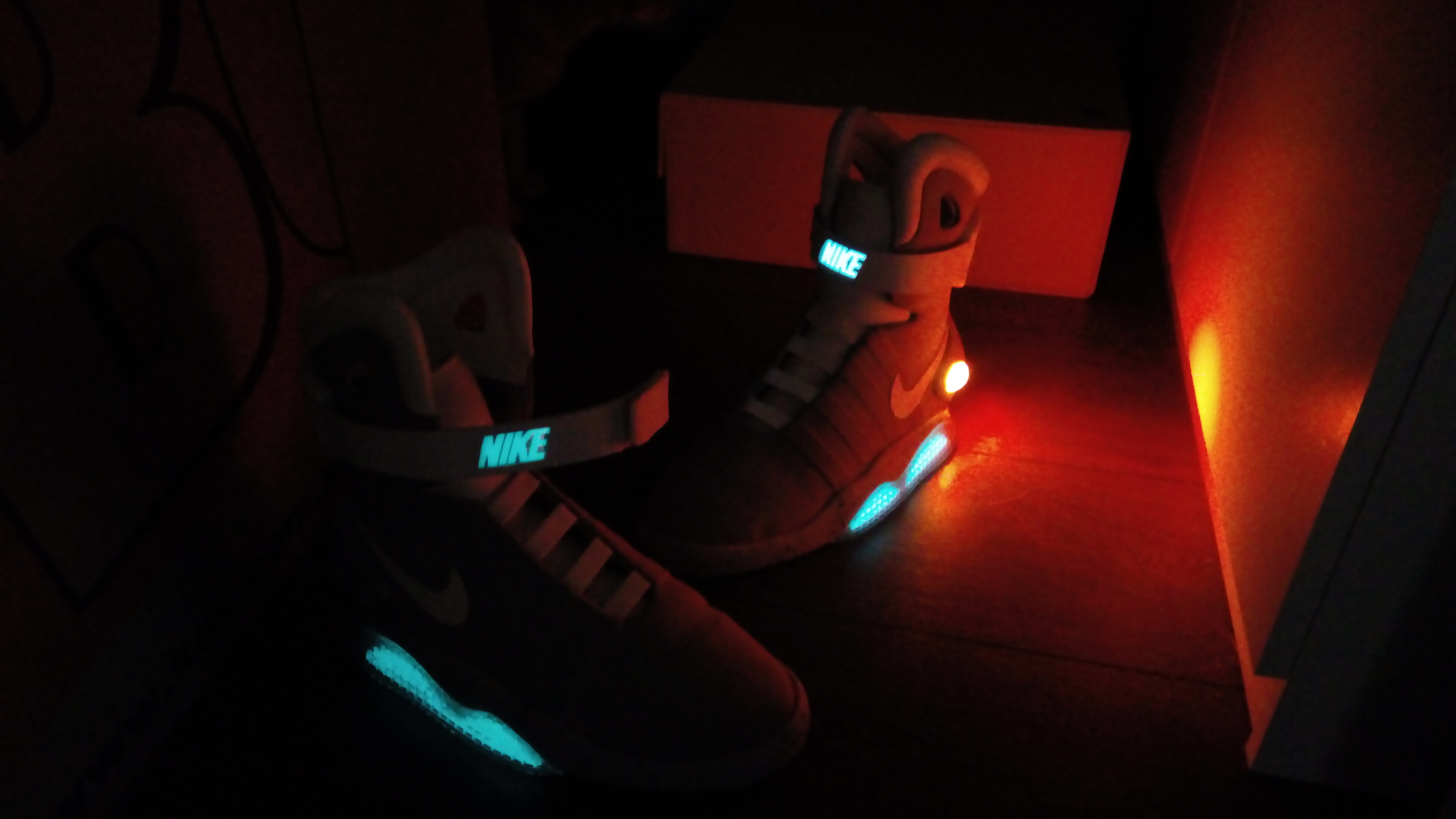

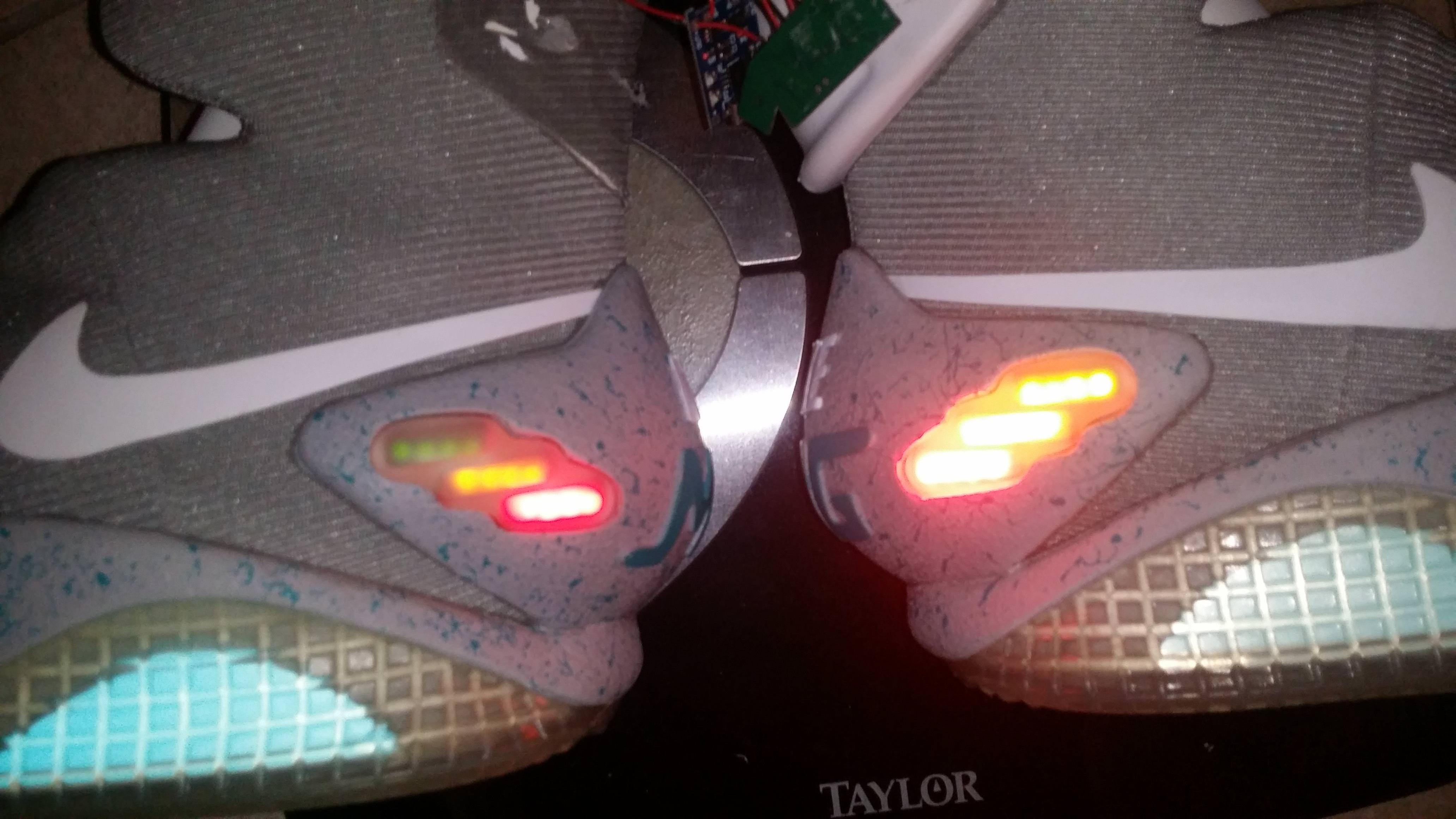

Completed the right shoe's sole swap and GITD install. Got a better finish on the strap this time. Happy with my result. Last photo is the right shoe with GITD and left shoe from one of my other pairs, running the electrical system. Pity I don't have a way to GITD the ankle bubble, but oh well.
IMG_20171104_082904.jpgIMG_20171104_082934.jpgIMG_20171104_083318.jpgIMG_20171104_084504.jpg

Offer accepted and you can have a free cast for doing this.
As for the pyramid, I have a brand new sheet of mat so can replace the tread.
