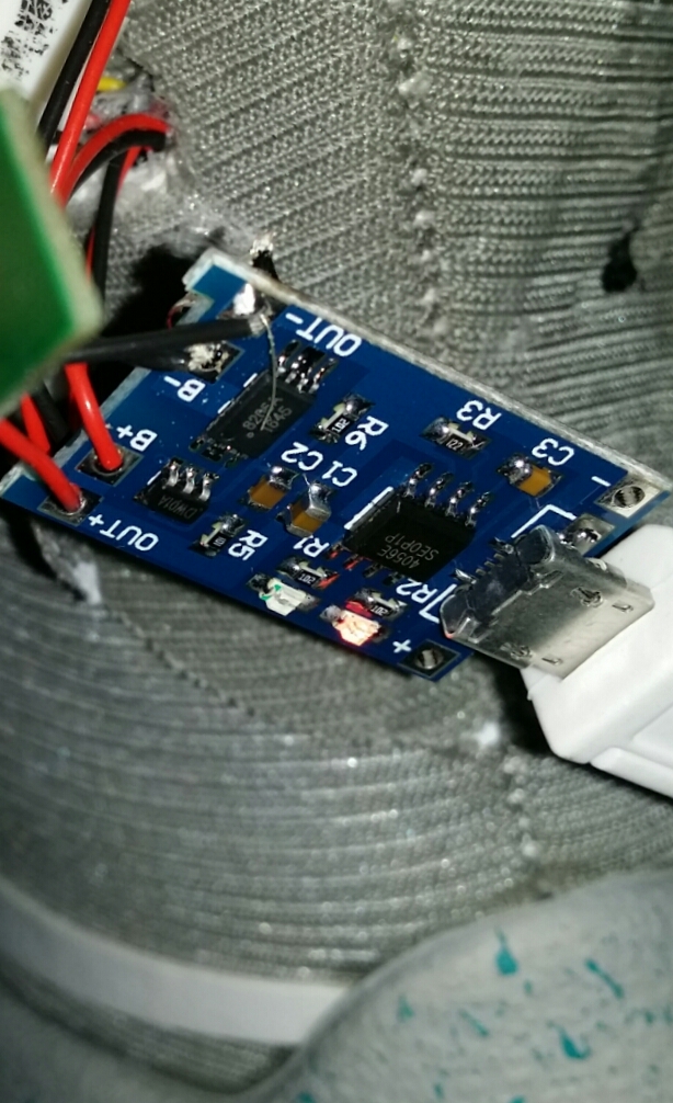

Surgery was a success.
I decided to add a charging board since old one's port broke beyond repair.
the upgrade now has micro usb connection, hence how I managed to hook up these awesome cables bought thru ebay.
the cables have leds that "flow" current into Mags and when charge is complete, the lights shut off.
cool way to finally know when your shoes are completely charged.
the red light is from board, not from the cables themselves.
Job is not complete, i still have to do the other shoe.
and this is the board:
TP4056 Charging Board Charger Module
here is where i got it from in case anyone wants it:
http://www.ebay.com/itm/2pcs-5V-1A-Micro-USB-18650-Lithium-Battery-TP4056-Charging-Board-Charger-Module-/191850083395?roken=cUgayN&soutkn=zkK2sa
just keep in mind the existing board is still needed, this board is used to bypass the charging process done via the existing charge port
i may do a tutorial or document the whole process later on but for now im just happy the shoe works again.

its a micro usb connection like the android phones samsung phones, newer ones
its really small to be honest;
it should fit fine next to the existing port
as
far as for the leads
if you mean how i did the wiring
i checked street veterans youtube video where he is selling all the electronics, and from there you can see what wire does what,
so the first wires do the battery
thanks @streetveterans
if it wasnt for this video i dont know what i would have done lol
its as simple as cutting the cables from the battery to the existing board behind the cup, and connecting the battery to b+ and b- and the other wires to out + and out-
ill do another post later on more detailed and also for other stuff ill be doing
like trying to connect the ankle bubble leds to the red light in the new board to force the shoes to show that they are charging by the ankle bubbles
but with this new cable, it doesnt need it
so idk if ill do that or not
doesnt hurt to test though.

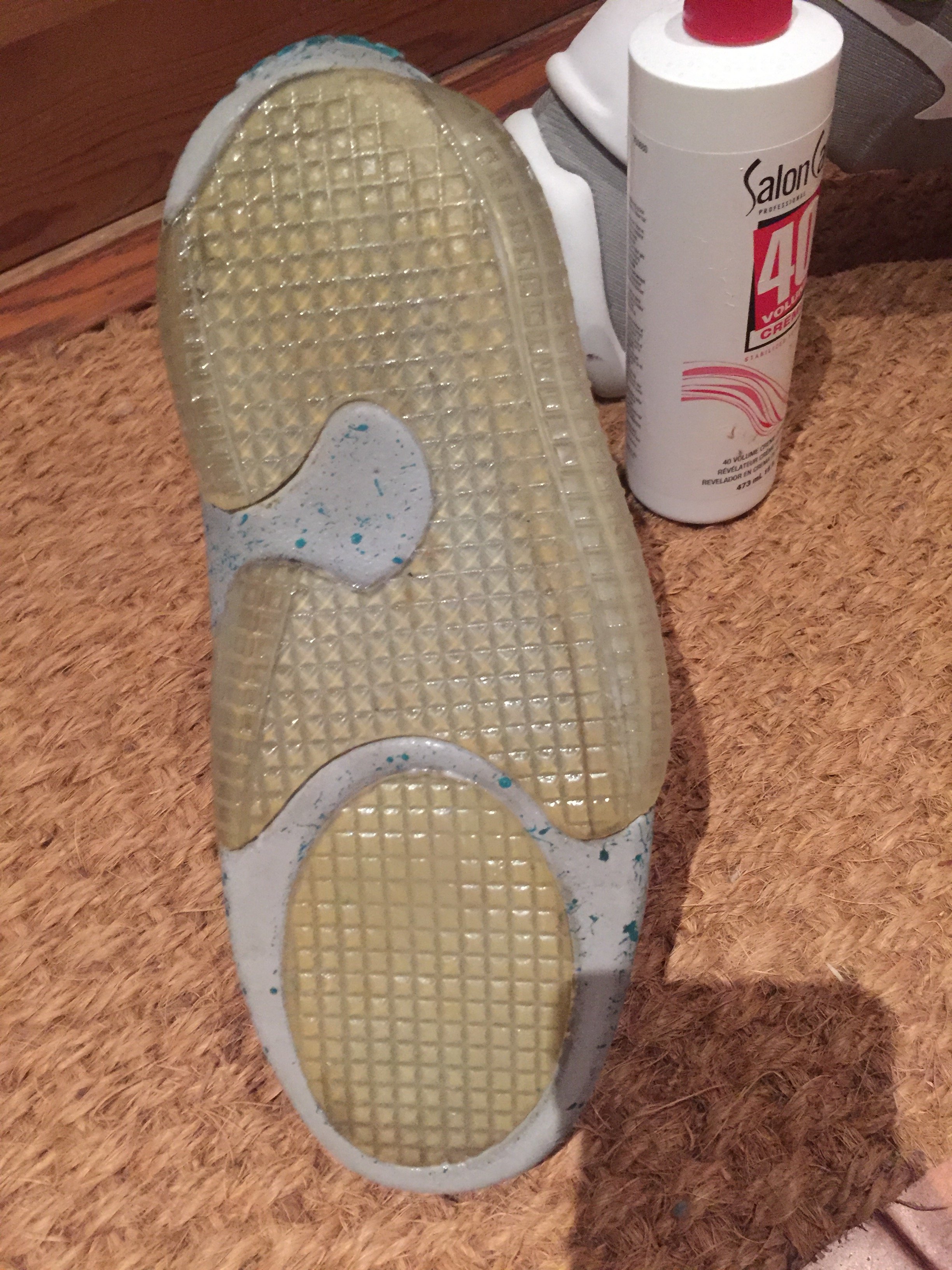

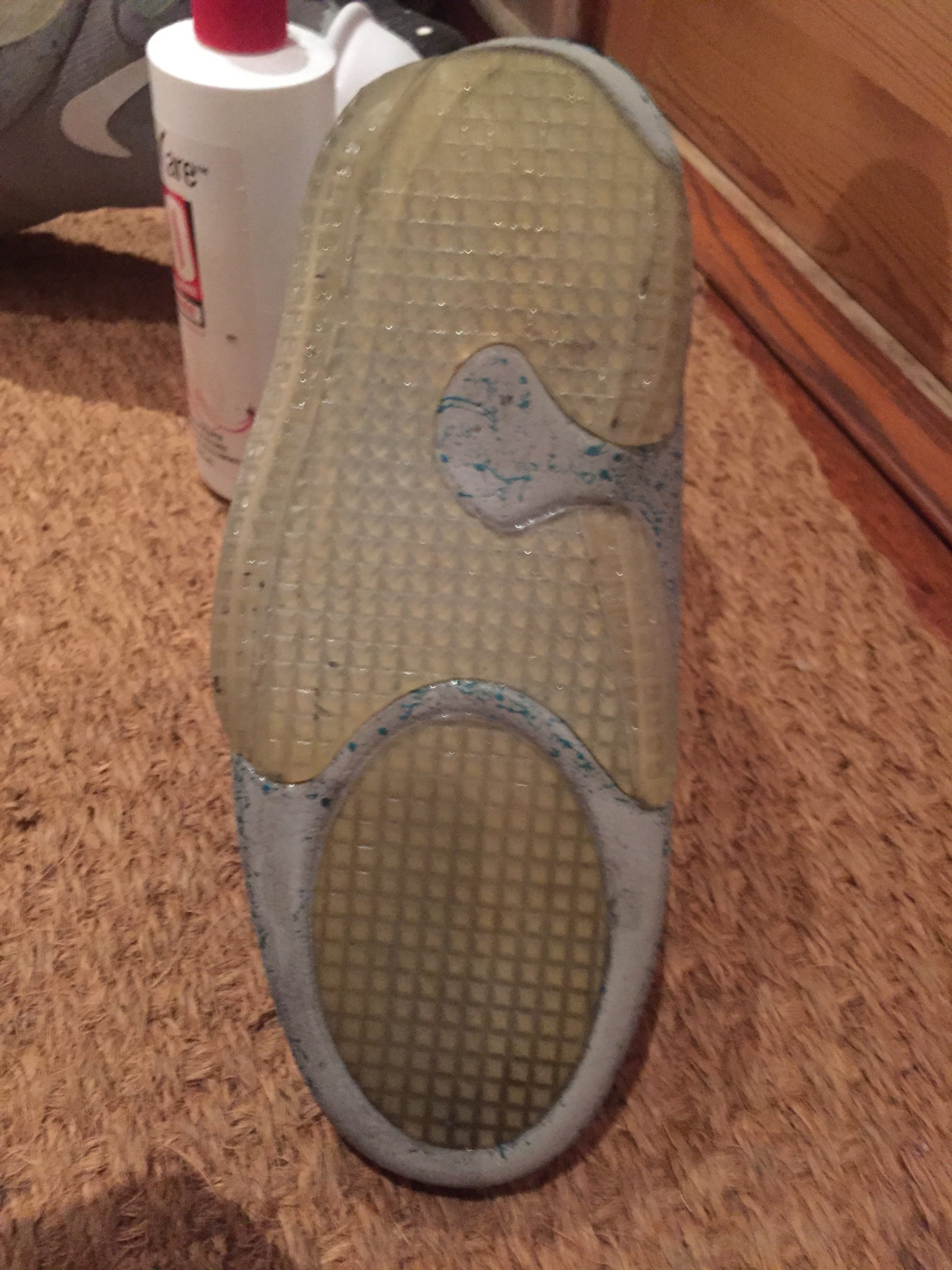

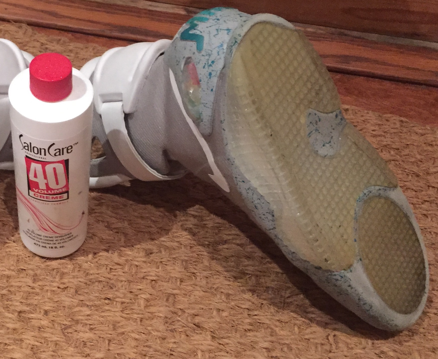

I just picked up this "Salon Care Creme" from store as people have had luck with it to lighten soles. My soles desperately need it as they are very yellow on the bottom. I will let you guys know how it works. I tried it today but there was no sun and I started too late. IMG_3586.JPGIMG_3589.JPGIMG_3587.JPG
Rather than leave your shoes in the sun, I would suggest that you track down a UV light (black light) from an electronics store and that way you control which part gets hit with the UV rather than just baking the whole shoe in the sun. Leaving them in the sun means that whist you are fixing the soles, you are damaging the rest of the shoe.
