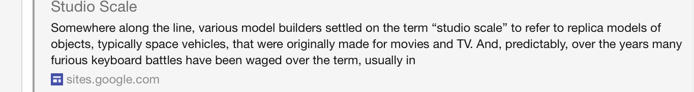

The concept of studio scale model making is totally fine. I have no issues with that. I do, however, have issues with the term, because it's deeply misleading. In particular it misleads the public, who aren't into the minutiae of this kind of model making.
This is a bit off-topic, but this is my rant into the night as to why "studio scale" is a really bad term:
All the dust-up apparently comes from the use of 'scale' instead of 'size' as a label... another not uncommon instance of technical terminology 'appropriated' by non-technical users who, uh-hem, lack appreciation for the technical aspects for which they are 'hijacking'.

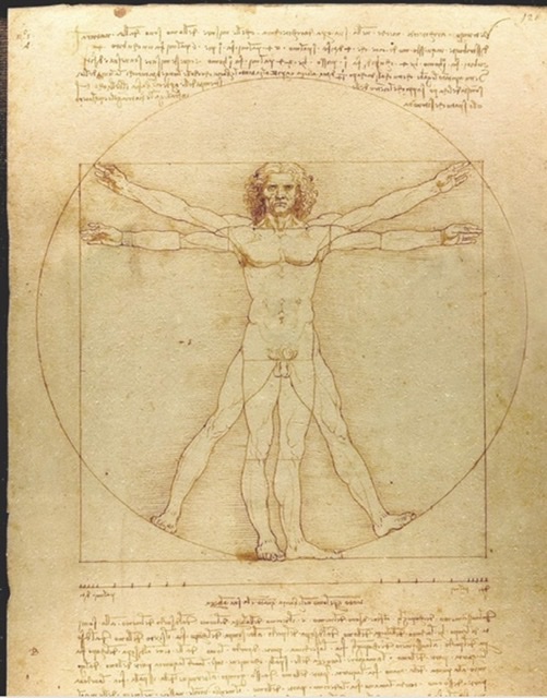

In architecture/ design industry we originally had this for scale…..

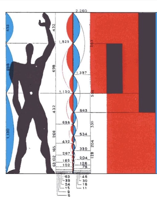

Then we had this from the self styled “Le Corbusier”( which btw I always thought looked like an Alien and good for designing & scaling fantasy spaceships.
Th

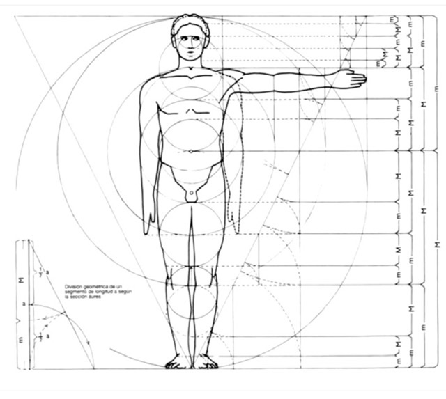

Then we had Mr. Neufert….

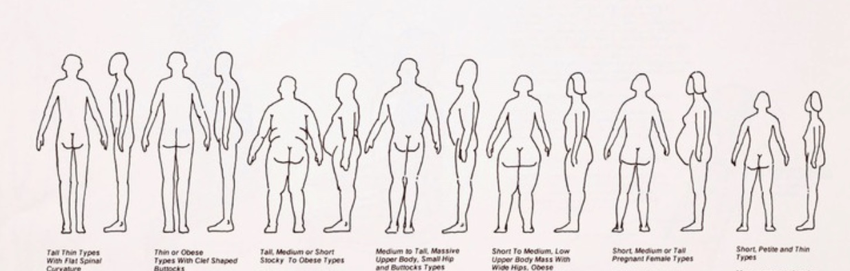

And nowadays they want to use something like this…..
