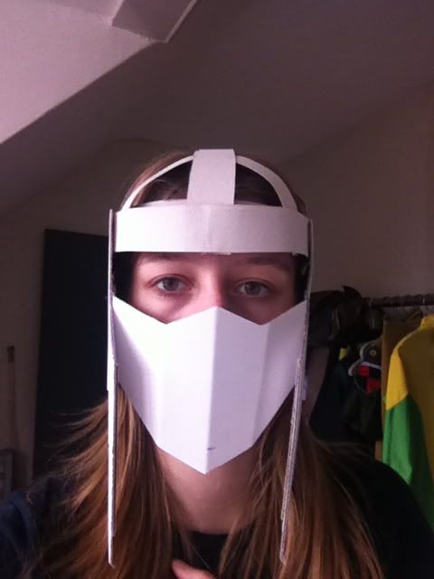

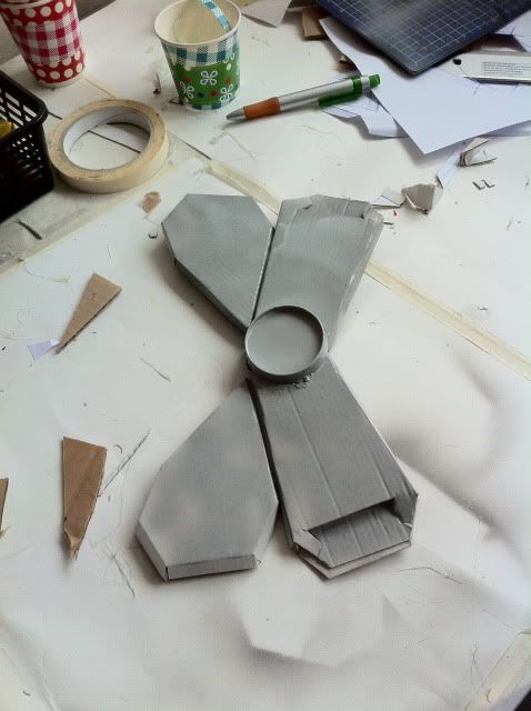

It's funny you replied(although you're no longer alone ;) seeing a new member on here), I have started with the costume. I'm quite satisfied thusfar, but my big problem is; I can in NO WAY find EVA foam here. So I'm working with cardboard and I'll reinforce it with fiberglass. I'm pretty much on the go and trying stuff out.
Almost all of it is covered in a first layer of primer. I want it visually less disturbing than all the ads on it.
Here I'm test fitting the helmet. Seems okay.
it also fits my sculpting head. Whoohoo!
Her (not finished yet) ribbon on the chest.

Mind you, I've never built a suit of armor ever. This is my first try in something like this. And thusfar, it's less frustrating than a sewing machine that gives up on you all the time....:lol

Yeah I've used that and the mecha manual mentioned earlier. I'm mixing methods and a bit of my own. I'll see what works. That tutorial is especially nice when it comes to the helmet. (I just can't find the cheap bowls he talks about here....)
