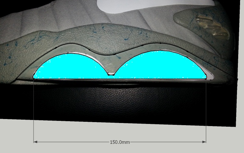

I would make the el shapes even smaller, as once its behind the rubber, it will look bigger than it actually is, although not sure what it will look like behind your clear soles.
You need to leave a good gap around the edges to glue the clear soles back on.
Thanks airair. Yes very important to have gluing surface especially with these clear outriggers.
Good luck with the EL cutting.
I'll be using a sharp blade instead of scissors on a cutting mat. Been watching a few YouTubes on this and they all seem to suggest best results from this method. .

A sharp blade on cutting mat is good, less chance of something going wrong, although i have used scissors sometimes.
Cool. I'll go with that. Revised the shape a bit. You can see the older shape poking out in white.

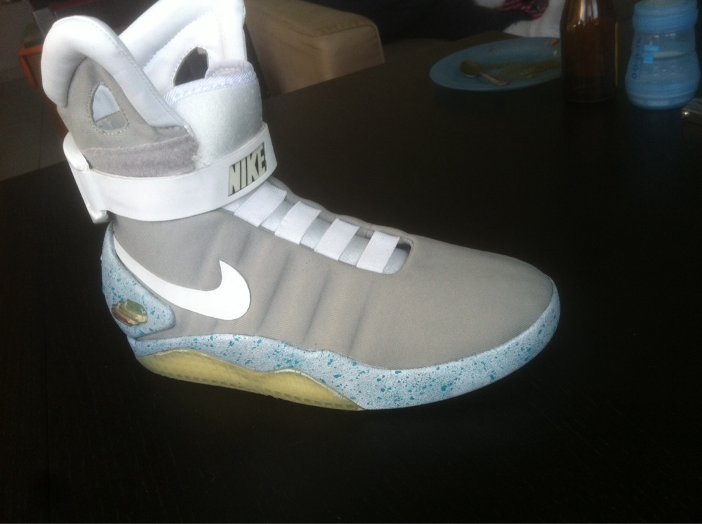

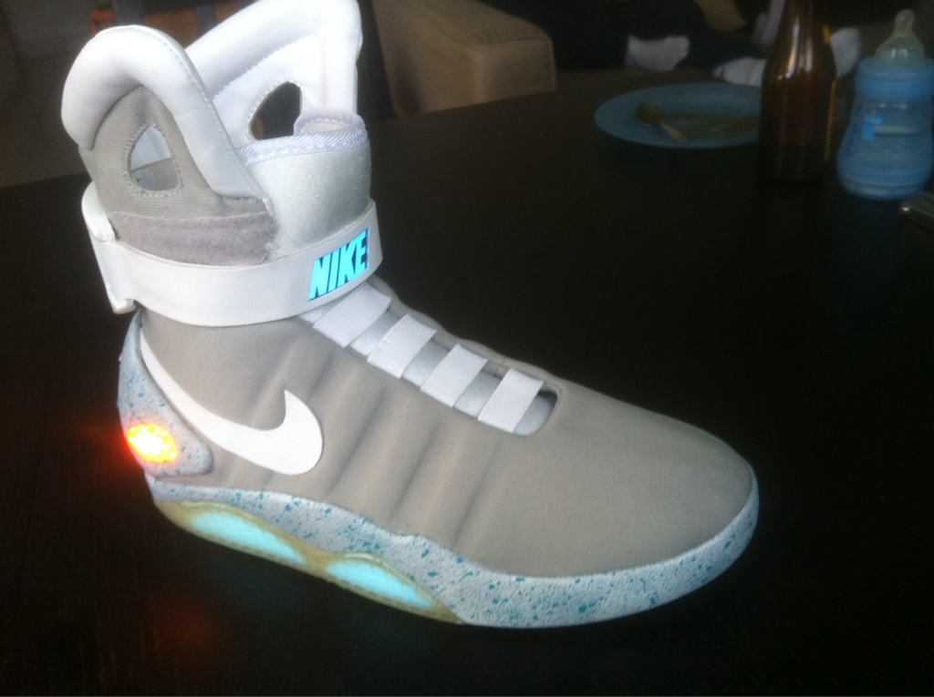

Those looks awesome. Just needs clonesprops buckle and cavx's clear soles and you will be golden. I really like the movie accurate dotted splatter instead of the 2011 streaks.
Good job. The slimmer toe and the lighter grey mid-sole really make these.
Vormz those look amazing!
care to share what paint/colors you used on the midsole, it looks great!
Thanks a lot guys! I'm really happy how it turns.
I just have to "frost" the leds area and maybe whiten the yellowing sole. I want it to be closer to the screen used than the RDs.

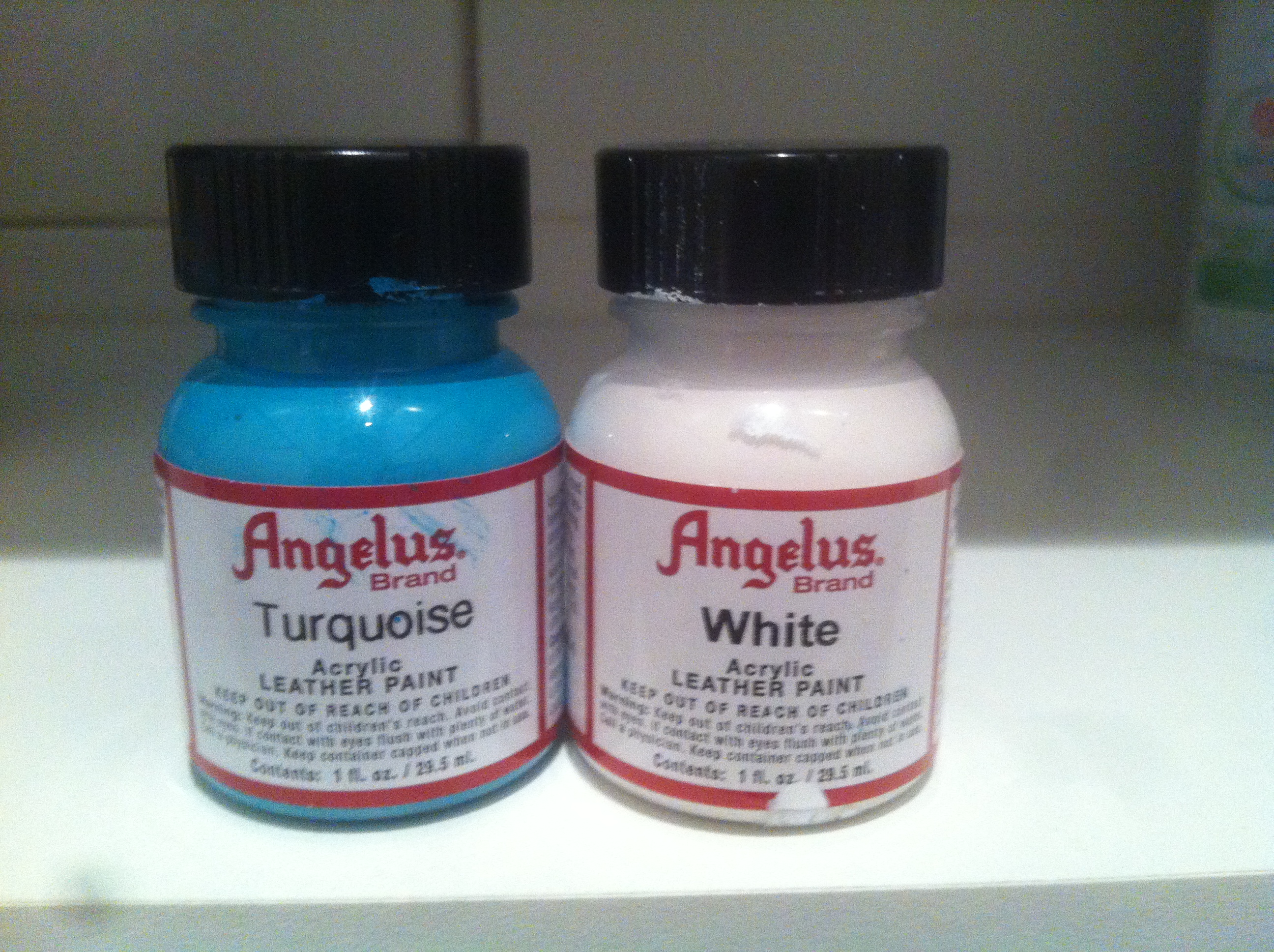

I used Angelus Turquoise paint for the splatters and Mag lettering and Angelus white paint to lighten the grey sole:
Follow this tutorial : https://www.youtube.com/watch?v=HZxkCac3e9k&feature=youtu.be
It's simple and no peeling or cracking for now, but I only display them...
nice work on the midsole, Vorms. I repainted the midsole on a pair of mine because they were yellow and the lighter colour looks better. Never did get around to speckling them though. That Angelus turqoise might be the way to go for me when I get a pair of Cavx's clear outsoles, as I will paint under the clear then. I see your outsoles became as yellow as mine. It's such a pity they do that.

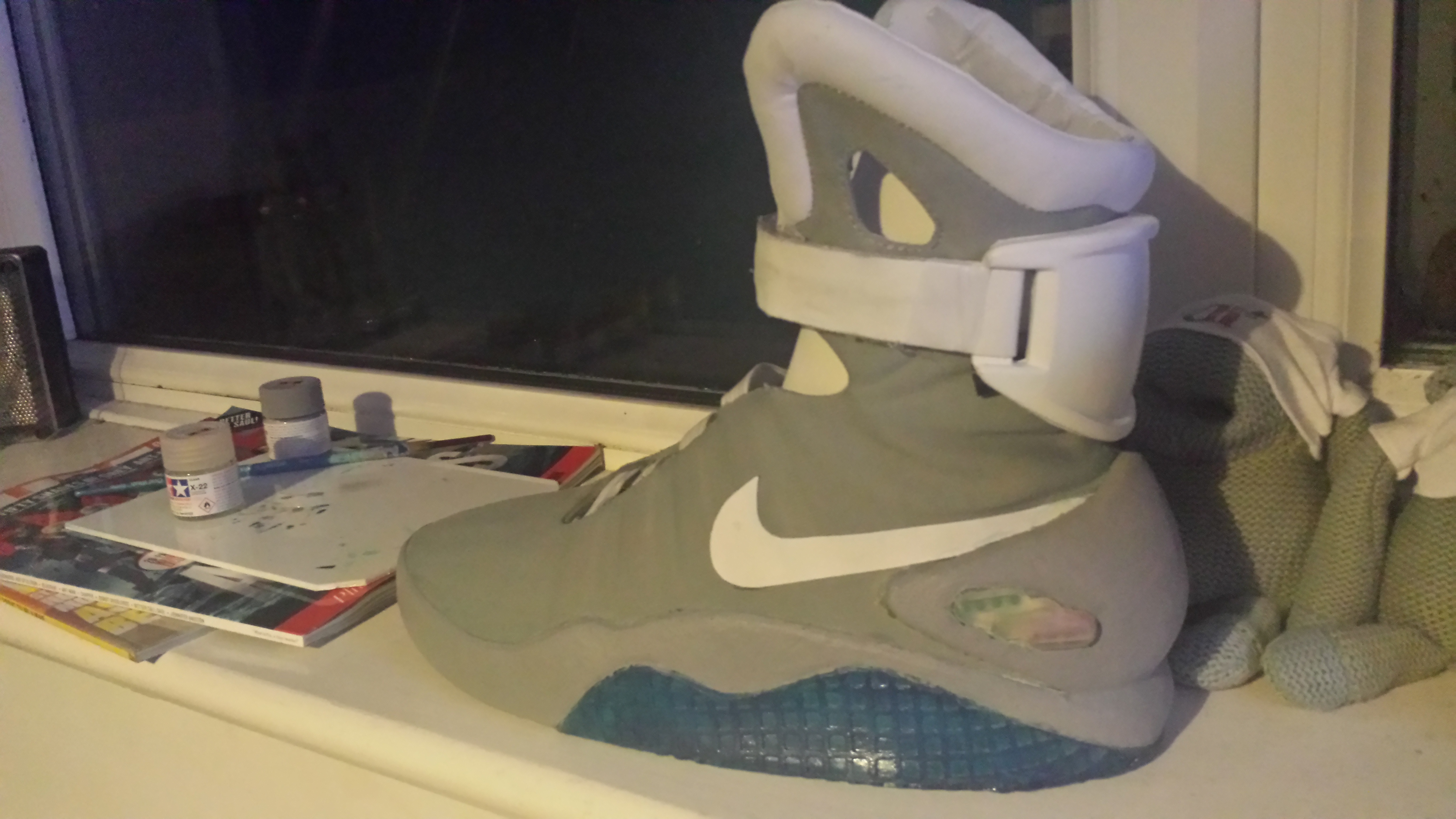

I went for the Tamiya XF Sky Grey acrylic paint. Did 3 coats last night and have given the shoe a bit of a flex and there was no cracking at all so hoping this holds up. Checked this morning and they have dried nice and smooth.
Just got the splatter to do later then a coat of Clear Tamiya Acrylic again to seal it all up. Putting a lot of faith in Tamiya products here.
