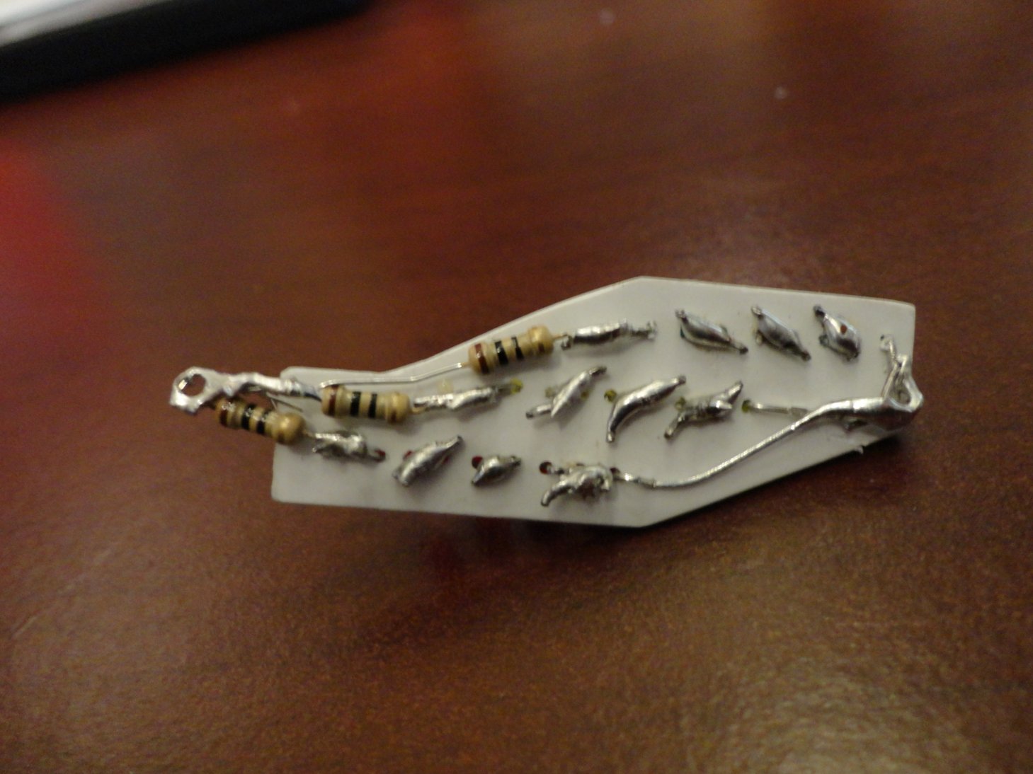

Hey Alvin,
I think you installed the resistor the wrong way. The resistor should go infront of the positive lead before the LED's on each row. Also the gold band on the resistor needs to go towards the LED's. I hope this makes sense

Standard resistors do not have polarity. Also for LEDs, you can put the resistor on the negative or positive lead. I know there's a lot of info stating to put the resistor on this or that lead but there's even more info countering that misinformation.

I think I got them all on the positive side correctly, but I def. did solder them in with the gold part facing out I read that it didn't matter which way they faced through google somewhere. I guess that was inaccurate? Can you explain that really quick for me? I'm assuming there is a positive and negative side to the resistors then...
I guess there is the answer. Thanks ARKM. Yeah I also read it didn't really matter what side the resistor went on too but I wanted to stick with what I already knew was working for everyone. Thanks for the feedback gents.
This is news to me. Though, I will have to double check this since I am certain that my LEDS didn't light up when the resistor was flipped with the gold ring was near the positive lead.
