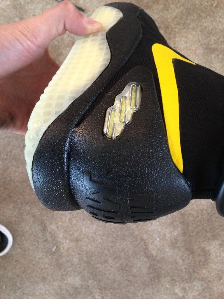

I love this group of die hard enthusiasts. I literally spent the last 2 days tearing apart my shoes. I killed the lights in there that came with my V2. I'm thinking I over charged it? Anyone have this issue? Interesting that China used a regular watch cell battery.

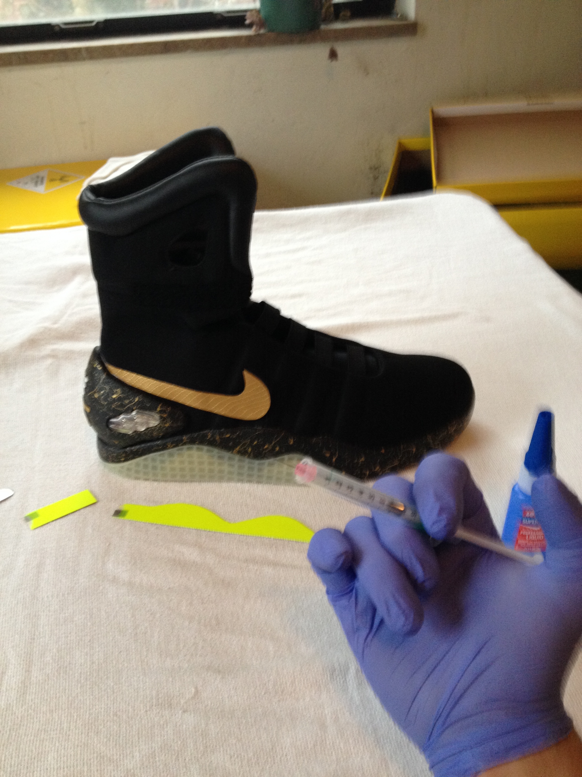

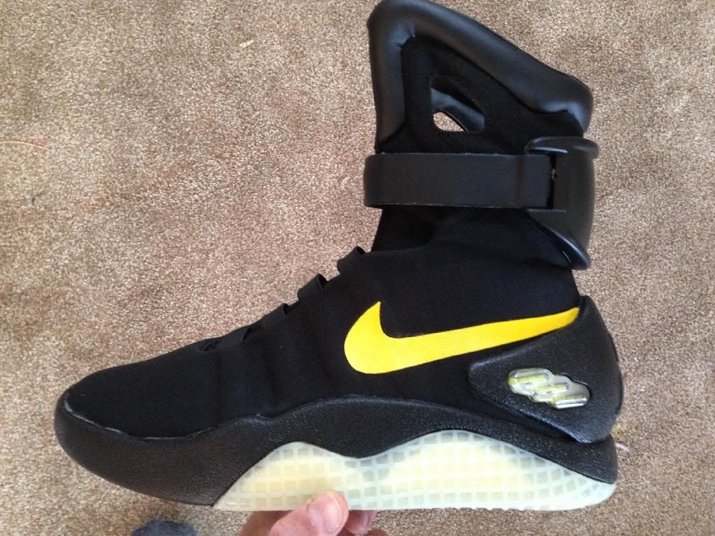

i made my own yellow el panels i discovered floresent paint is transparent and glows yellow when lit dont photo well ill see when i have them in the sole but i used faskolor air brush paint its for rc car bodies ill cover it with clear packing tape to protect from scraching :)
im doing the swoosh in el as well this gold thing they have on hear is gross lmao

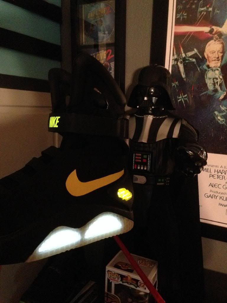

Cool DJ. My FOOTWEAR MAGs are almost done. The FOOTWEAR logo is too big in this photo and will be about an inch shorter in length. The NIKE and MAG logo on the heel will be the same yellow as the swoosh and footwear. All the LED's in the ankle are yellow and the EL in the soles are white but the soles will be tinted yellow...
so sick JEDIfyfe
I used white els as well but painted them wit floresent yellow paint its glows yellow ,weird that regular yellow blocks the light ?? but im going to paint the sole as well just started today on the toe mod also planed to use all yellow led as well seems great minds think alike LOL
im taking the crappy gold splatter off with goff off what do you use bro or did you just paint over the gold ??

as for the black silicon, I guess you could do that. the clear shows up in photos much more than it does in real life, so I am not concerned about it, but go ahead and try it. As for the yellow NIKE emblem, I used yellow EL and put the clear/black NIKE logo over the top. It's the same NIKE logo that has been posted many many many times before.

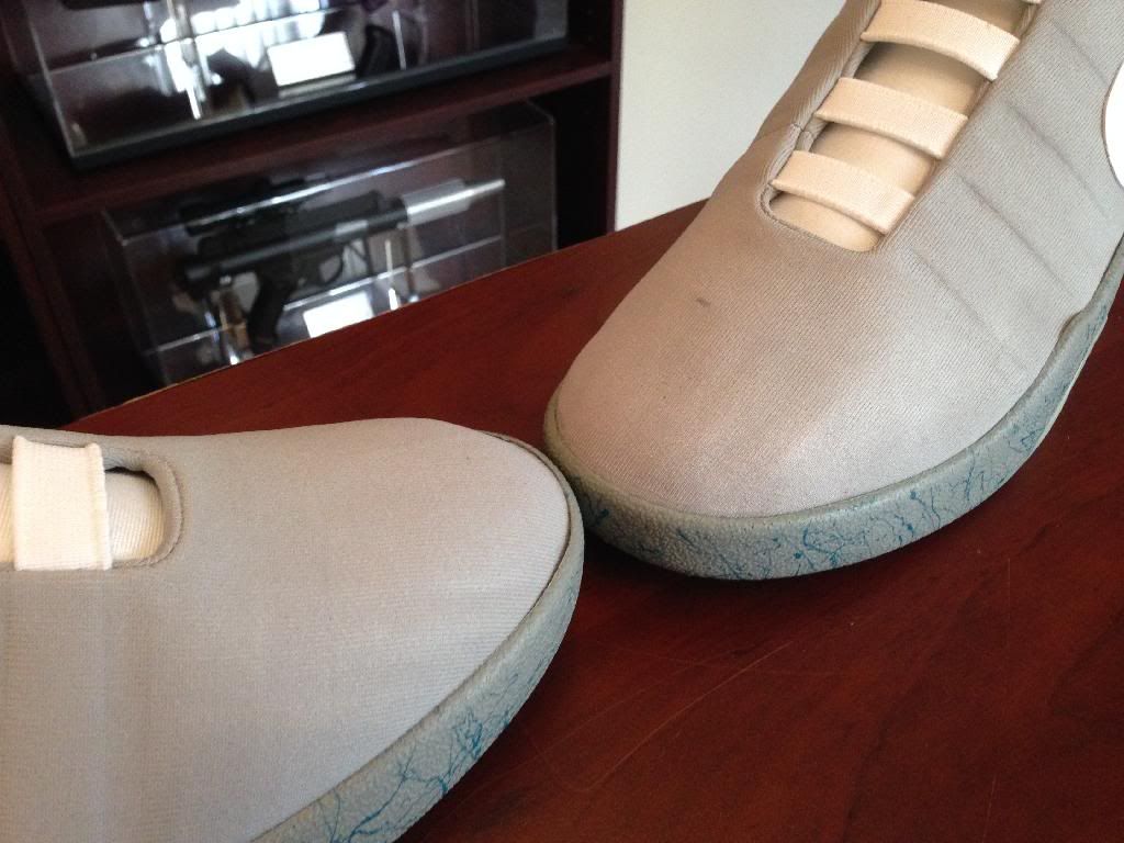

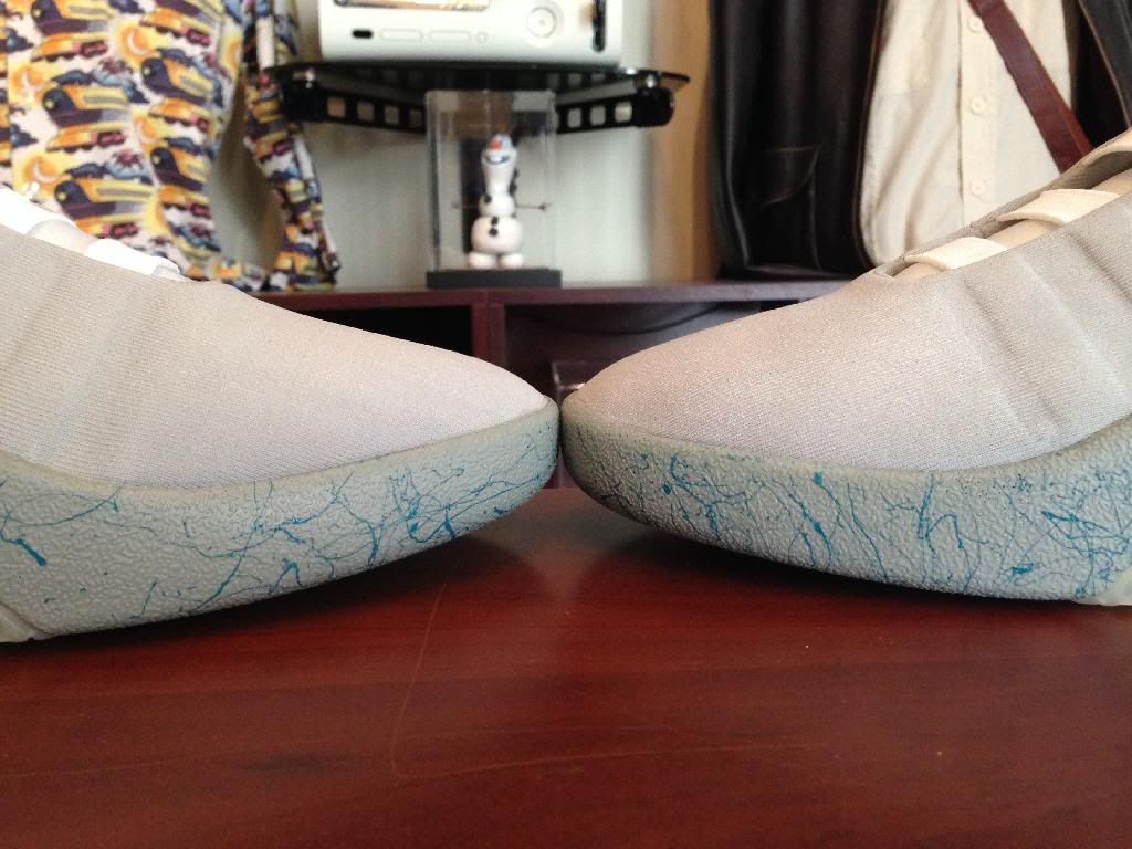

The grey fabric is slightly overstretched over the original toebox. It is pushed up by the rigid white material underneath. If this material heats up it gets soft and the grey fabric can go back to it's natural shape. As you can clearly see from my images, the grey fabric's structure runs perfectly straight and parallel after the mod. It is not compressed and didn't shrink further that to it's natural, unstretched shape.
nike-mag-v2-mod-discussion-page-58-shopping-list-mag-mod-5.jpg-292086d1393640140
This will never ever pop back. No way.
It doesn't even pop back if you re-heat the toebox. In my initial try I made the toebox too flat.
When I re-heated the toe area, I had to push really hard from inside out in order to make the toebox bulge again.
Even if someone wanted to restore the original shape, there is no way to do that as you don't have enought power to overstretch the grey fabric again.
I wore the modified shoes already and they still look the same.
That's all I can say.

You can remodel the complete toebox like this, heating up one segment at a time. It takes some time, but works really well. airair already confirmed it:
I just got the iron out and went over a few of my own pairs which have slight wrinkles in them (thats after I cut them and glued them back), and the iron trick with a thin towel has done the trick, its smoothed out the toebox completely on them, the rigid part goes soft with some iron steam heat, then dries back to its original hardness and not a single wrinkle!
Emmet, top job! such a simple thing and no need to cut anything up again! :cool:thumbsup
Emmet is right, the grey fabric on the toebox seems to be stretched by the rigid toe piece when they've done it in the factory over the shoe last.
I don't know what its called or what type of material it is, but i've removed it on a few pairs straight after cutting up the toebox, and you can see that is quite hard and stiff.
Sometimes it peels straight off in one piece, while other times, it seems to be stuck quite strongly to the inner bit of the grey fabric.
When I put a hairdryer to it, it sort of melts and goes very soft and gooey like a glue or something similar. You can even start to peel it off then or scrape it off, so I believe steaming with the iron is doing the same thing, its melting it and then you are reshaping it down.
I got two of my own pairs which i've done the toe modification on (cutting them up and glueing back) and since they had slight creases, I simply put my hand or some fabric inside the shoe, got a thin towel and started to iron over the toebox.
All the creases have gone and the toebox is now perfectly shaped. I even pressed down on it, and it just pops back up perfectly.
Well what I can see in your video is just the regular behavior of the V2s lights when the battery is empty. The blue light is off, the green and orange lights are dim, only the red lights are still on. If you put the USB charger to this shoe all lights should light up again. If not, you probably broke a wire off the shoe's usb port.
