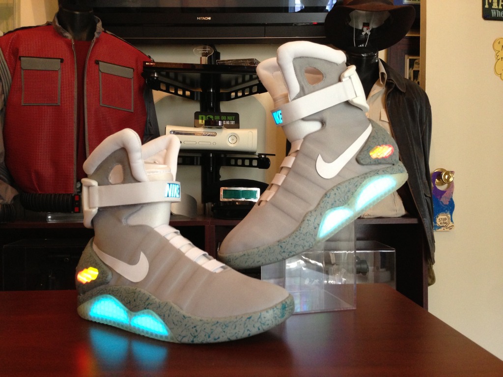

I just finished these up for a member. Almost done with another pair and just starting my last 2 conversions for customers.... UGH!!!!

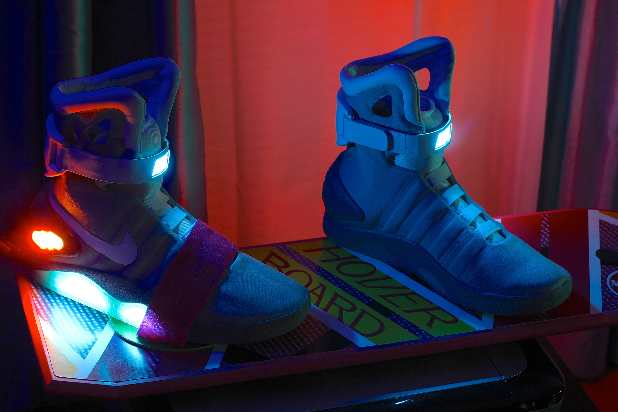

After my attempt at ironing down the laces. Shoes on the Hover Board!

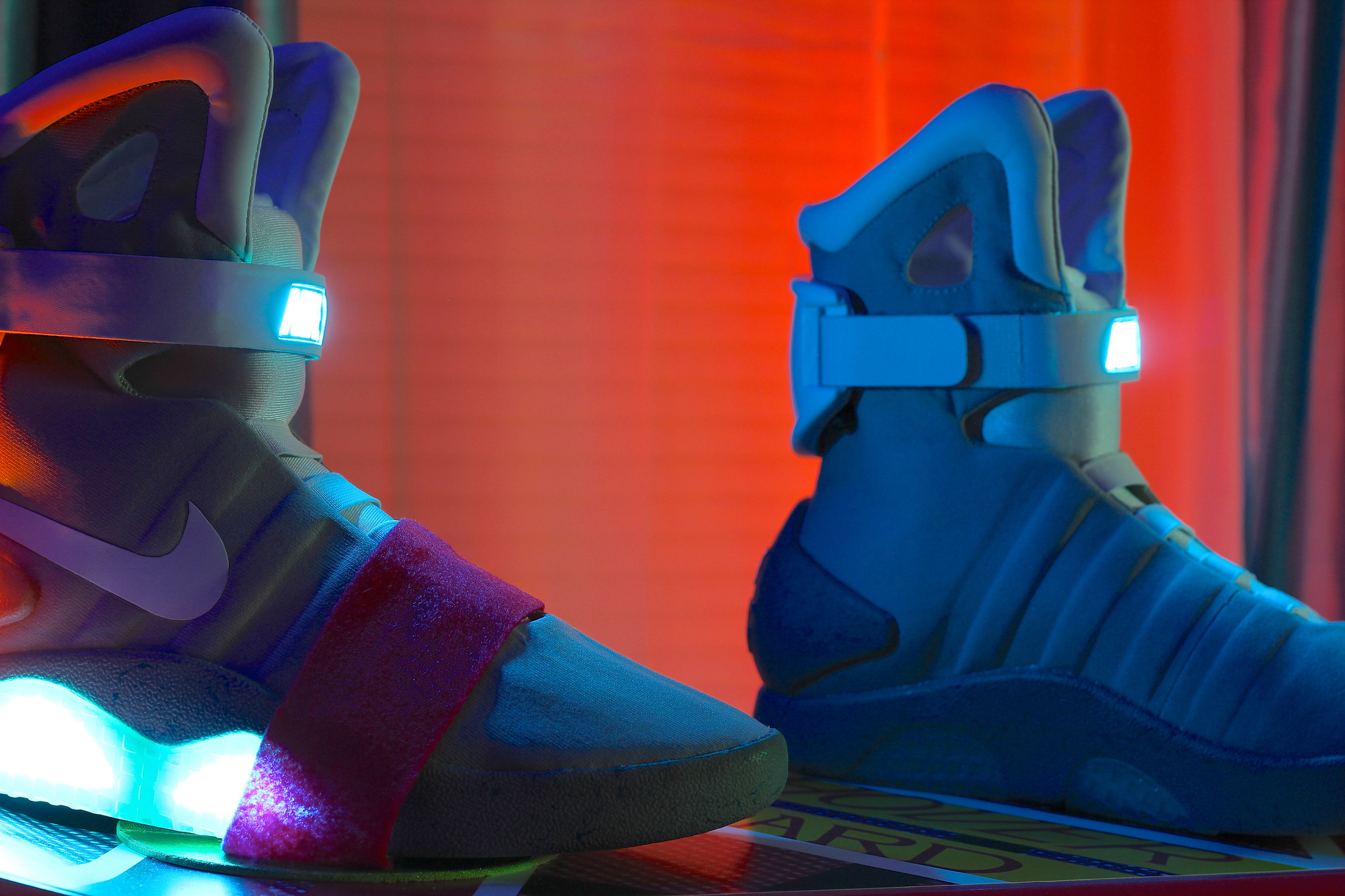

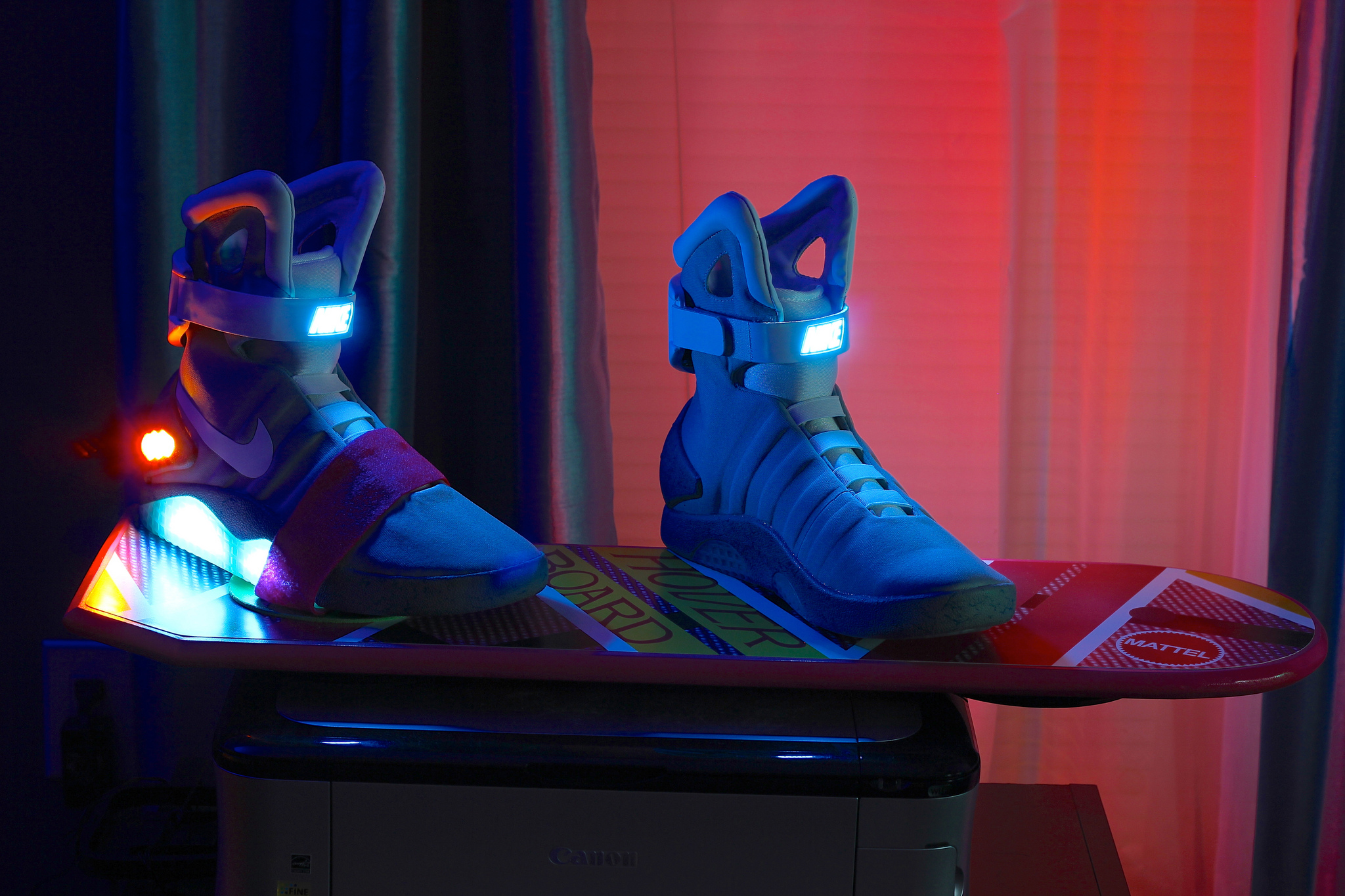

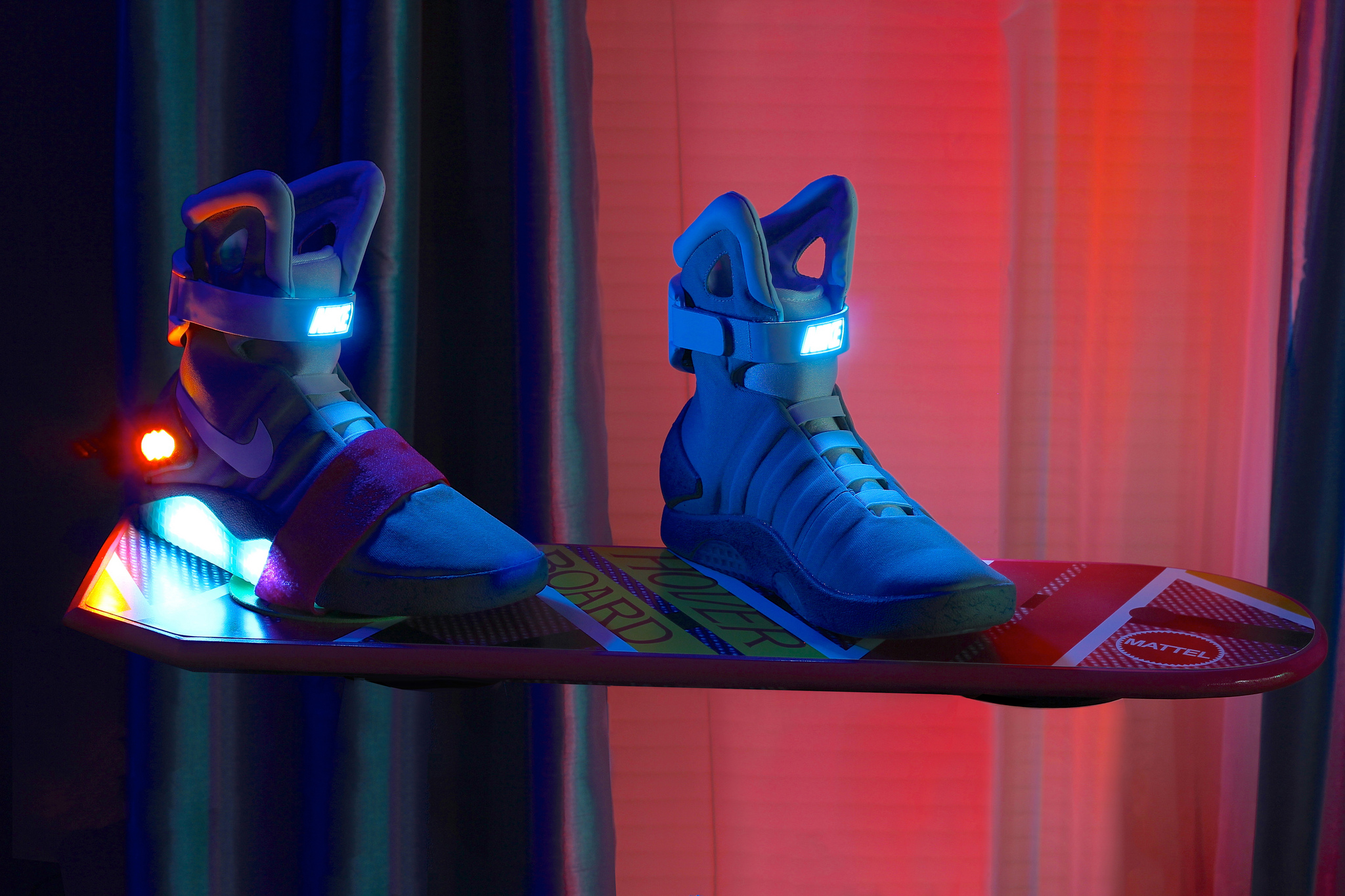

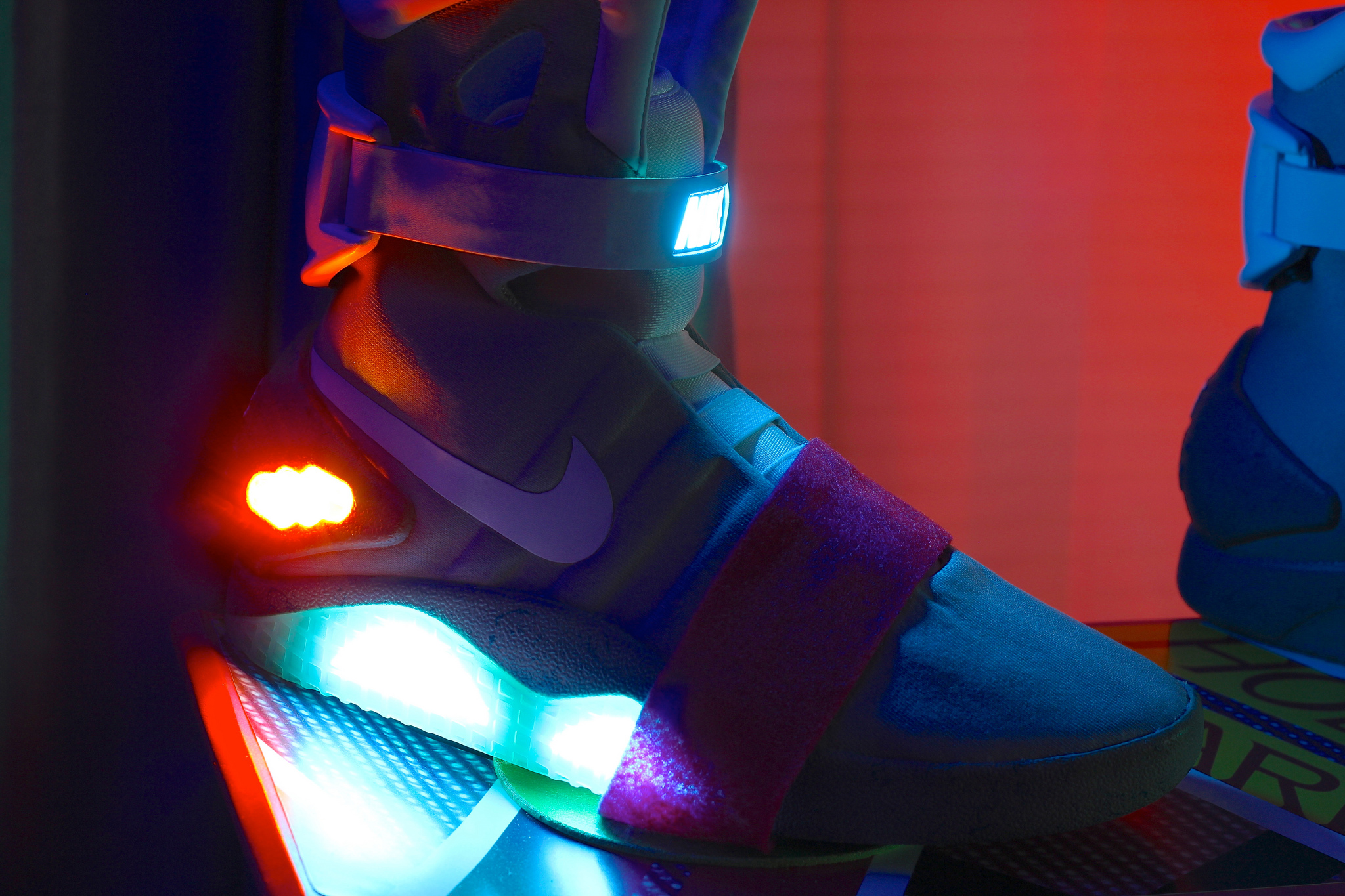

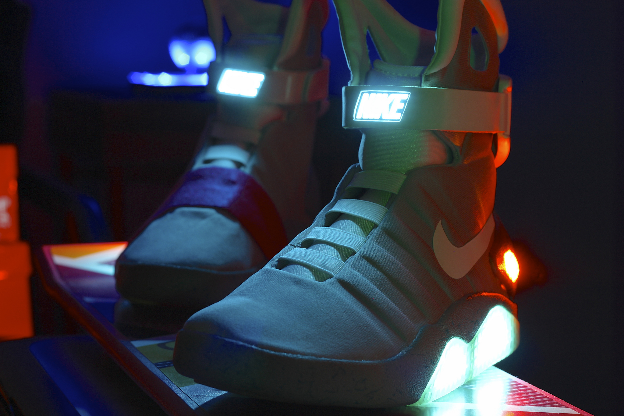

So here's the full set of pictures taken.
The pictures were made using a long exposure technique. I did this so that way I wouldn't have to use any light that wasn't coming from the shoes themselves. I really love the various hues of reds and blues the shoes give off.
And finally one with Photoshop Magic

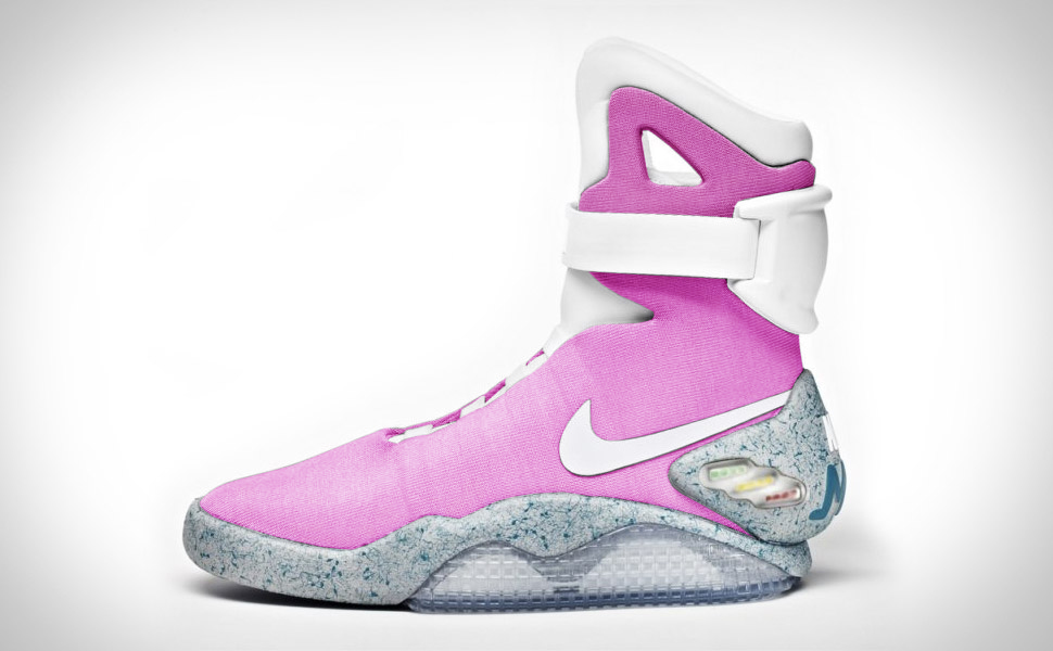

Updated hoverboard MAGs:
Please excuse the bad GIMP work. Also I can't shake the feeling that the ankle buckle and top white cuff should be a different color, but oh well.
Call me old fashioned, but I prefer just the fabric color be changed. With the just the right tone of pink.
