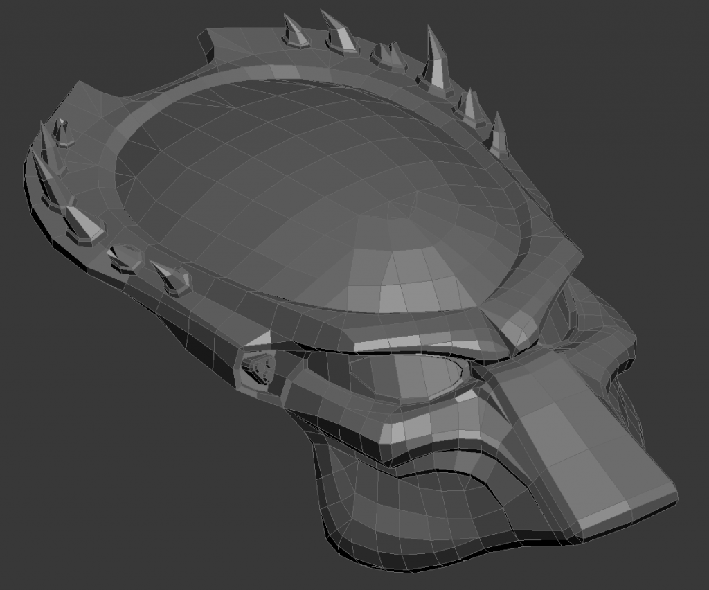

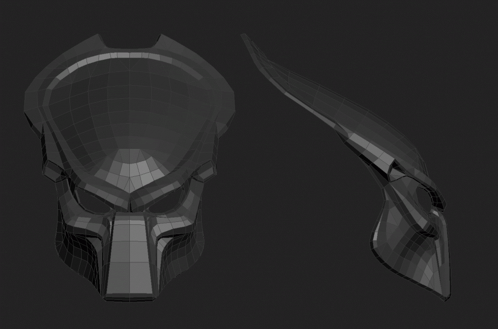

Hello, folks! That's my first prop in AvP universe — movie mask of Wolf (bio). Started to design in 3D from planar mesh. Right now it's on unfolding stage.

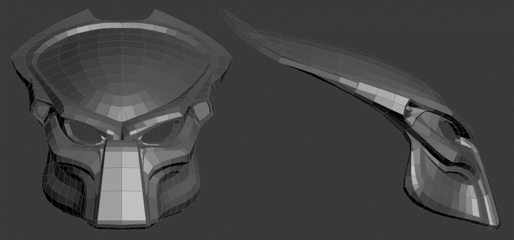

1st stage. Preliminary forms (symmetric halfs) and wrong proportions.
2nd stage. A bit closer to movie model has better shapes but not so good.
3rd stage. Almost done.

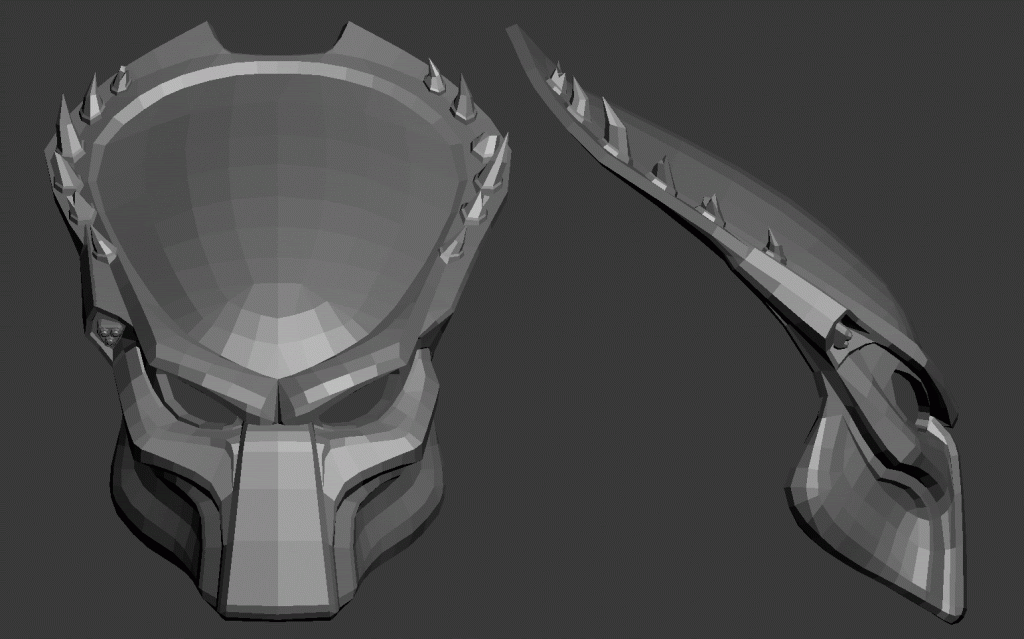

Added horns and laser targeting module for correct appearance.

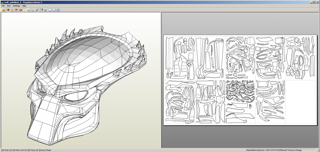

Exported as .3ds and ready to unfold in PD.

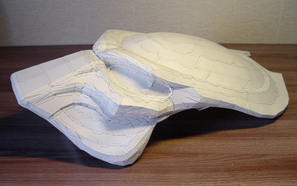

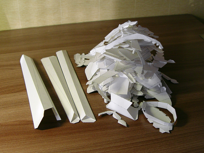

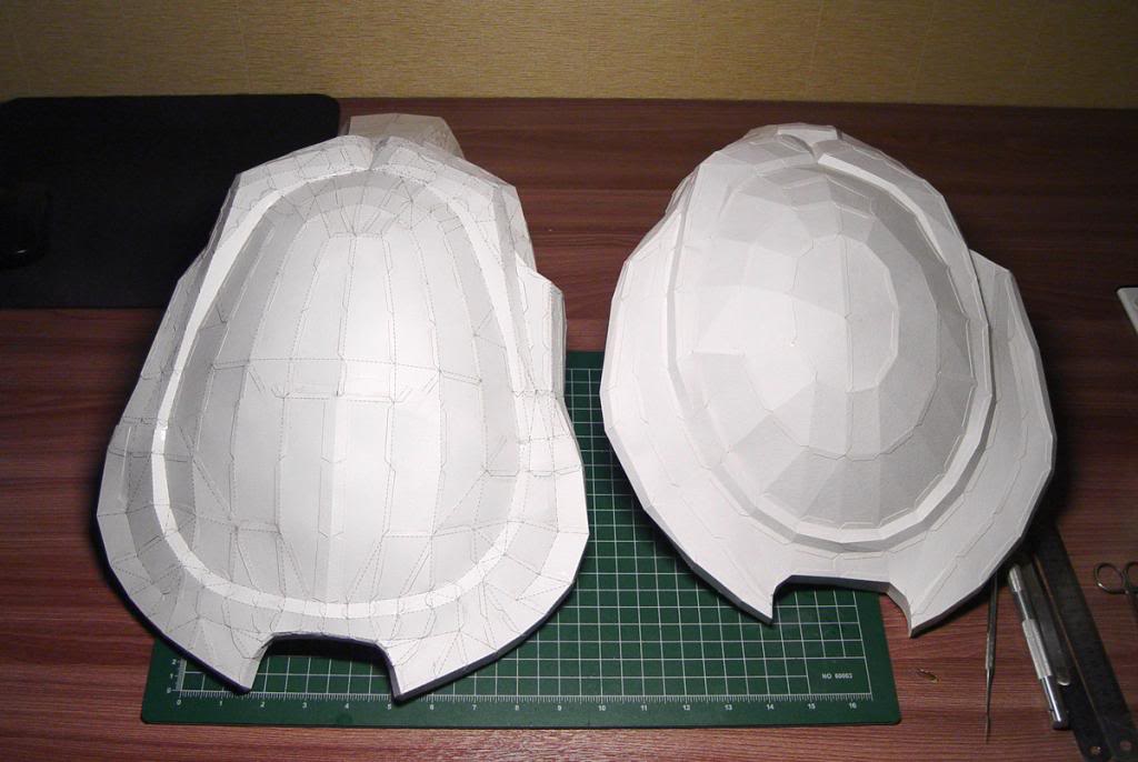

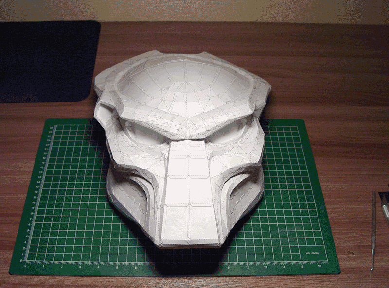

I unfolded and printed the mask on A3 paper (200g/m2) and complete it.
Work in process

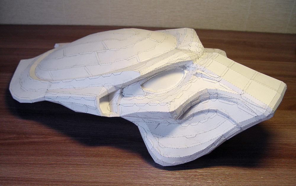

And now the final result (horns and laser module i'll make a bit later).
Compared with previous probe (game model):

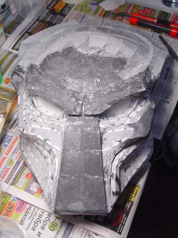

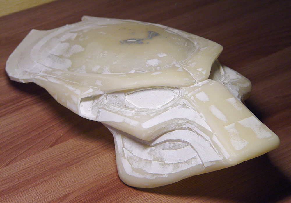

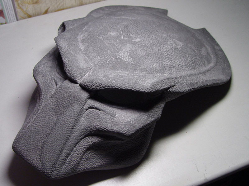

My first test formed with urethane resin (Protocast 85R). Paper matrix was grinded off with sandpaper and dremel.

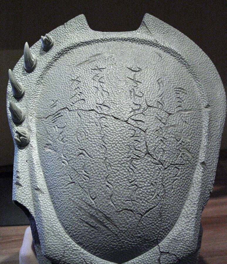

Added irregularities on whole outer surface with dremel and spherical grinding stone.

Xenothis said:
How did you do that. I want to do this, it would make it so easier for me to make a cast.
I used paper model as a casting form for urethane resin (Protocast 85R): step by step a small parts of resin (around 40-60g) fill into paper model. But better way is in using of epoxy resin for impregnation of paper model and using urethane resin for making main layer thickness.
Updated (redone) and re-unfolded 3D model (corrected face angle and eyes, simplified mesh and corrected separation).
Second version awaits impregnation with resin.

Alls cool about the files. it seems that to get the actual files free without 4shared trying to install their programs is to register with them to get the no bs files. lol I cant wait to start cutting. i also wanted to ask why you would glue the tabs on the outside of the mask? is it because you are covering the outside and it gives the inside a cleaner look?

Yes, external tabs gives less problems with grinding off the paper surface.
