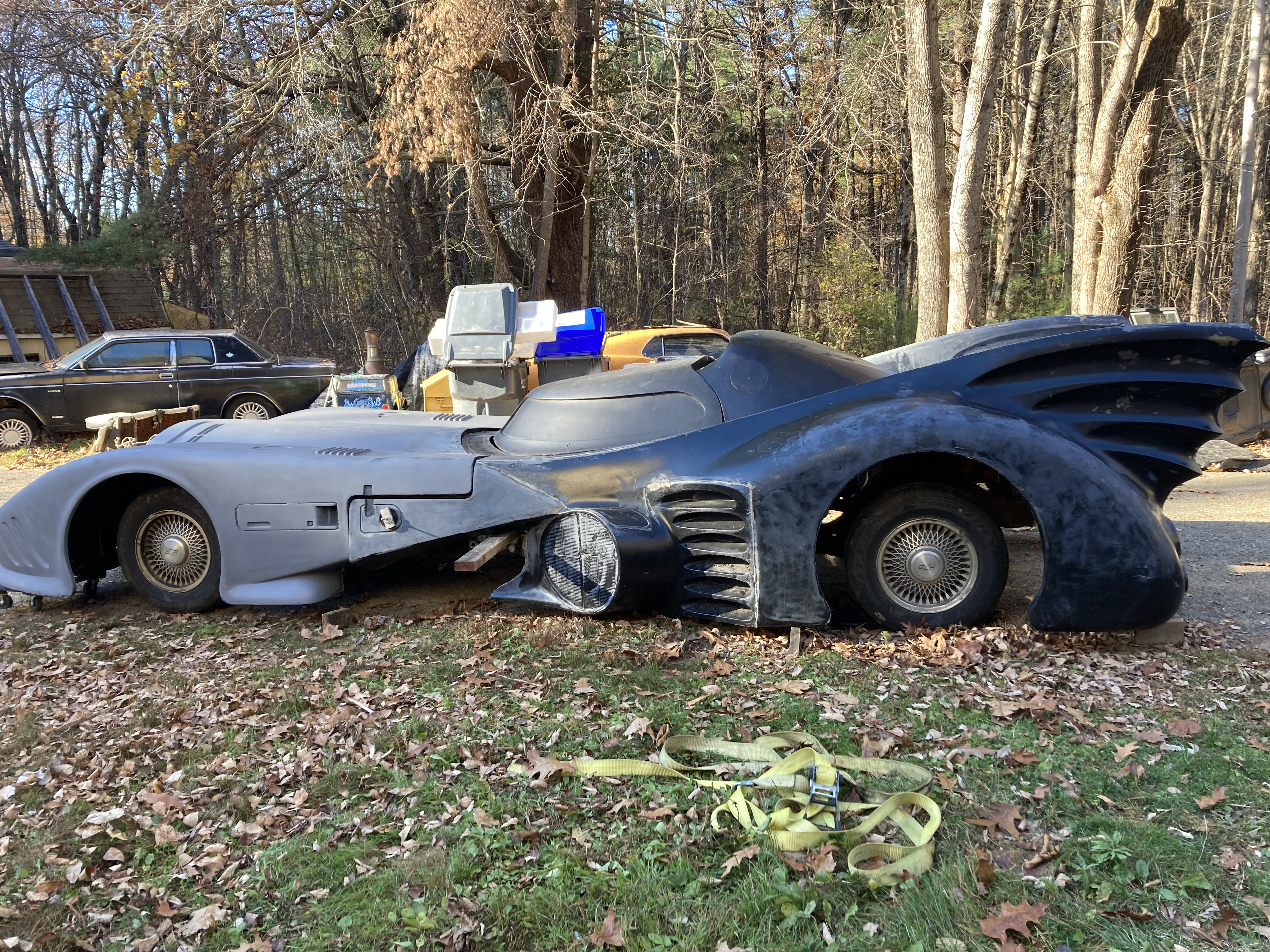

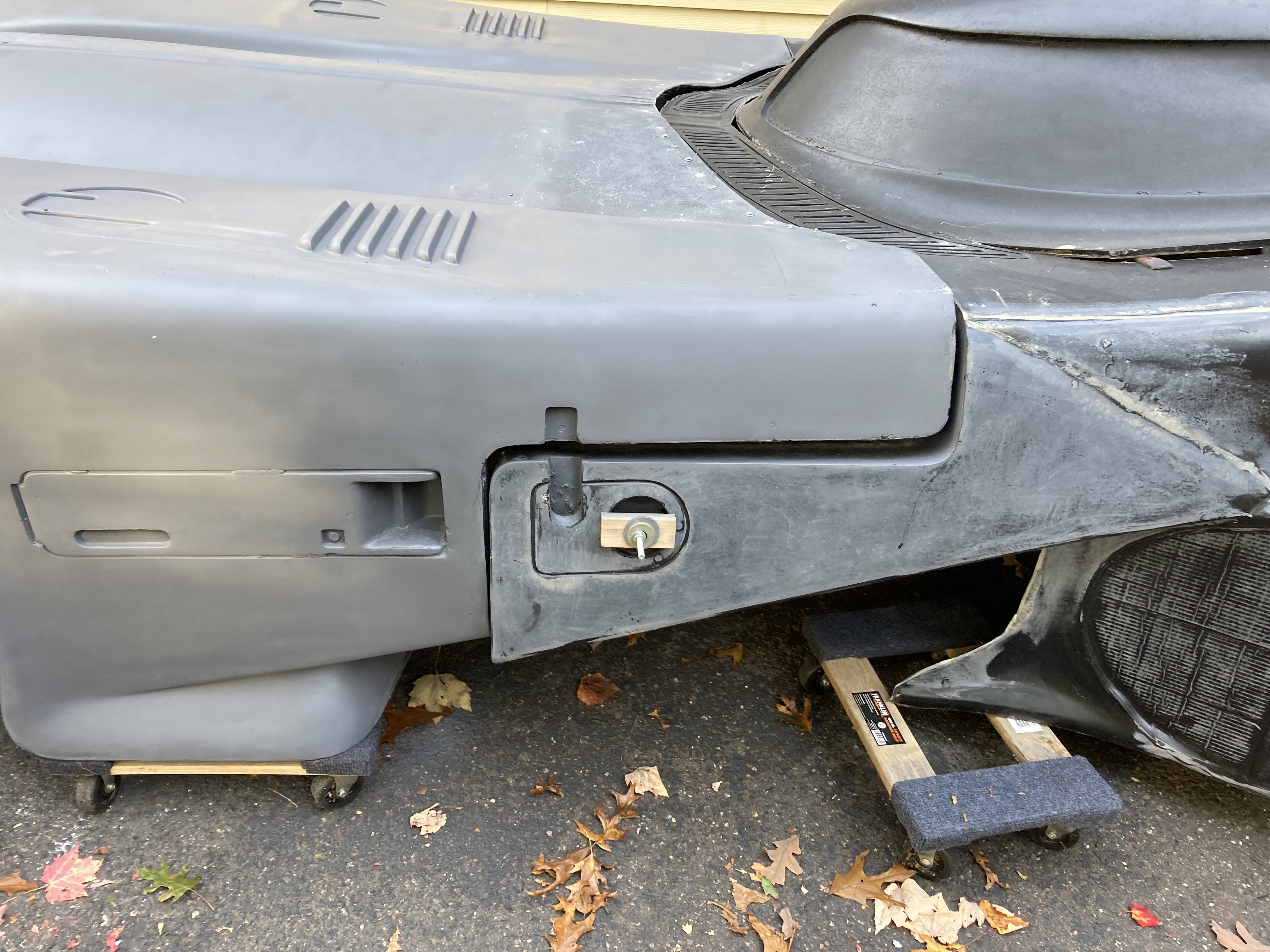

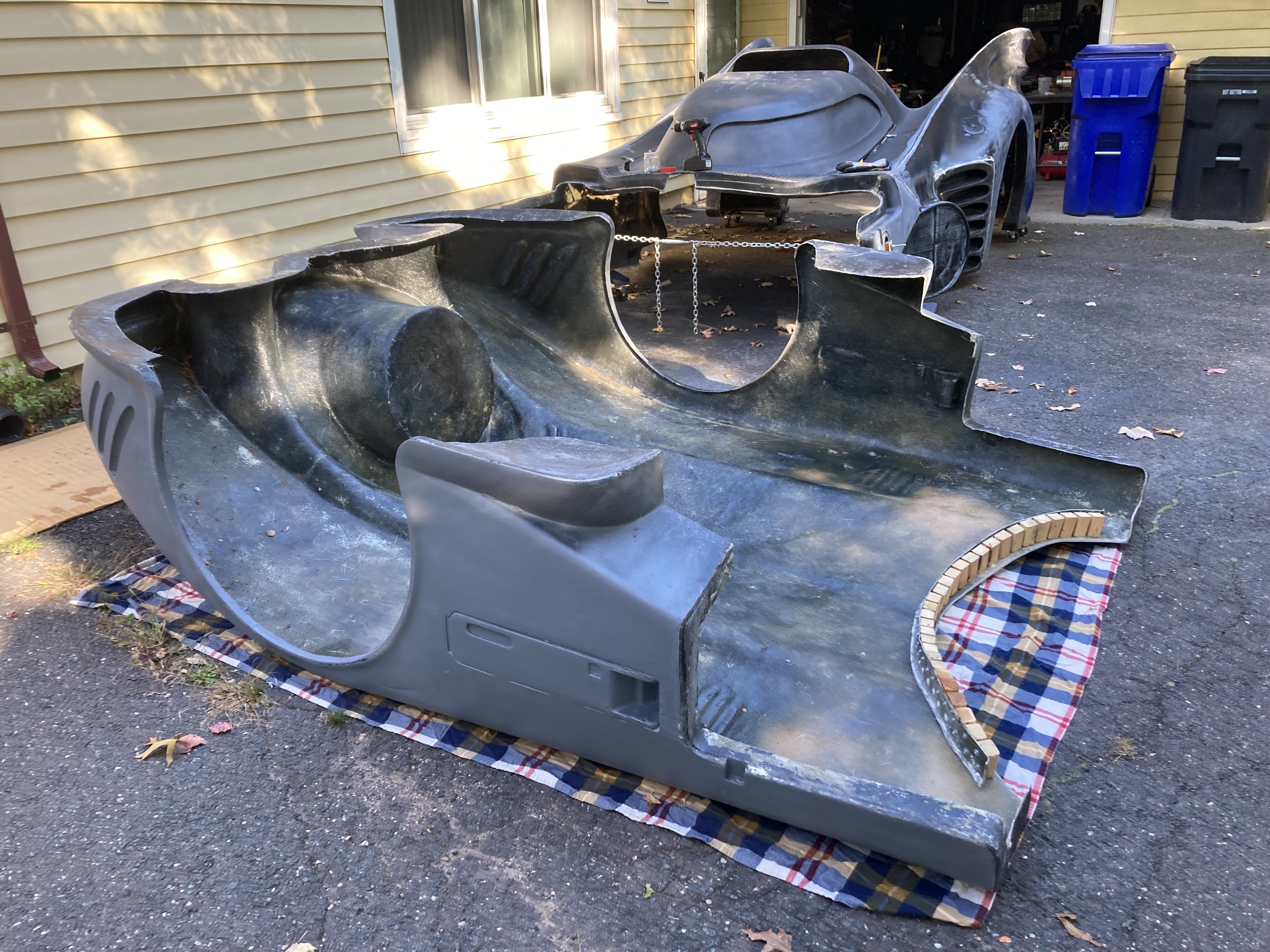

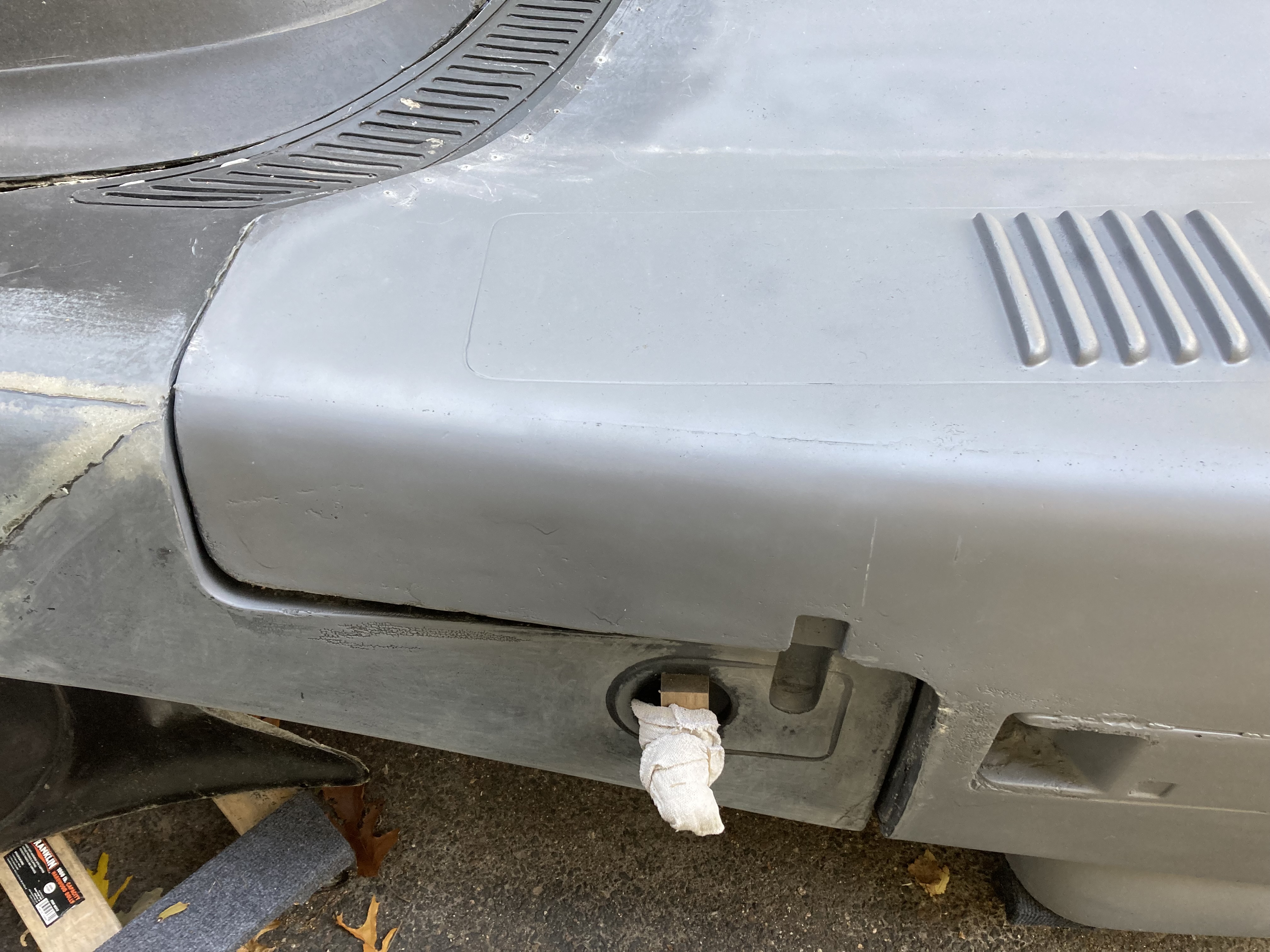

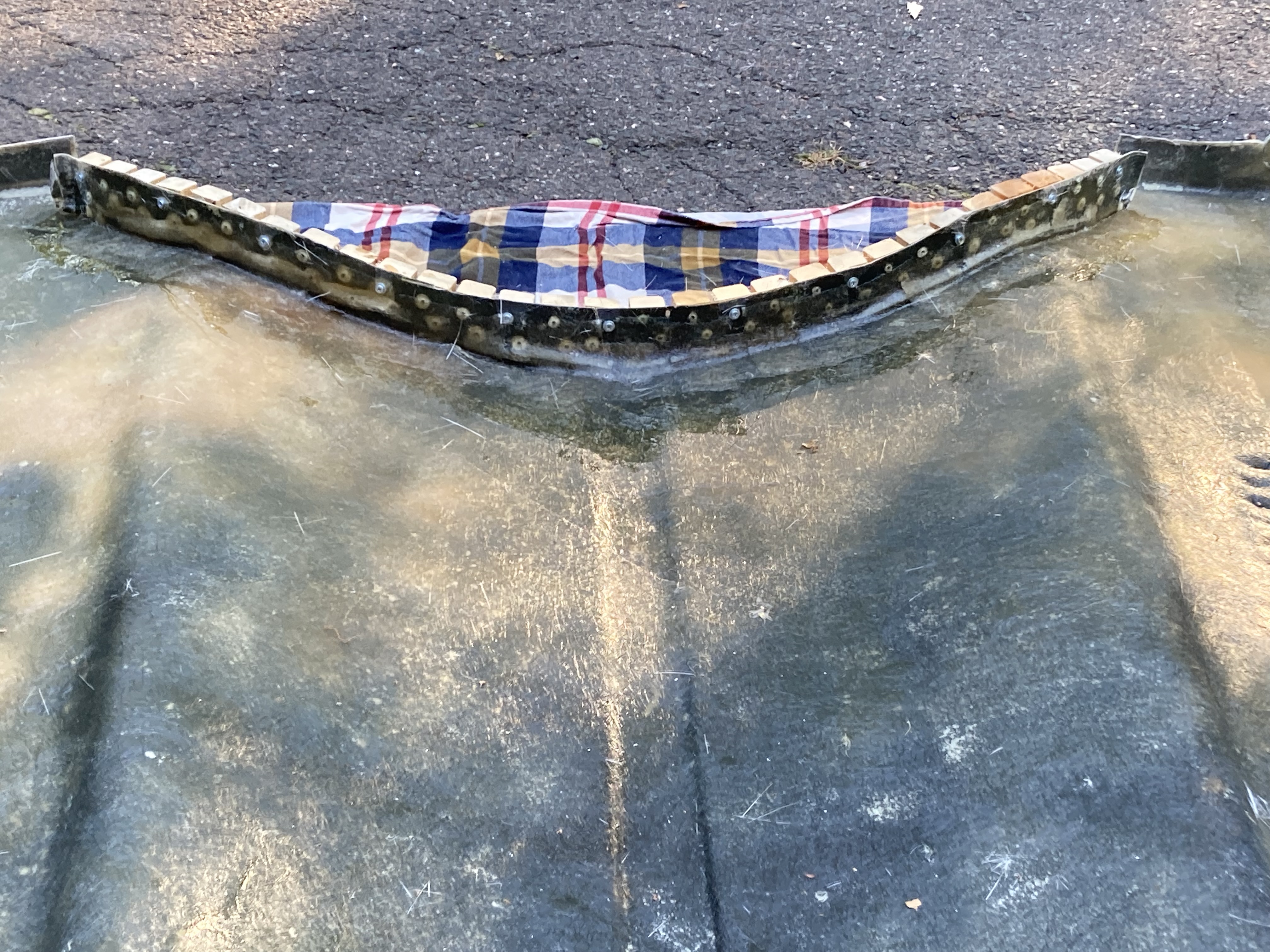

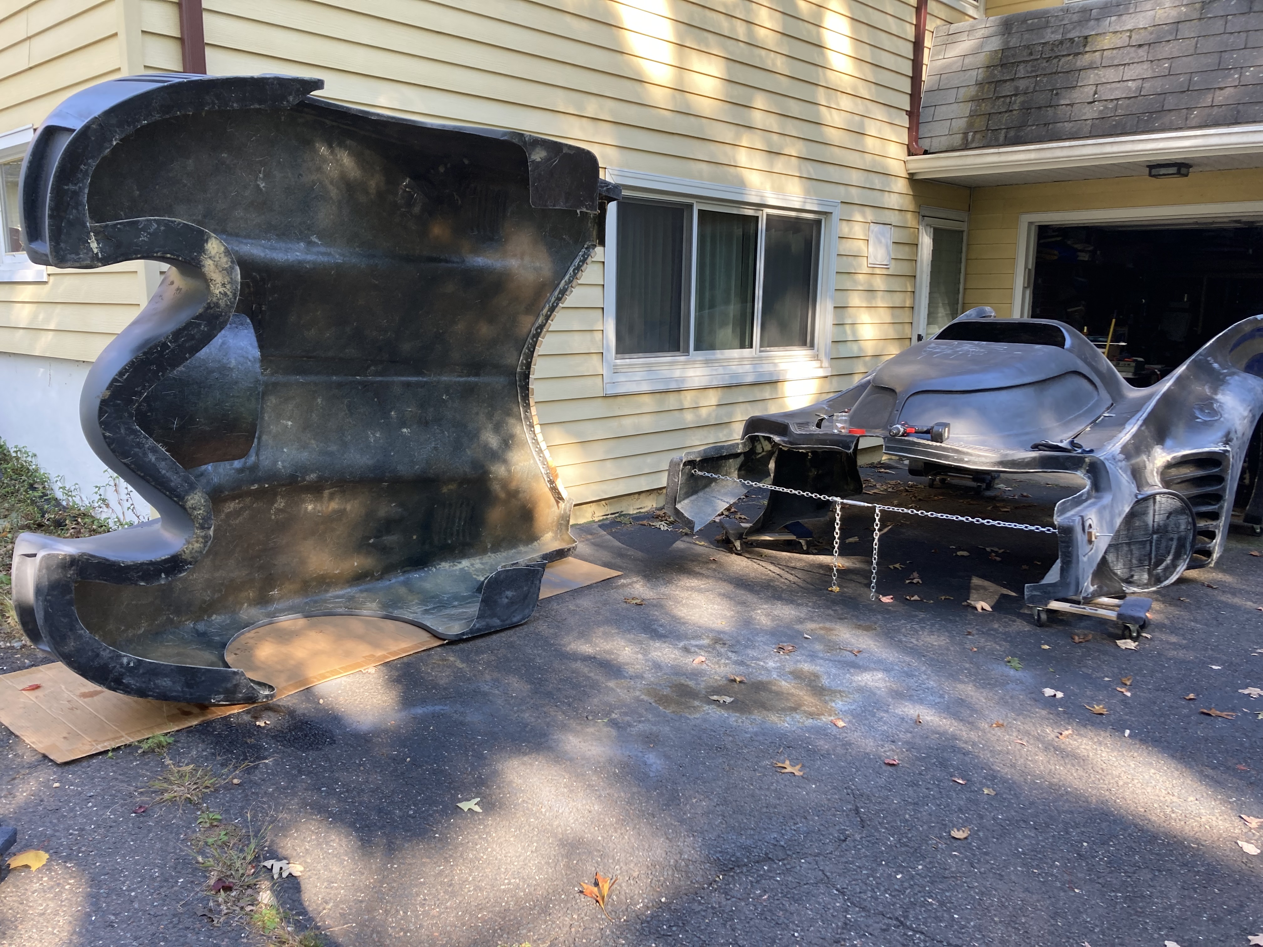

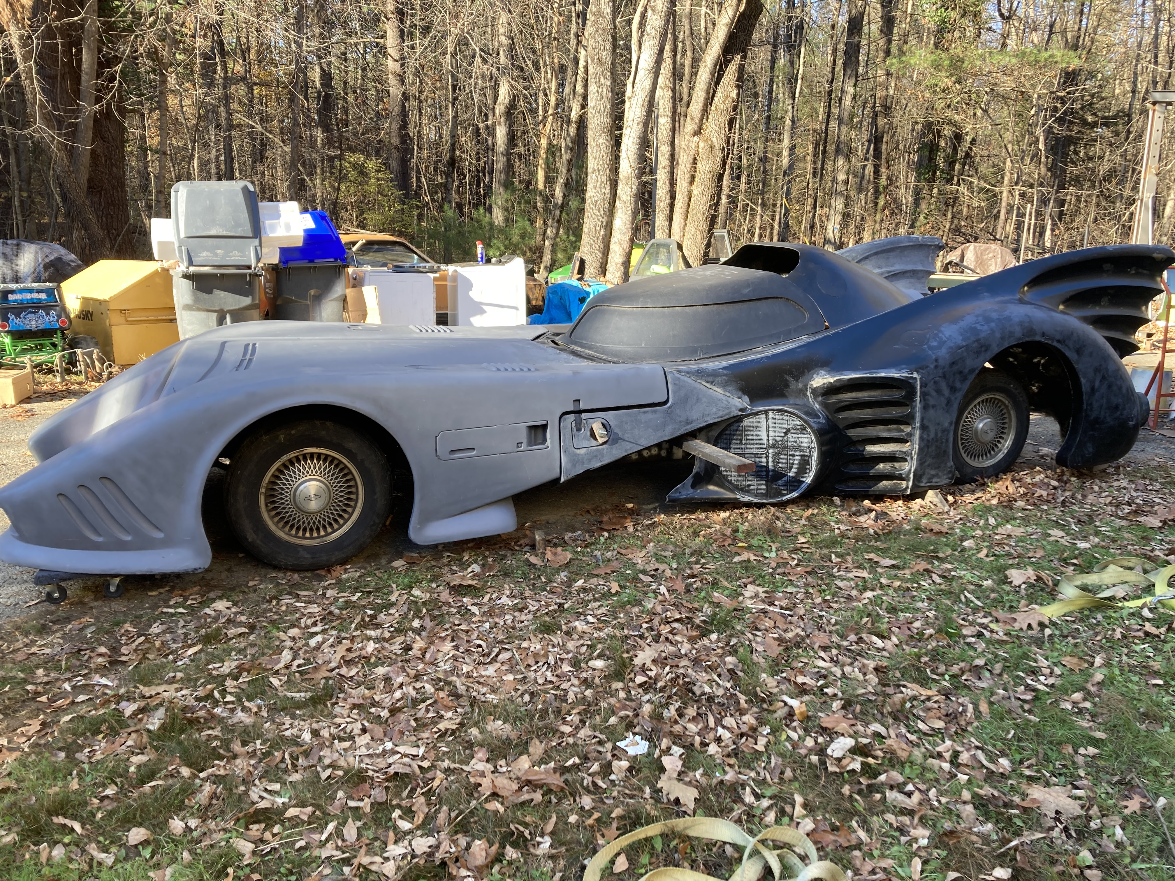

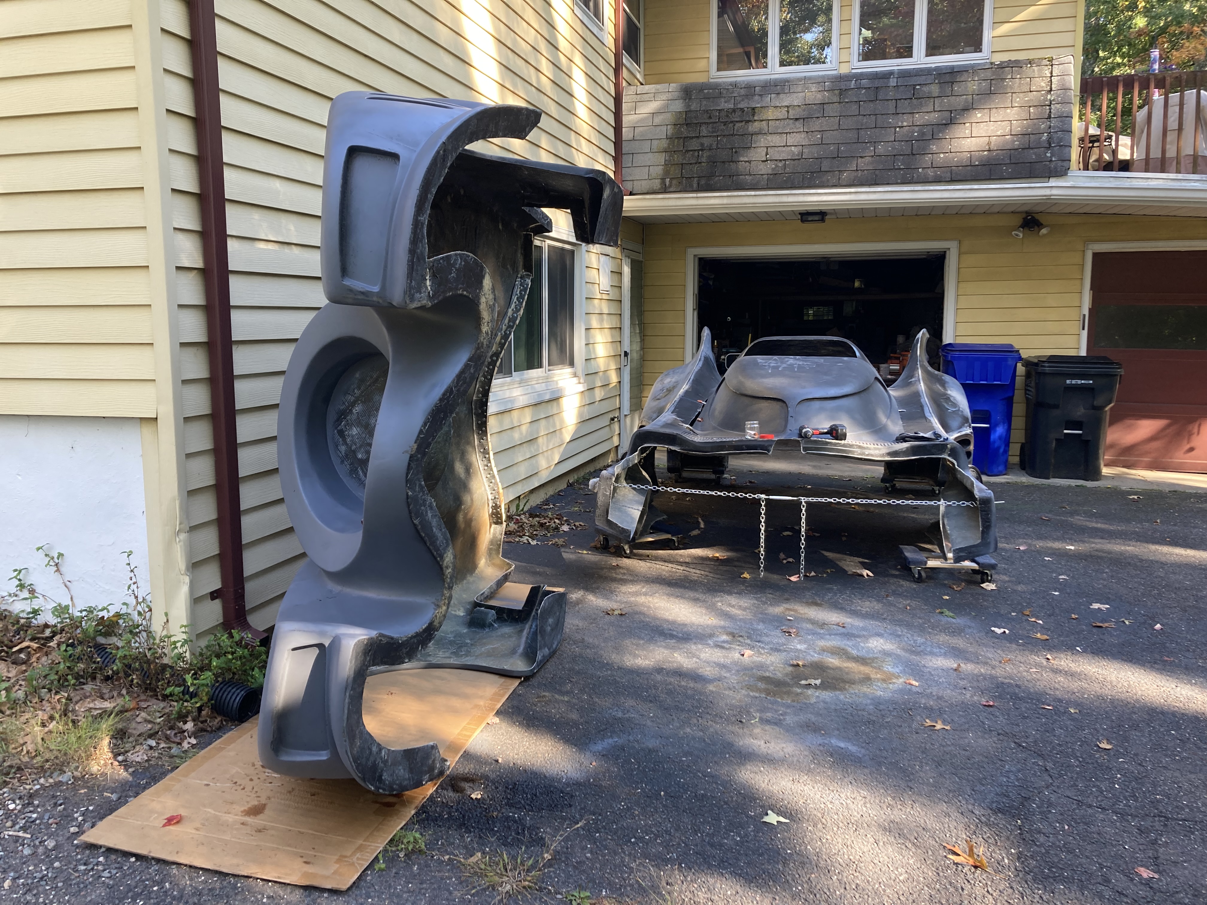

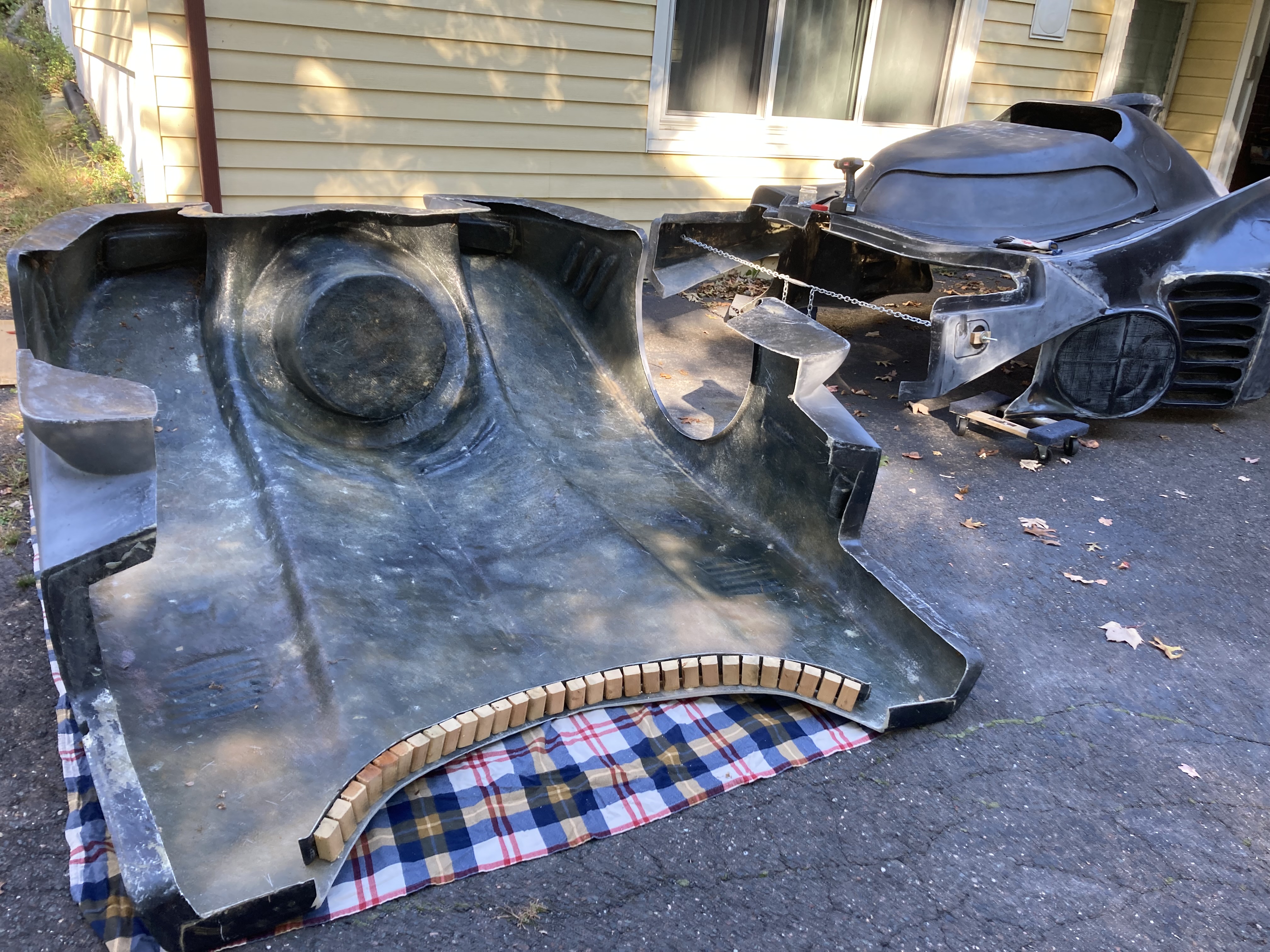

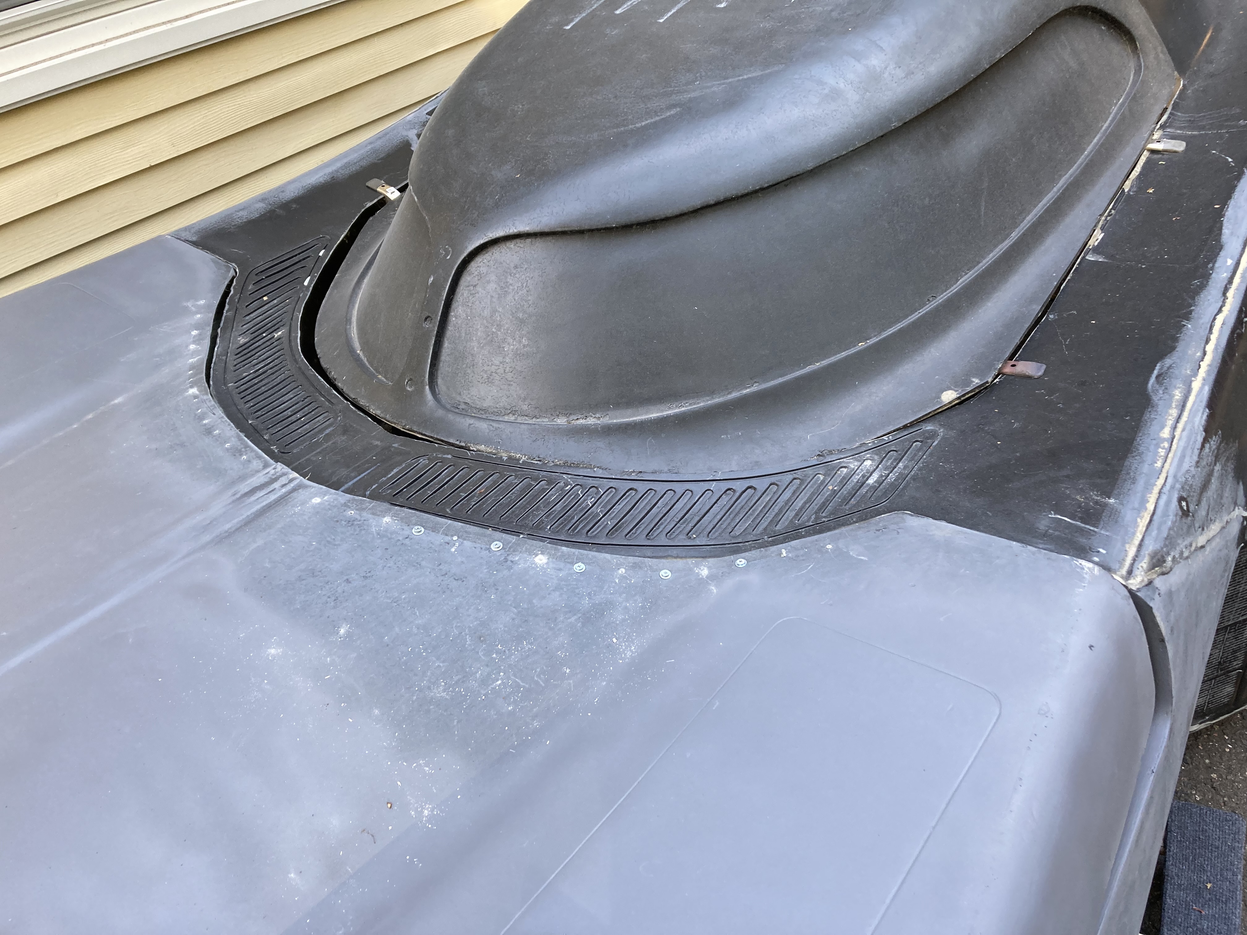

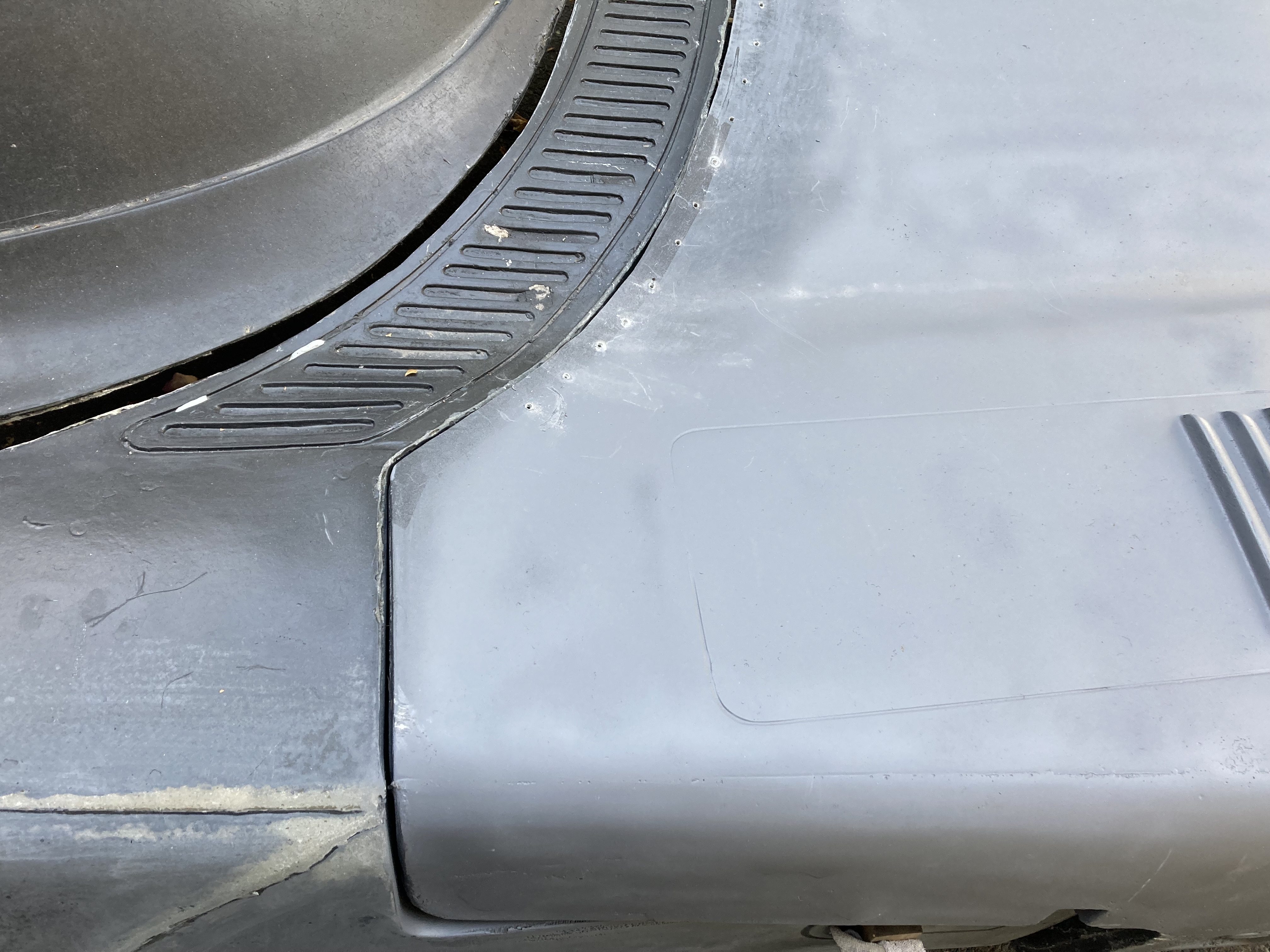

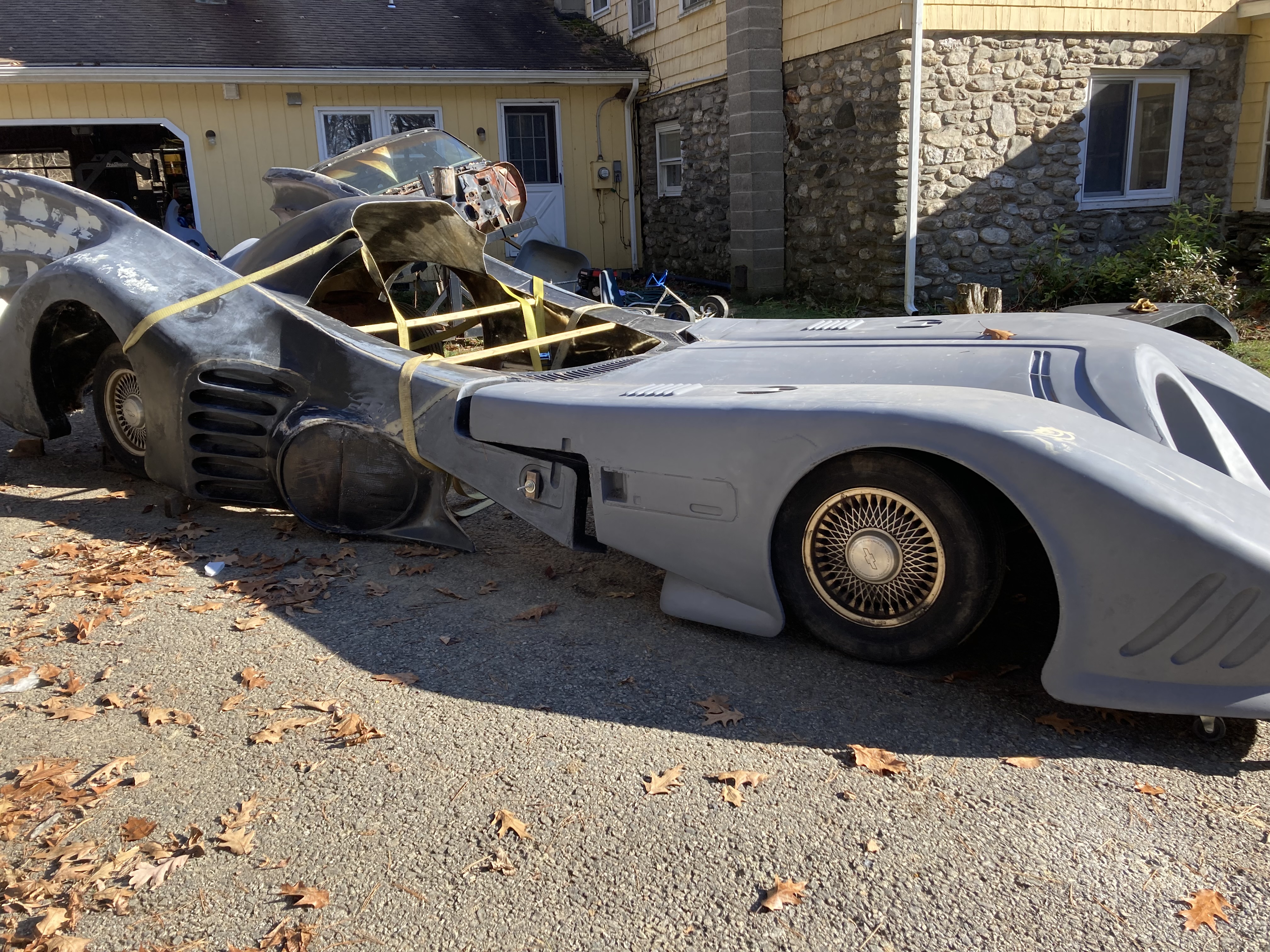

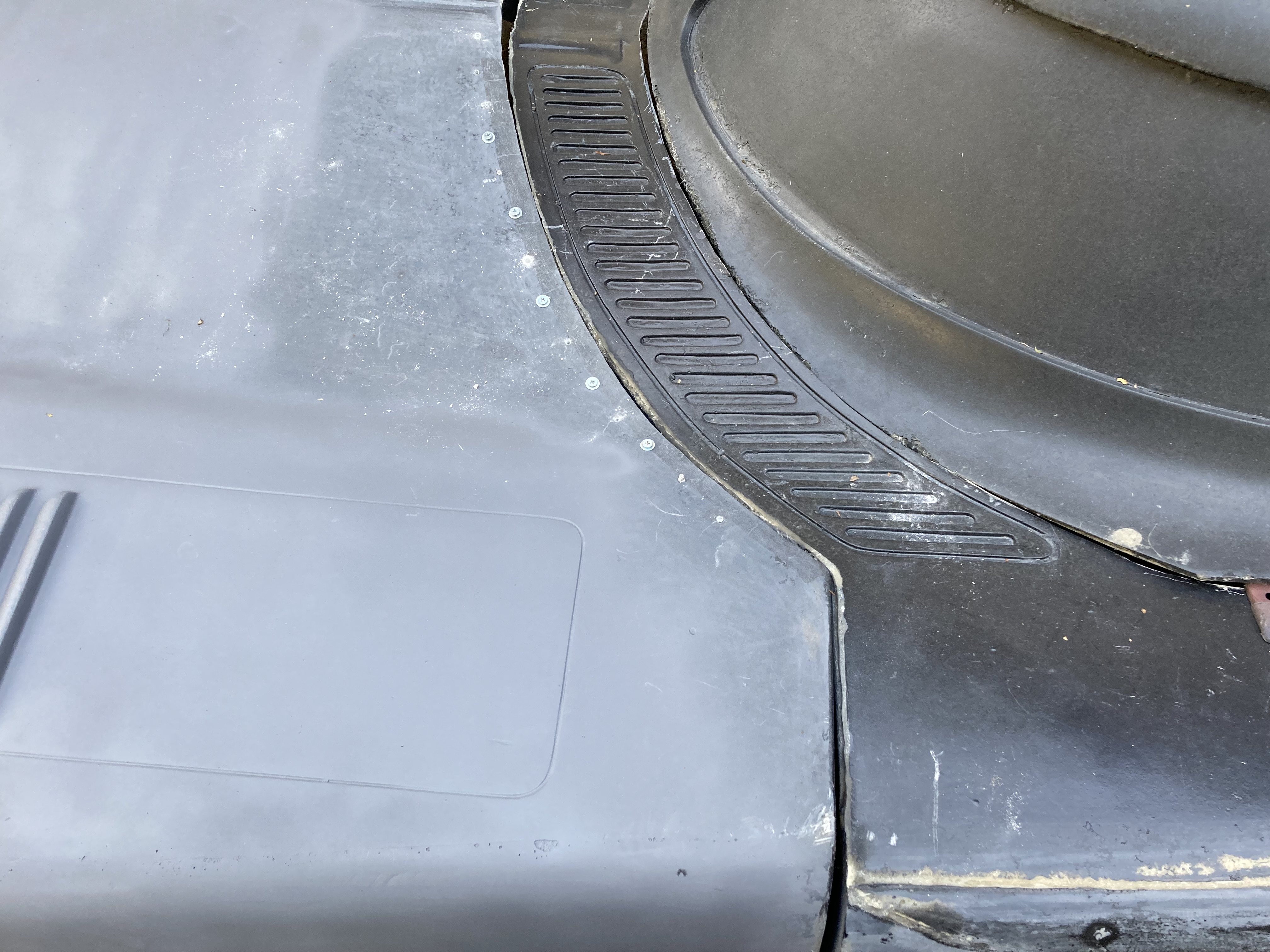

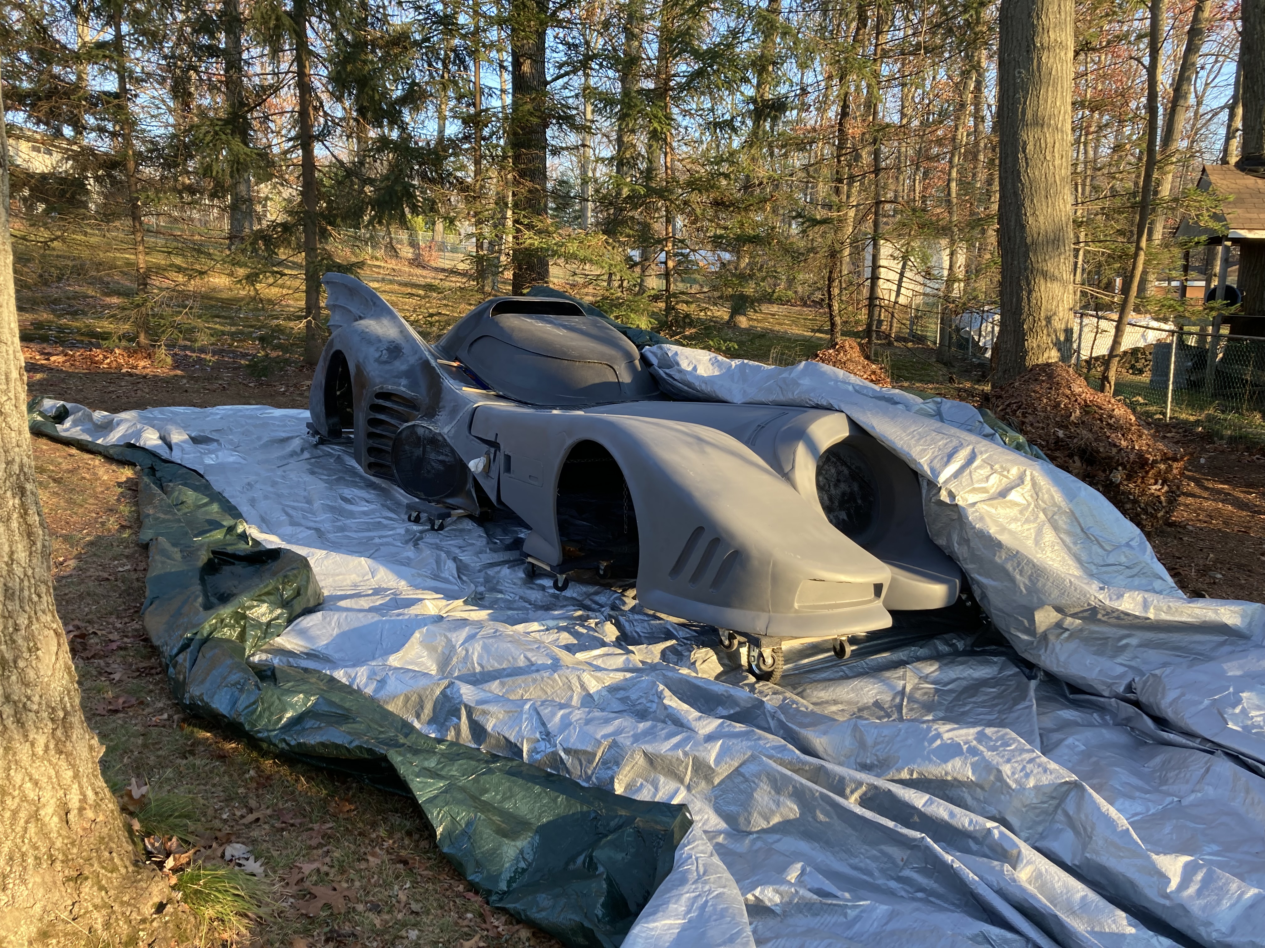

Been cutting, adding and reshaping the front end to line up better to the back half. It was really off quite a bit.

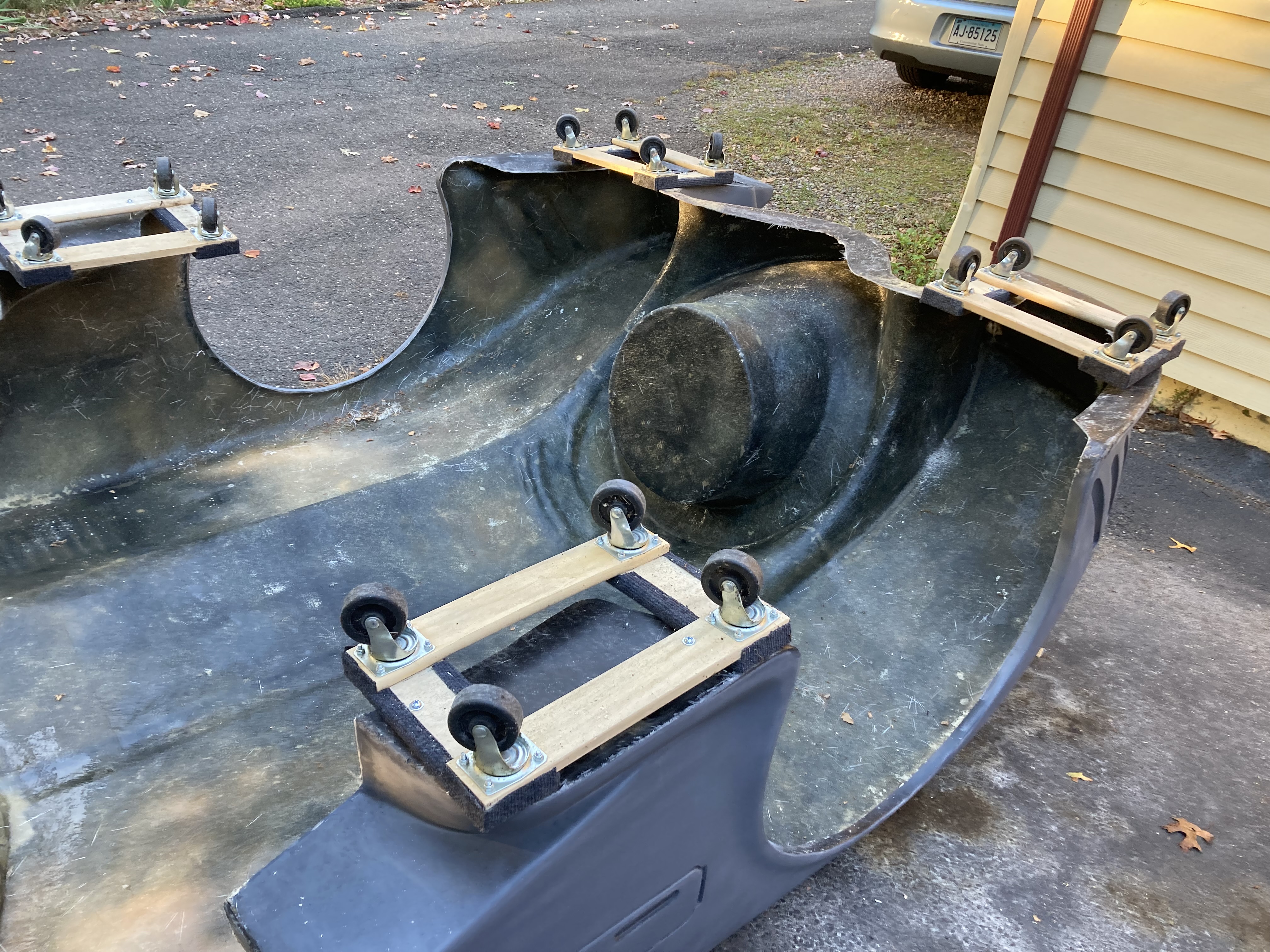

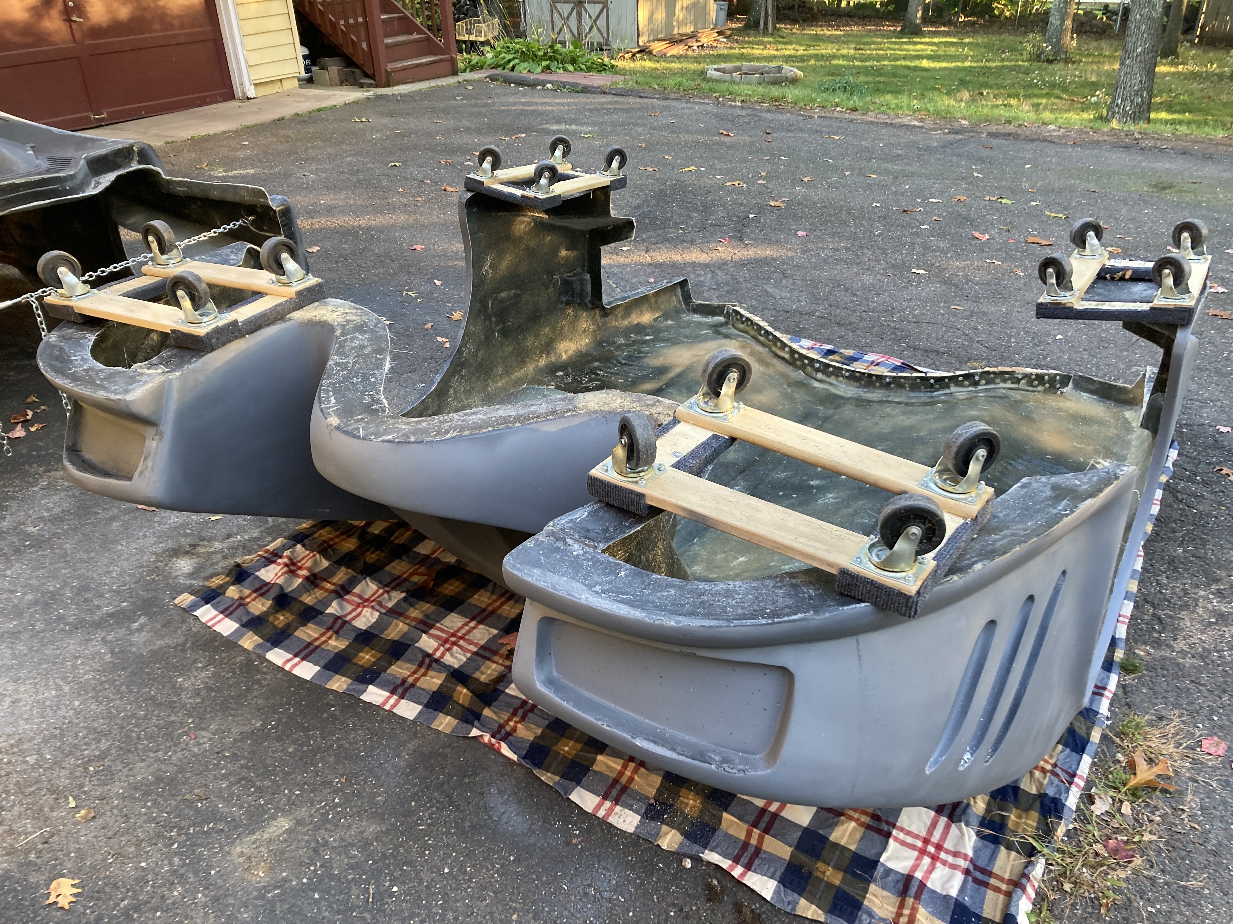

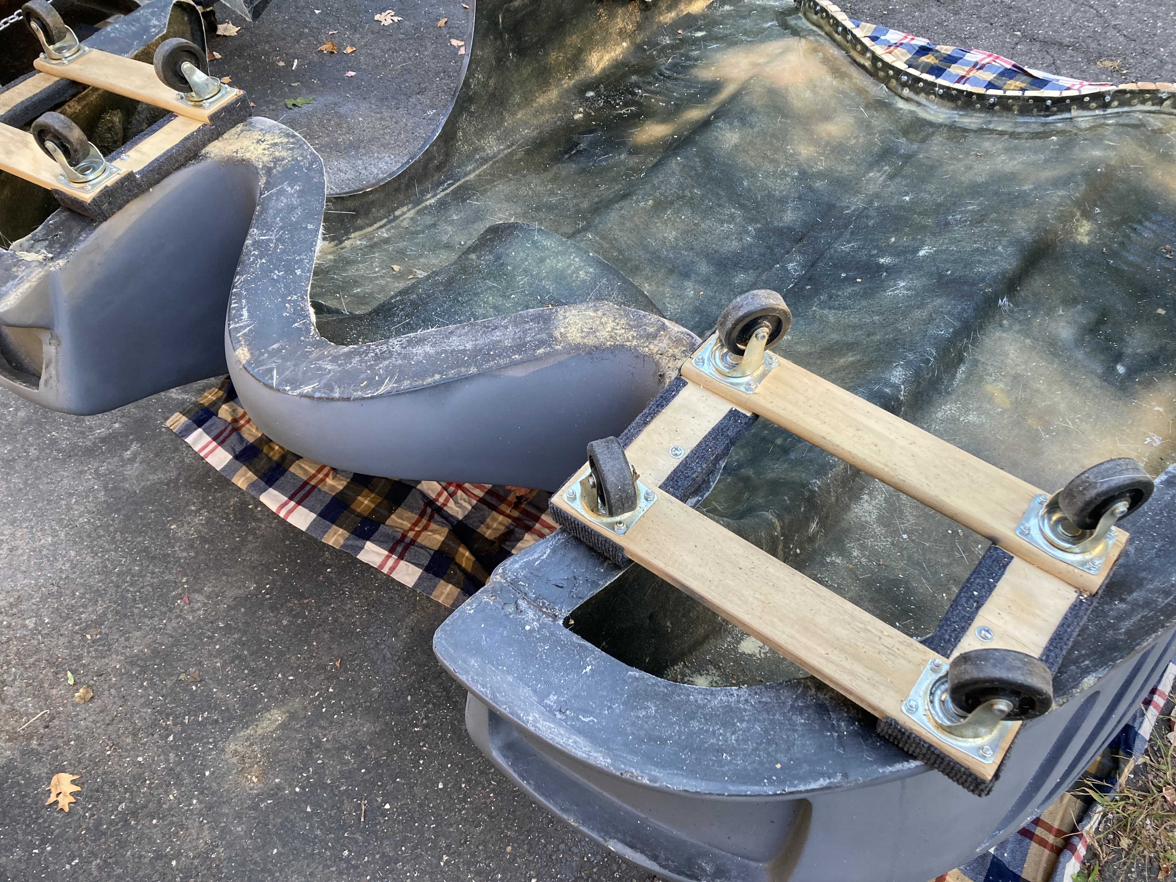

Things are fitting much better. Even added bolt on temporary dollies under the front half to help move it around.
It's a bit heavy when you're by yourself. Flipping this thing over by yourself to work on it isn't easy. But we are getting there.
Trying to do what I can before it starts getting any colder. Before long this thing will head to storage for the winter.

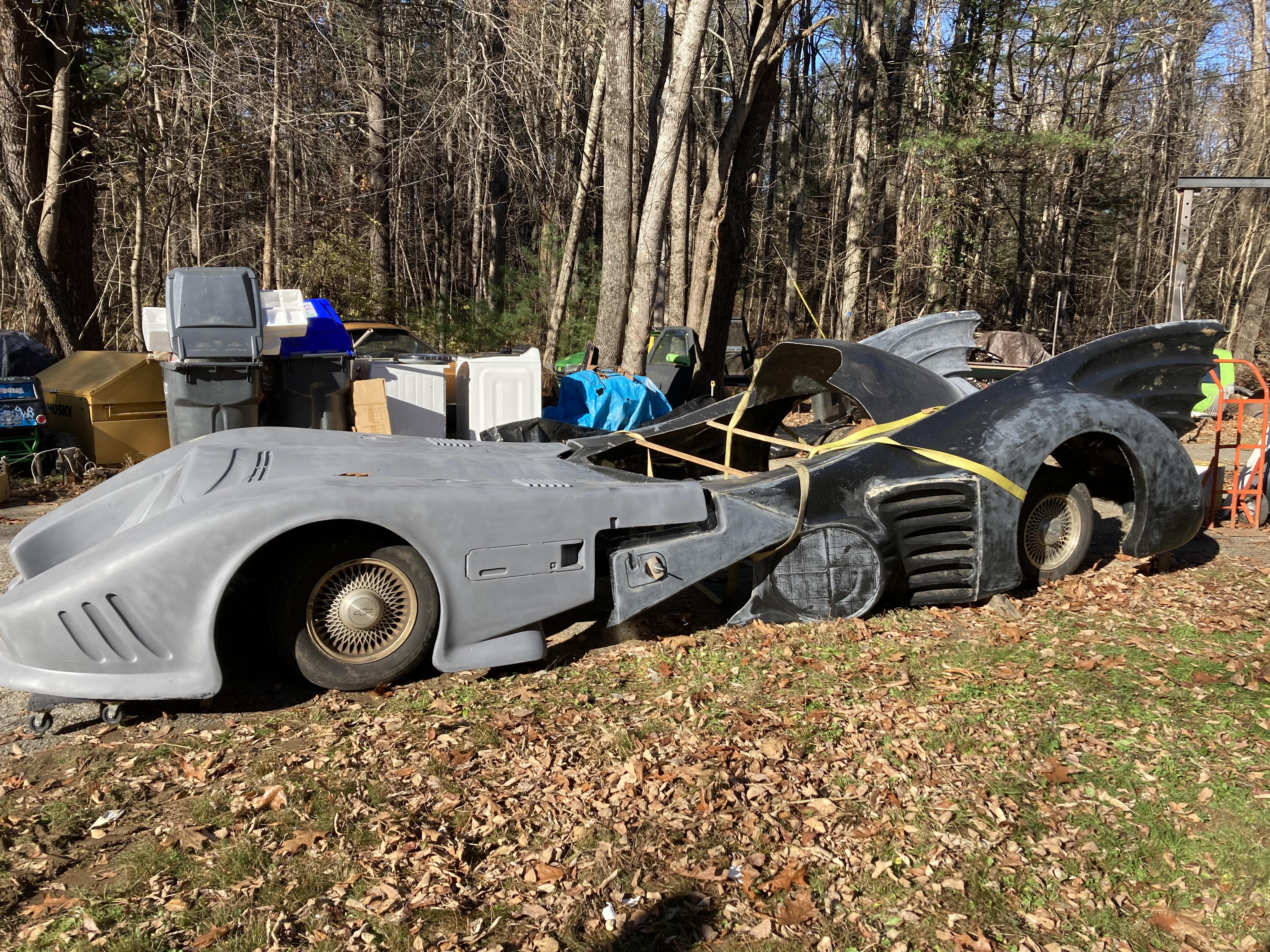

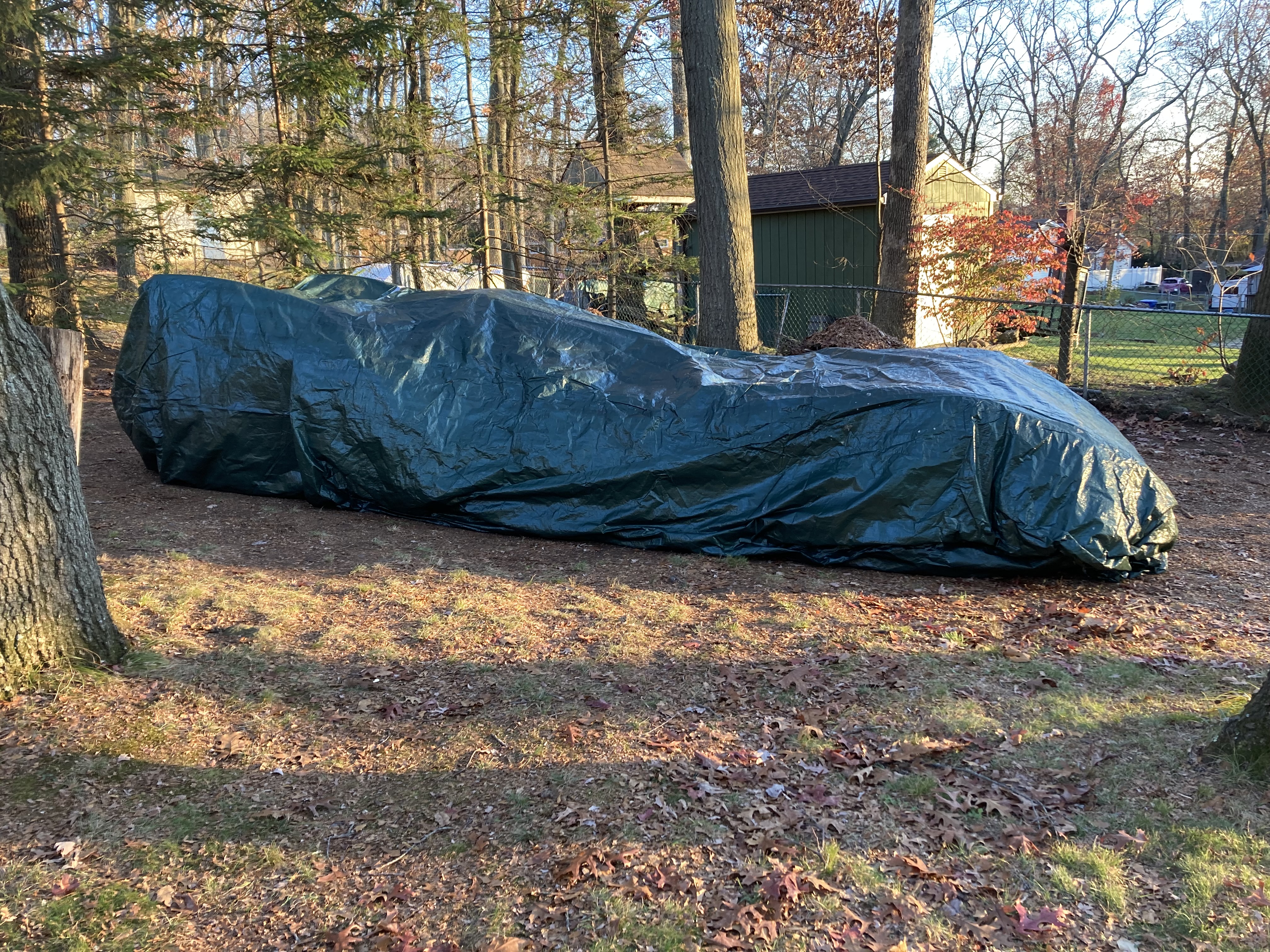

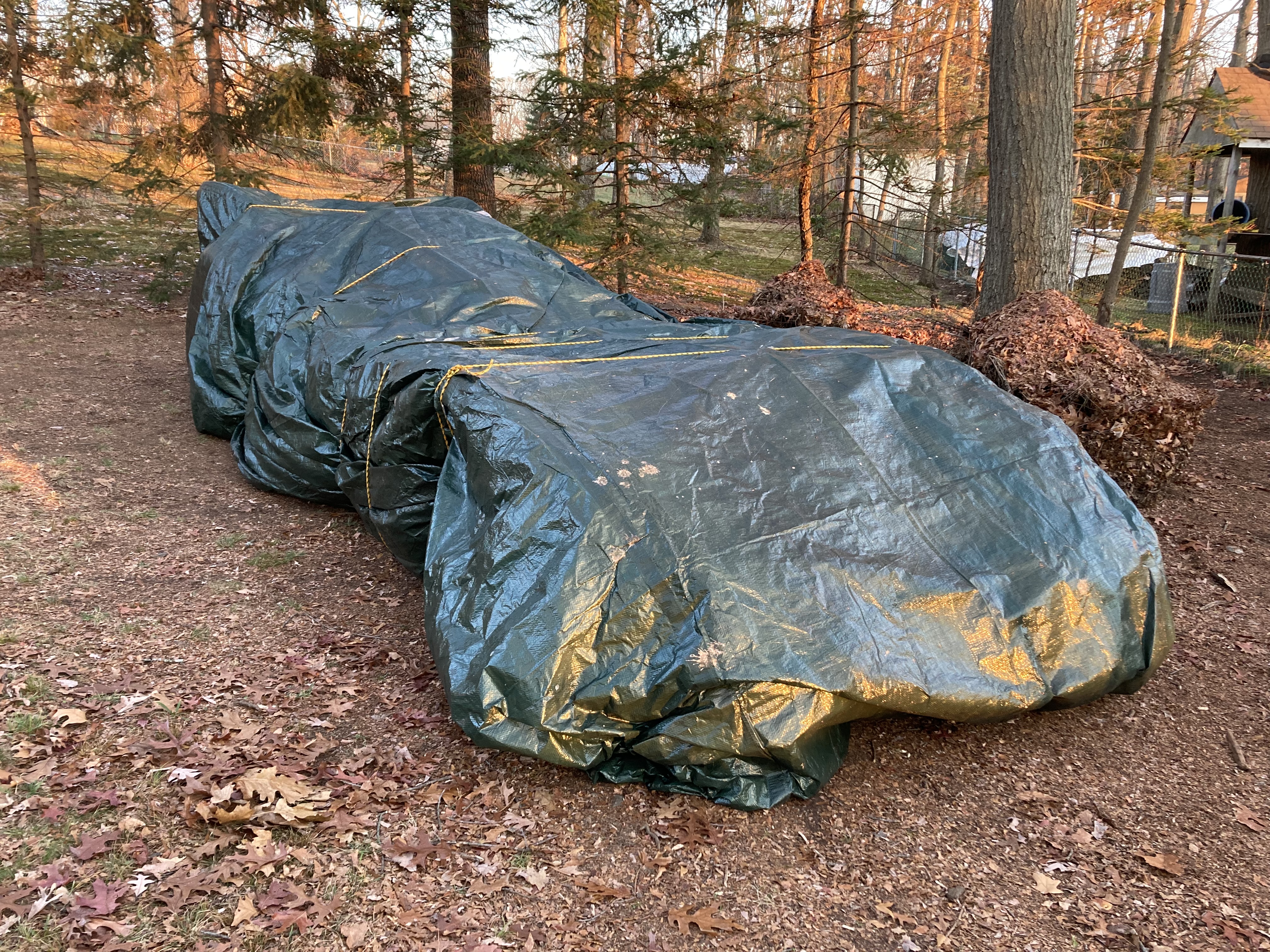

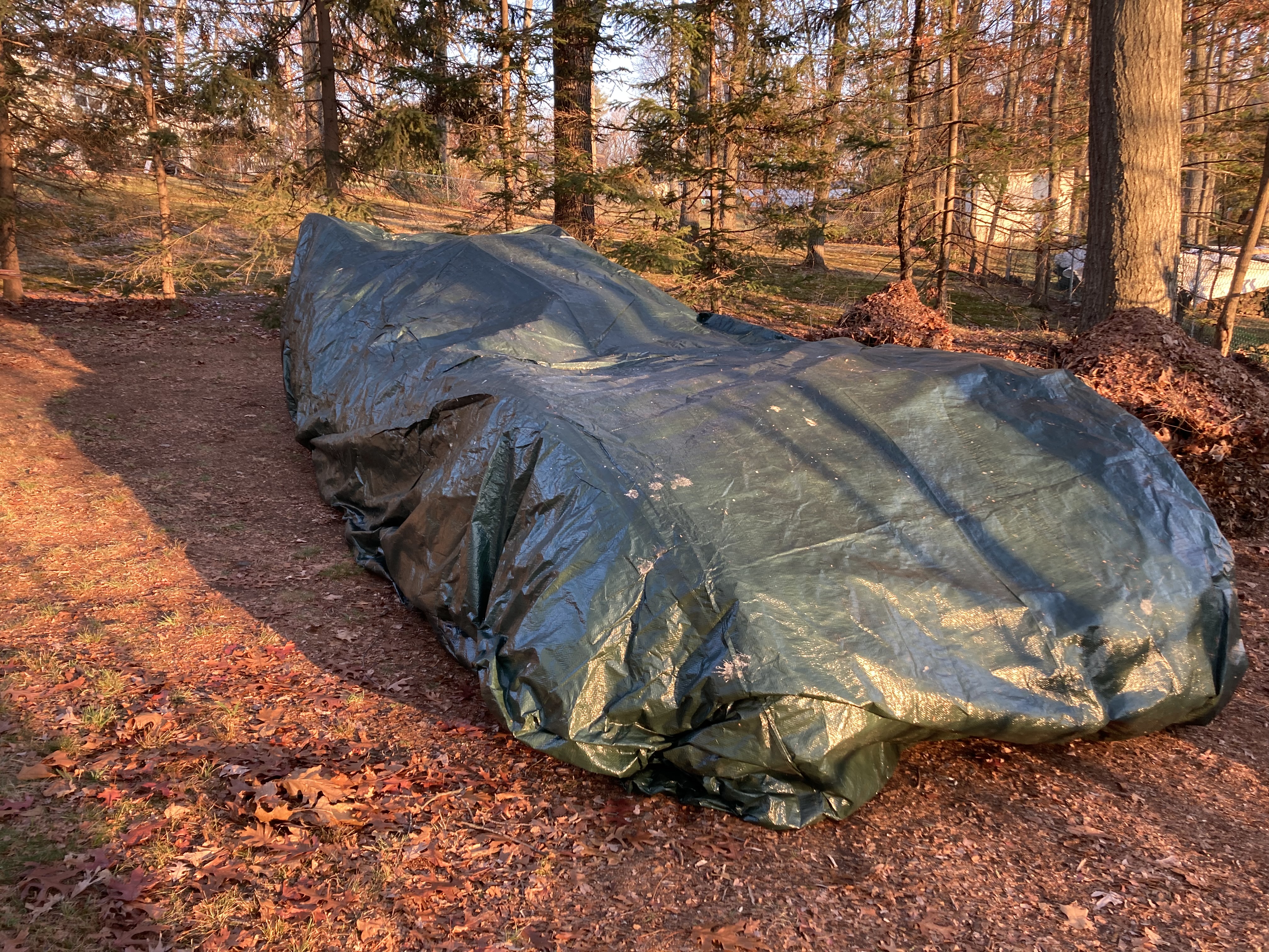

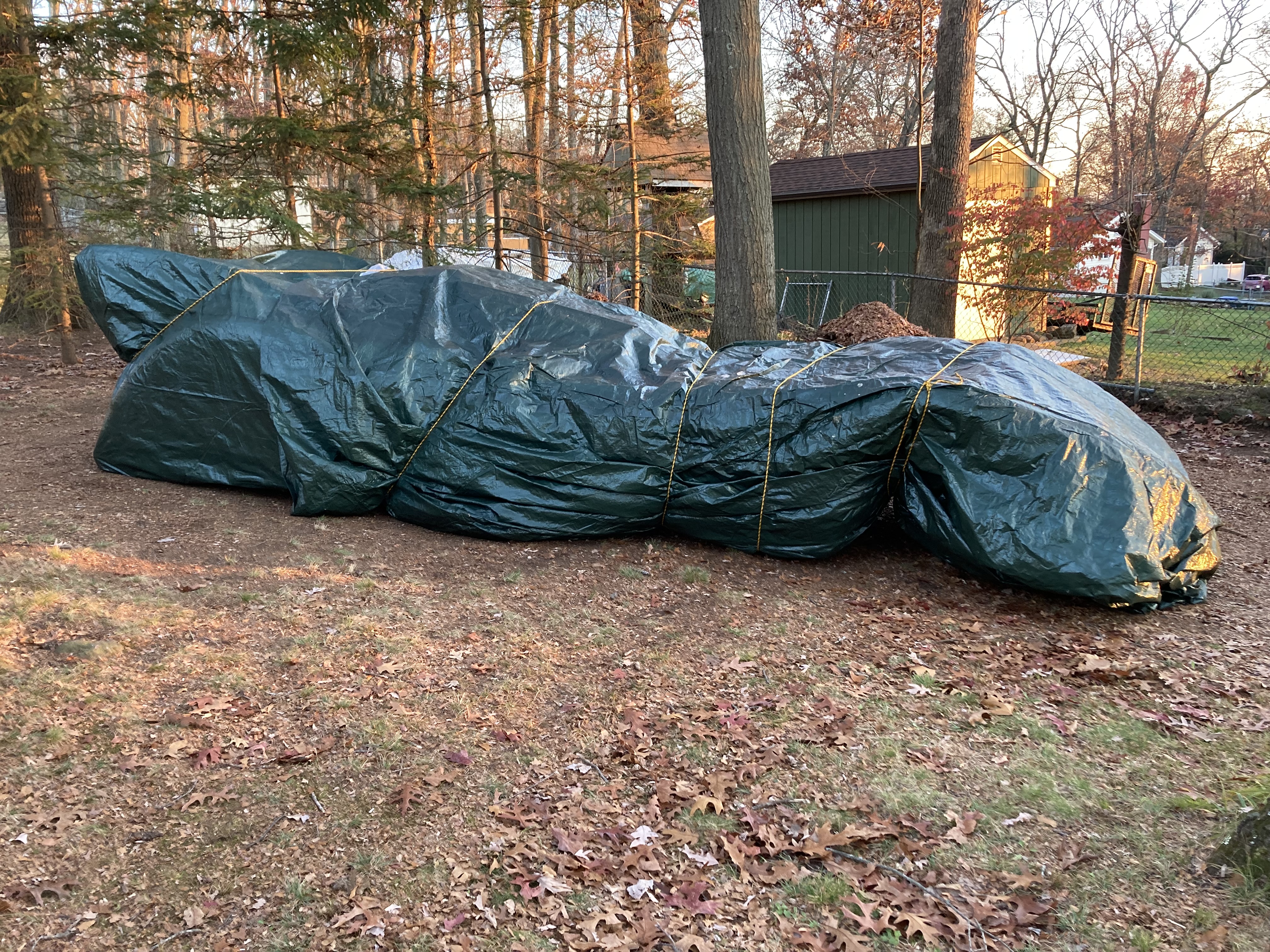

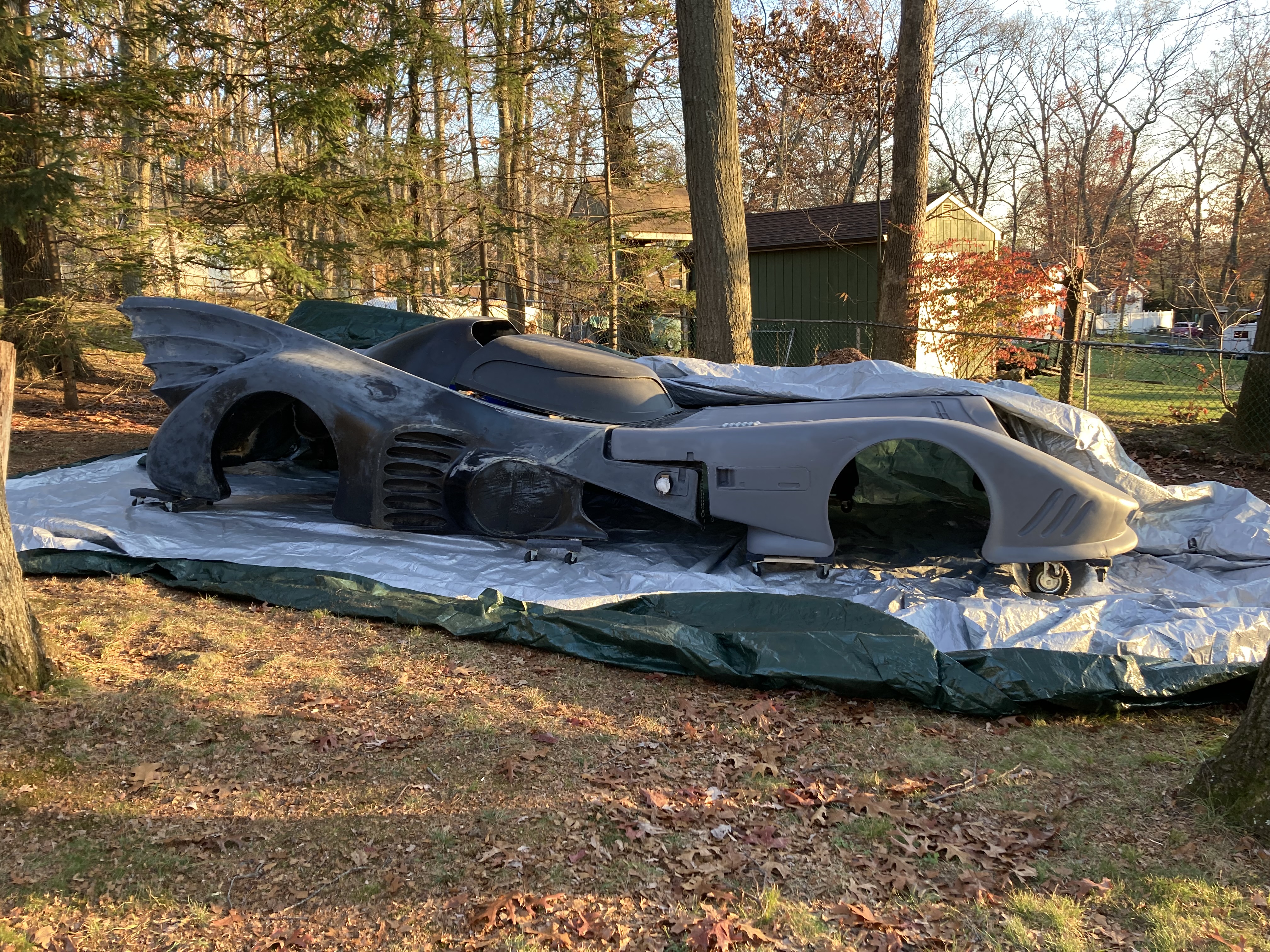

Well, with old man winter starting to hammer down on us here in new england, it was time wrap up the Bat for the winter. I'll pick back up on things in the spring. Mummified in layers of a 20' by 80' tarp.

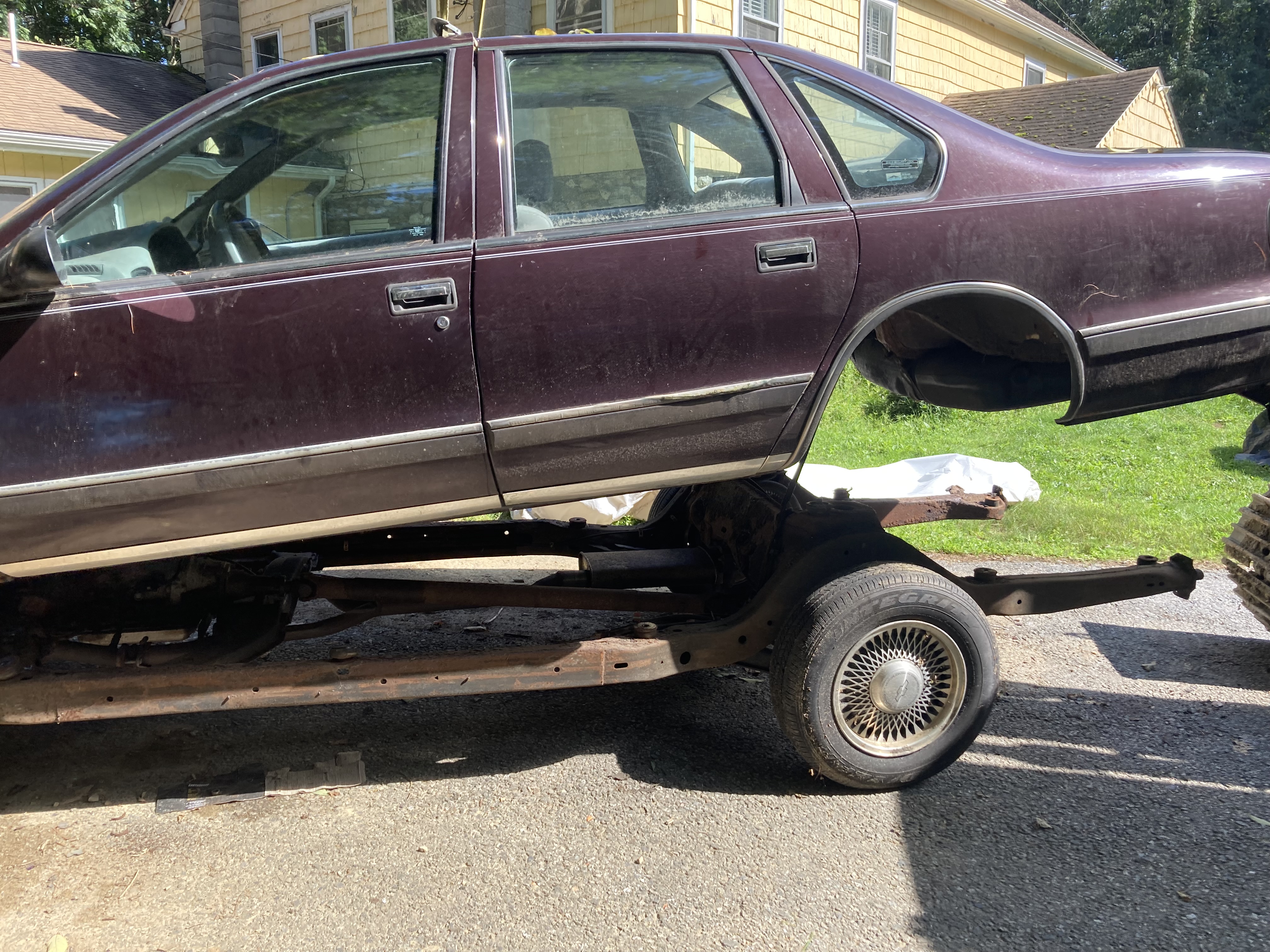

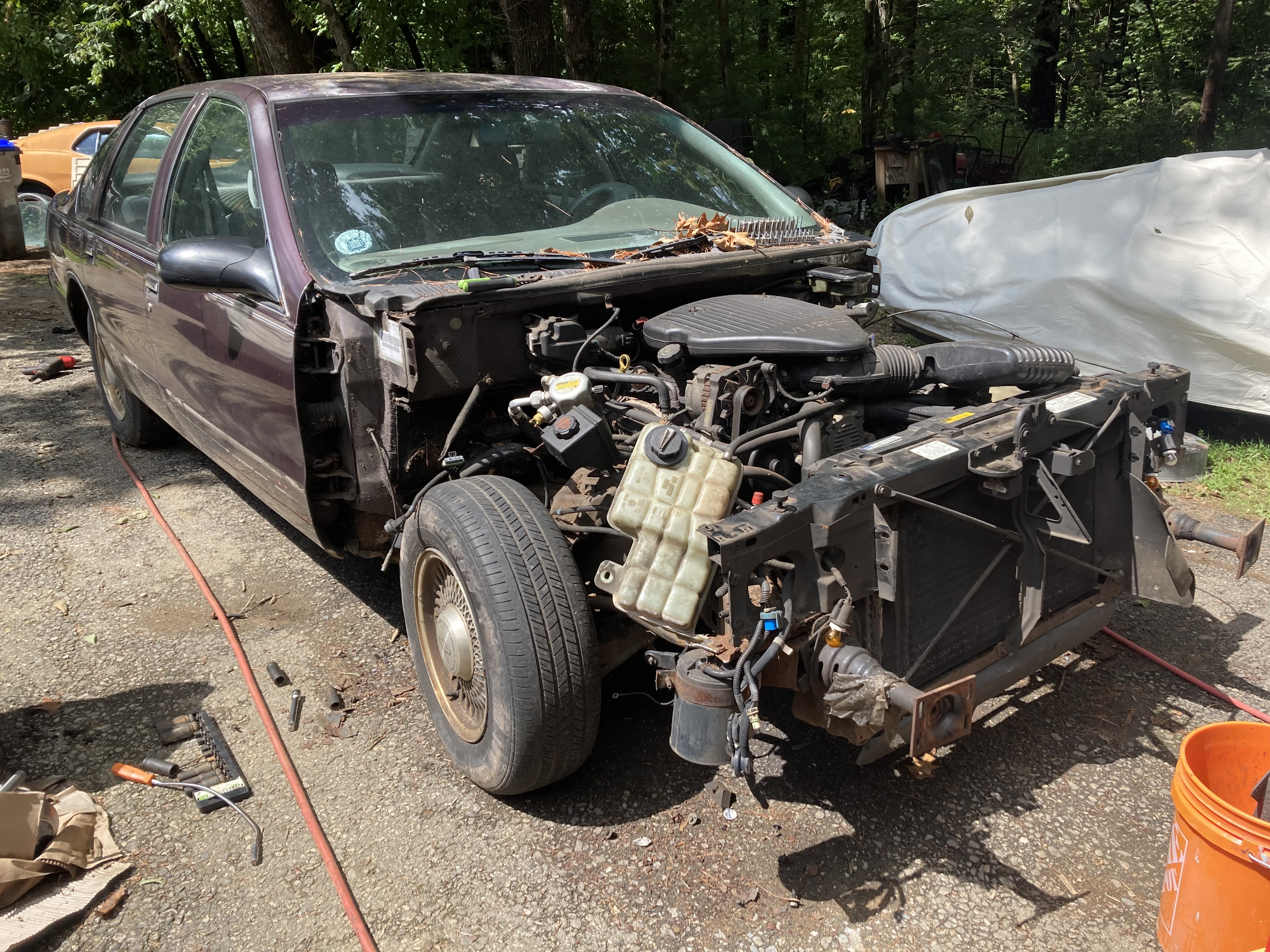

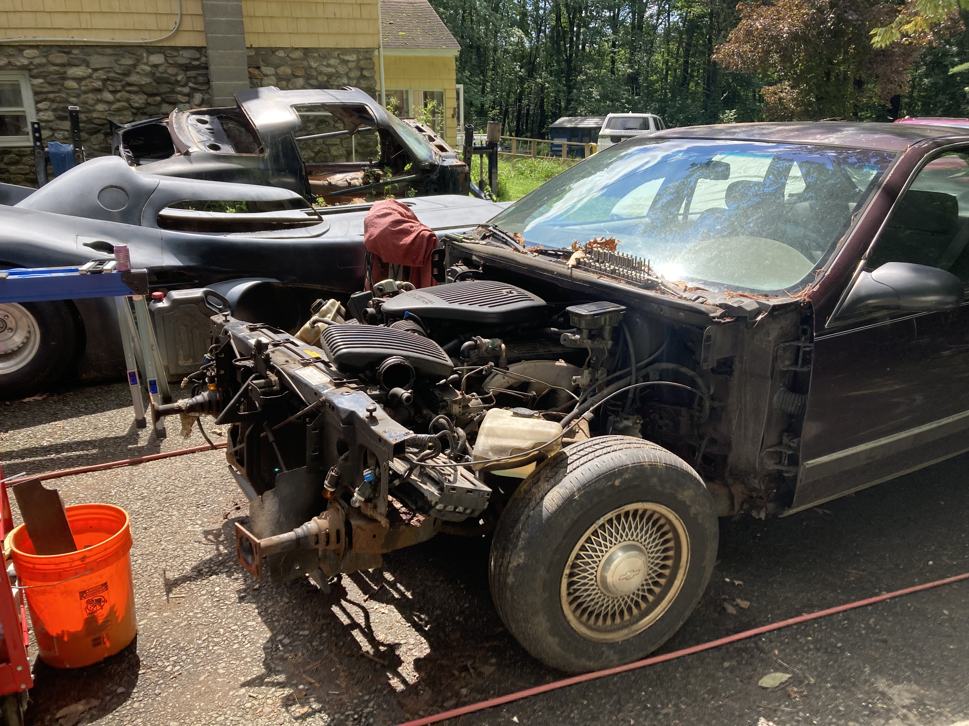

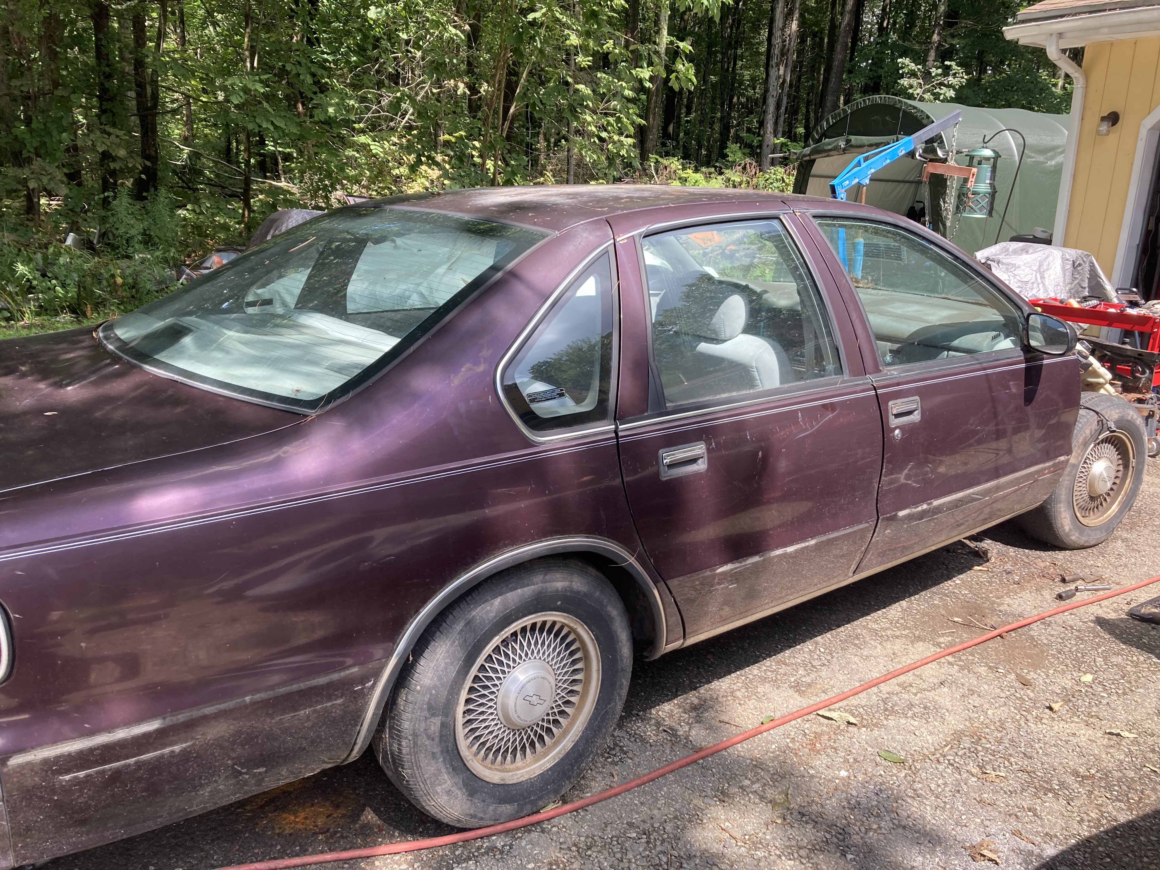

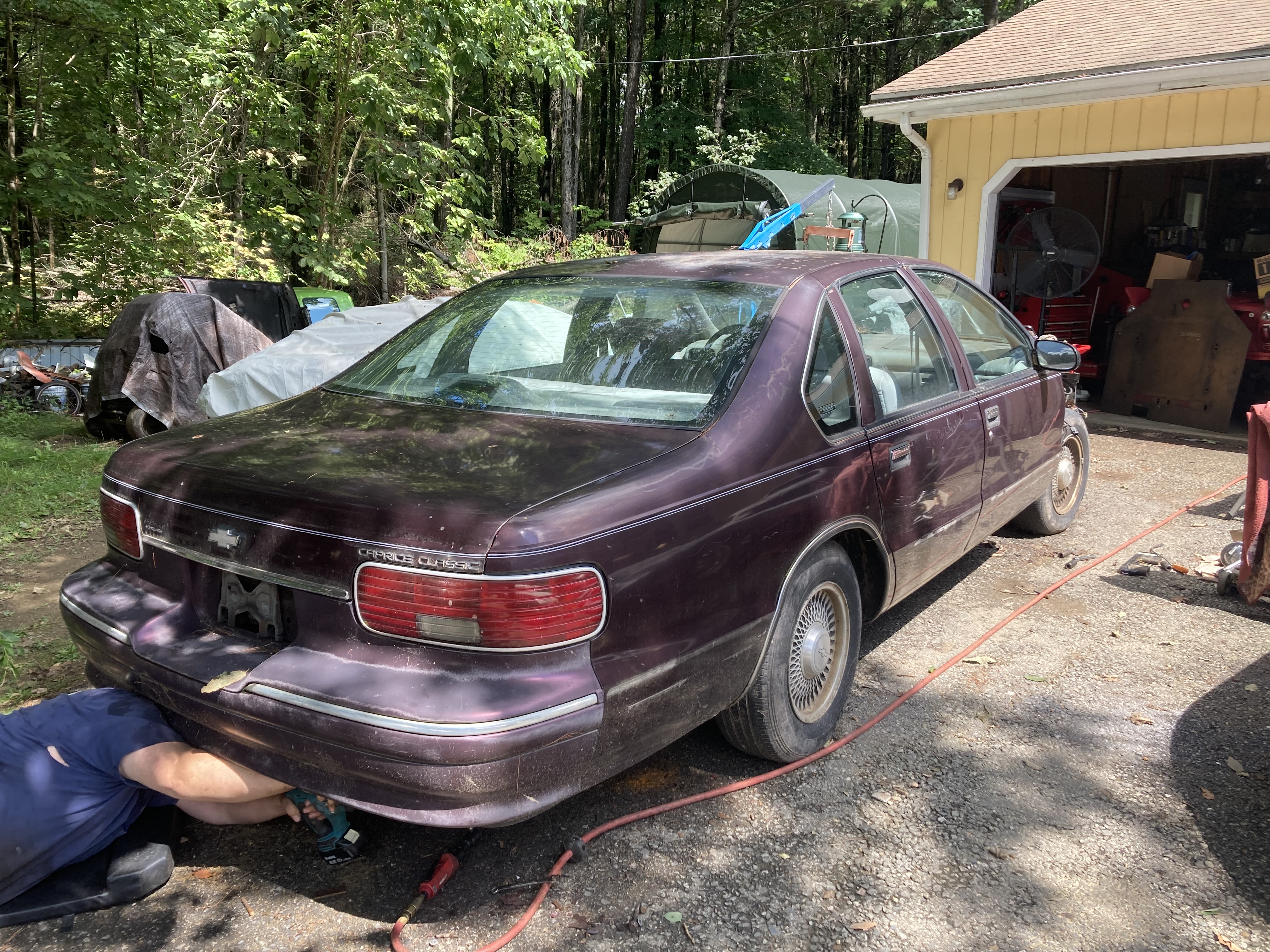

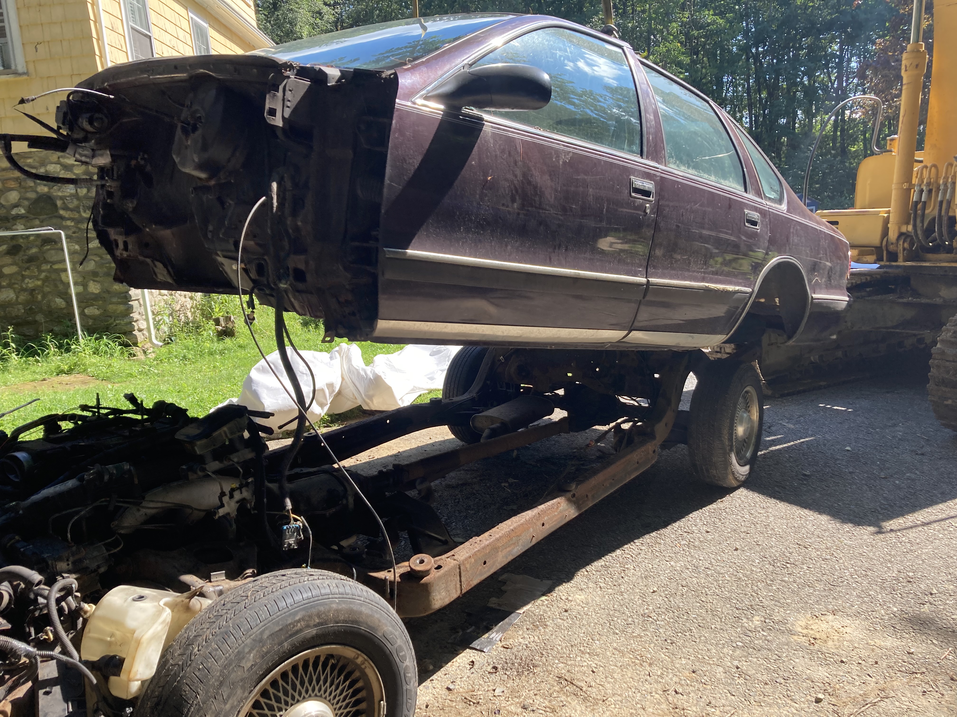

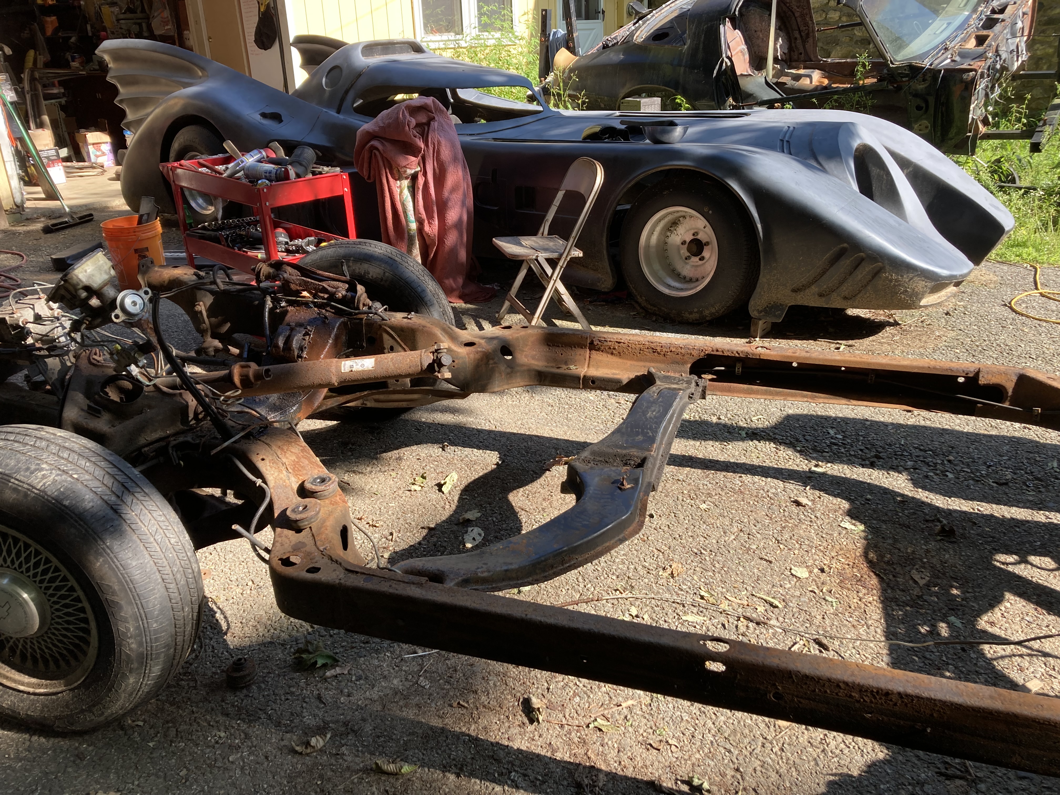

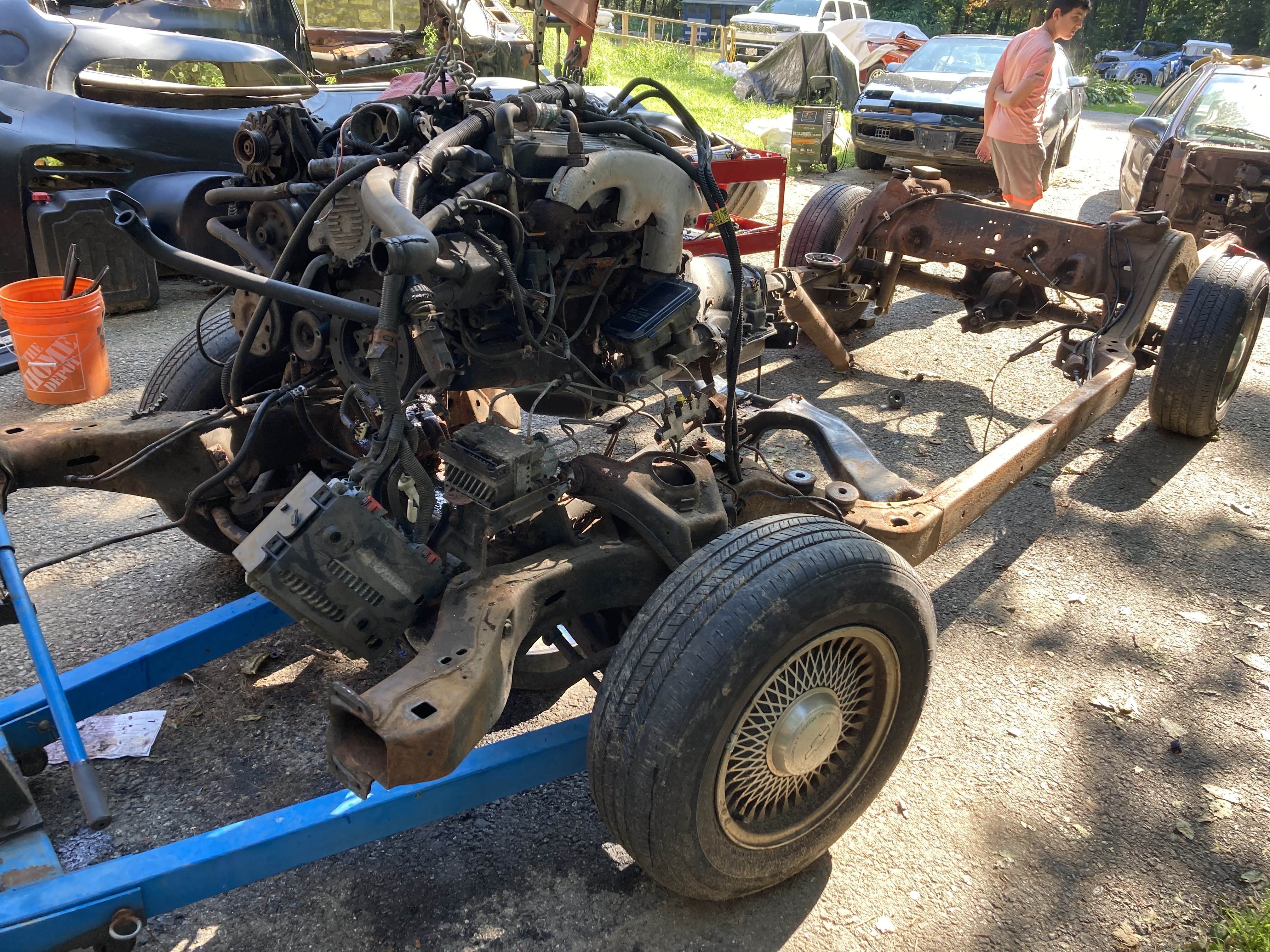

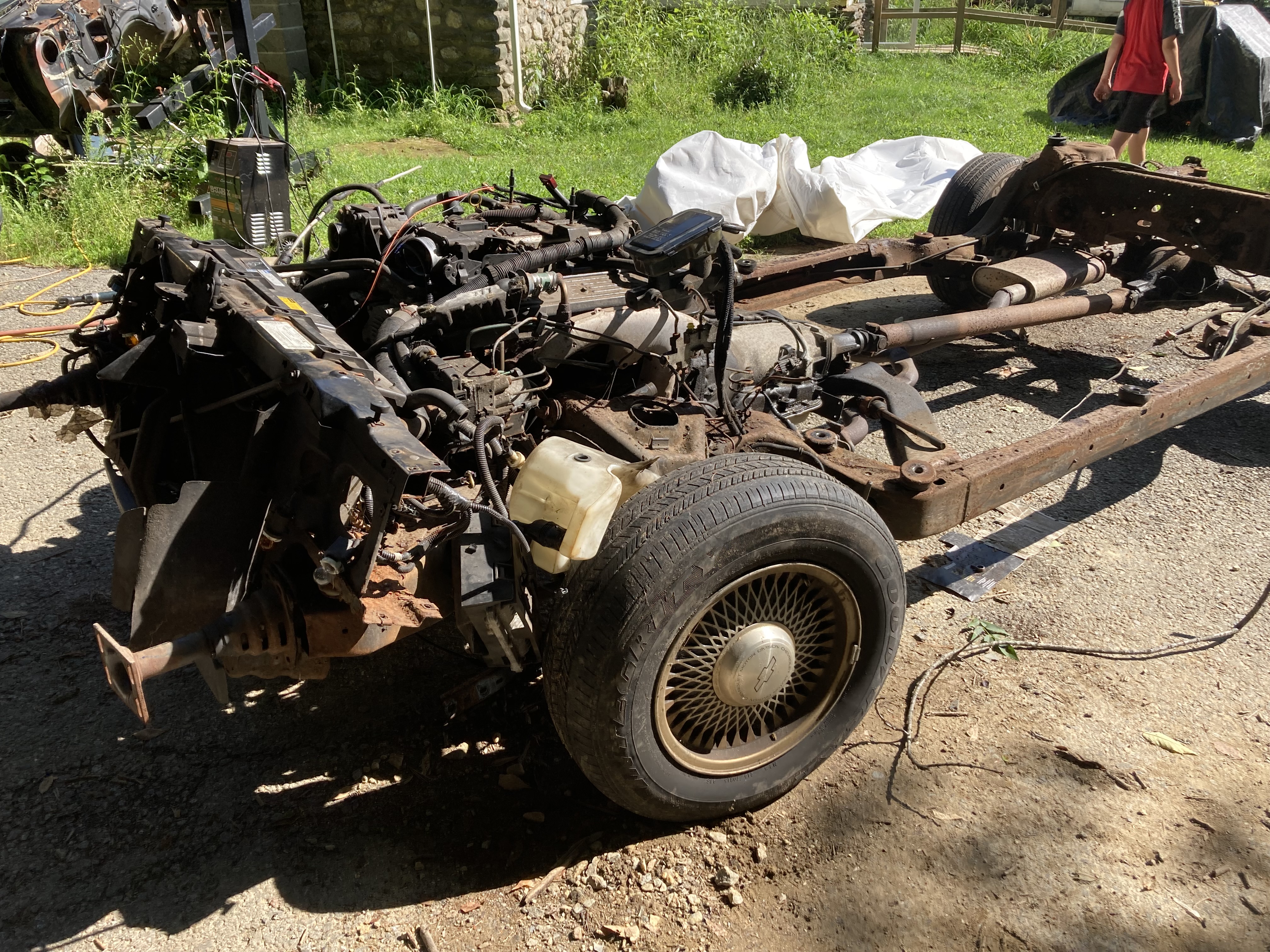

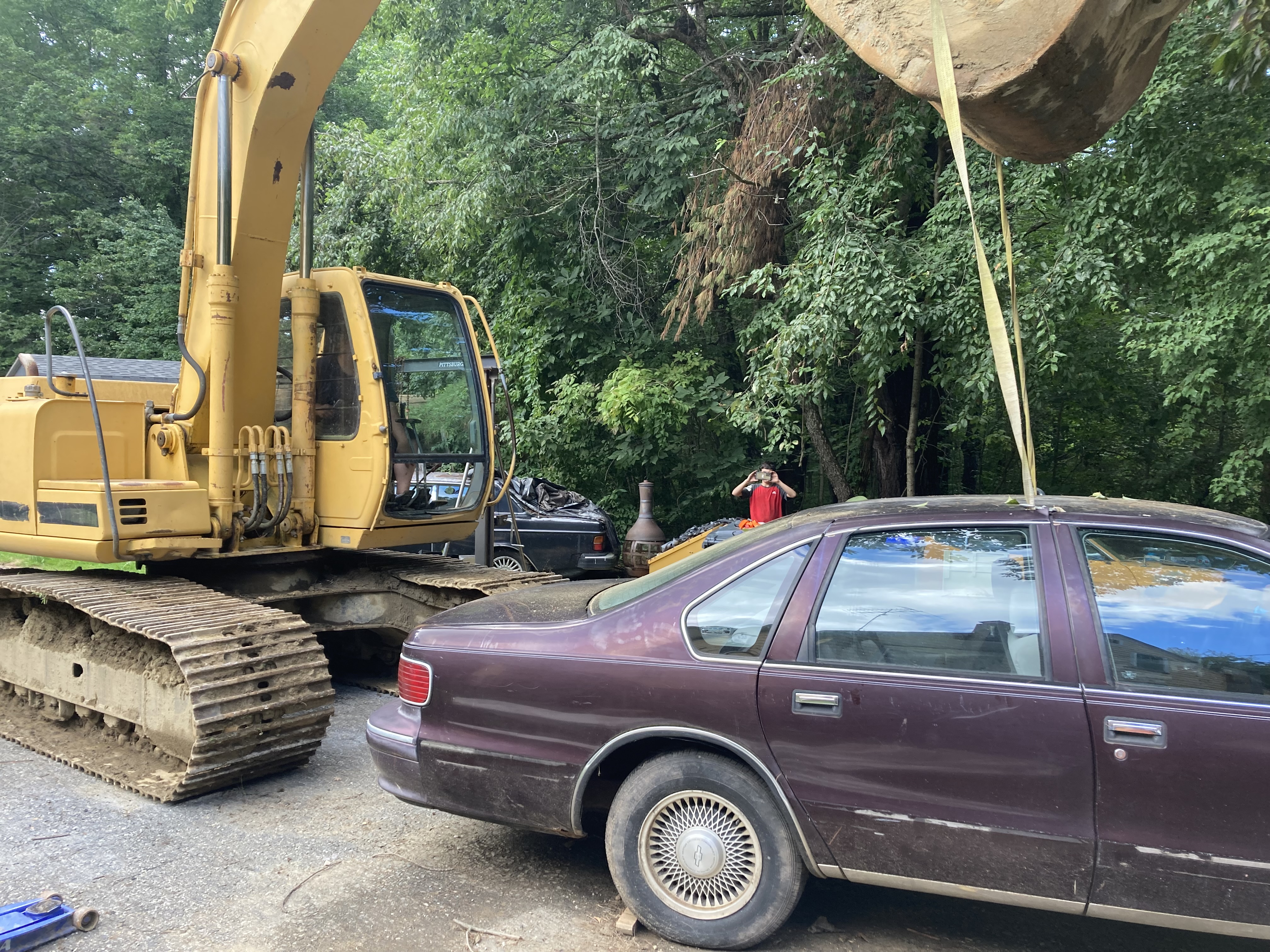

Well, last year we managed to pull the body and drive train out of a 96 Chevy Caprice. Got it stripped and ready to be cut and stretched. Pull the body off with a 33 ton excavator. Quick and easy.

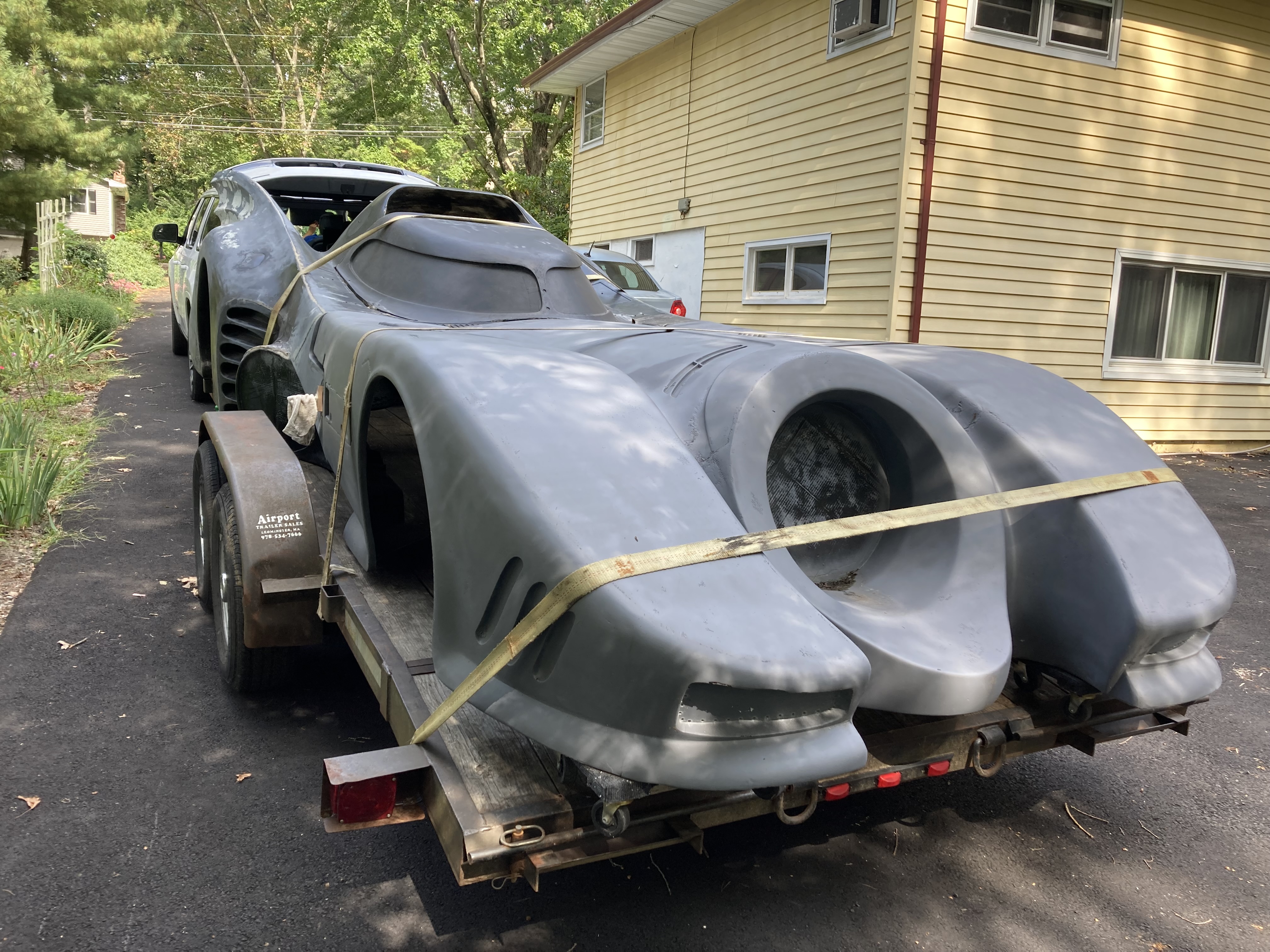

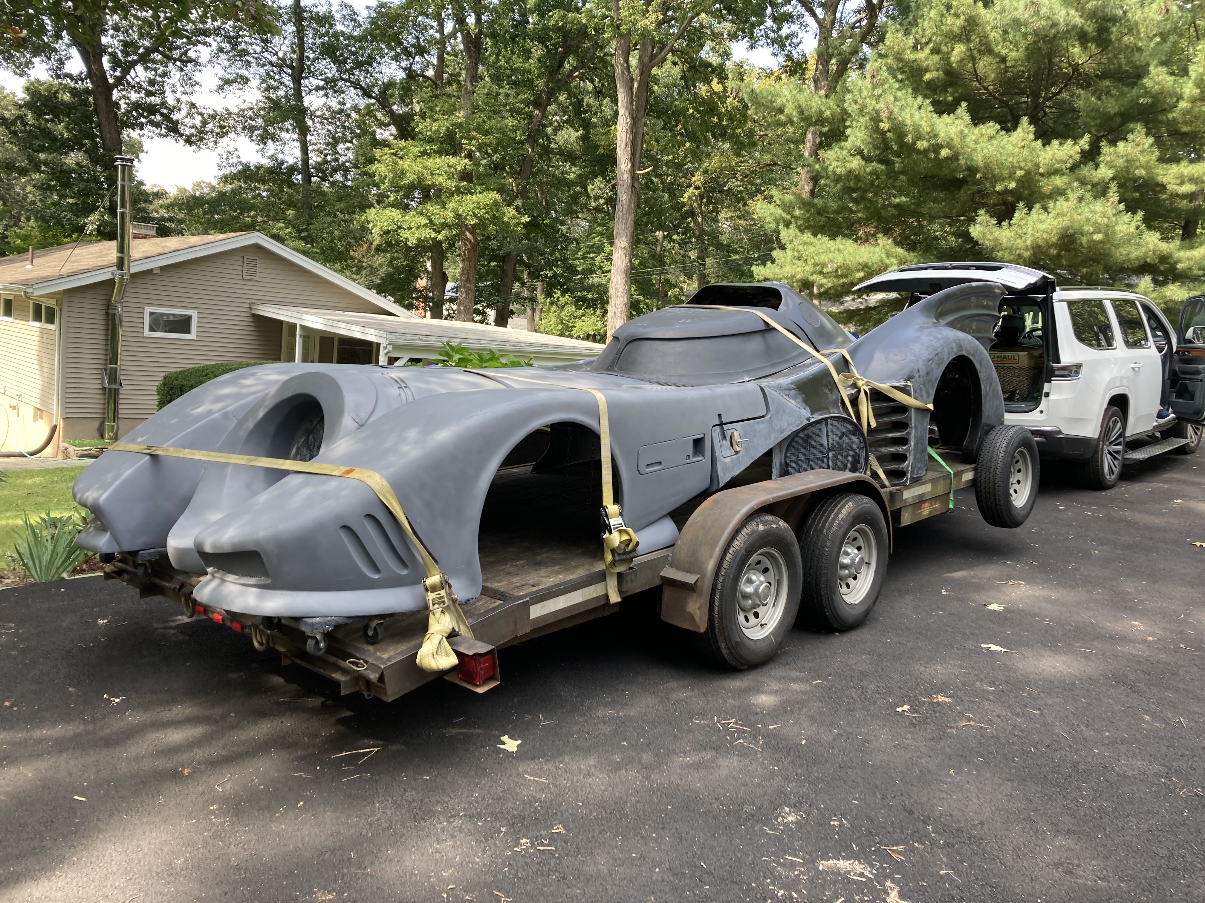

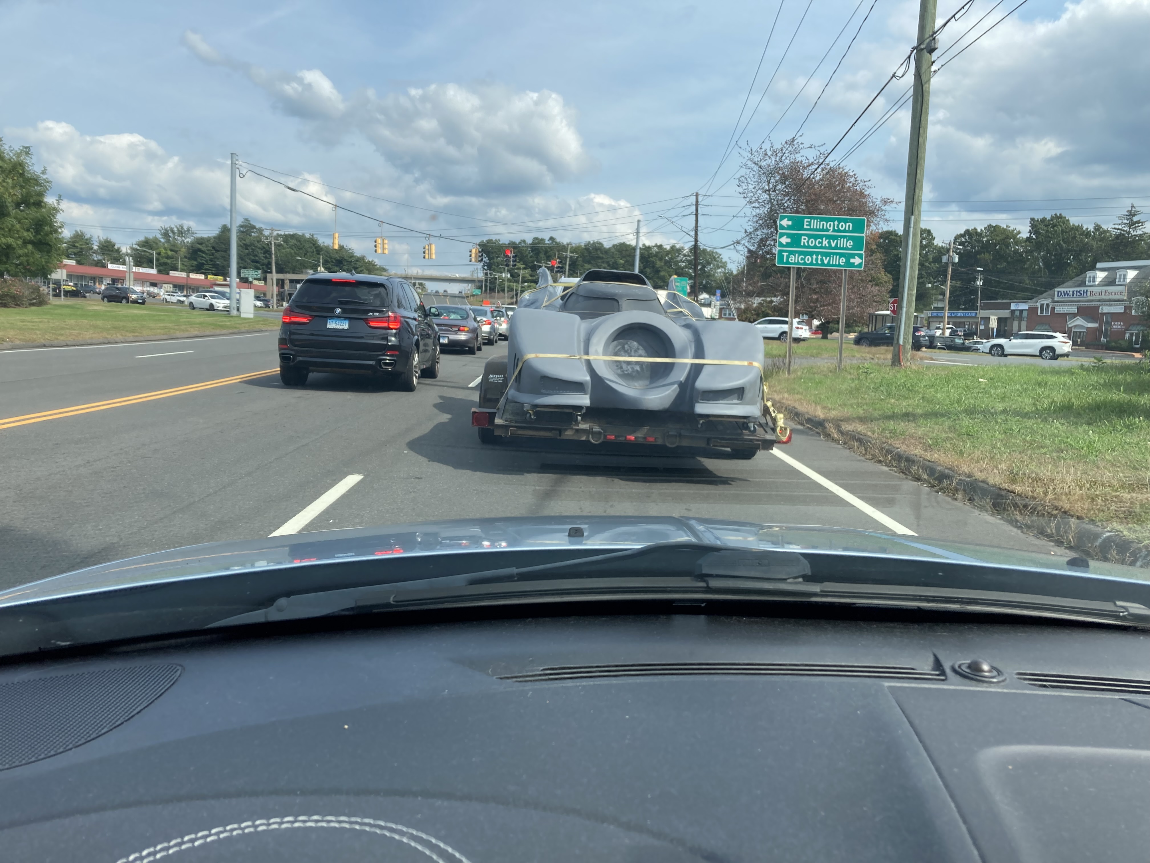

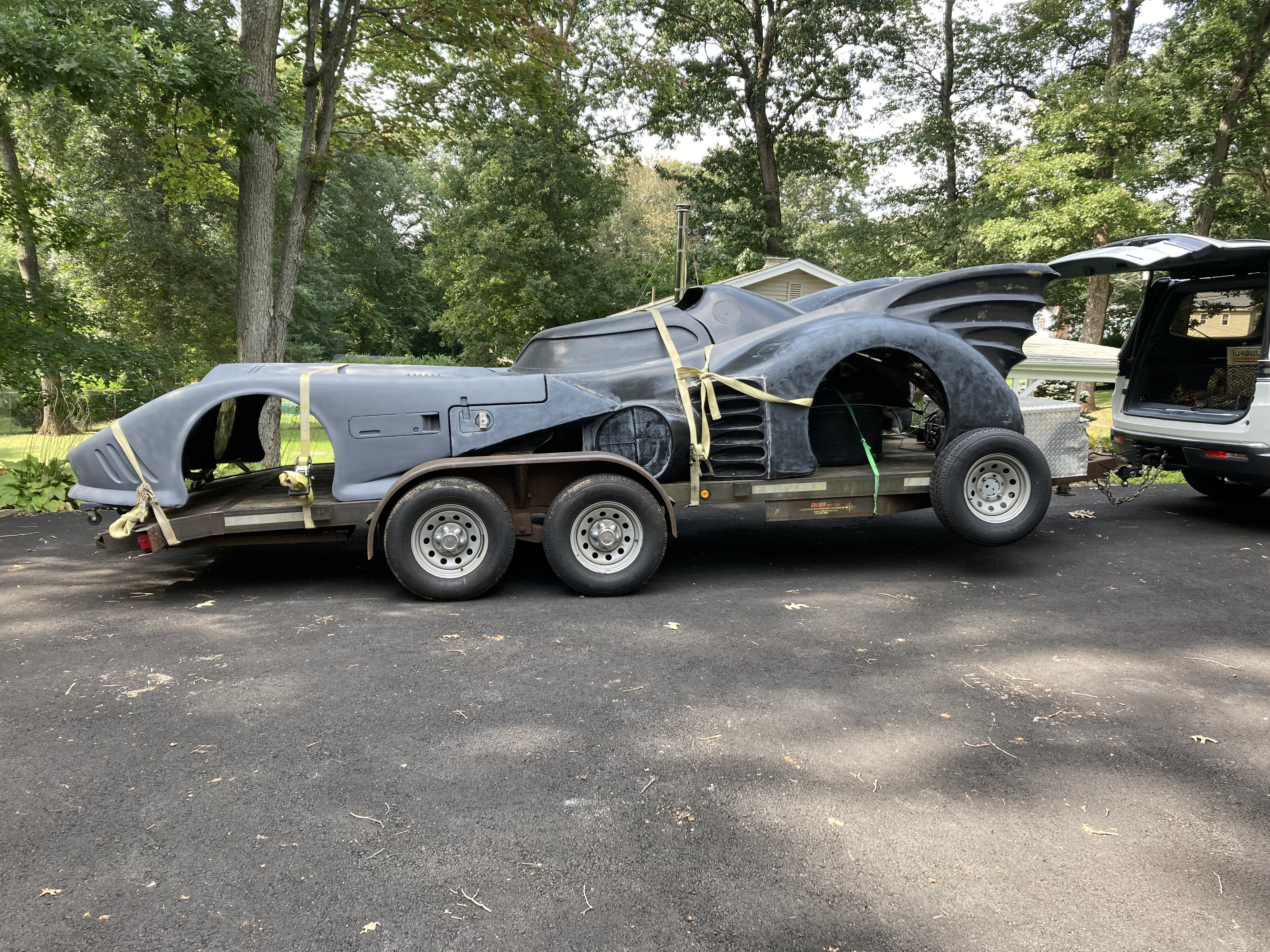

We then loaded the car body up and transported it to the new location to continue the build.

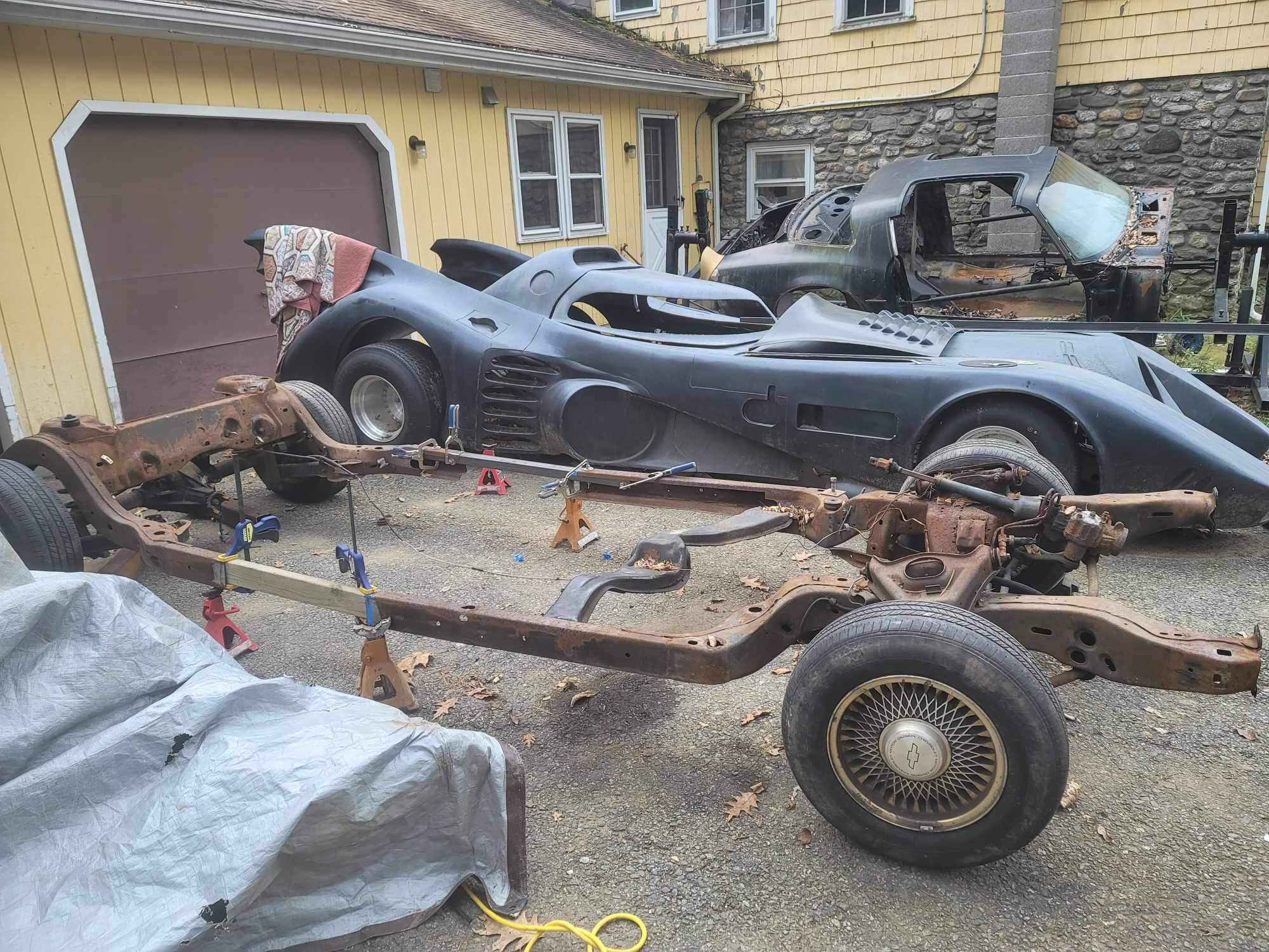

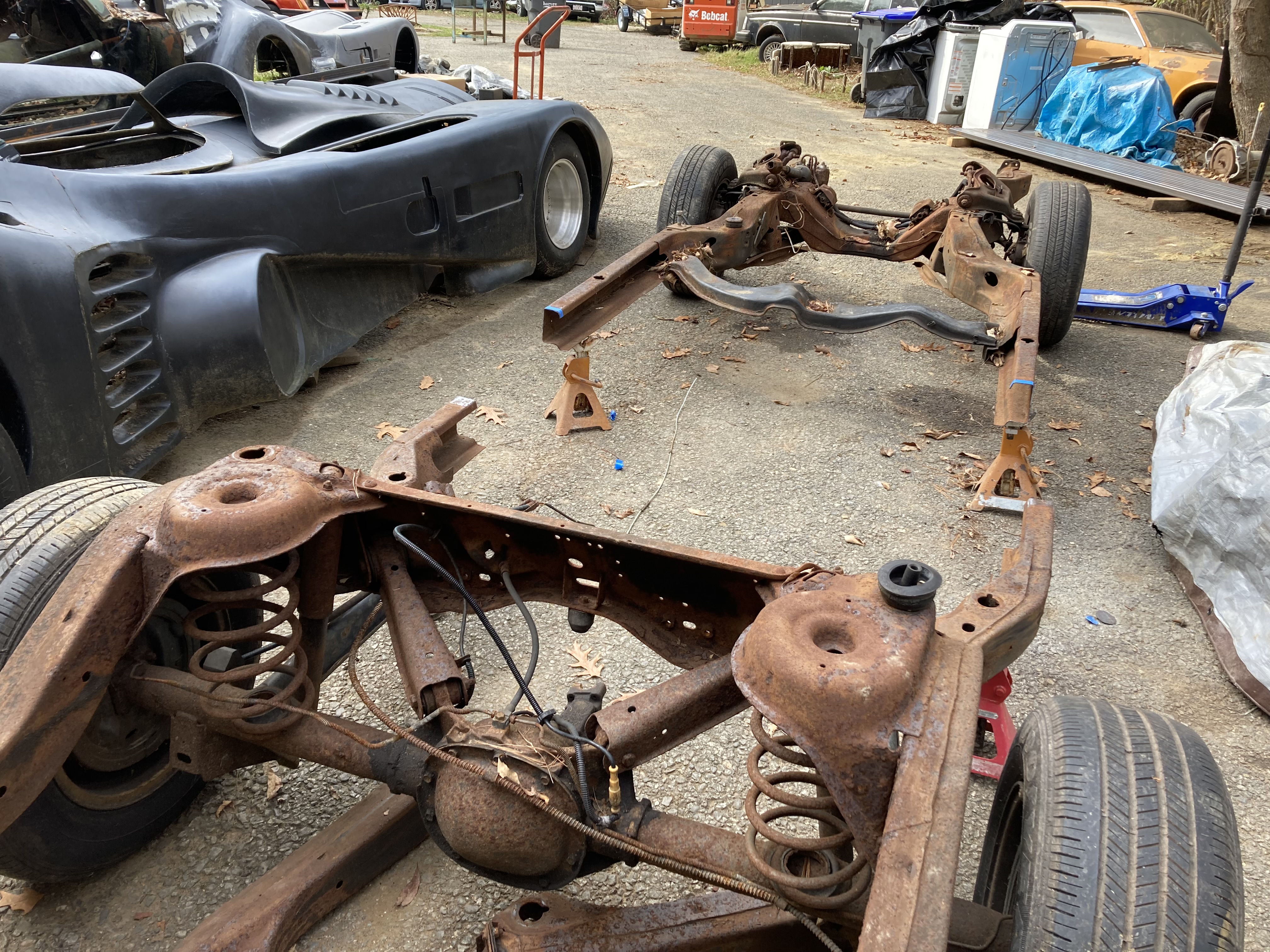

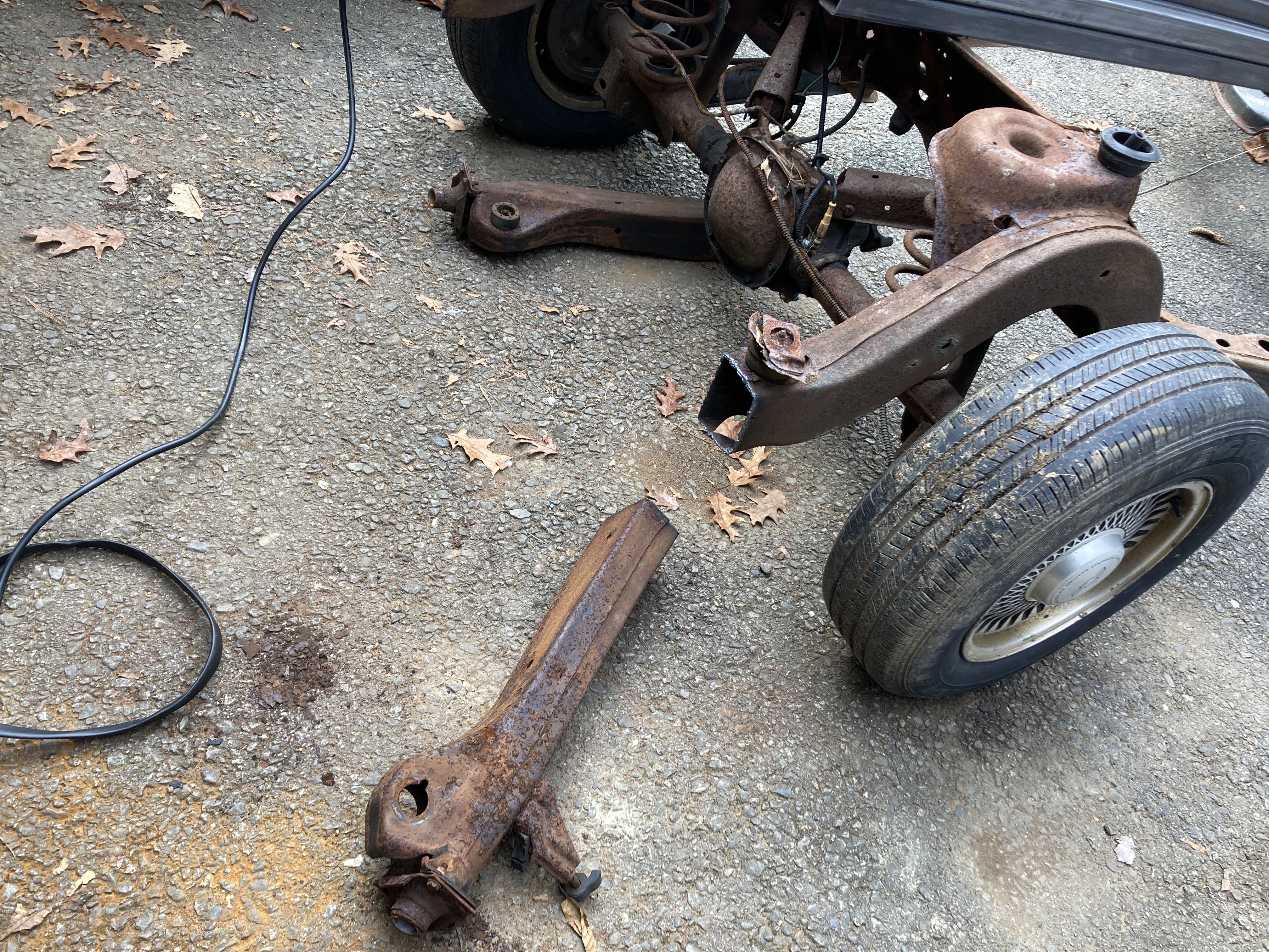

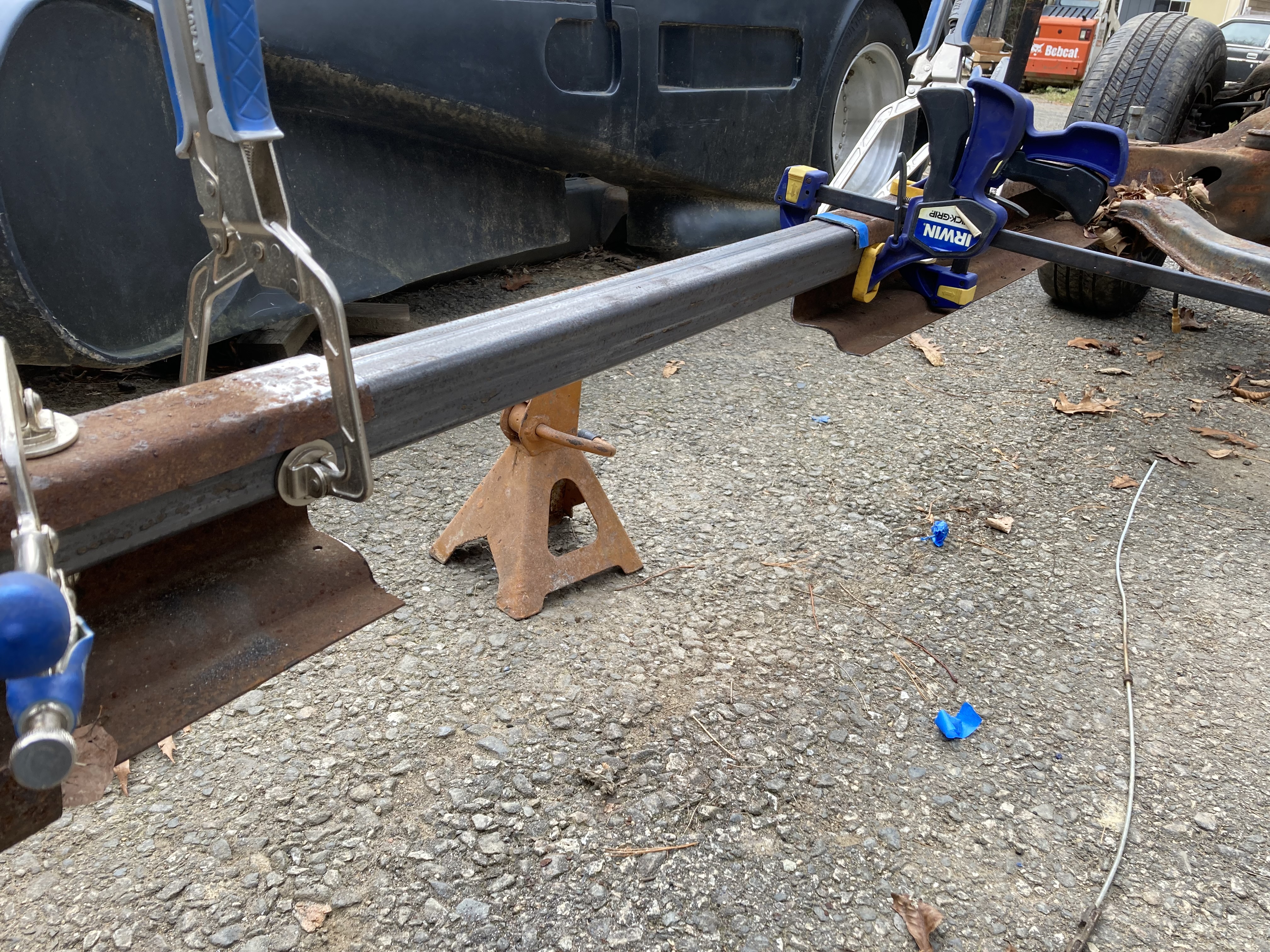

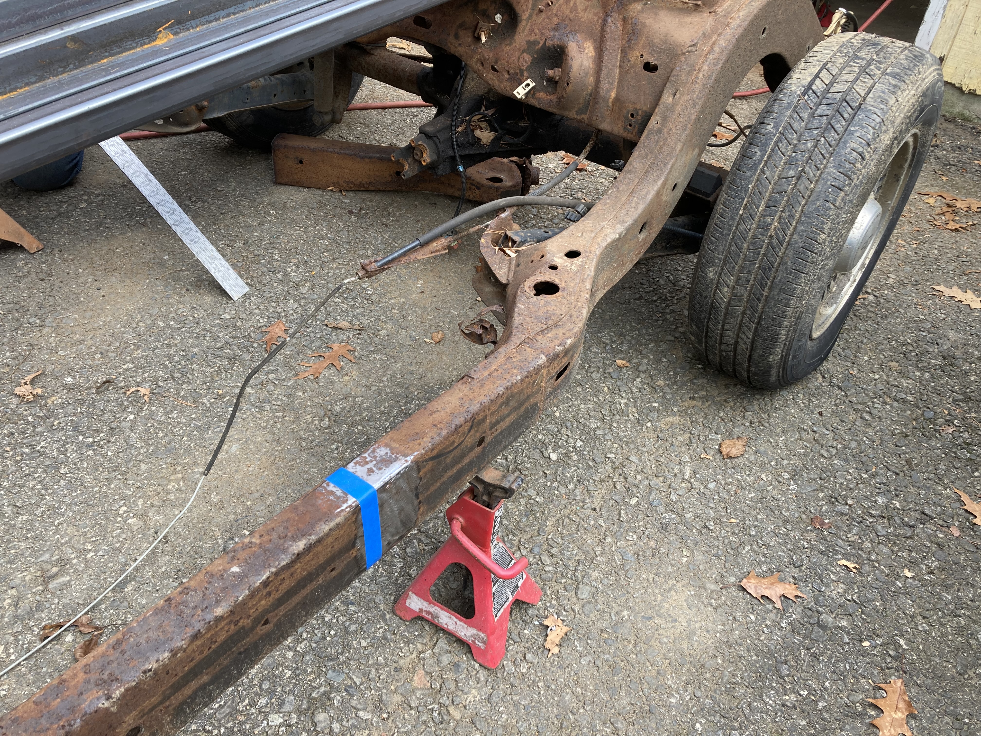

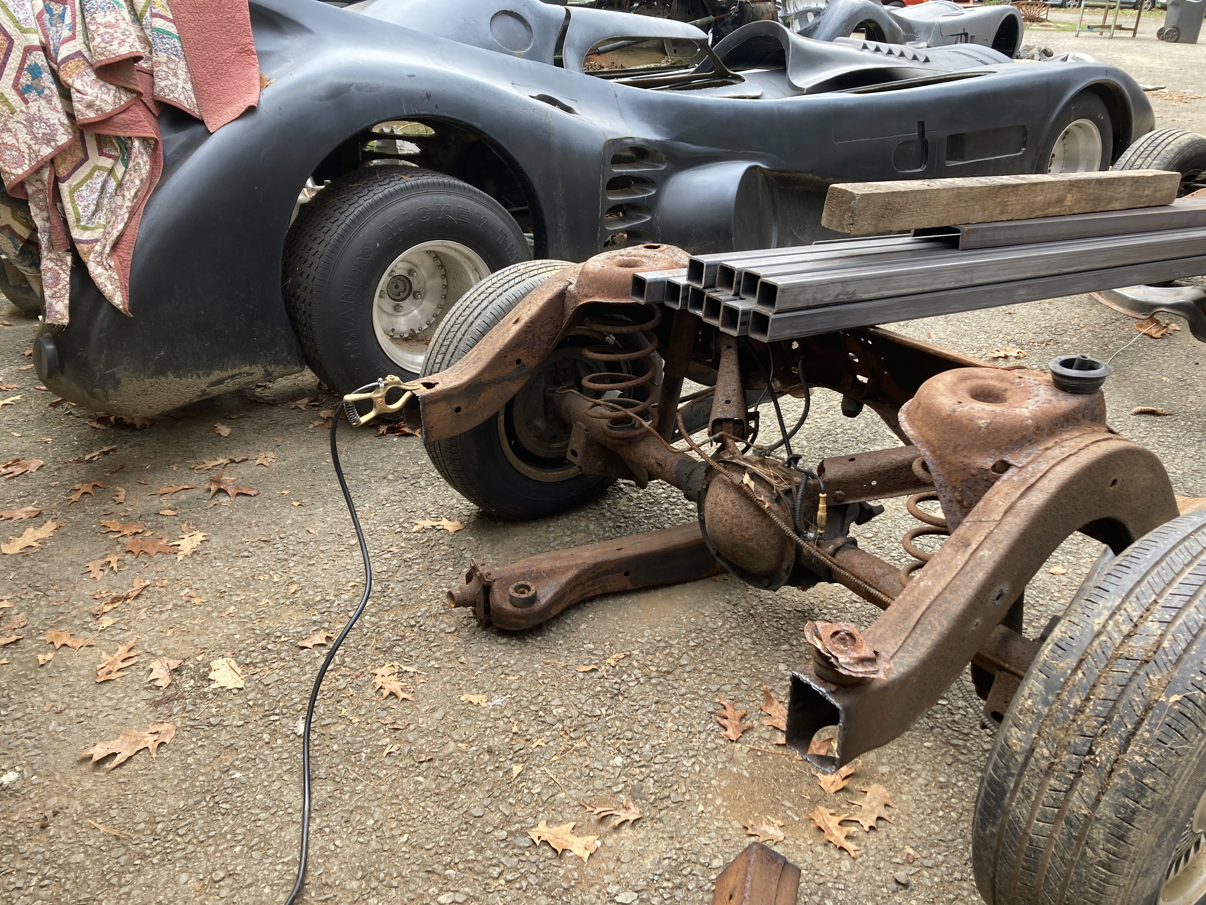

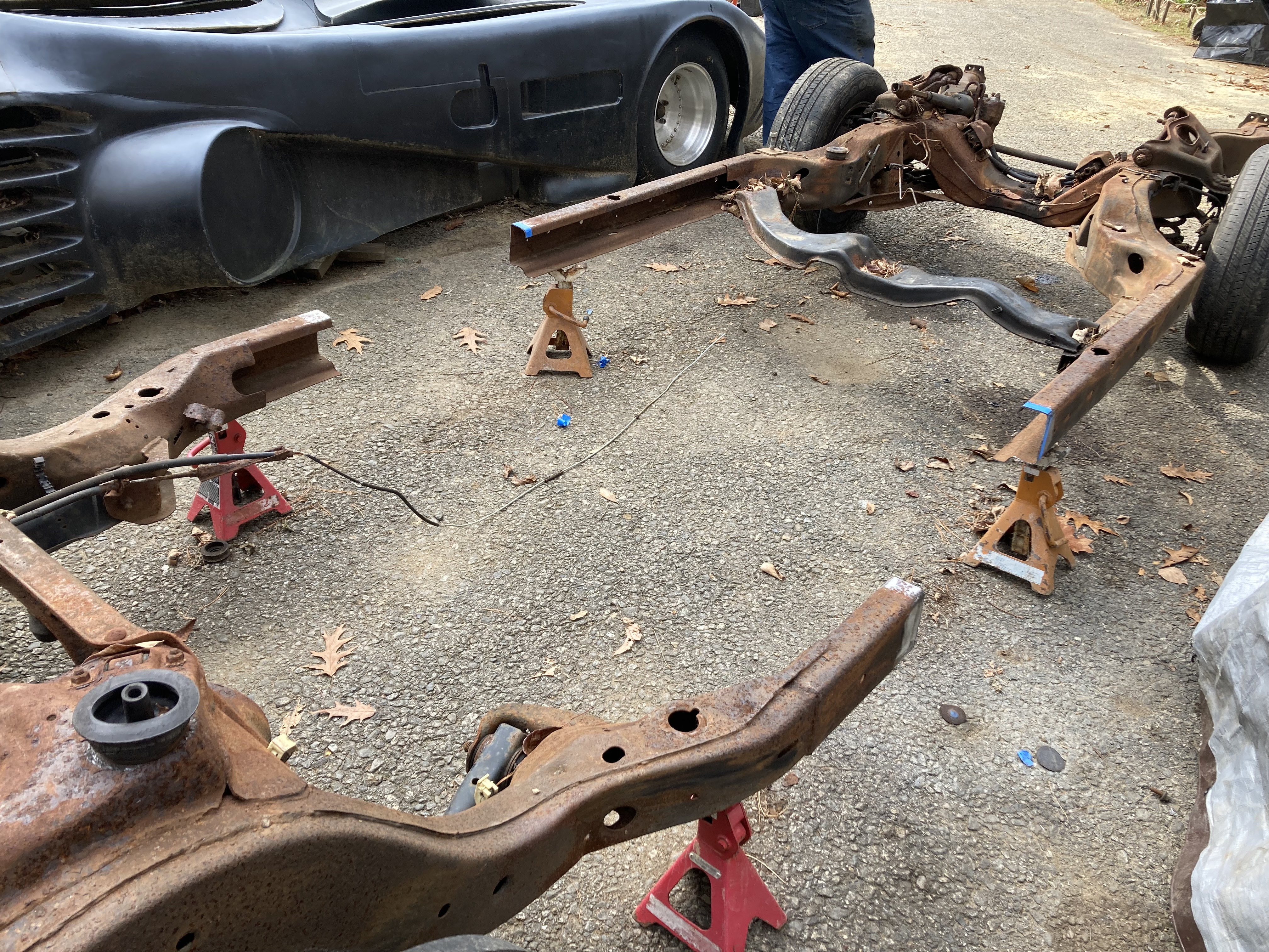

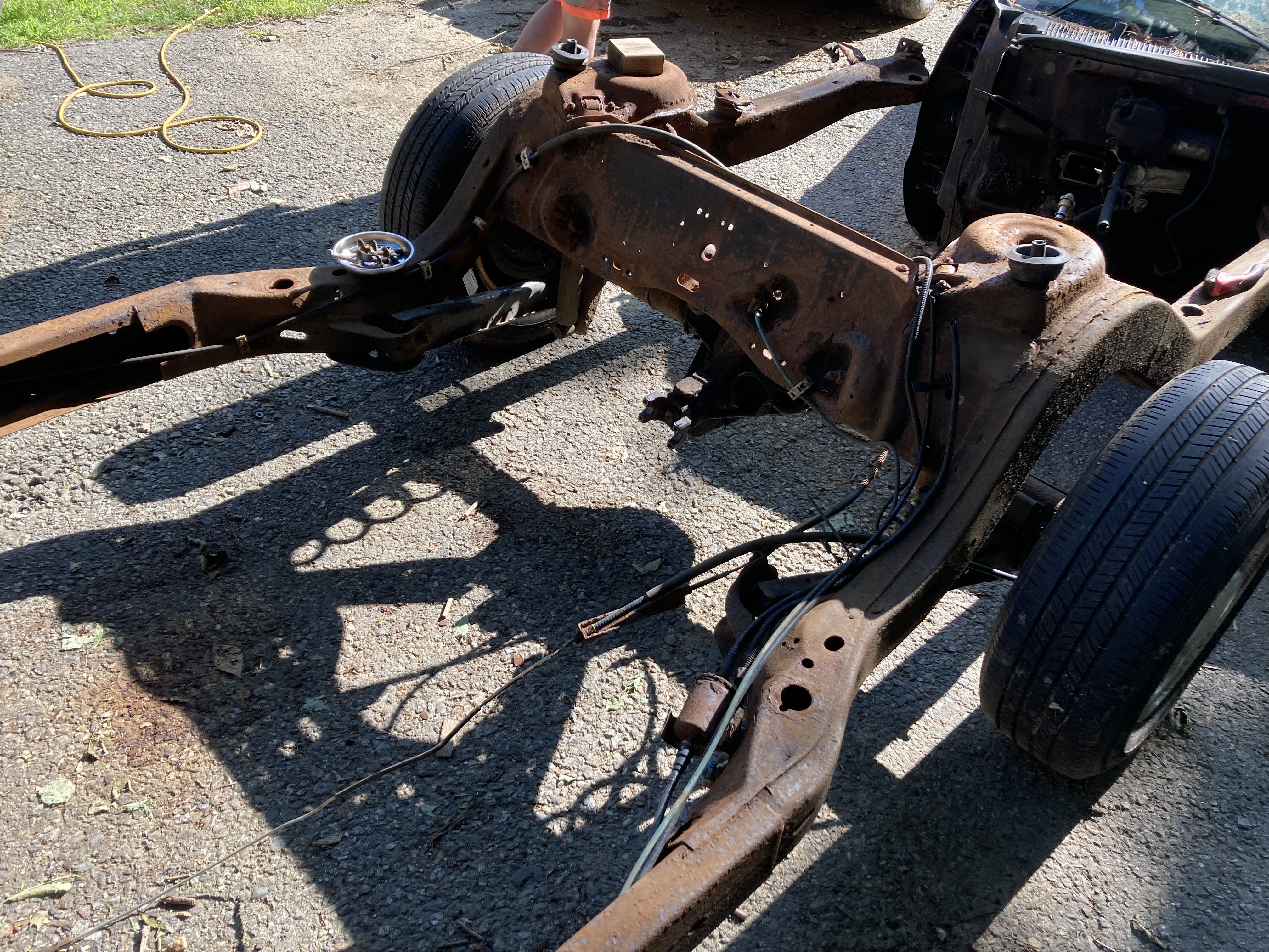

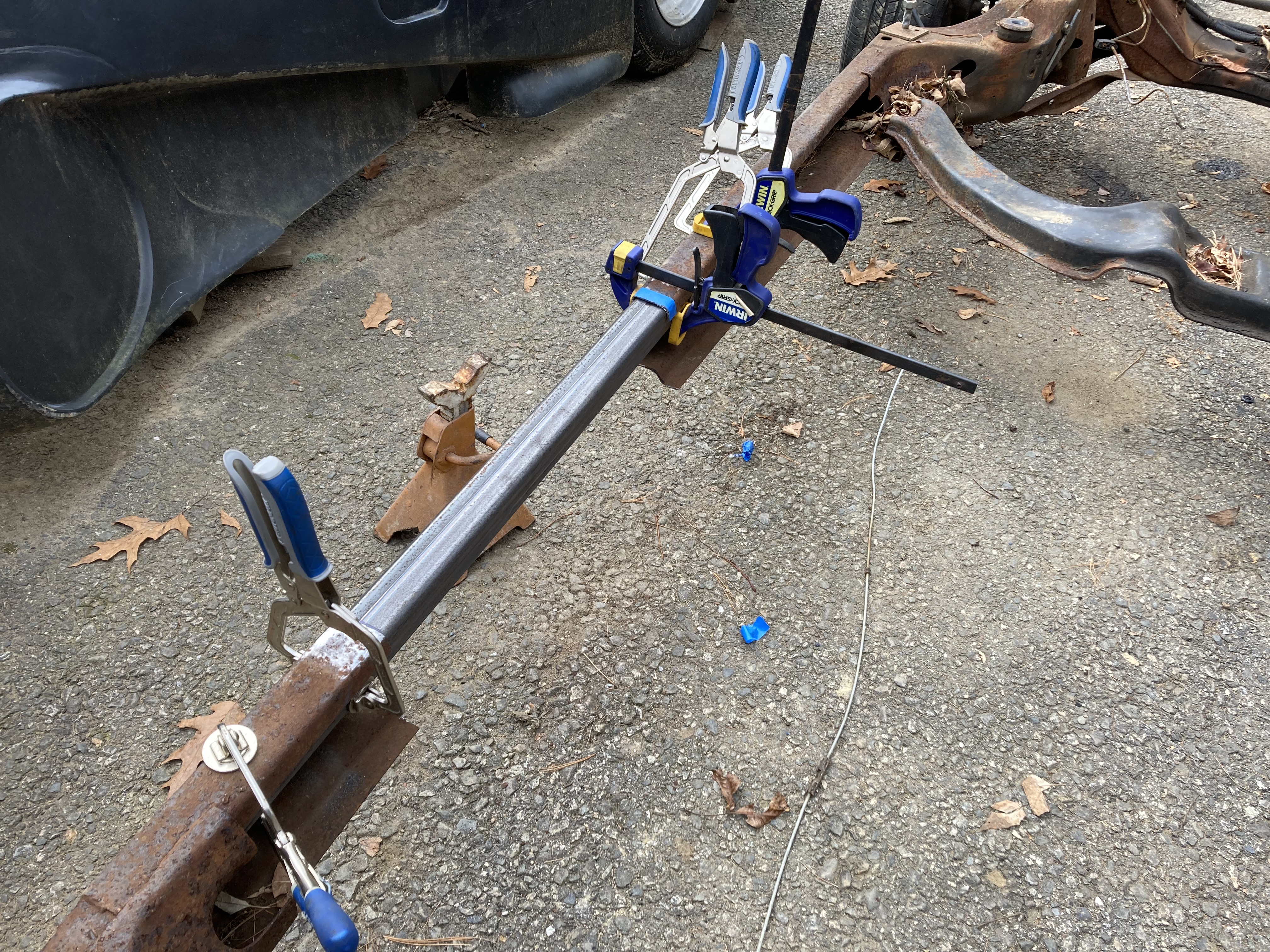

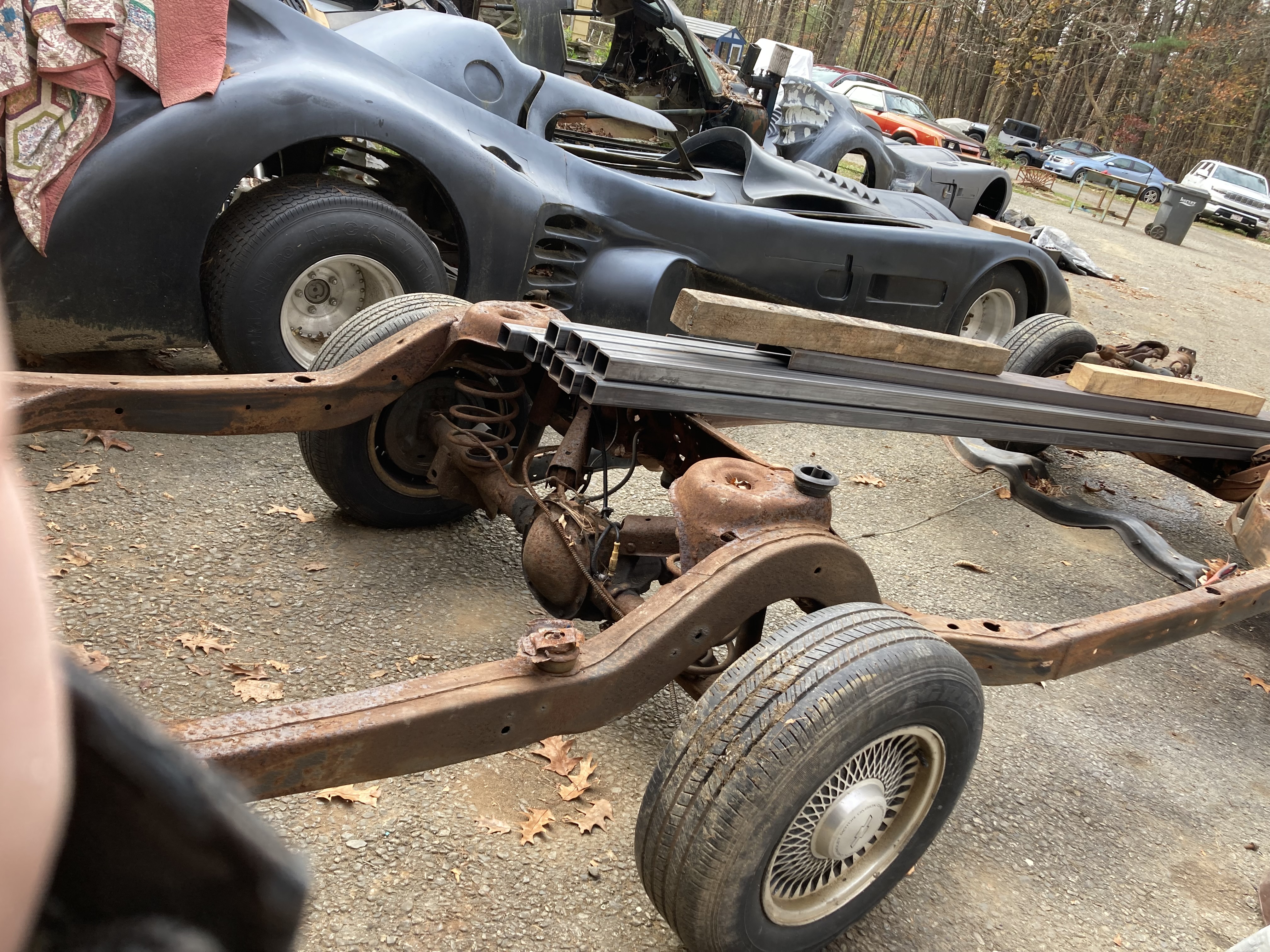

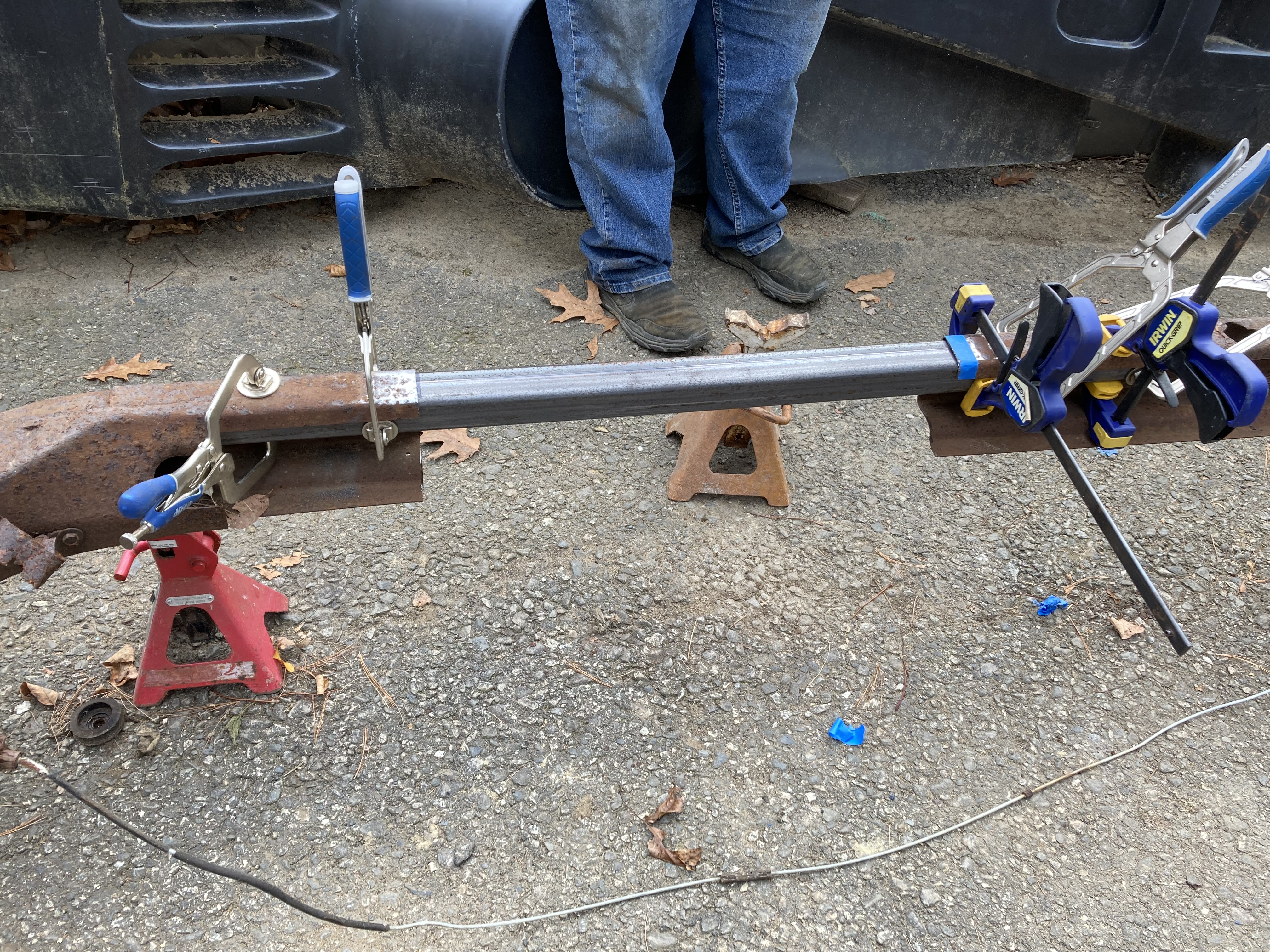

The frame was the measured multiple times, marked and cut into two. 4" steel square tubing was threaded through the old frame and stretched it by almost 2 feet, giving us our 141" wheel base needed for the batmobile.

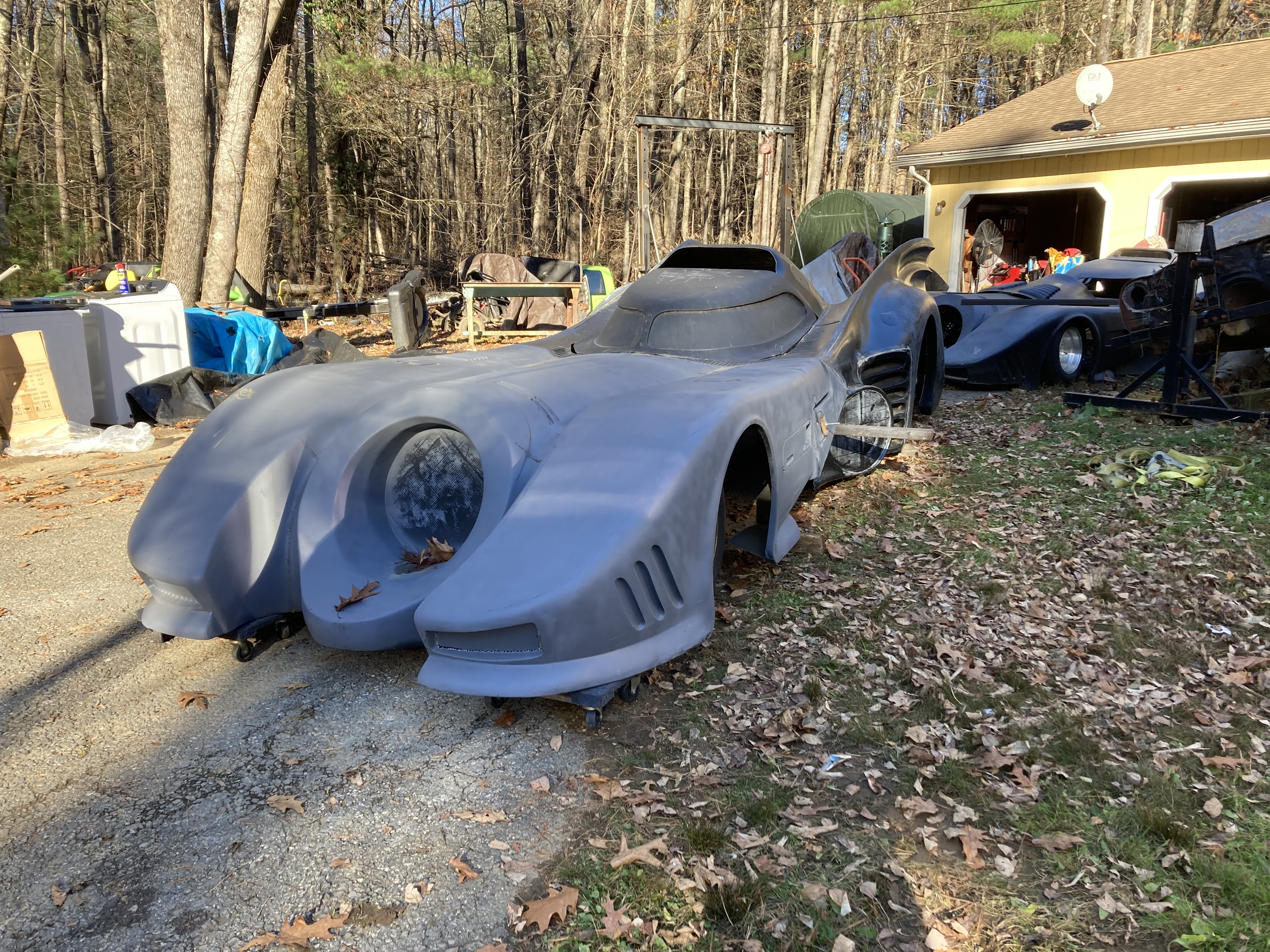

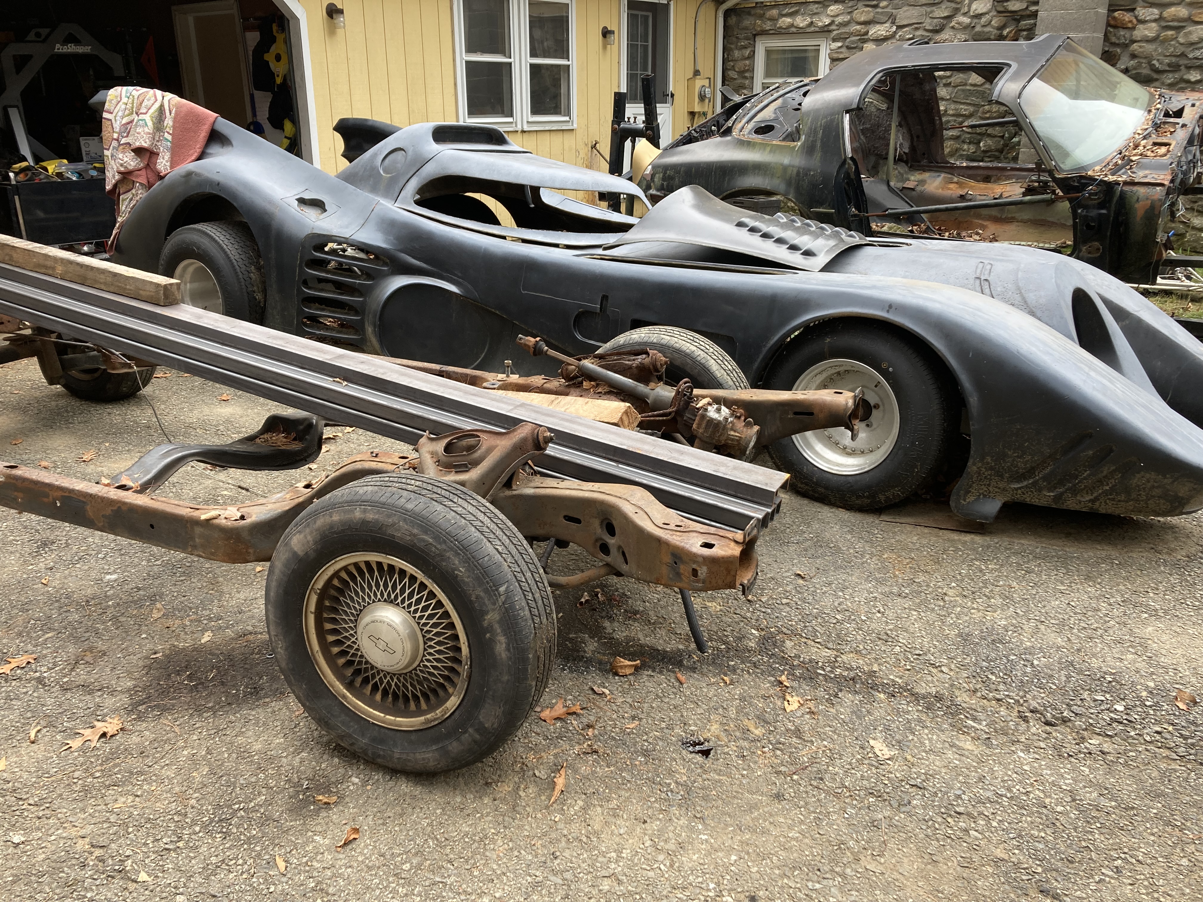

The body was then placed over the frame to test the wheel base, making sure the wheels lined up with the body wheel wells. and yes................... We are building two. The one in the back is a bit further along. Both cars will be getting LS Engines too.
