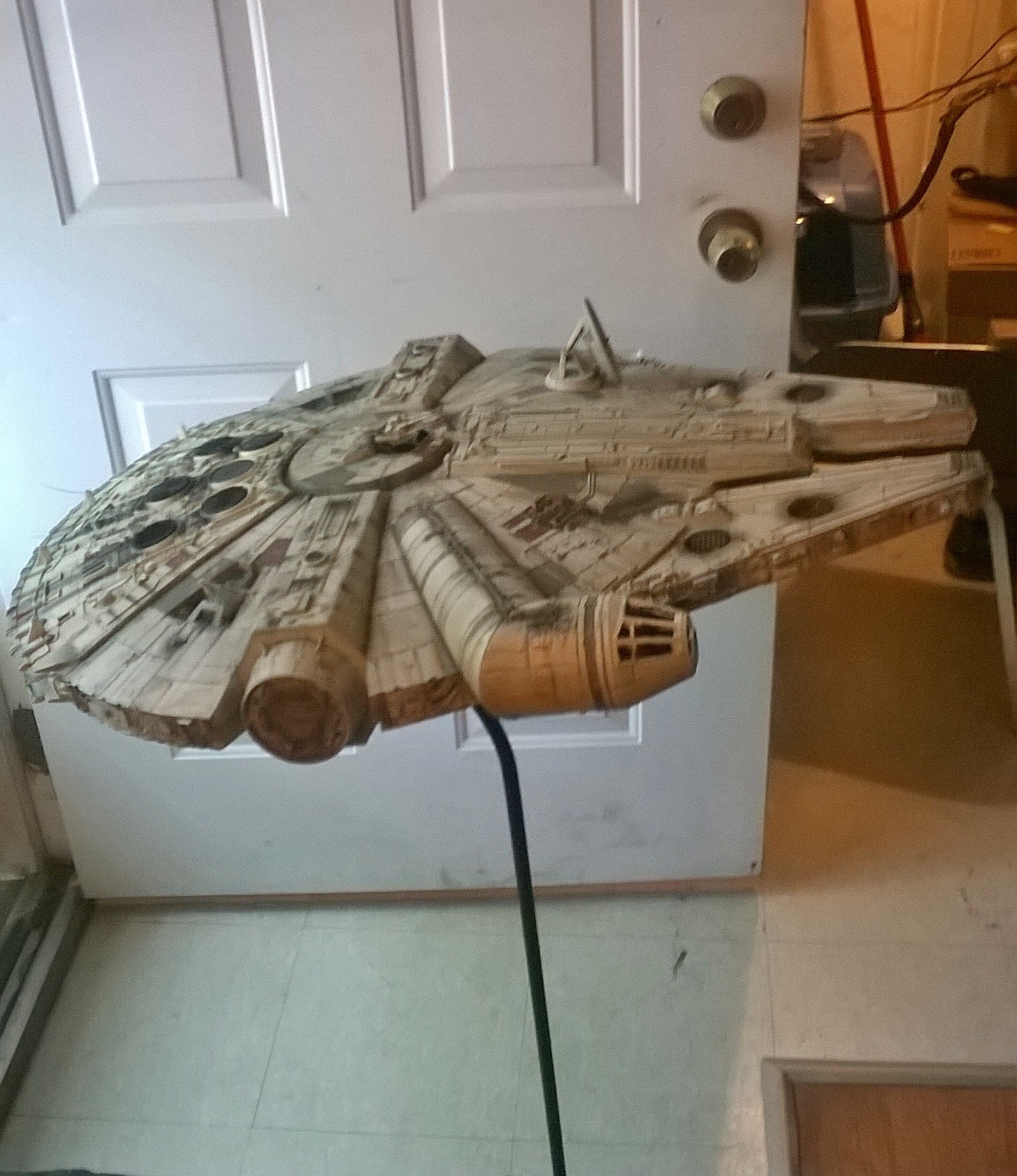

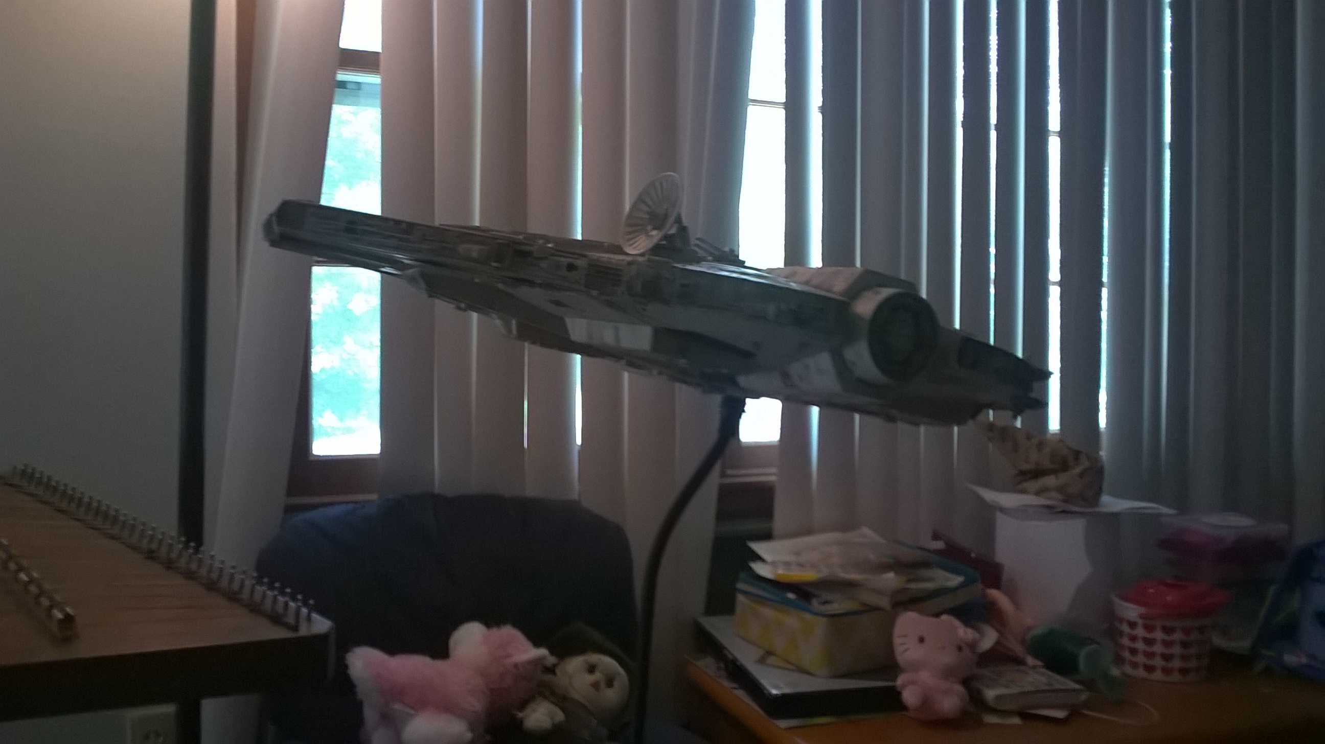

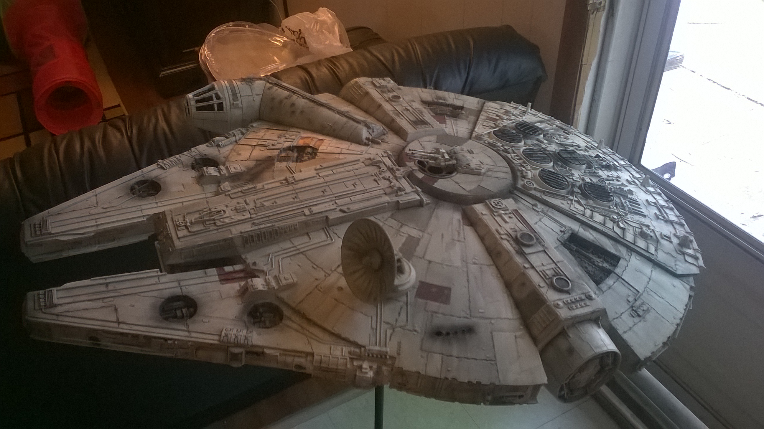

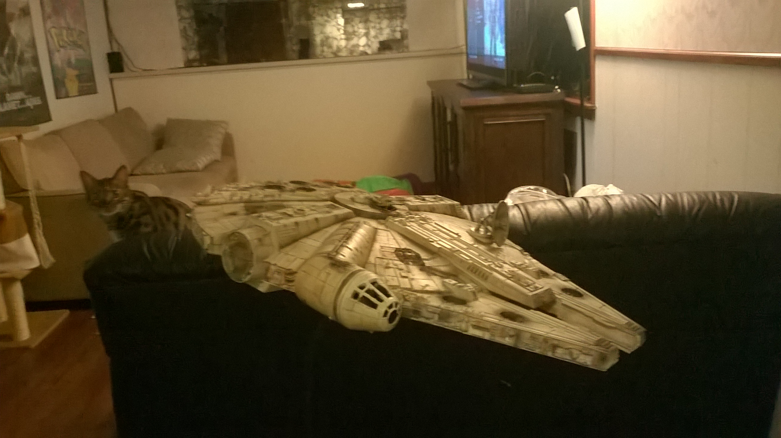

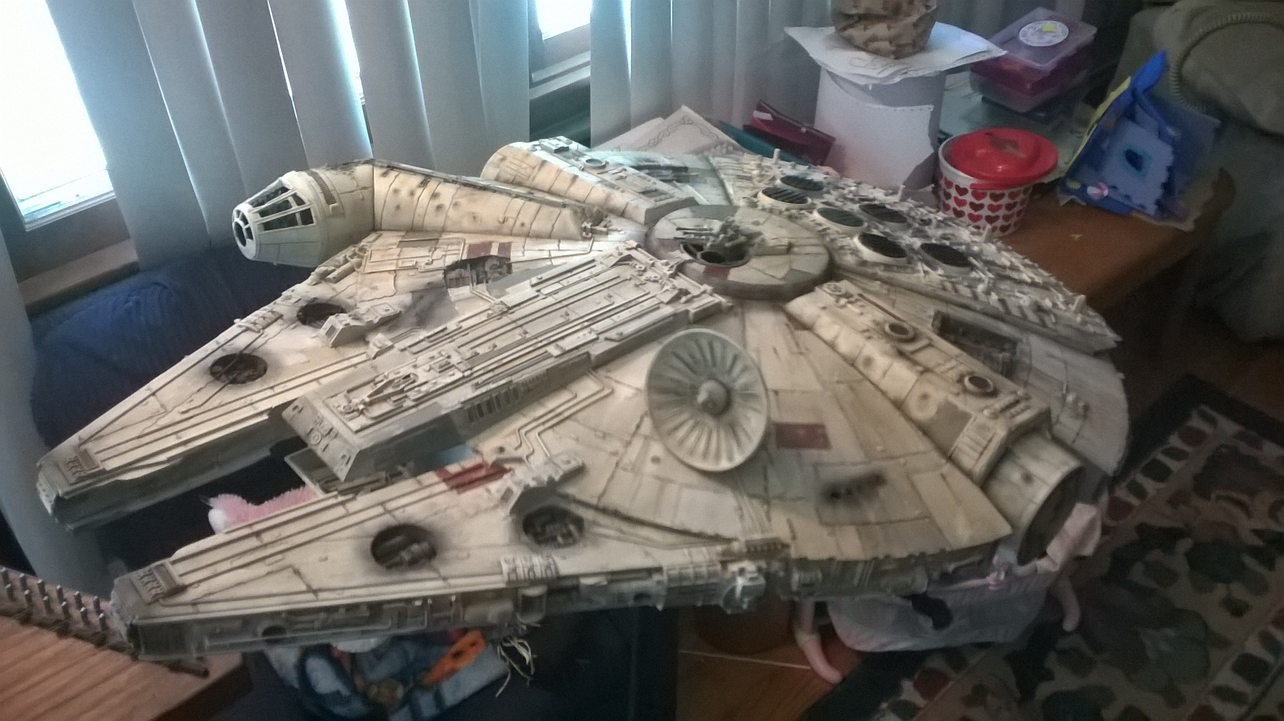

Looks great Leyrich. I finally finished my first Falcon. At least, I am not going to do anymore. It has been more of an experiment to see what works and what doesn't before I start another. I just finished re-painting it and have already given it away. WP_20150704_11_47_29_Pro.jpgWP_20150704_11_47_51_Pro.jpgWP_20150704_11_48_26_Pro.jpgWP_20150704_11_48_54_Pro.jpgWP_20150704_11_49_22_Pro.jpgWP_20150704_11_49_35_Pro.jpgWP_20150704_12_04_32_Pro.jpgWP_20150704_12_04_41_Pro.jpg
This is basically my first attempt at something like this (with the exception of the second paint job on this one) and done as inexpensively as I could. Turned out well enough. I think I am ready to start one for me now.

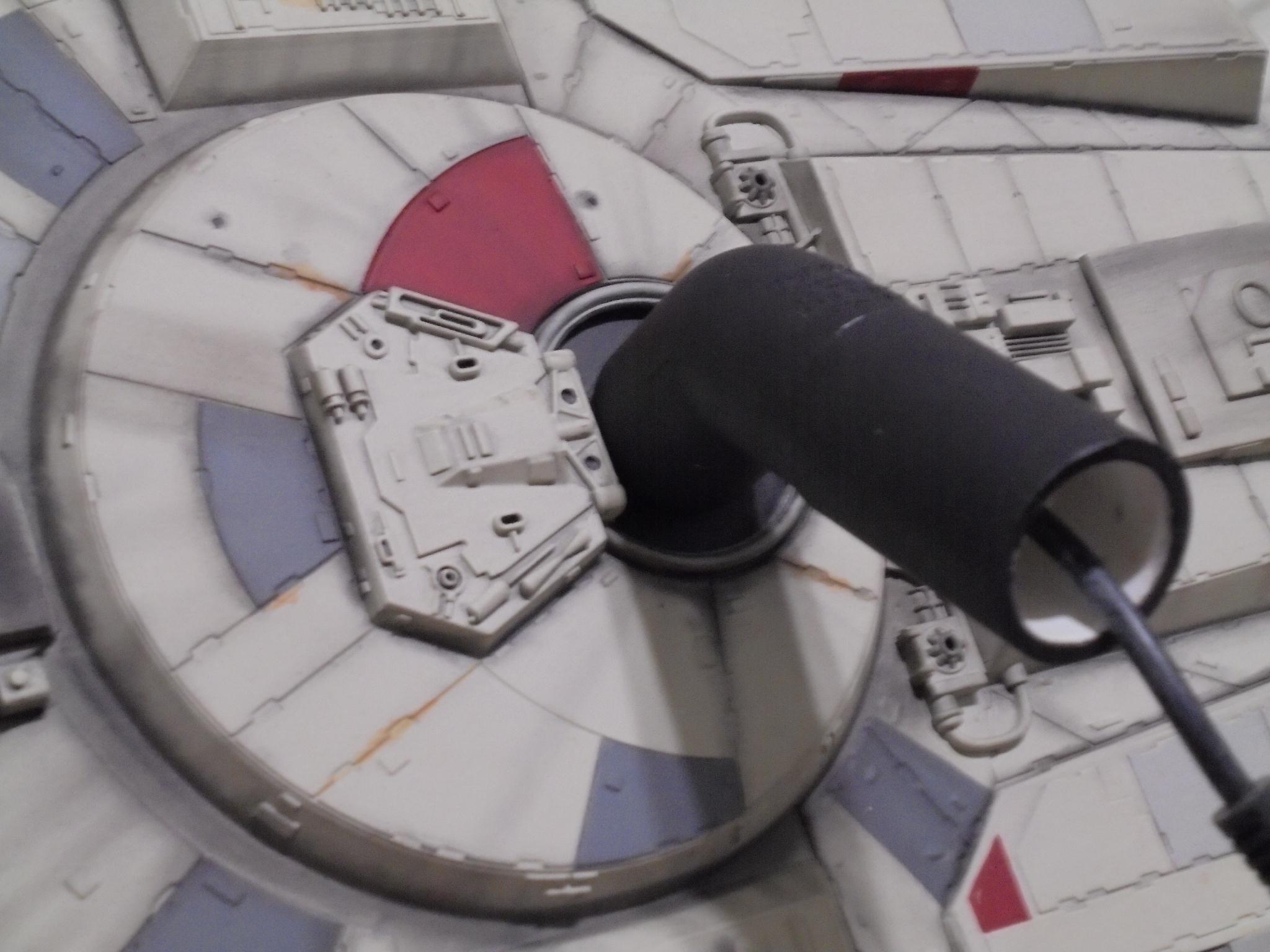

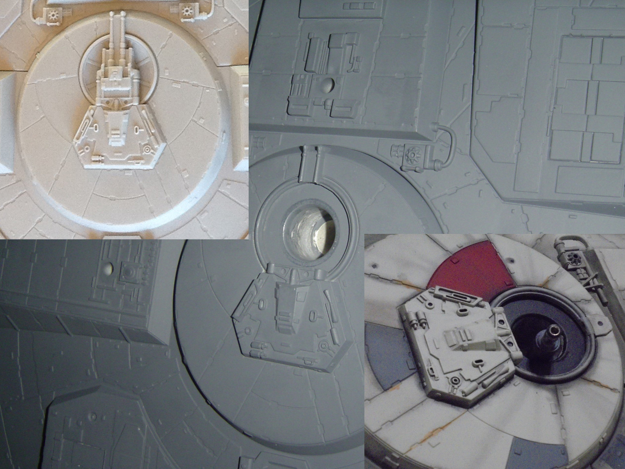

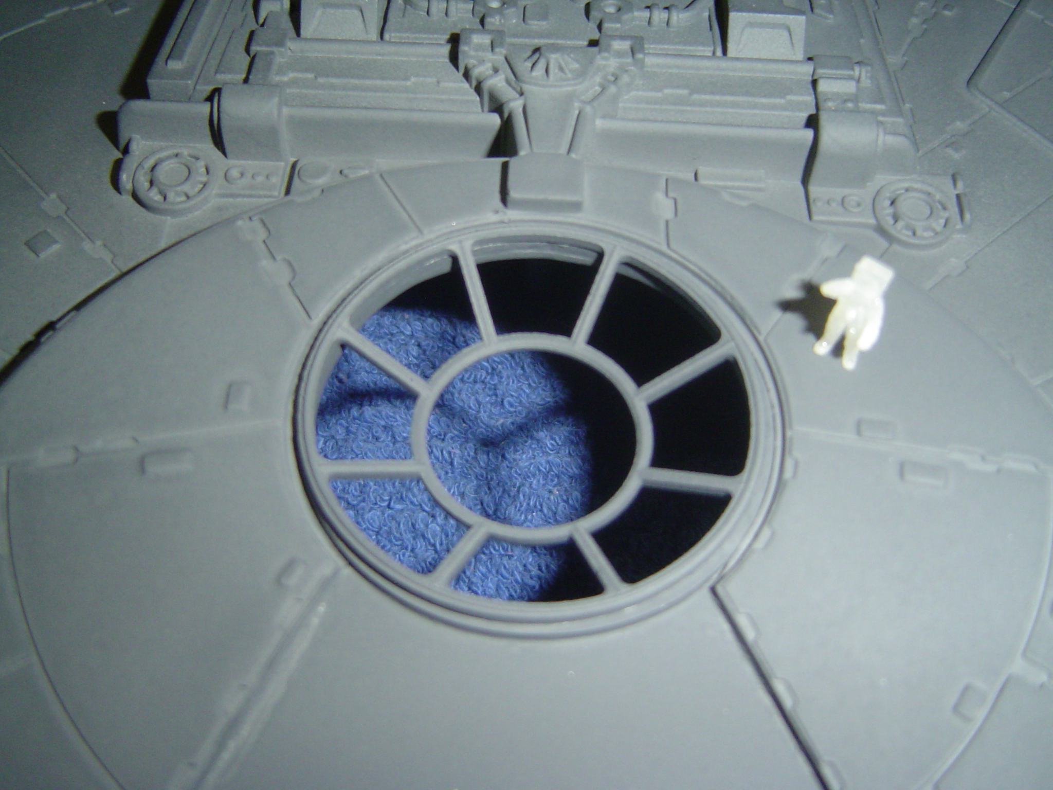

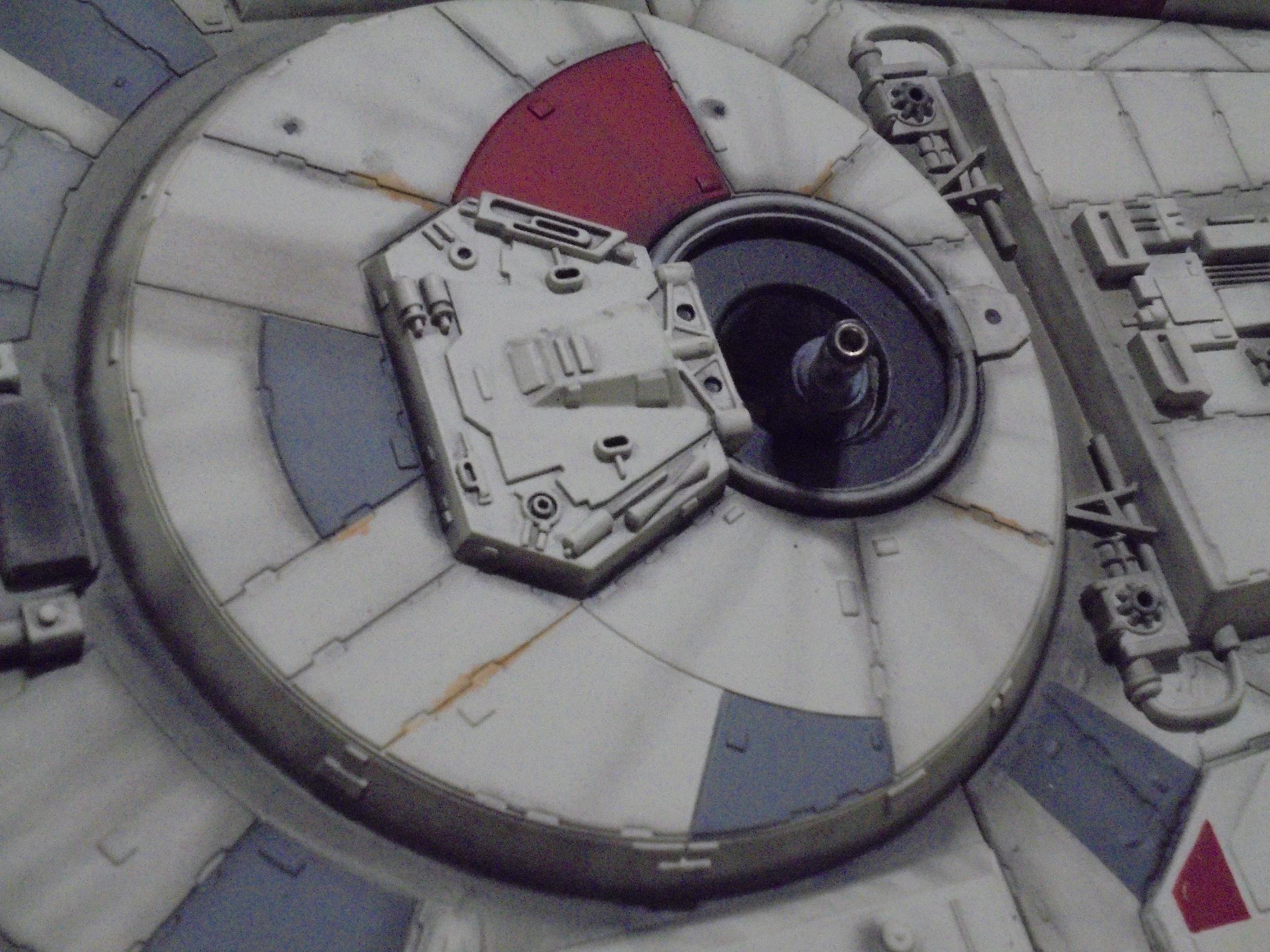

Looking at the mounting point again, one thing struck me, Leyrich - how did you deal with the molded on gun? It's slapped all over part of the hexagonal cannon support, all across the turret window, and spills its horrible, lumpy way across the front curve of the turret as well. As I think they're identical, I was thinking of casting the portion of the top turret needed to replace that area and popping it in on the lower one, but, based on a lack of seams, it doesn't look like you went that route. What was your solution?
I cut them out with a x-acto then teach up with a dremel then I got tow turret window from shapeway . I did not like the Hasbro windows.
Ohhhh.....so the plastic is not as thin as I was worrying at that spot! I was thinking if I cut into it far enough to remove the cannon, I'd have a big hole to fill there on the turret base. Awesome stuff - that looks do-able!

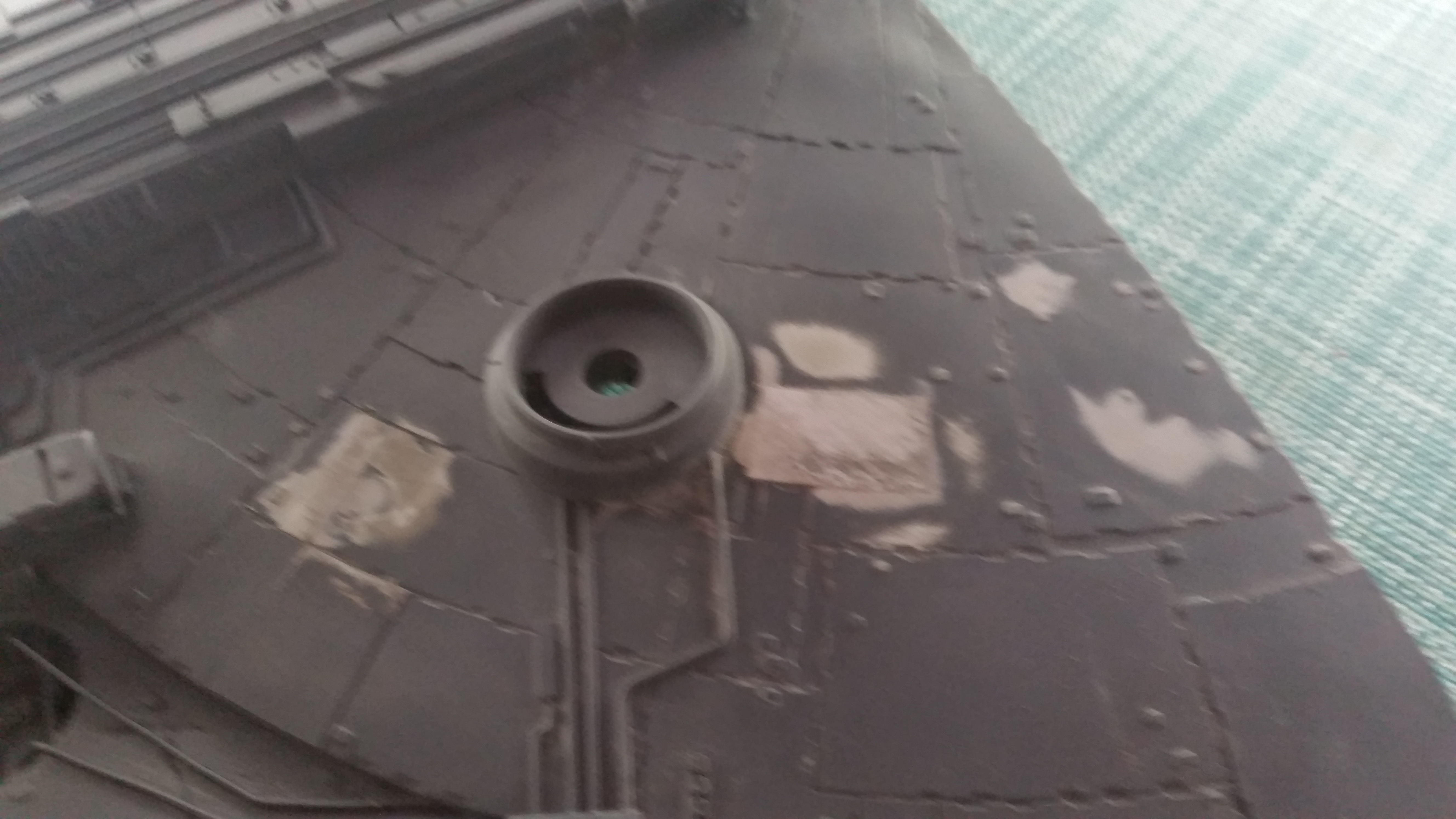

In other parts of the ship, if I never see another notched hull panel again as long as I live, it'll be too soon. I hadn't realized JUST how many notches need to be cut (messily...I keep telling myself I'm sure the 32 incher has some sloppy cuts...somewhere) or how many of the stickers actually represent two plates, or how many represent only parts of larger plates. Those are worse - I have NO idea how I'm going to blend the seam lines between my new panels and the existing detail. Thinking it may require getting the panels on there first, then hitting the whole thing with adhesion promoter, then a tiny bit of Bondo rather than Squadron putty, and hoping that sticks.

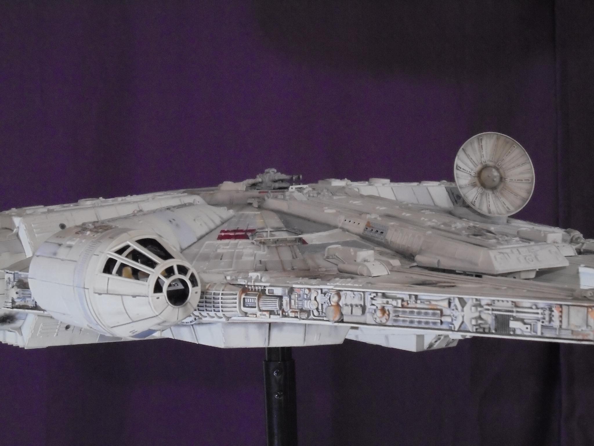

Hey Timmy, the Humbrol model filler sticks beautifully and sands so much easier than bondo. I filled all the needed seams with it. ..20150619_175455.jpg

(And I HATE your in-progress shot - it keeps taunting me, telling me I have to bite the bullet and cut out all the pits)
