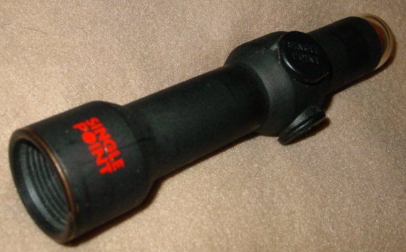

My blaster came in the post yesterday, so I ordered a few bits and piece to mod it with (no 3d printer unfortunately) mainly aluminium in various sizes/shapes.
The thread in the scope is 32mm, I ordered a 1.5mm thick flat mineral glass watch face for it.

AnubisGuard, would it be possible to create an eyepiece part that screws in that secures a lens or faux reticle?
not the same model but you get the idea…
I hate that I have ideas an no skills. Because now I’m thinking with the working trigger an the free space, this thing could have lights and sounds as long as you can live with exposed screw holes to change out batteries.
@AnubisGuard, would it be possible to create an eyepiece part that screws in that secures a lens or faux reticle?
No reason it wouldn't work, though I'd need to know the thickness of the lens piece being held in; I get the sense this varies depending on what people are sourcing?
An all-in-one (i.e an insert w/ the "lens" built in) would be more practical, imo.

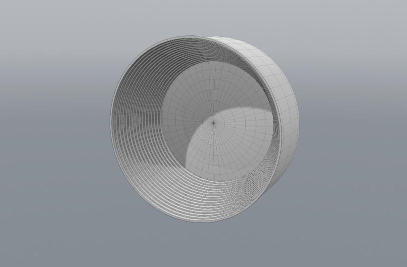

Here's a basic version of the all-in-one idea I dashed off before work. No threading, it just drops in. I imagine the lens will need to be separated out for ease of printing and finishing.
The all in one would be a hassle free solution for someone who wants a quick and easy way to not see the inside of the plastic scope.

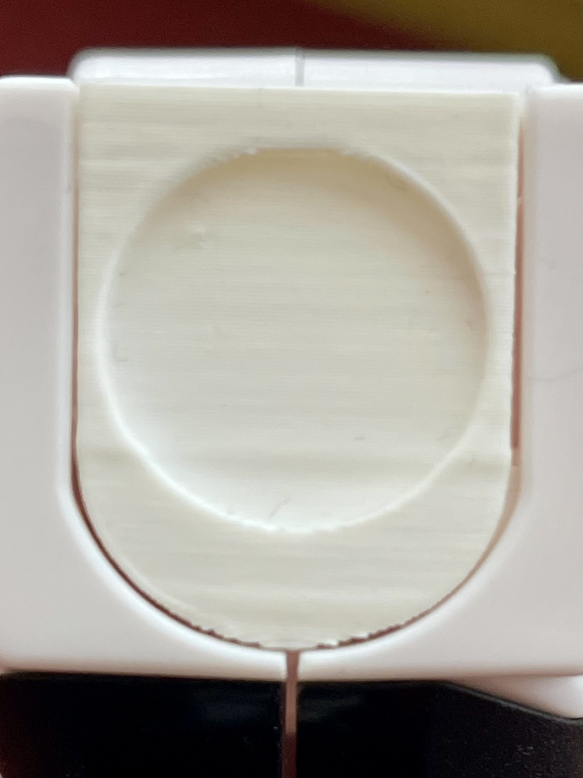

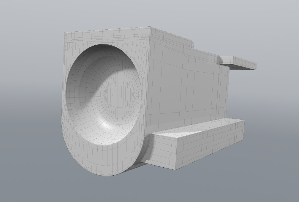

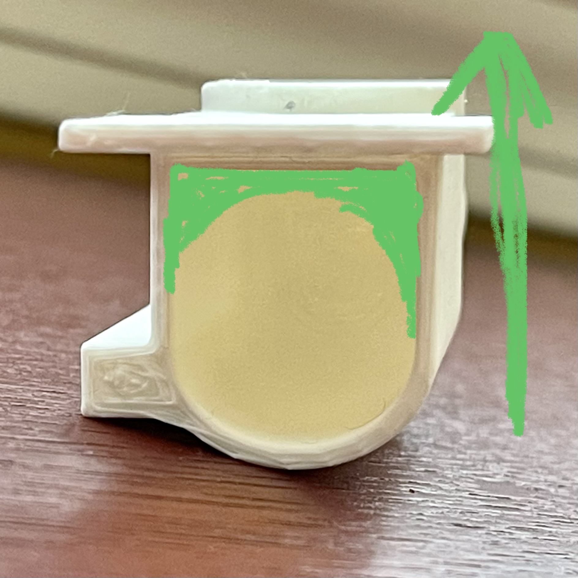

I think I did a poor job in describing the changes. This is what I was asking for…
I was wanting the roof of the inside space to be rounded at the top try to prevent or to minimize the support inside because I wanted to print in this orientation so the exposed top gets a nice smooth surface.

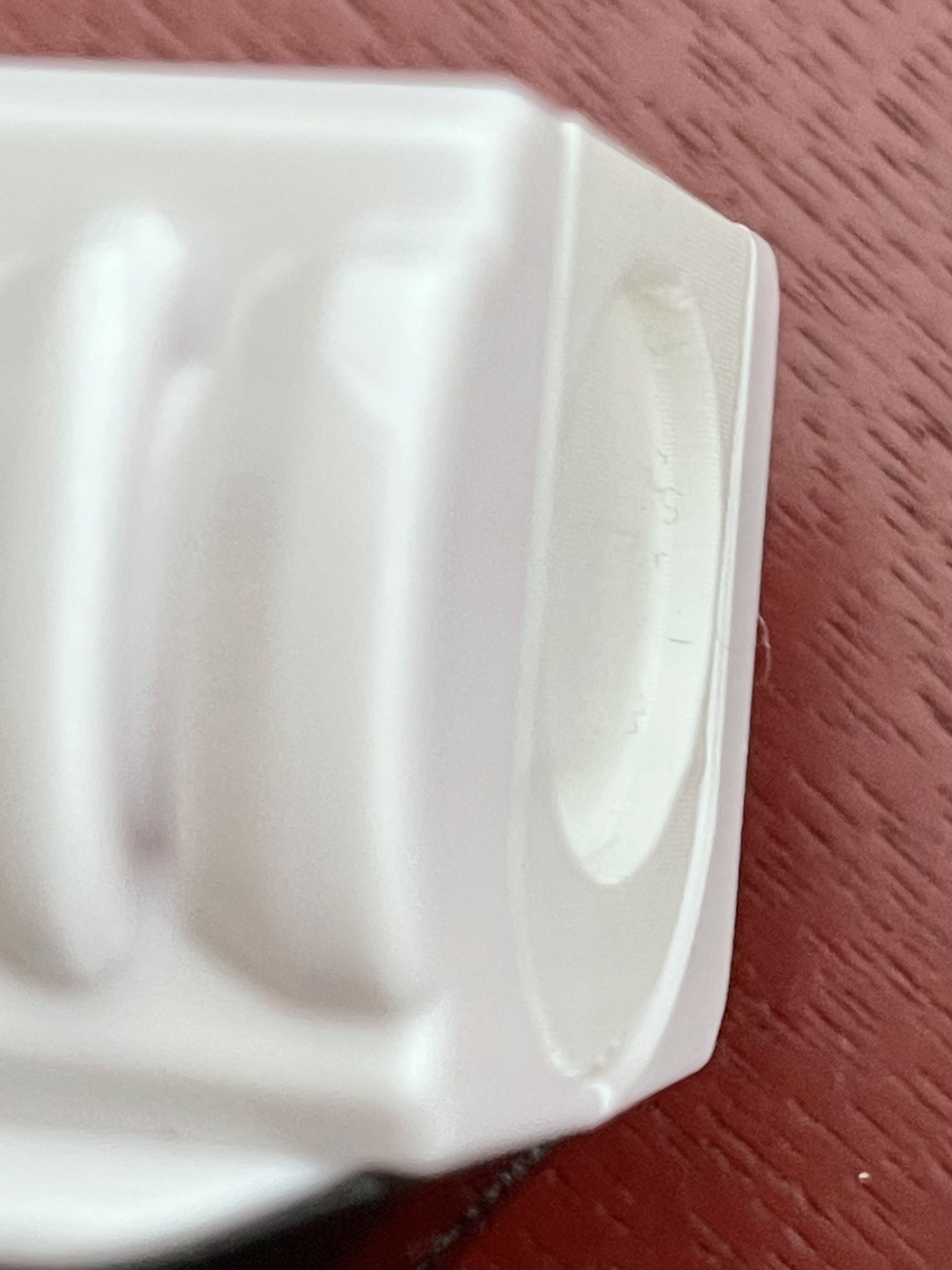

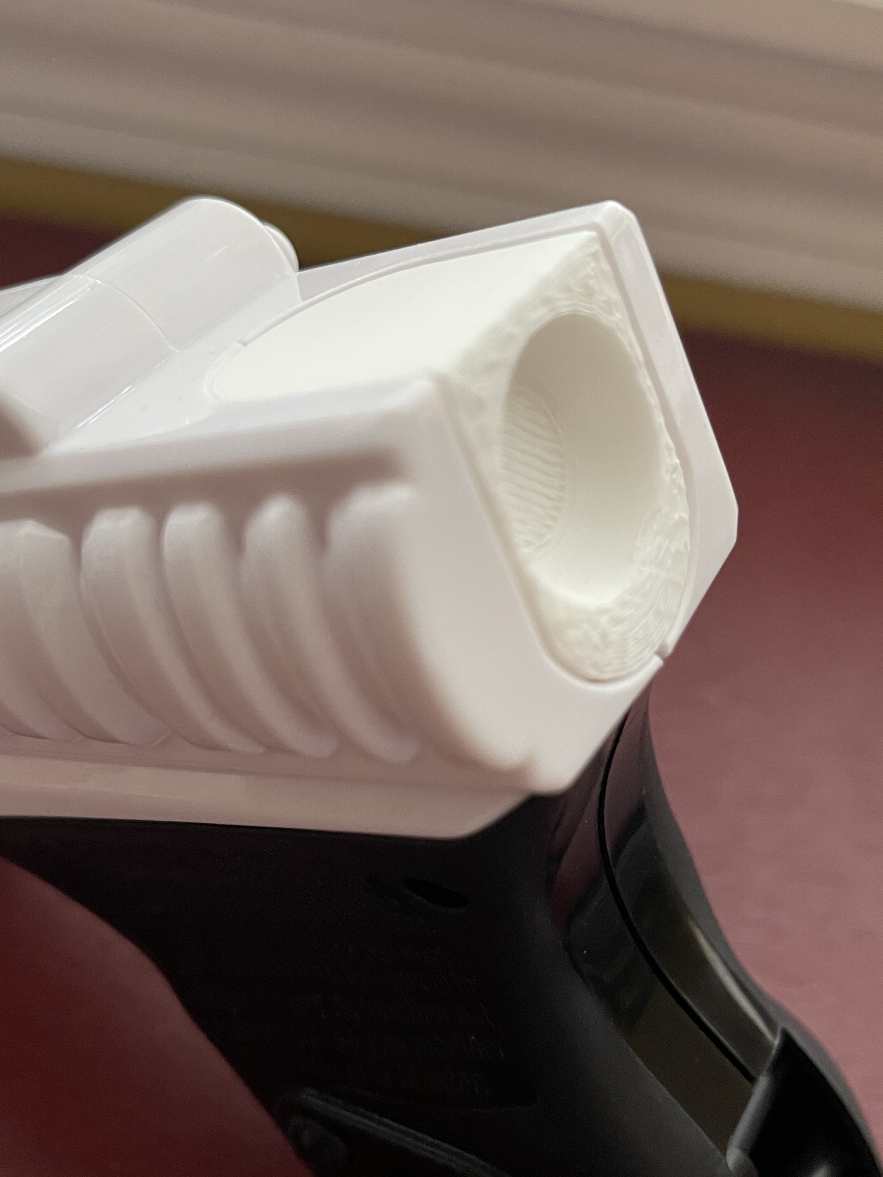

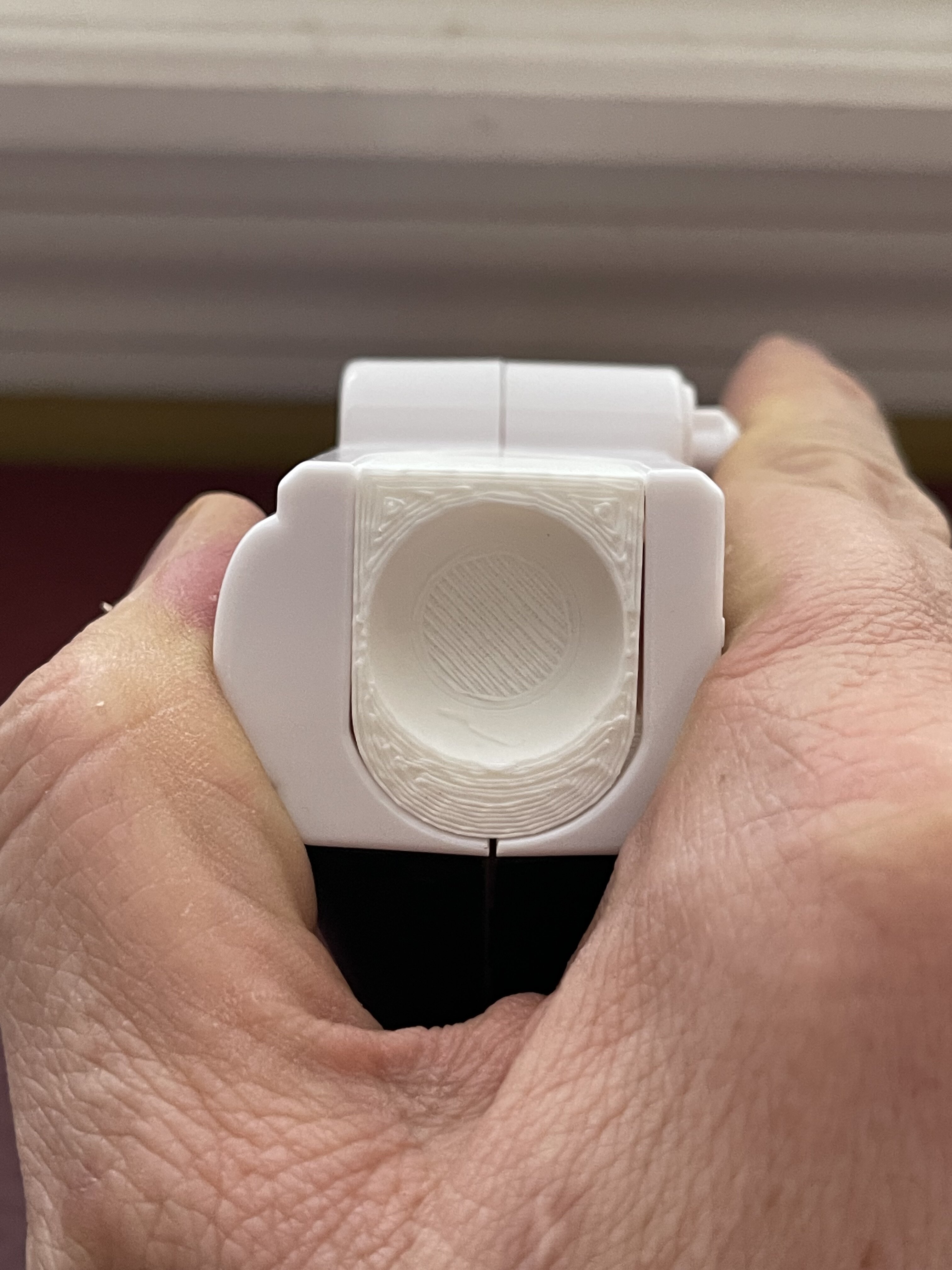

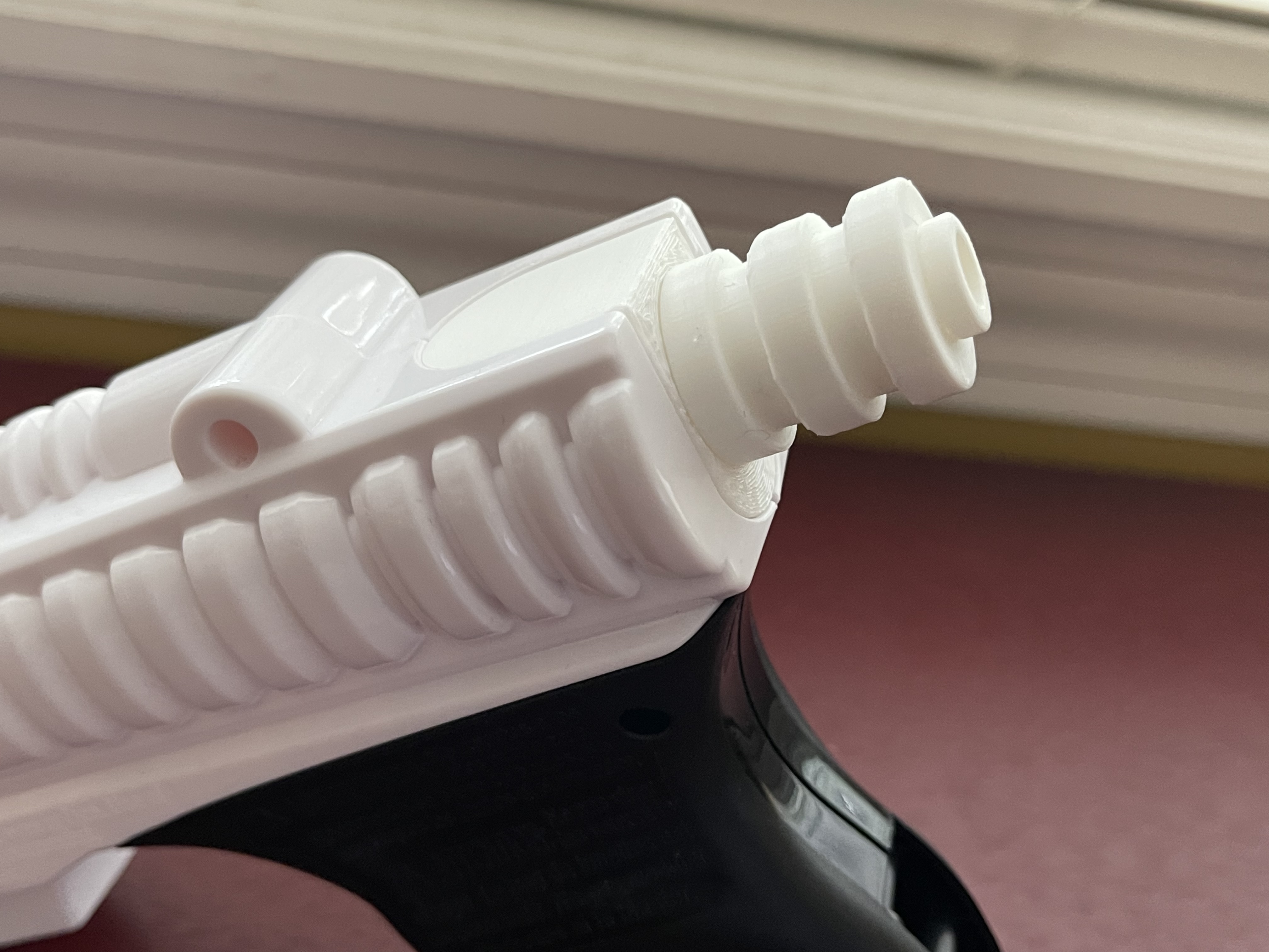

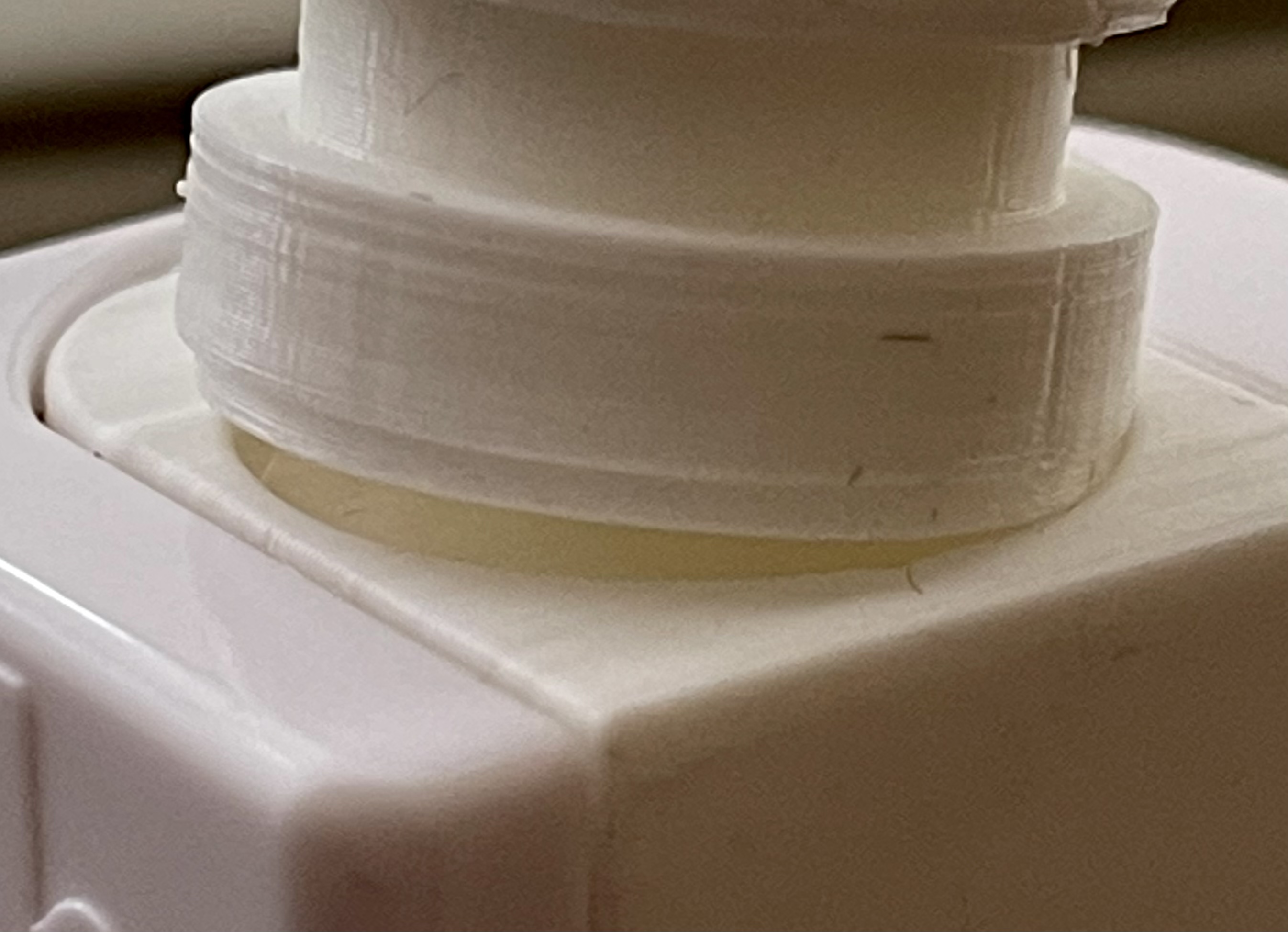

Here is the updated print of the plunger. There is still something inside (the supports that is keeping the two halves from coming together.
I did not print the cap since even the the hole is deeper, the old one still fit.
