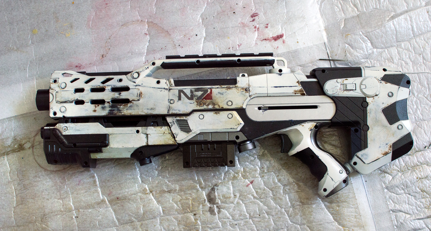

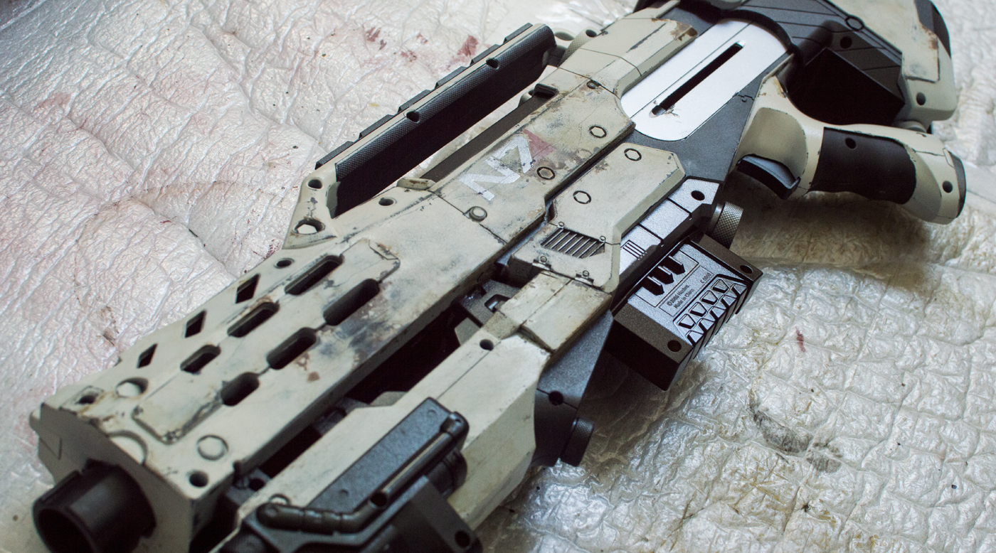

Awesome thread! Here's one I repainted summer of last year (also in an N7 theme like a few here).

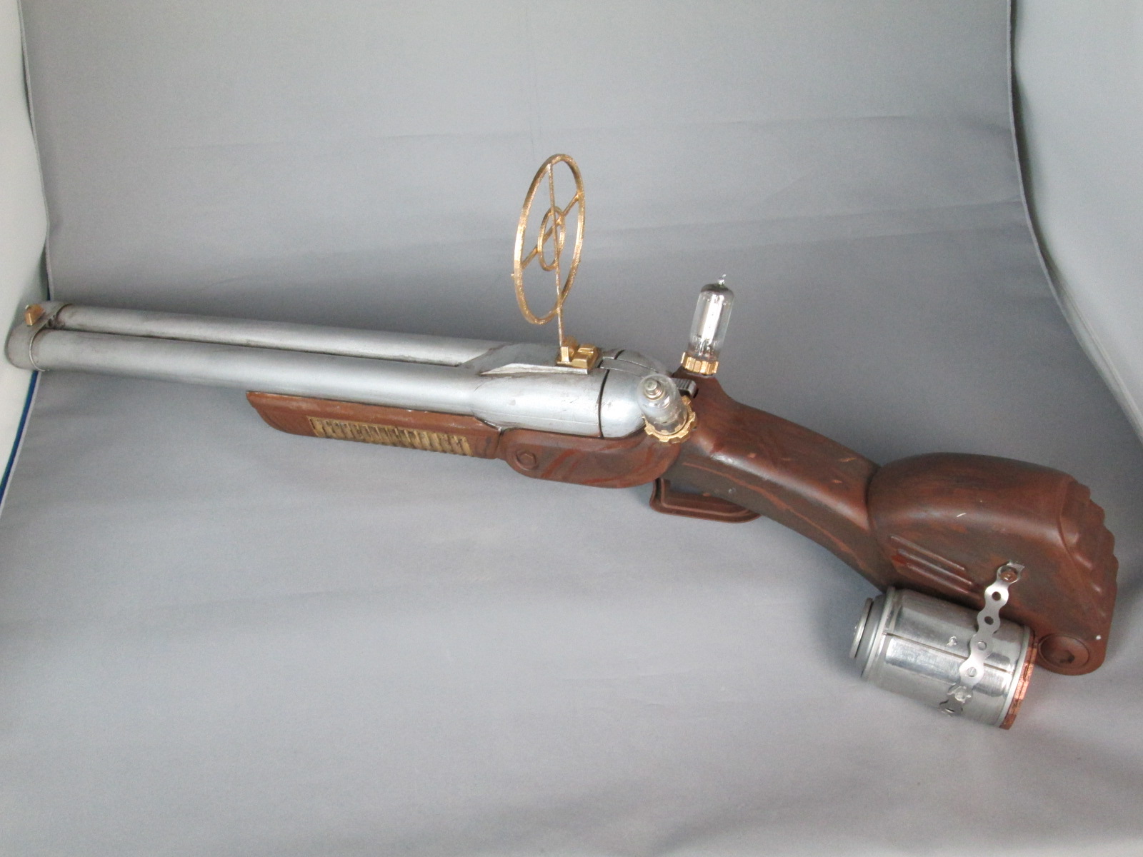

First steampunk style nerf gun, used the nerf longstrike as a base. I removed the barrel and stock to give it a shortened look.
