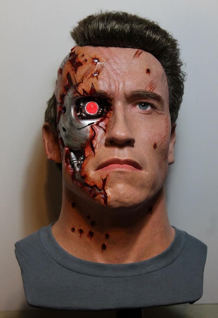

Hi all , I have one of Joes busts being built as we speak and I want to buy a manniquin and do a full statue . I think the bust is called a T2 stage 5 battle damaged ? Sorry as I'm not to good at the terminator terminology yet lol.
Anyways I was hoping in the future that Joe builds and offers a leg joint area and chest plate for sale , and I was debating to buy one of those endo arms you see for sale on eBay that I think they copied off of HCG .
The battle damaged arm is the left arm I believe in the movie and his right arm is still intact , but the re pop is the right arm , at least I think it is?
I'm wondering if I removed the hand and made it look damaged (rods only) if it would matter which side it was on the statue?
Or just leave the Endo arm intact and use it on the right side as the face is damaged on the right side also.Just add some blood to it etc .
Also I'm not liking the leather pants and would prefer to use the brown pants . I'm liking how the knee area is exposed but I'm not sure how it would turn out with torn pants as opposed to the leather ones that I think is correct .
Any opinions on how you guys would proceed and have it look would be much appreciated.
This is the bust I will be using
Nice work. I'd happily add that to my collection.
I think doing a full statue would be killer , just not sure how much battle damage I want to do on the statue . Was thinking that seeing as the right Endo forearm /arm is available , that I could do the Endo arm exposed and have the other hand with a black glove on it with no damage holding a gun . It wouldnt be screen accurate as the damaged exposed Endo arm is pretty messed up in the movie wih no fingers and its the left arm , and my only choice is to do the right arm in an Endo skeloton . I could remove the hand and have just the broken rods coming out of the jacket and that way I could swap it to the left arm of I had to , but I think it would be cool seeing the hand ?

Nice bust!. Leave it as is. ...Display the bust next to a 1/4 or 1/3 scale Terminator statue :p
I agree. If this was mine, I would display it as just the bust.
