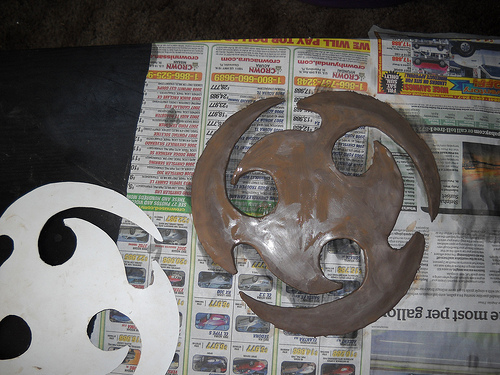

After several unsuccessful attempts, I finally have a basic clay shape that I like:
I cut out a template from posterboard and used that to keep checking the shape. It's about 10.5 inches across.
I'm using air-dry clay. I didn't want to use sculpy or anything that stays soft because it's a thin flat shape and I didn't want it constantly warping as I work on it. So once it's bone dry, I'll start building up the center parts.
Arrrggghhhh, my first hard-learned lesson---using air-drying clay for thin flat shapes is, uh, not a good idea. Large cracks have appeared all over the place as it dries. If pieces end up breaking off completely, I'll have to superglue them back on or something. :(
I'm thinking my best option now is to let the piece finish drying, then fill in the cracks, let that dry, and then coat the whole thing with some mixed resin to strengthen it and hold it together.
Or is there a better option that I don't know about . . . ?
