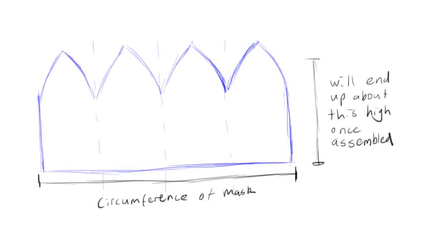

im certainly no expert! but I have seen people make helmets from foam by dividing it into 4 pieces so they can shape them seperately, then glue them together.
so like this picture
but stick with glue rather then tape. So the foam parts were shaped to create the curves at the top

The pic icedjemz posted would be a good idea for the frame.
I make most of my stuff from foam (can link to threads if you want to see how I do it) but the basic premise is make anything structural out of 10mm EVA foam, add detail in carved upholstery foam and cover with latex or fabric. The pattern you're after to make the sort of tube+dome shape is kinda like this:
The easiest way to get the best pattern and fit is to make a mockup out of paper, preferably full scale so you can check the fit (though half scale is good for getting the trickier parts of masks patterned out) and adjust that until you're happy - the advantage being you can add or take away paper just using scissors and sticky tape. Flatten the pattern once you're happy with it, trace it on the EVA and cut. I'd personally do the beak in EVA as well, adding the detail with a dremel and soldering iron. The other parts I'd carve some upholstery foam with scissors and glue that on, I've found it's the best way to keep the details flexible, cheap and very easy to correct/redo if things go wrong.
