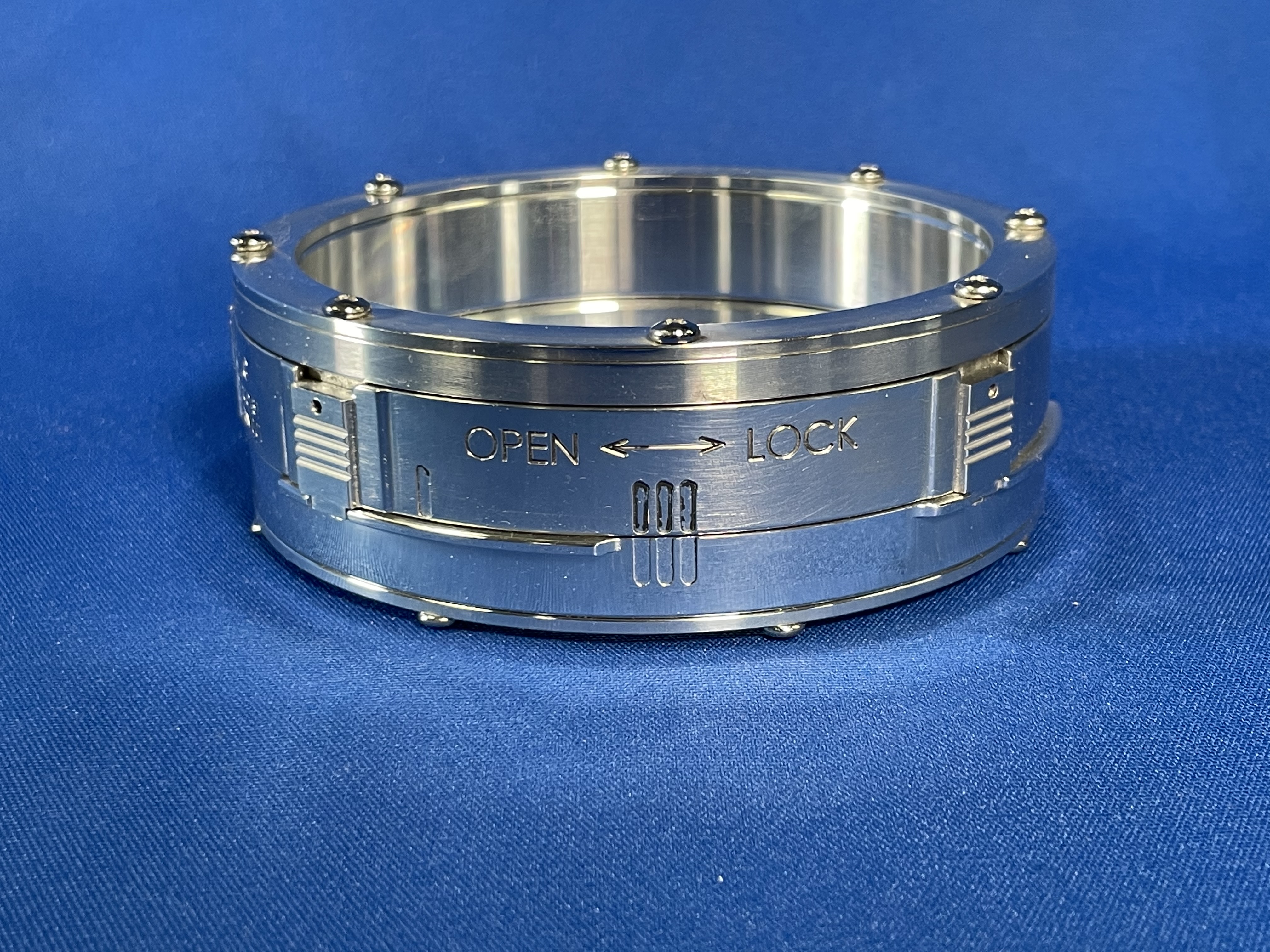

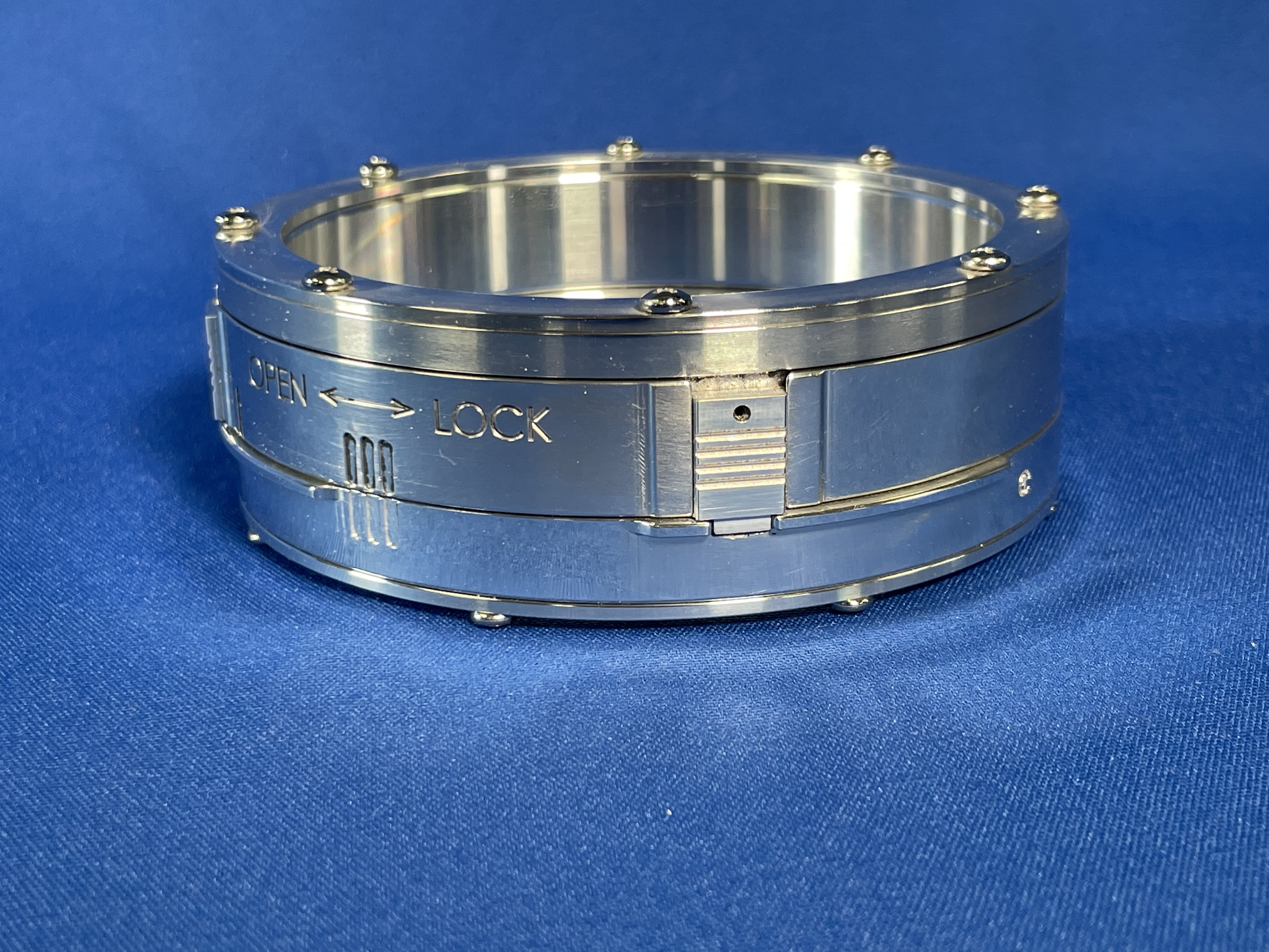

Just thought I'd share some of the machined aluminum spacesuit hardware replicas we have produced for various film projects.

Here are a few other fittings I have been working on.
This is the work in progress of the A7LB / EMU Glove disconnects. This is my clear 3D print on a real A7Lb lest suit side disconnect, and in the background is the EMU glove side.
I have also been working on Apollo gas connectors, also modelled directly from real fittings.
ACES glove disconnects have also been produced. (Currently not anodized)
These too were created using a real fitting. They have the same function as the real fitting, but with no pressure sealing capabilities.

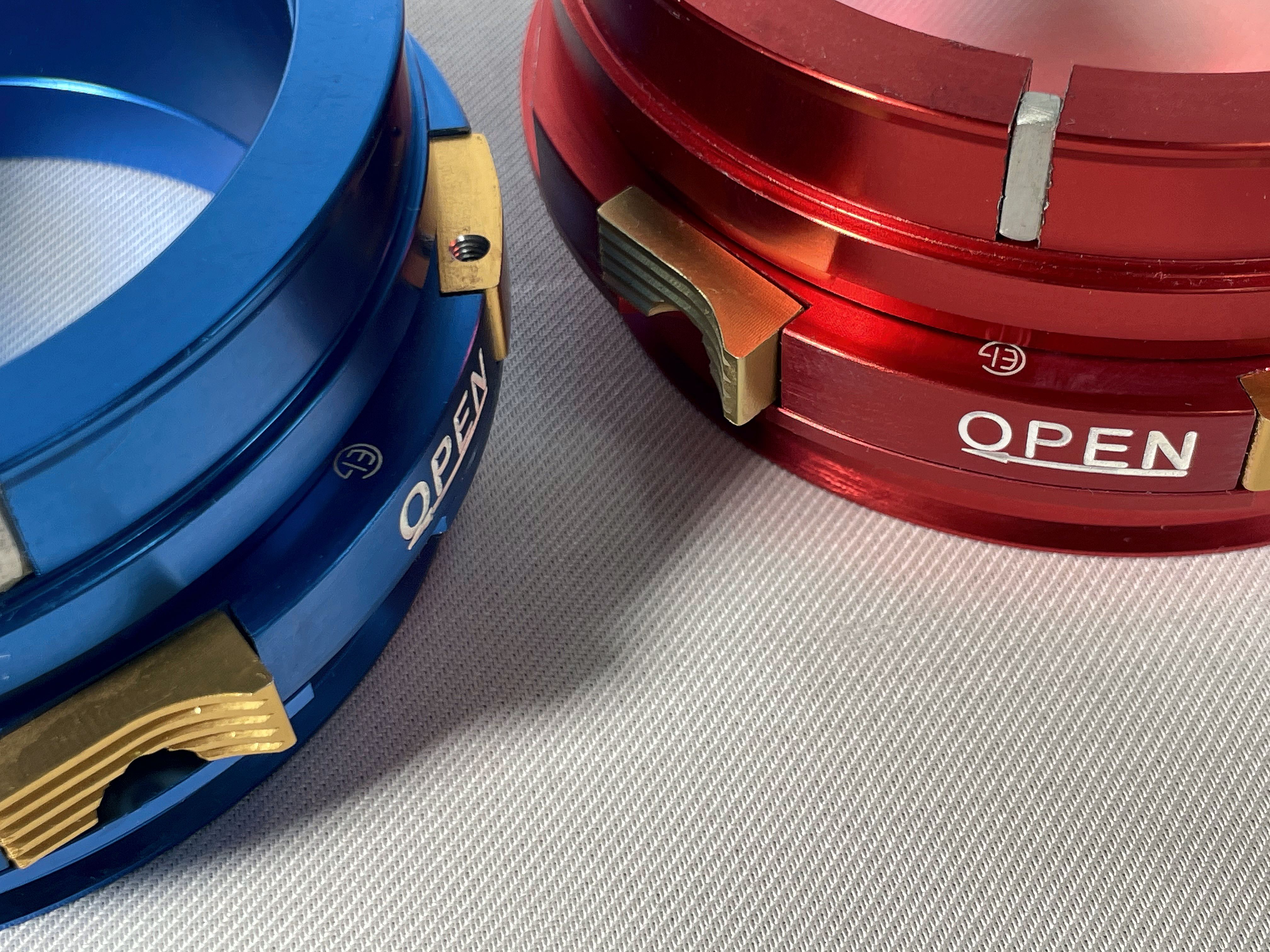

Thanks. We eventually got the ACES glove disconnect into production, but ended up redrawing the ring in order for it to fit a real ring The client had the one side but needed the other side to replace the missing elements, so it needed to fit a real ring.
Here is the set we produced, anodized in special colors.

They both have "OPEN <-> LOCK" engraved.
Shouldn't the one on the right have "LOCK <-> OPEN" engraved?
These look great!
Yes......:rolleyes:
I intentionally made small differences, so they wouldn't seal or couldn't be passed off as real fittings, but this was a mistake. I mirrored the parts and forgot to reverse the Lock - Open
