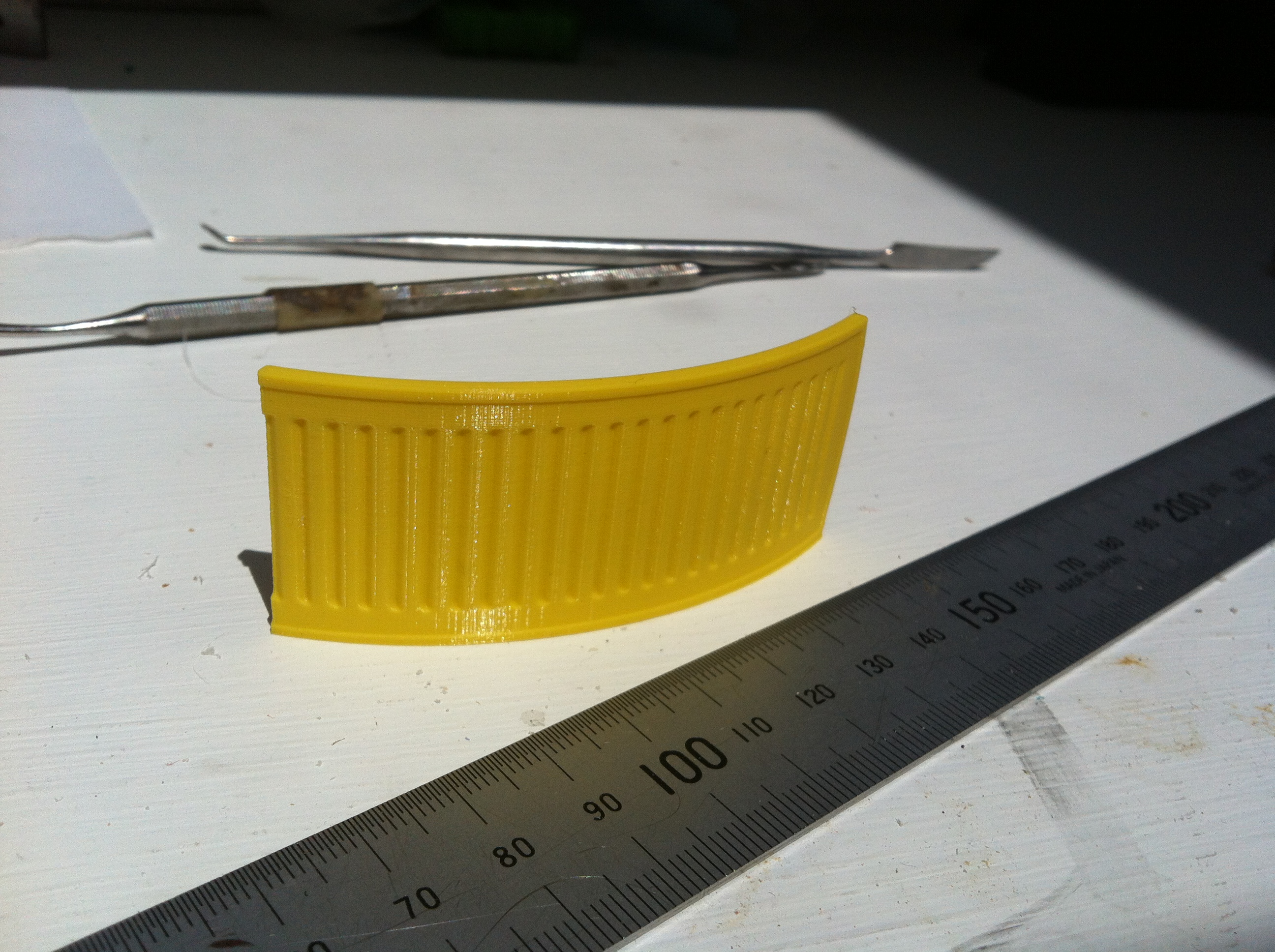

3mm filament is 2.85 . I had the same problem when I started till I found out you just order 3mm. there is a E bay PTFE tube the convert the Ultimake to run on 1.75mm Filament that people have had great success with but as it works out of the box perfectly well with the 3mm (2.85) theres no need. IMG_0825.JPG this is a part I've just printed at standard settings. it took an hour. larger part I print a fast setting because I know its easy to topstop fill and sant if you don't need super detail. This is a part of my 6th scale spinner project you can find here on the site.
