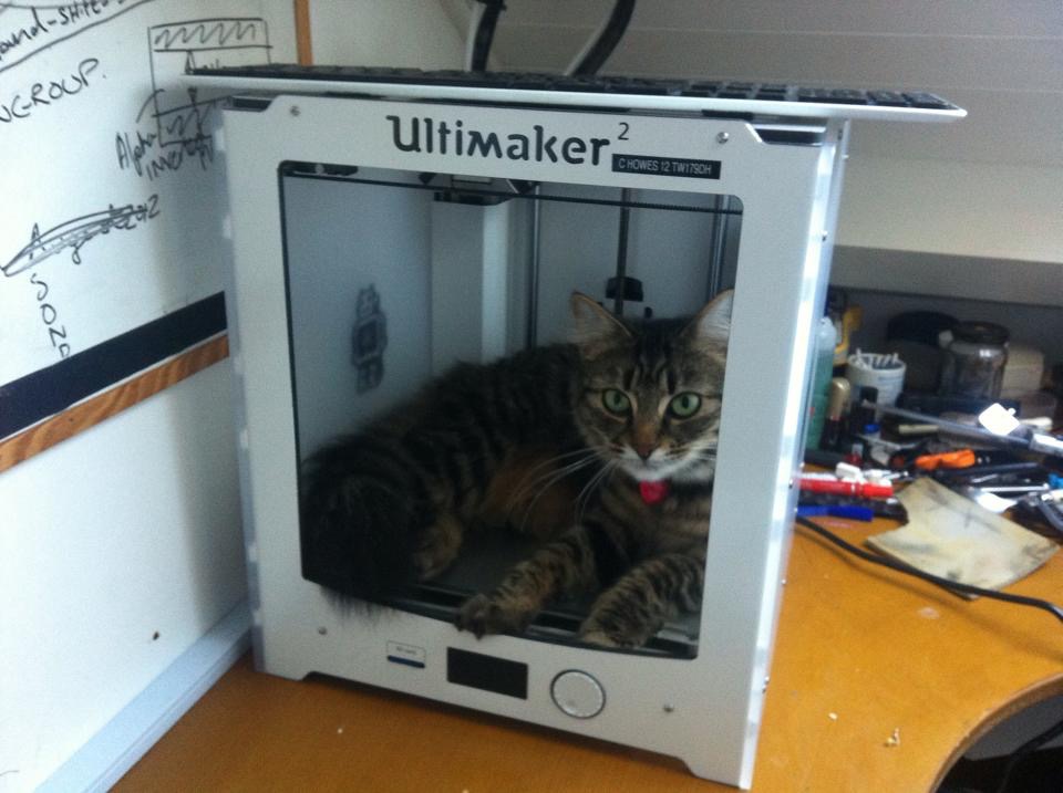

    IMG_0054.JPG the one problem I ever had with my Ultimaker 2 was finding hair on the build plane one day. never found out why ?
    Teddyboy16, swgeek, Bogleo and 2 others like this.

    :lol hehehe
