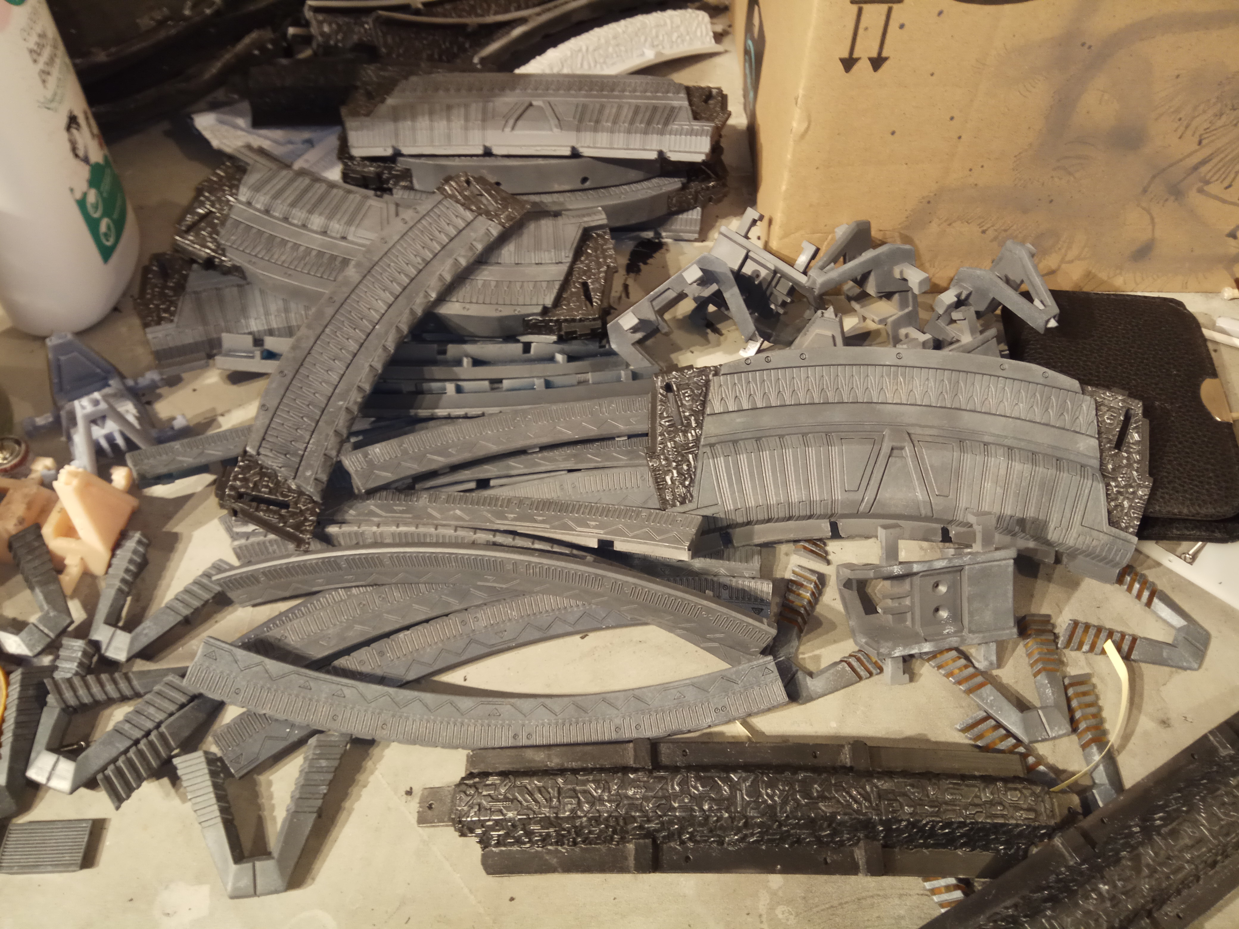

So just primed everything up about to assemble.......... ANNNND some how I still have a few bubbles in the square detail corners :/ not as many but some :/
And to top it all off............... my resin parts have all shrunk by about 5% *cries* so while yes I can still hack this together. Nothing meets up perfectly.

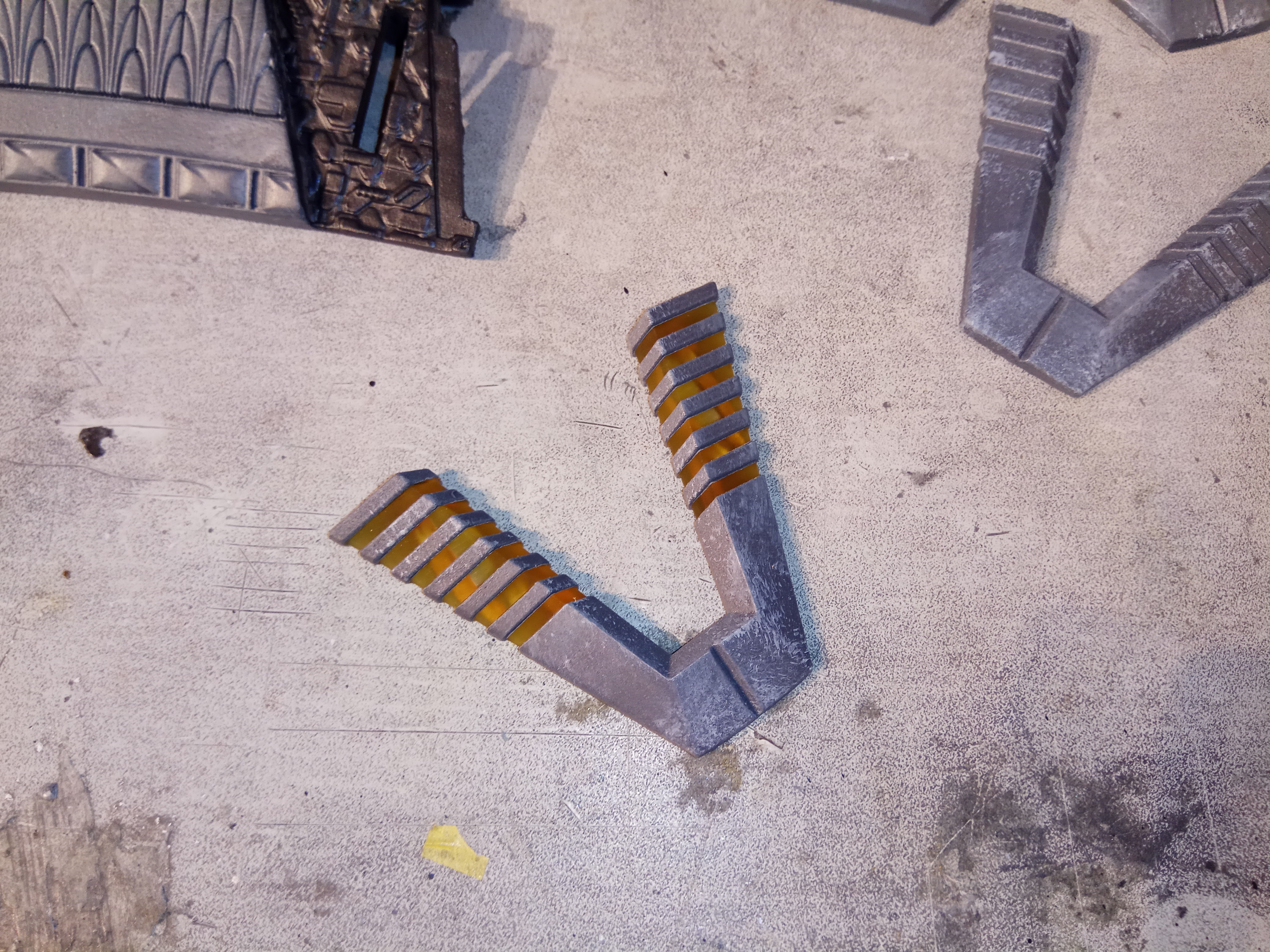

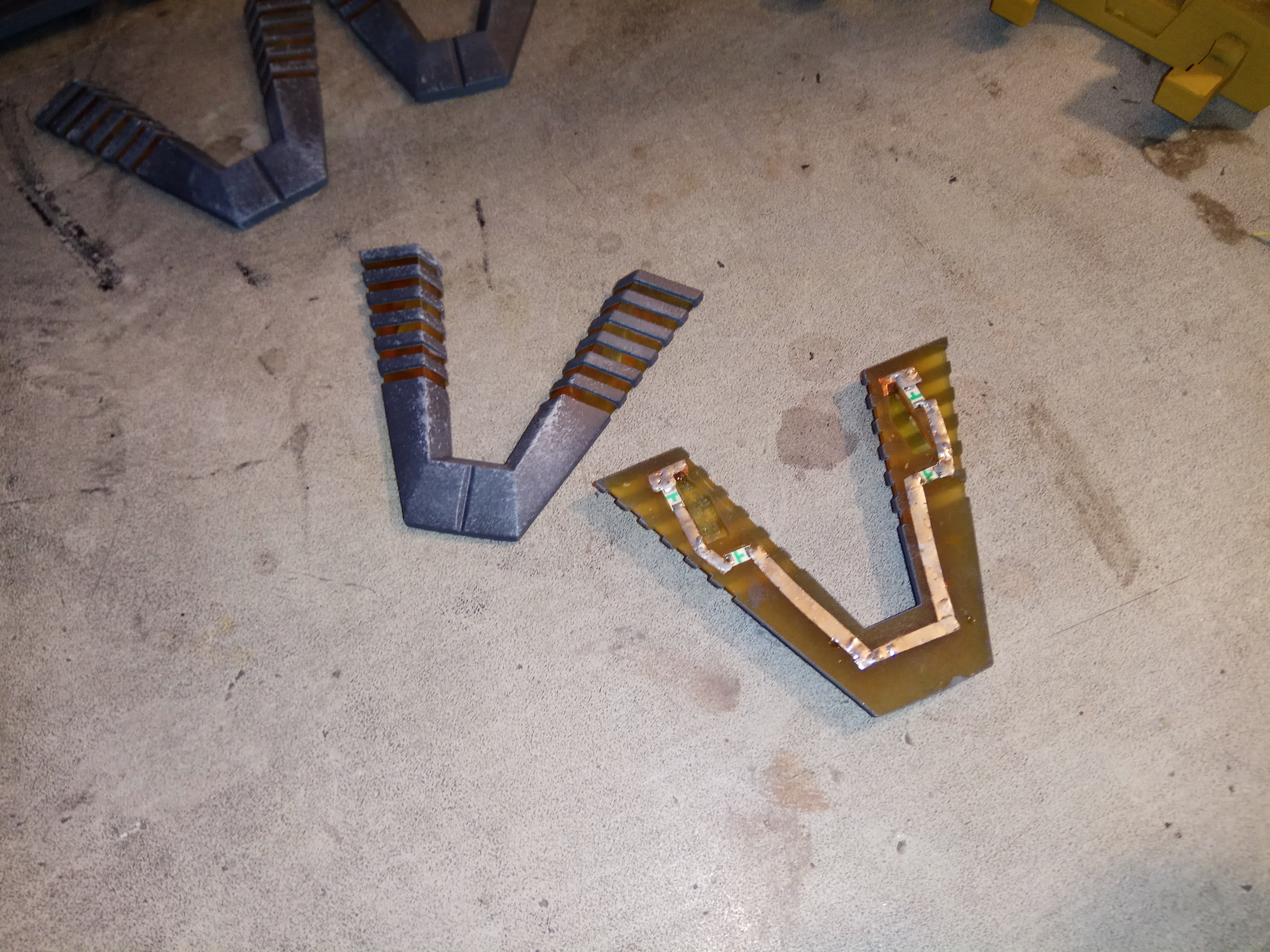

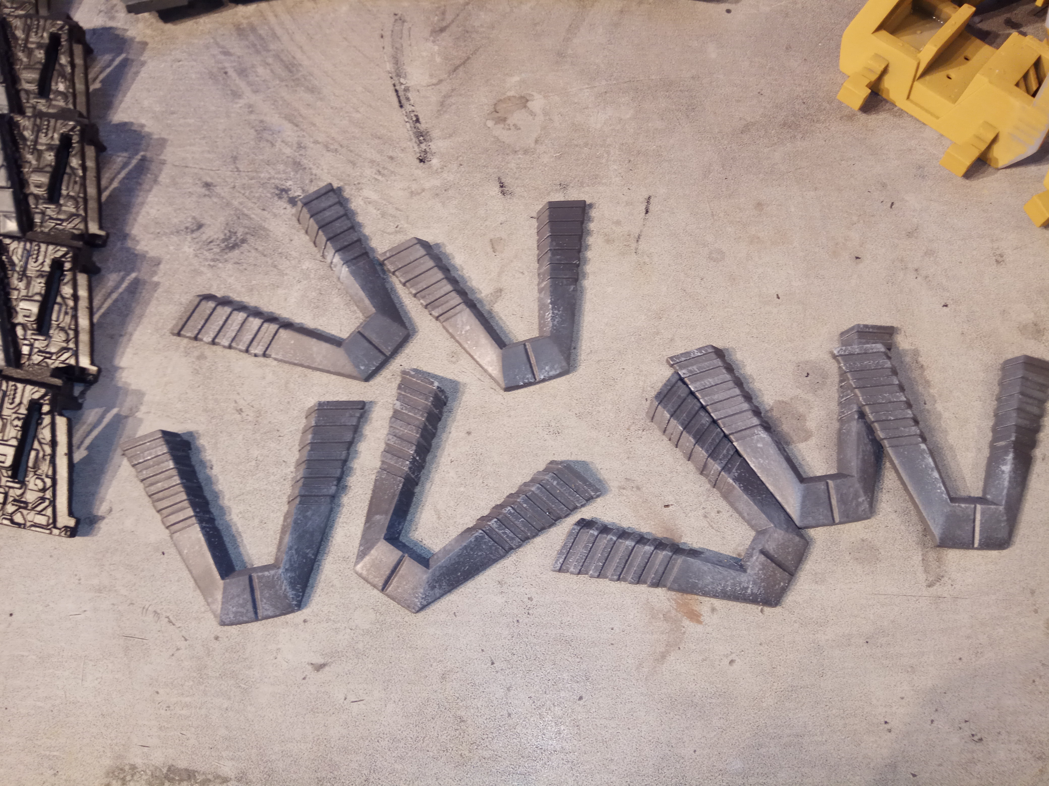

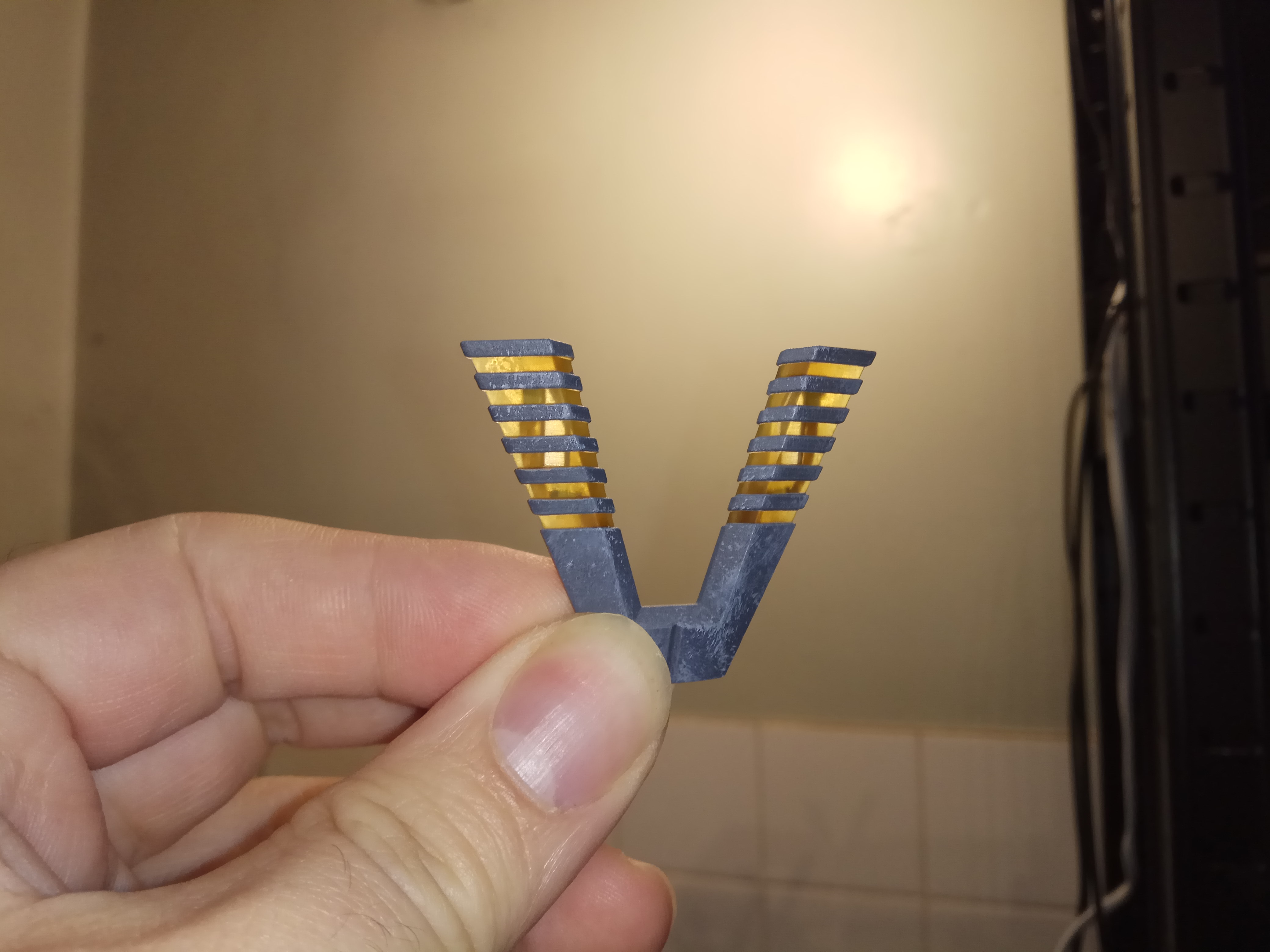

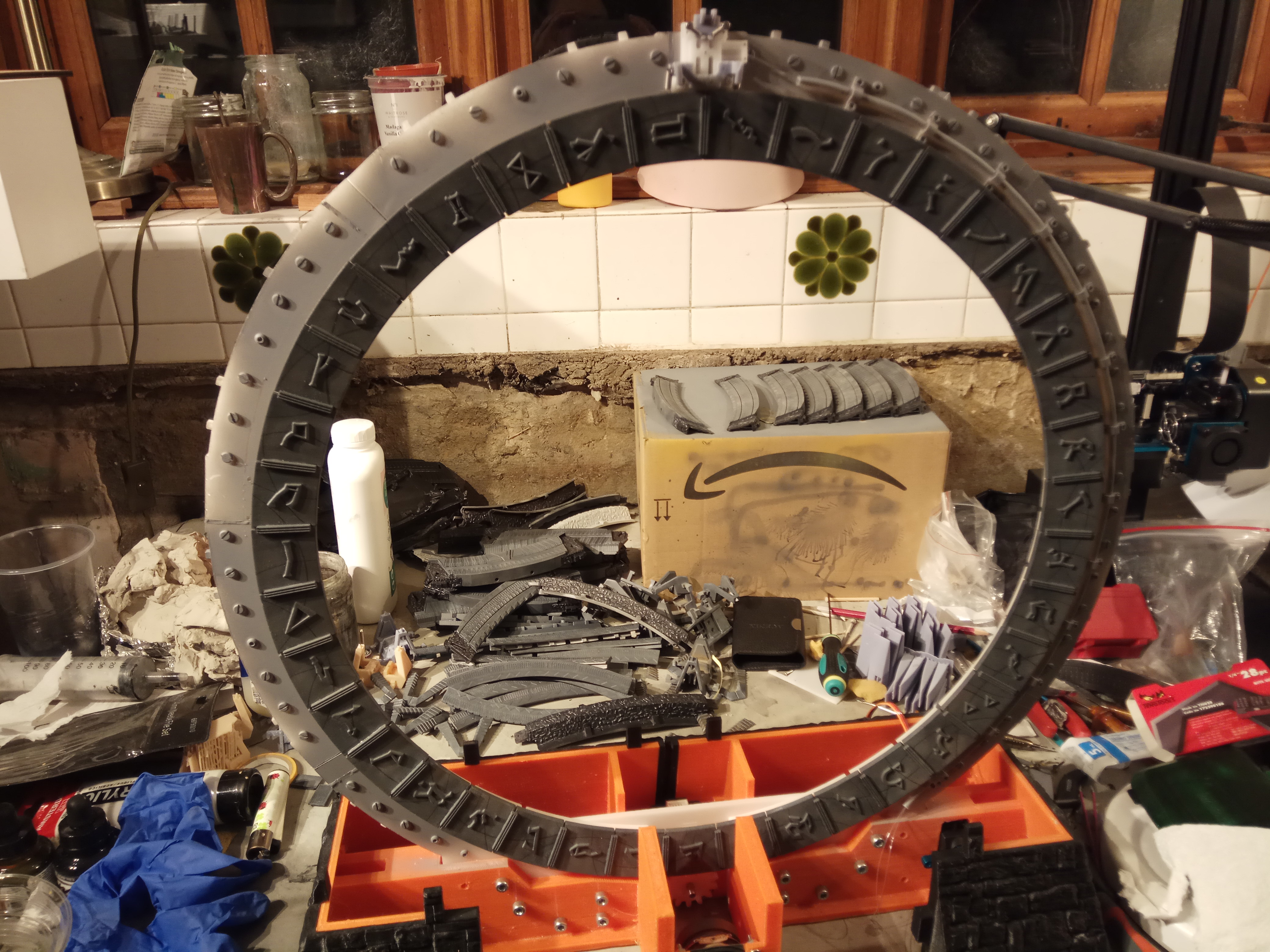

Though I did take all the masking off my parts, and its looking pretty :D
Though Some of the bubbles in the corners of the squarish bits, im not sure how to hide them yet... Will see, but at this point I REALLY CBA to try and do more casts and try them again.
Anyway heres some pics.
I still need to prime and paint some other parts too and need to print the "wings" that go by the chevrons... But nearly there......

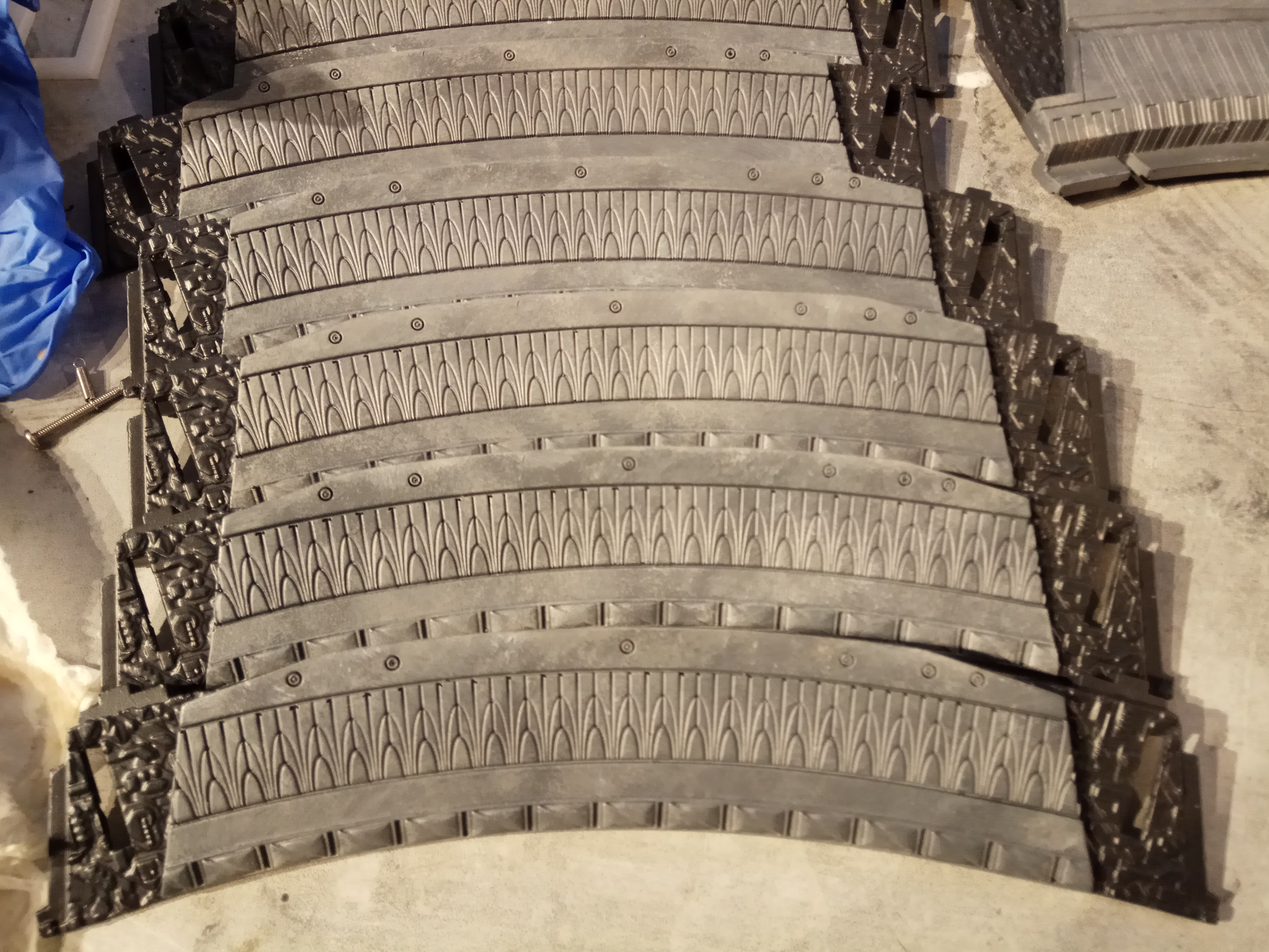

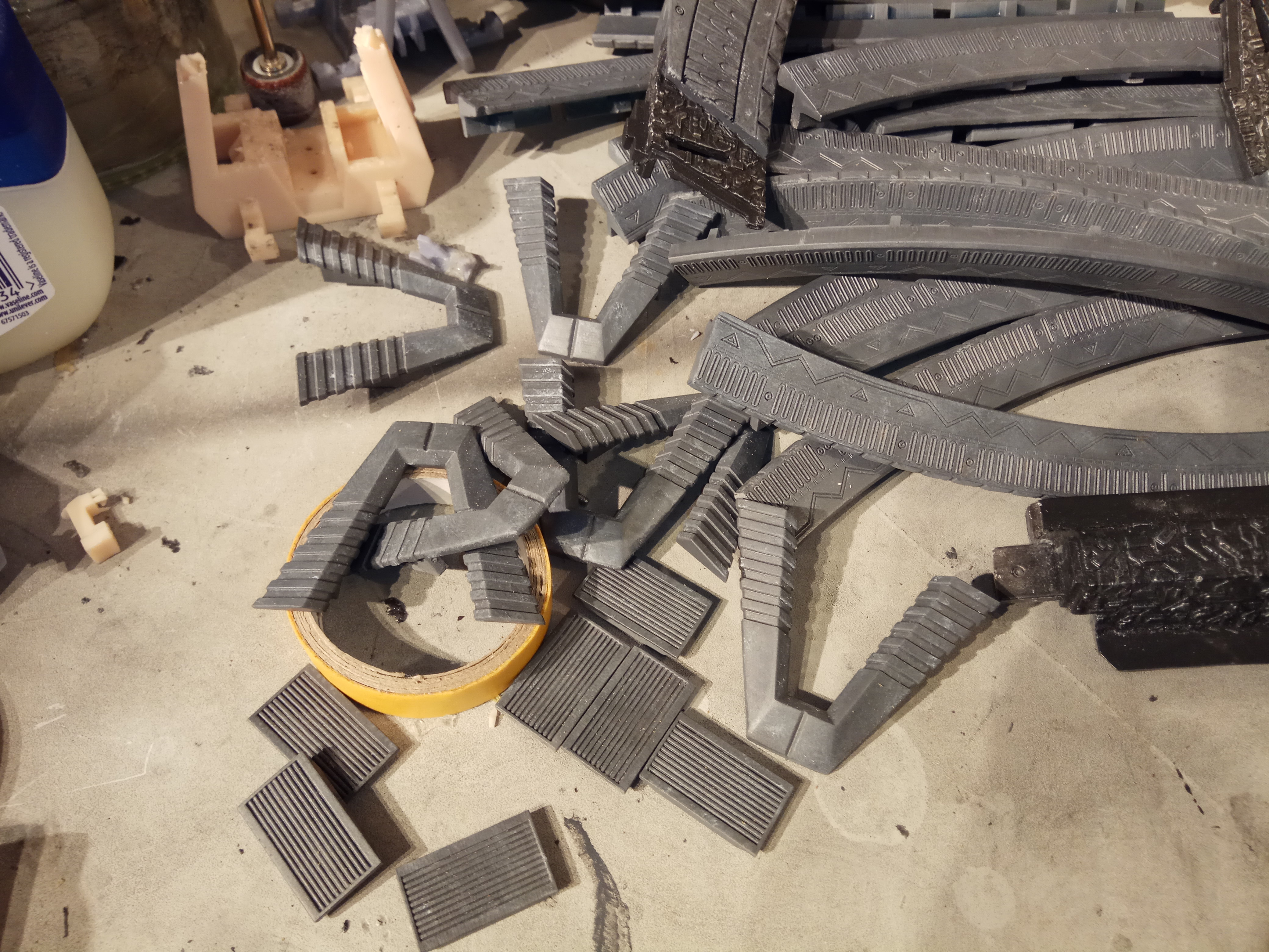

The simple fact of the matter is, after spending the last few months on and off printing, silicon moulding casting duplicates, scrapping them and making NEW silicon moulds and casting more duplicates, and then painting them.... And today prepping to assemble and fit it all.........
Ive discovered every single resin piece is imperfect, warped and shrunk. At first glaces they looked ok but when trying to fit it all together. NOTHING fits. And its not as simple as just filing back some key points... Some major areas like the inner ring frame clamp down onto the dialing ring making it impossible for the ring to rotate.
The chevron frame housing does not meet up with the gate facades at all leaving gaps.
Simply put NOTHING fits. And I thought I gave the designs wide enough tolerances.
But as I say theyve also warped some what in thin areas. Such as the main face facades, where the grey part meets the greebly wing... This has bowed out slightly and no longer fits under the chevron frame.
Ill be honest, this is difficult for me to explain and deal with. As it frankly hurts putting so much effort into this and failing not because the design is bad, but my creation of the parts was bad. Or the resin not behaving as it should... So much for low shrinkage resin :/
