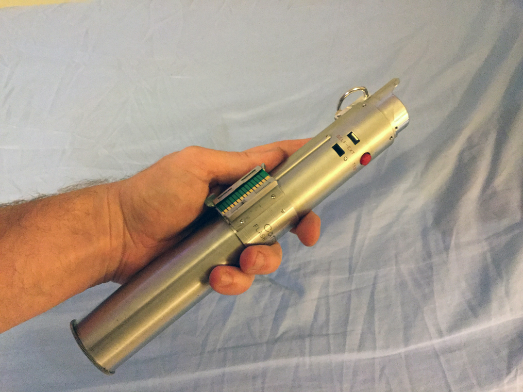

My 'Vintage Found-Parts' Lightsaber: Opinions wanted!
I guess It's a Model X according to @AnubisGuard - I haven't a clue - it was just sitting in a pile of Junk at a flea Market and I went "THAT!" I've been on the hunt for one of these since I was a kid and it finally paid off.
You might be able to just buy the bottom of an old graflex to extend it right
Haha nice! Wish I had the same luck at the antique & second hand fairs I go too!
It should say by the way, on the clamp section unless it's tarnished off, Canon Model "?" - Made in Japan usually.
I thought about that, but the Graflex has a different kind of connector, kind of like a Bayonet-Plug light bulb. There is another Canon Flash Handle on eBay, entitled "Canon Model B", which looks like it has an 2-cell extension tube, thinking of buying it too, just worried that it might make mine too long haha.
Really looks like brass, IMO. Steel would be hard to cut and you can't plate aluminum. The fact that there's visible brassy pitting seals it as far as I'm concerned.
I think you might be right there, looking at the pictures again it definitely seems to have a brassy colour showing through, at first I thought it looked like rust, but if it was easy to cut like Mooniteman said, then it could only be Brass or Aluminium, and the latter doesn't tarnish like that and can't be plated either like you said.
It looks like we had a lot of the same ideas btw! The "Emitter shroud" (top piece thingy) that you take off the actual flash hood bowl....thing. No way to describe that. And then the inside emitter (you put springs on your though) I really like that piece! It looks great! The actual guts of the flash and pieces it come with are really great for Frankensteining something together! Awesome to see another build from that same piece!
Yes, it's really enjoyable to see your take on cobbling a saber from most of the same parts! Pretty neat how different personalities will shine through even given the same starting point. I really like where your saber is at now after the latest additions. Congrats!

I blame this thread for putting the bug in me. I just dropped some dough on the 'Bay so that I might make a few of these vintage flash-sabers!:lol
That was fun. It just needs grips and then I think I'l call it done.
I'm not 100% happy with the chrome donut inside the emitter, but I only thought of a better idea after all the epoxy had set and everything had been drilled and riveted together.
The finish on the Canon body and the Heiland flash I used for the bottom don't match perfectly, but it's pretty close. Overall I'm happy with it.

Mine just came in the post today. Interestingly enough, the top part of mine is larger in diameter than both of yours and does not fit into the handle as you can see...
In every other respect it looks exactly like yours Anubis.
One question though, how did you manage to separate the metal part below from the plastic? I've undone the screws, but it just won't come apart.
Wow! Love your custom saber. It looks sooo original trilogy. All the attention to detail is fabulous. I would love to have this in my collection. Thanks for sharing.
Once both screws were removed, it slipped right off. There might be glue under yours. I'd suggest applying heat to soften it up.
Will give it a try thanks! Now I just wonder why the bit that connects to the Flash's Reflector is larger in diameter than yours.
Nope... heated it up enough to cook an egg on it... nothing, tried putting it in a vice and pulling.... nothing.
Something is definitely holding this motherf**ker in!
Got my Model Y saber finished up. Pics are over in the Custom Saber thread.
Nice! That looks sweet as man, I'm debating whether to go for the notched t tracks or straight ones ala ANH.
By the way I managed to get that ******* piece of metal off the plastic. There was no glue, just a really REALLY tight push-fit. A bigger vice + Duct Tape for grip did the job. I tell ya they don't make things like this anymore!
