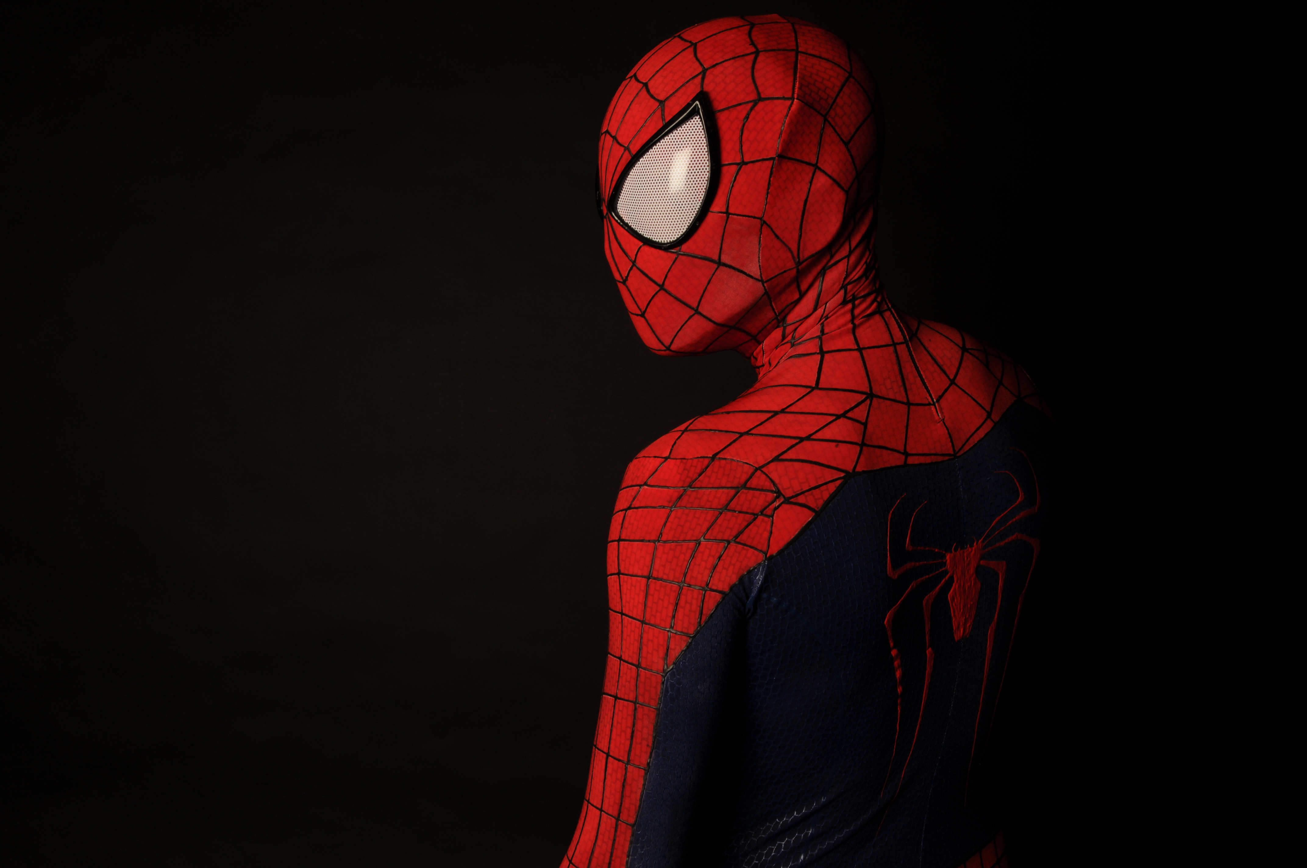

Alright guys!! so sorry for the lack of update!! i needed to finish my suit asap as i had one week to puff paint my entire suit before my local comiccon, in montreal, canada. Glad my thread is still alive! I'll answer some question!
First to cyup it tooks me 2 bottles of red and 2 of blue. 4oz each.. but my suit was very very fade.. pretty white!!!
Then to mrjenzy, i dont think it will matter to spray the paint on an already puff painted suit. i did my second layer of spray paint when my blue area slick paint was done and it works badass!
It's not too tricky to do.. but for sure time consuming..
As i said in my first post.. u have to use a small artist brush.. (i took my 3yrs old brush loll) the paint all section separately. u can see it on my first picture.. i did paint like 4-6 inches wide.
Then u could spray the rest by paying attention to not spray blue on red part and vice versa.
The red or blue choose doesnt really matter in my opinion as its not what u'll see on ur suit. It will darken the suit a little. but without masking muscle shade too much.
every white parts will be colored also.. so if u dont want to puff paint ur blue bricks.. the will be darker a lil..

well its my pleasure to help!! I had so much advice by reading and discussing around here with many rpfers!
Btw.. i would suggest to apply layers as even as possible.. ull see it will add deepness to ur color which i found awesome. Also the fabric will get a sort of stiffness which i found also very cool! But with wearing it as i did for all the week end it will be soft and smooth back..
as i mentioned earlier, my local printer did a terrible print to me loll. It was verry fading when stretch which i know is usual as the print is on white fabric.
i read somewhere thenickfox who suggest the idea of a total overdying process i though i should give a try as my suit was unwearable anyway... and it turns just amazing!! No more fading even in the knee part, ass etc etc.
I will definitely suggest u to do it that way without a doubt.. and i would suggest u to stretch it a little to make sure to cover as much white fiber as possible. So u only have to do it once.
Hope it helps.. and remember it my only two cents! Im not a pro as ita my first time doing a suit like that!!

it was fading without washing it yes. just because its print on white fabric.. it will.
but i don't know why.. maybe it was a little too tight.. or the print does not transfer properly but mine was really but really white when wore.
i'm a stupid idiot and forgot to take picture before the dying process.
Also i didnt watering the fabric paint at all.. it was ready to spray.. but this guy at Michaels told me that he thought it was also brushable. And he was right!
It's time consuming, but it definitely worth it as it seems to be on colored fabric now
