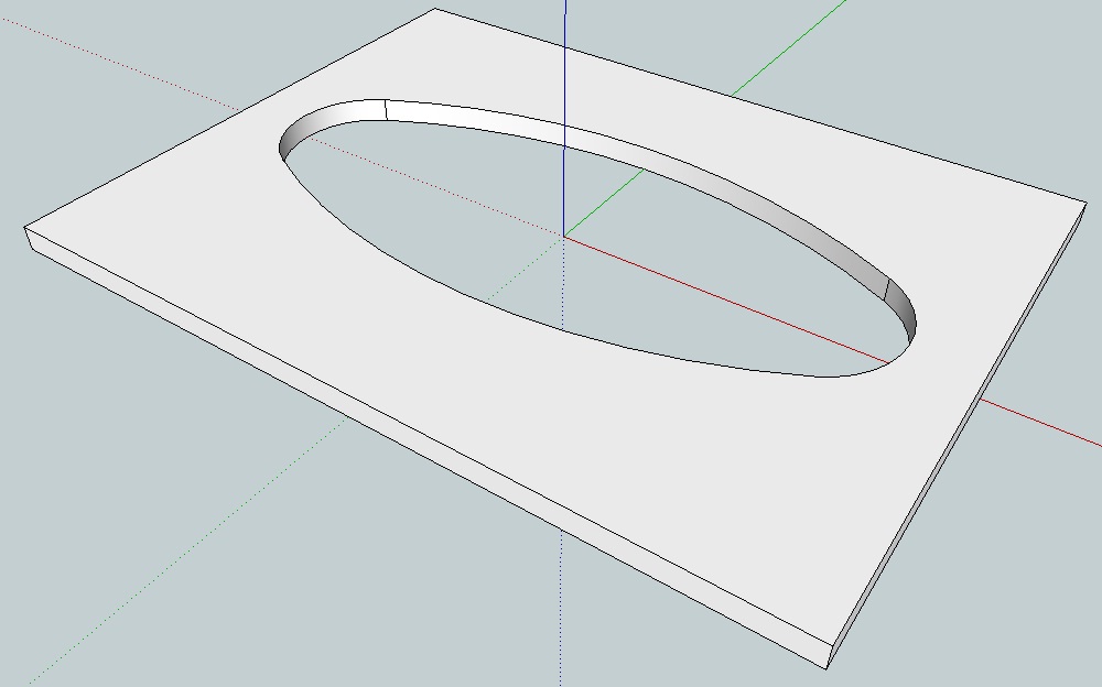

So you need to make a jig which is a board with an oval cut out. The cut out needs to be the exact size of the final part. You need to take plastic thickness into consideration given you are placing the dome over the head.
Slump forming is just that - Mount the plastic to the board and heat the plastic to soft state and let gravity take over. Remove the heat when the desired height (slump) has been achieved.
Vacuum assisted means you build a box around the jig and use suction to help pull the dome.
Your jig will look something like this.

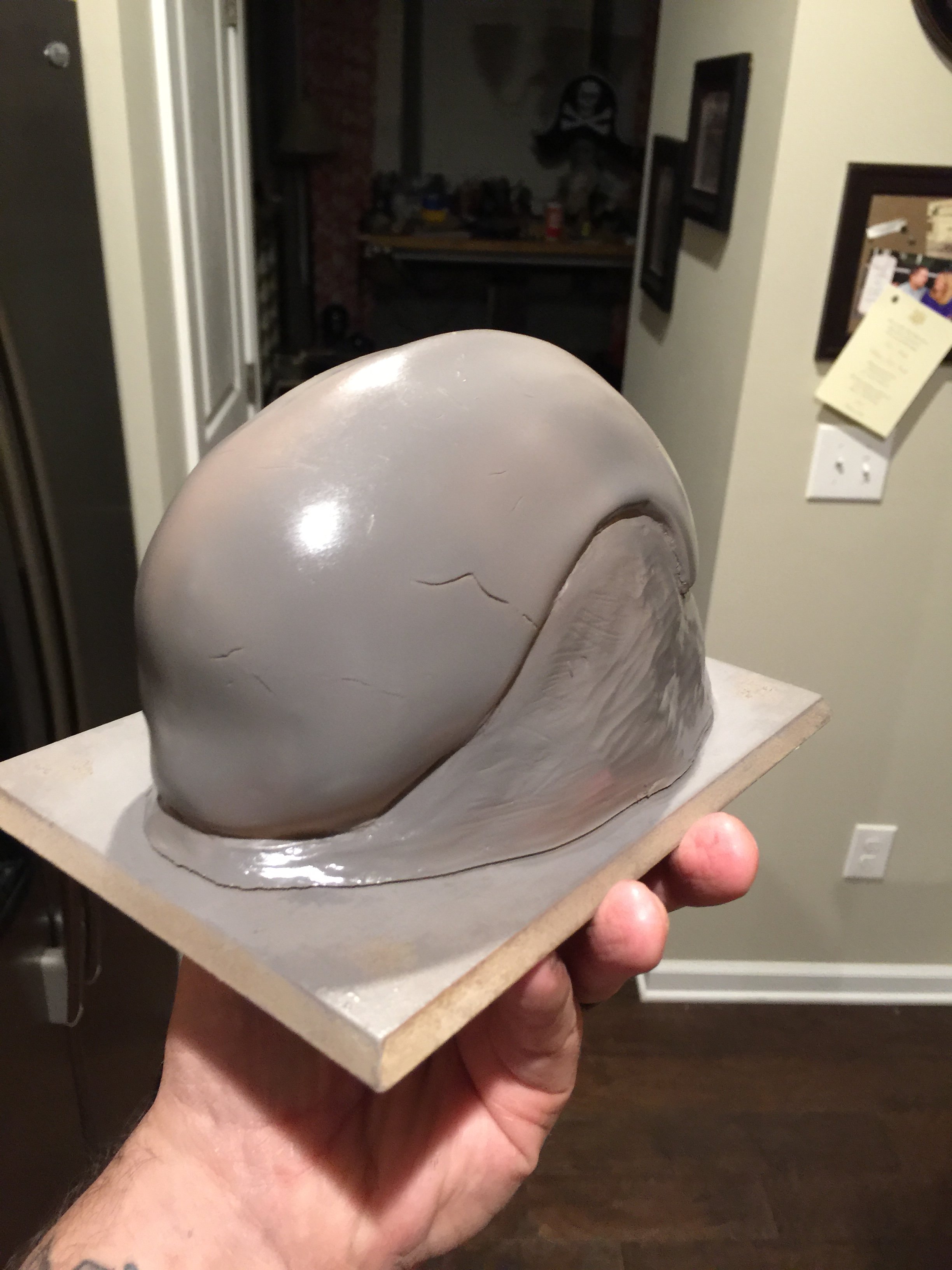

Here's where I am currently... Starting the "sand, prime, fill cracks, sand and repeat" stage of the dome... Though it seems monotonous, it's worth it in the end! Sculpey, while I LOVE sculpting with it, can crack during the backing process. I tend to do the "low and slow" method where I bake it at a low temp for longer times and most times that takes care of the cracking issues but it might have been a little dried out having been set aside for a bit before I was able to get it finished... Either way, fixing the cracks is no biggie, all part of the fun! ;)

@Beeb89 be careful not to make too much of an undercut.
attachment.php
As this stands now, you may have to cut the plastic away from the buck. As the plastic cools, it shrinks onto the buck. This also why I am massive of female tooled vacuum forming. As it cools, it shrinks as well, but now pulls away from the tool.
Looking at your image, you might want to build up and out the side parts so that the line around the base of the dome is a line and not a hard undercut. Building up the sides will still give you your distinct edge, but allow the plastic to lift off.
It is looking really good, so keep going.

With sculpy, from what I understand, to help reduce cracking, when you bake it, it's best to turn off the oven, but leave your sculpt in the oven and allow it to cool down slowly with the oven. If you take your piece out, especially if it's built over an armature like waded up tin foil, the sculpy cools too fast and causes the cracks.
