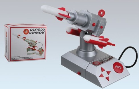

I also have one of those dummy security cameras coming in and I also am about to get one of the Desktop Defenders in and I will try to make a decent working Shoulder cannon out of both of them.
Dummy Security Camera
Desktop Defender Cannon
Once I start that project ill put up pics and vids of the project. If it weren't for the GREAT huntorials on the site, I doubt I would have the courage to attempt a pred suit!

I have a desktop defender coming in from ebay that I will be using to try to make a decent plasma cannon, pics here:
I'm thinking if I can find a wire that I can extend the length of the controller to the actual mount, that I can run the wire to a gauntlet and I can configure the buttons into a bomb gauntlet so I can move the cannon via gauntlet computer. Anybody know of any tips to make this cost effective and easy let me know!!
