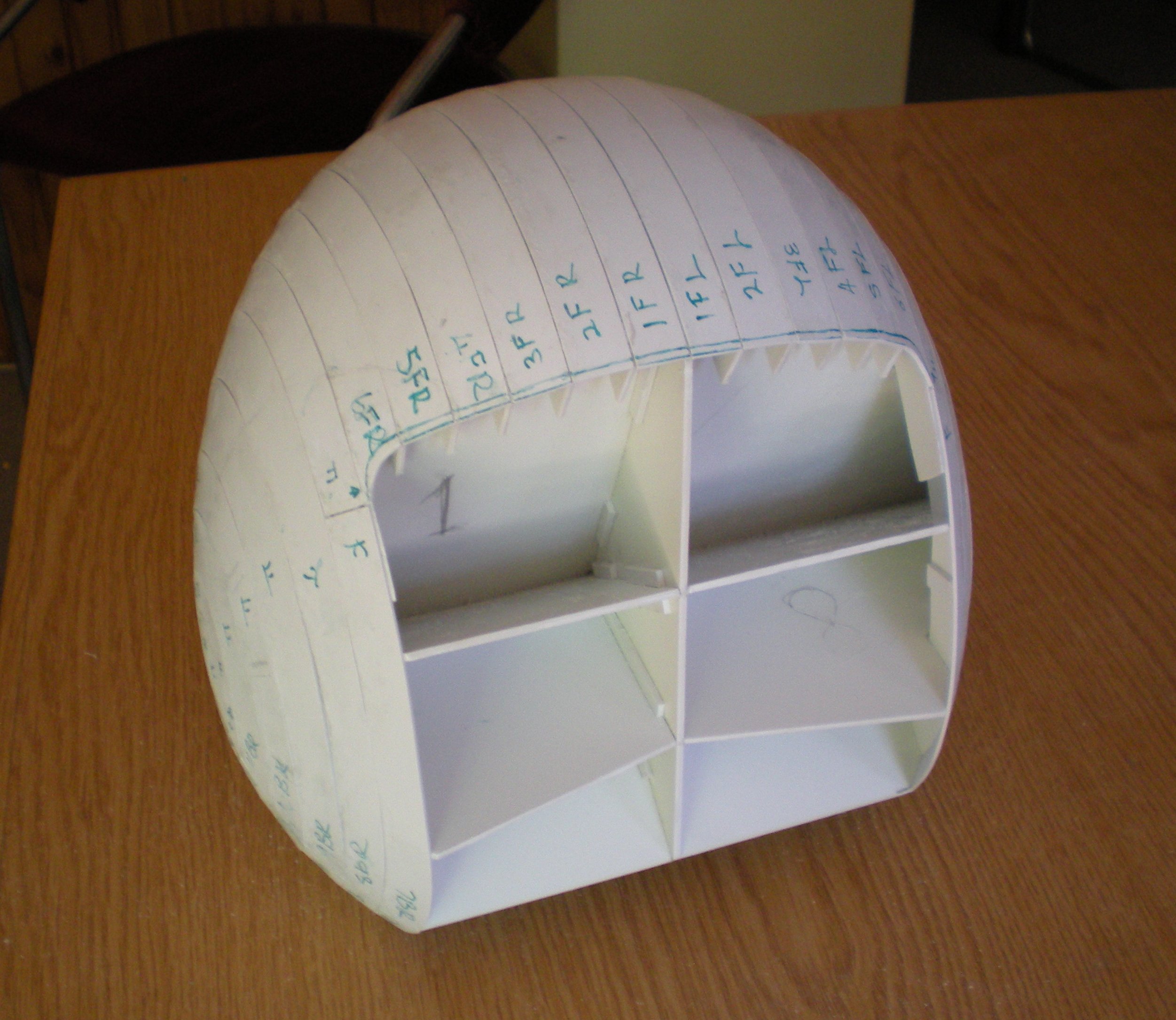

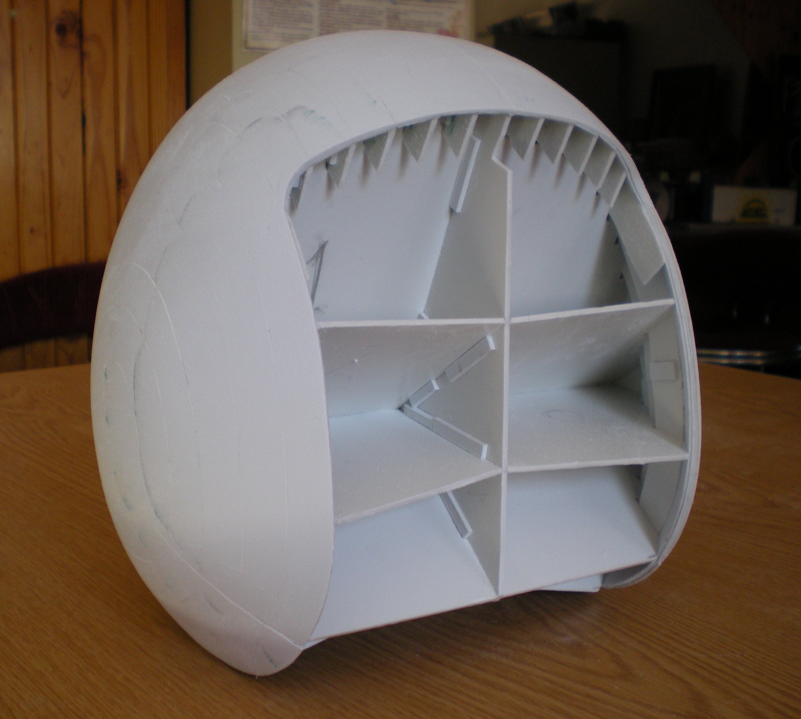

My Star Wars helmets workbench
Holy crap! I've worked a lot of styrene for a long long time and have never ever seen anyone skin anything like this. It is completely crazy and the result looks amazing! You sir are a talented and patient man. :)
Hi Pedro. I promised myself this would be the last helmet I'll model out of styrene. I think I've sanded enough styrene to last a couple of lifetimes.

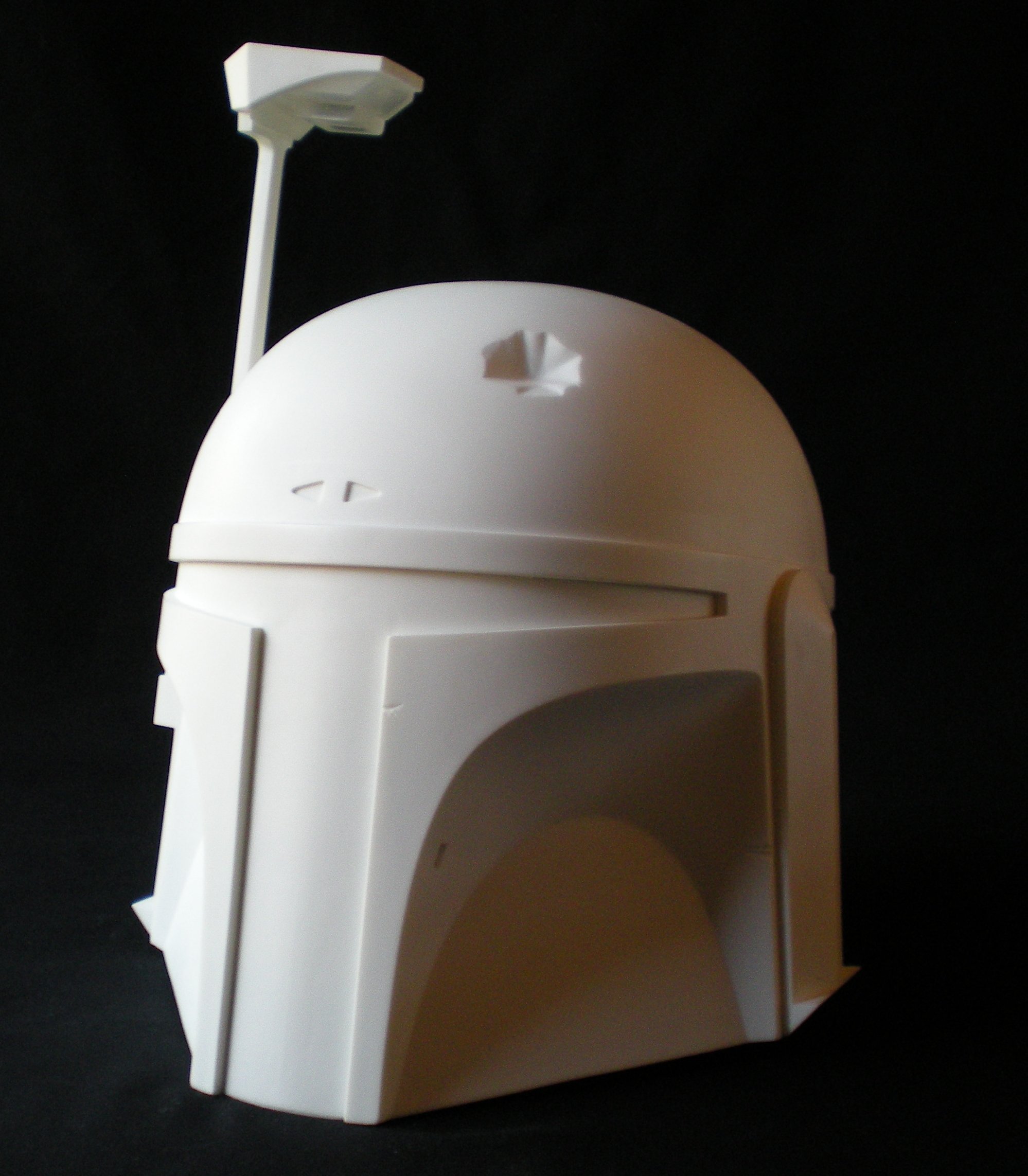

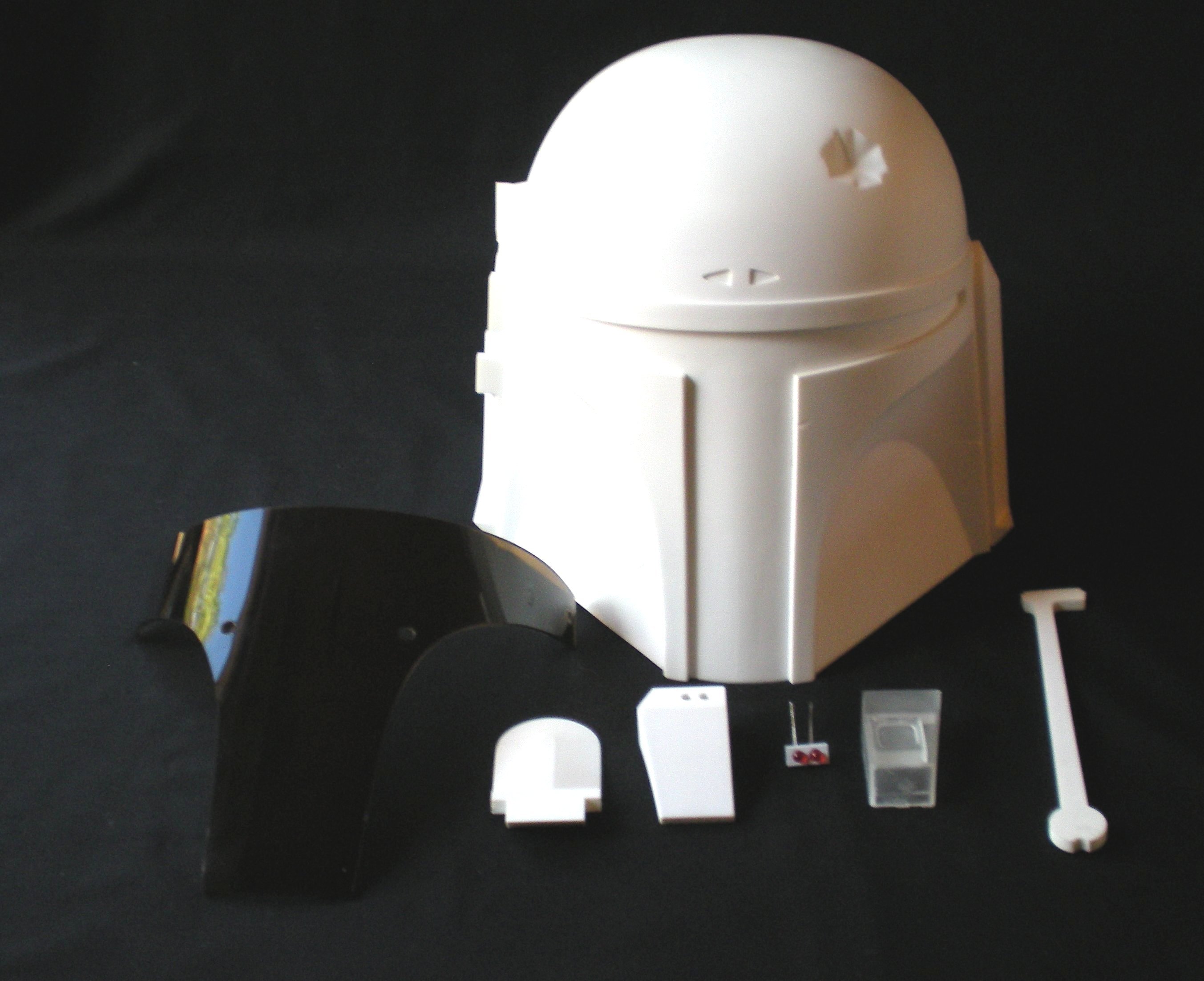

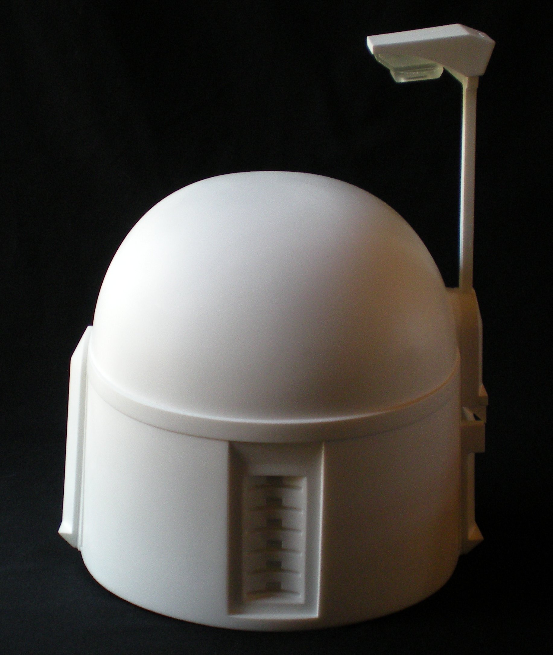

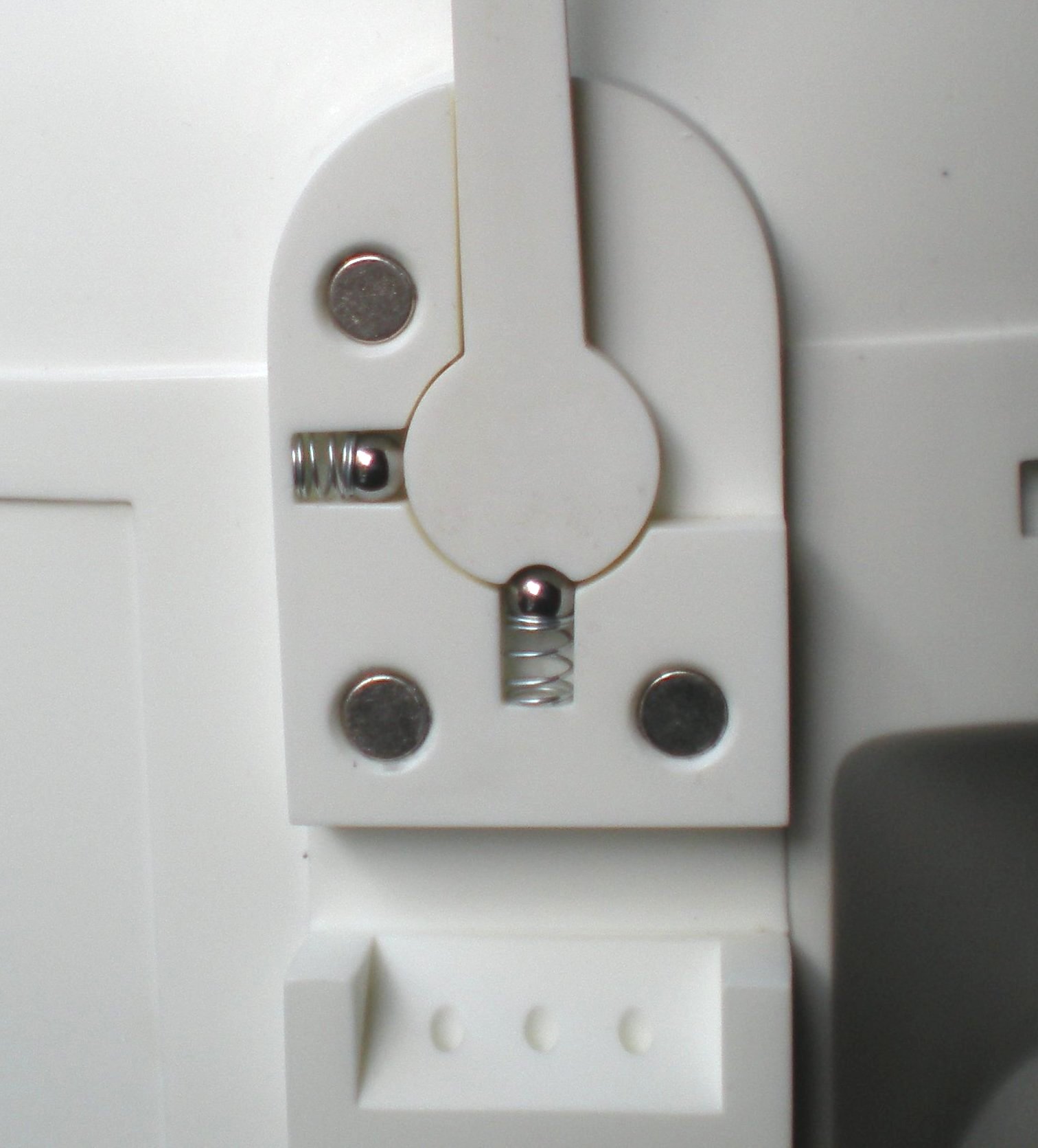

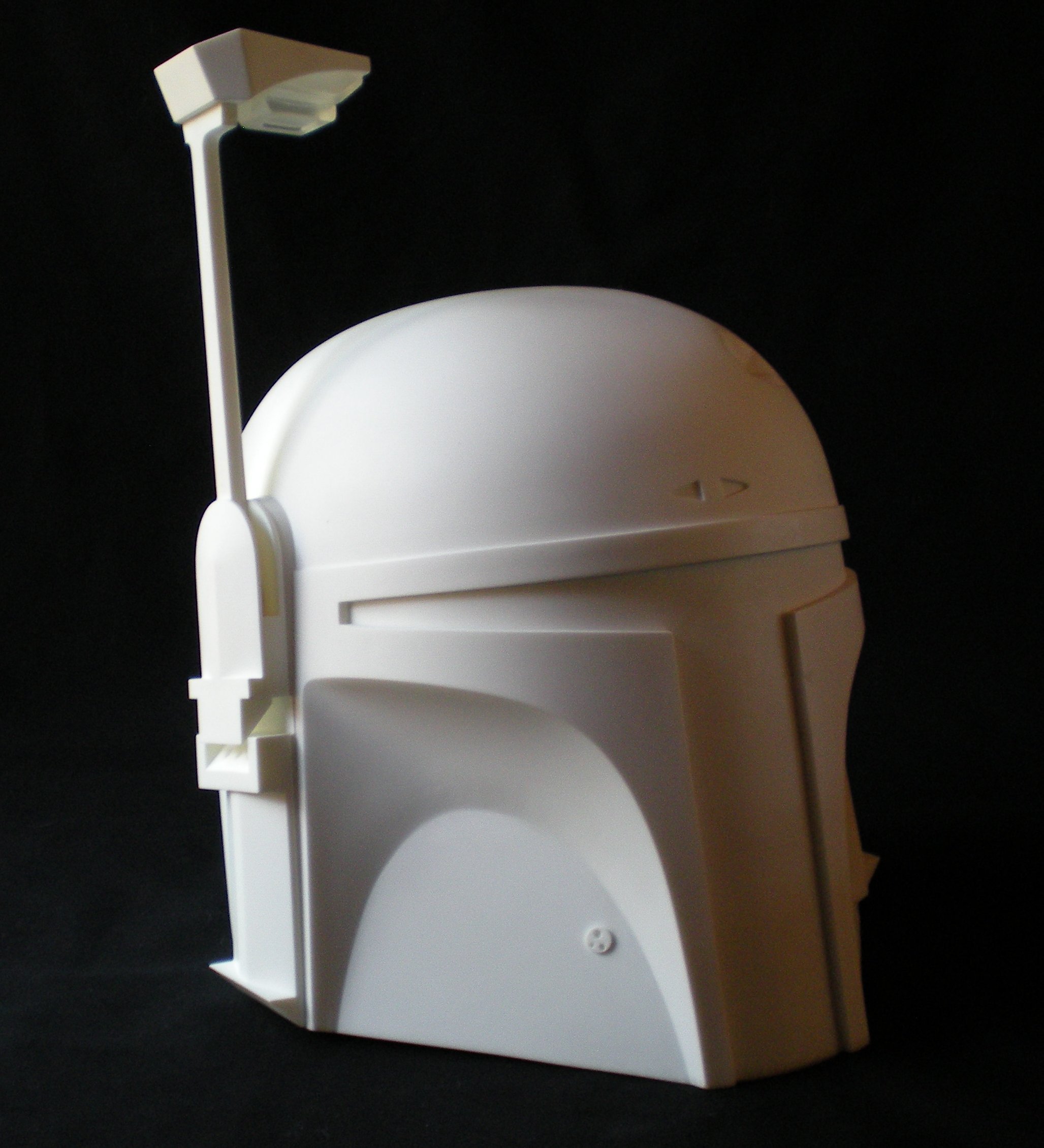

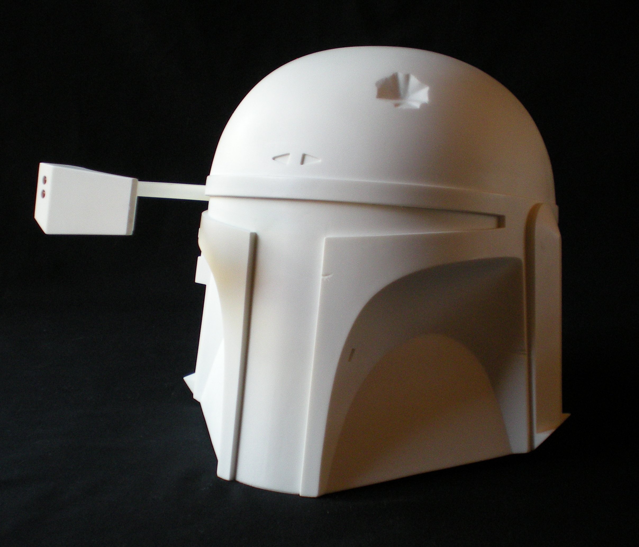

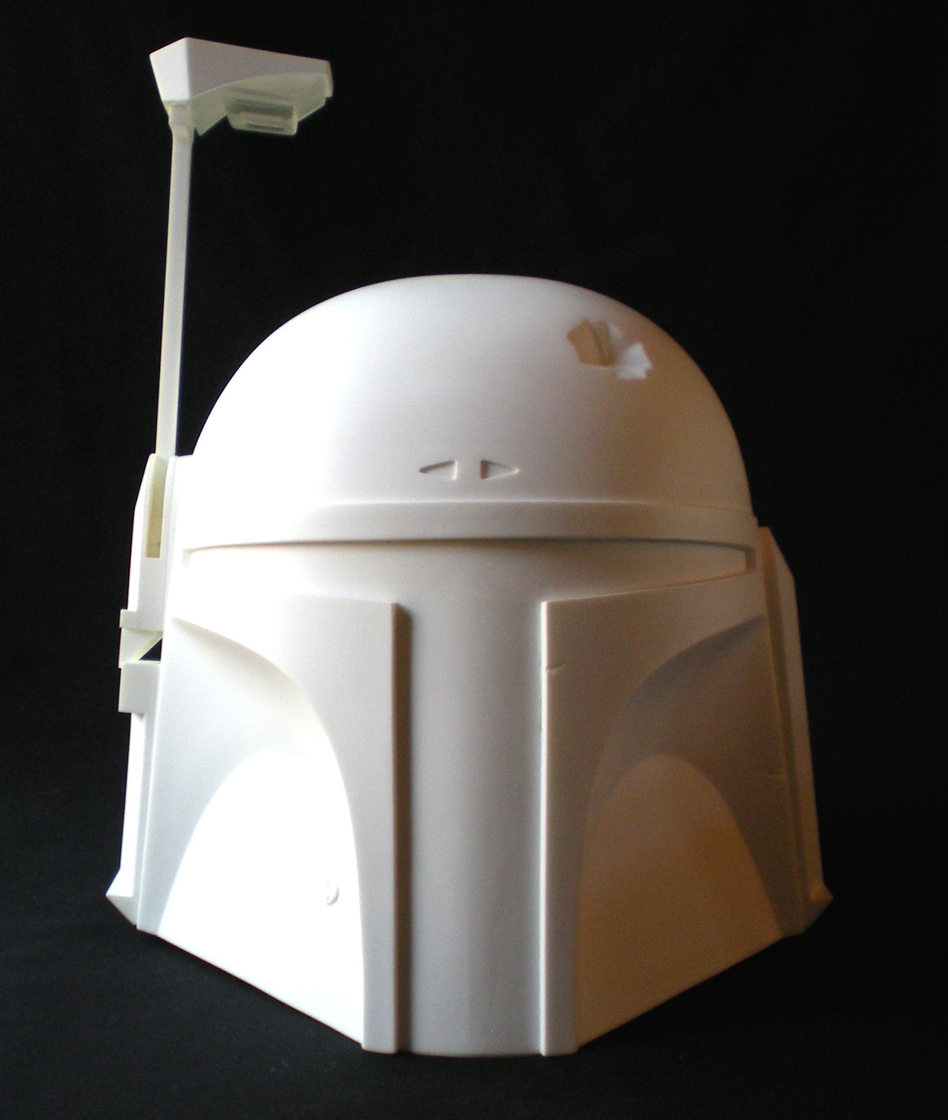

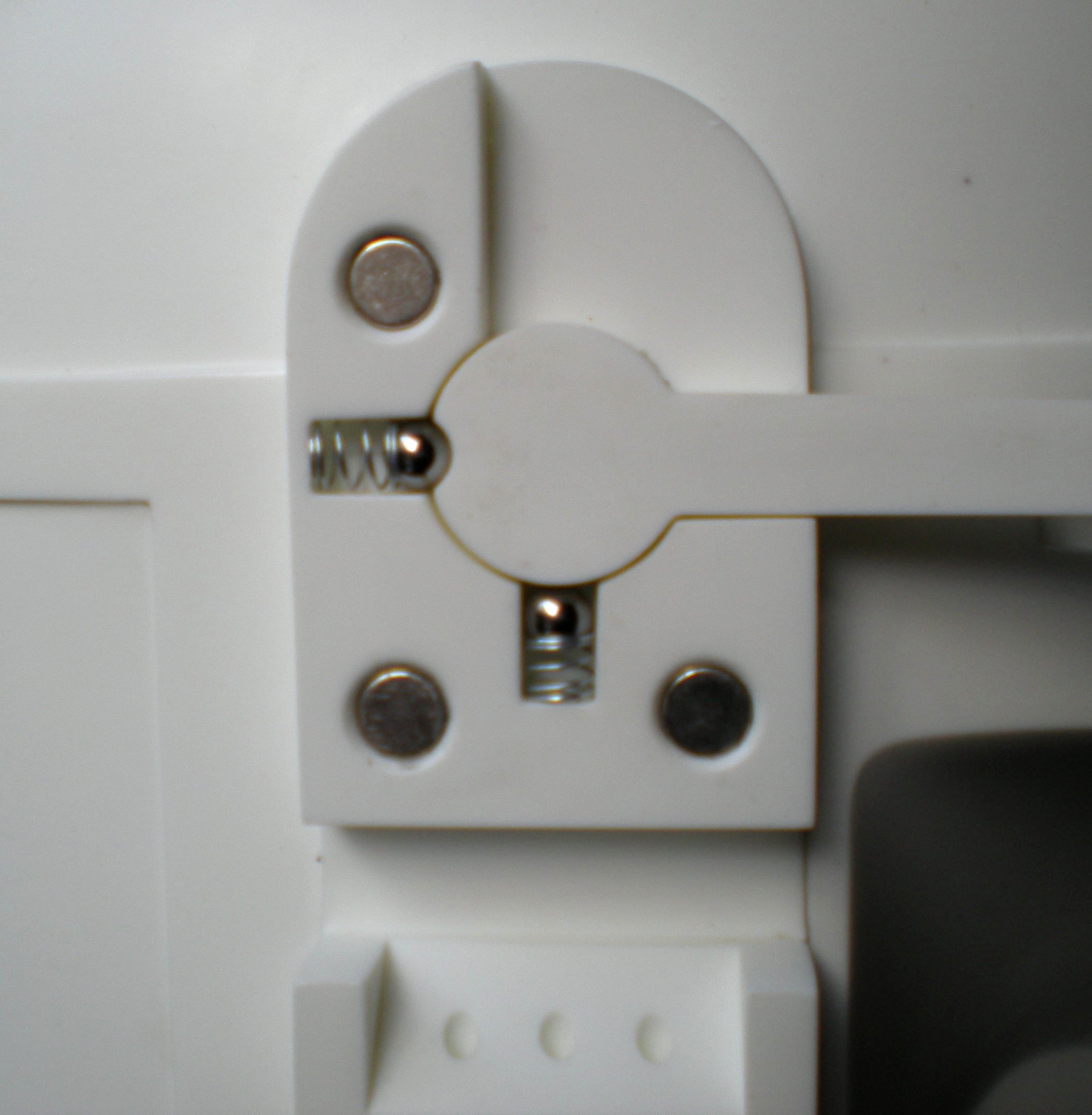

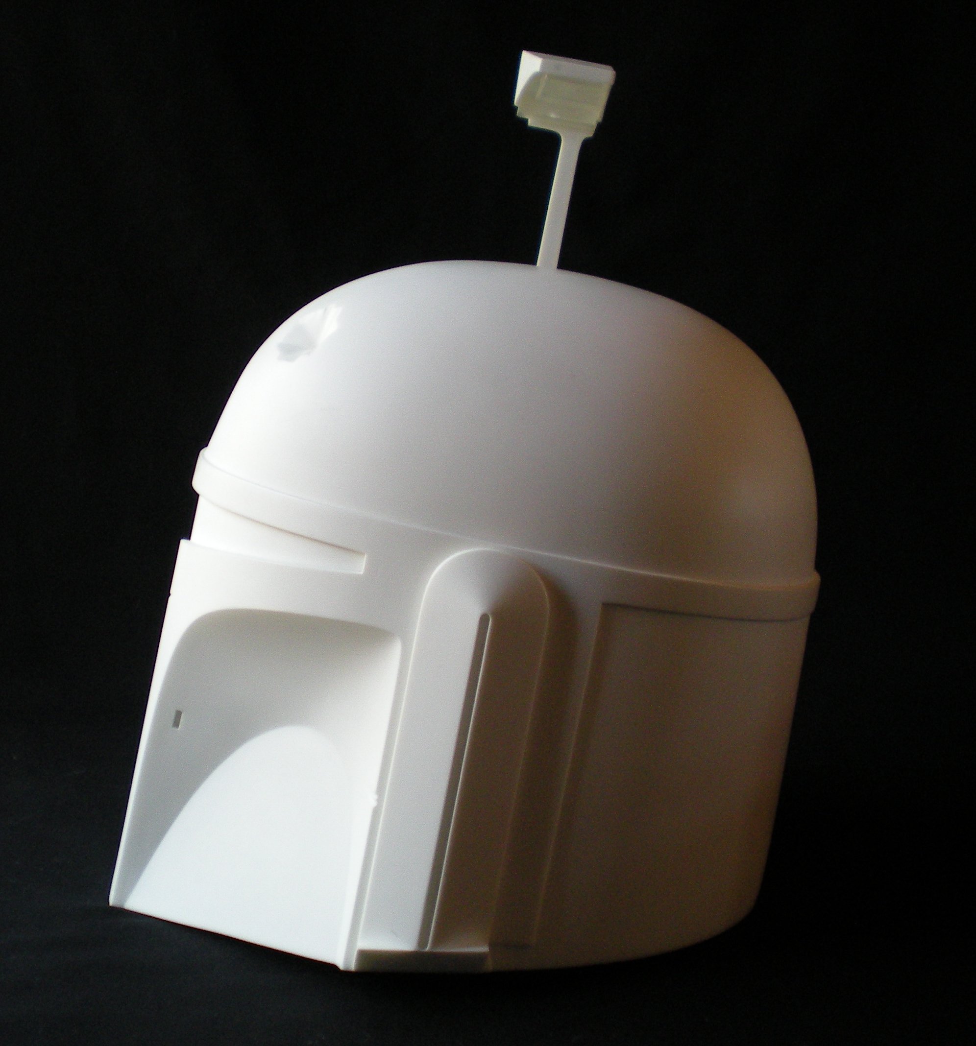

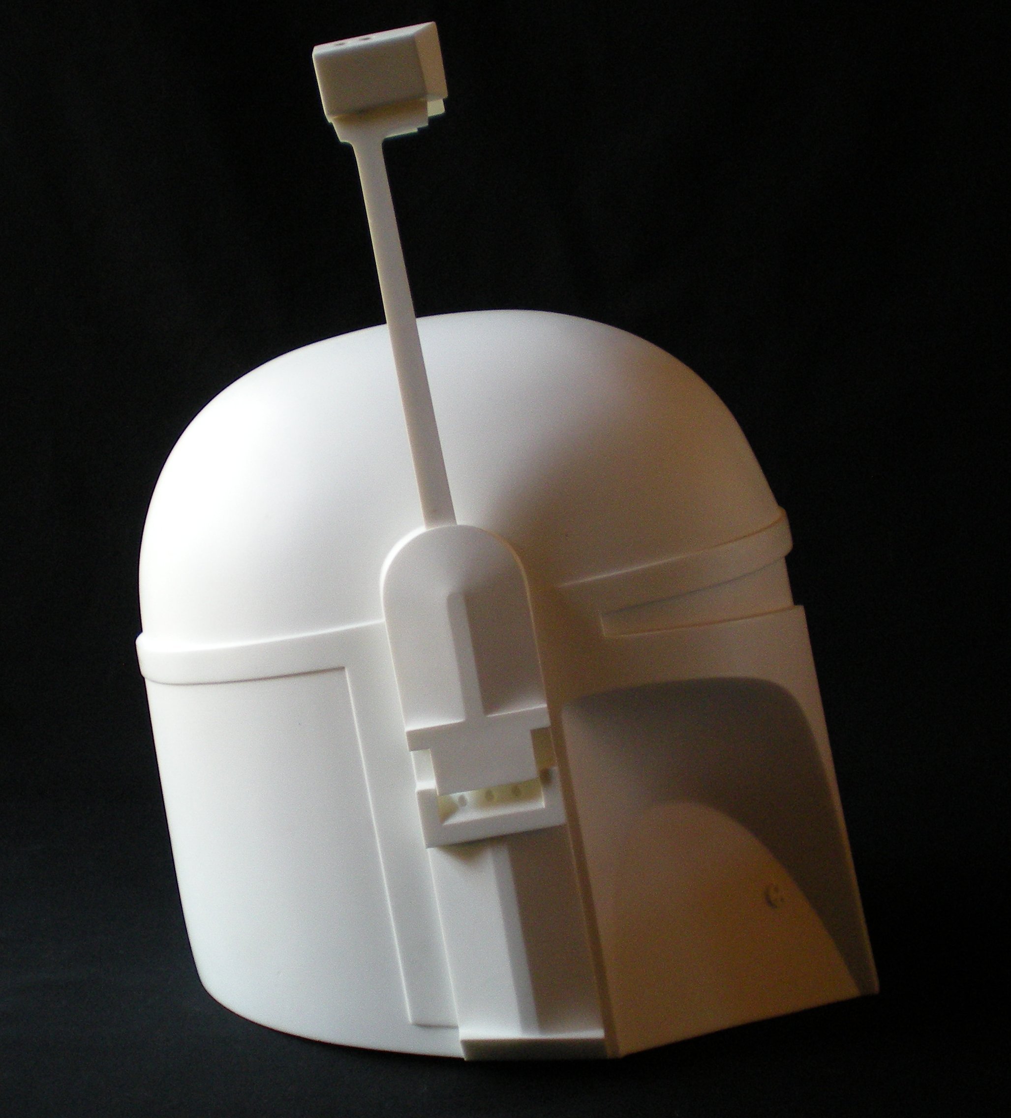

Finally got around to molding and casting the Boba Fett helmet. Cast mostly in Smooth-on Smooth Cast 305. The ear cap attaches magnetically to the ear piece which contains a spring and metal ball mechanism for the RF stalk.
Boba Fett 001.jpgBoba Fett 002.jpgBoba Fett 003.jpgBoba Fett 004.jpgBoba Fett 005.jpgBoba Fett 006.jpgBoba Fett 007.jpgBoba Fett 008.jpgBoba Fett 021.jpgBoba Fett 022.jpg
Now that is great detailing work, well done !, I am growing fond of fetts helmet.
Wow! Beautiful Boba helmet, well done! I like what you've done with the RF stalk, are the metal balls and springs strong enough to hold the stalk upright without it easily falling?
Hi RetiredClone. Thanks. The stalk does stay upright but my springs are a little soft so there is a little bit of movement. A harder springs should keep it tight enough so the stalk doesn't move.
Thanks, that sounds good. I've been looking for a good, manual and non-servo way to use the rangefinder in my own helmet so this is great inspiration :)

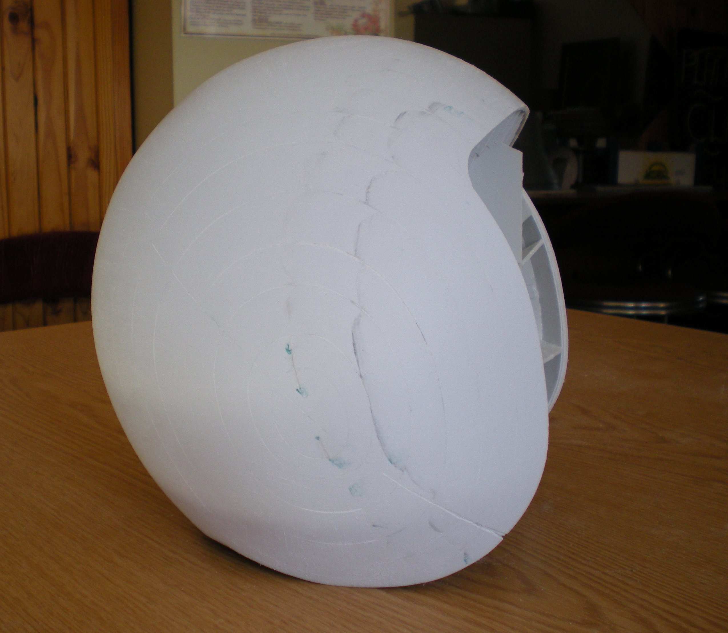

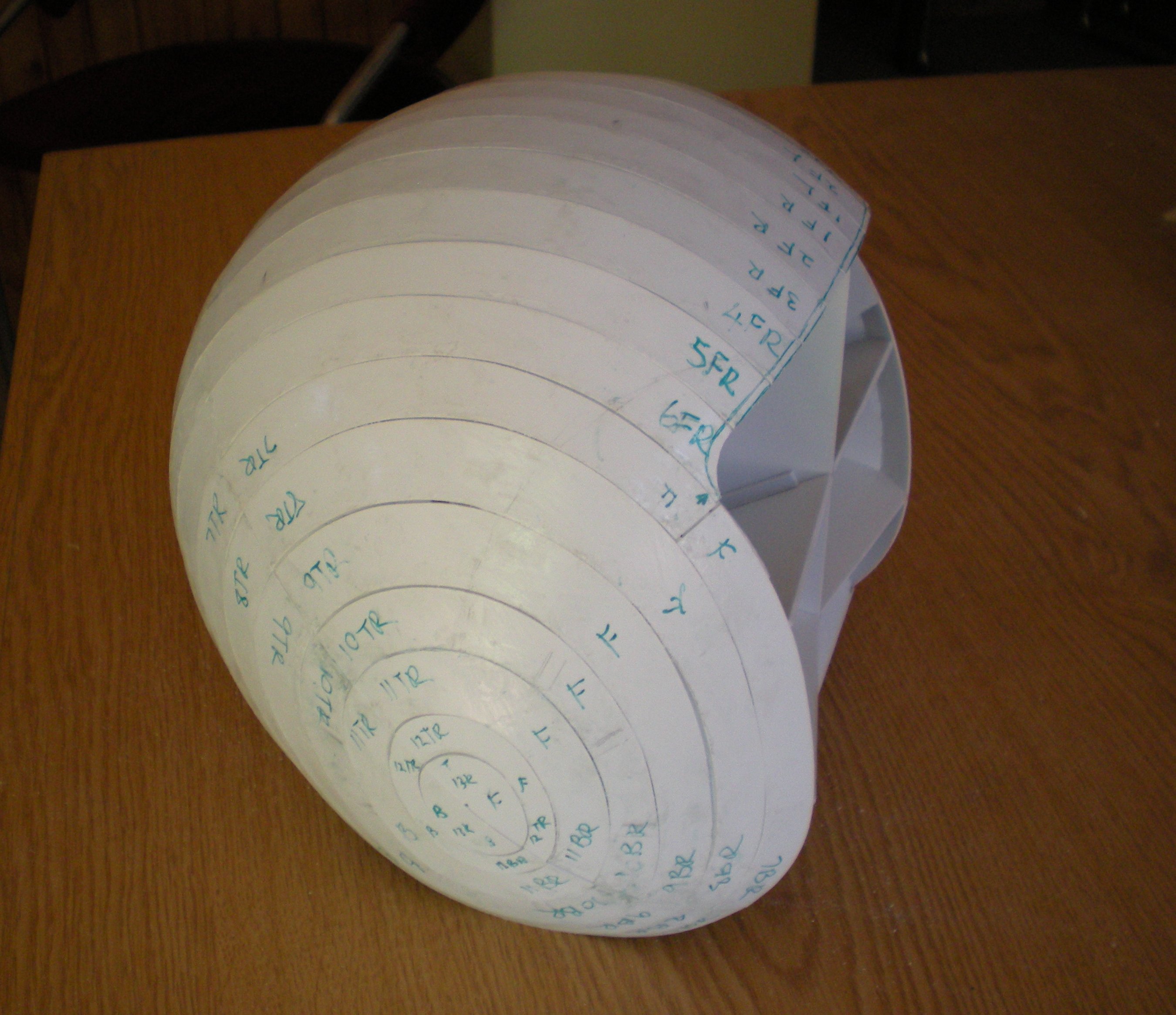

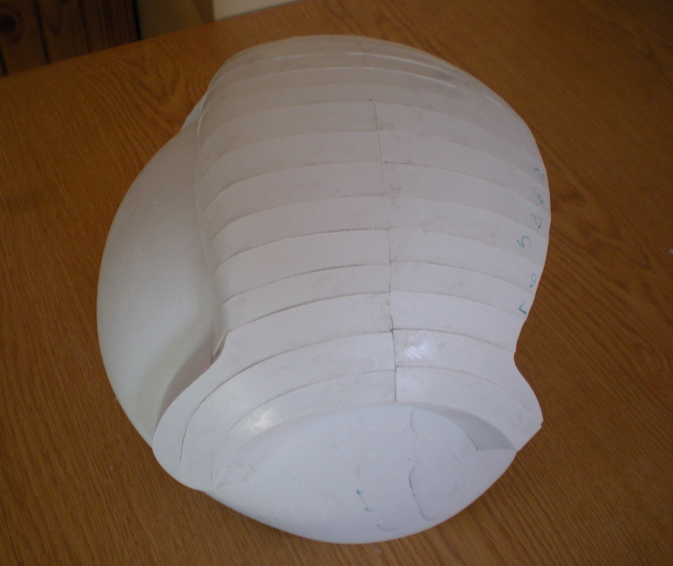

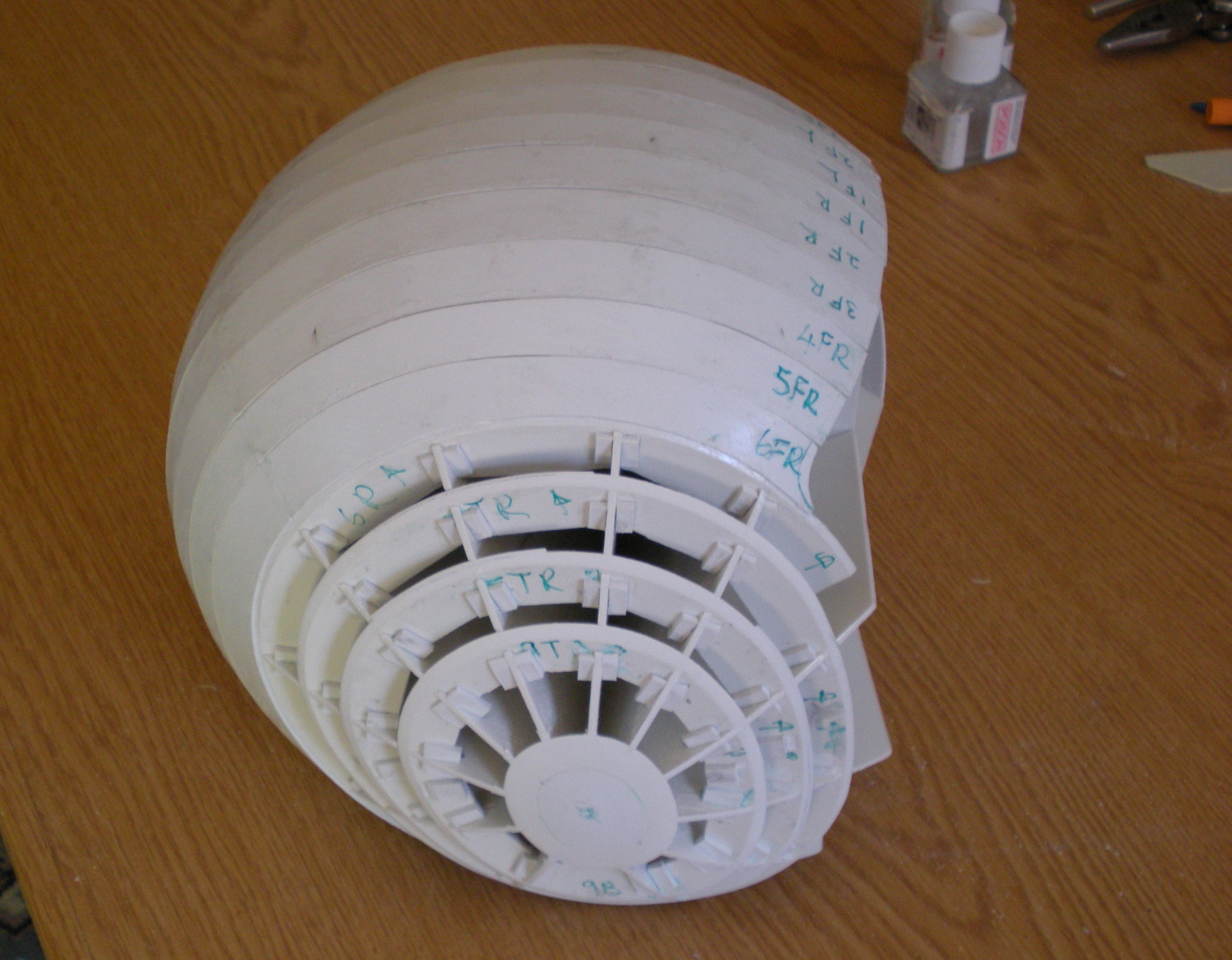

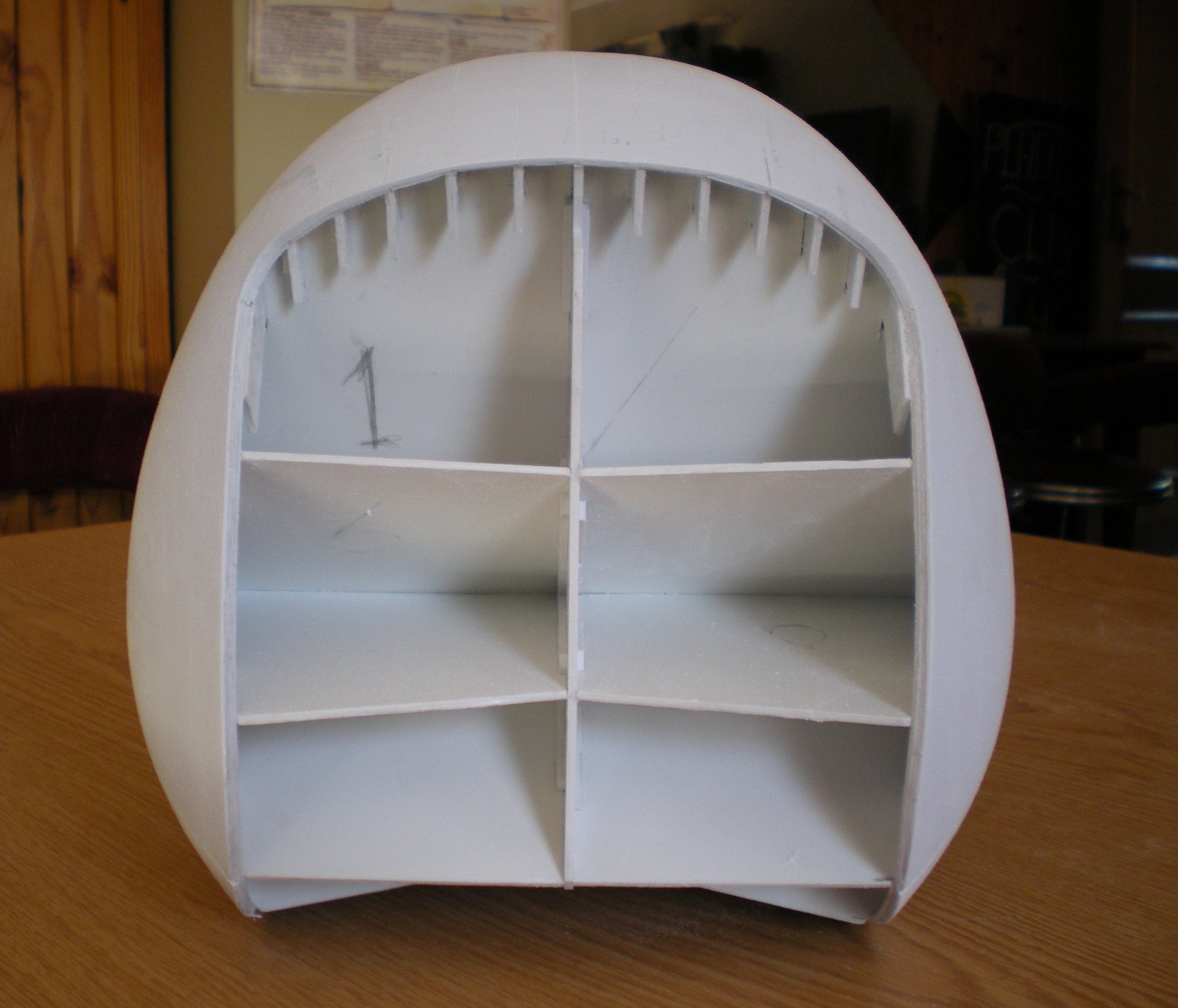

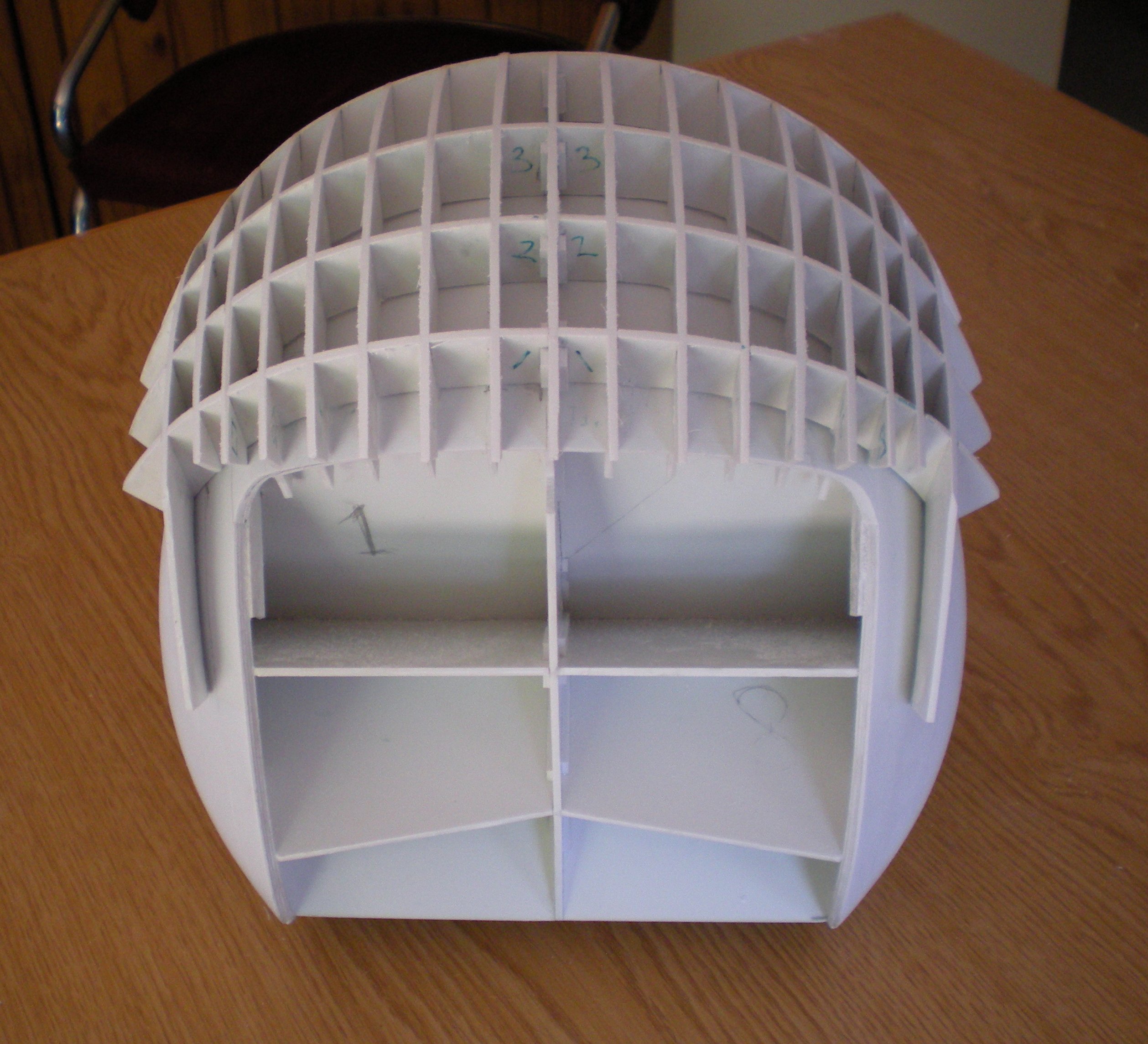

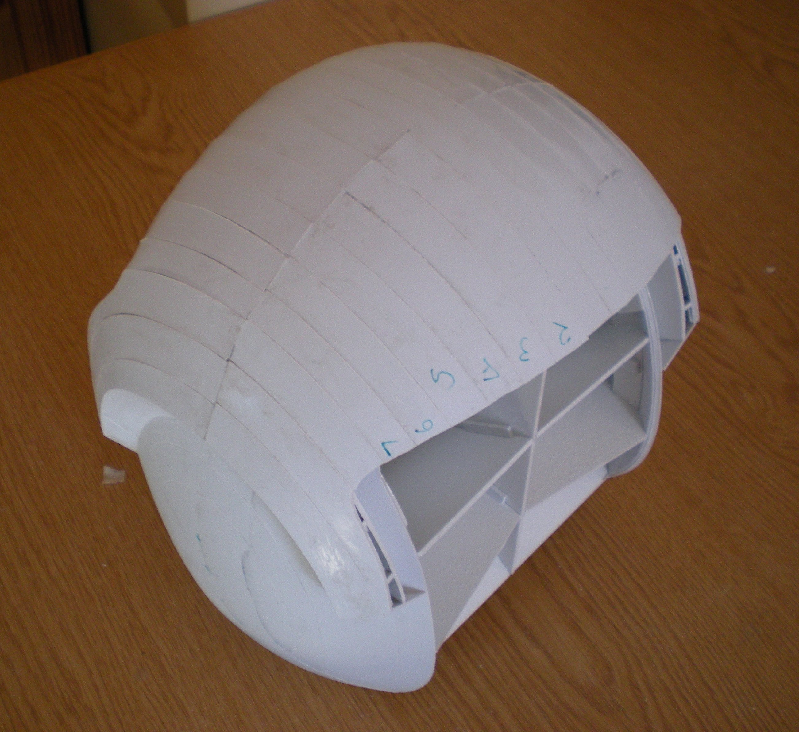

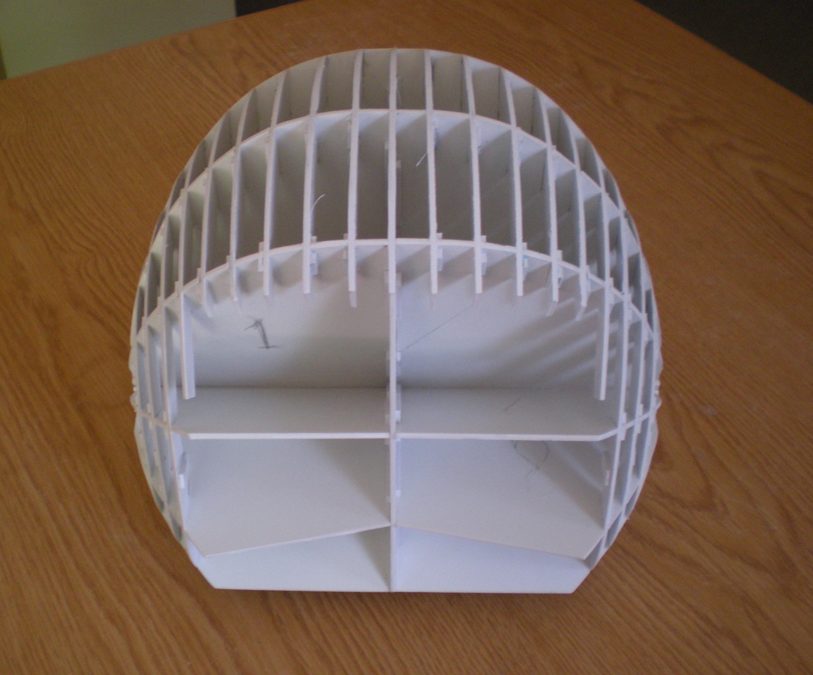

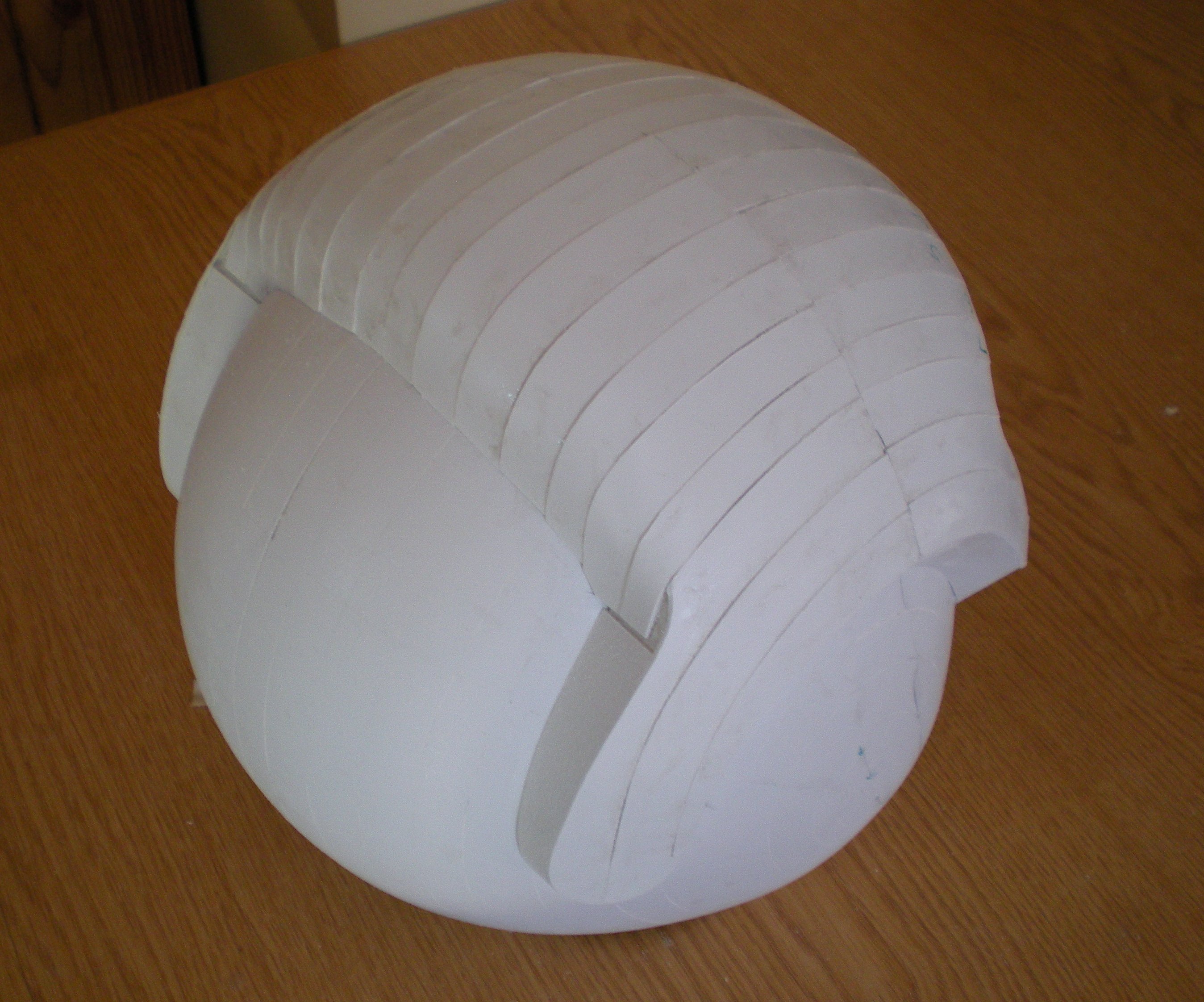

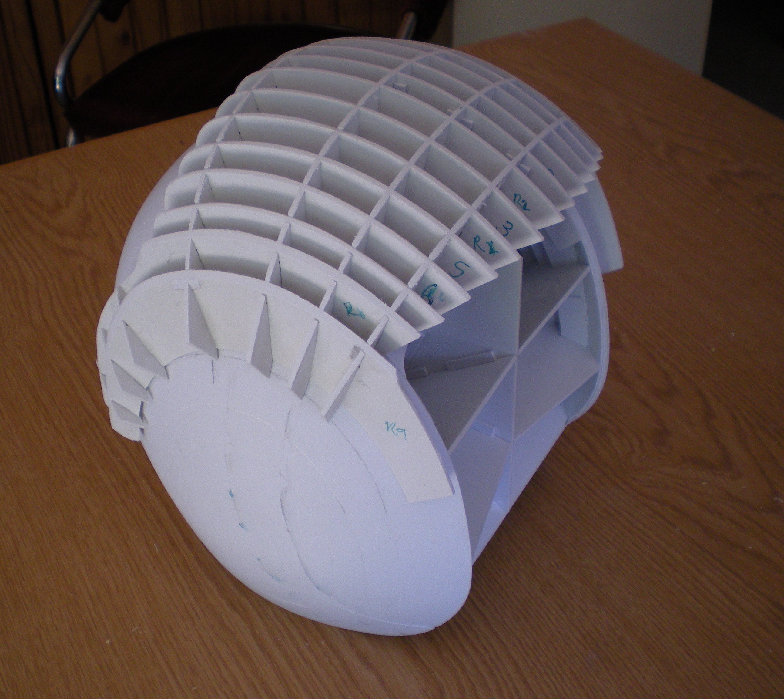

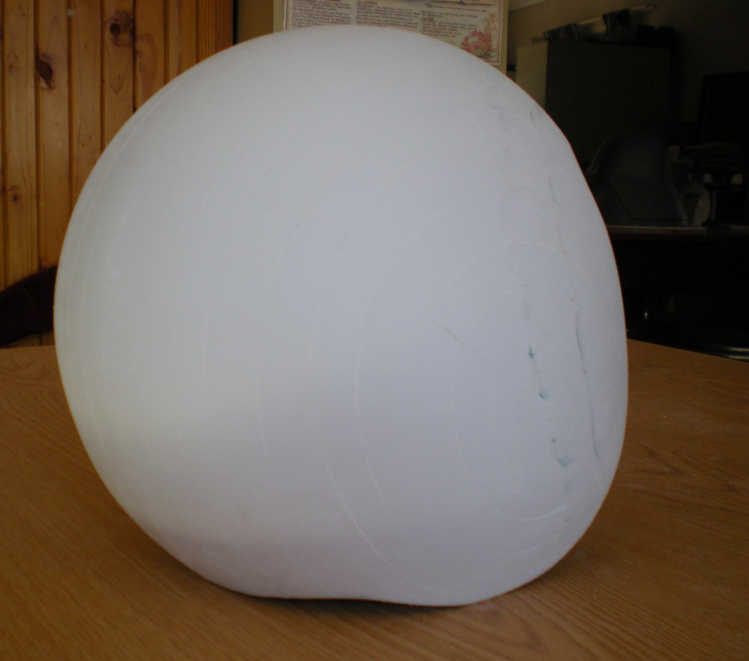

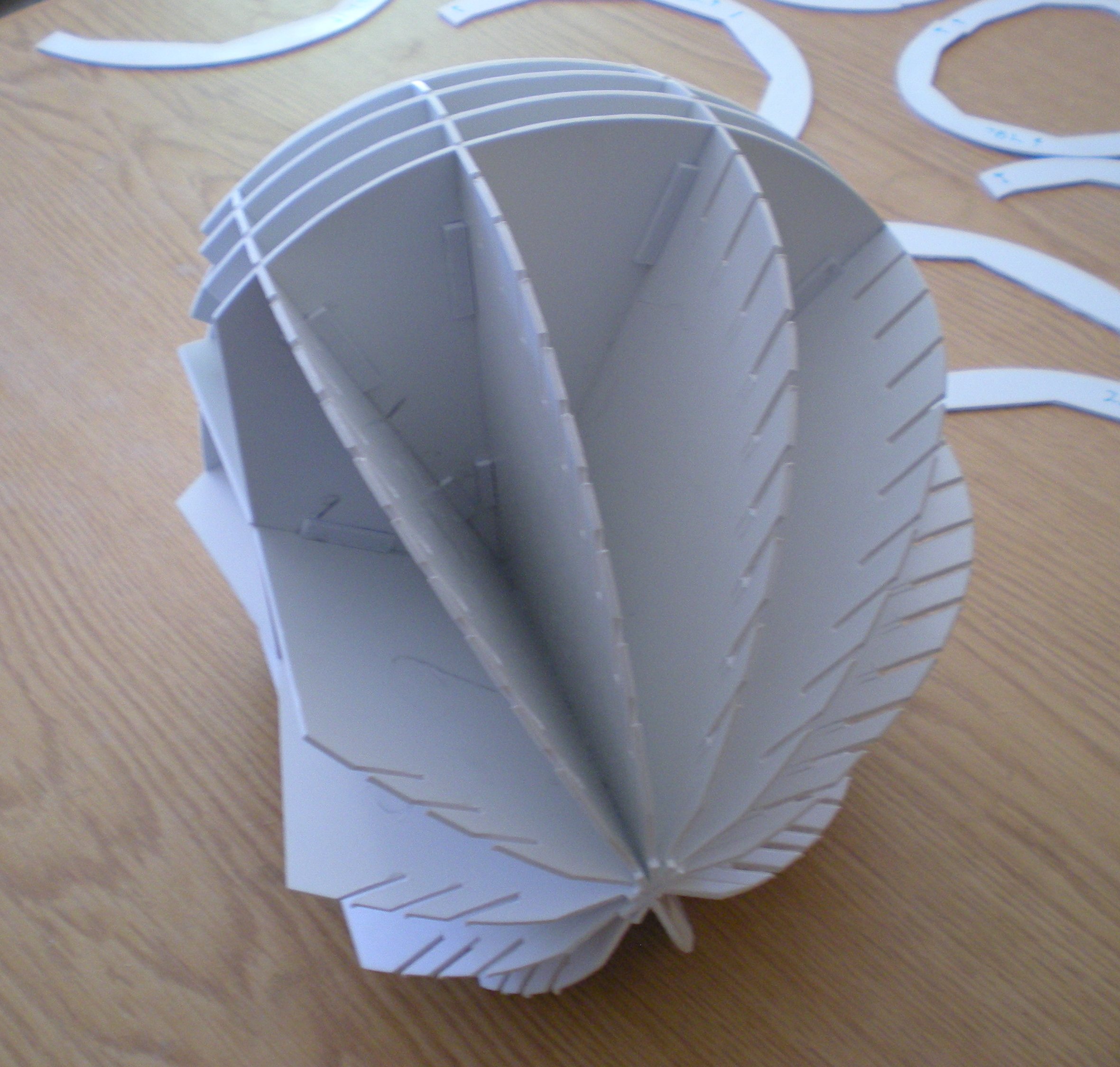

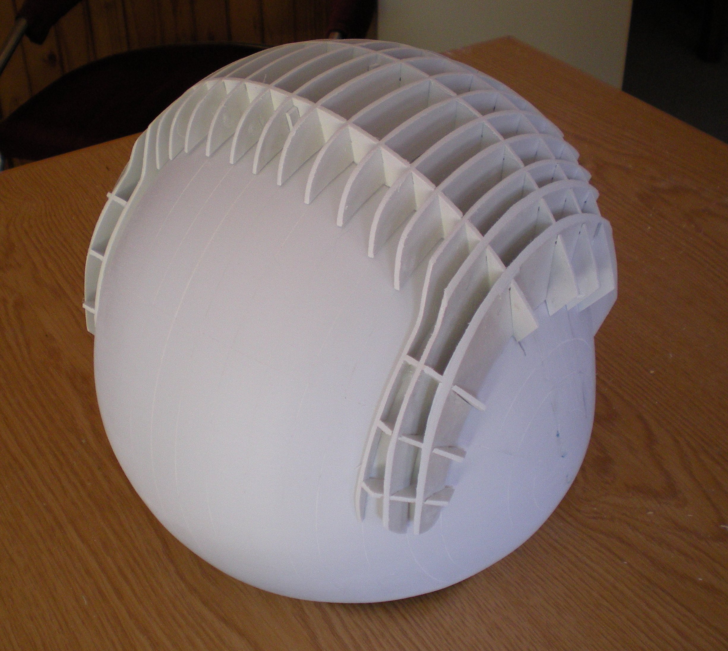

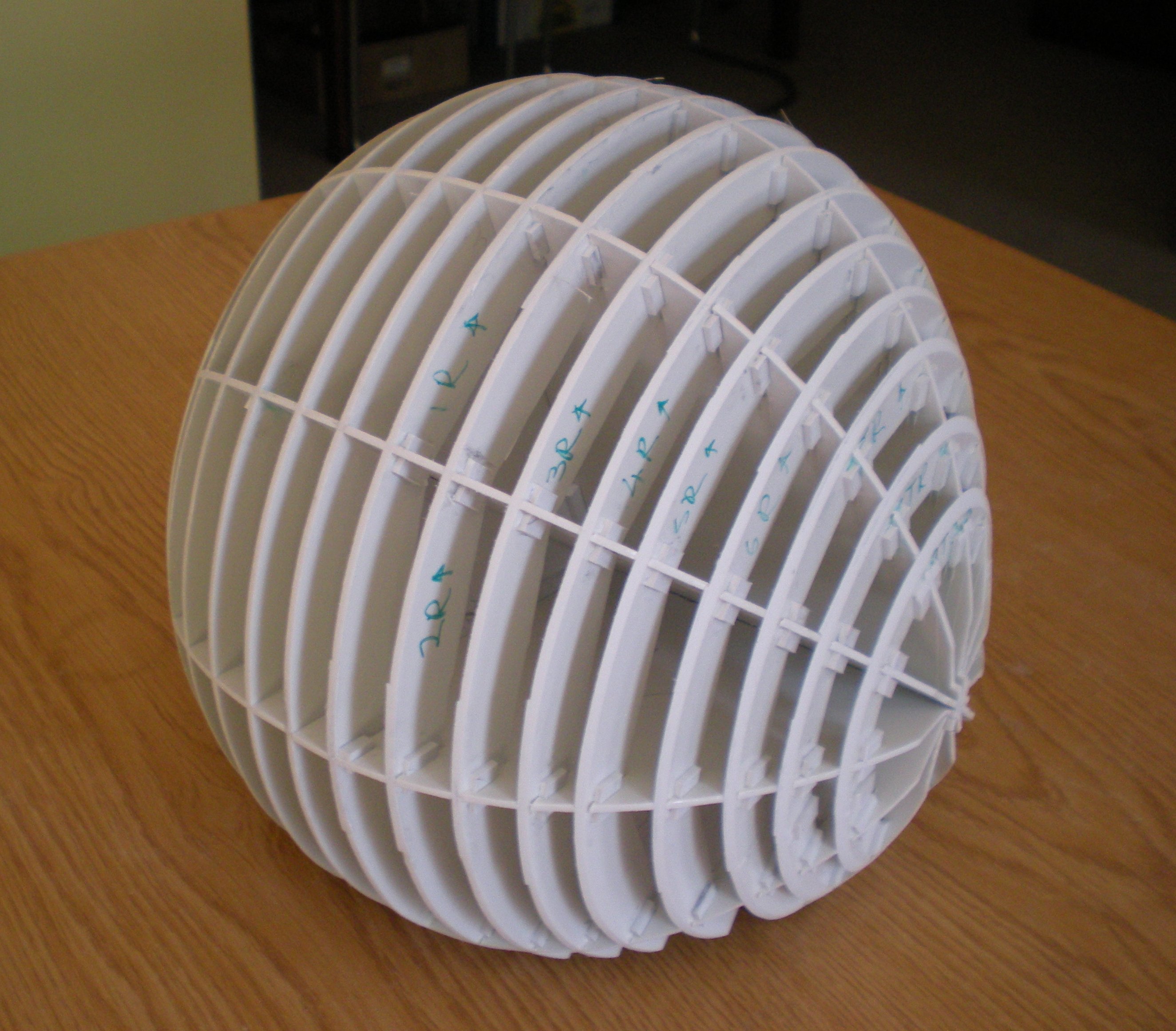

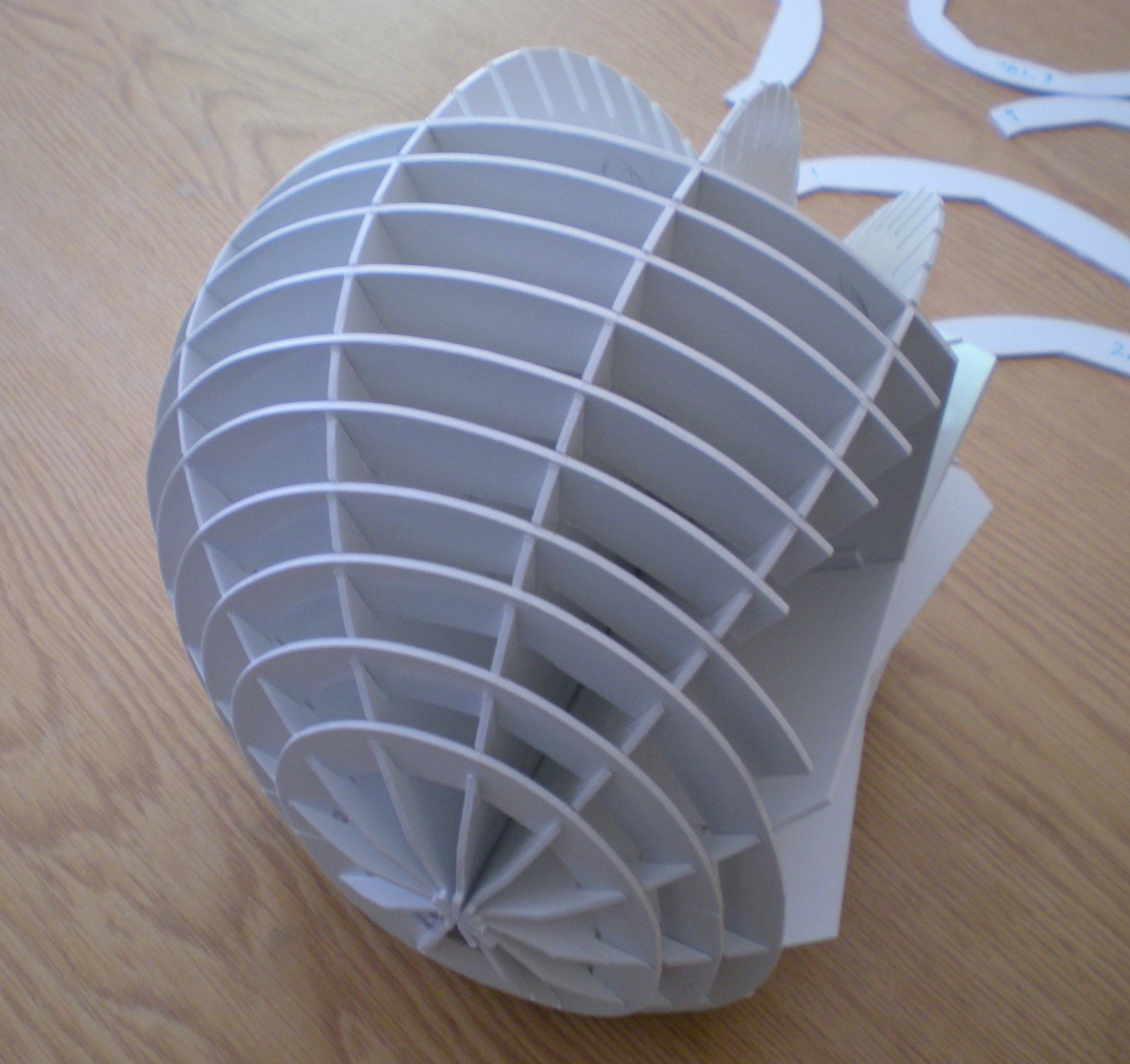

Here are some photos of the X-wing Pilot helmet I am currently working on. The construction is basically the same as the other helmets I've made out of styrene. The support structure is made from 2mm styrene and the skin is made from layers of 1mm styrene. The plan was to construct an APH base helmet first and then add everything onto the base. I completely forgot to take pics of the construction of the mohawk. Here are a couple of pics of the construction of the APH base and ramshorn visor housing.

I plan on vacforming the outer shell that goes over the base helmet with the visor attached to the base helmet. There are a couple more things to do like the edge trim and screw covers but this is more or less the final look.
