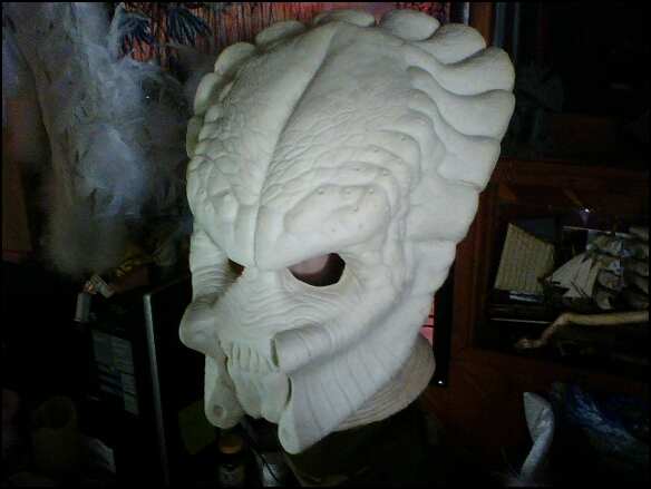

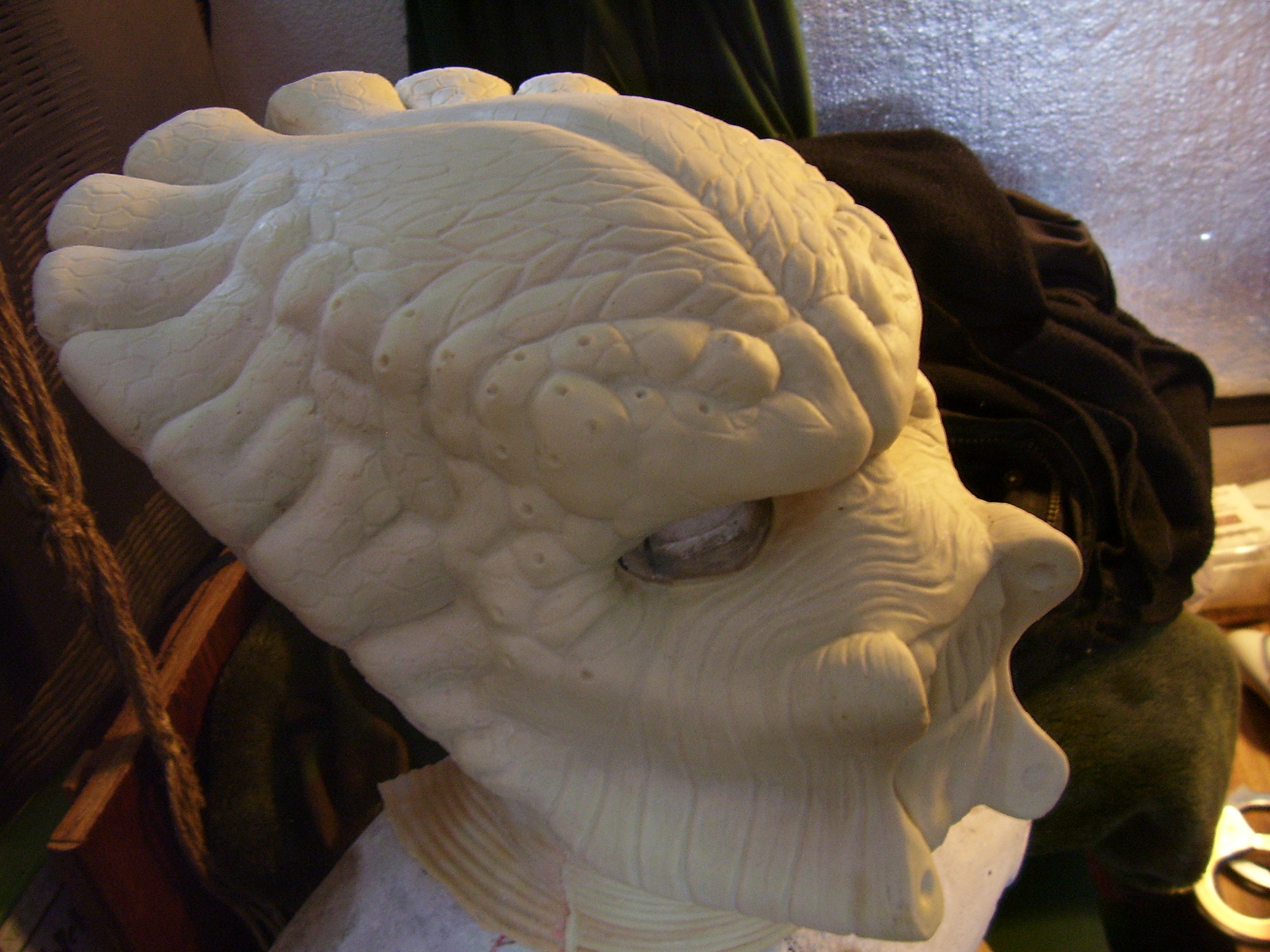

Hey guys, this is the first time im gonna try to post some pictures on the sight. Let me know if you can see this picture. It is the first pull from my molds i made last week, and i appolagize about the quality i had to use my cell phone. I have more pictures of the molding process and some beter ones of this mask with my friends camera, i will be posting them shortly. I left the tips of the mandibles off for now, and they will be cast seperate, as will the dreads. I am completing the sculpture of the dreads now and i will post them here soon! Thanks for looking.
Hey mate, looks to be some great detailling n that, get some more pics up if you can for us to ogle. Top work.

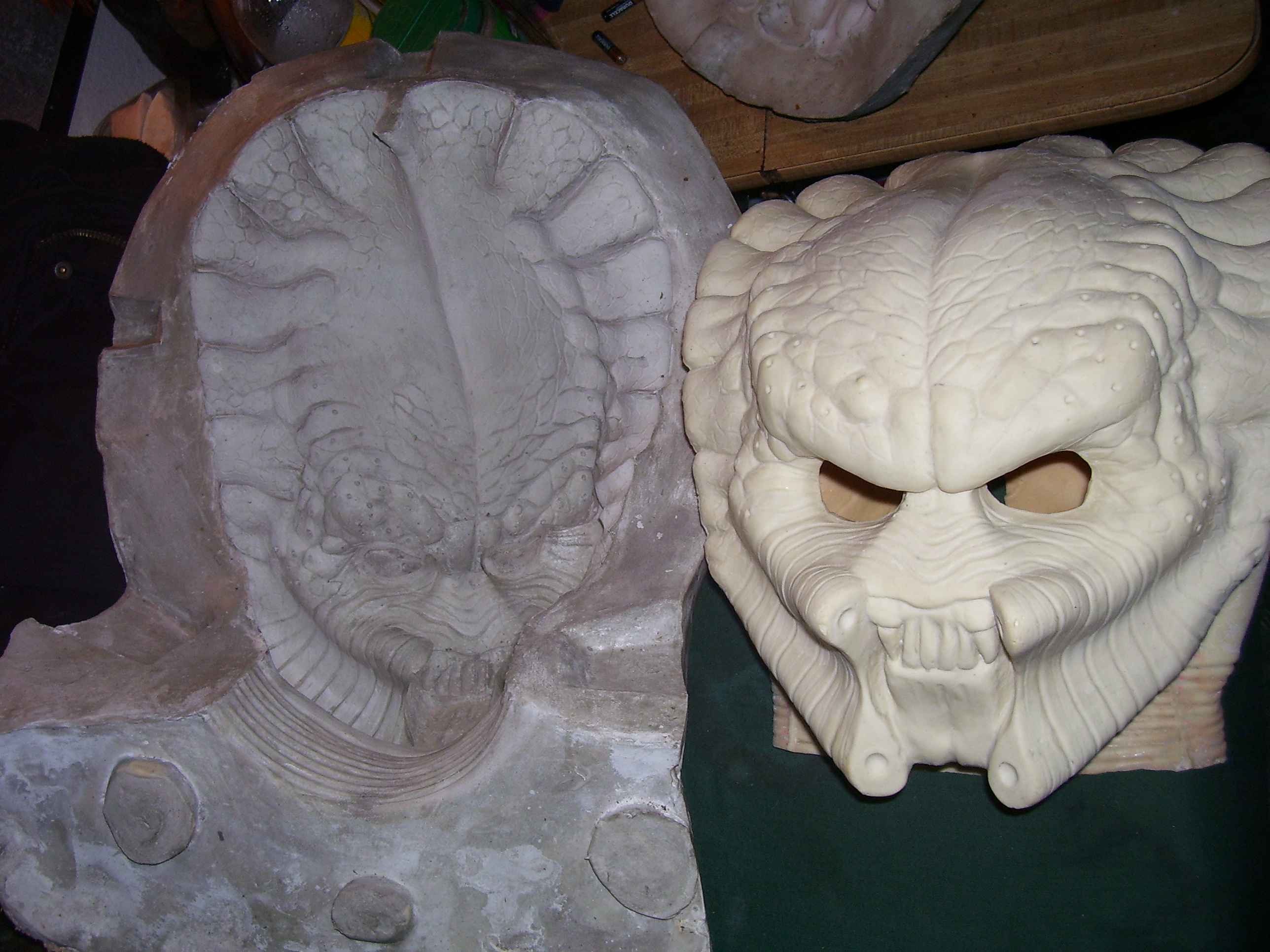

Hey here are a few more pics of the pull and the front half of the mold. This is just a raw slush cast latex pull. I am going to be making them with a soft polyfoam infill, that will take up any gaps between your head and the rubber of the mask. This should make it keep its shape, and move more naturaly when worn. I put a WIP picture of the dreads i am making. And comments are appreciated!

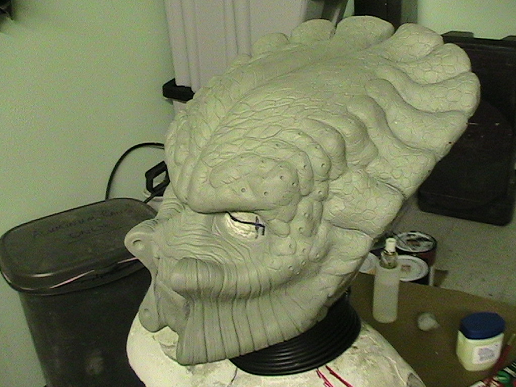

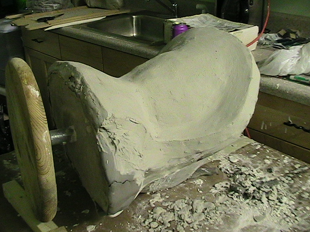

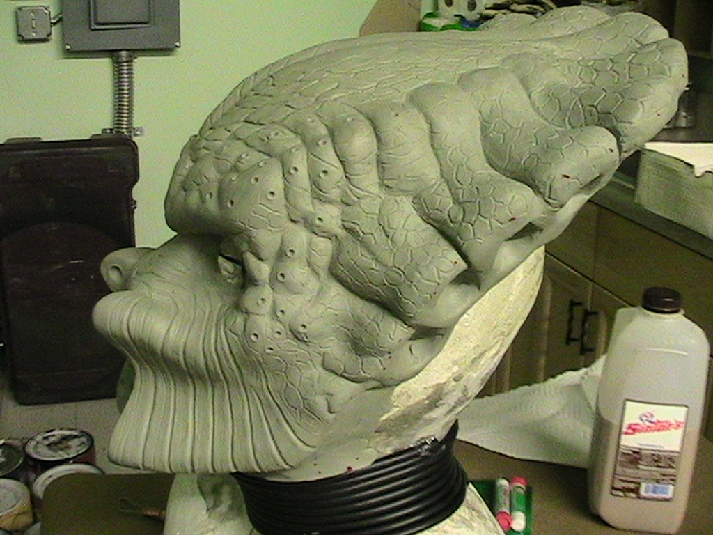

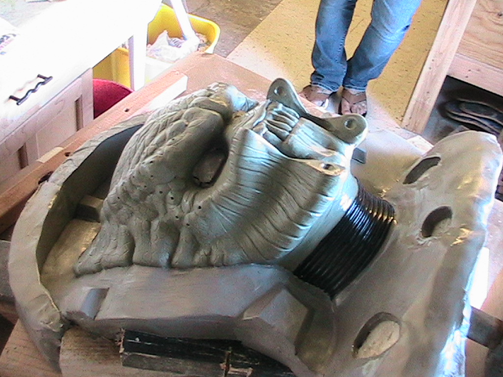

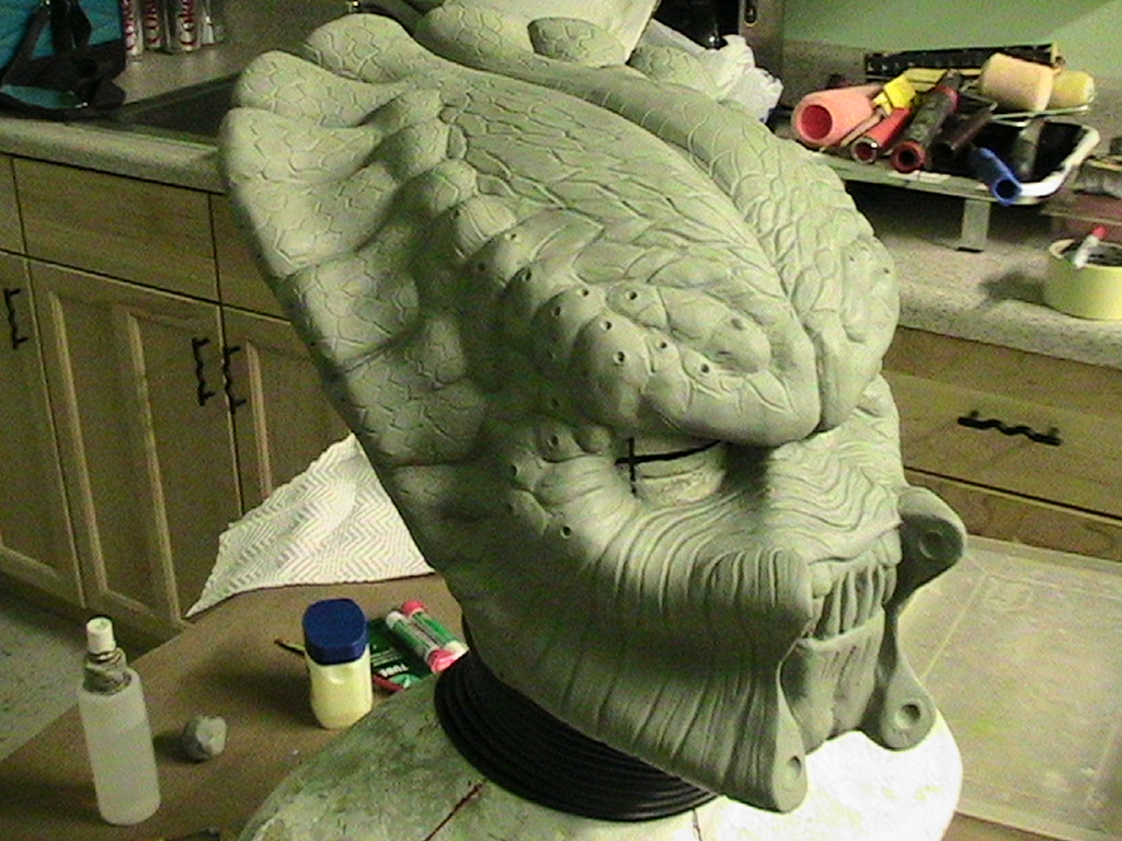

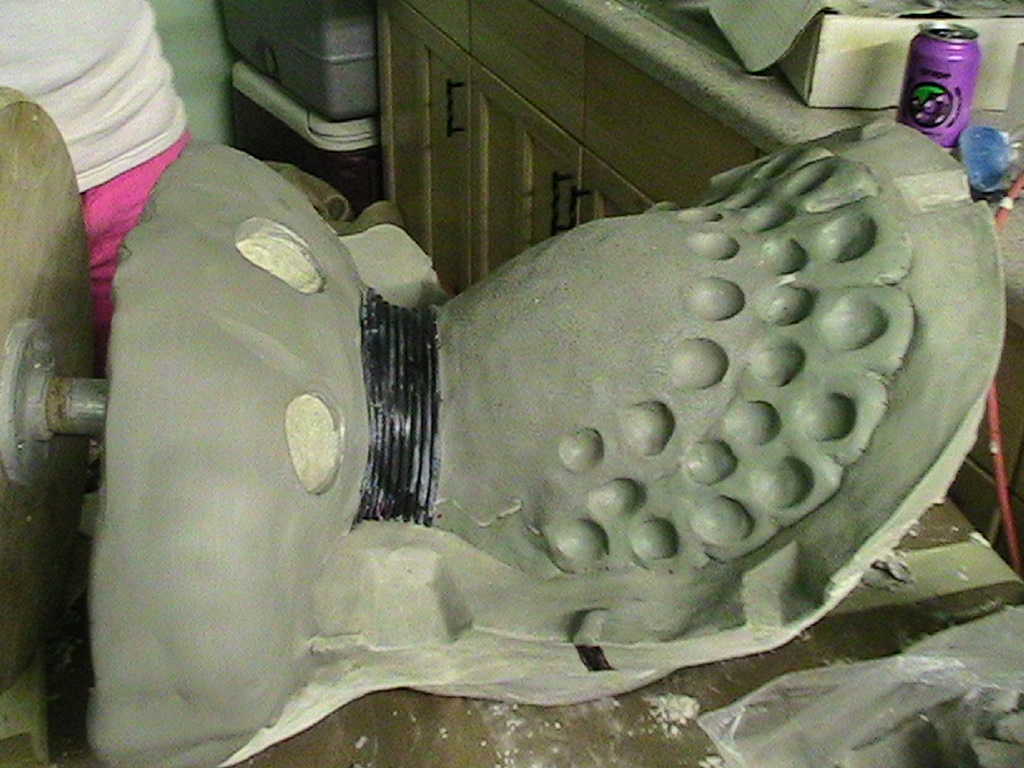

Hello all! I finaly got the pictures of the sculpture and the mold making process from my buddy so here they are! I know the order is kinda backwards, but i work with what i got lol. The sculpture was done in a number 2 roma clay, and i put up several picks of it. The molds were al done in ulrta-cal 30, backed with burlap. More to come!

Hello friend! I am not entierly sure what your question is, but i think you want to know how to start the molding process on your sculpture? I use water based clay (or disneys wed clay) to build up an edge where the highest, or thickest part is to prevent the molds from locking over an undercut. The third picture down on the sculpture post shows this. Then keys are added onto the clay to make it so the mold will lock together, withour being able to slide around on itself when you make the back. When the first side is hardened, then it can be flipped over and heavily vasalined to separate the ultracal, and keep it from sticking to itself. (next picture) I added pry points and marked them with black marker so you cant loose them during molding. Then when both sides are cured, i usualy wait overnight to give it enough time to fully cure. The longer ultracal sits the harder it gets. Then CARFULY begin to pry the molds apart!

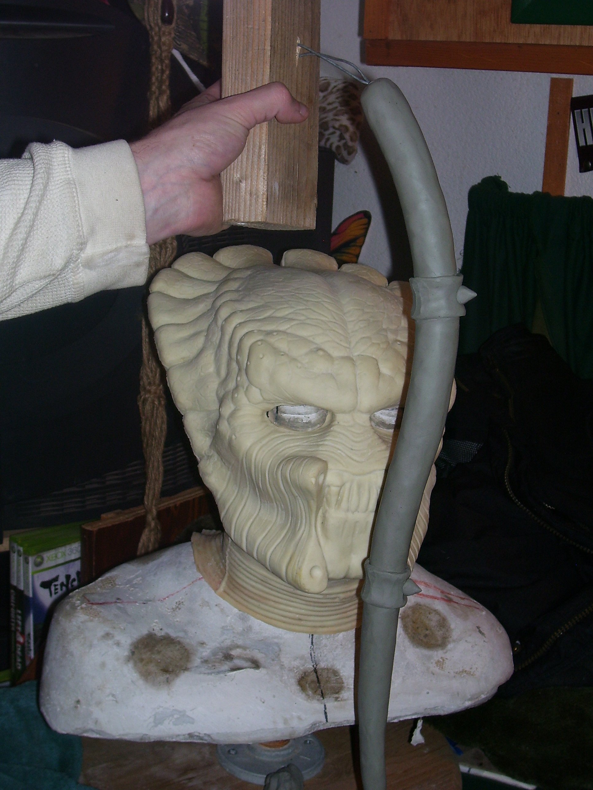

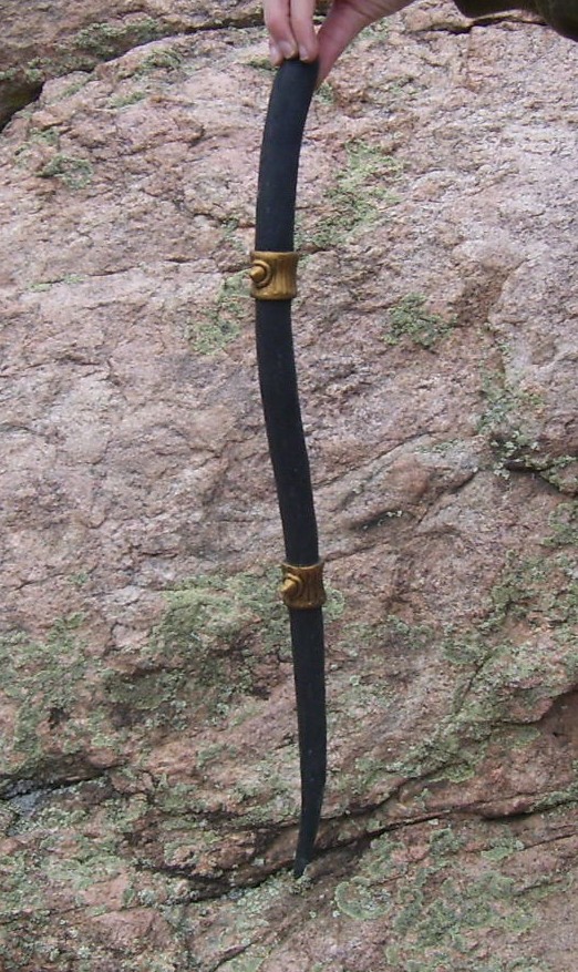

The first of the dreads have been made! I have been fine tuning thickness and polyfoam mixtures to get the right jiggle. I have been trying to shoot a little video and post it of it wiggling, but so far no luck. I will try to get it up shortly. The dreads arent fully refined yet, they still have a bit of crystal clear on them from the molds. I took a snap mold of the face, and i am almost done sculpting the mandibles. I will post those very soon as well! Thanks for looking!

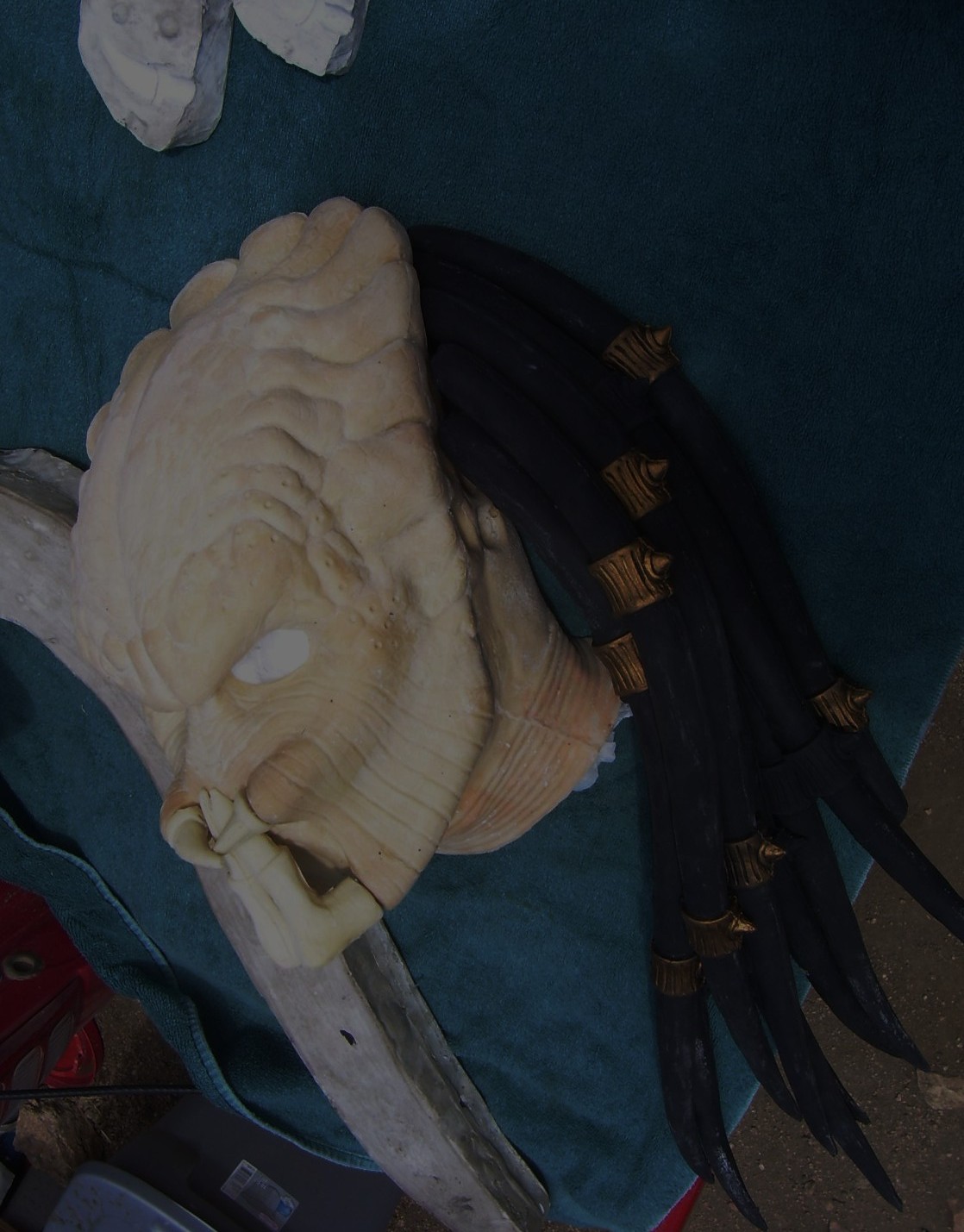

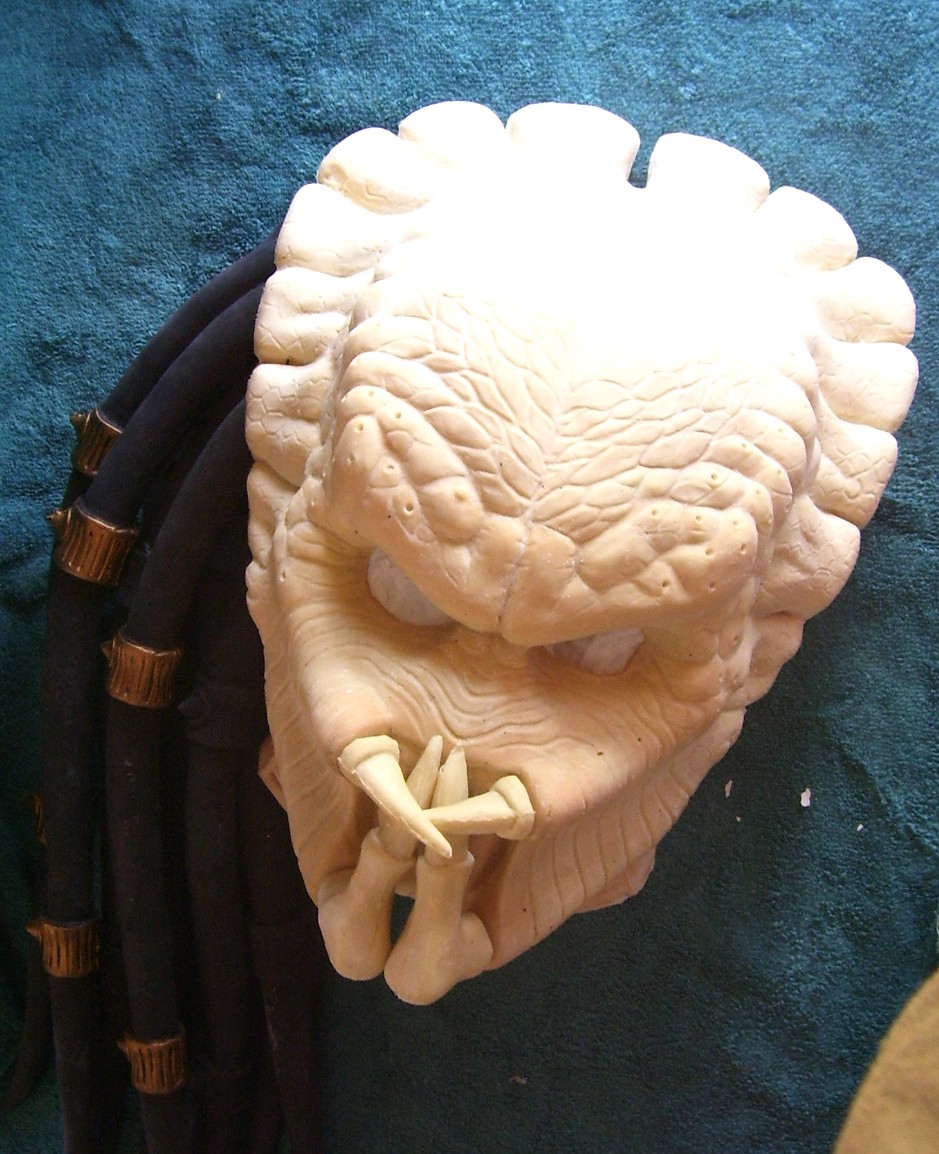

Hello again! I have been slaving over dread and mandible molds and i am almost done! I only have one dread mold atm, but i am making a few more in the next couple days. These mandibles are the first pull from the molds and are still a little rough but i wanted to post some progress pictures. They have some airbubbles and i have another set poured up but they are still drying. I ordered a new airbrush capable of spraying the rubber cement paint i will be using on it and i should be able to begin the paint up in less than a week! Keep in mind these all all just rough progress, there is still little goobs of alginate on the face from when i life casted it to make a solid base to sculpt the mandibles on. I have only been able to make 11 dreads so far but i need a full 36 for the head so i just pushed them up against it so you could see the size and look of it. The mandibles are just set on there too, thats why i had to lay it back, i need to paint the inside of the mouth before attaching them. Thanks for looking.
nice one man it looks way more kickass with the teeth in i cant w8 to see it all finished and painted mate
i have to admit it was lookin kinda cartoony before the teeth in my opinion but with the teeth thats just gone away now and become full blown kickass
