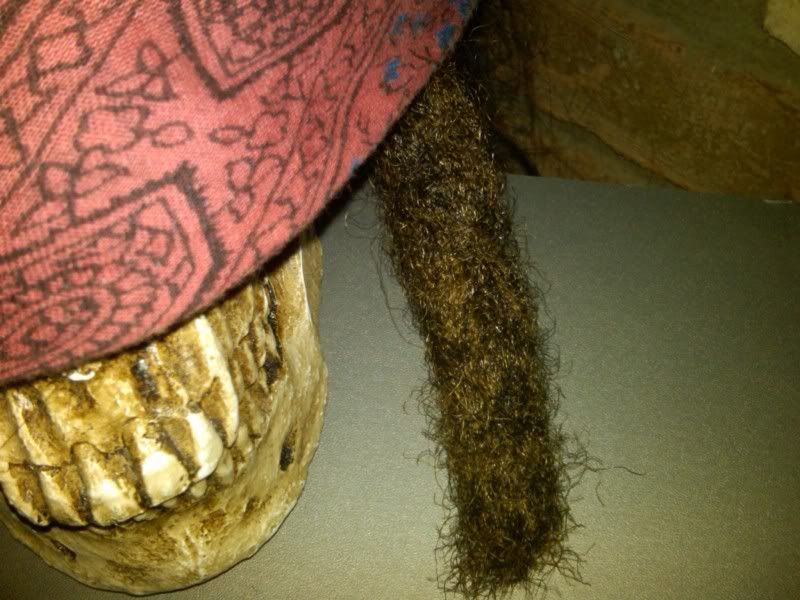

Get yourself a crochet hook, mate! You can end up with dreads that look like this, and require very little to no maintenance, so no worries about them coming undone.
I've seen a video of the crochet hook, but doesn't that just poke stray hairs back inside? How does that do anything to keep the dread twisted?
This sounds pretty similar to felting. You start with loose wool fibers, then take a needle with a small hook and you stab the wool with it repeatedly until it all knits together in a firm tight shape. I think it'd definitely solve your unravelling problem.
Talk to Angel about it next Saturday - she's the felting expert and can probably give you some good advice.
I tried out the crochet hook on one of my dreads and it definitely helped. The hair is way straighter than the stuff in your dread there so it doesn't look like that at all, but it seems to be mostly holding together. If I had more time left I'd put more time into crocheting each dread, but unfortunately I don't. Here's where I'm at right now:
