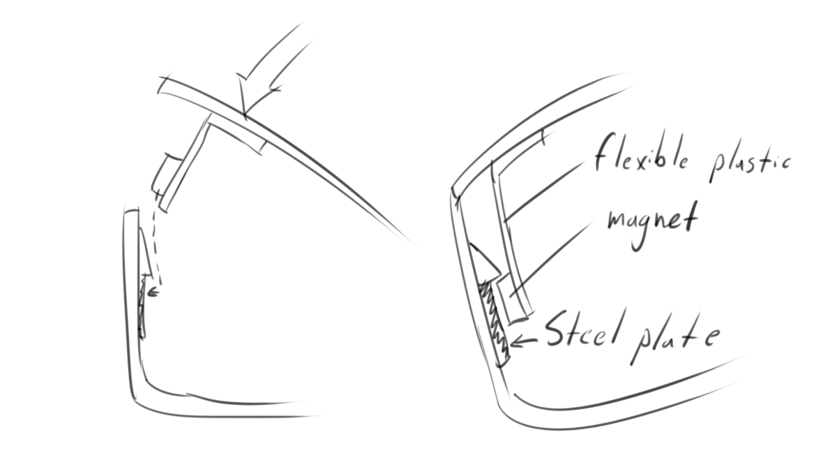

First things first: Holy crap what gorgeous work. Seriously so detailed and smooth, I applaud you. I would love for my next set of gloves to be this good. That in mind I have questions like how are the fingered exactly attached? I saw you have the elastic at the base but it looks like that only is used there and you talk about using fishing line? Also what kind of magnets do you use to act as the latch? I used some rare earth metal magnets but my glove would pop open. Do I need stronger magnets or a bigger glove? I also had issues getting the magnets to stick using hot glue or super glue (gorilla glue too). Final thing what kind of batteries? I know you said flat coin type cells but is there a particular model and did you need anything else besides the light and the battery?

As for the locking, I use a rare earth magnet thats also held into place by a wedge to keep glove from opening. I would show you a photo, but thing is it's currently broken :p Hopefully a quick scribble will do:
When the glove is closed, the magnet slides over the wedge and then snaps onto the steel plate.
I use super glue. It usually works ok if you roughen up the magnet surface with some sanding paper.
