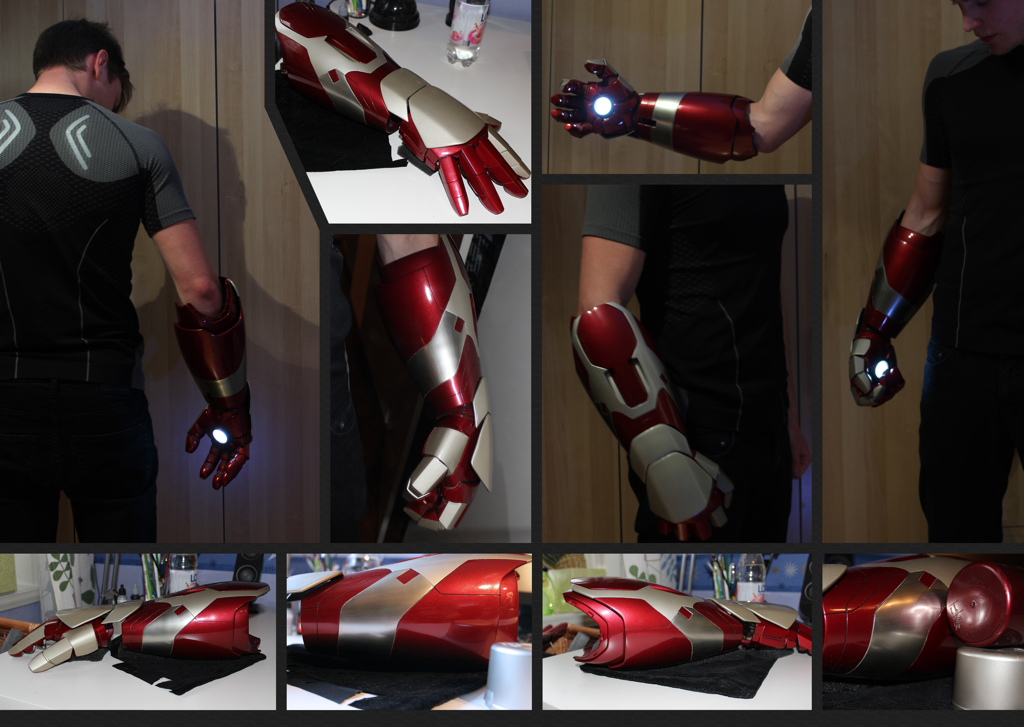

My Mk. 42 build, new STL files for upper arm section

How did you make the wrist? And can you show us how you connected that g4 bulb to your power supply? Keep up the great work!
The wrist is made of the same material as the inner glove; ribbed silicone sheets. The member Mockle has started selling them: http://www.therpf.com/f13/ironman-glove-ribs-red-black-silver-194053/

Hi Abb, I've got a few questions about the LED panels that you used in the hand for the repulsors:
1) How wide are they?
2) How thick are they?
3) How did you attach them to the palm?
4) How did you power them, and where did you store the power supply?
Also, how did you attach the glove piece to the forearm, and the hand plates to the glove?
Thanks, and keep up the great work!!!
2) How thick are they? -
These are the ones I used: G4 T10 9 12 24 LED 3528 5050 1210 SMD Light Lamp Bulb Cold Warm White AC DC 12V | eBay
I don't have the measurements in my head, but I would guess around 3cm in diameter and a couple of mms in depth
3) How did you attach them to the palm? - Just some hot glue and a frosted plastic disc on top
4) How did you power them, and where did you store the power supply? - I use a couple of button cells that right now is taped on the inside of the palm above the thumb.
Also, how did you attach the glove piece to the forearm, and the hand plates to the glove? - The glove isn't attached to the forearm at all, and the plates are held in place using magnets.
What kind of paint/technique did you use to get that brushed metal look? It looks fantastic!
Thanks!
I used Alclad II Titanium-Gold chrome paint on top of a brushed gloss paint.
This is absolutely beautiful! Similar to the above question, what colors did you use for the red and gold?
It looks spot on and I want to use those colors for my 42 helmet. Thanks!
IIRC the red is Mica Red Metallic and the beige is Volvo Lunar Gold Metallic

Did you use the g4 LEDs with the pins on the bottom or did you bend the rods on the sides?
I desoldered the pins and attached wires.
