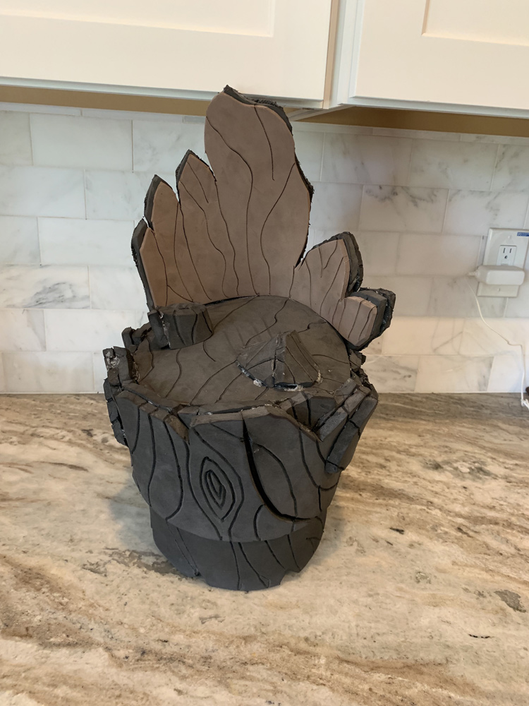

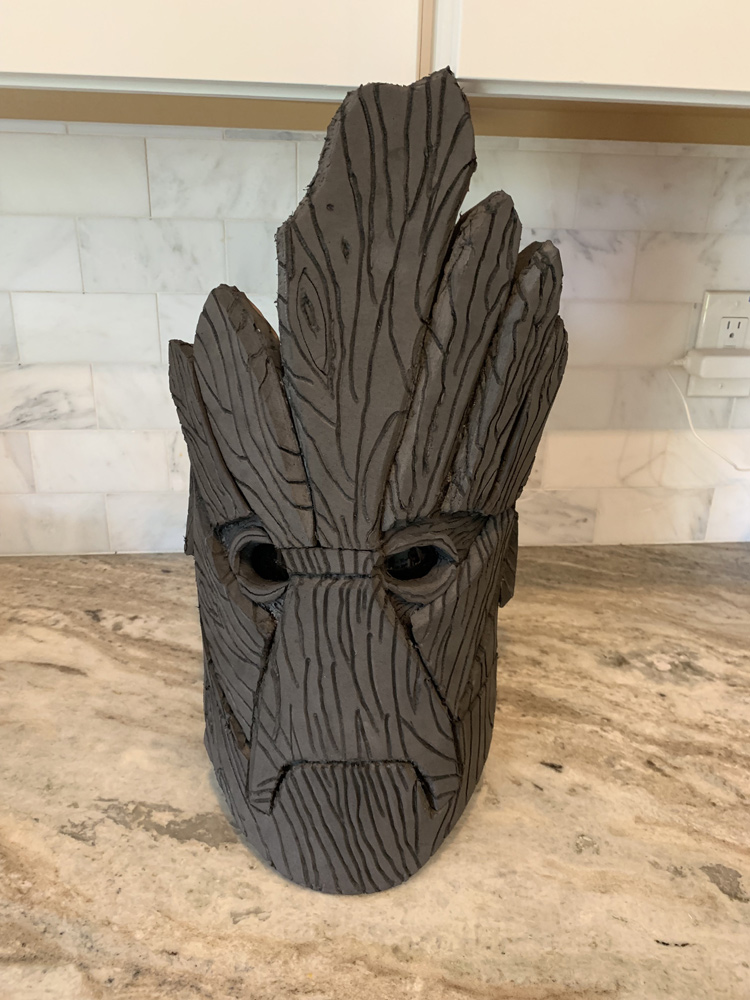

I started with a couple thin sheets of hobby foam but I could only find the puzzle mat foam in black so I redid the face with the same black puzzle mat.
The puzzle mat foam is black although it looks brown in the photos.

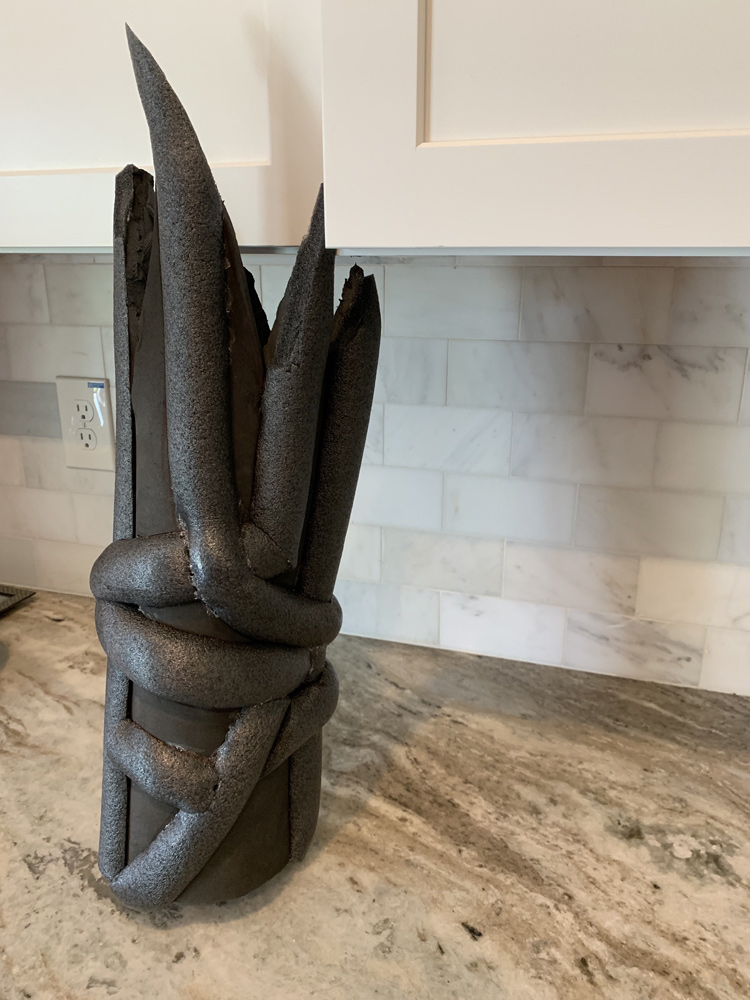

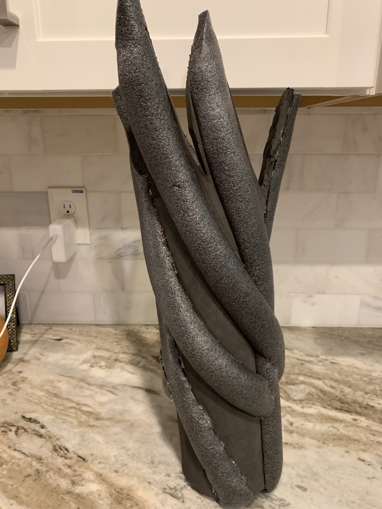

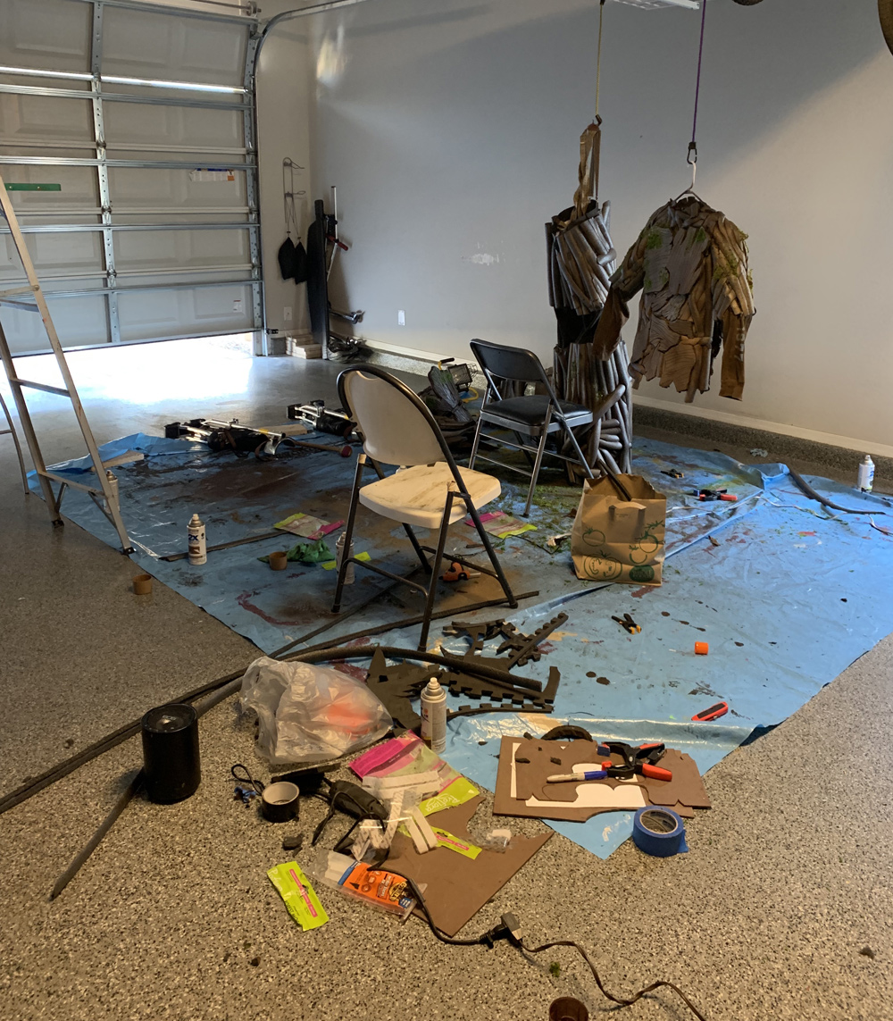

Start of forearms
Right forearm before dremel
Left forearm before dremel

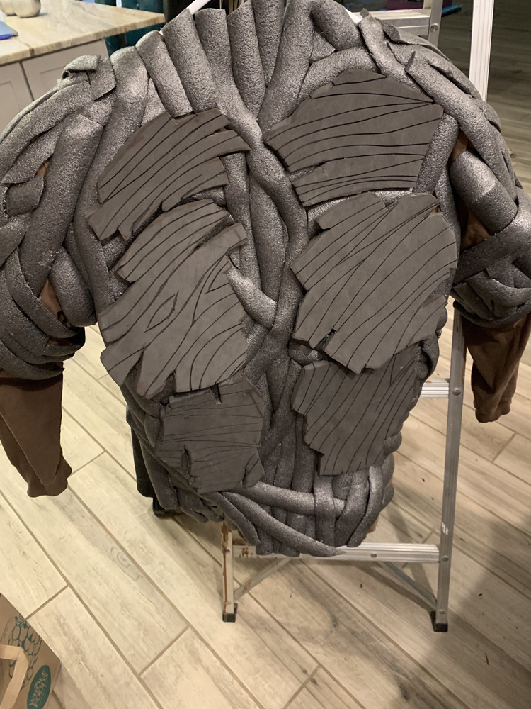

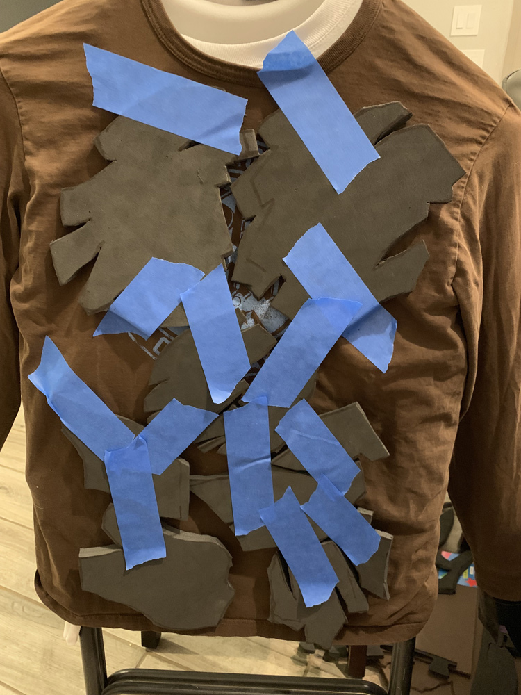

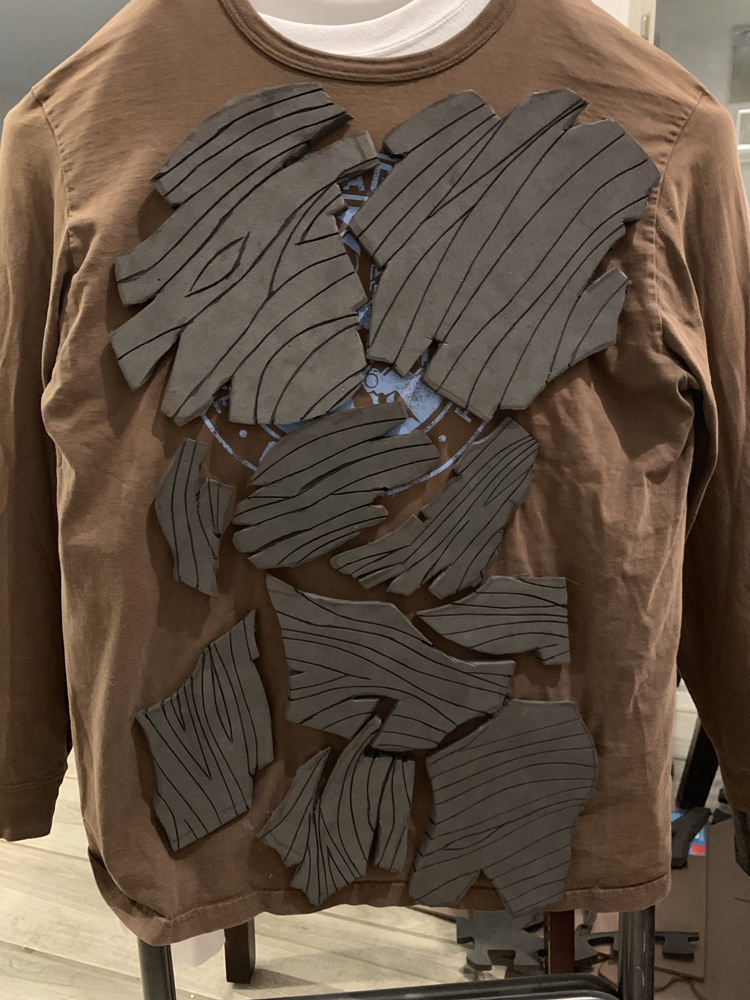

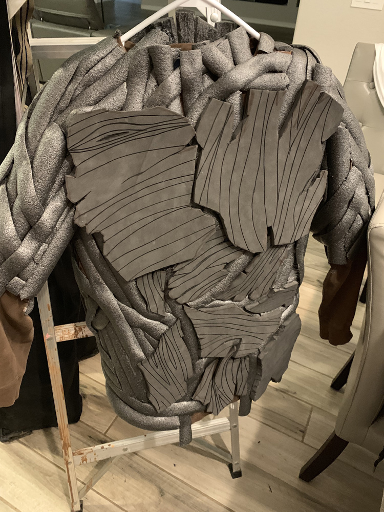

Laying out the chest and stomach pieces before gluing them
Front pieces dremeled and then glued

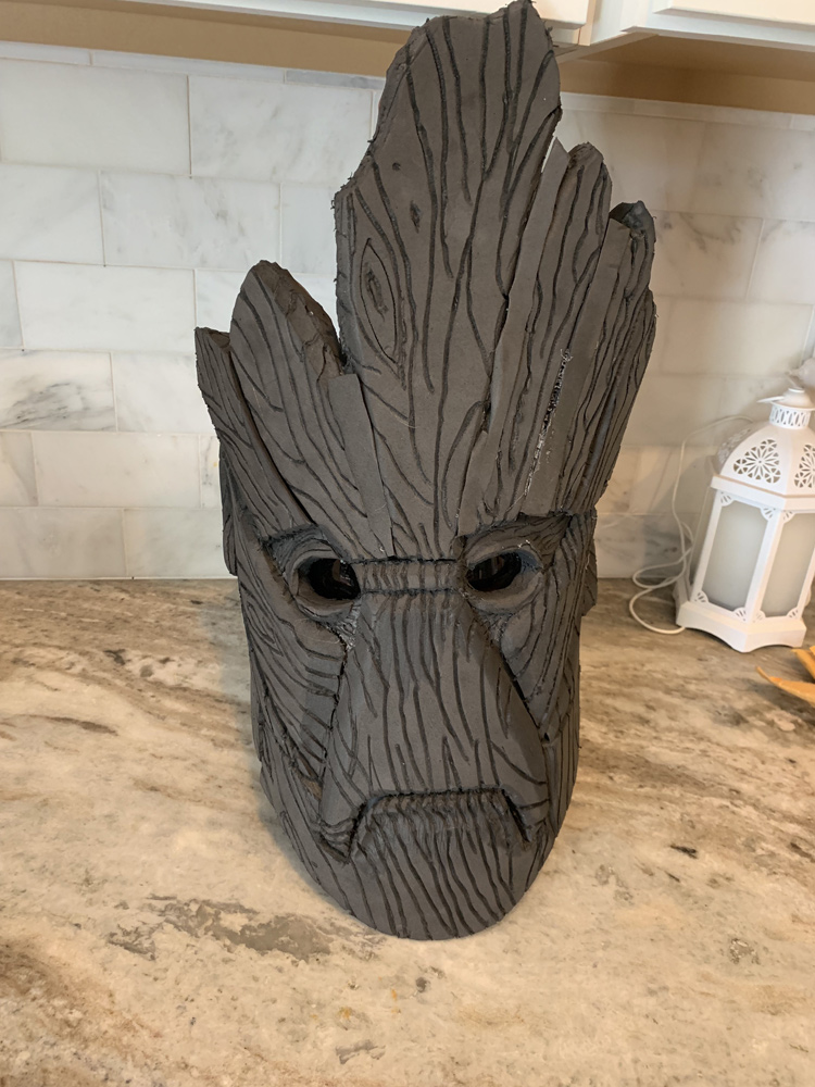

Trying on the shirt with the mask. Later in the build, I ended up taking a heat gun to the mask to pull in the cheeks and make the face more narrow.
A little more work on the face, still prior to heat gun and pulling in the cheeks.

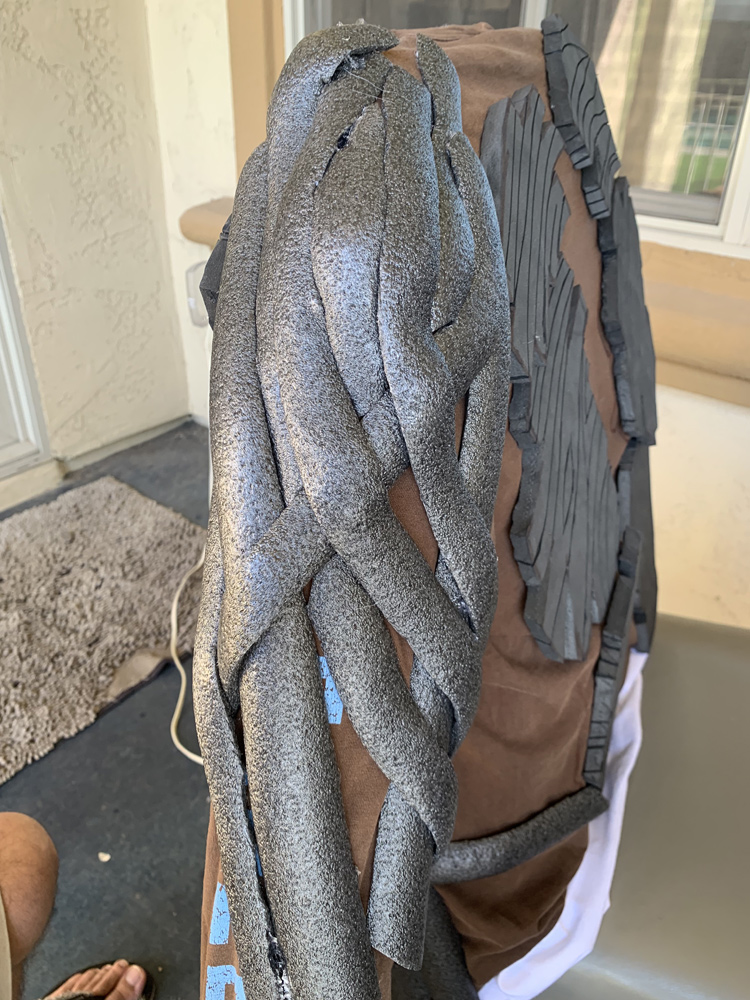

Completed front

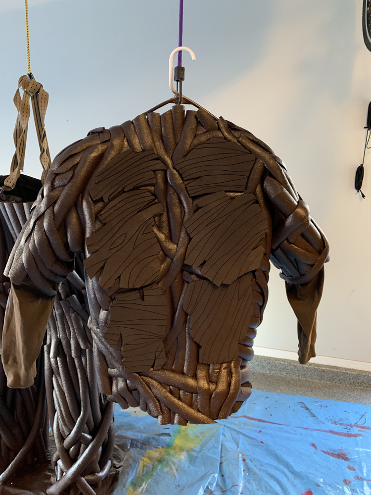

Completed back

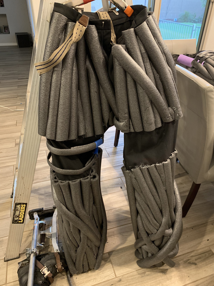

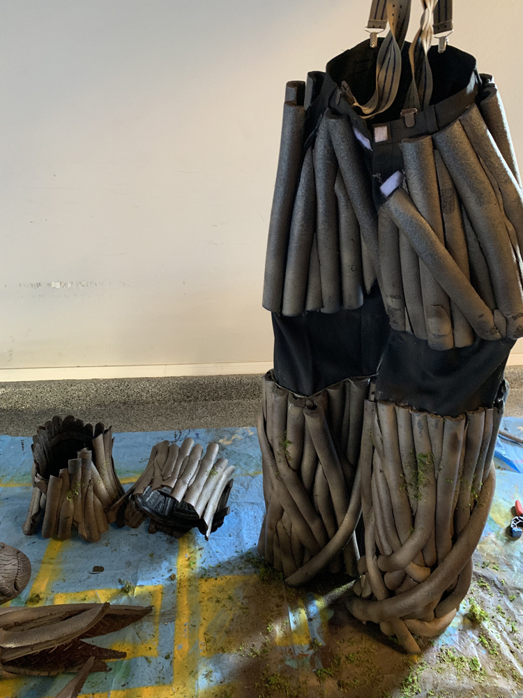

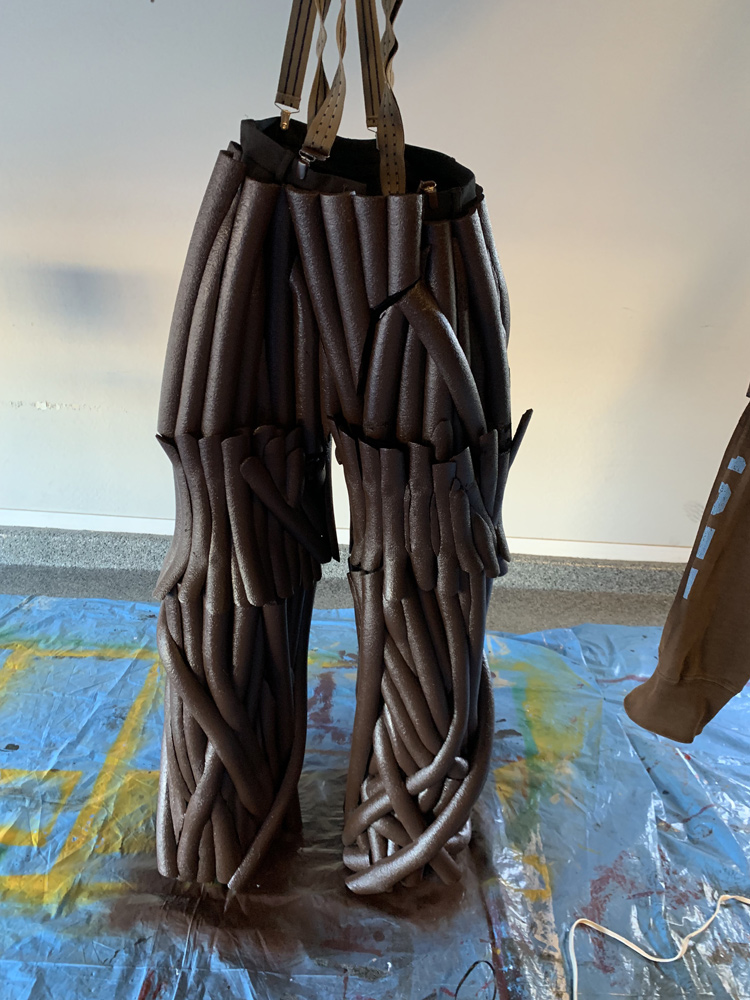

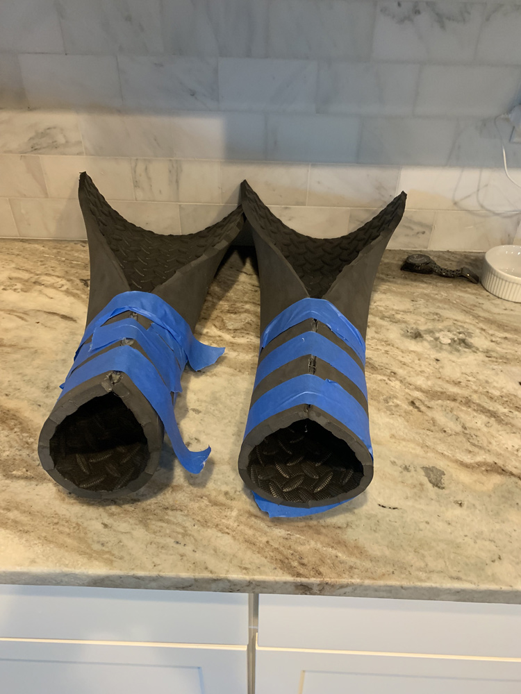

Here is one place that I deviated from the original build that I was following. My stilts are drywall stilts and I have to be able to reach them to lace up my boots and pull the stilt straps tight. So I left the kneed area empty on the pants and created knee brace types that I could velcro on after the pants and stilts are on.
Knee brace #1

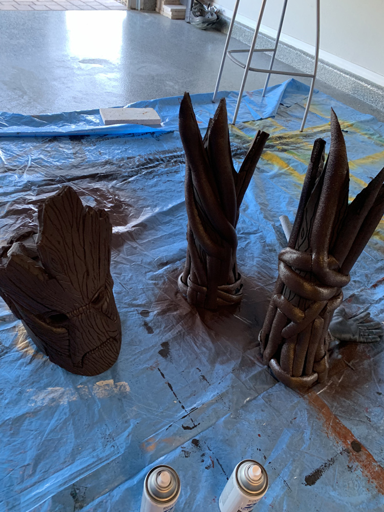

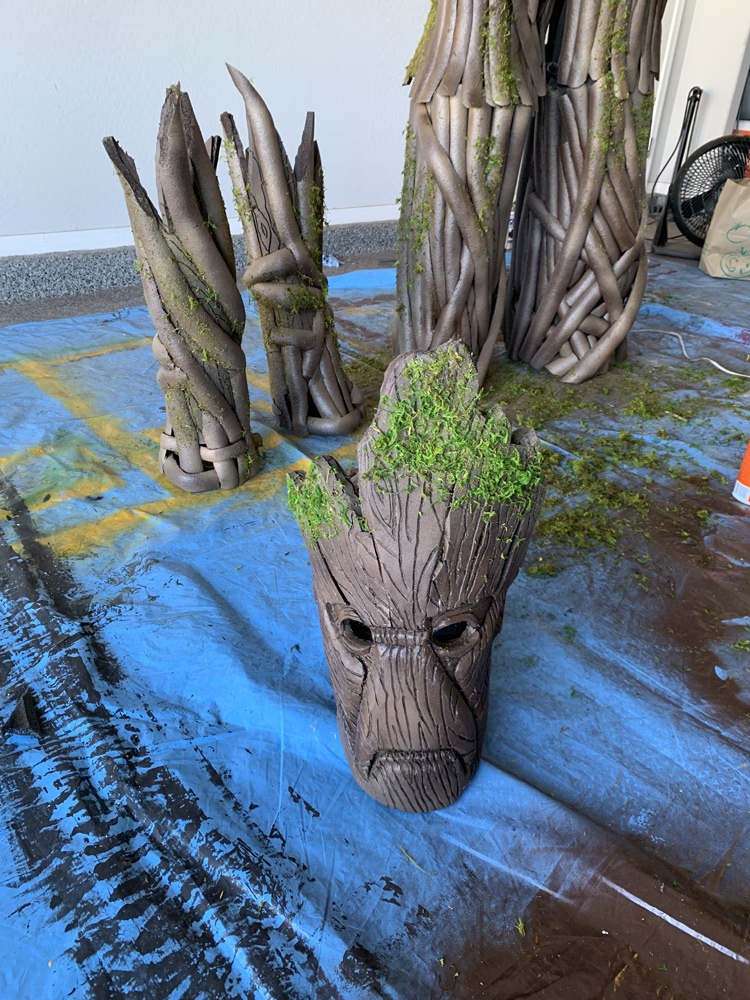

Base coat of brown spray paint

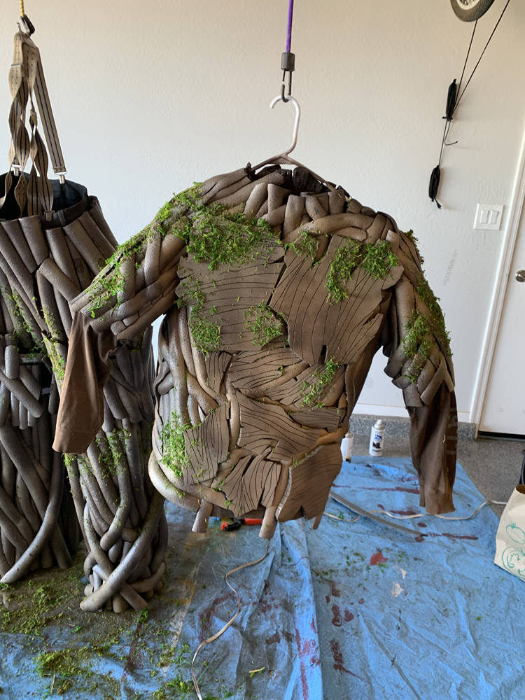

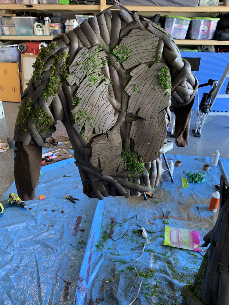

2nd coat of paint with light brown and then elmer's spray glue and moss
Narrower face after heat gun

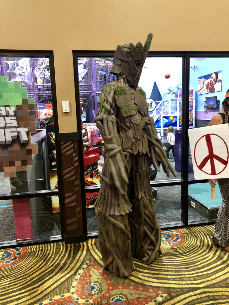

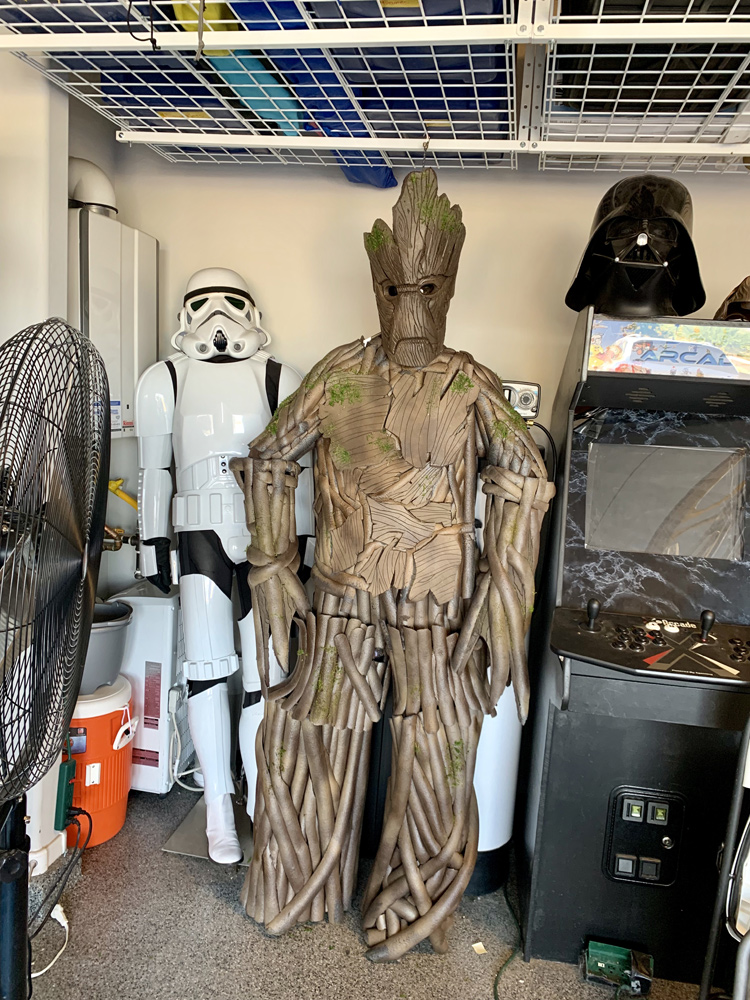

Here is the completed build, hanging from bungee cords.
I bought a wood pattern balaclava and compression shirt. The balaclava definitely came in handy as the back of my neck would have been showing otherwise.
Knee brace #1
