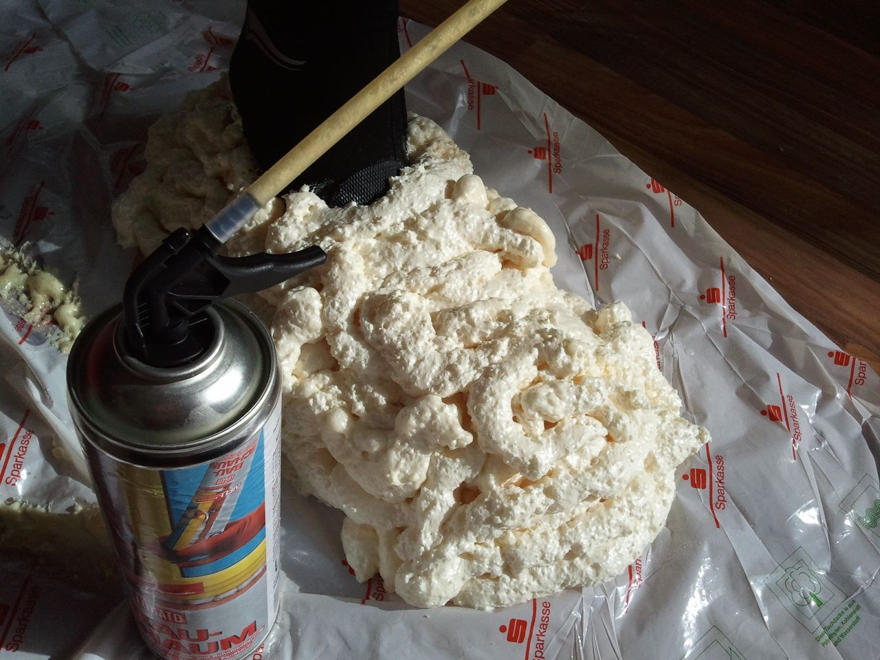

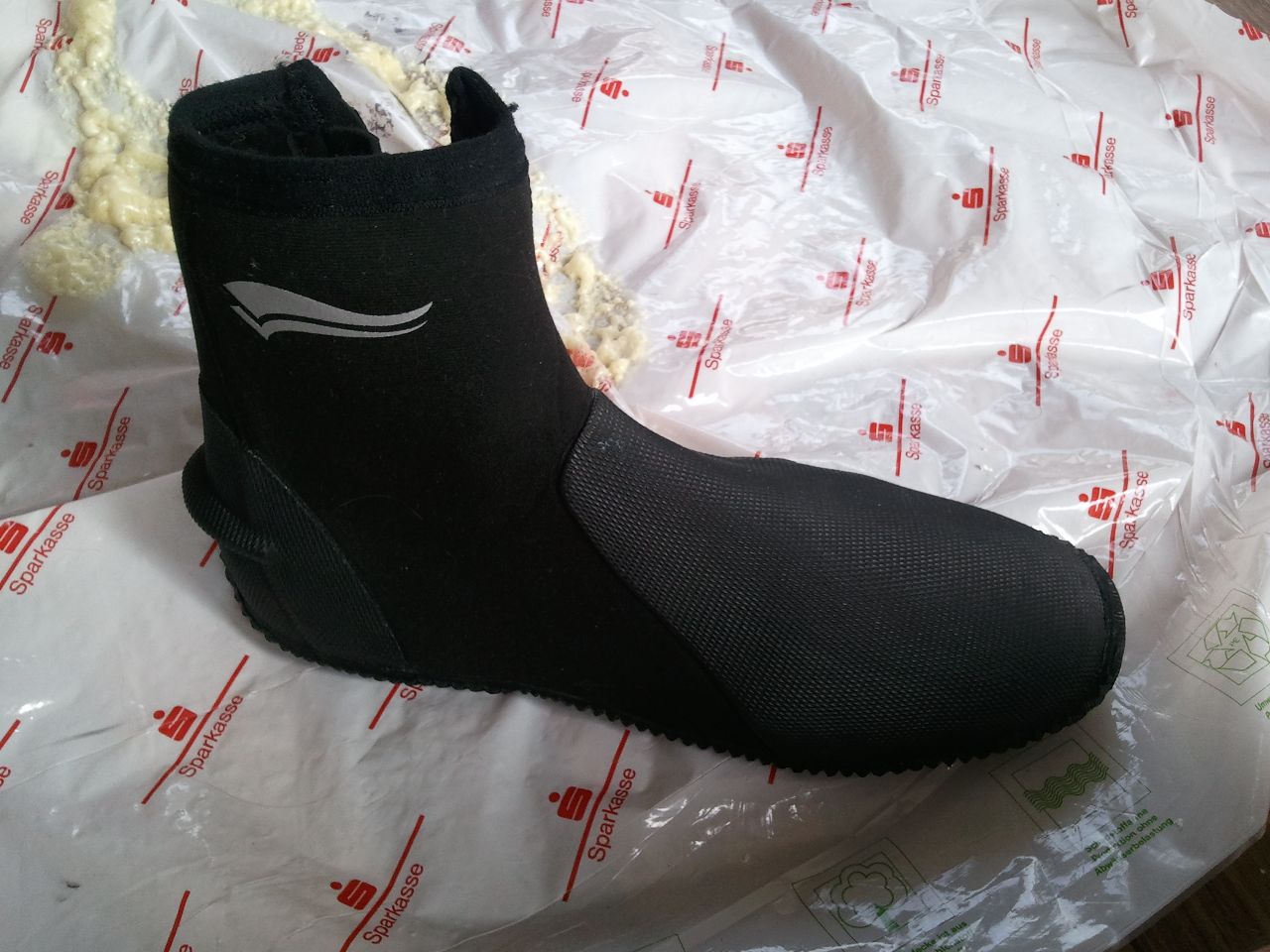

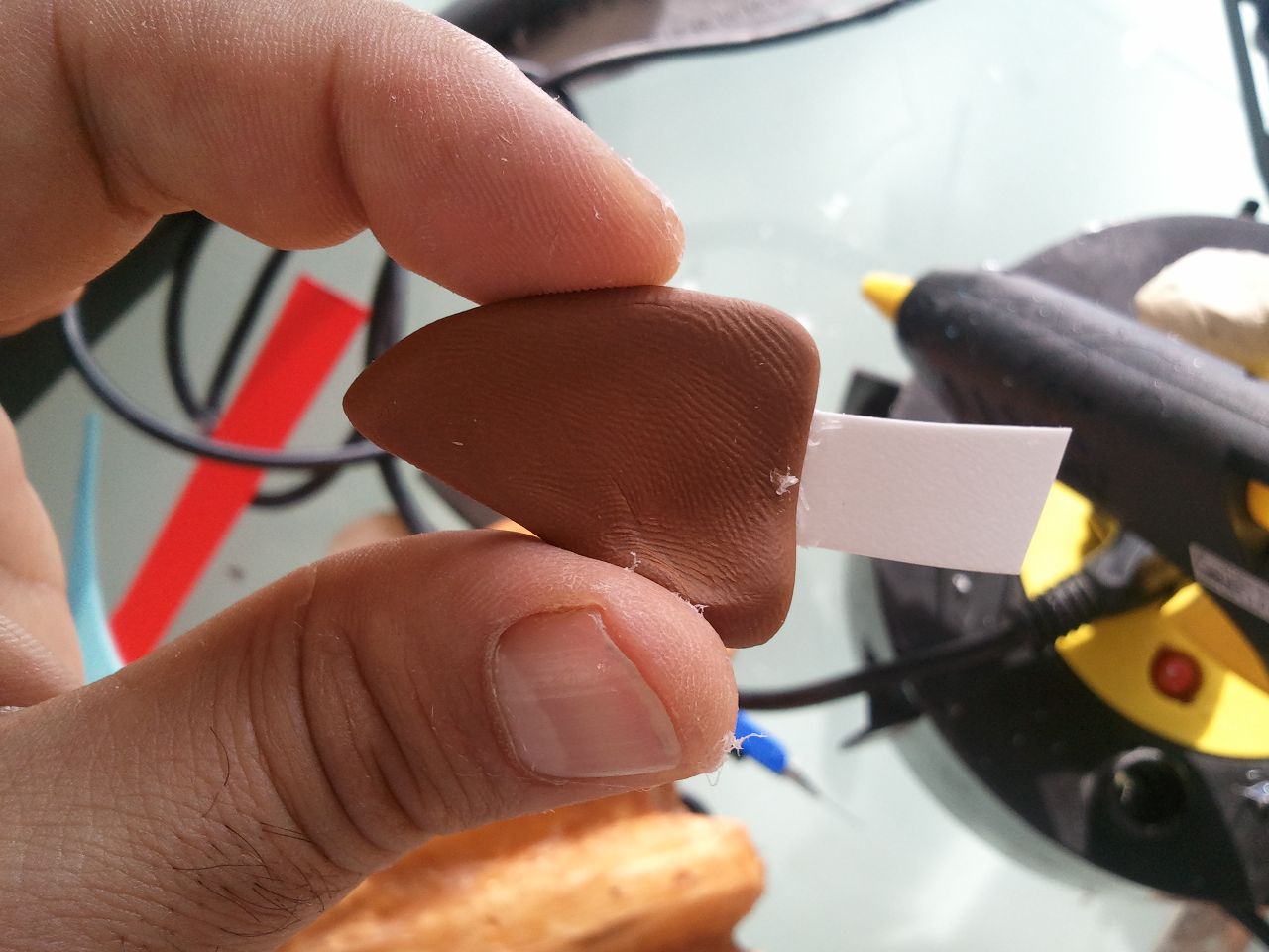

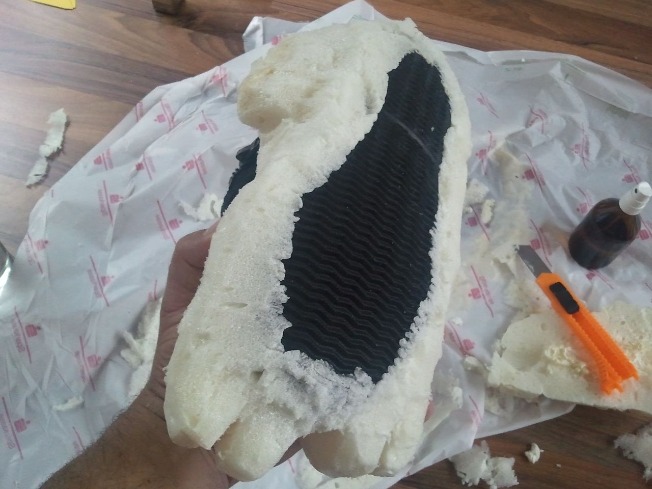

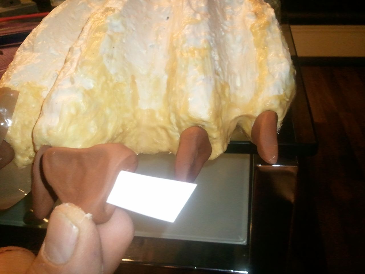

1. Bought some cheap neoprene surfer shoes & a can of polyurethane foam (uised for sealing windows...)
2. Stuffed the shes with some old socks ans sprayed the foam all around the shoe
3. let it dry (some water sprayed on the foam helped to speed up the process)
4. cut out the basic form auf the P1-Feet, then get step by step closer to the final look
5. make some nails from FIMO, insert a thin piece of plastic (old yoghurt pot) to get a slit in the FIMO
6. FIMO in the ofen, get it out glue the plastic peace in there
7. sand the foam
8. put latex on (2 - 3 layers of thik latex paste)
9. let it dry then cut slits in the latex and foam, plug the FIMO-nails with plstic strip in there (hot clue)
10. paint it with acylic paints, I used airbrush colors
11. Seal it with LIQUITEX MATTE VARNISH (I prefered matte cos I didnt like the shiny style...)

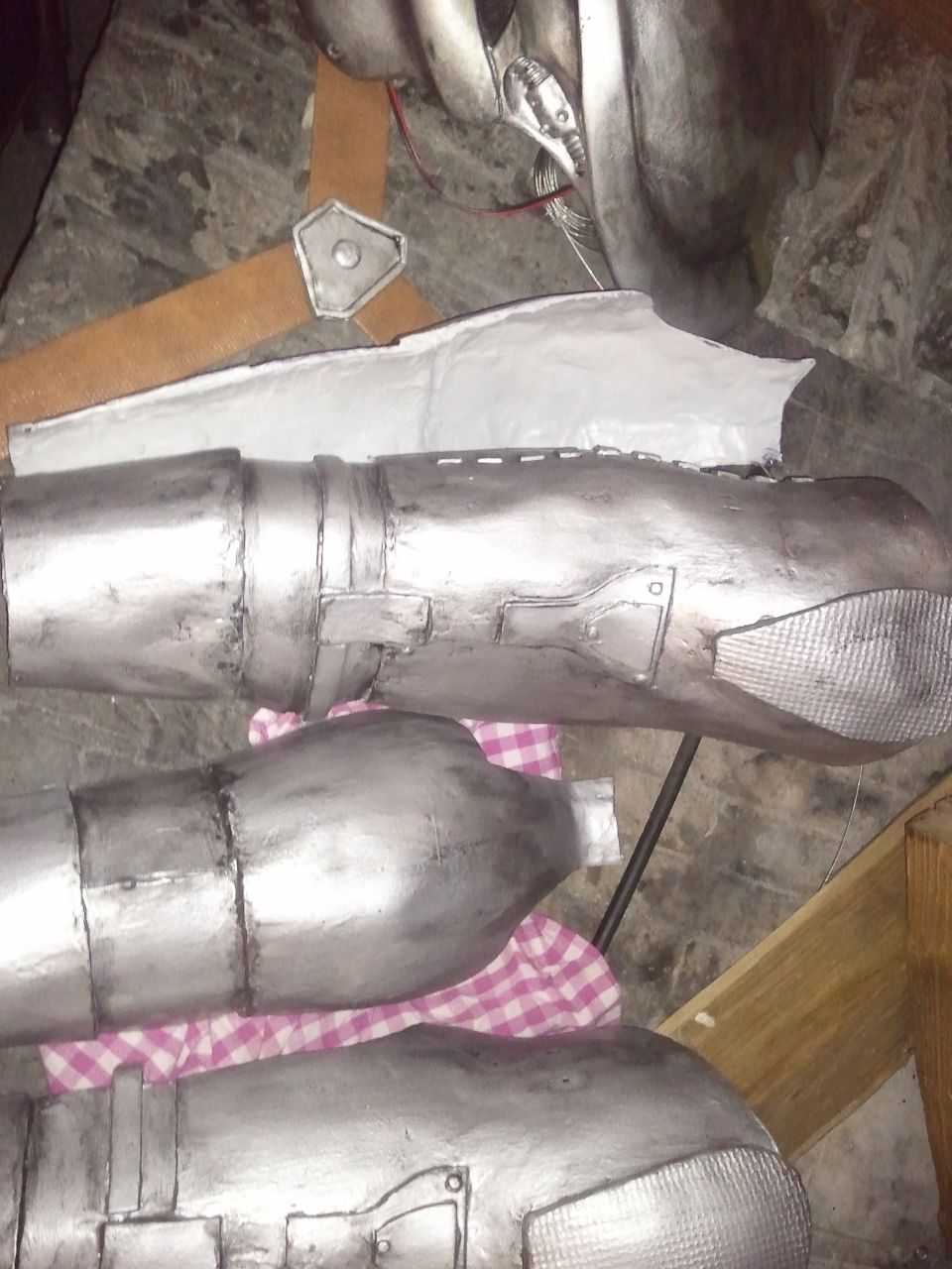

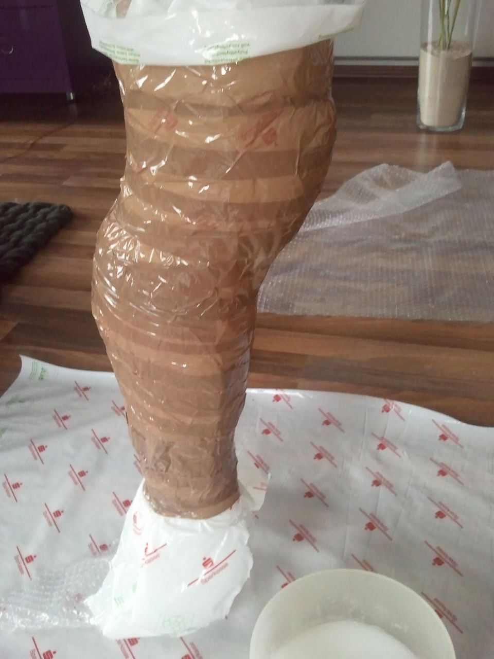

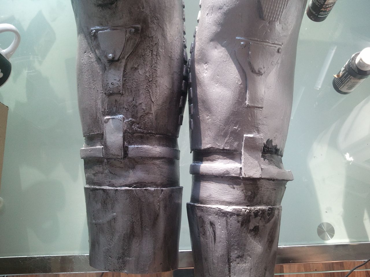

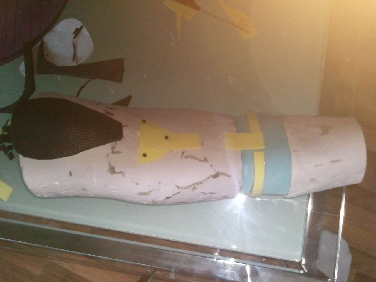

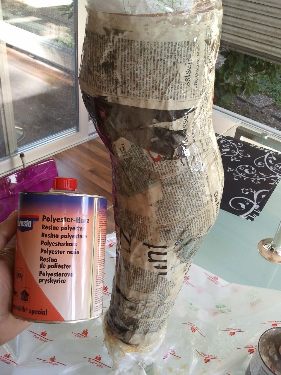

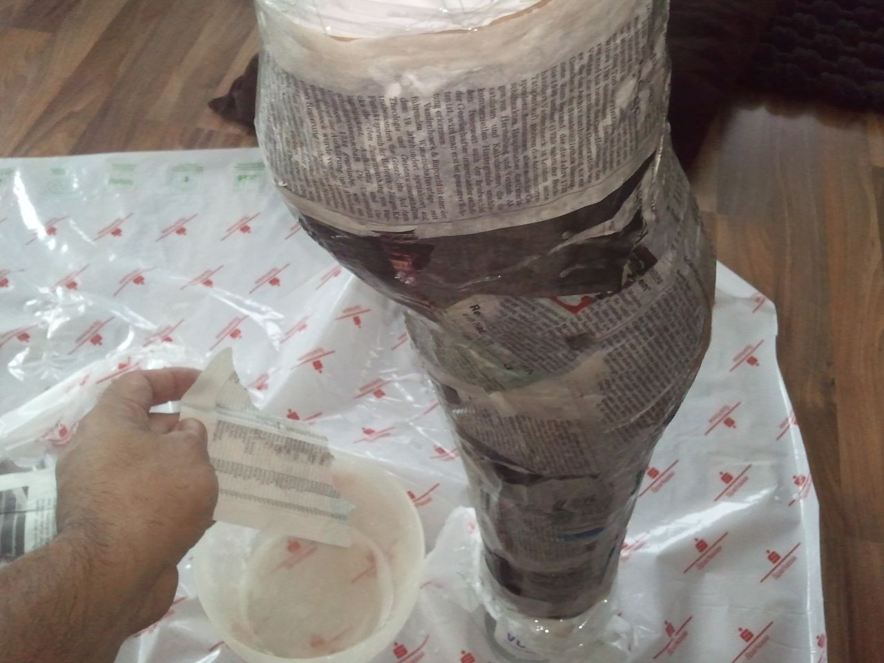

1. Put some heavy high socks (tubes) on
2. make a tape dummy, covering the whole leg
3. pull leg out and stuff it with paper or old clothes or something
3. use newspaper and a white children glue and cover the leg with 3-5 layers, let dry
4. put resin on the dried cast, inside and outside (I dindnt use resin mat, just the fluid.)
5. put some filler / surfacer / putty on the cast to create a surface
6. Cut it up/down in a nice shape and around to cut the lower part from the rest
7. hot clue a fomie part / spacer in the lower part
8. clue foamies on the cast more r less similar to the original
9. put PLASTIDIP (I used a can) on the cast with foamies
10. paint it with hammerd silvermetal spray can and after that with transparent airbrush color black

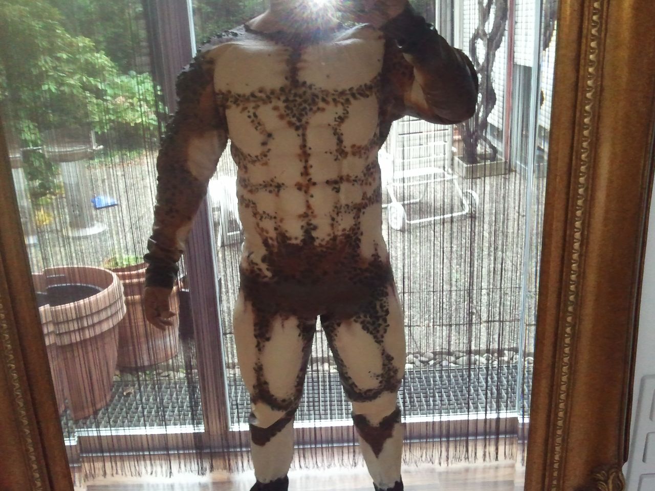

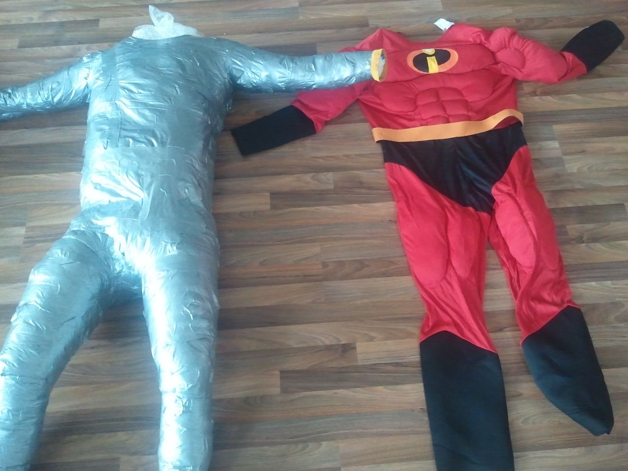

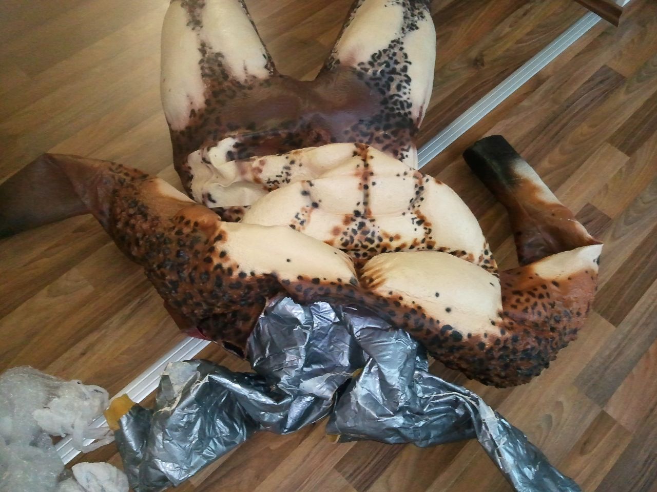

Basically I followed the wonderfull Mr.-I tutorial(!)
I just discovered that the suit shrings arount 10 %, so buy a suit with a little space!

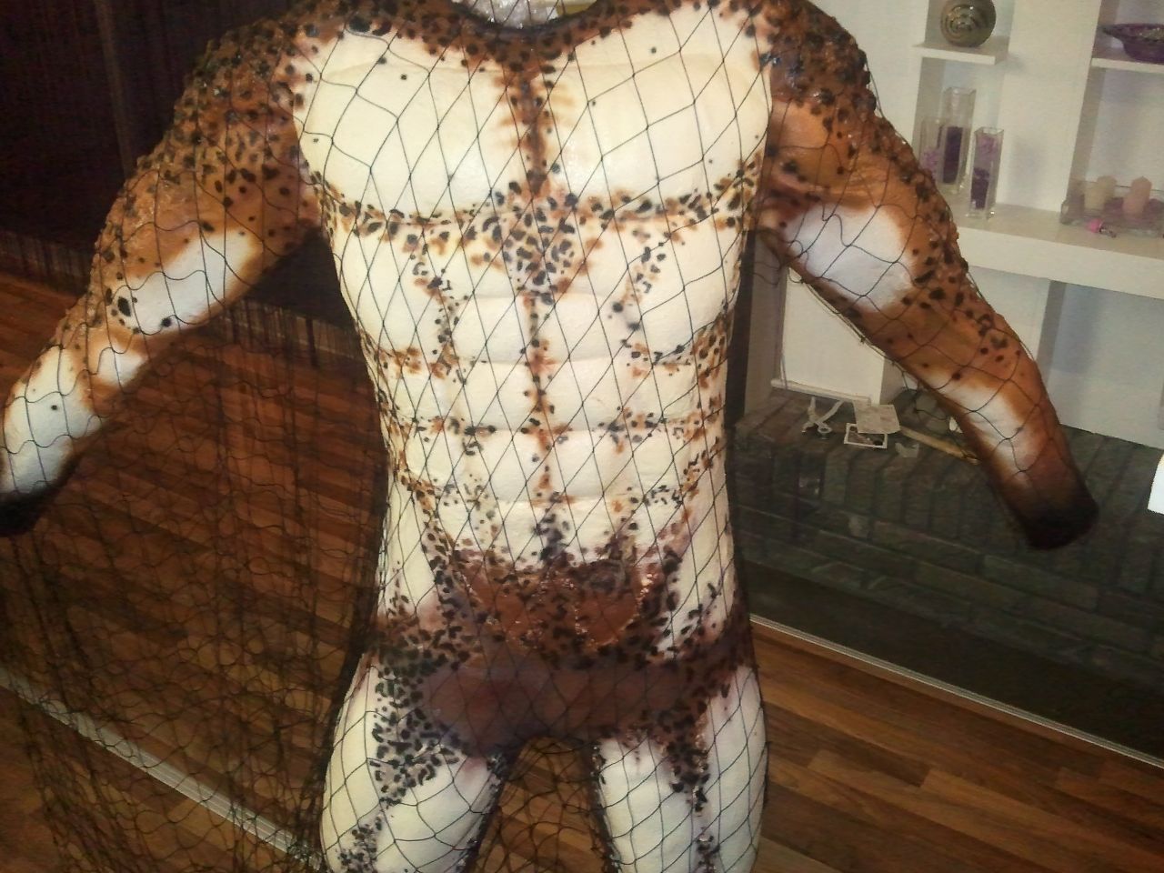

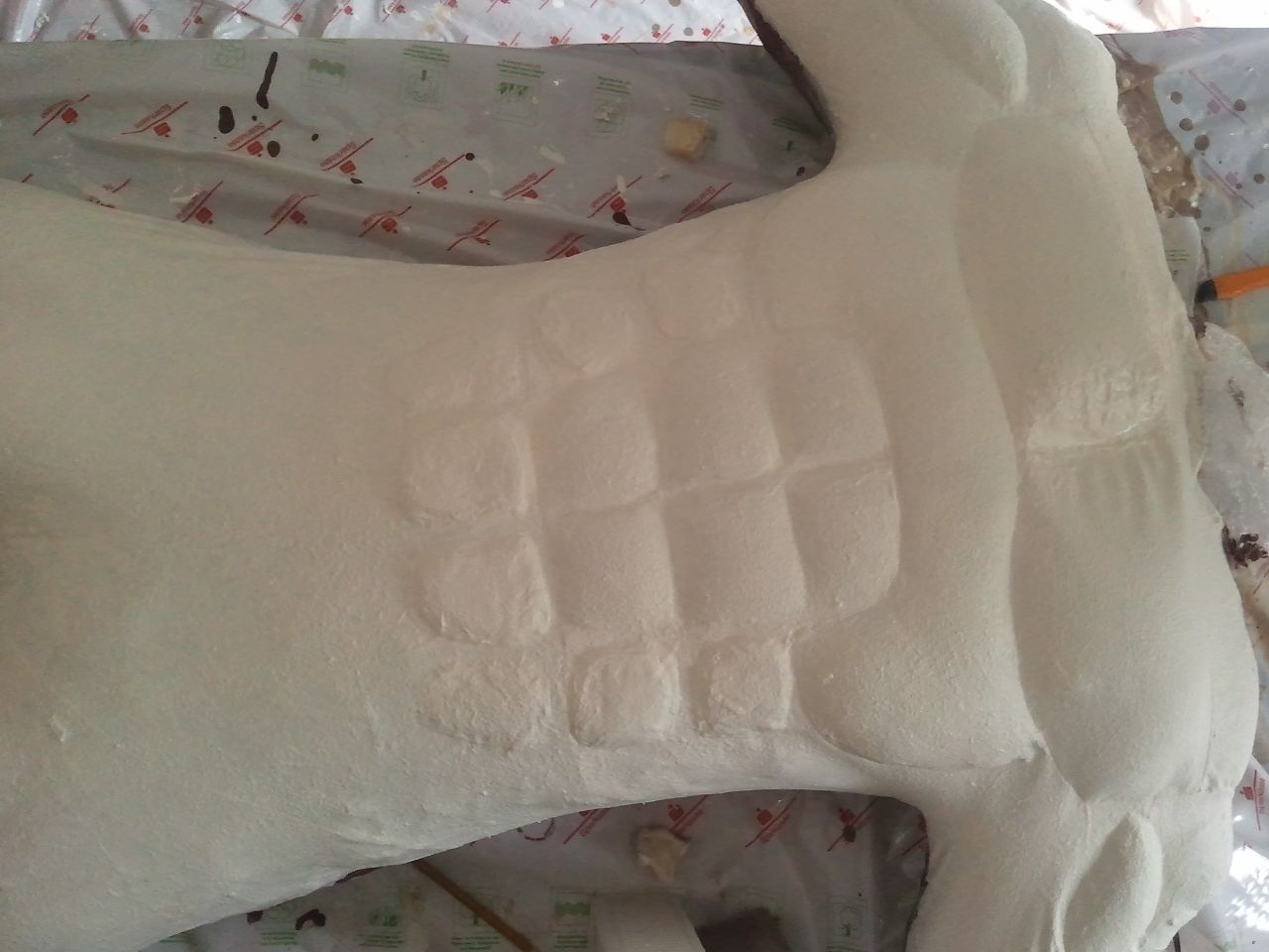

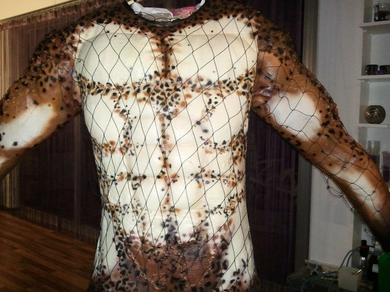

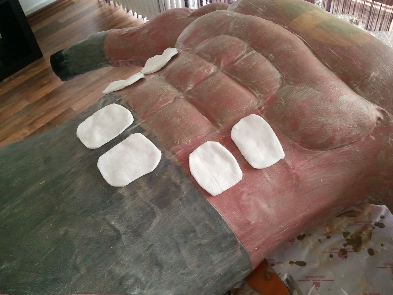

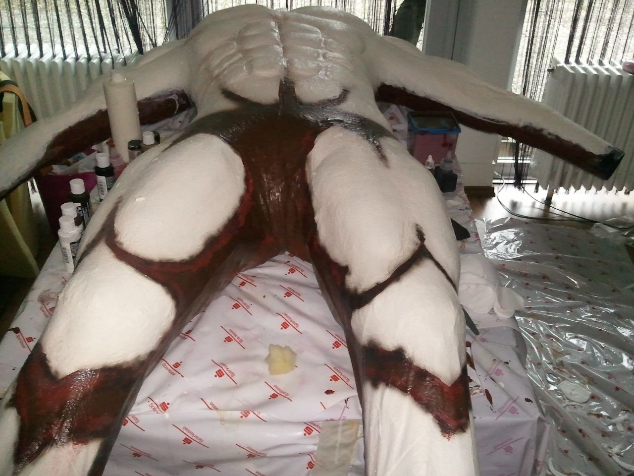

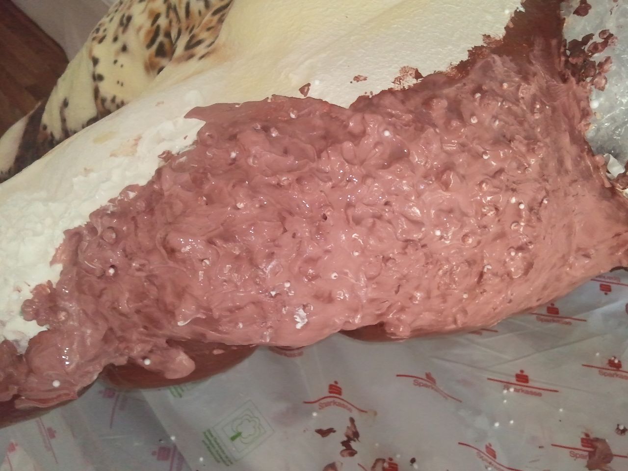

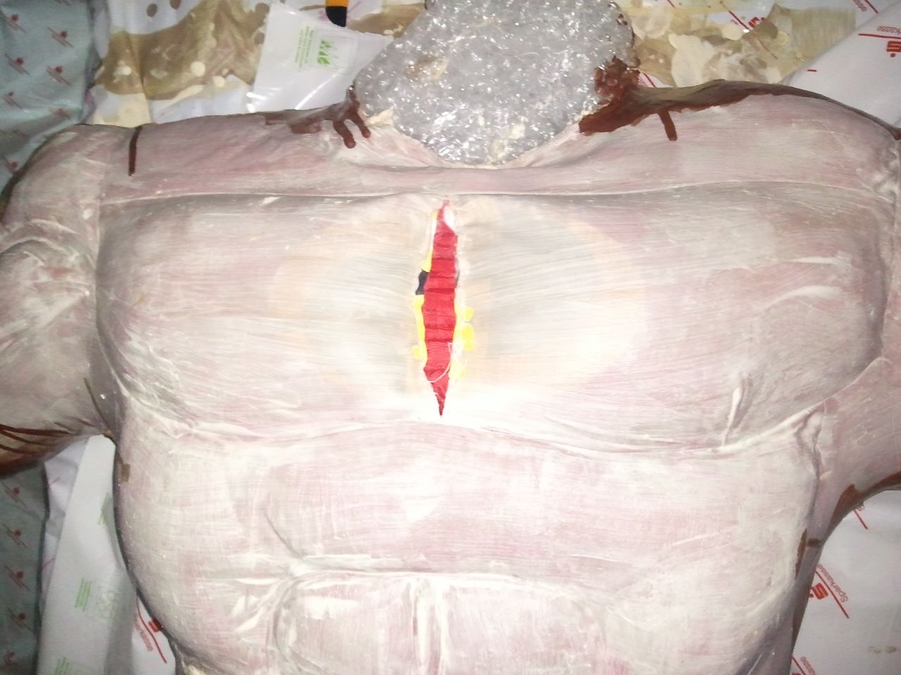

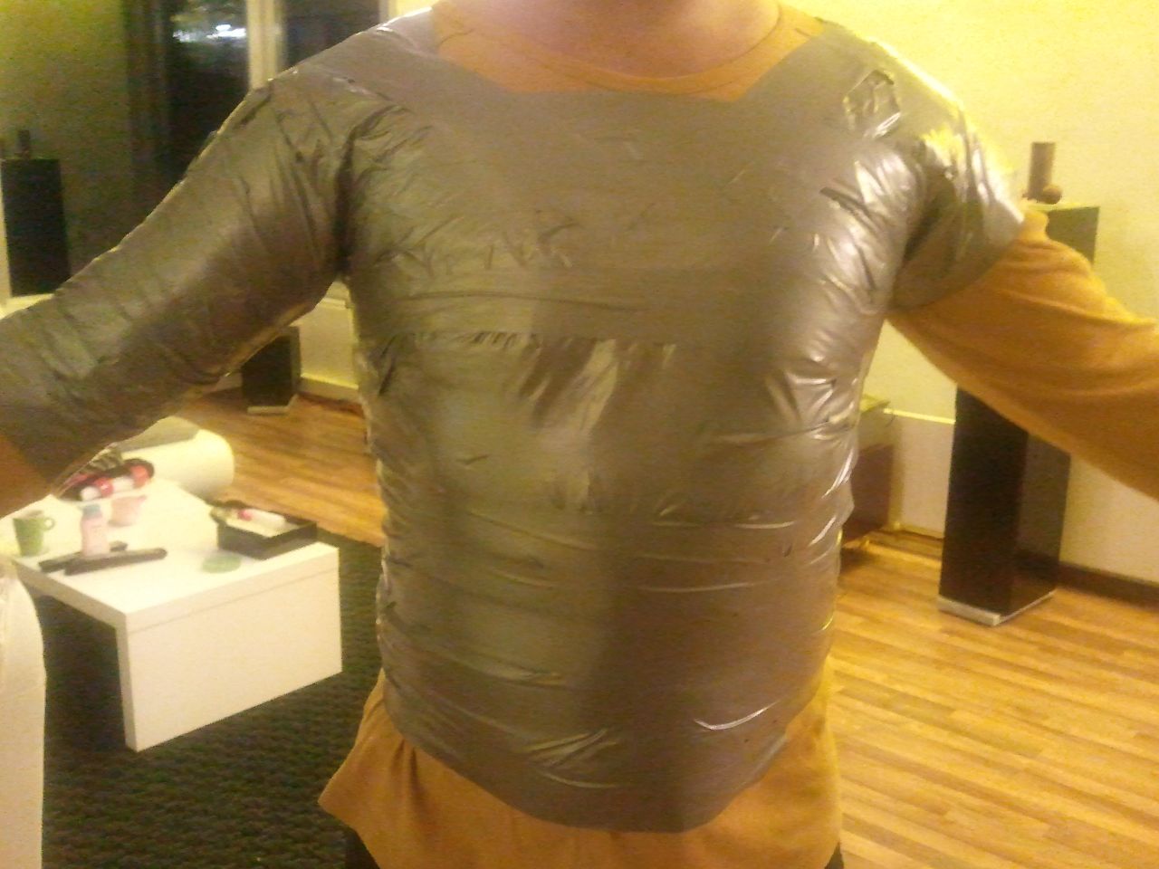

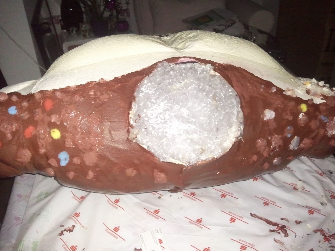

1. Make a tape dummy
2. cover the whole suit with thick latex paste not the thin milk 2 times
3. cut the chest with a sharp knife and fill the muscles a little bit with foam rubber / sponge rubber and stitch it togehter

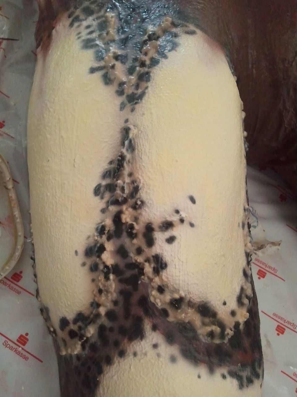

4. Create more body muscles (8-pack) with cutton pads and styrofoam balls for pimples / spots / hickeys
5. put latex on by tapping the latex with a piece of soft foam rubber on the suit min. 2 times
6. use colored latex to paint the big areas, like the dark back, its way better then airbrushing everthing later on
7. paint the whole suit with airbrush (semi-transparentI) color mixed with PROS-AID adhesive

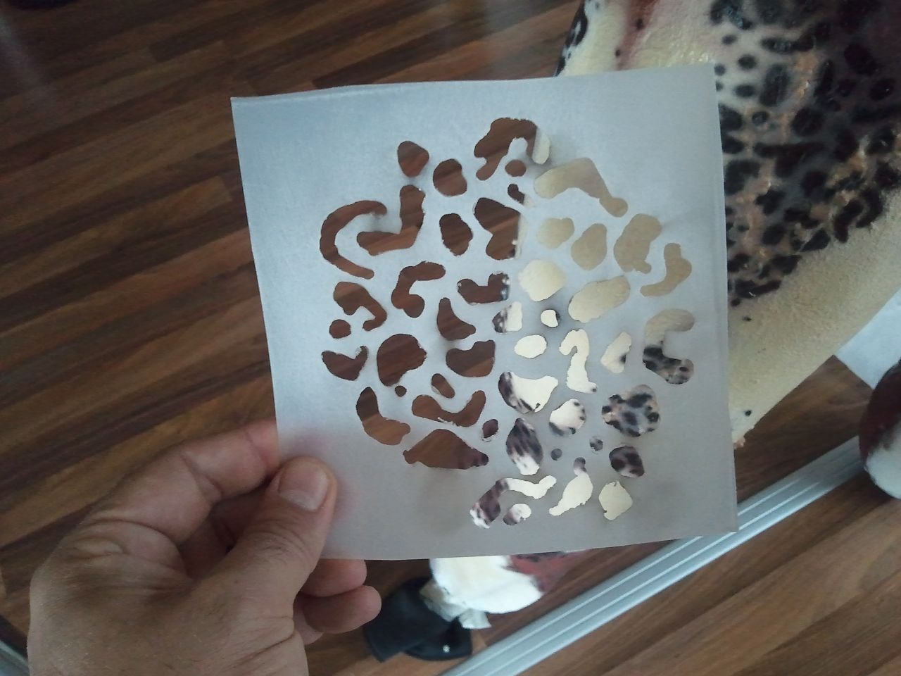

8. For the big areas like the back, I used a pattern t get these black / brown stains
9. after finishing with the paint seal the suit with LIQUITEX MATTE VARNISH or PERMA-WET GLOSS Coating
10. Throw a (fishing) net with a 35-45 mm mesh size over the suit closed starting with the legs
11. Leave a V-cut out pen in the back to get in to the suit
12. dummy stuff out and wear it

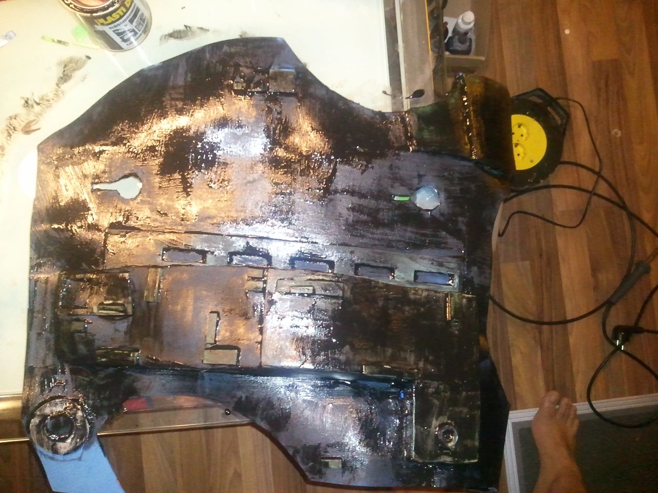

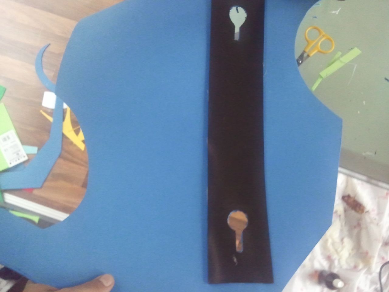

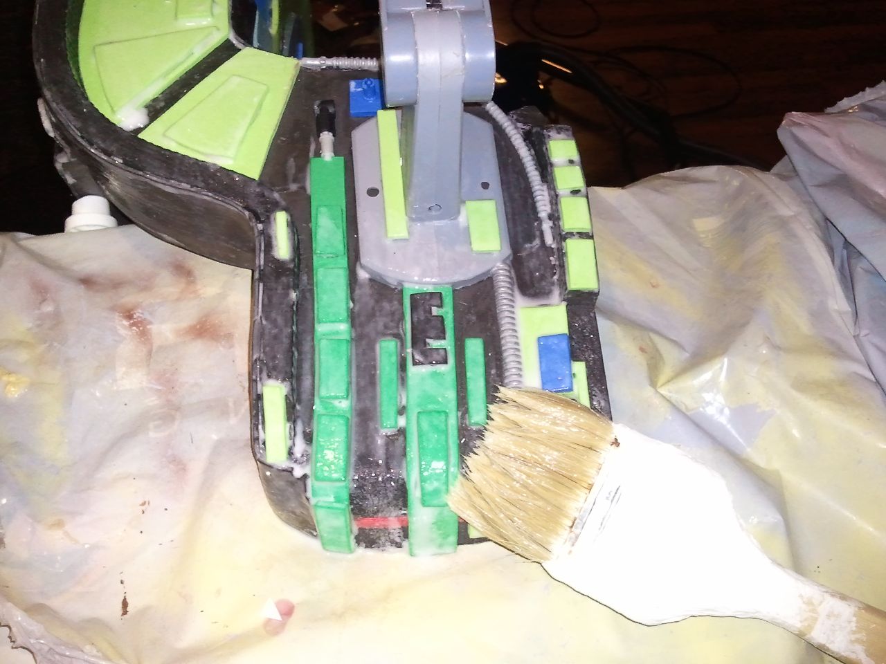

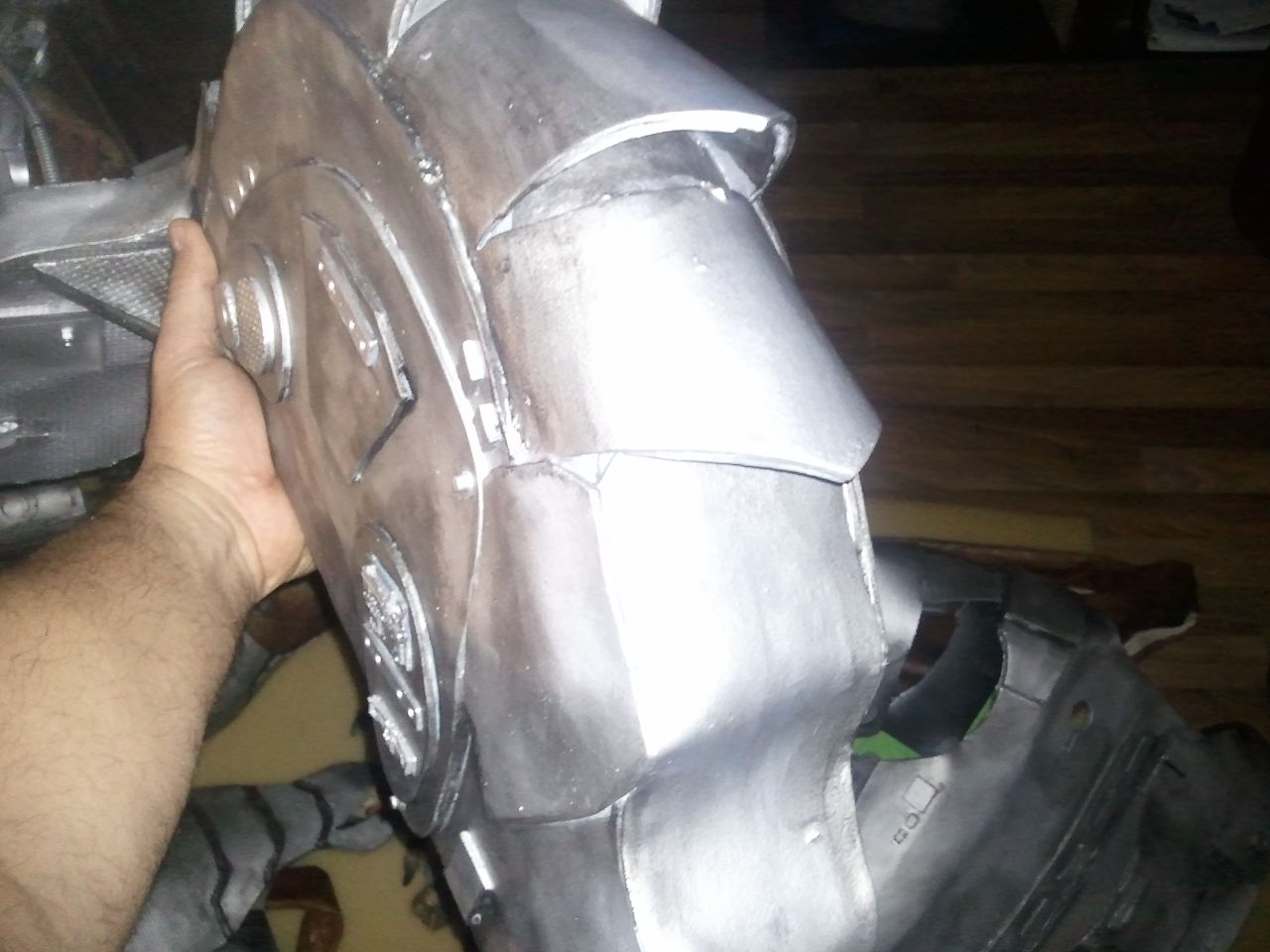

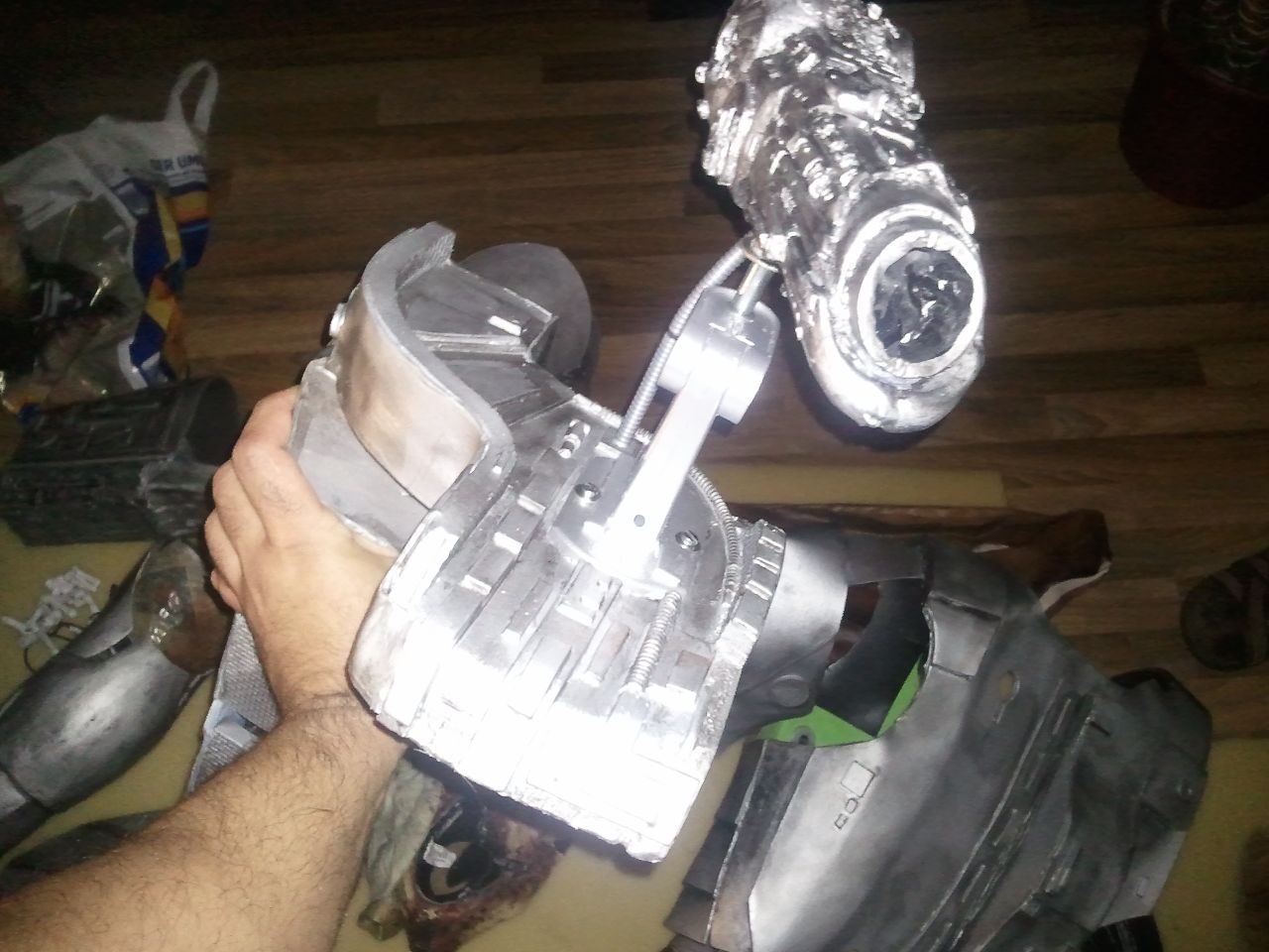

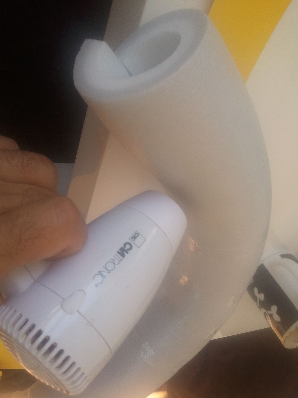

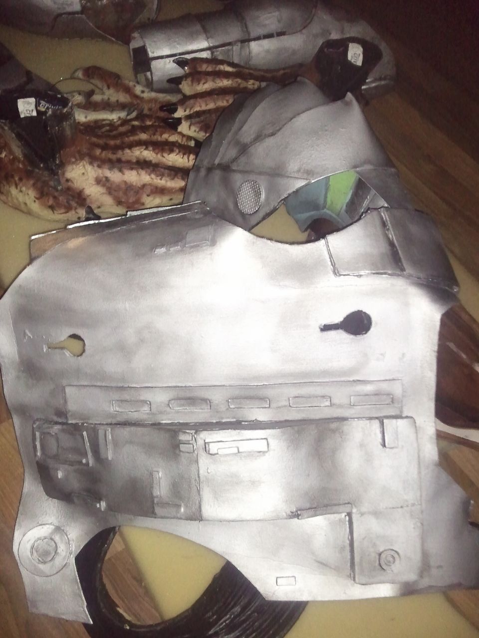

I got a cheap sideshow resin cannon from a e-Auction and used it here.
1. I used a thermal insulation for heatings and bend it with a hair dryer (hot)
2. cut out some fomie parts fr the sharp edges, hot clue them on
3. closed the side with foamie, but make sure to have some supports clued in
4. put some technically looking stuff on
5. cut out the backside from fomies and hot clued a stripe of 2mm hard plastic on the inside

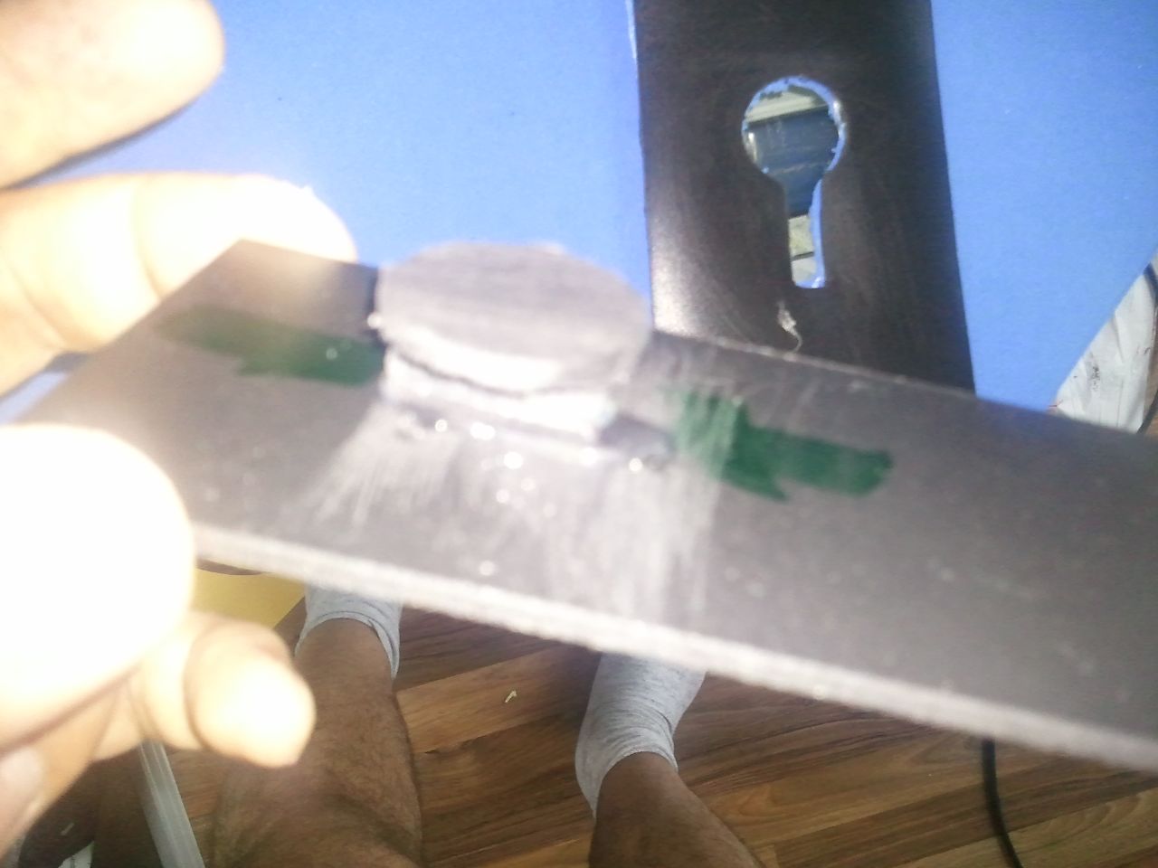

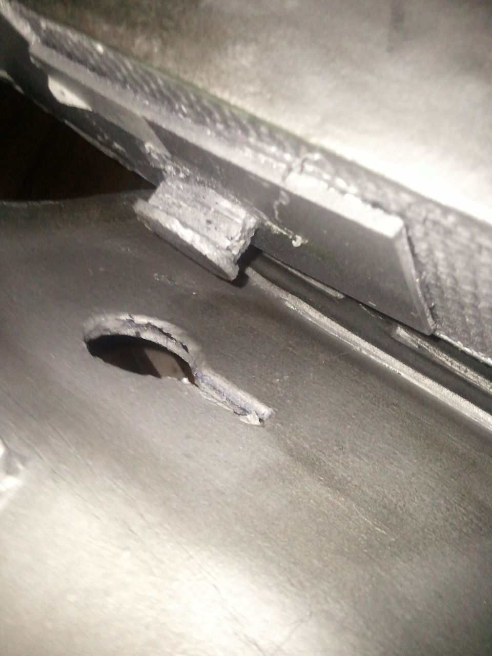

6. create a key keyhole kind of mounting socket (to be able to take of the big medi kit)
7. hot clue the other part of the key keyhole on the medikit
8. create the shulder cannon holder / bridge. I made this from two parts of foamie and a hard plasic in the same shape
9. cover everthing in children white glue
10. paint it with hammered silver metal and create the used and dirty look with black semi-trans. airbrush paint

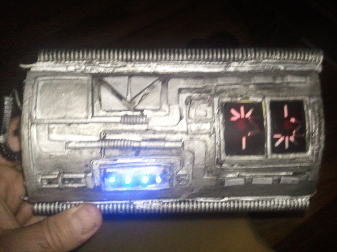

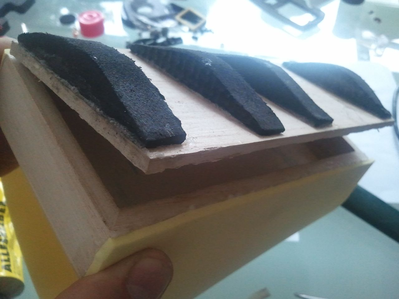

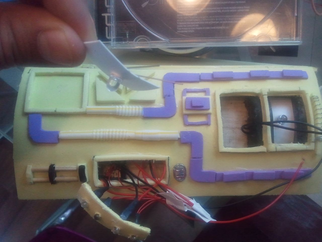

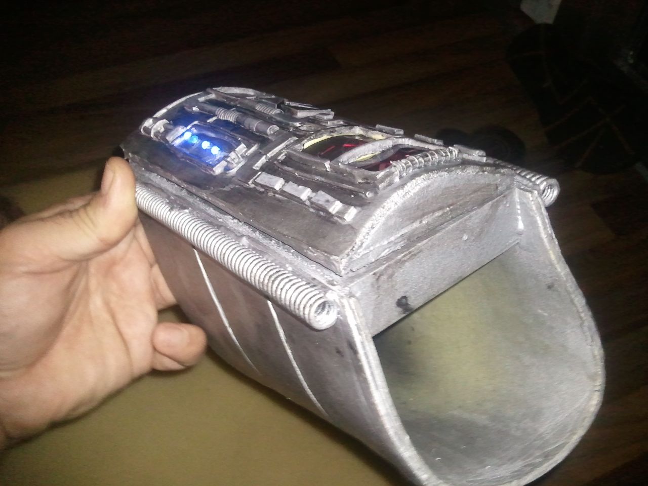

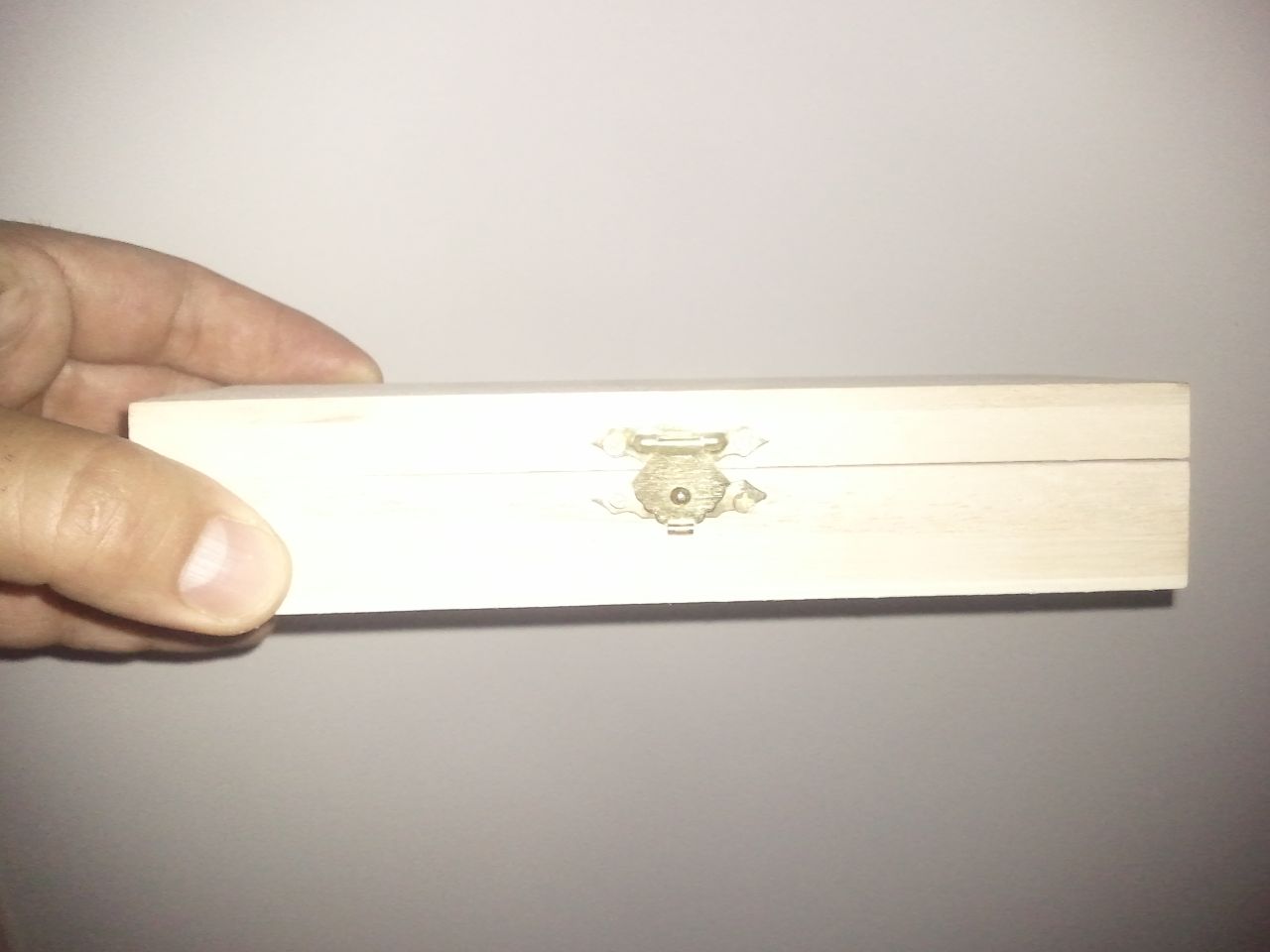

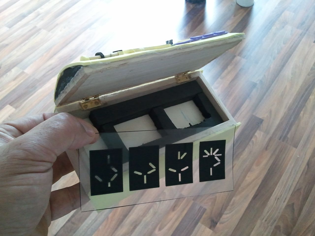

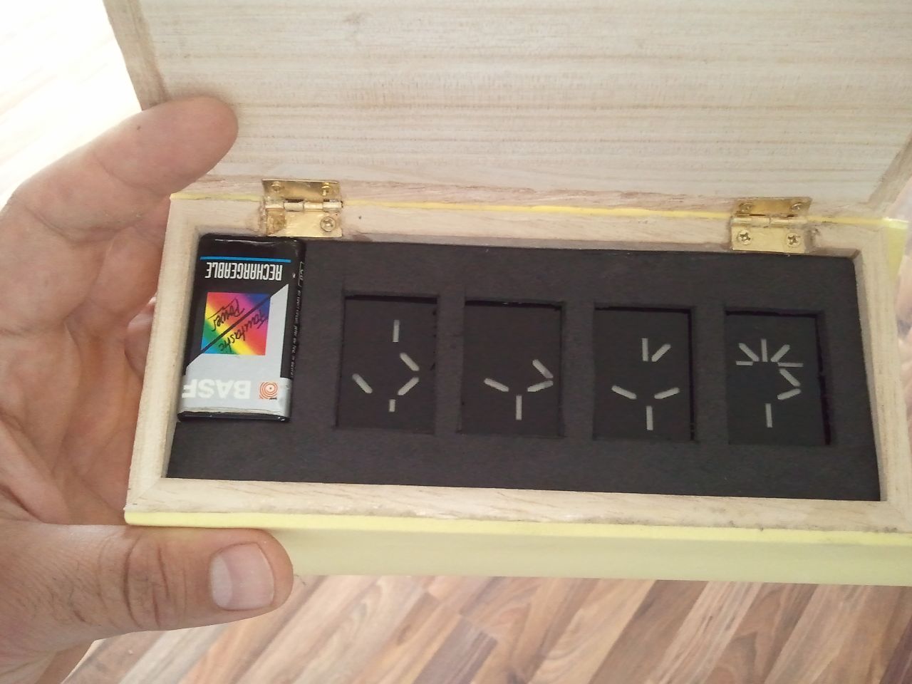

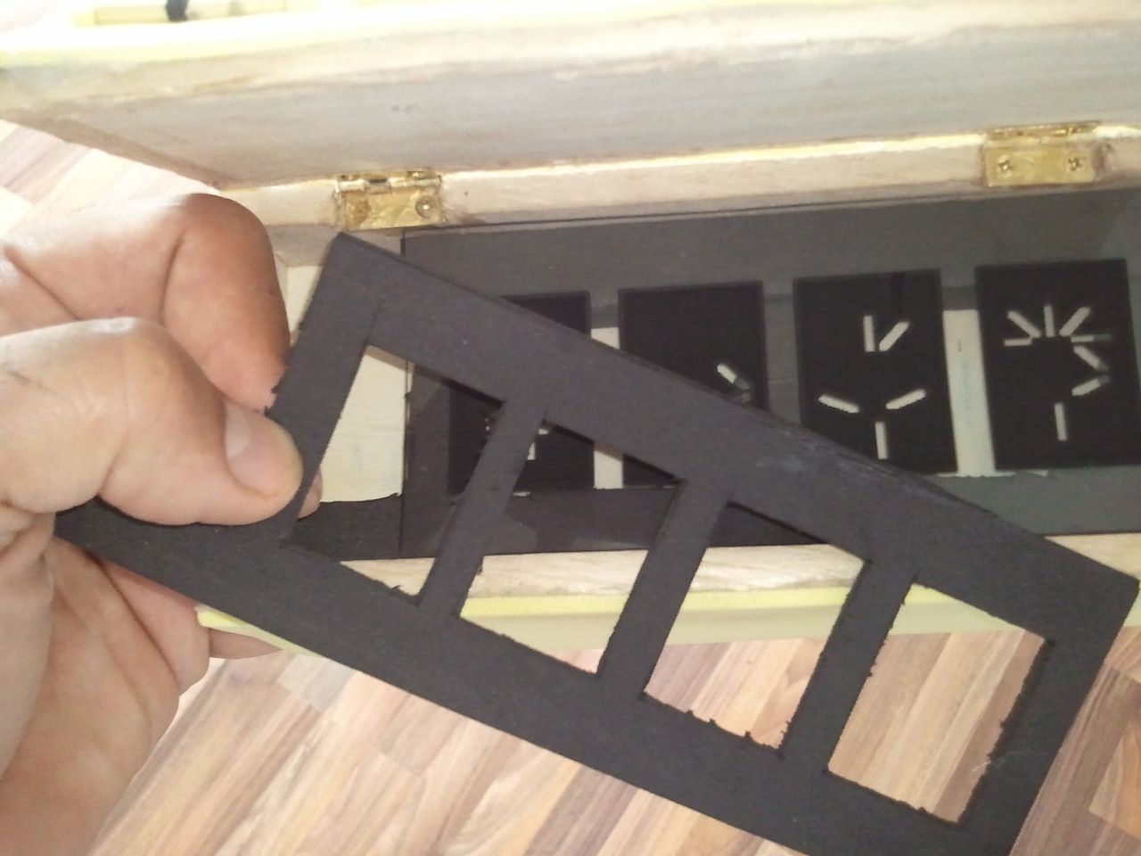

1. I bought a simple wooden box from a handicraft store
2. cut support foamies for the curved top outside the box electrically looking stuff
3. I printed the alien letters on a transparent print foil
4. soldered some led and cables and swithes together and adjusted them in to the gauntlet
5. reserved some space for 9V battery in the inside
6. coated everthing with PLATIDIP
7. painted with hammered silver and black airbrush color
8. sealed it with LIQUITEX MATTE VARNISH

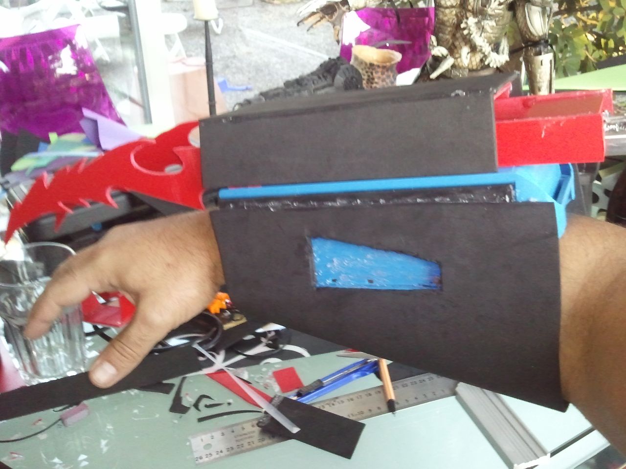

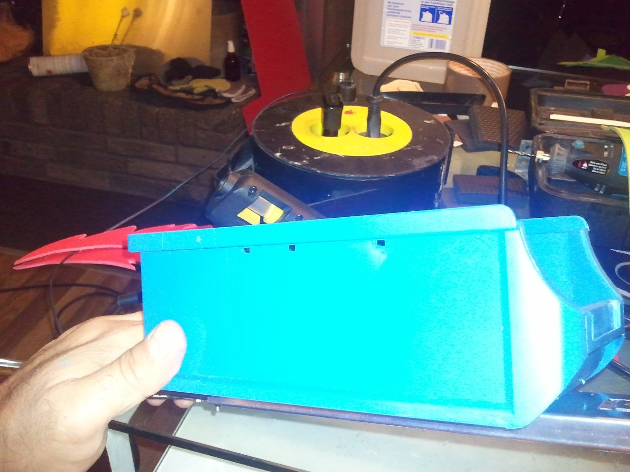

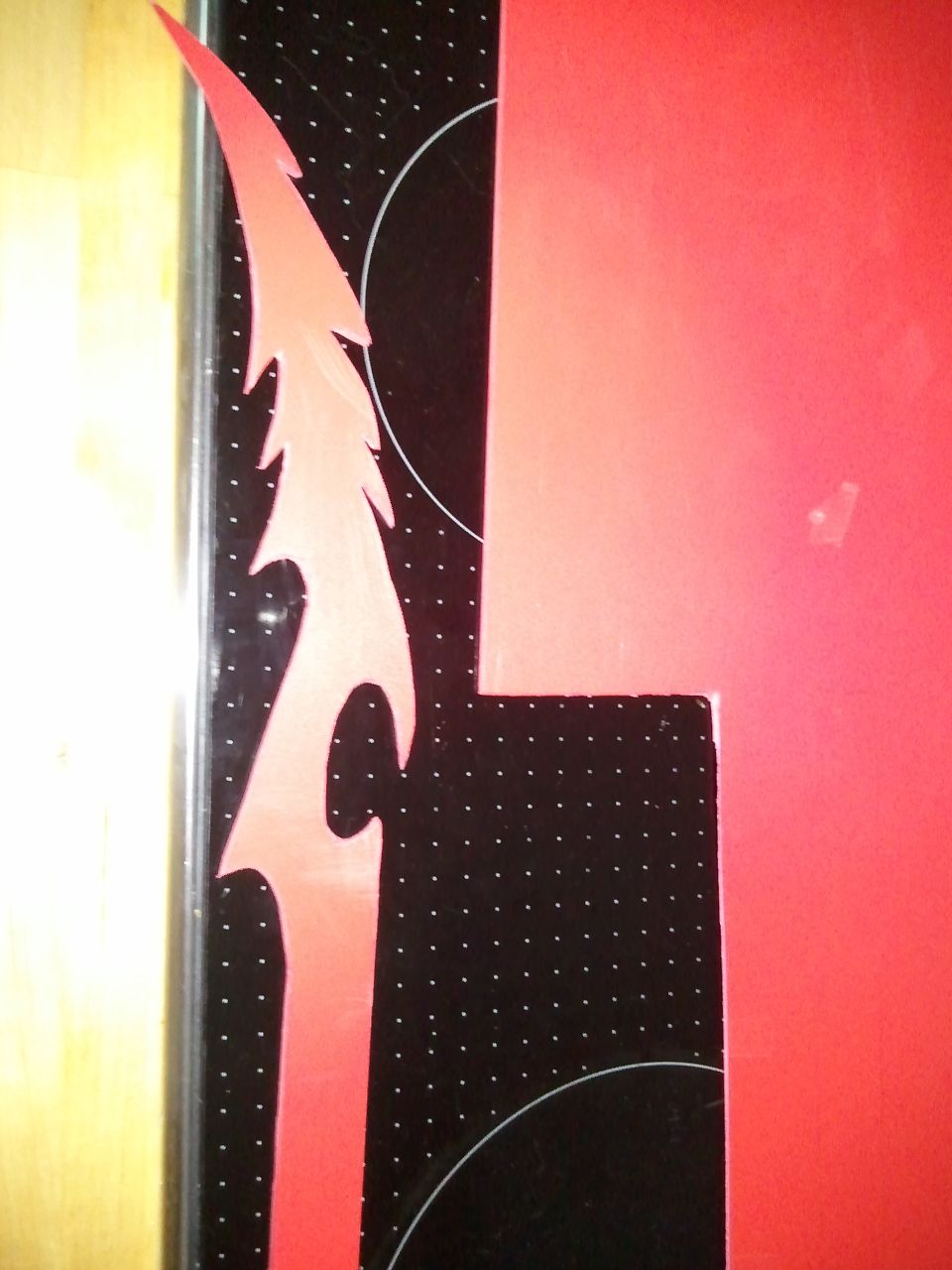

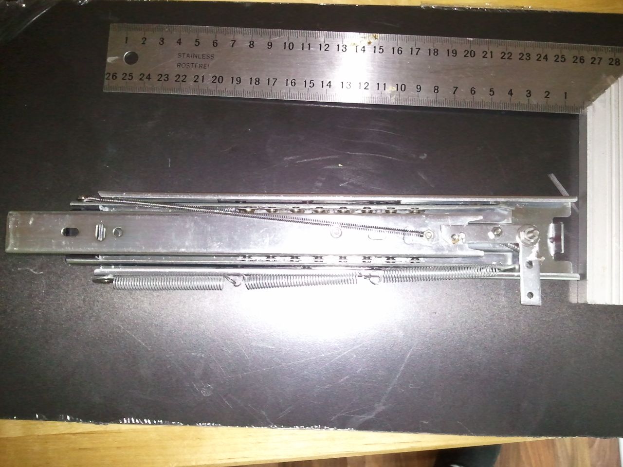

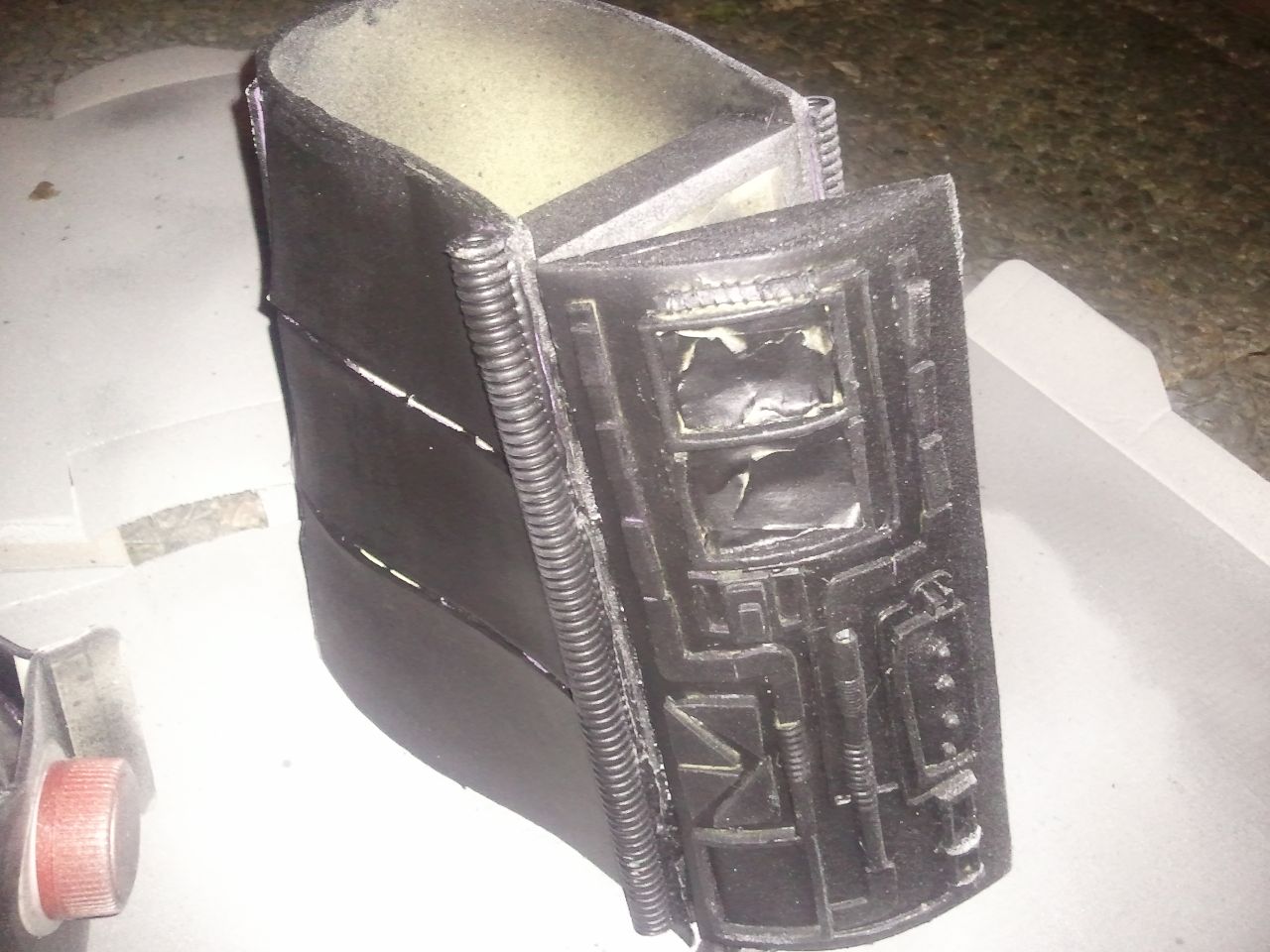

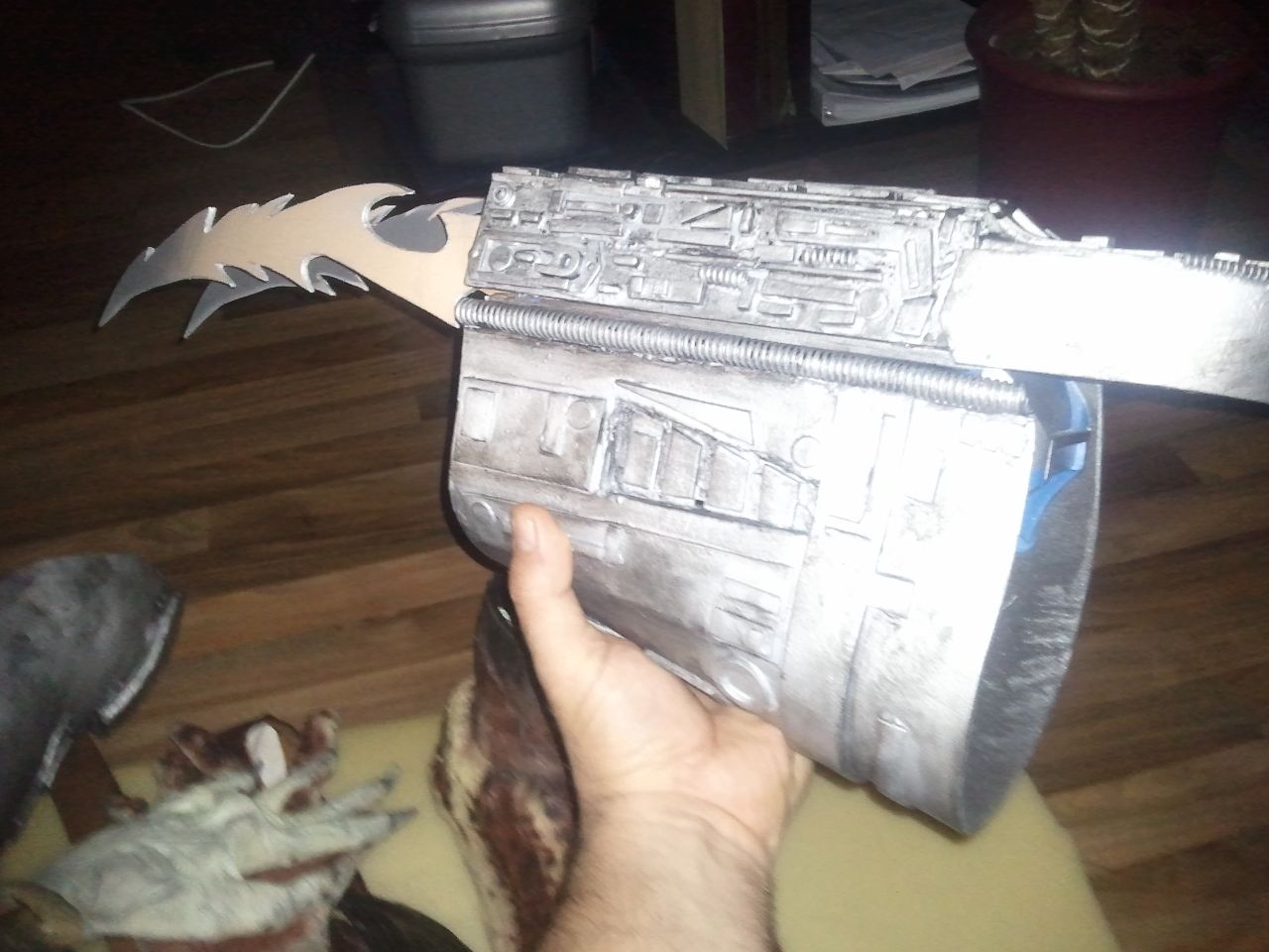

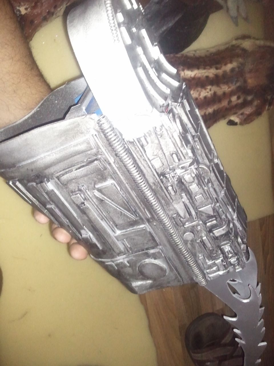

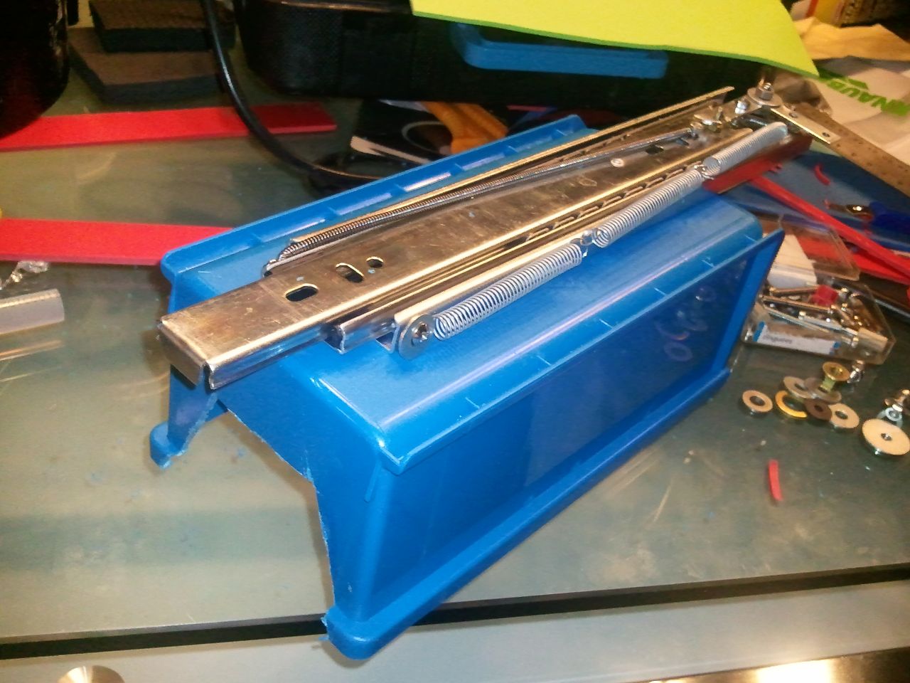

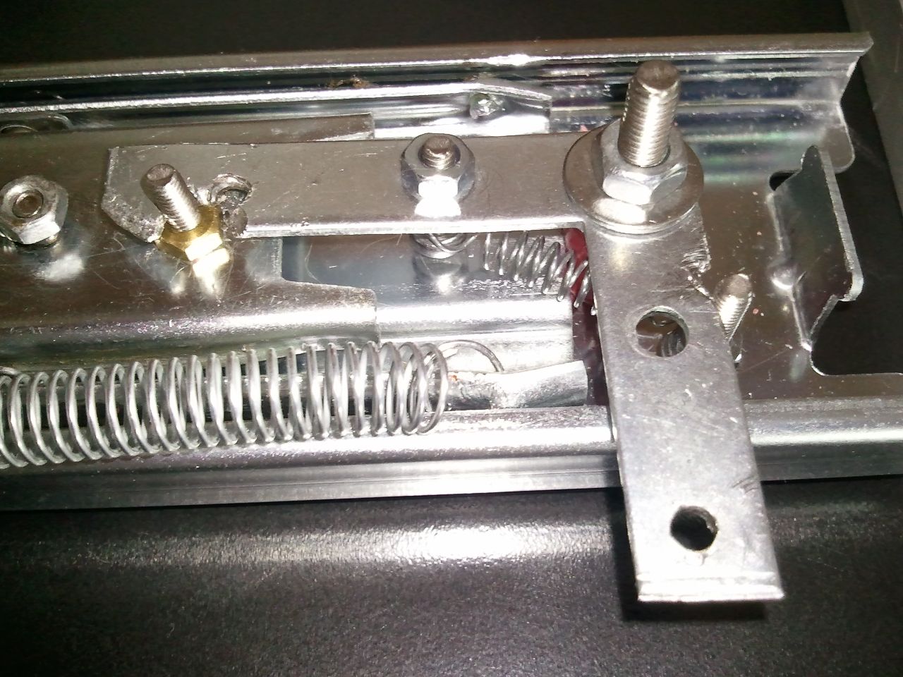

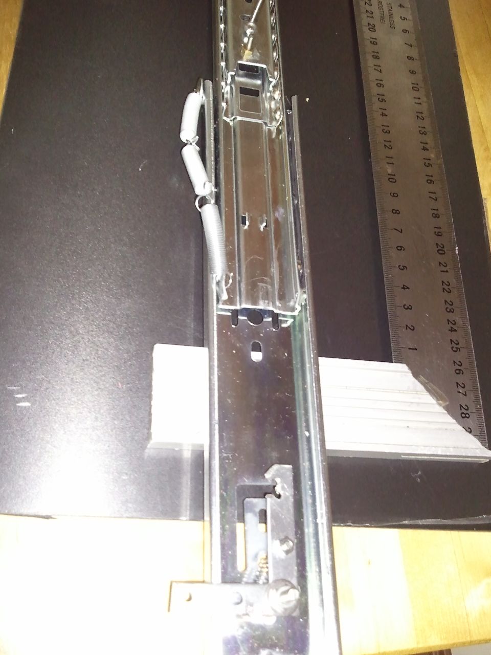

1. Bought a small tool box for srews, nails etc. and a drawer slider
2. followed the tut from here with some importand modification
3. mount the slider on the tool box
4. messured my armwide and hot clued a foamie sleeve on the tol box
5. cut out the blades from hard plastic and hot clued them toghether
6. assembled everthing
7. put technically looking foamie stuff on the gautlet
8. coverred all the foamies with white childeren clue
9. paited the blades aluminium silver and the gauntlet hammered metal silver iwith black airbrush paint
10. sealed it with LIQUITEX MATTE VARNISH

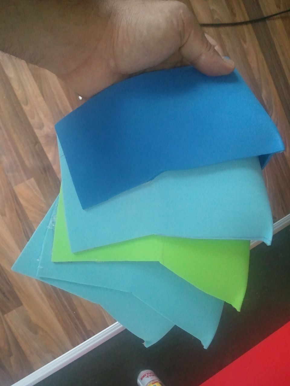

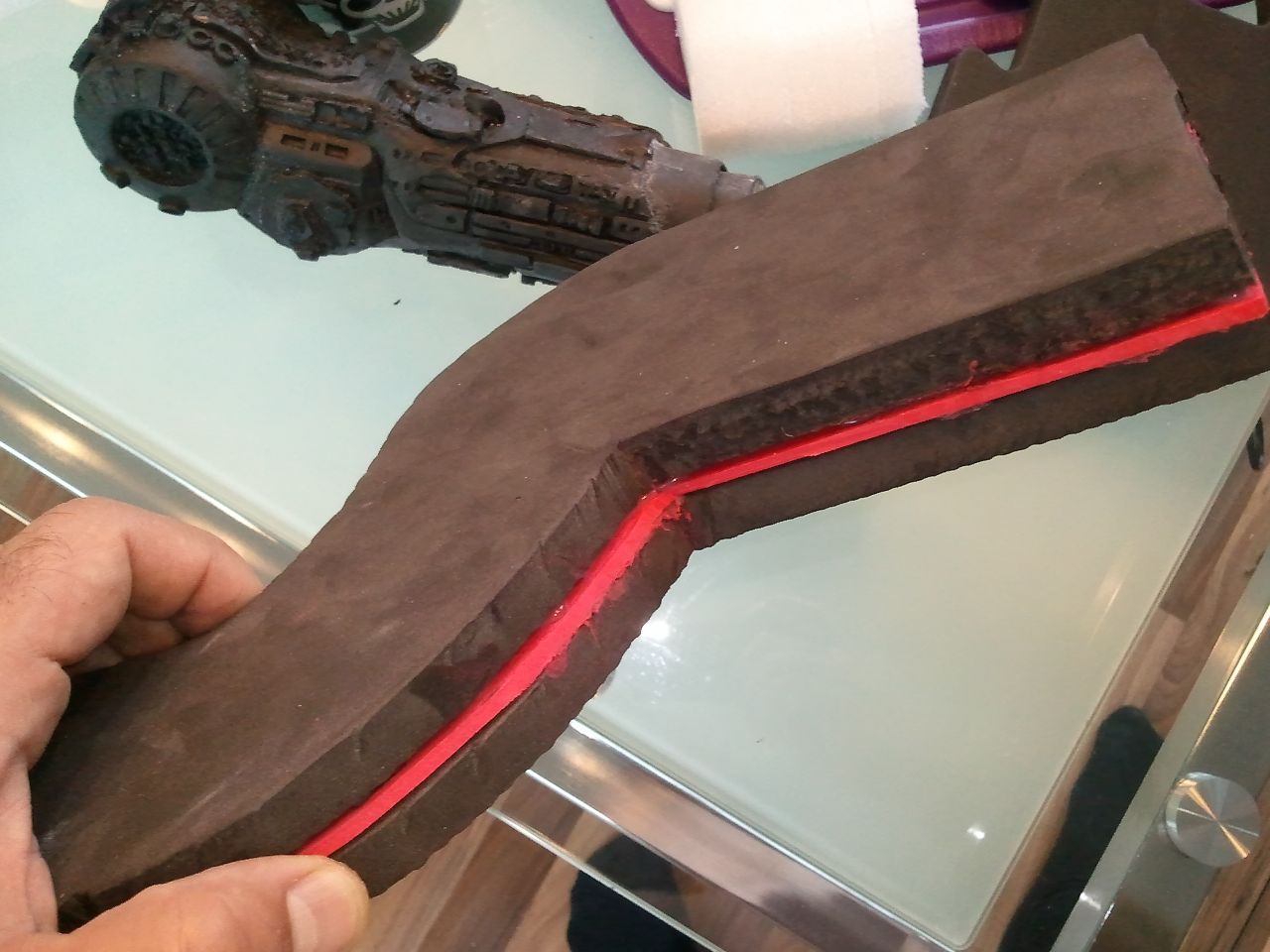

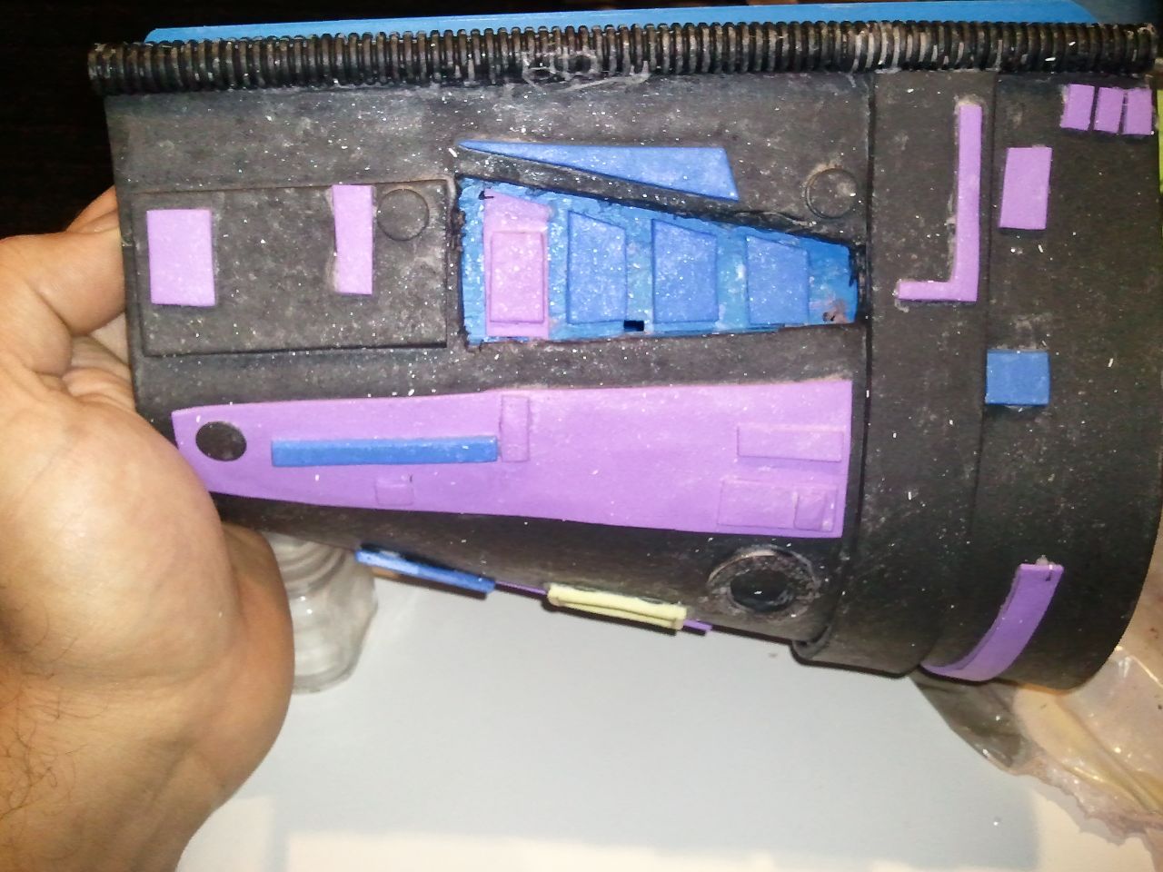

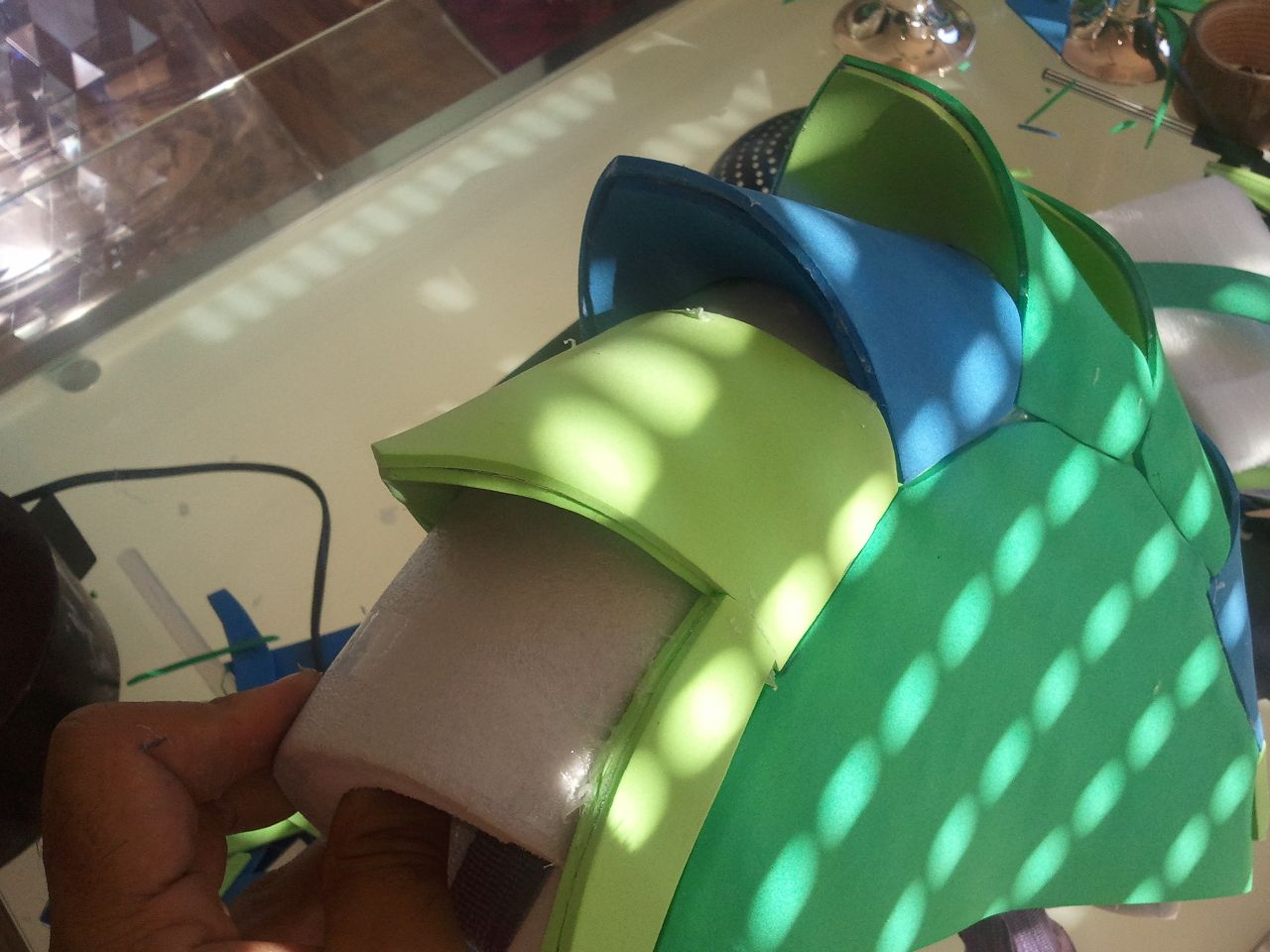

1. cut out the parts from foamies and closed the insides of the spikes
2. hot clue them toghether
3. cut out the covering with the hole for the tube, I used a cap from a bottle of coke
5. covered them with PLASTIDIP and sealed open cracks
6. painted them in hammered silver metal and after that with black airbrush color

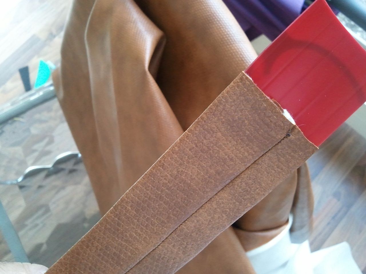

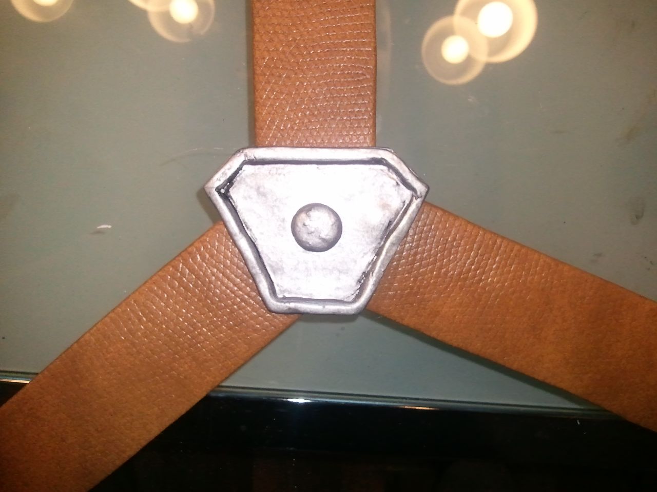

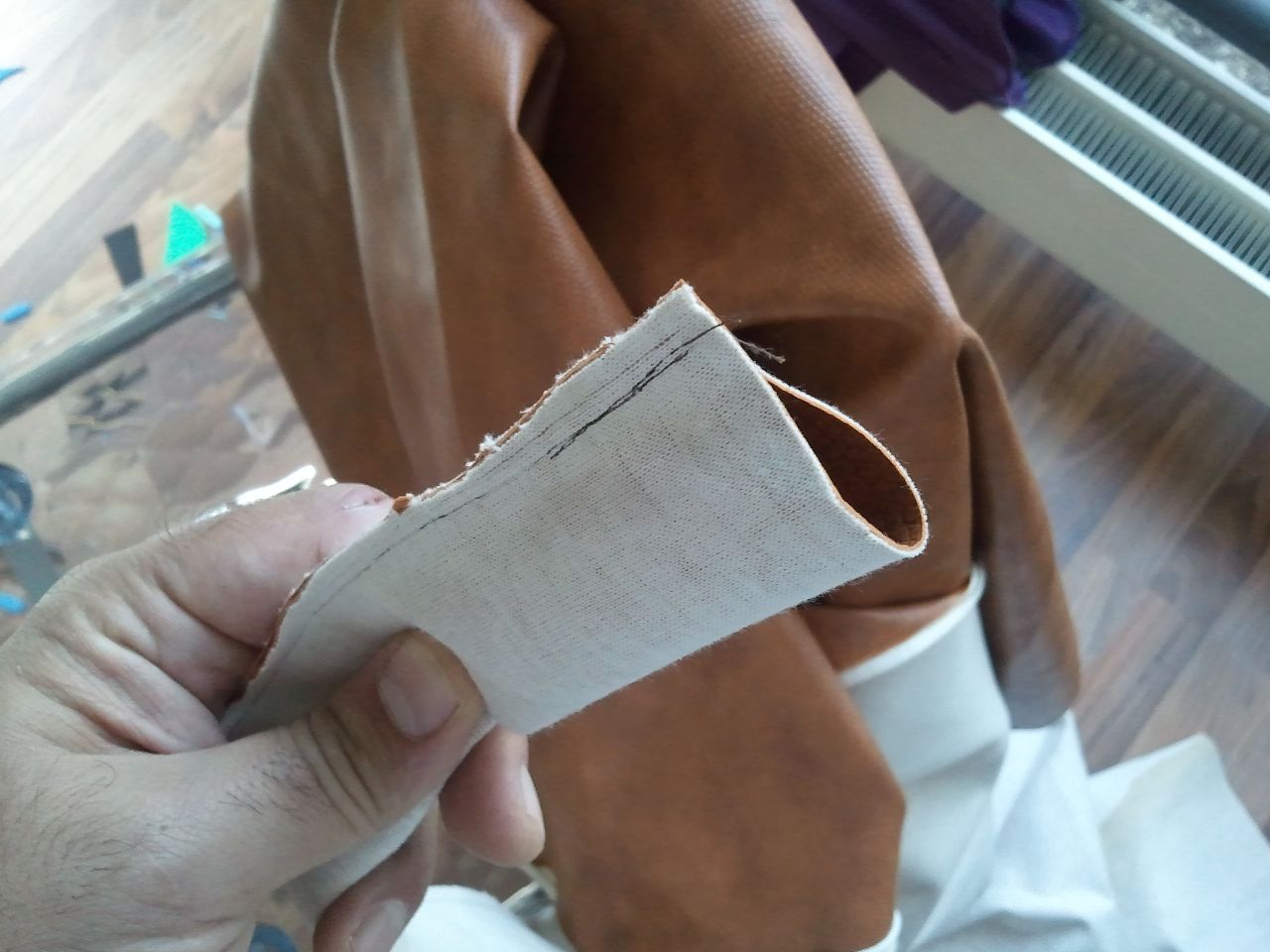

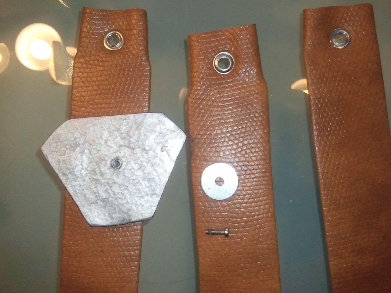

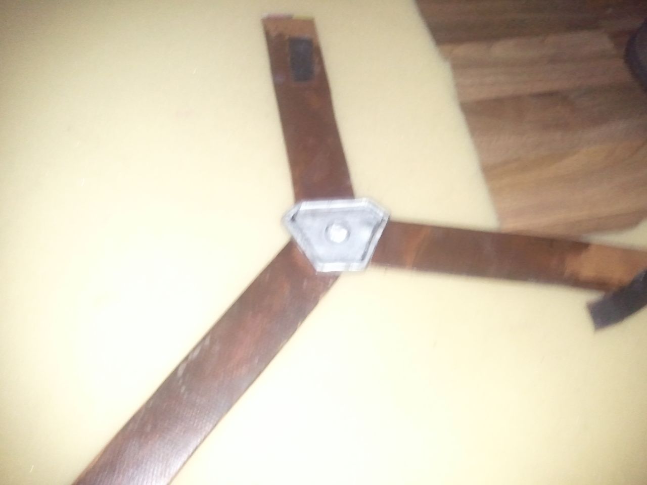

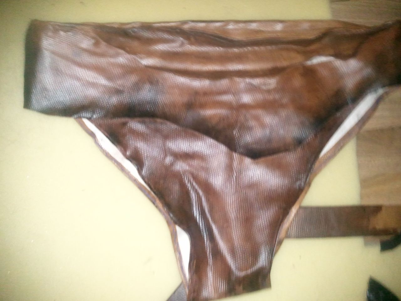

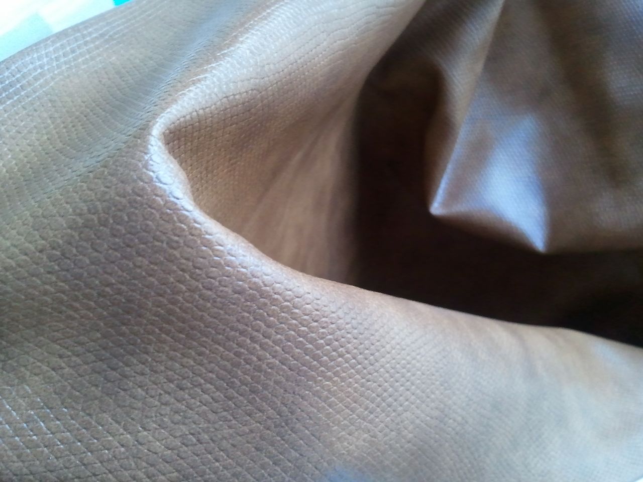

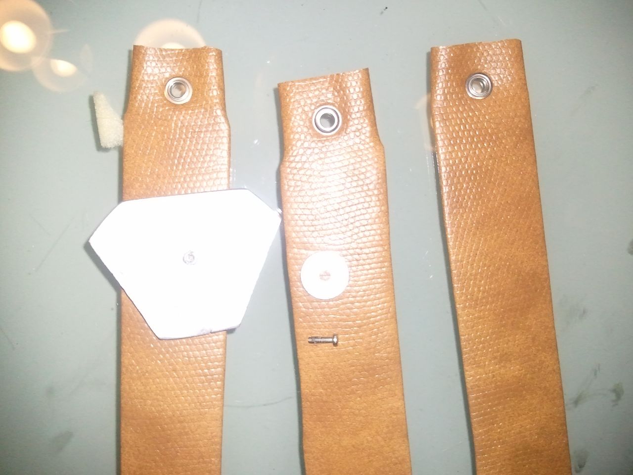

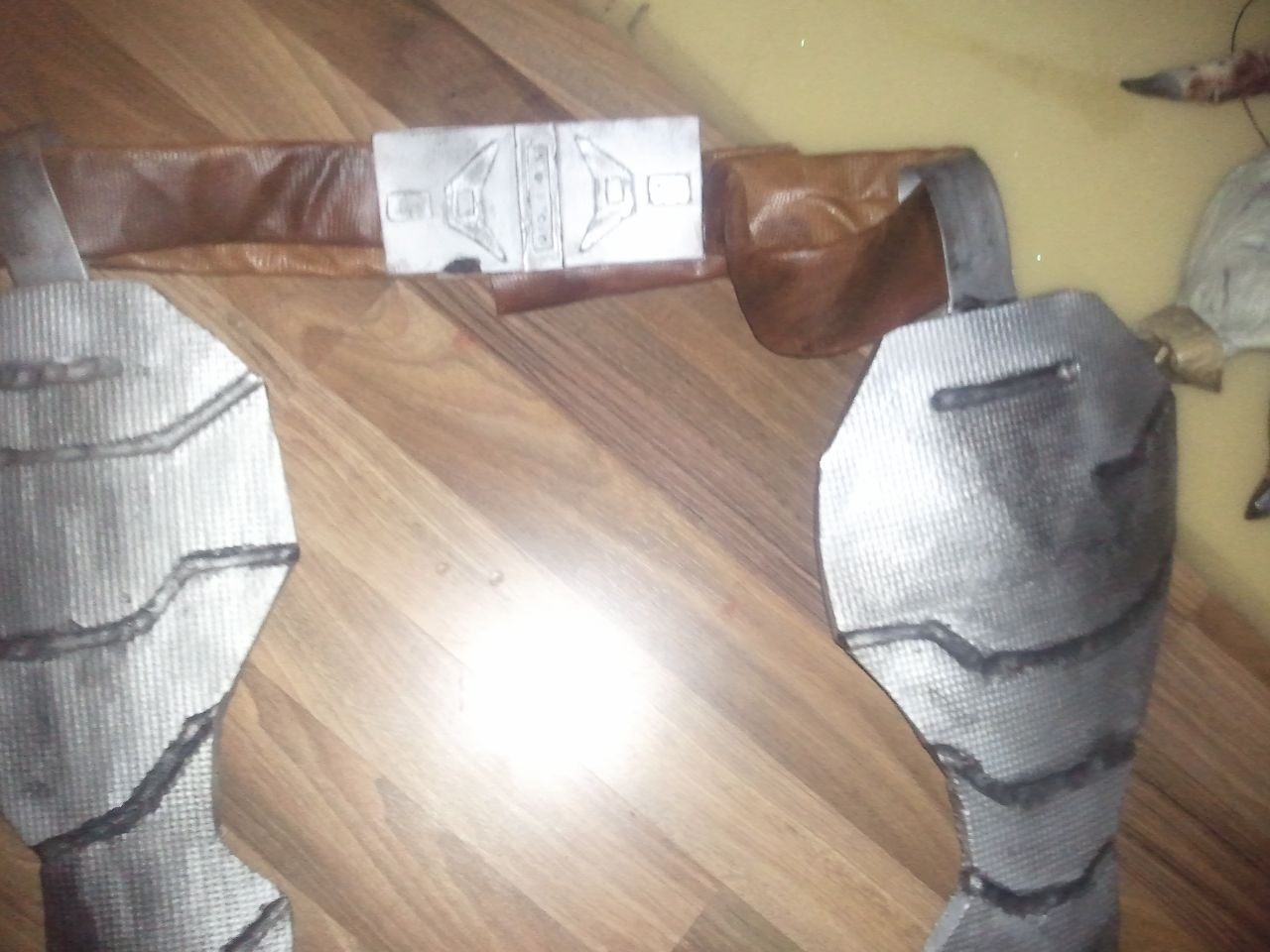

1. I bought imitation leather / leatherette with a snake-reptile pattern
2. stichted toghether the lether and slide in a thin piece of platic in the same lengh to give the leather support
3. cut the leather tube in to the needed lengh
4. created a belt buckle from FIMO and placed a tap in the thickest part in the center
5. painted them hammered silver with black airbrush color semi-transparent
6. I riveted oon end of each leather belt strap and assebled the buckle with a srew trough the holes
7. I messured with a old bed sheet my pants size and cut that from the leather
8. cut two more layers from the leather and stichted them on
9. belt buckle is made from foamies attached with a strip masking / crepe tabe
10. covered the real beld buckle (on the back side) with a simple blend from leather
11 make everything look like used with black and brown semi-transparent airbrush colors
12. sealed it with LIQUITEX MATTE VARNISH

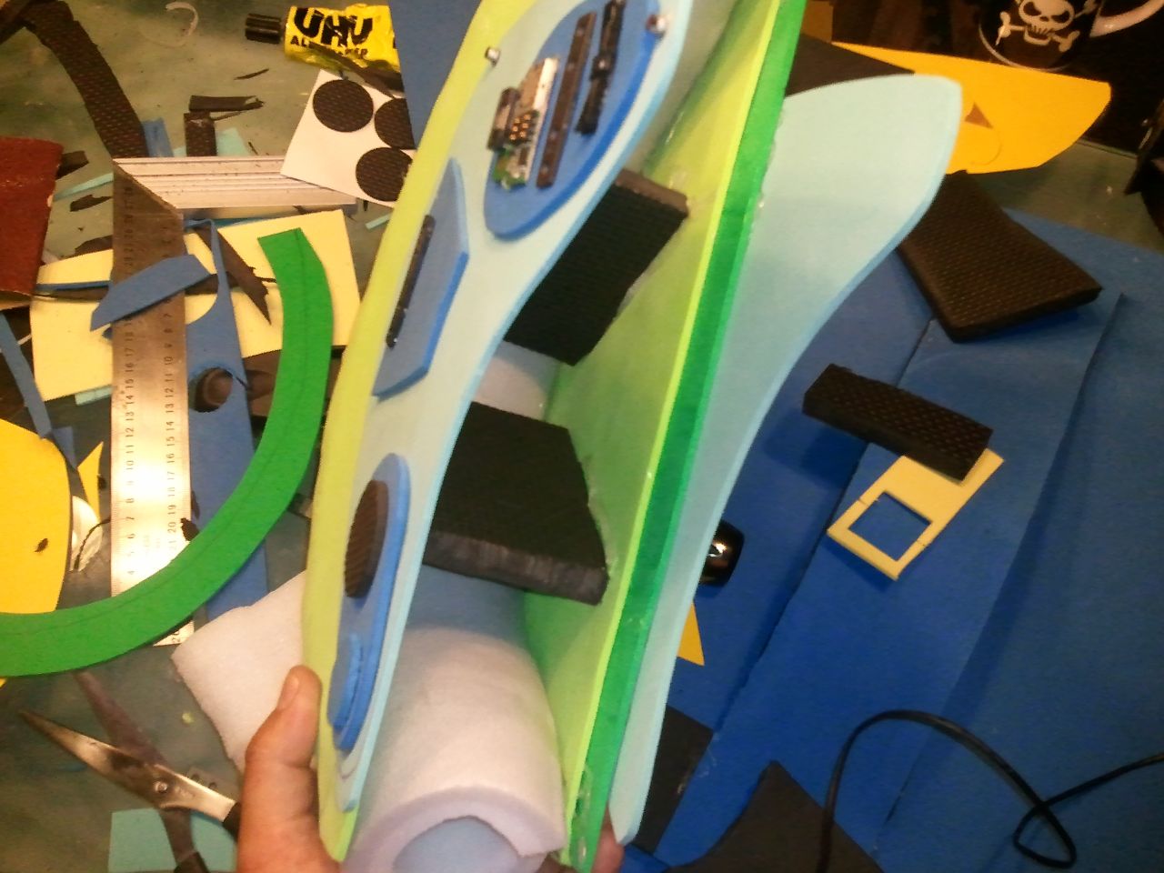

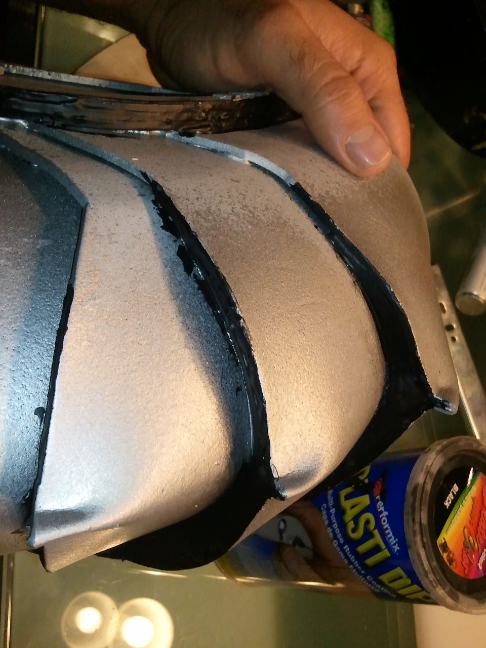

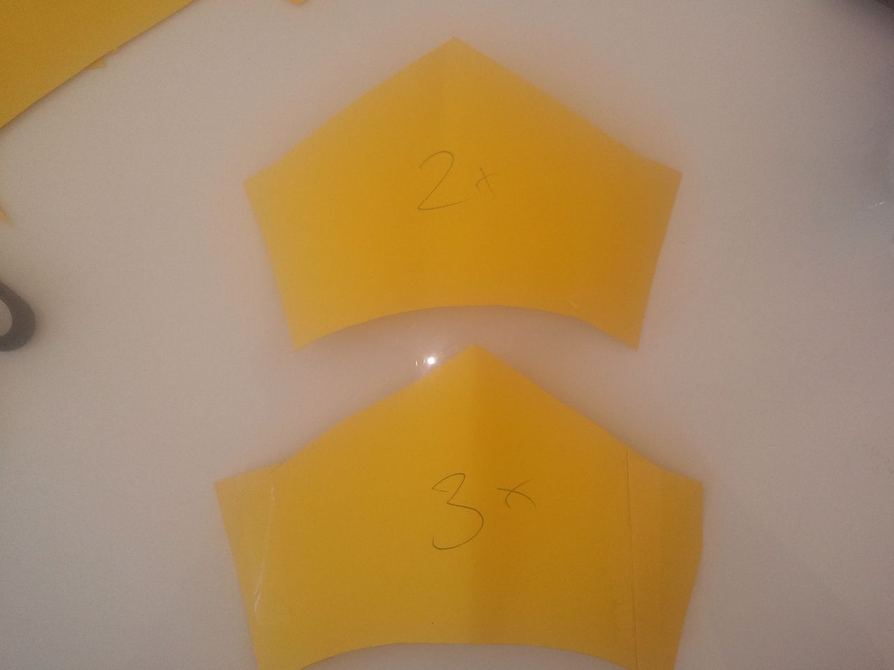

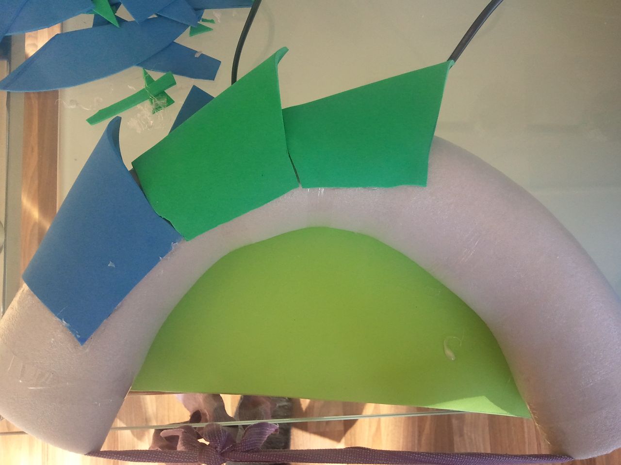

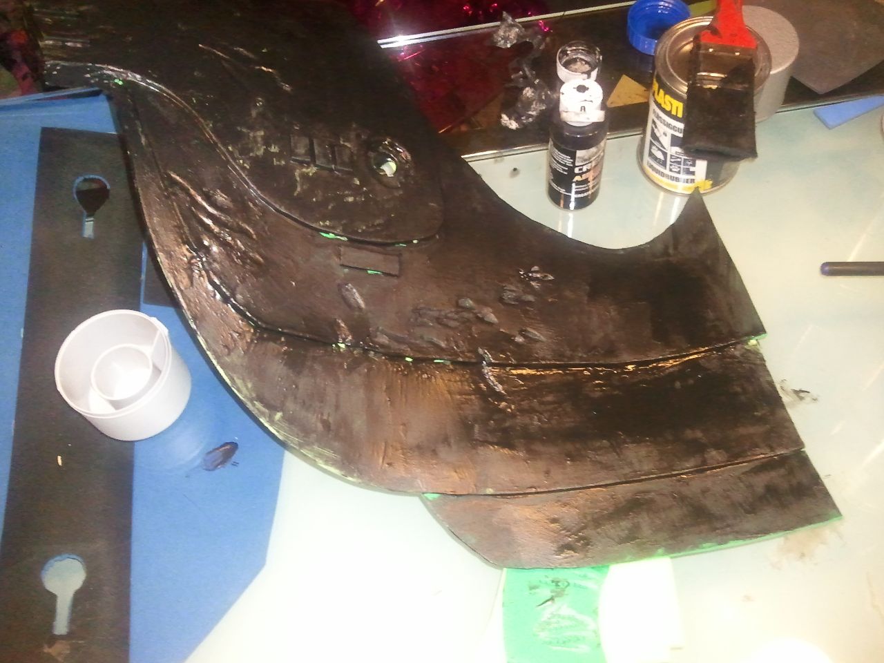

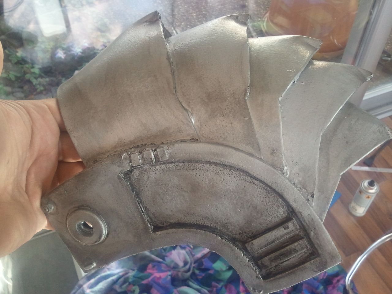

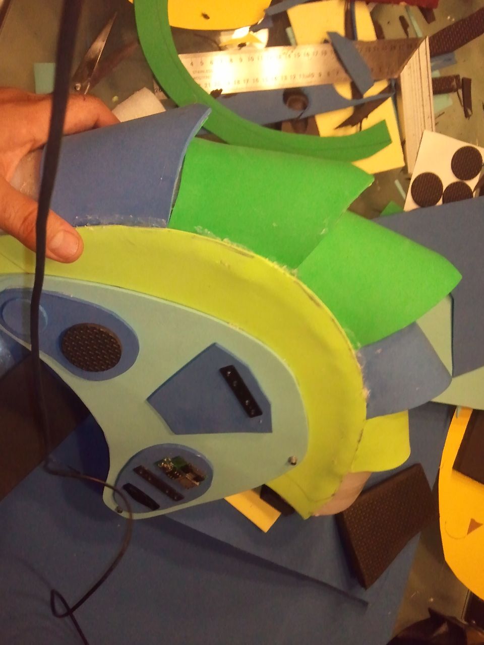

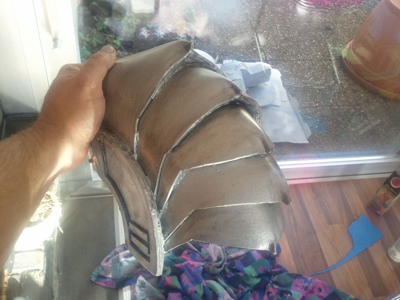

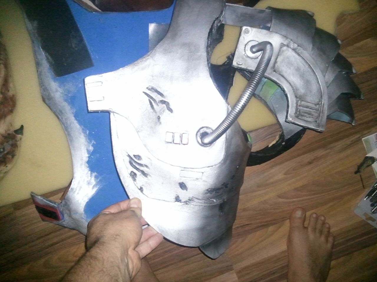

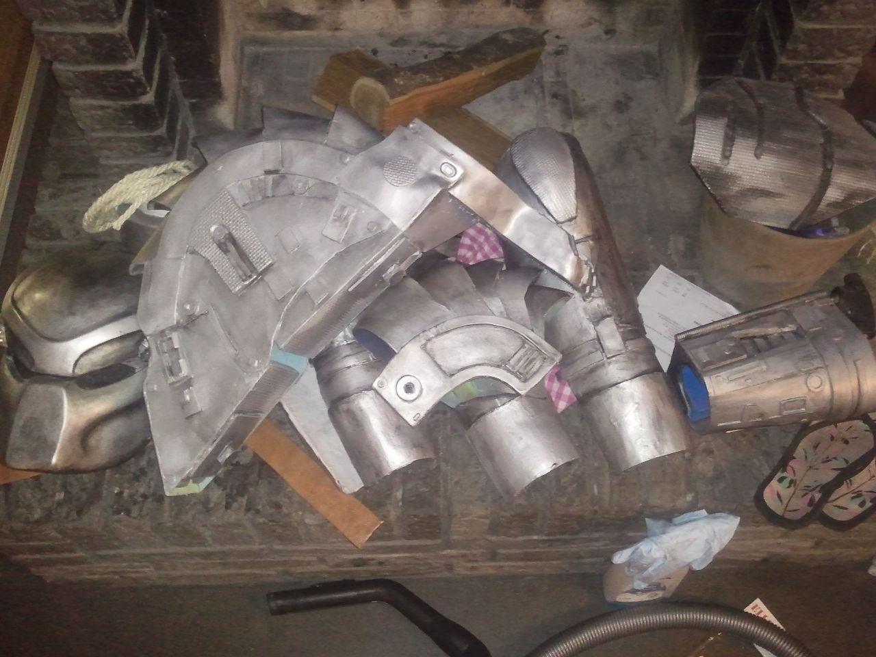

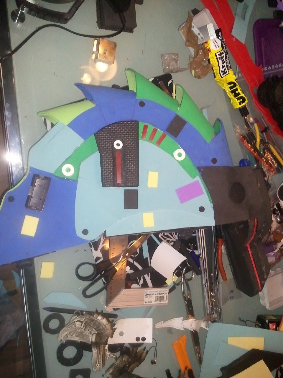

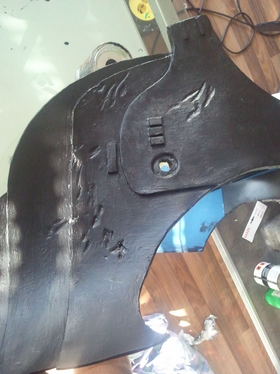

1. messured with board and transfered on to foamies
2. clued the different layers together, hot clued some stuff on it
3. drilled a hole into the armor for the tube from the shoulder belt
4. scraped some scratches with a soldering gun in to the foamie
5. coated everthing with PLASTIDIP
6. painted with hammered matal silver and after that with black airbrush color
