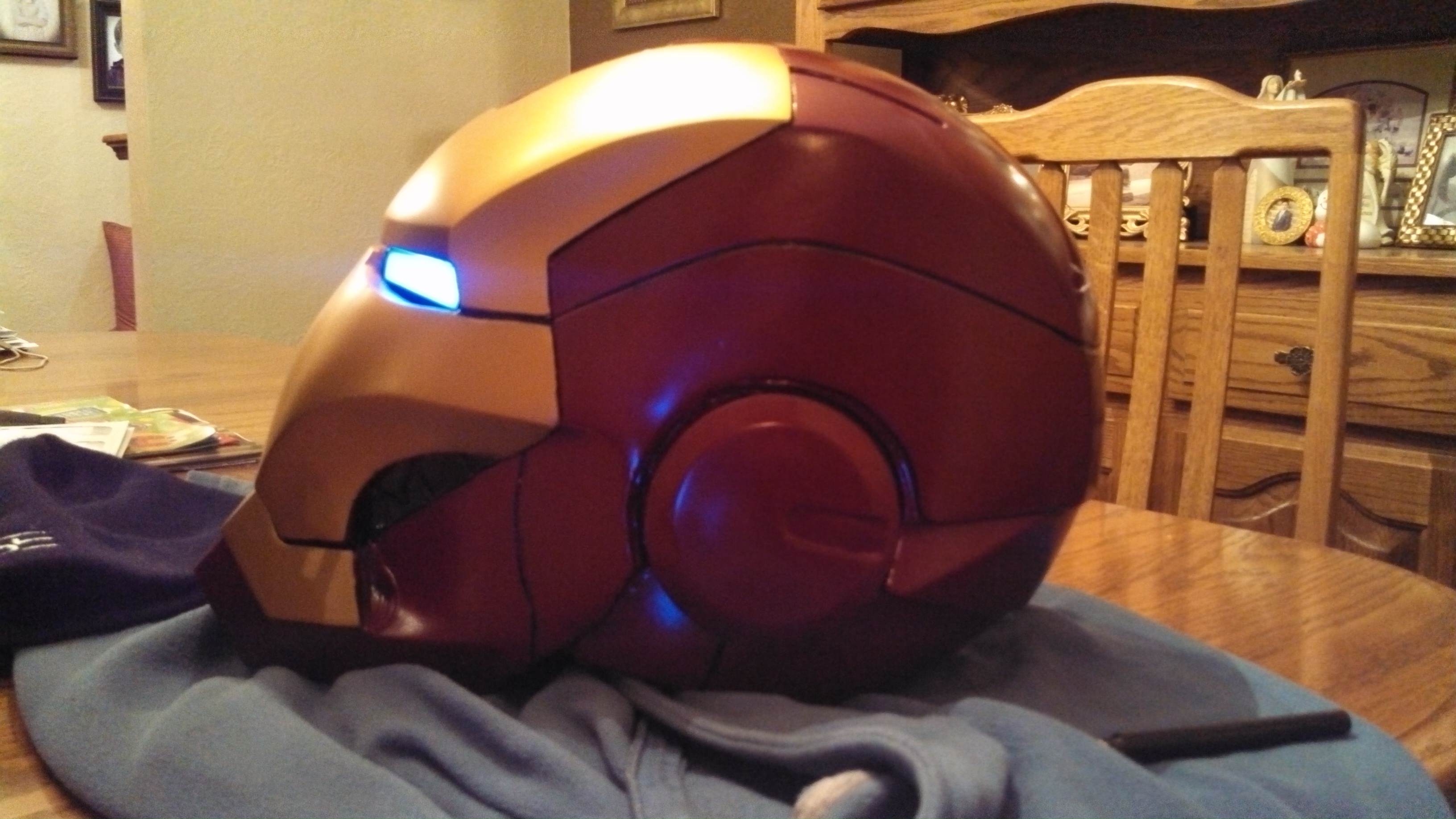

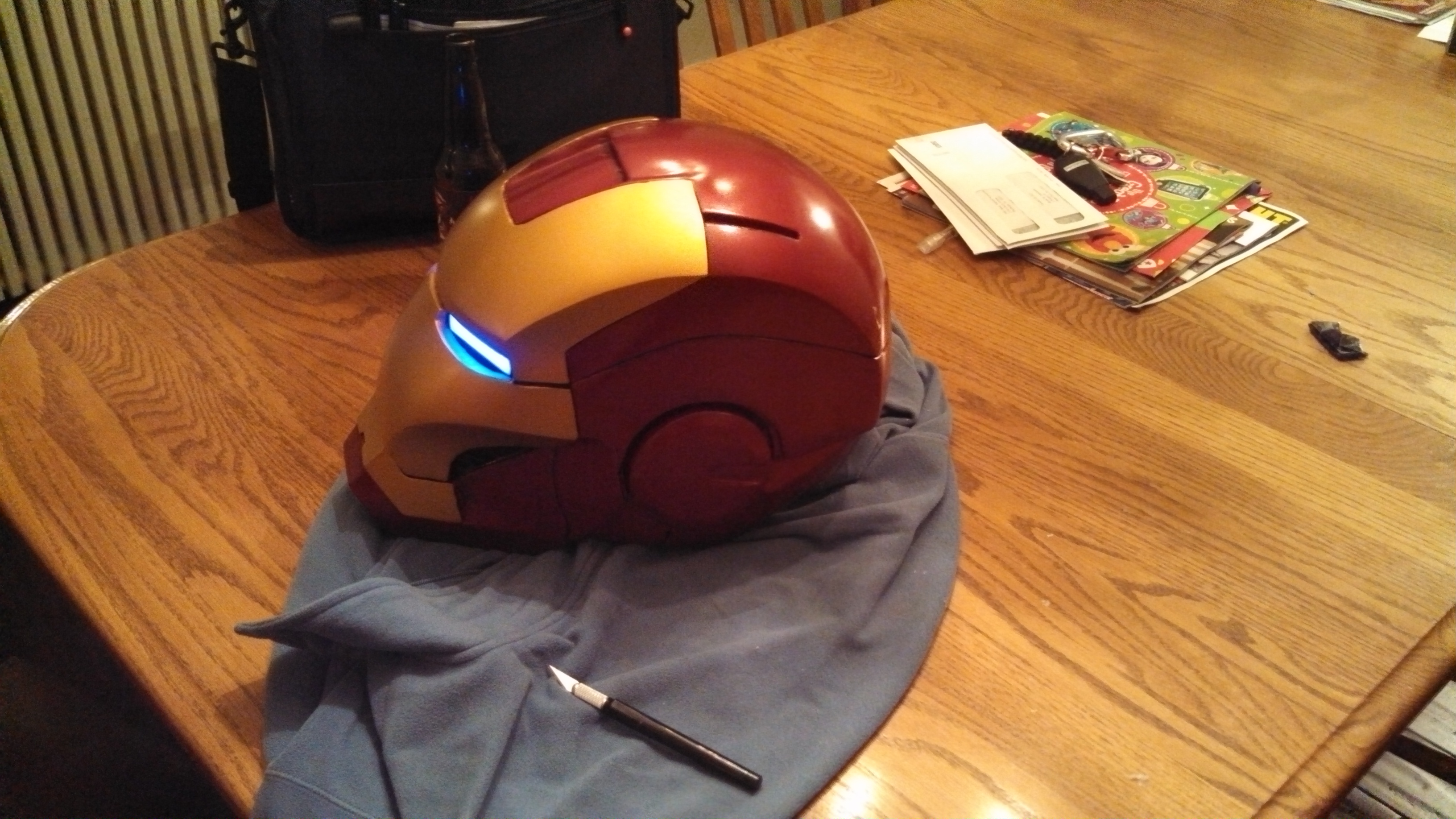

That is one clean build. I have one ready for the resin but I was wondering, how did you get the indented lines along the sides to fold clean and smooth?
Thank you!. I used a razor to score the lines, tweezers and a thin metal ruler to place the paper on for the crease. When I was doing the bondo I didn't put bondo in the groove. I went back after the helmet took a better shape and filled in the groove using a different color hardener in the bondo. That gave me a contrast difference to follow for sanding. You could use primer too.

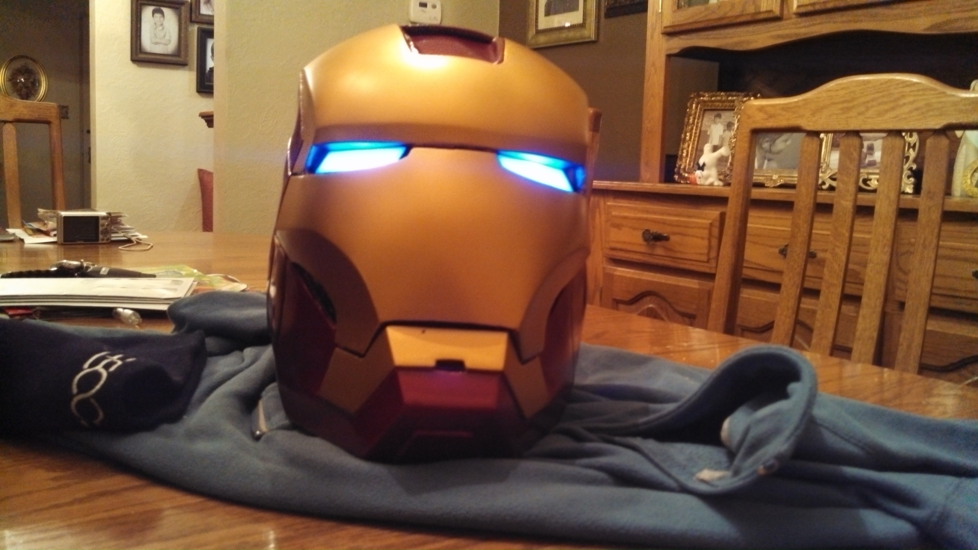

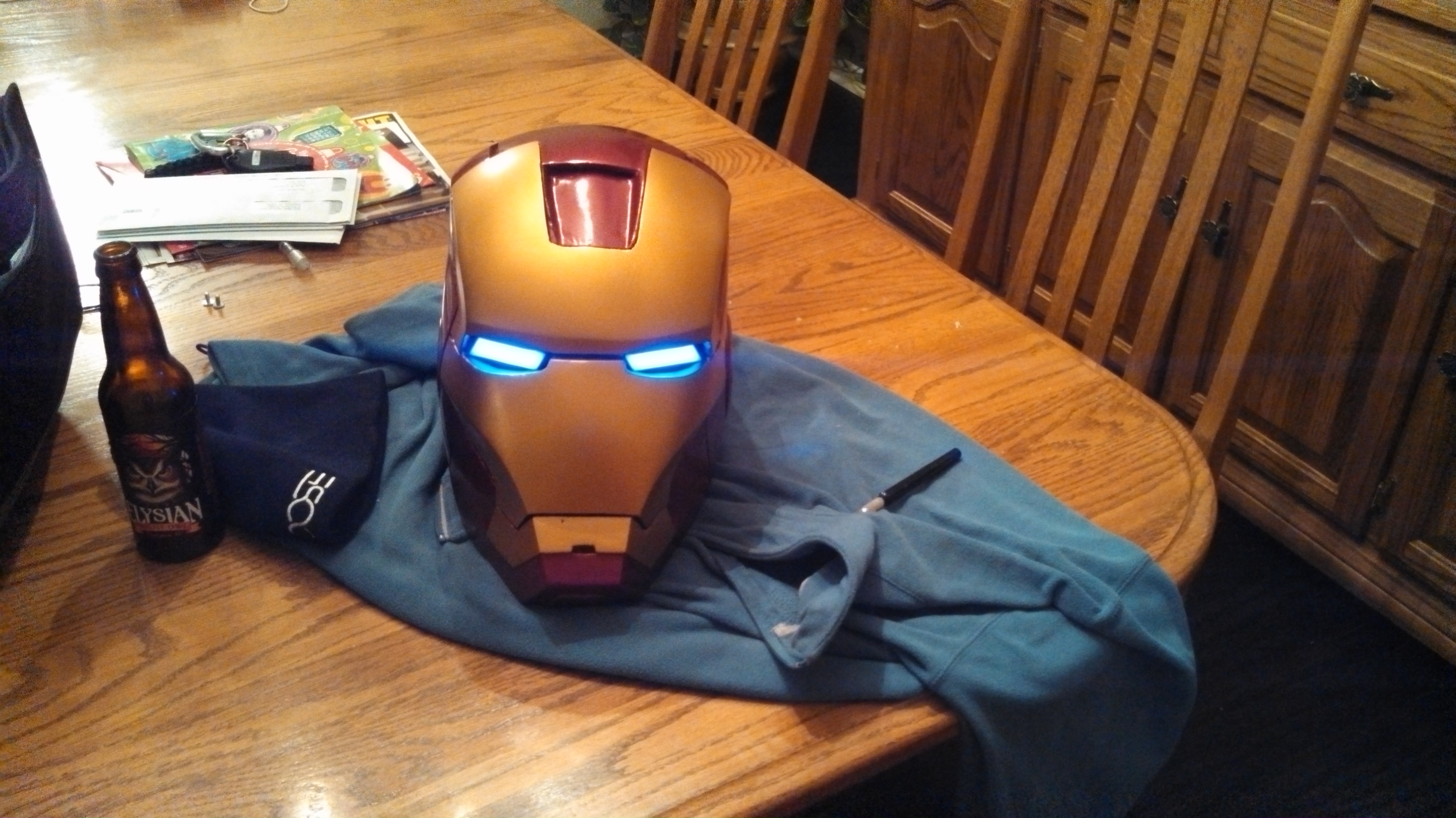

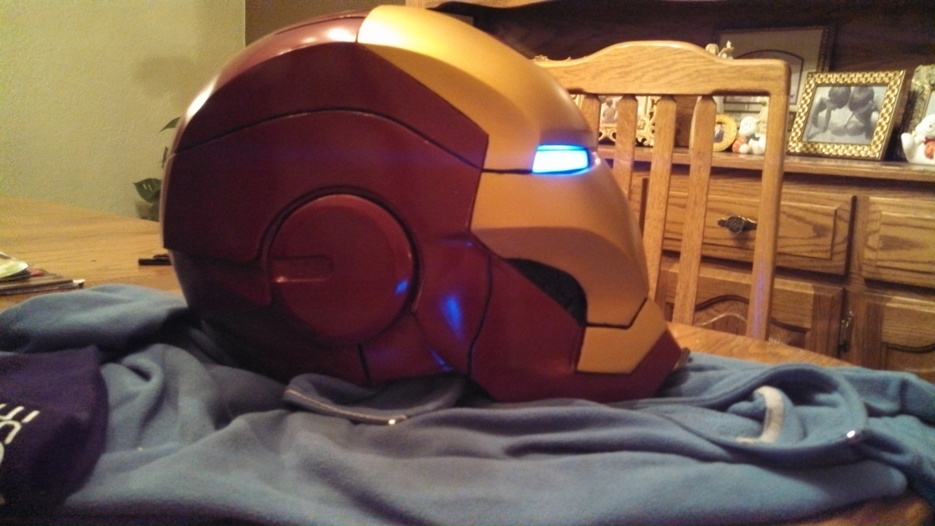

I am going to call this semi-finished. Here are the photo's of the paint and detail paint.

Thats bad ass! How did you do the eye lights? Could you post some pictures of the set up if you don't mind? I thought about making a MK8 or 42, War Machine, and Iron Patriot helmet and then attempt to cast it and make multiples but I dk where I would even start with that.
Re: My First project!
Thank Man! Glad you like.
Just some card stock and white opaque acrylic made the eyes.
Once I installed the LED's I closed it up and wrapped in electrical tape to prevent the light from leaking out.

Thanks RvanAken! I am quite proud of it. I will be doing more work to it in the near future. You can't see it in the photo's but the right side is larger than the left by about 1/4" among other things. I want this as good as I can get it, so when I cast copies for my kids they will have the best I can give. Good luck on you build.

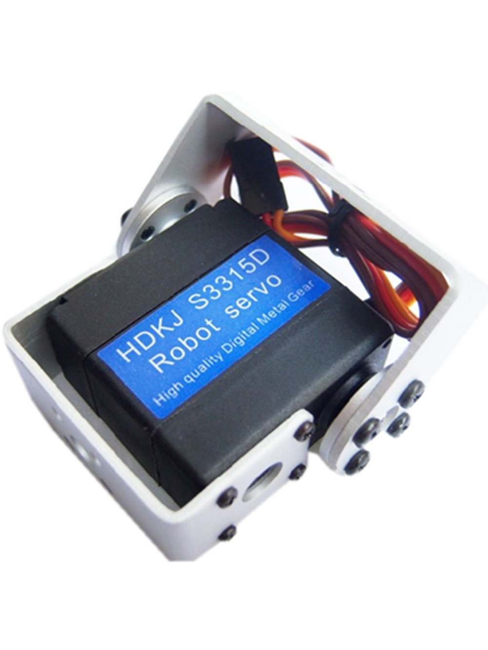

Anyone think this servo would be good for the face plate?? its cheap $19.00
Metal servo mount :U holder + round servo mount One piece sepcification: Size:40*20*40.5 Weight:60g Wire length:320MM Speed: 0.18sec/60 degree at(6v) 0.16sec/60 degree at(7.2) Torque: 14kg.cm.at(6v) 15kg.cm.at(7.2) Voltage: 4.8v-7.2v Dead Zoon setting:4 Microseconds Rotation Angle:maximum 180 degrees(Plug/Output wheel/Radio control system compatible with Futaba JR Hitec)
So no one has an opinion on this servo?

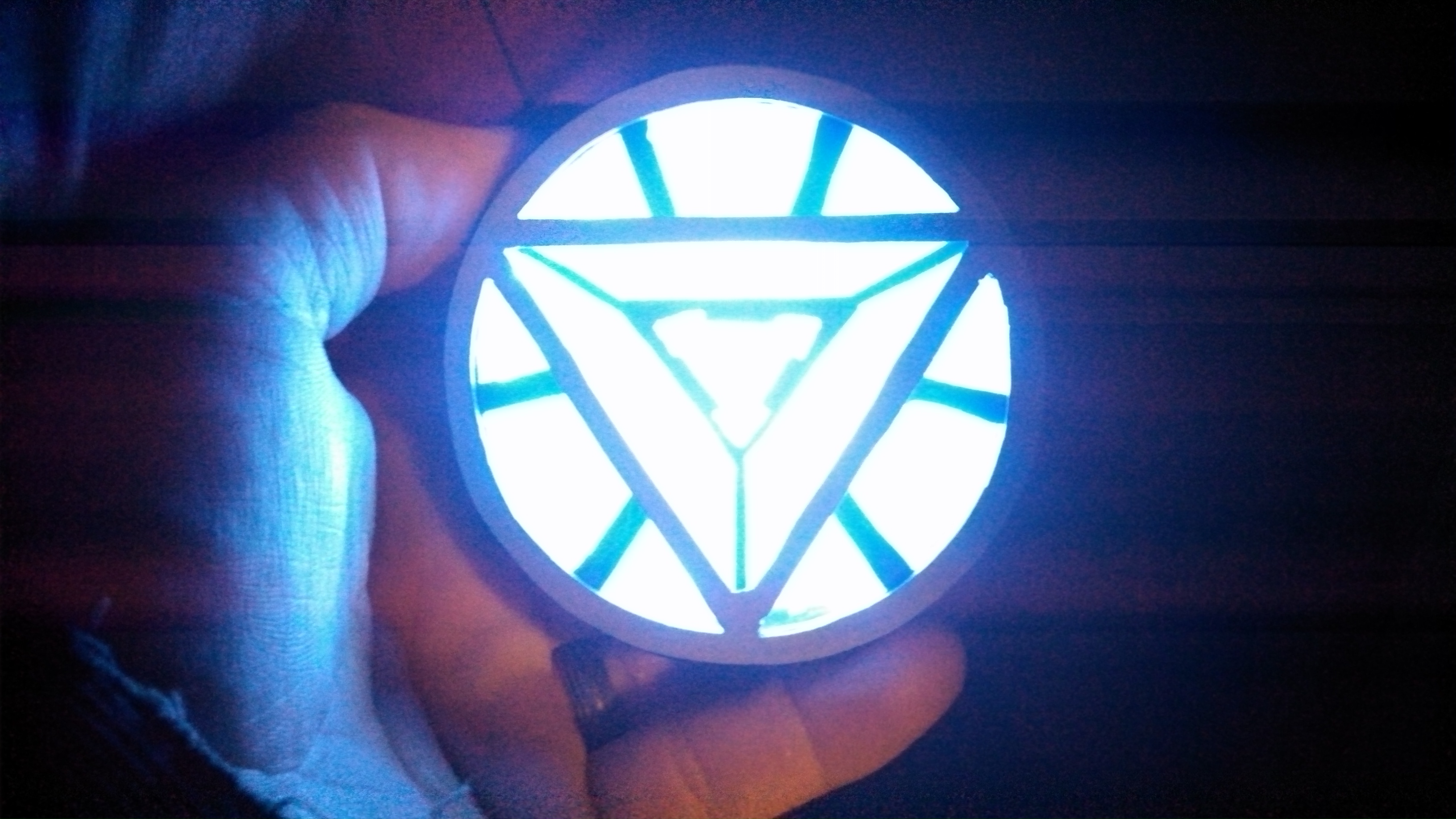

Here is the one I already made
Work in progress
I would like to know what SMD LED would be bright. Should I be looking for a 5050 19 lumen for example. and where to buy.
I used a LED light strip(From a hobby shop now out of stock) and a nine light flashlight board (cheapy from HD) for the one I made but I would like these brighter to shine thru a shirt.

I made the layers out of plexiglass. 5mm and 3mm and cut out using a scroll saw. lights I used are in my previous post.

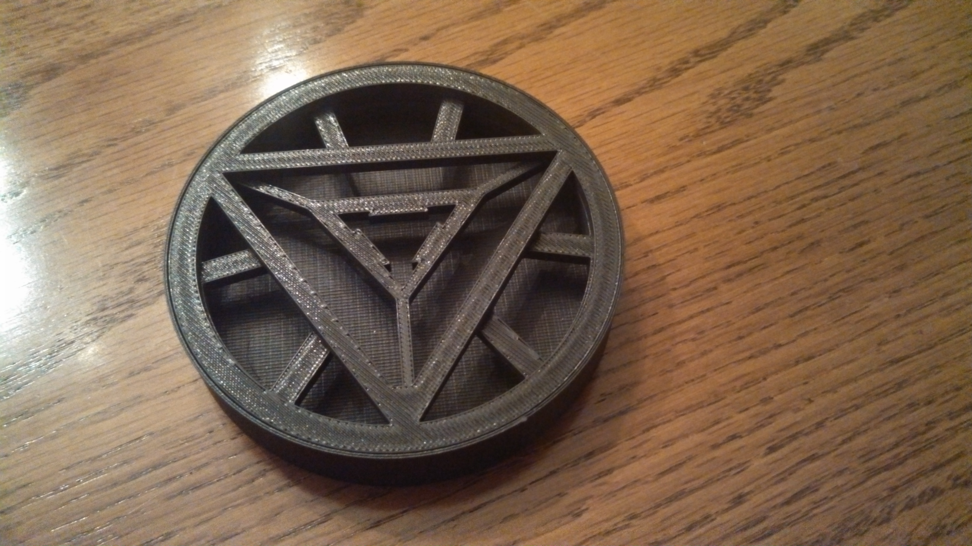

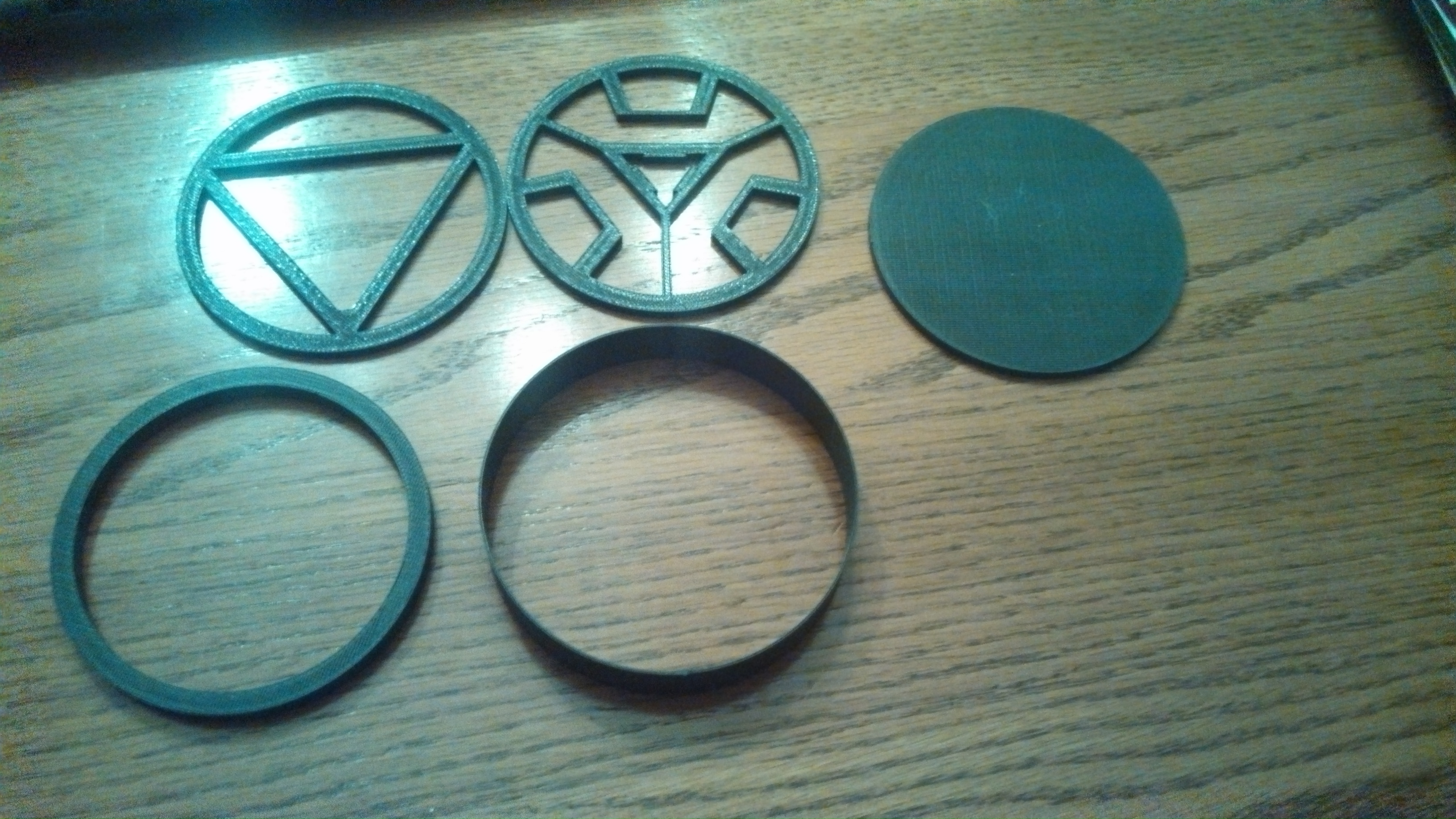

I am still side tracked on making arc reactors for my kids. So i found out my best friend had access to a 3d printer. I drew up 2d plans for what I wanted and he modeled over mine and made me some pieces. Still making some adjustments.
The pieces all separate
I guess this looks like the Iron Man 3 Ark reactor
And the final assembly of what I wanted.

I also took a leap and bought the servo in my previous post for the face mask. Hopefully it works out for me.

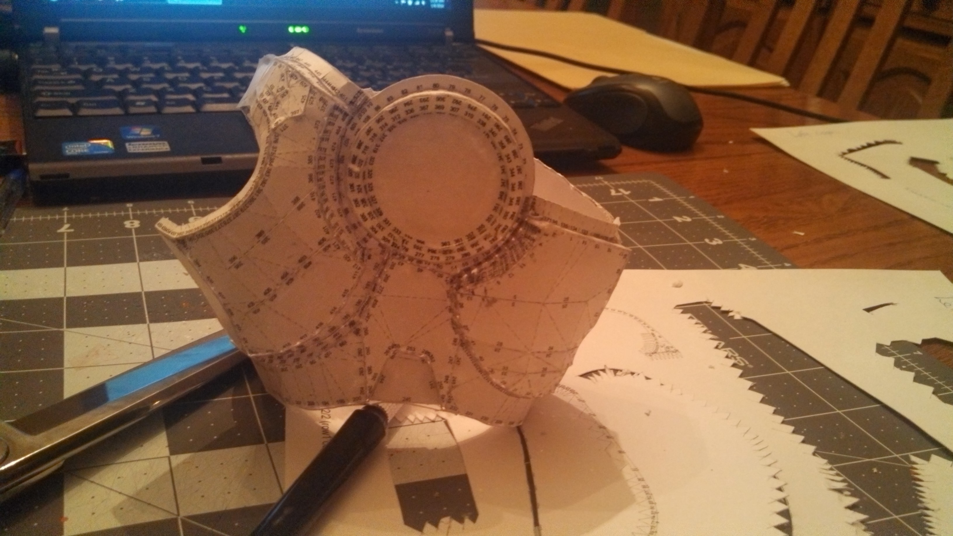

While waiting for parts on order, I thought I'd take a stab at doing a set gloves using Zabana's file. I only did the left and still need to finish. I don't want to do do a ton of these trying to get the size right but does it too small?? I did this at 1-1 scale. Seams like they fit now not sure after I harden them and Are you supposed to keep the gloves in to halfs when Finished.? Not sure how to go about that when I get to that stage.
Your thoughts??

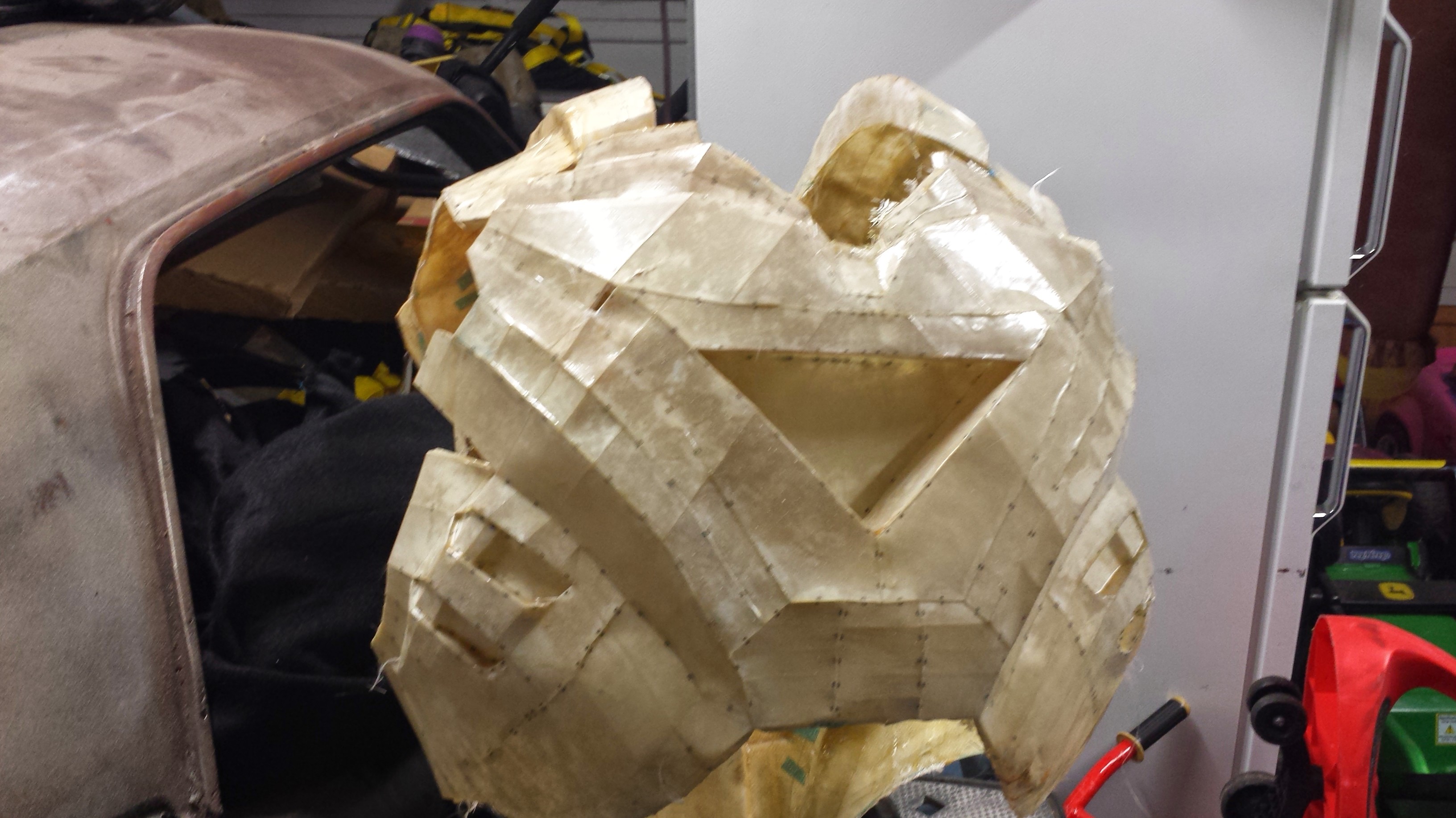

Should be getting back to work on this soon. Been so busy at home and work. I've got the left palm almost done the fingers not so close, Also got the chest, back and neck seal put together still need to harden. Pics will follow in a few weeks or so.
Finally got a bit of free time in the garage.
Real close to being able to put some body filler on.
