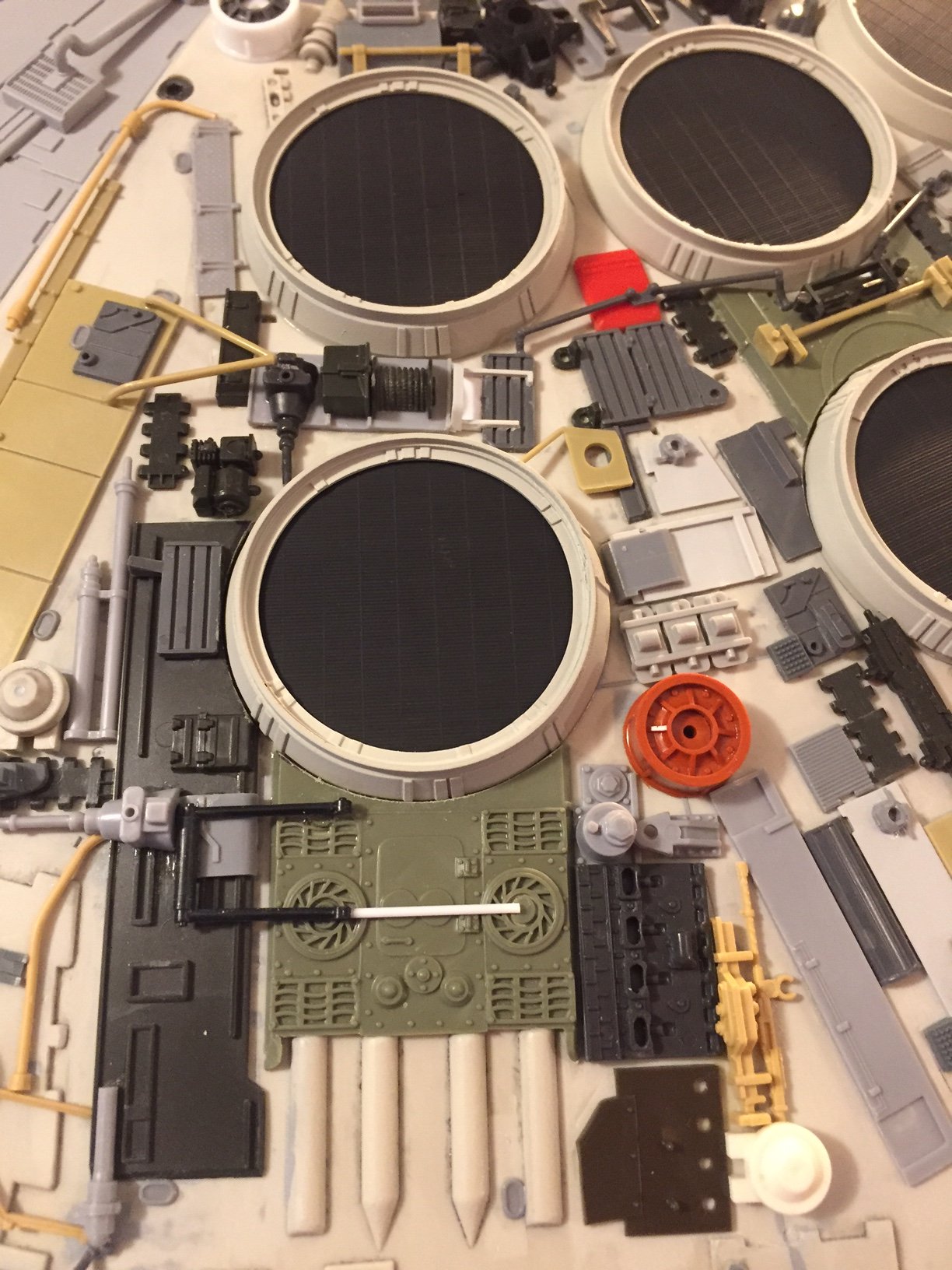

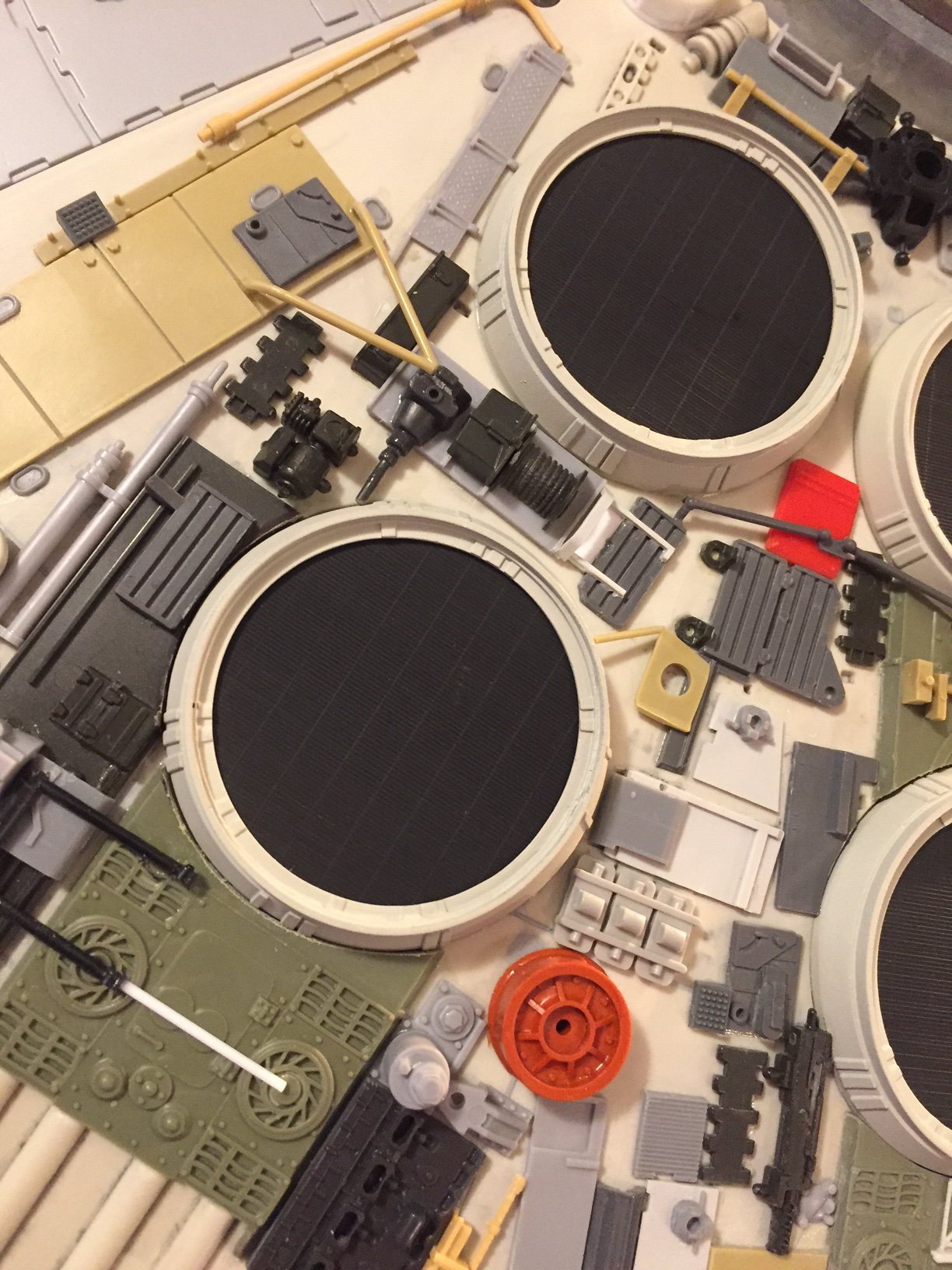

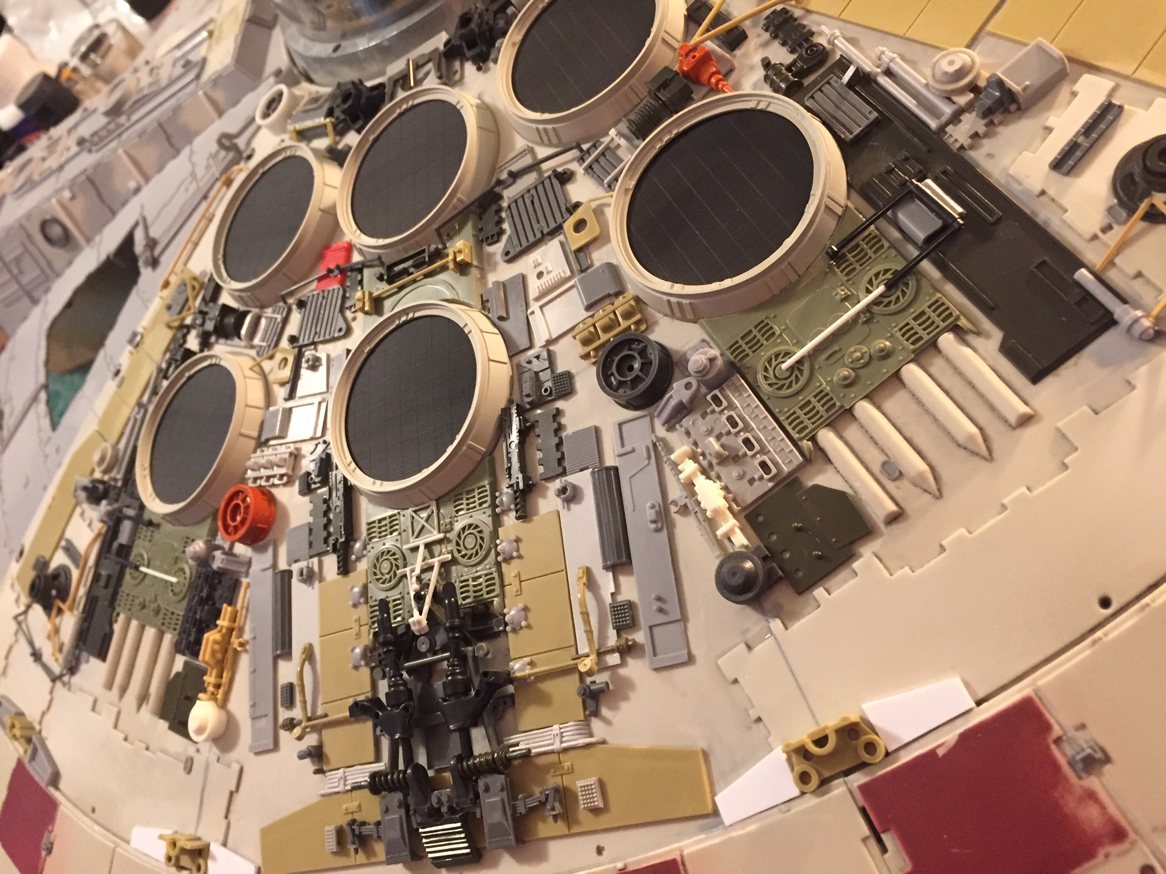

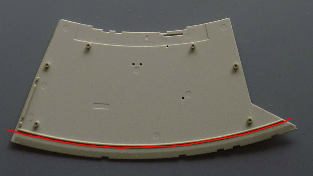

Yeah I am going to sand off the original plating and trim the hull edges/pit sides back so that the new hull plating hangs over all the edges correctly! Plus I can fill all the seams as well so you don't see those big gaps in-between the plating that you get now from putting them all together.
(ill cut the hull back to that lip that is there all the way around to get that shelf you see on the SS model and allow the new plating to hang over correctly)
If I had this to do over I would have just used the armature and all the hull shapes sanded flat and built it all up from those raw forms, I clearly didn't plan this all out very well haha but to be fair I only decided to do all these mods half way through the build ; / I already have painted the lower hull haha going to have to scrap that and do it all over after I get all the kit parts on it and new plating... This model is such an undertaking and time/money investment I just decided to take it as far as I could so I would be happy with the final SS scale replica and not look at it and say I wish I would have done "x" might as well take the extra time to make it exactly how I want it.

Silly question, how will you be sanding down the plating without distorting them? Are you gonna sand them down while they are attached to the metal frame? I had thought about doing this to just the outer edge pieces but was afraid I would warp or break them in the process.
WOW Ktaylor, this is quite the endeavor! I suddenly feel so inadequate, lol.
I'm going to take the panels off the armature and sand them down individually using a glass sheet that is true with some sandpaper on it, the hard glass really helps the sanding process and lets the paper really cut well. The plastic is pretty flexible so it should work well, this is basically how I sanded down the sides of the corridors on the hull to add the plating back on page one of this thread and that worked out really well. Once I get the plating off I will re attach the pieces to the armature and do a quick final leveling pass on them and seam filling, then glue on the new hull plates.

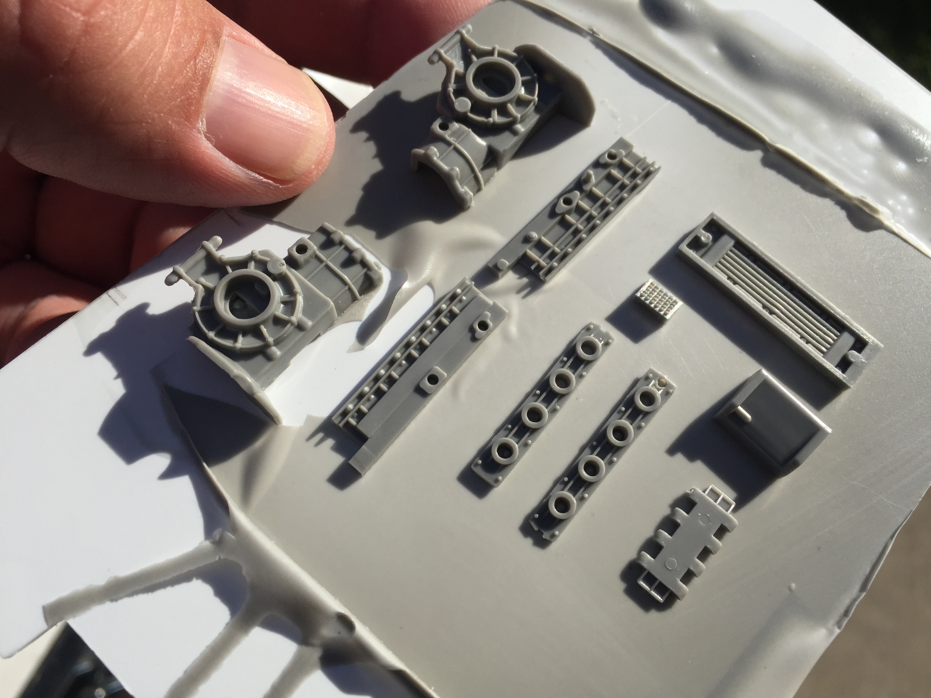

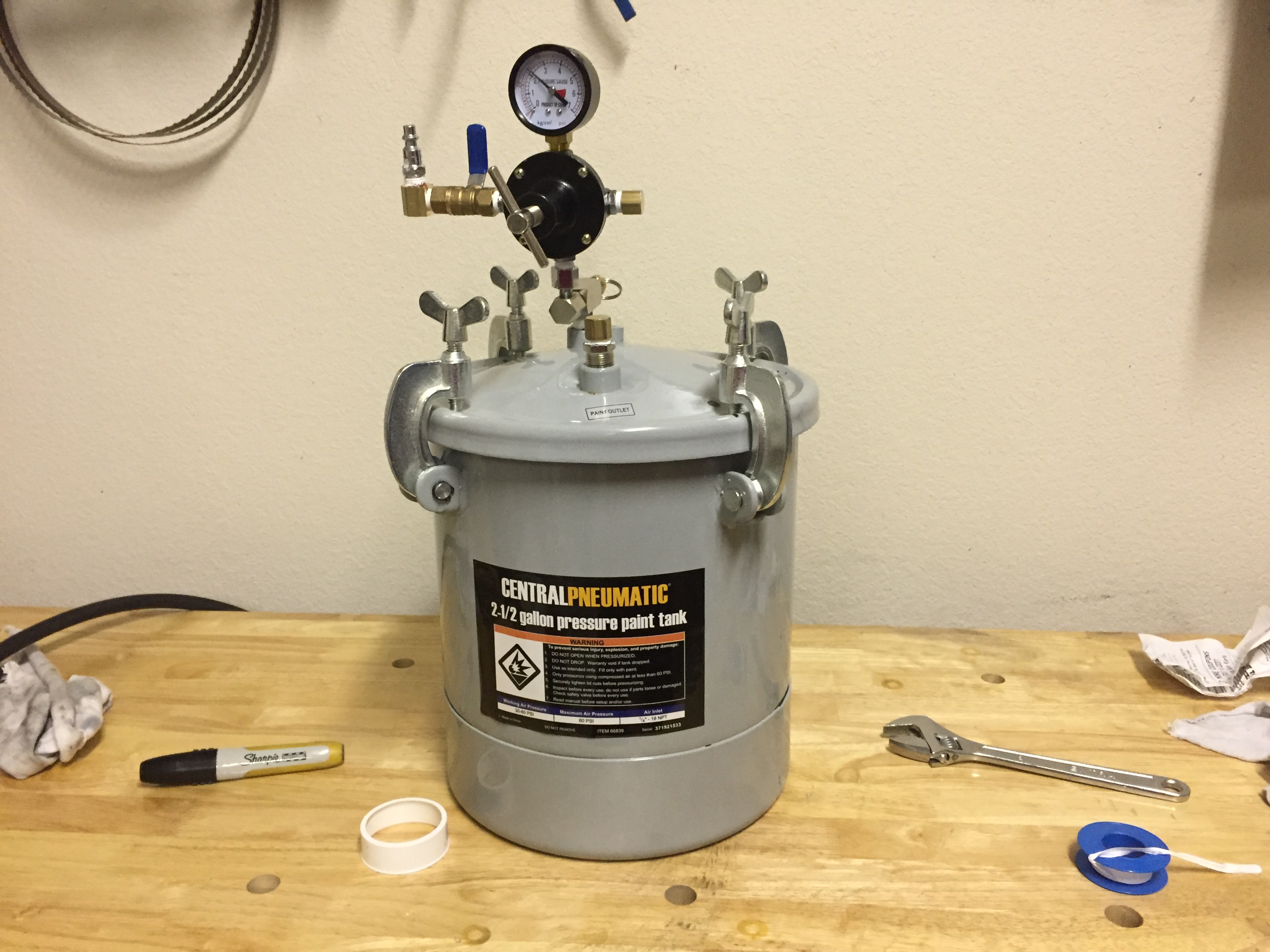

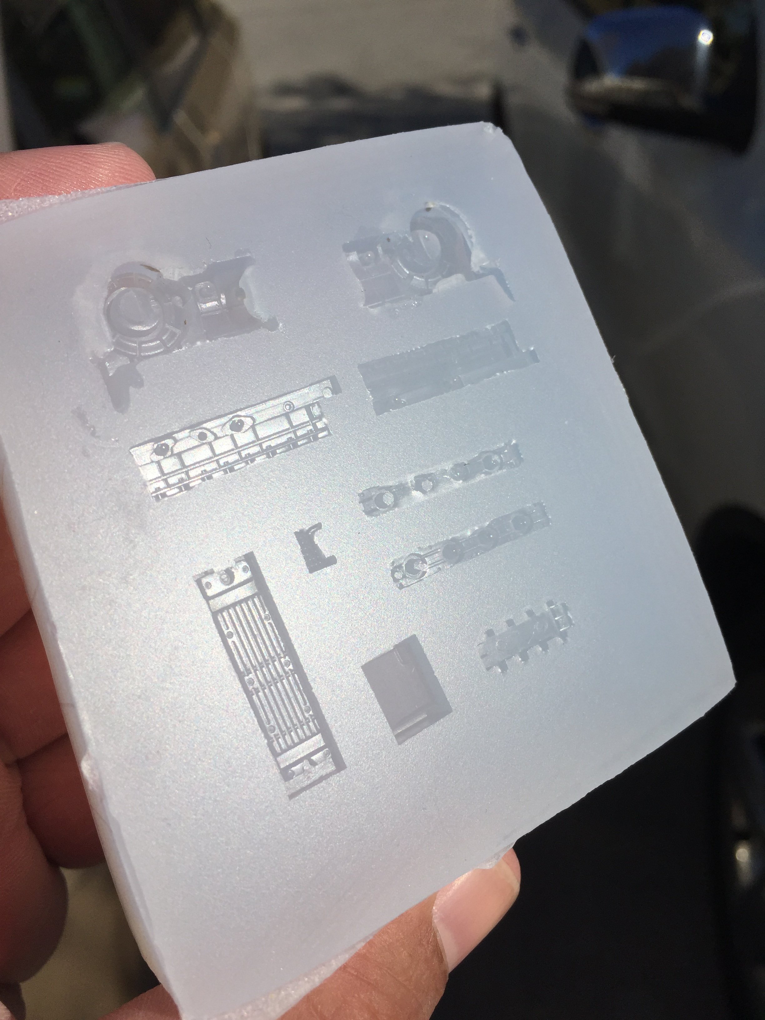

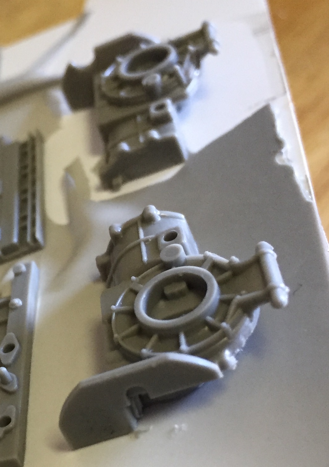

Did my first pressure mold/castings, turned out great! Really impressed with how clean and bubble free they came out, guess this pressure stuff is that way to go!
i got the cheapie HF pot and replaced most of the brass, using a little 100psi pancake compressor with no probs! Used smooth on silicon MoldStar 20-T and some 1:1 allumite(sp) slow set resin ( 7/30 pot/cure time)
Used 30psi for both the mold and the resin and it worked great!
should more than pay for itself with all the kits I don't have to buy multiples of! Excited!

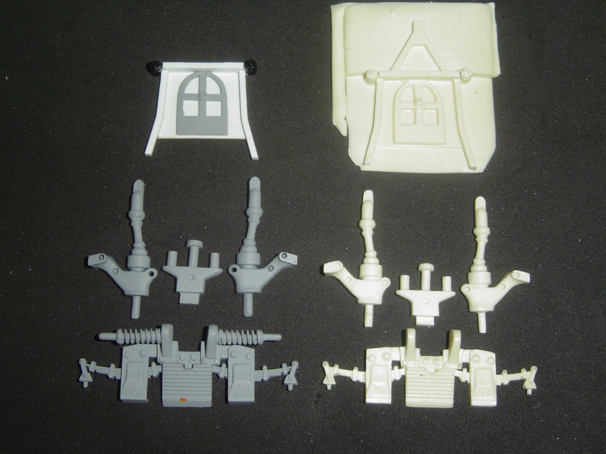

They way I understand that quote is that it is a 'no-no' to try and sell anything that is, or was, being promoted by someone who is considered to have been 're-casting' someone elses work...But I know for sure that others have molded and cast specific parts from model kits to be used in studio scale modeling, and that sets of those cast kit parts have been sold.
So IMO it should be fine to offer a set of cast kit parts...BUT...that is just how I see and understand it, you should try and see what others say about this too, I would also like a definitive answer on this.
I made a cast of these parts a wild back and sold them her at RPF it was a short run. All my orders dune thru PM DSC00227.JPG

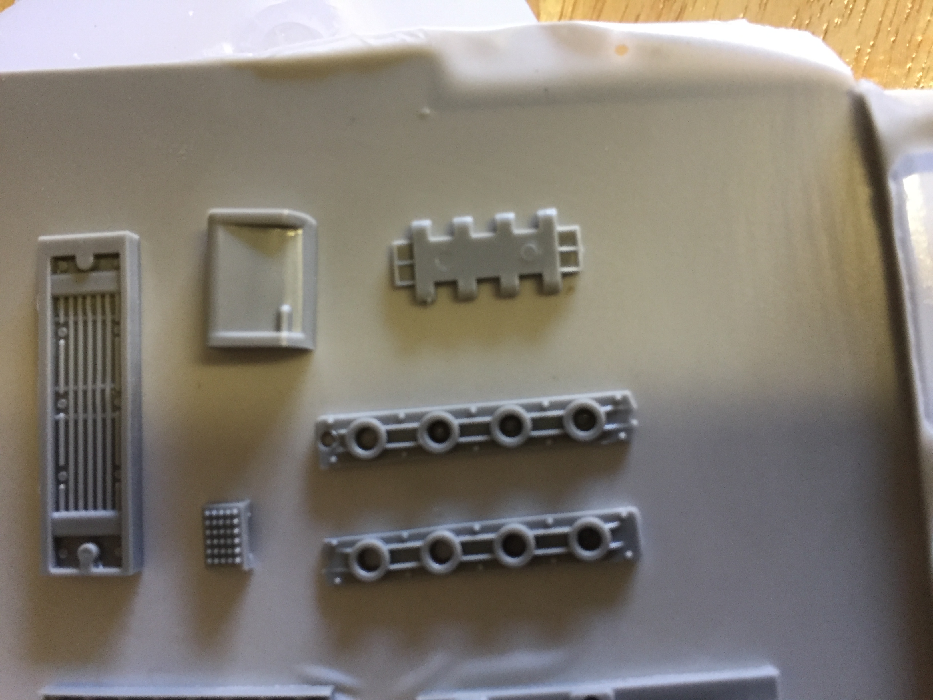

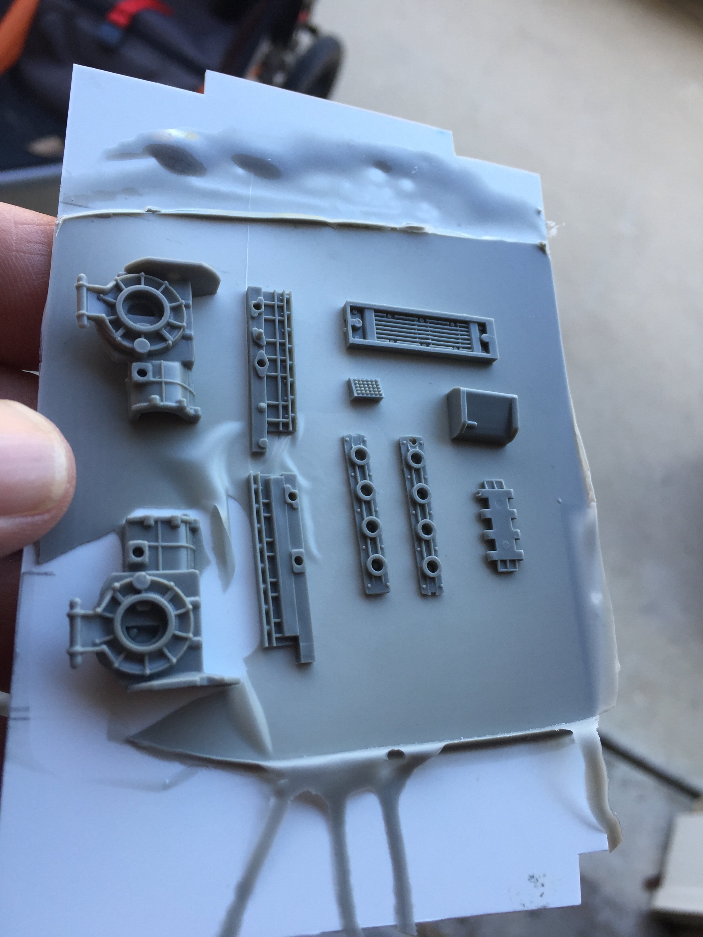

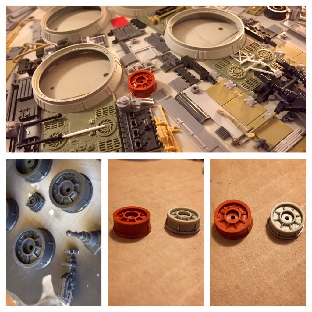

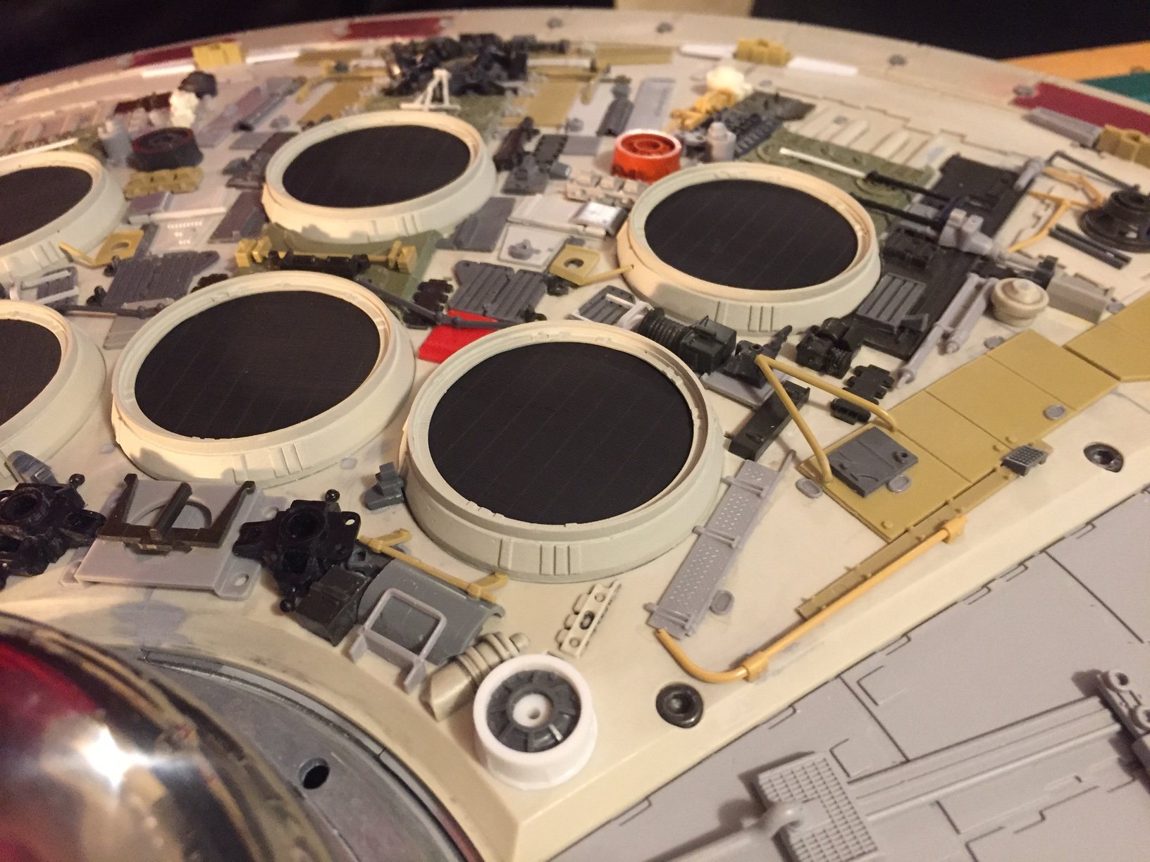

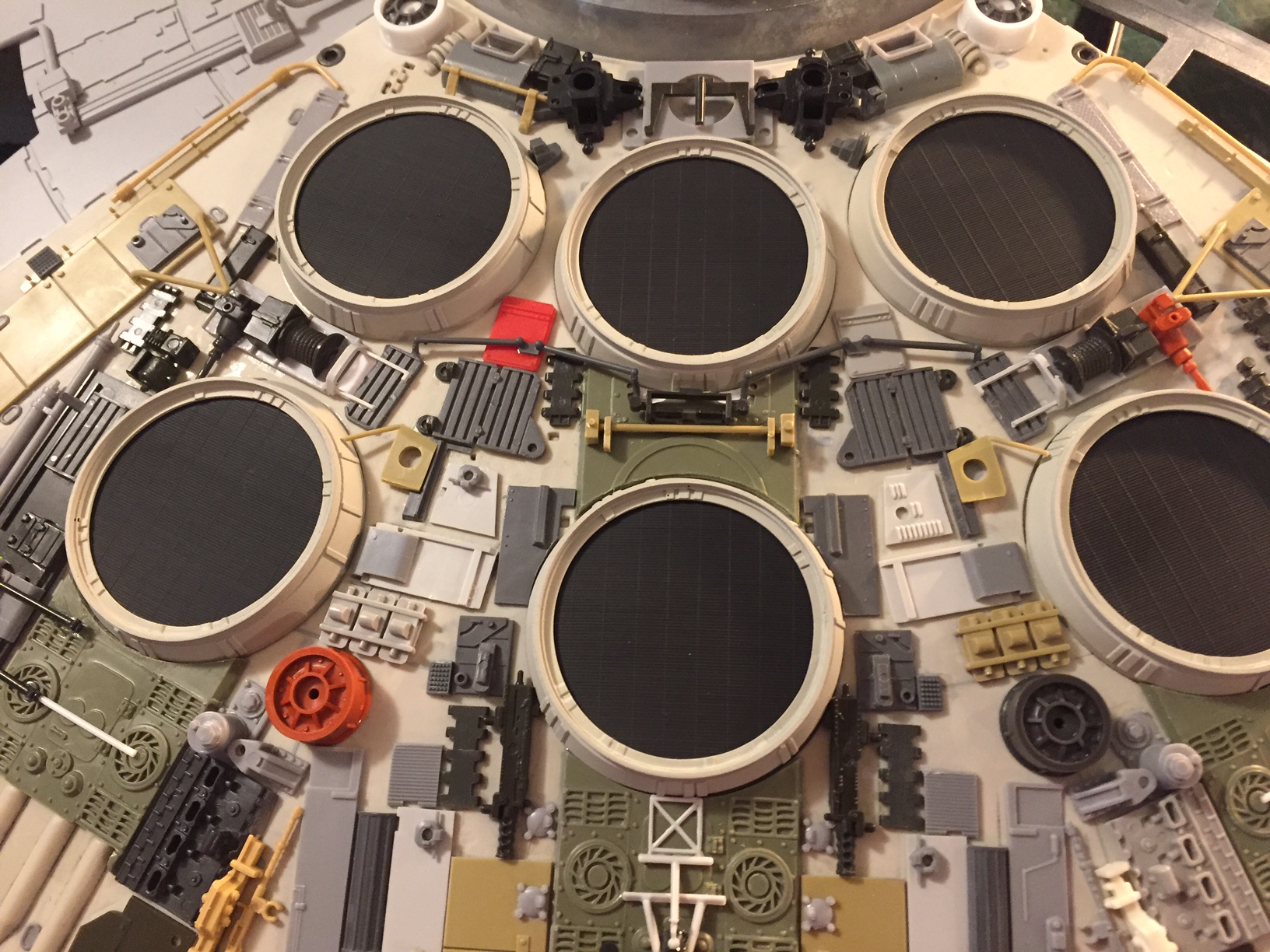

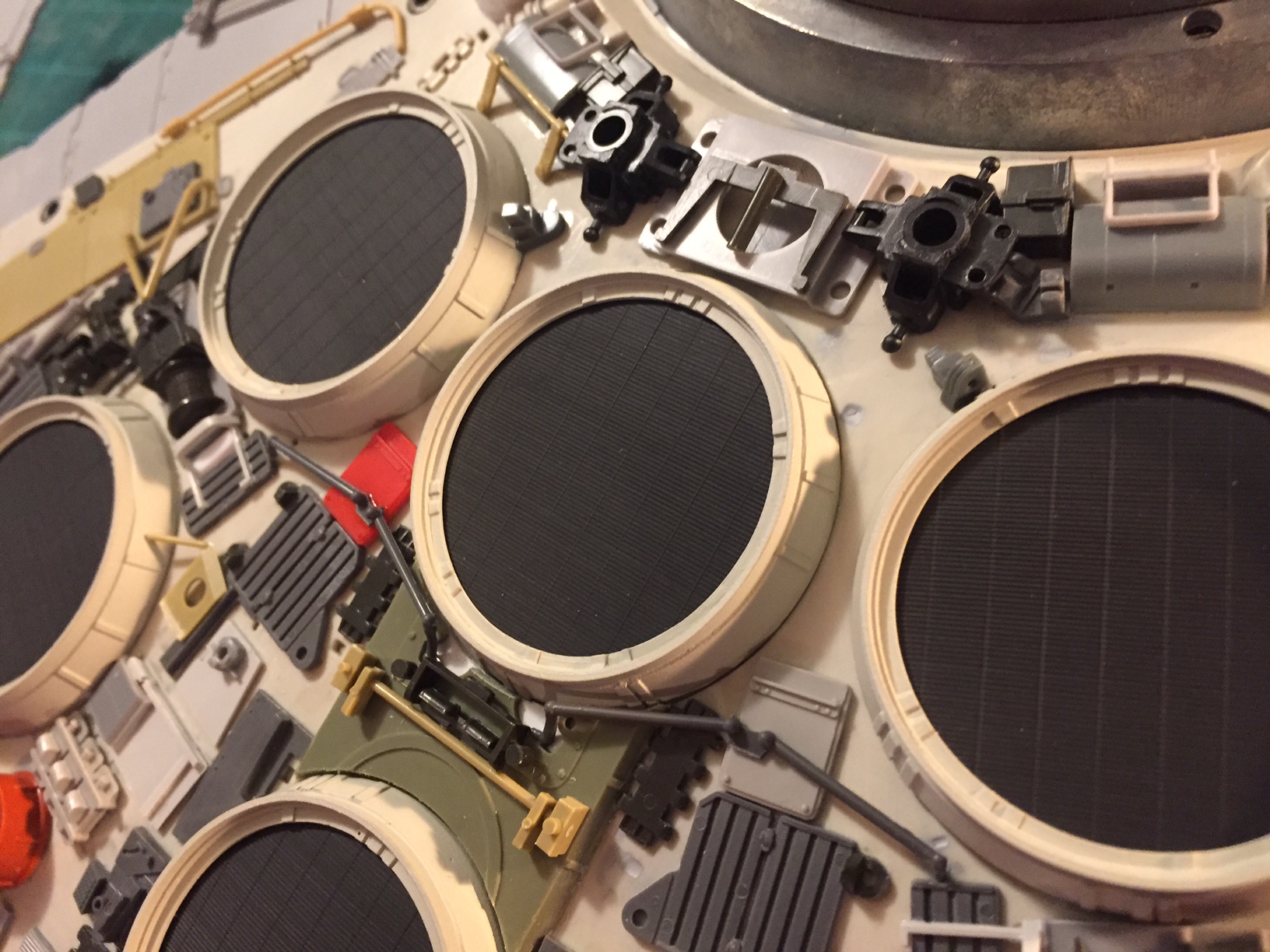

Finished up the molding and casting for my new Engine vents, love they way they turned out and couldn't be happier! They are a 2 part set with the ring as one casting and the vents as a separate casting that fits in the back of the rings, makes working with them and painting much easier. The vents are cast in Black resin and Ill prolly just weather right on top of that without painting them.
Got to finish out a lot more of the detailing on the deck as well now that they are installed! Close!!!!
