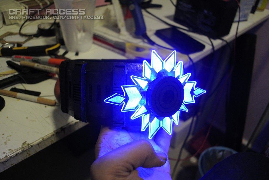

The Five Lives of Albios-Warlock Bond
This one was made by craftaccess.deviantart.com

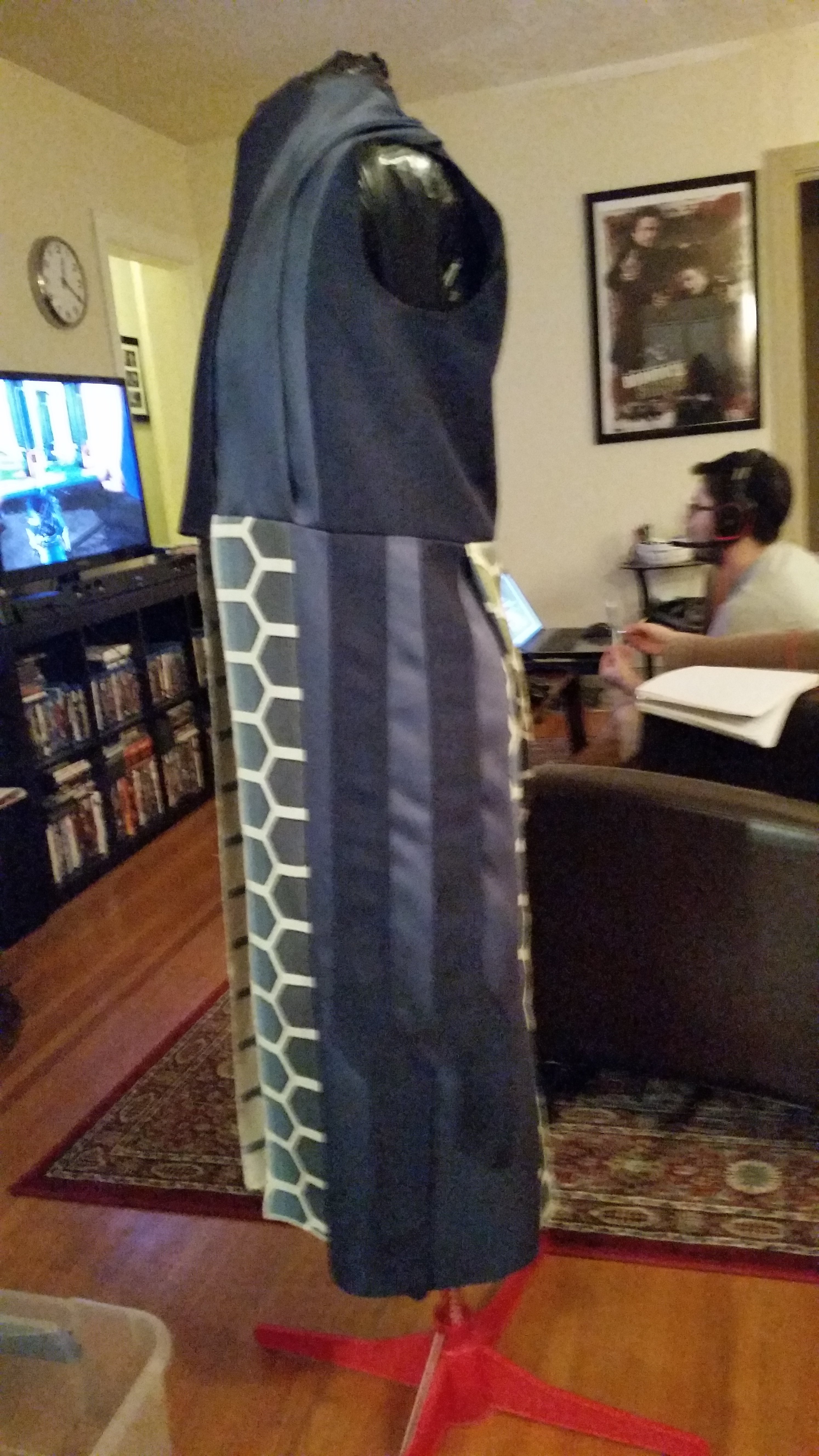

The pattern for the cloak was pretty straight forward. I used a drafting pattern from Pattern Cutting for Men's Costume by Elizabeth Friendship.
It was one of the first drafting patterns in the book (the basic upper torso draft). There is a nice little chart in the first few pages tha help you out if you don't get every measurement under the sun (like cross chest or arm-scythe depth). One thing that bugged me is that the armholes were pretty small. I will get to fix that in the next few days and then double check the sleeve hole.
For the skirt part of the cloak I just squared down from the princess seams (normally dead center between the center front and the side seam) and worked me way down for 30 inches. I then added the design lines and made some notches for matching.
So far this is what I have. Unfortunately I cannot get exact fabrics but there are different color shaders in the game so I guess I have that going for me.
Next I will be fixing the arm hole, sleeves and add lining to the skirt. Then start drafting the collar, shoulder decorations and the hip flag (as seen on a few YouTube channels).
