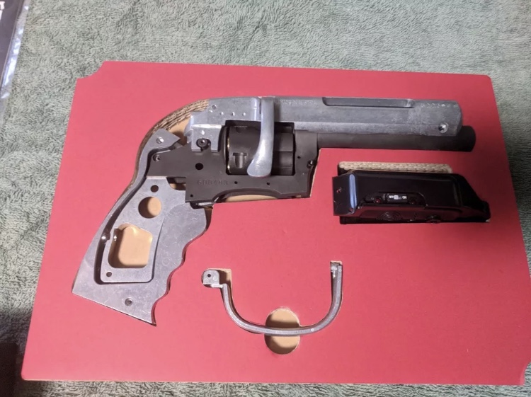

So I finally got my kit in and put it together last night. There were two main reasons for this: one was so I can see where everything was supposed to go and if there were any problems I would need to address.The other was because I was super excited to get it.
Now one thing I did notice was my grip is a little bent. I’ve never really worked with resin but from what I’ve read it is fairly normal and heat should be able to bend it back into shape. So that is one thing I’ll need to do.
Another thing I noticed is my real weaver knob has a different thread size from the Tomenosuke Part. While I figured that would happen, I thought the threading on the Tomenosuke would be larger. But nope, it’s smaller. And it looks like if I try to drill it to the larger size I will break through the metal on one side.
So guys who have added real weaver knobs: what did you do to get your weaver knob on there? Any advice will be great!

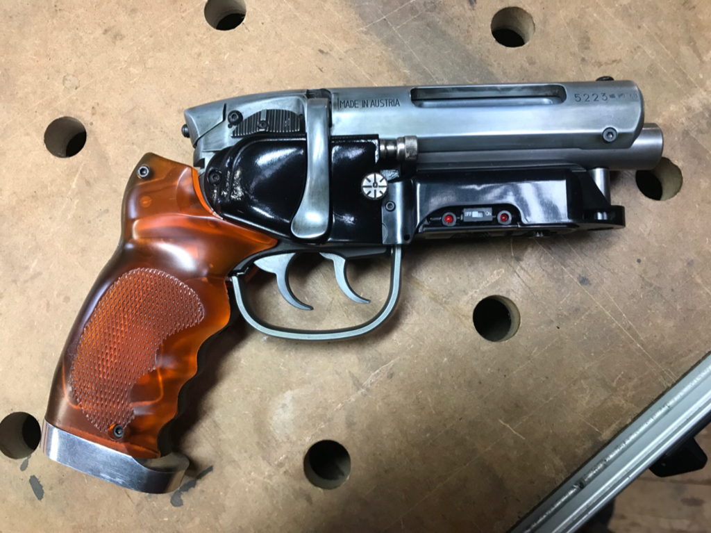

I’ve got a quick update for you all today! The wires have been added to the gun, and for the time being it is finished. So what we have is:
- A Tomenosuke Assembly Kit
- Added Steel Barrel
- Real Binding Post
- Real Weaver Scope Knob
- All metal pieces that are gloss black painted with Enamel
- All other pieces blued.
- 30 AWG Teflon Wire added
- Butt plate painted and weathered.
One last modification I may do is I may go ahead and buy a Steel Cylinder to upgrade the kit even further, but since I would like to put a real Charter Arms into it at some point it may not happen. I also have not put in my real K- Frame trigger yet. I’ve also opted for a more natural weathering so while it has an overall World-Con look, I decided to keep things unweathered and let the pieces weather on their own.
Hope everyone enjoys this Holiday Season!

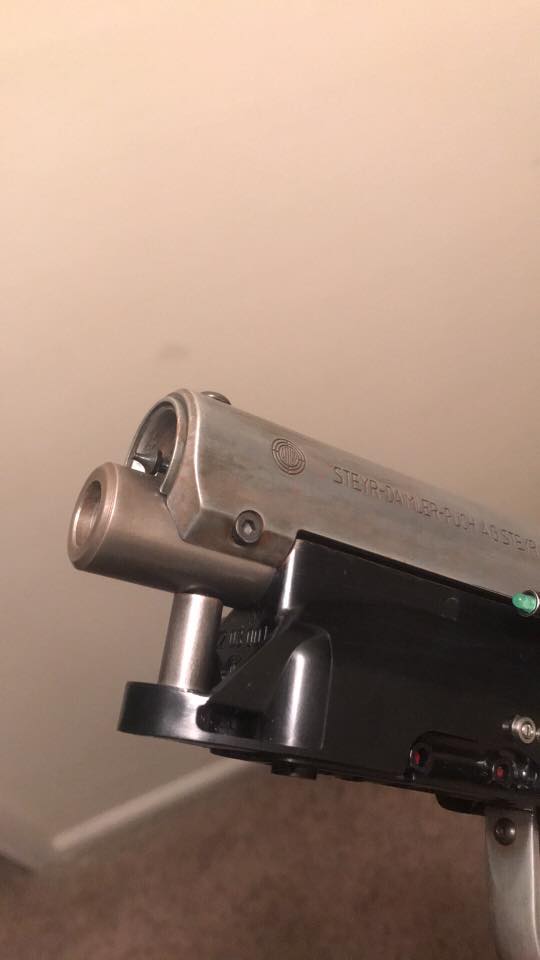

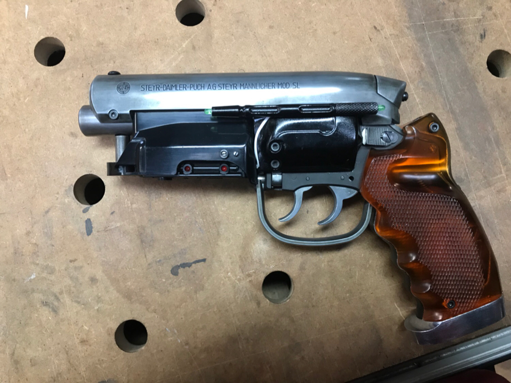

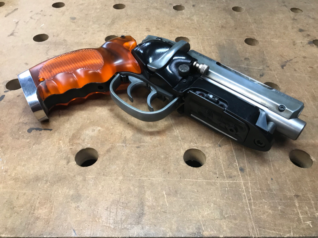

This is a long overdue Update, as I have been very busy with work and other things. But I have done some small but important updates to the blaster. You can't see EVERY one here as a couple are on the other side of the blaster, but here is where the gun stands as of the last update:
1. Lots of natural weathering on the sight rod
2. Re-Did my wires with longer ones.This gives a far more accurate look on the wire.
3. Blued and installed a Steel Barrel from Don Parker over on PropSummit
4. Removed the Screw holding both the Steyr and the right side cover (with the BP and the Weaver Knob in it) To the Bulldog. Surprisingly, the Steyr Mag doesn't move or flop around at all.
5. Put a chip into my Left side grip where it is on the world-con grip. I goof'd this up a little so i may need to find new grips and re-do it.
6: Took off the anodization on the threaded washer on the Sight Rod side of the Steyr Mag, as well as the color on the two installed Grup Screws
7: Installed and reblued a real Smith and Wesson K-Frame (This picture was taken before the rebluing
8: Reblued the trigger guard to be closer to what we have on the Reciver and Barrel.
9: Gave the metal blued pieces an acrylic rust wash in order to give it a rust look. it is hard to see, but when looked at closely gives amazing detail.
