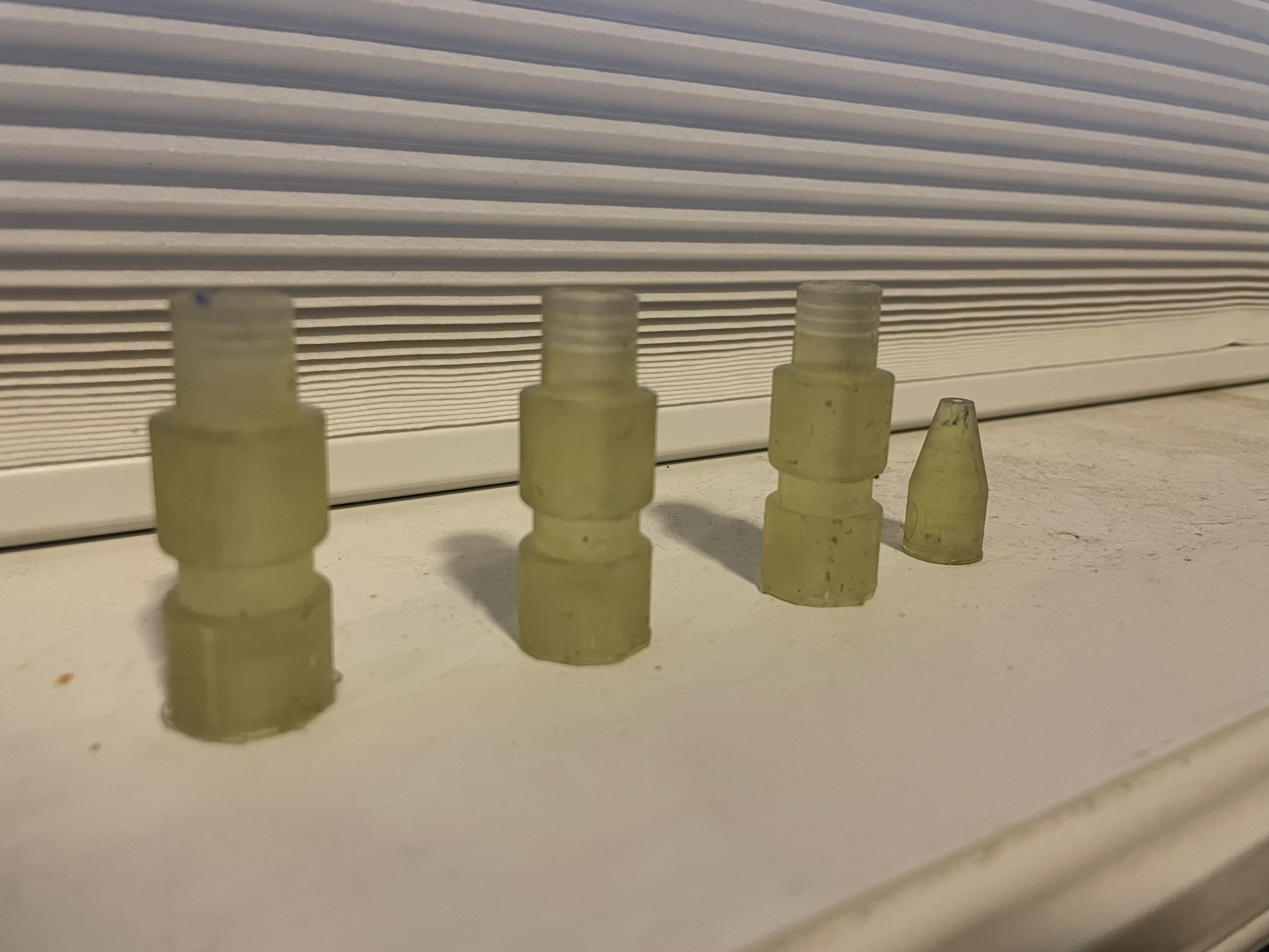

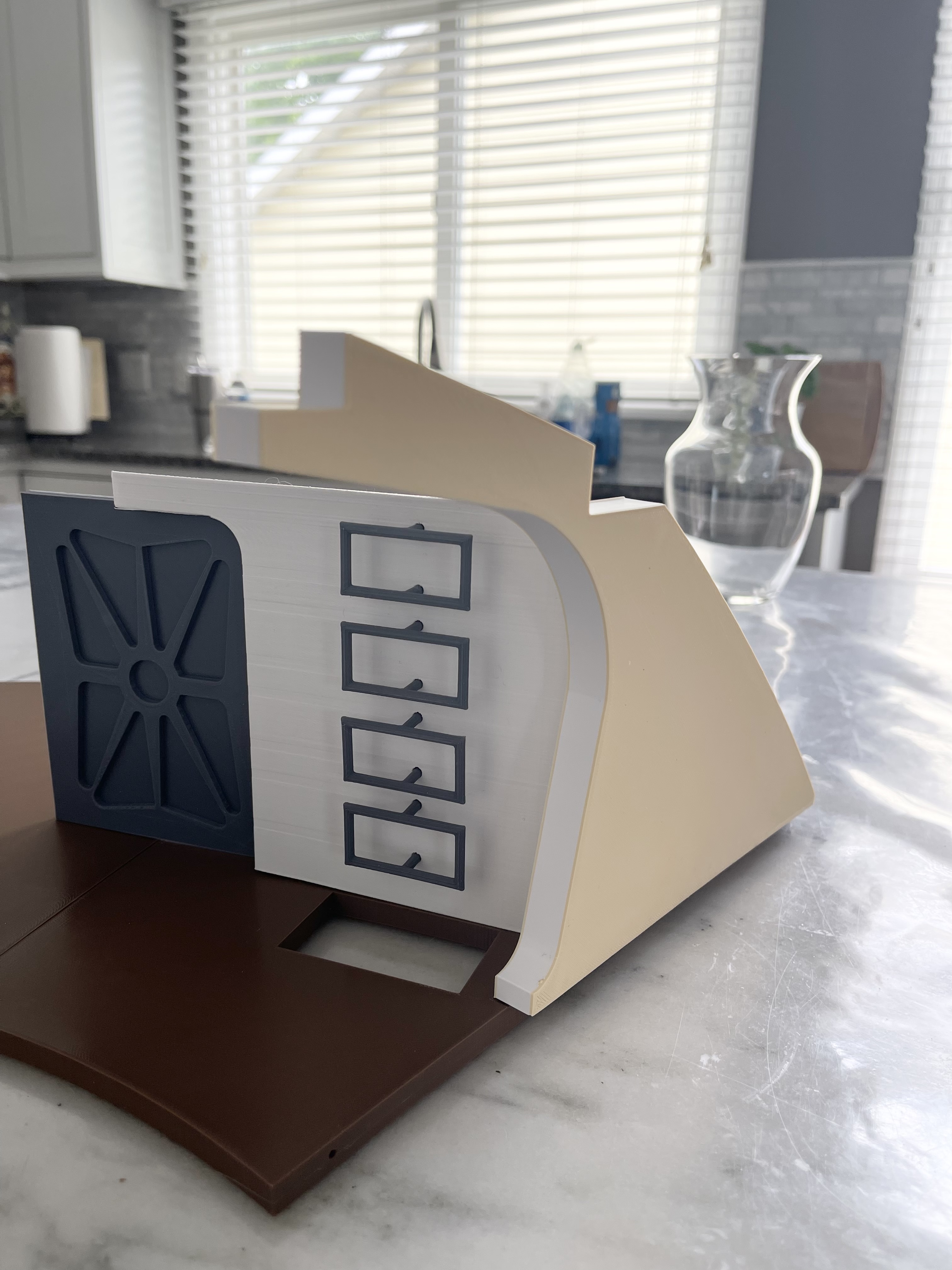

Some Boba knee cylinders for my friend’s Boba Fresh build. Printed on the AnyCubic Photon Mono X in SirayaTech Tenacious to give them some flex since they’ll take a lot of abuse.
Sean
Just tenacious?
How much flex does it have
I use tenacious with a mix of another resin
But never tried it on its own
It depends on the piece…
The knee cylinders are pretty solid so they don’t flex much.
I also printed some darts for Boba’s gauntlets. Those are much thinner and have a lot of flex to them. Will post a video later.

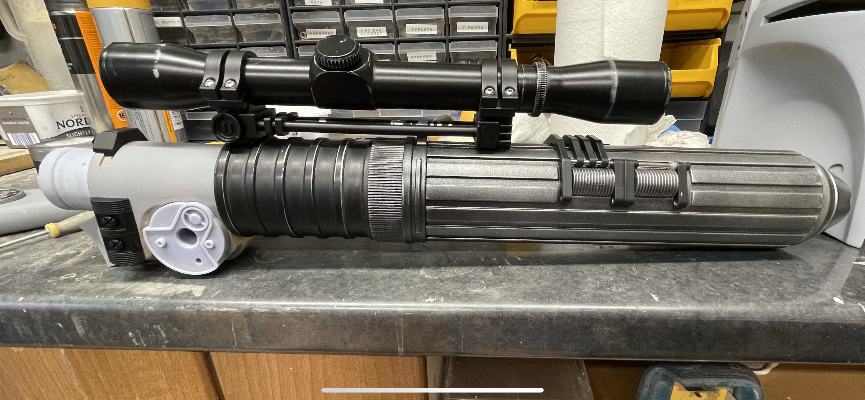

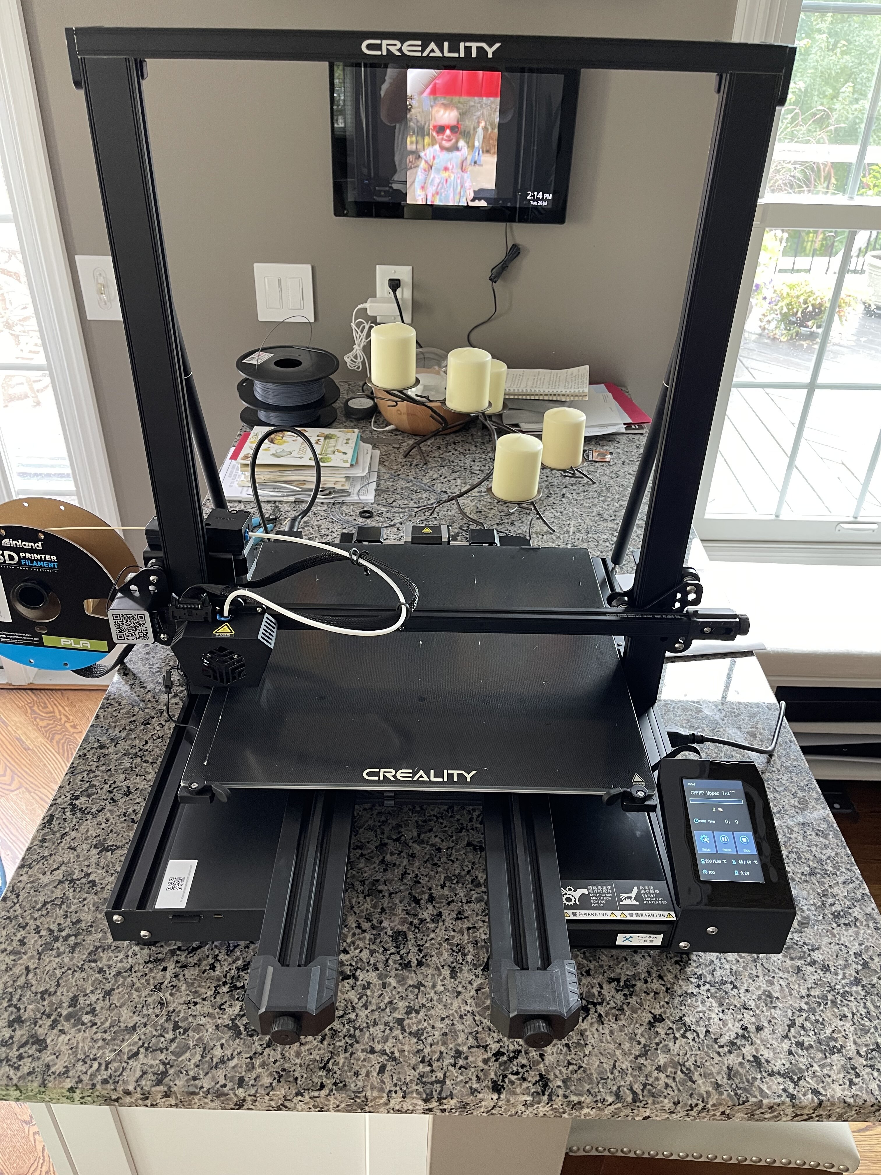

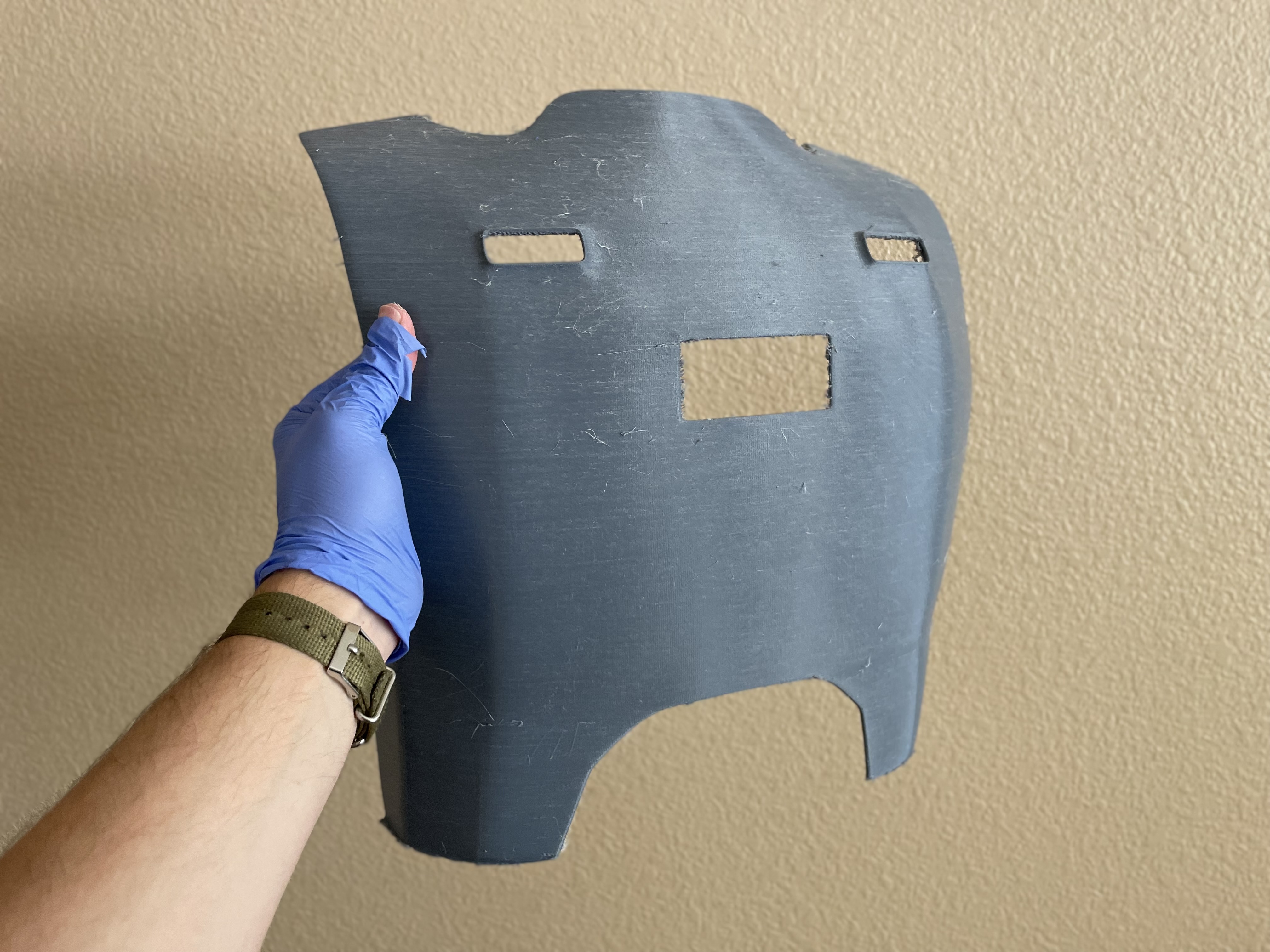

Helping a friend print his BoBF Boba Fett armor. He was struggling with finishing a multi-part resin back plate, so I threw it on the AnyCubic Kobra Max and printed it in one piece using PETG.
This was my first PETG print on that printer, so it took a bit of tweaking to get it working. I used Cura's "super quality" profile adjusted for PETG. In total, the print took just over 199 hours - my longest print to date! Overall, really happy with how it came out. Most of the stringing and goobers you see rub right off. While filament is typically more challenging to sand than resin, I don't think this will be too bad given the large surfaces.

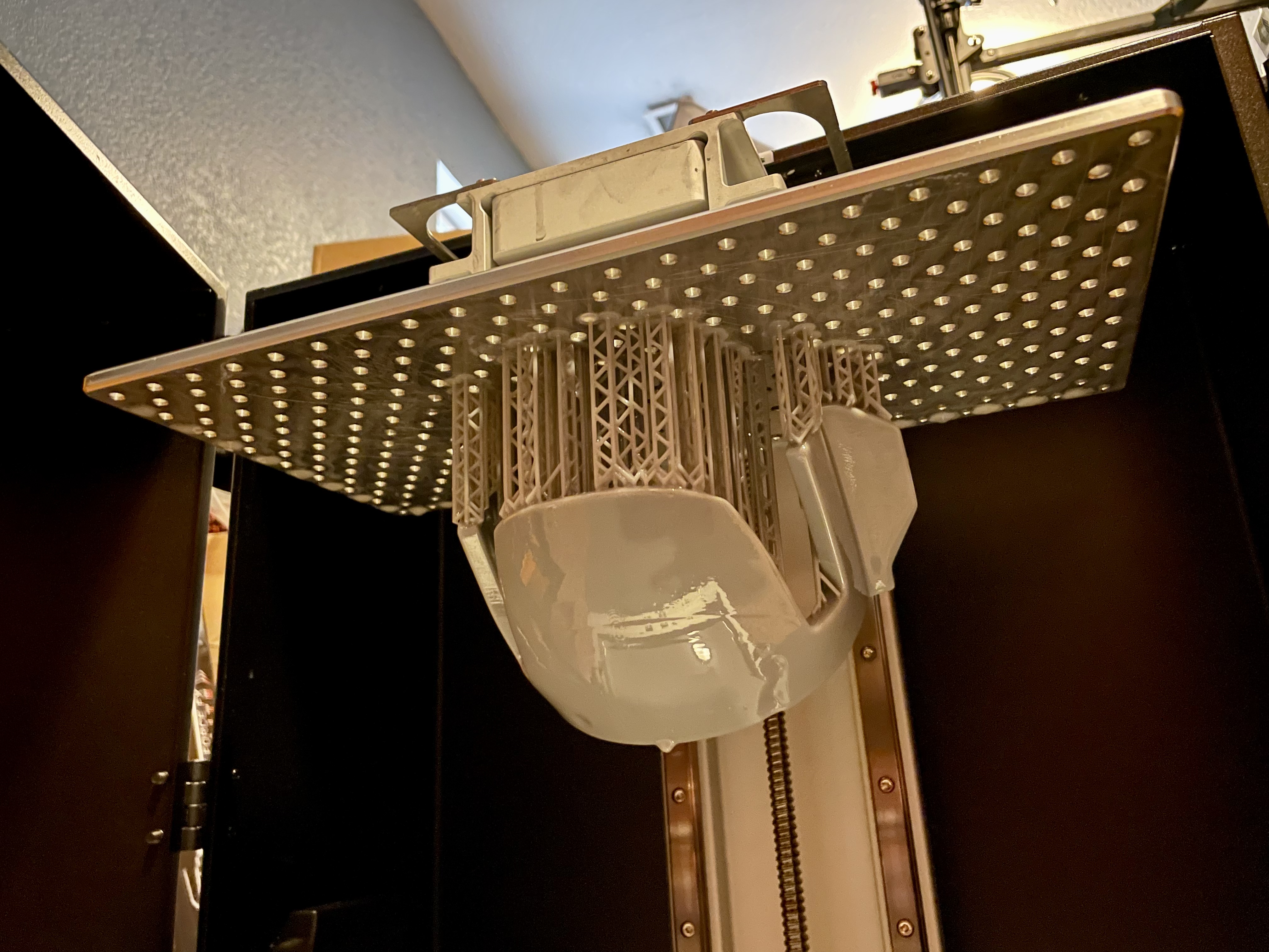

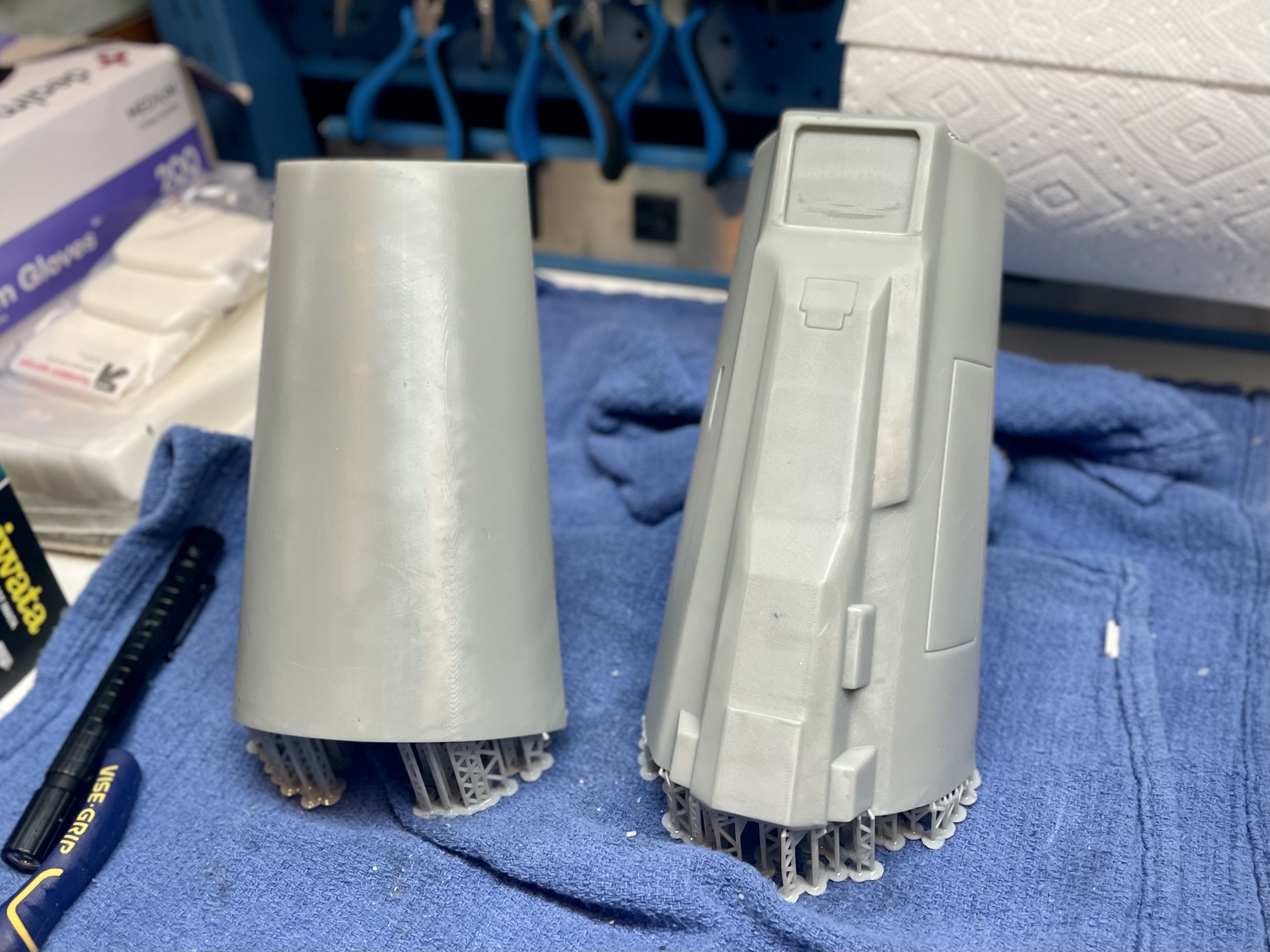

For the Mando and Boba Fett armor I’ve been printing, I’ve been using a mix of Phrozen’s ABS-like resin with a bit of Siraya Tech Tenacious.
Unfortunately, the Phrozen resin has been out of stock on Amazon for a few awhile now, and purchasing it direct from Phrozen costs a lot for shipping and takes a few weeks to arrive.

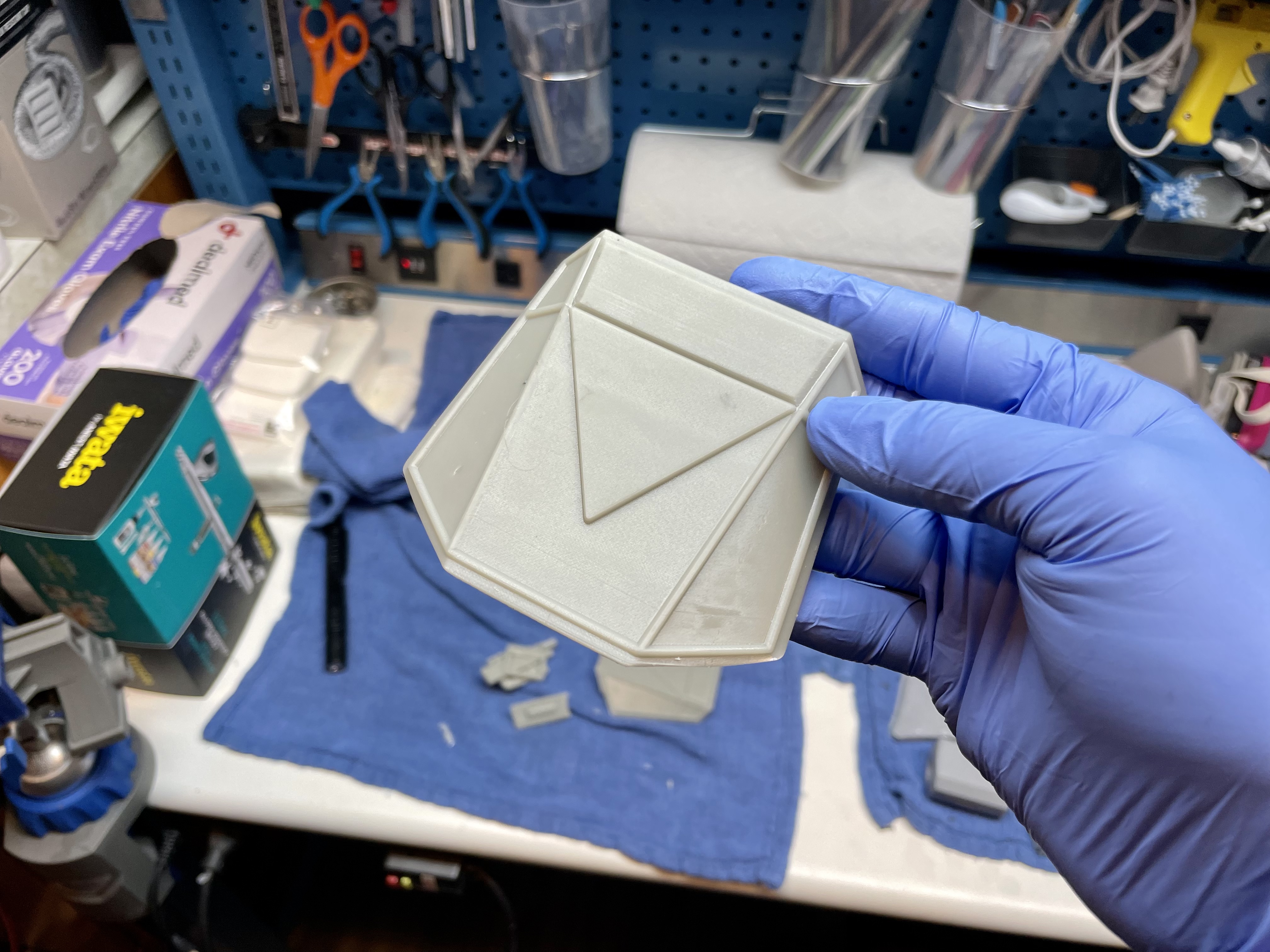

So I opted to replace it with Siraya Tech’s Fast resin (still mixing some Tenacious in). First print was my Mando knee plate, which came out pretty good!
Printed on the Phrozen Sonic Mega 8K.

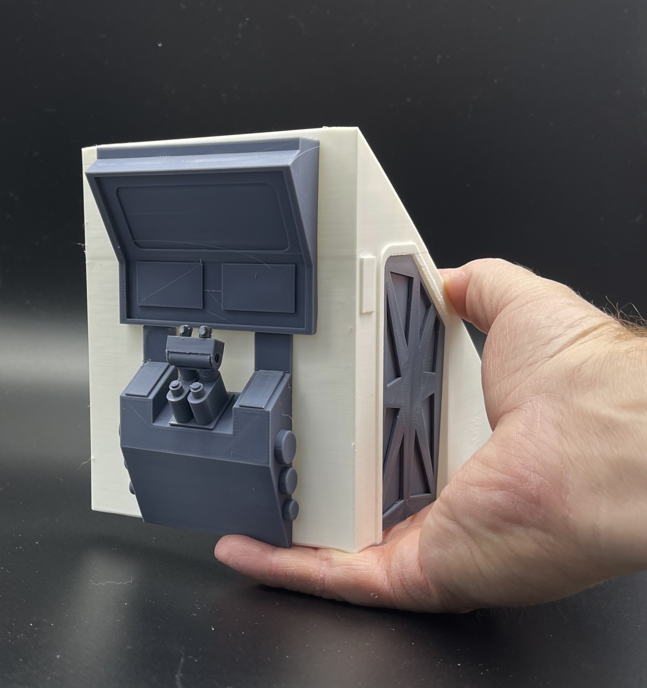

More Boba parts…

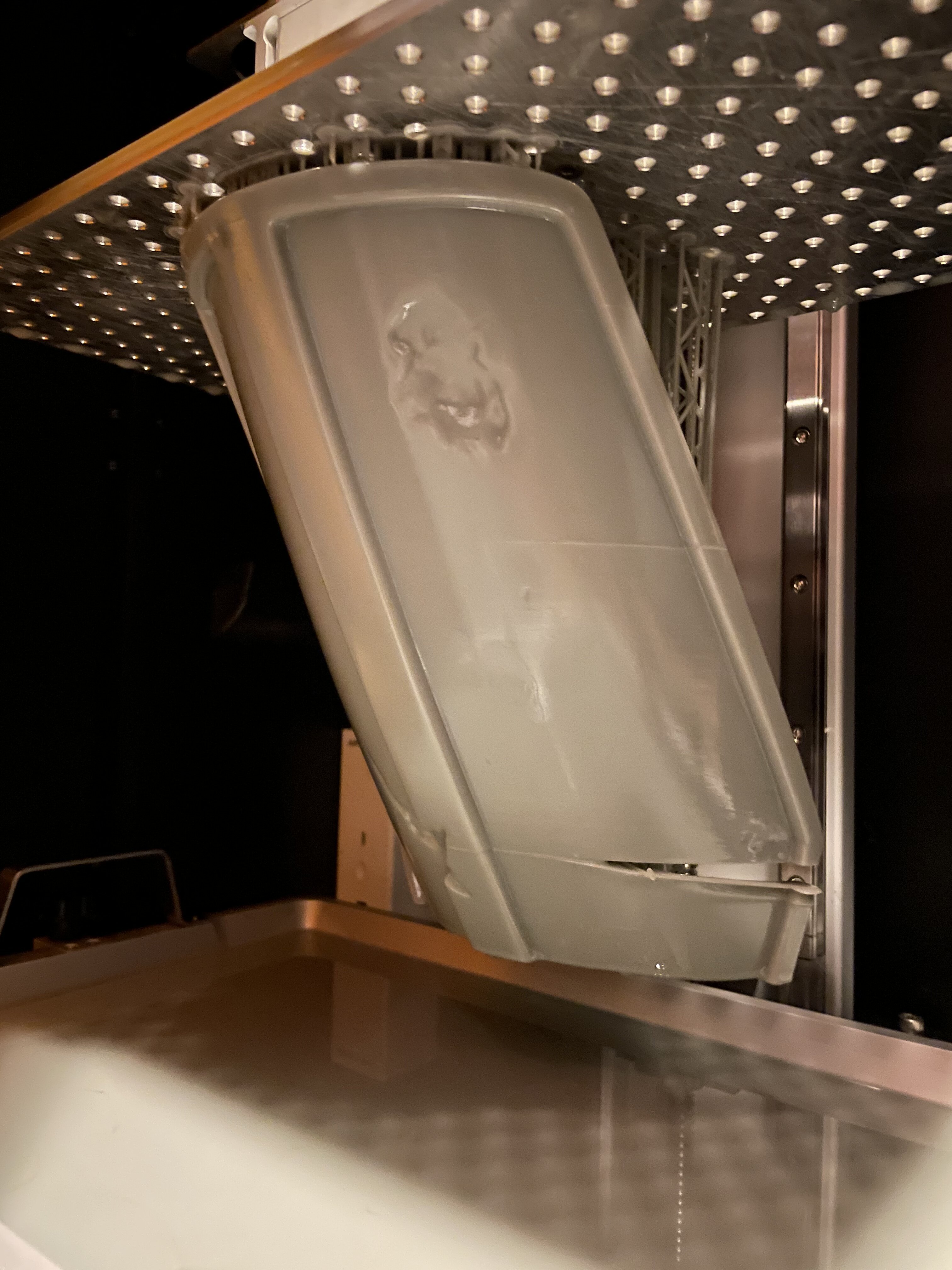

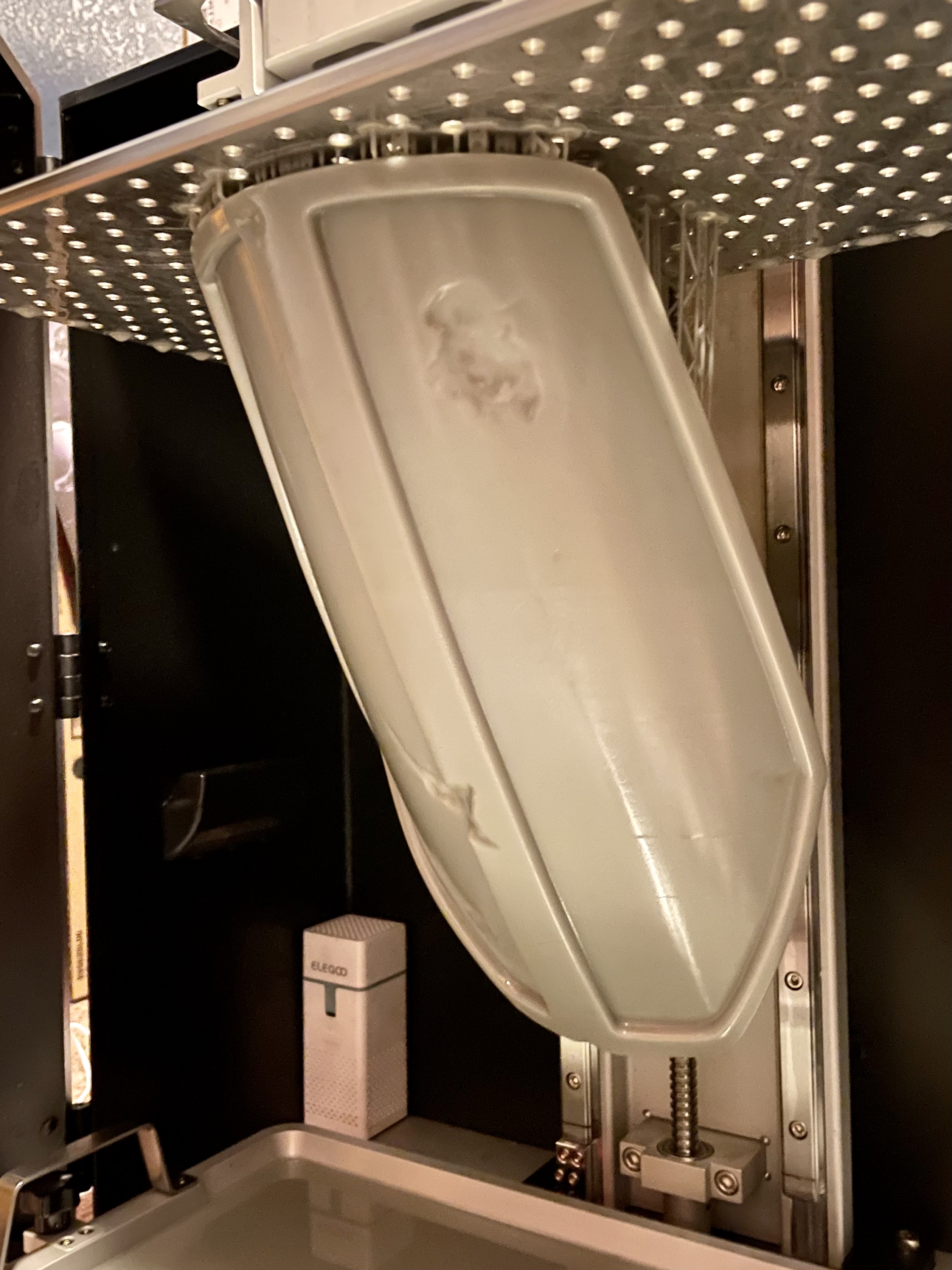

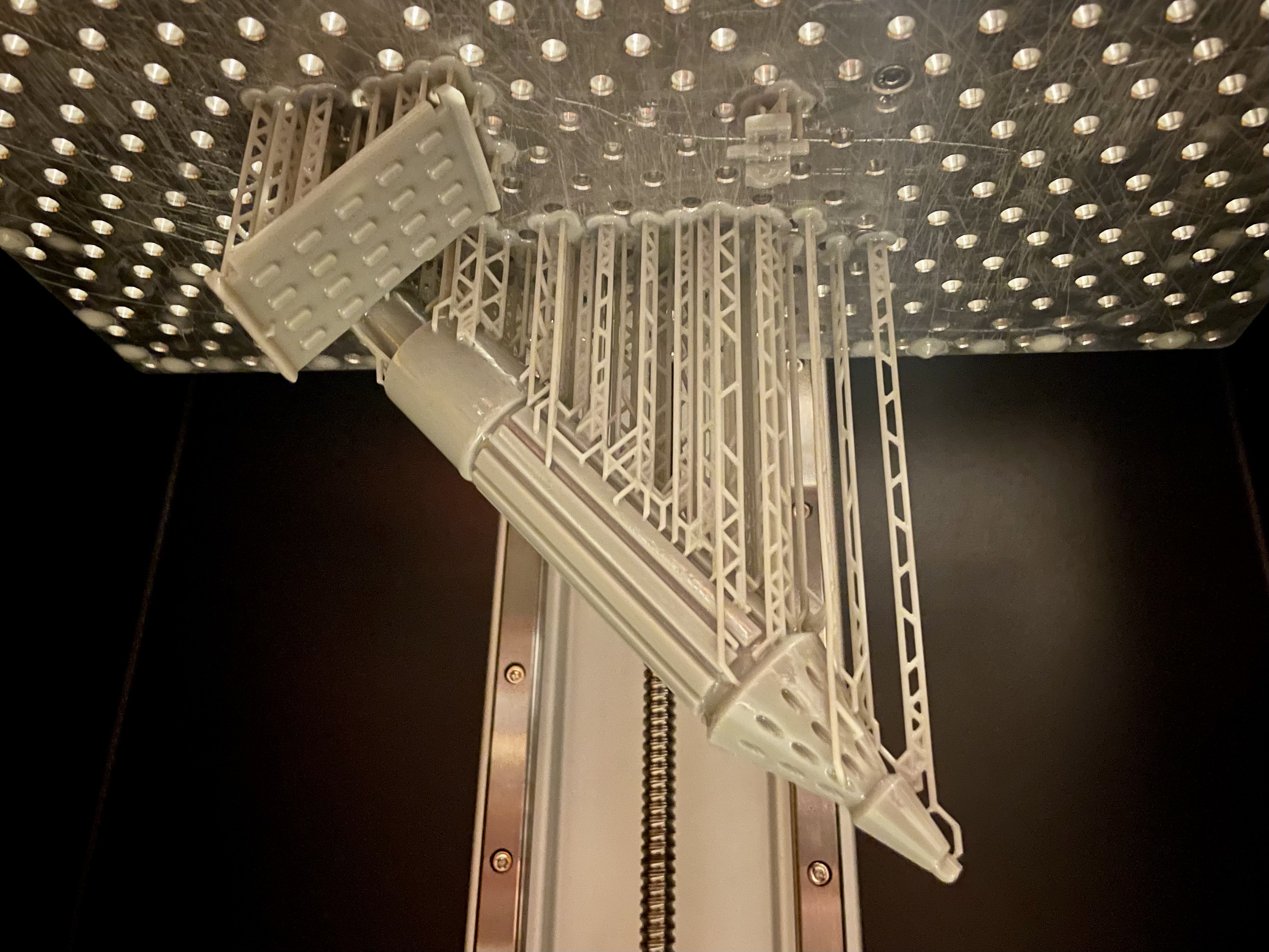

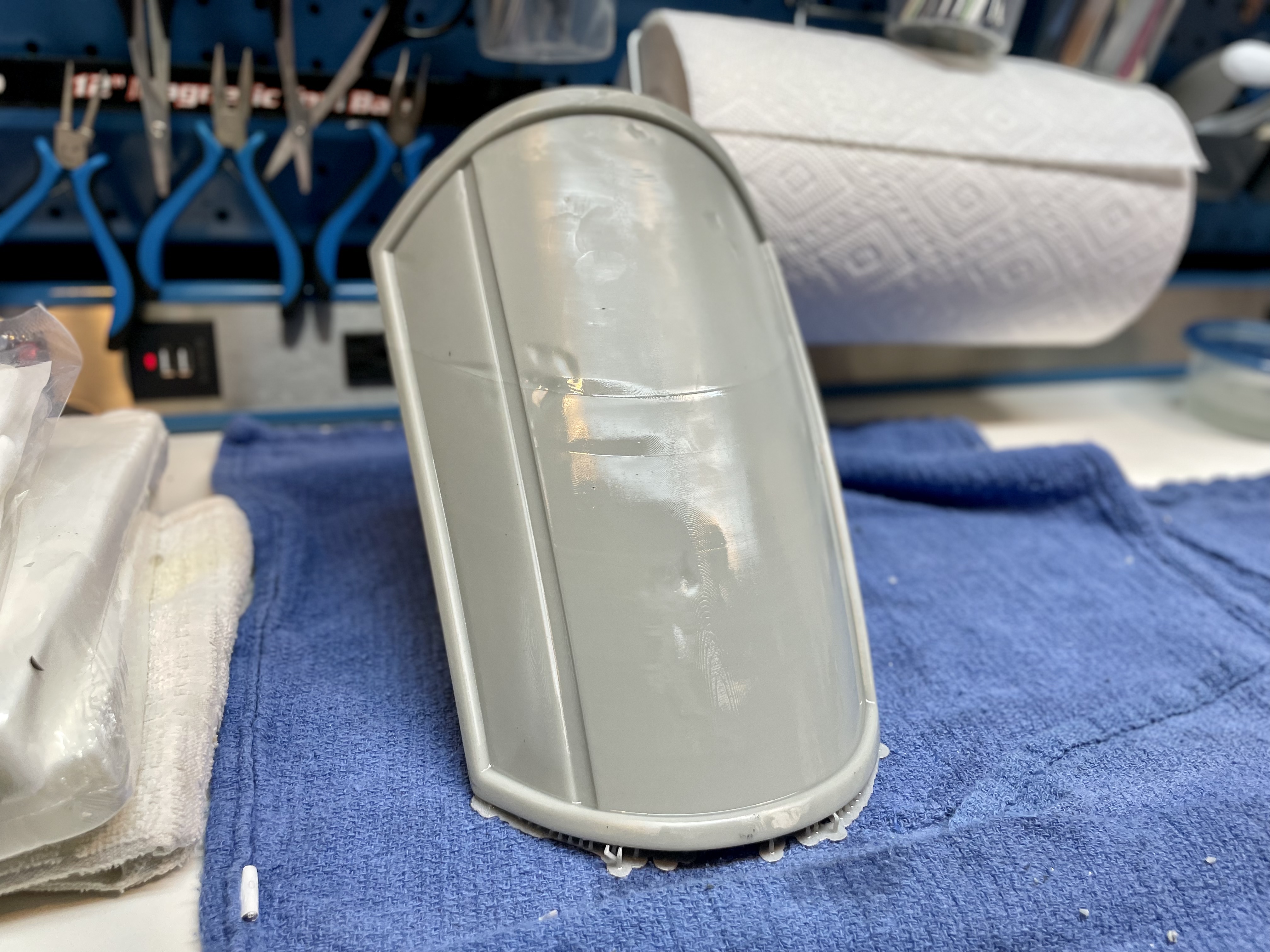

You can see a slight layer shift on the thigh print I posted previously. Not a huge deal and easily sanded.
But I wasn’t quite as lucky on the other thigh which actually tore.
I’m guessing it might be time to lubricate the z-axis, so I’ll give that a shot and try again.
