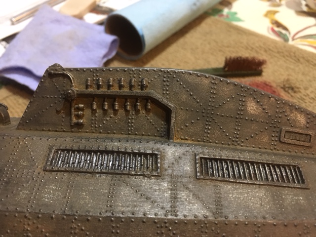

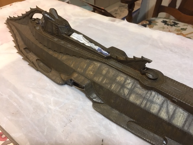

20kpaint1.JPG20kpaint2.JPG20kpaint3.JPG20kpaint4.JPG20kpaint5.JPG20kpaint6.JPG20kpaint7.JPG well, here is the final finish, on the lower at least. what this is...is Modern Masters rusting IRON paint, and the activator meant to go with it. Following the directions, you'd paint first, two coats (timed) then sprits on the activator twice (timed)
I did that the first time around, went on too thick and real heavy brush marks, so I stripped it with oven cleaner.
This time, after the base coat and the panel/rivet lines, I mixed the activator and paint, 2 to 1. I used an old hypo for exact measuring. 6 cc's od paint and 12 cc's of activator. mix 'er up real good in a small plastic bowl. paint the stuff on, not super heavy. you will get some brush marks but brush in the direction of water flow and it won't matter.
dry overnight. I found that I had lost my panel/rivet lines once again and the dry rubbing with a soft cloth like Bob had done wasn't getting it. So I had these artist erasers, the off white ones, rectangle shaped. Went over the whole thing with that, the lightly brushed it with a fine copper wire brush, brass I'm sure is fine too. and this is what I ended up with. in the right light it's got a cow-pie green hue to it and the metallic of the base coat can be seen. I conferred with Bob martin on the clear and he suggested semi-gloss rather than matt or gloss. I'm betting that's going to be correct and this thing will turn out good.

Hey thanks Buds...it's been a rascal so far with this finish, but I will admit I was overly focused on trying to get Bob's results, but since the formula has been changed on the rust iron paint, it's elusive to say the least. I'm sure there's a mix ratio that would do it but this last try looks good enough for who it's for. In fact I'm quite pleased with it even though it was hap-hazard. you certainly can get the really rusty finish with this stuff, but be warned...brushing it on will give you brush marks. the stuff is too thick to run through an air brush, you'd ruin the air brush. I had thought to try a pump spray bottle with a high-end adjustable nozzle but I didn't get that far. if you've got one of those inexpensive sprayers like you would use on interior/exterior house paint, that would probably be the thing to use. the trouble with the spray bottle, even with a good adjustable nozzle is, that it will still spit a little and that might not be desirable.

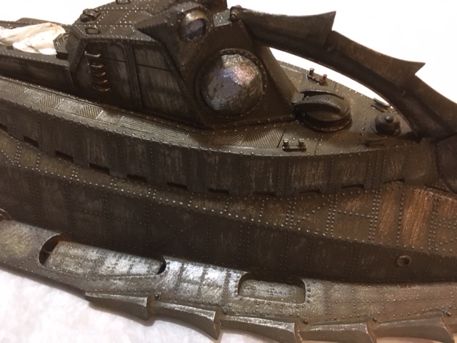

ok, Bob said semi-gloss and here are the results for the lower hull, I'd say he called it correctly and I'm very pleased with the outcome.
I did the upper last night as well and this morning before leaving for work I took the eraser to a couple spots. looks as though it should turn out as well but I won't know till I get it all rubbed, brushed, wiped and sprayed. I know what you're thinking...should have done upper and lower together for uniformity but I would agonize about having to strip the upper like I had the lower. next build will be all at once since now I have a proven process.lowerhull3.jpeglowerhull4.jpeglowerhull5.jpeglowerhull6.jpegupperhull1.jpegupperhull2.jpeg

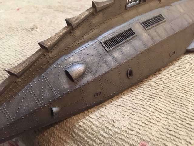

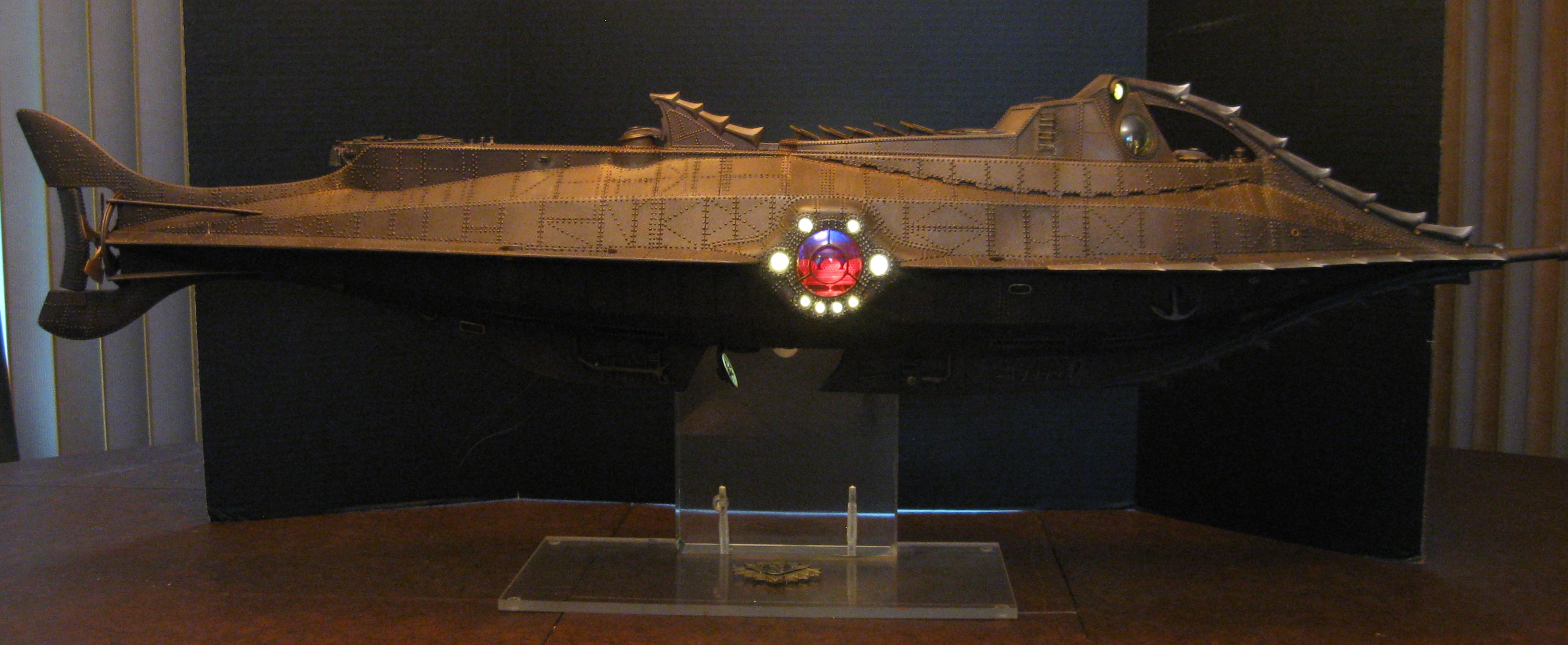

well, here is the final results of the process I used on this one. Thanks in great part to the guidance of Bob Martin, the RCsubguy...I still have some pastel work to do, but all in all I'm quite pleased with it.upperhull3.jpegupperhull4.jpegupperhull5.jpegupperhull6.jpegupperhull7.jpeg

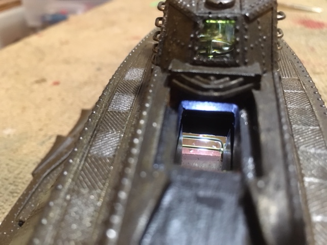

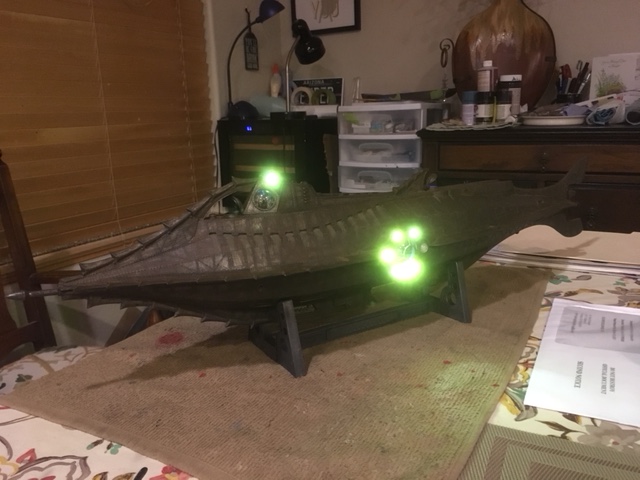

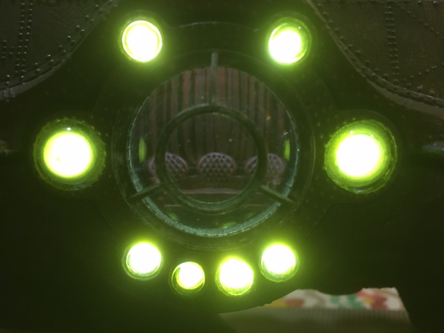

ok, I need a little help...I've been using the pre-wired 5mm LED's with built in resistor for 9V, I flat-tipped them, sanded the surface, AND sanded the backside of the acrylic and glass lens I used but these are still way too bright. Standing back they're kinda ok, but up close trying to see the salon interior the light is too much to even see the sofa. I'm sure there is an additional resistor that I can put in the main power wire to drag down the brightness, but not sure where to start. I used to have a genius old guy at my local Radio Shack that knew all that like his own birthday, BUT all the Shacks shut down around here and the guys at Fry's Electronics don't know the butt from a rat-hole. 20klighting1.jpeg20klighting2.jpeg
Re: My 31" "20,000 Leagues Under The Sea" Nautilus Build
however, the rest of the interior lights and the dragon eyes are good. Going to run 2 separate power wires to single a multi-circuit switch...

figured it out...by accident. went to Fry's Electronics, just what I expected...collection of idiots. Had some left over resistors from another project when I was doing it like Timey does.
