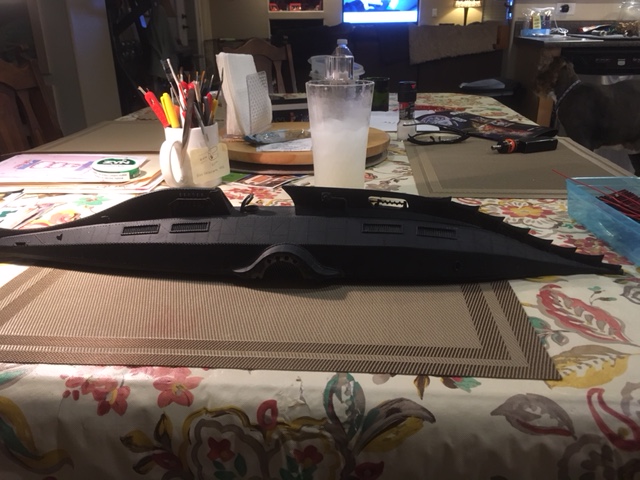

well, I forgot to take a snap shot, but...The paint removal went well. No fume Easy-Off out in the garage. let it sit for about 2 hrs, soft tooth brush and the garden hose. Had to shoot a few areas a second time. let it sit for another hour or so, stiffer tooth brush this time. got it pretty clean. there are a few areas as you would expect, particularly the keel fin where all the little vertical cylinder things are. an hour with a scribe and it'll be all clean again and ready to start over.
I think I'm getting close on the mix of the iron paint and activator, but I've got a hull from a LVT I'm testing on. there's a problem with brush mark, but I'm going to get a few plastic spray bottles from our detail guys (I work at a Chevy dealer) do the mix and spray it on...I don't think I want to try running that stuff though one of my air brushes. But I'm pretty confident that's going to be the key. when I get a solid on the mix I'll post that if anyone is interested. Bob wants to know. I think he's busy with other things and probably clean up from IRMA.

Easy-Off makes model cleaning easier...rust effect2.JPGrust effect1.JPGand then...20k sub paint redo2.JPG20k sub paint redo1.JPG...feels pretty good to be able to have another run at this. I'm sure glad it was the lower and not the upper:D
Wow...Oven cleaner...Never in a million years would I have thought to try that. I would've just figured it would melt it.
Learn something new every day.
yeah, I had heard it from several folks over the years, but I had never tried it. evidently the tale is true though, works great. wear gloves though. it had the base coat, the panel/rivet air brush lines, a dull clear, the rust stuff and a clear gloss on it...came right off. had to work it some with a tooth brush, and then hit it a second time for the "busy" areas, but yeah..heck I even took a few minutes to re-shoot the base silver again this morning before I left for work so it would have all day to dry :thumbsup

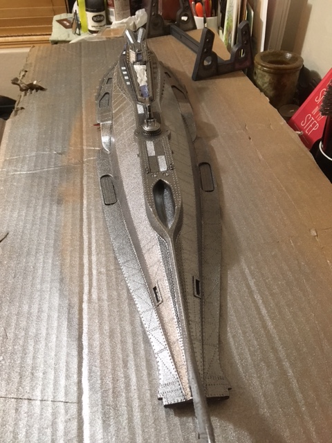

besides my finicky airbrush :angry...moving right along 20k repaint1.JPG20k repaint2.JPG20k repaint3.JPGstill working on the rusting paint mix ratio. once I think I've got it, I got an adjustable high end pump spray nozzle, going to apply with that, no more brush lines
testing the rust paint formulas this weekend on a kit bashed hull of a landing craft...but the upper and lower are pretty much ready. I did the stand in the same as the boat as seen here, but I think I'm going to leave it like this as it would not have been in the water and it will make the lines of the sub stand alone 20k upper1.JPG20k upper2.JPG20k upper3.JPG20k upper4.JPG it's not yet glued together here, have much more to do inside first with lighting, fitting the salon frames and the one side on the salon that I put together, plus build a small battery and switch box that will sit to the rear of the stand, or possibly in the front behind a name plate.
