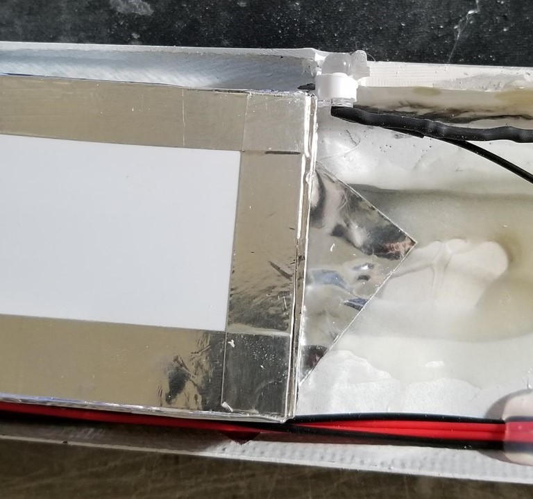

Tons of sanding, some priming, and a single piece of finished paint I needed to start work on the light boxes for the warp nacelles and I am pretty happy with the results. There is some light leaks that need to be addressed, but not worried at all on that part. I also went ahead and did a cut run for the Reliant replacement parts on the bottom. I did it in card stock, and there is some tweaking needed, couple of parts to short and 1 too long, but overall, really nice, and the hard parts, angles, are all within a degree or so. I need to finish up a few more parts, then cut some plastic, then sand that sucker flat. So many bubbles….gone…woohoo!

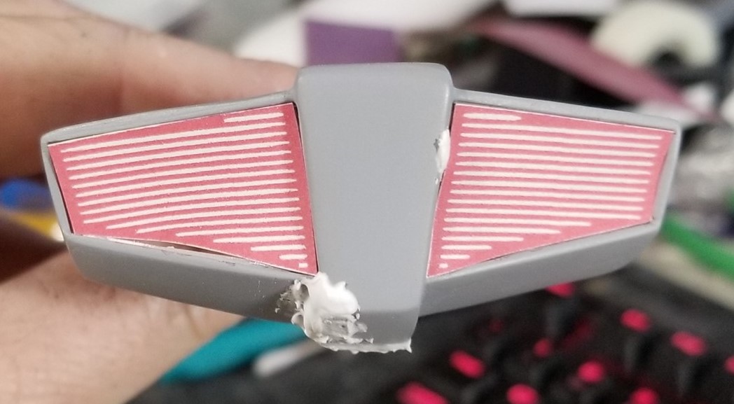

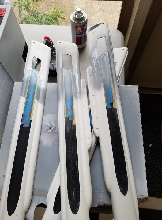

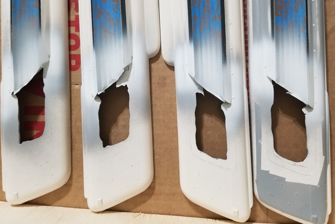

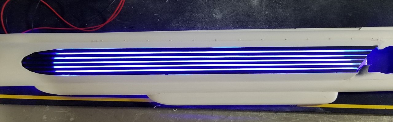

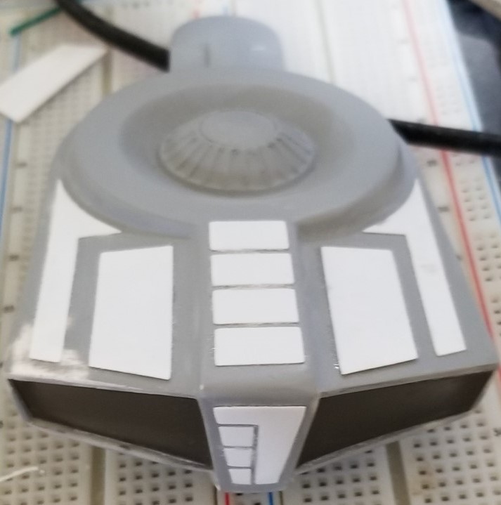

Got the nacelles with updated paint, so far so good on the light blocking. Still have not gotten the photo etch printed, still waiting on the transparencies that work in a laser printer. I am hoping all works out well with that. I have the design done for the impulse engine PE and parts going on the bridge and docking ports. Hopefully in another few days will have some completed PE to show off. Also, have the shapes laid into the program for all of the PE that is going on the pylons for the Enterprise. I am using an easy to use CAD program, Silhouette Studio for Business, BUT, not a lot of power in the program, so have to get really creative to draw some of the shapes. I am concerned with the ring that helps clean up the deflector ring on the secondary hull getting drawn up. Hopefully will get it drawn fairly accurately.

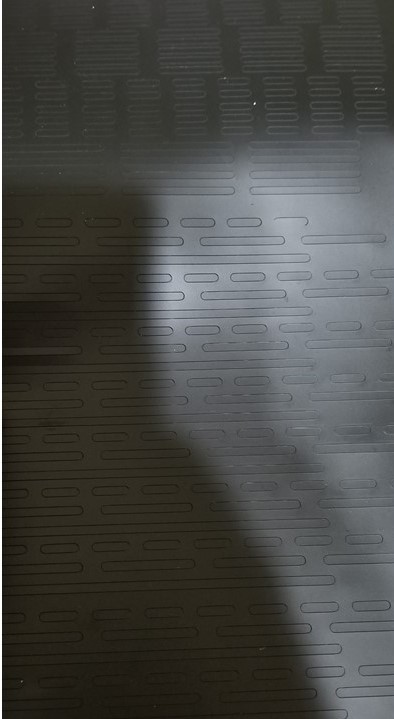

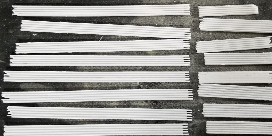

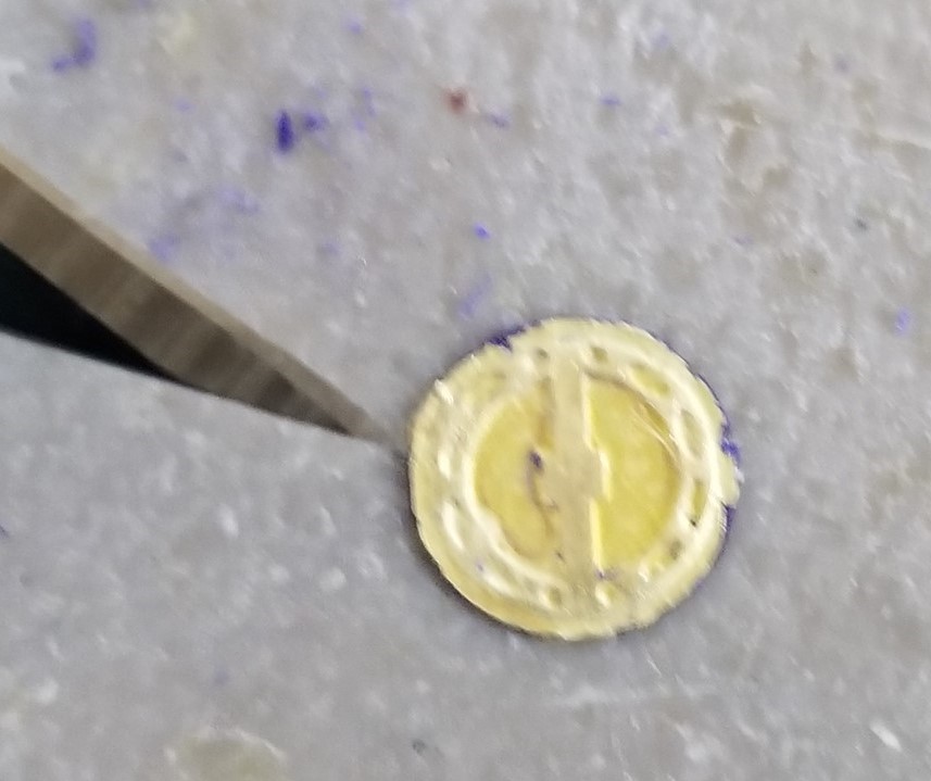

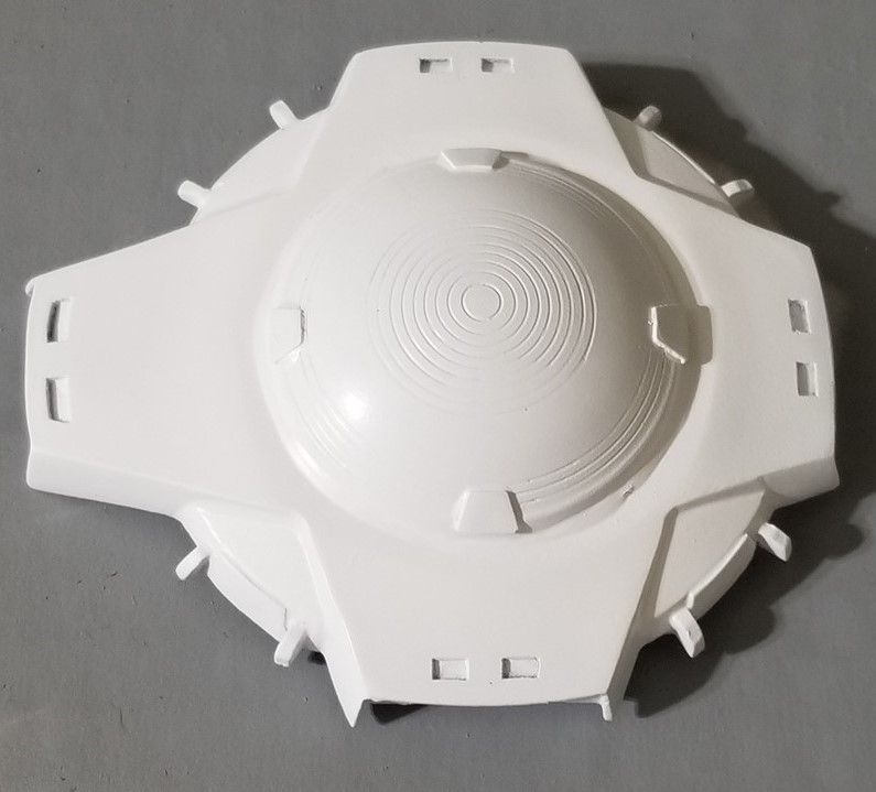

The pics are of all of the CNC cutting machined cut plastic parts, pretty excited about getting those done. The machine can’t go through 0.020 styrene, will try it out with the deep cut blade. The sheet styrene was scored enough that I was able to get the parts out, they will all need some sanding before getting glued into the hull. For the really complicated cut part, I went down to 0.010 thick styrene and cut two parts to be glued back together. I will need to build up the courage to just scrape all of the detail off of the cast hull….

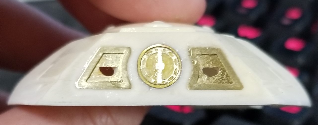

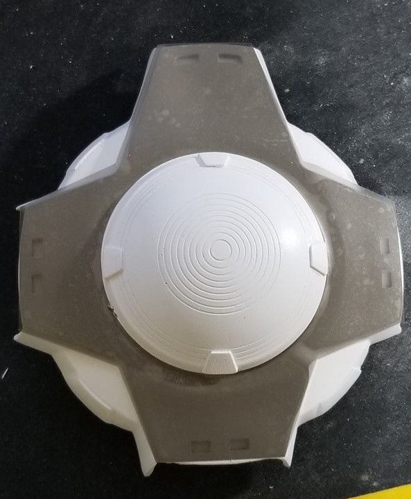

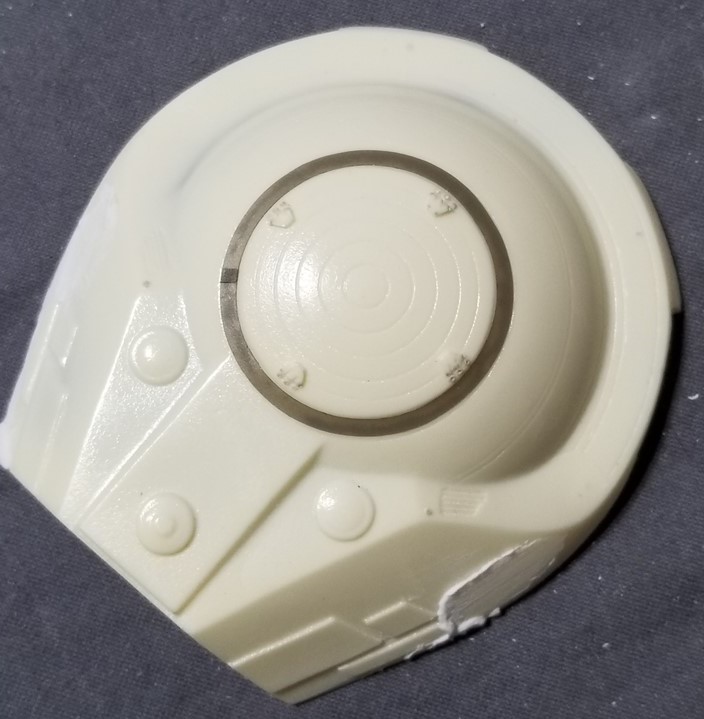

The other pic is of the PE design for the impulse engine cover. It is close to the original part, I am running into a capability gap of the CAD program, I can not go back in and thin out some of the horizontal lines, as seen in the studio part. I am doing some research to come up with a plan. I have some ideas, but it would be a ton of work for this detail. Oh, ignore the filler on the part :)

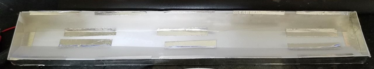

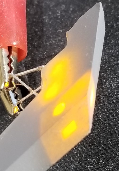

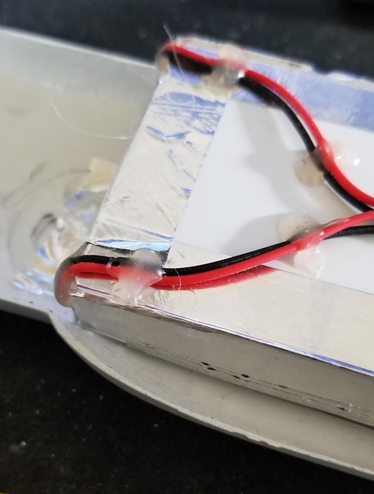

The battle continues via sandpaper, putty and added paint. Lots of progress across many fronts. I completed one of my light boxes for the warp nacelle, with all of the diffusion built in, looks great as a box, but a picture looks really bad. Also, all of my nacelles are taped up for primer and base coat, so will not be able to verify the effect for a while. Will take some pics when that gets done. My laser transparency paper came in, hopefully get the printed tomorrow and get my first parts made up tomorrow night that is the goal. Today, I got the impulse engines formed up and the clear resin poured, will take it apart tomorrow and prep the part for the white base coat, so that is exciting. I will also be able to glue down my new 0.005 thick panels, hopefully the look cool, will add to more parts of the model if they do. I think a little dimensionality will set this model off. I cut my first complex shape for masking, 99% there, I can then go in and do all of the extra cuts needed to paint the sensor dome that is exciting. The cool thing is that the outline works on both the E and R, saving some time, finally, on something, LOLOL. The paint scheme is different between the two models. Next pic is of the nacelles getting an area with the base coat white. I needed to get this put down before I glue in the chiller grills. I wanted all of the white that I will not be able to get to, to get painted, before gluing and priming. Hopefully the final product will look great, not just good. Next pic is of a white sensor done, excited and SAD. The camera sure shows a lot of little nits, that I cannot see under 4x magnification :( Last pic is of the three remaining RCS thrusters and Impulse Engine letting the resin cure, takes a day or so. Continual progress on the model, couple hours a night, one day, will be complete!

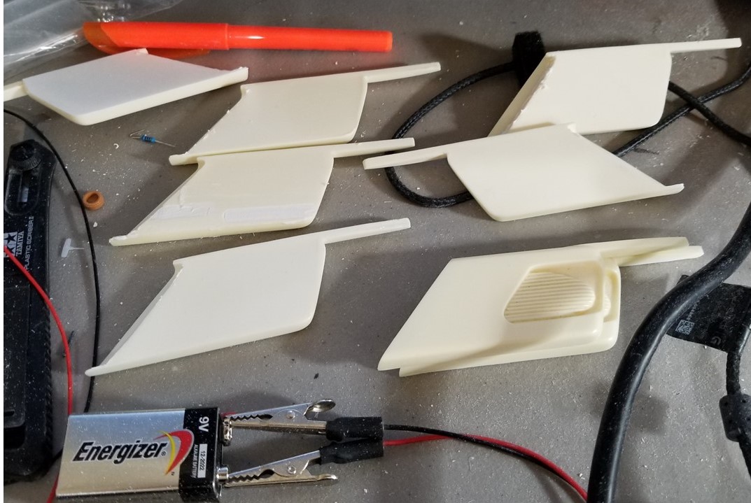

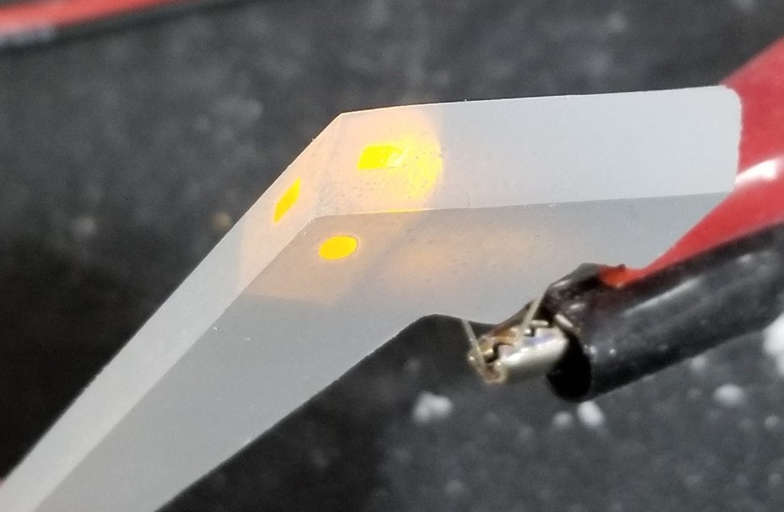

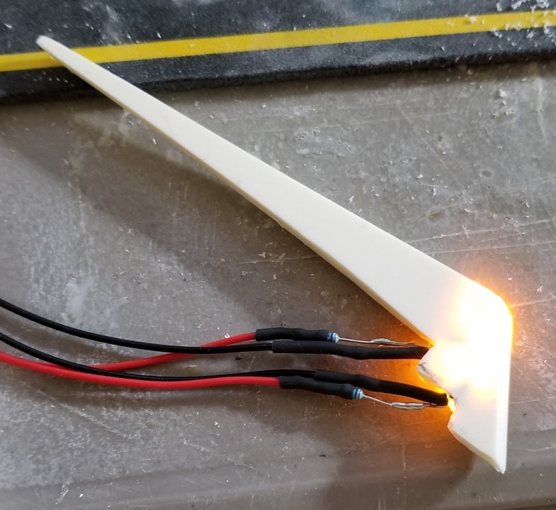

LOL, sand, putty, glue, sand, putty, glue, prime, sand, putty, sand, putty, sand, putty, prime again? LOL Resin kits are cool, but WOW, they are a TON of extra work. Of course, I want to go buy some more kits! I am looking into the studio scale Enterprise, still working on the Wife. Hopefully, these guys get built and sold relatively quickly, then on to the 8 footer. That would be cool, fun to dream though, right! Unusual to post so quickly, but I got all of the RCS thrusters glued into the nacelles yesterday, and the first round of 28, putty rounds put down. Really happy with how they went on, and the parts are pretty darn square considering how every surface is curved. Also, these are the first parts with LEDs installed and put into the model. I wanted to minimize the amount of material removable to get everything to fit, and making the holes big enough to install LEDs later was a sub optimal solution. Here is my #1 tip about building lit models.

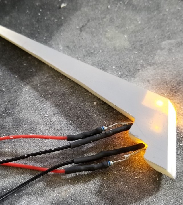

ALL LEDS THAT ARE TO BE INSTALLED INTO THE MODEL WILL HAVE A SERIES RESISTOR.
Do not ever break this rule, ever. You will rue the day when you break this rule, and blow up an LED buried DEEP in your model, which will require major surgery to remove and major reconstructive surgery to reinstall. Some of the electronics I have, have the series resistor on the board, these resistors will be moved to the LED, period, end of story. Enough on that topic!

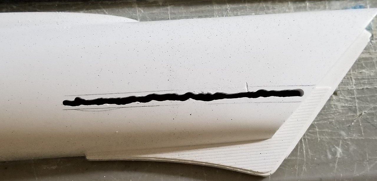

Last item, look at that amazingly straight line I cut into the nacelle by hand. Super straight, AMAZING. Ok, that is a little bit of sarcasm. At least no one will every see the butcher job I did on the nacelle. Probably no updates for a while, all I have to do is sand and putty work for the next few nights.

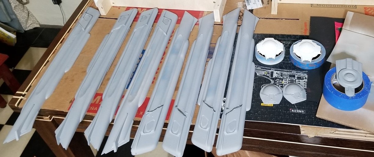

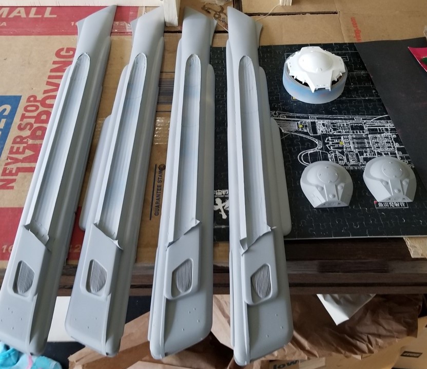

Well, here are all of the parts I have gotten through their first primer shot. The wife is out of town this weekend, so a lot of sanding coming up. Hopefully will get through all of the touch up on the 8 nacelle parts and the 2 bridge parts this weekend and start getting electronics in them. This leads to a cool problem, I need to start working on the E and R pylons. The plan is to complete the pylon and nacelle as an assembly. The second pic, or first, depending on they upload, shows some paint being pulled up. I left a mask on the bridge under tension for 2 weeks or so, and it damaged the paint. I am 99% sure that all of the parts were washed, I did not use adhesion promoter though on the bridge parts, will use that on the big saucer sections for sure. So, first paint down, and first paint repair, already, lolol, actually :(
Does not look like a lot but 2.5 months into the project, I have a bunch of filled in holes, lol and 12 grey parts, some with paint damage. LOLOLOL. Oh well.

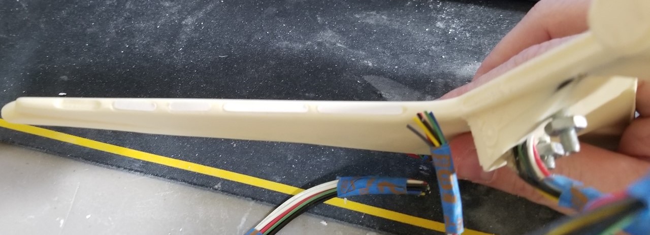

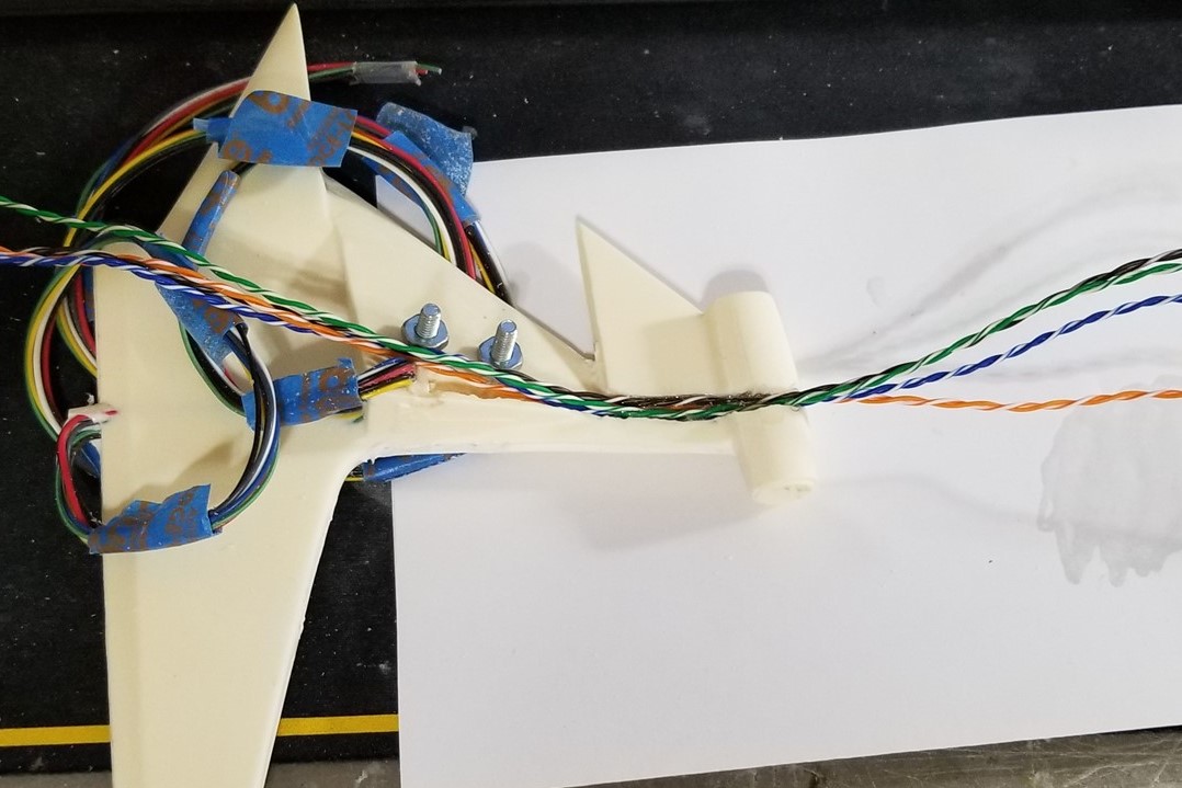

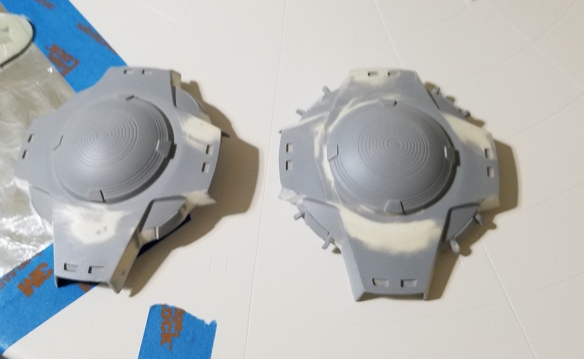

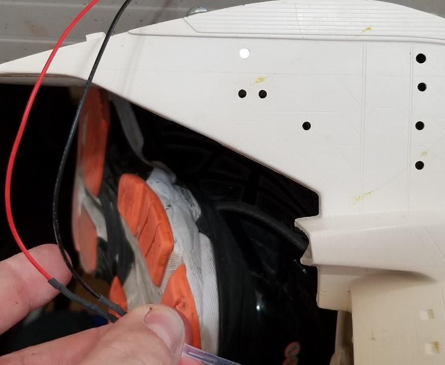

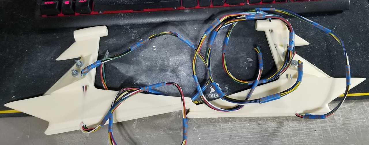

So, there is a series of steps that have to happen before I can glue up the nacelles, with the largest one being getting the pylons in shape for both the E and the R. As part of the Pylon Finishing Operation 2.0, I plan on installing a lot of CnC cut plastic inserts to clean up the mold work and also create super crisp inserts that go into these pylons. I do not like what came on the molded parts, the detail was blurred out, and the mold line runs down the middle of it. As a guy who has done a lot of casting, you have to put your mold line somewhere, and overall for the part and the shape of the part, you were kind of stuck putting it here. Overall the pylons on both models are fantastic, so do not take that the wrong way! So hopefully the first few photos are of the test cut inserts showing where they are going into the pylons. The next two pics are of DESTRUCTION! Oi, my Dremel work leaves a lot to be desired. However, I am sitting at 8 or 9 rounds of putty and sanding, the inserts recesses are coming along quite nicely. The problem is that there is some knife work required and if I screw up, I get to redo some putty and sanding work. That has happened a few times, which is frustrating. However, my skill level is increasing. I can see my XP bar filling up every night I work on this, LOLOL. If only I could grind out some levels quicker and easier though. Last shot is of all of the wires on the Reliant pylons, looks like a lot, there are not enough, which also makes me sad. There are 4 photon torpedoes in the roll bar, but each of those torpedoes needs 2 control wires, 2 reds and 1 white per torpedoes. So quick wire summary for the roll bar
8 torpedoes
1 nav ?
1 strobe ?
2 phaser cannon thingies
1 evil red lights, there are 4 of them, they are one when Khan controls the ship, I did not see evidence that they are on when he does not control the ship. So the plan is to add another 8 wires on the other nacelle, that would give me plenty to cover the requirements and still have a few.
Looking at the wires for the nacelles there are 8 wires, with two of them being a bit larger in gauge. One of those would be ground and the other for the warp engines.
1 warp engine, needs to be 24AWG or higher, actually caries a lot of current due to the number of LEDs in the LED tape.
1 RCS
1 Strobe
1 Nav??
1 2 lights at the front of the nacelle
2 spots?
1 warp crystal thingy
Looks like we have enough wires for the nacelles, woohoo! The progress continues, slowly, but relentless? LOL Still waiting on some parts to redo the grill thingies on the nacelle, hopefully get the parts tomorrow so I can do some work on it this weekend, who knows when and how the delivery man shall delivereth.

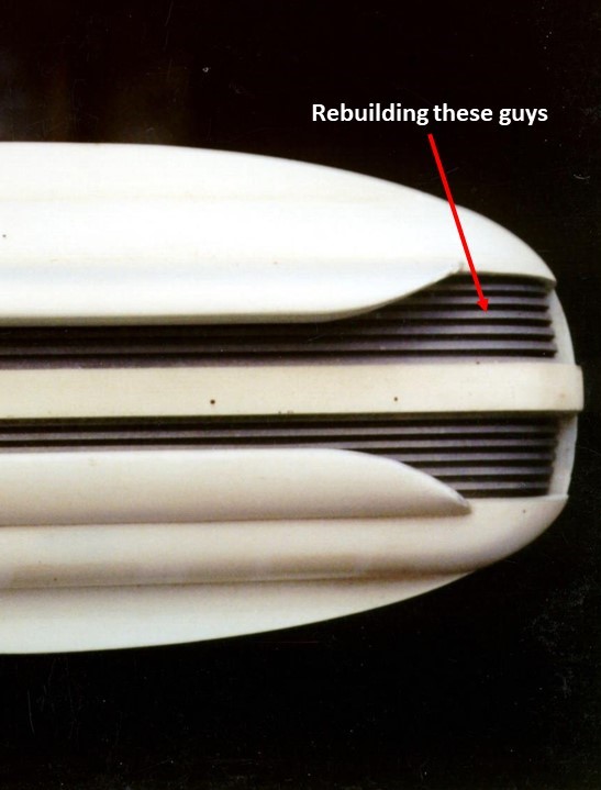

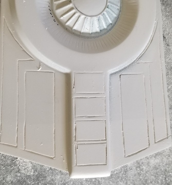

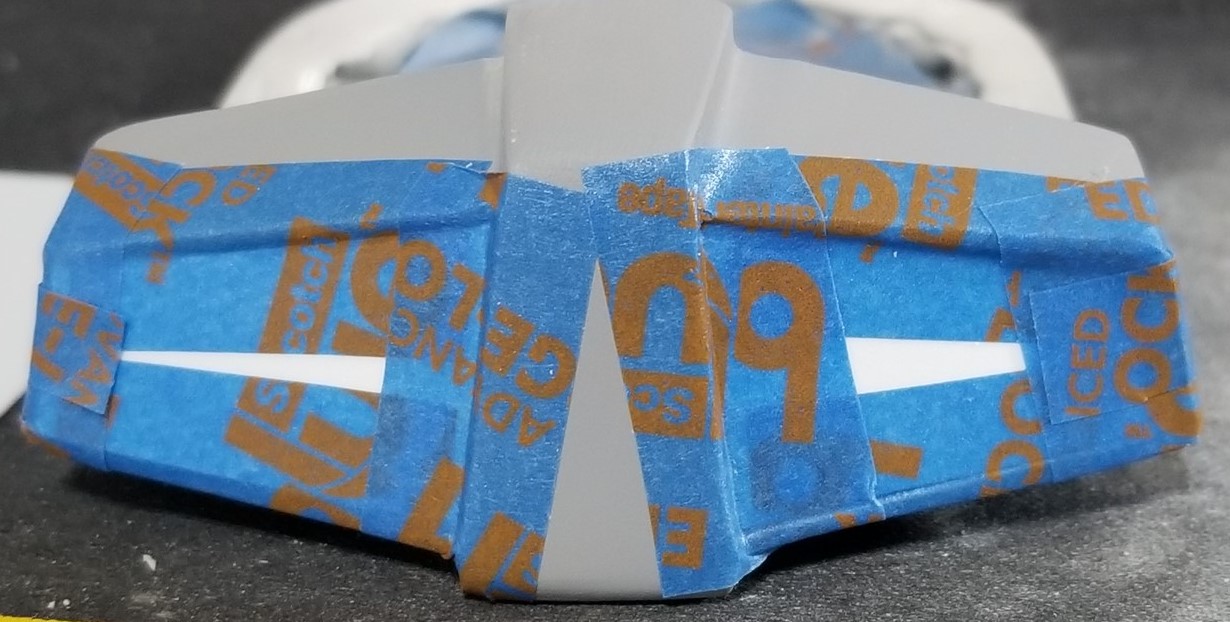

Lots of coolness happening, although, all of it is TINY ITY BITY TEENY steps :( Tons of work for literally half millimeter improvements. I will not do it this way in the future, but a good way to learn. I did not get to work on the models as much as I would have liked, but the family had a great time at the Renaissance Fair today outside of Austin. Lots of meat on a stick, sword fighting and the best show were the Washing Wenches.

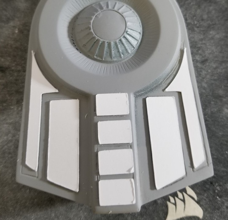

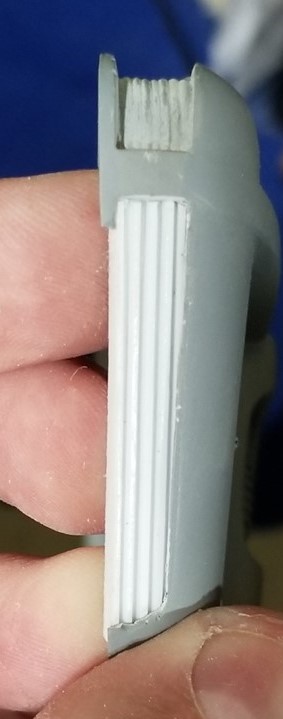

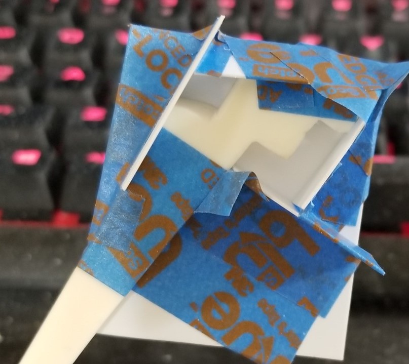

So the first pic is of the small steps. The Enterprises pylons are just about done and the Reliants are well under way. I started the Rs long after the Es, so progress is quicker. I have gotten better at doing this. As part of this process though, I could not figure out how to get the bottom of each of these holes to the same depth. So I decided to cut out a ton of 0.010 thick parts that go in the bottom of the holes, and that will allow me to get the depths of all of the holes to within 0.010 of each other, which is pretty good for a resin model. So the pic is a bunch of these parts cut out on the Cameo 3. Which is the best present I have ever bought for the wife!

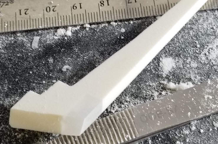

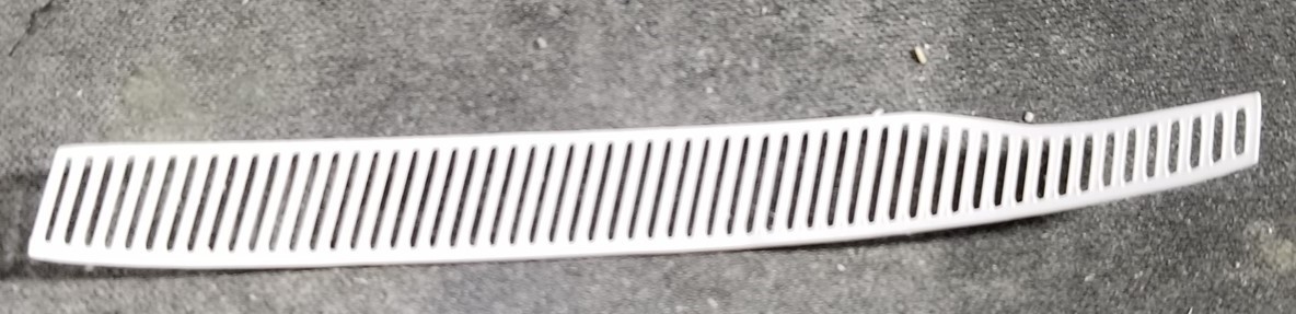

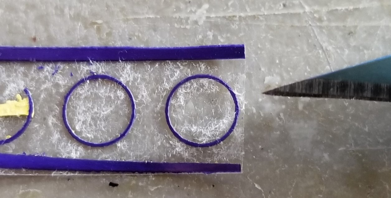

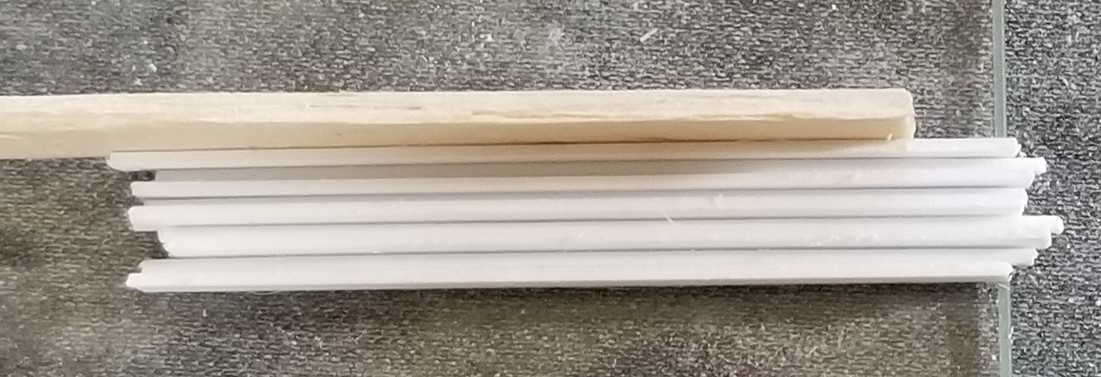

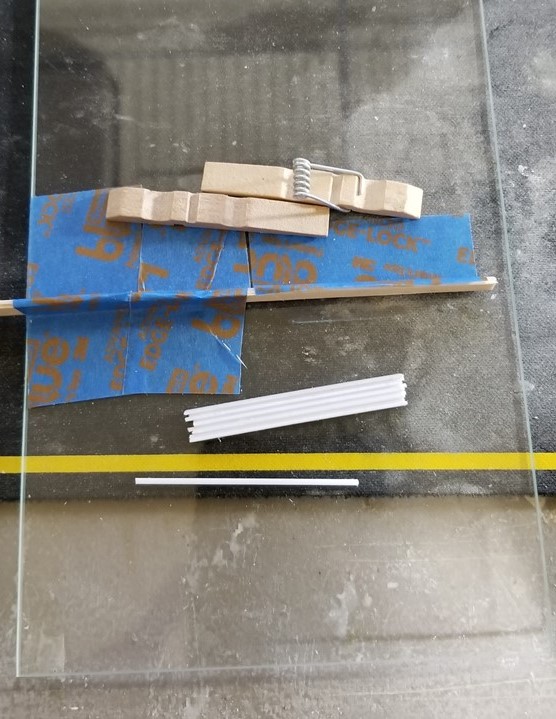

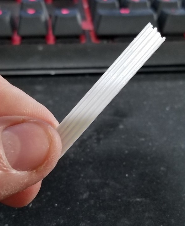

The HobbyLinc order came in on Saturday, woohoo, which allowed me to mock up my new ridged parts in both 0.030 and 0.020 thickness parts. I am going to go with the 0.030 strips to recreate all of the ridged parts in the nacelles. So, the clean up all of the detail in these parts and I will be able to paint both the nacelle and grill thingy off of each other allowing for some ultra-sharp transitions. The biggest problem is going to be on the curved section for the top grill, but I think I have a good solution on these. So, I am going to cut out some of these grills, hopefully not have a heart attack, and then make sure everything lines up.
All of the work is coming together on the nacelles, and looking forward to getting all 4 of these mounted up, wired up, closed up and painted up. That is a lot of Up!

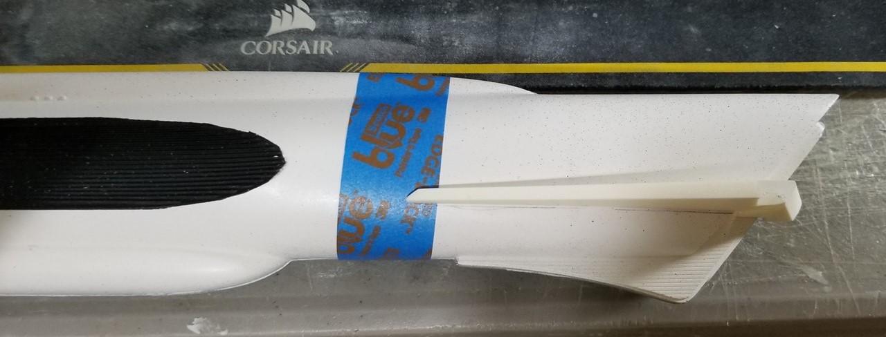

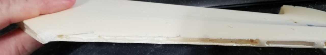

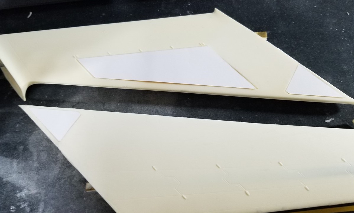

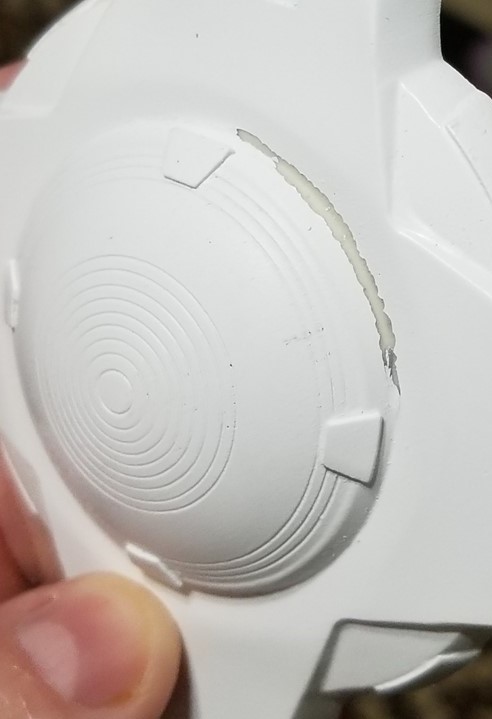

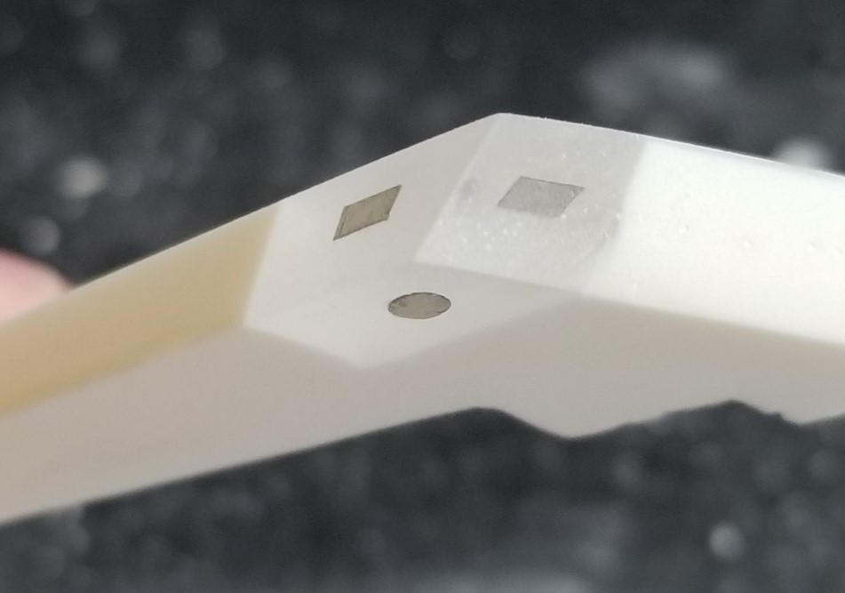

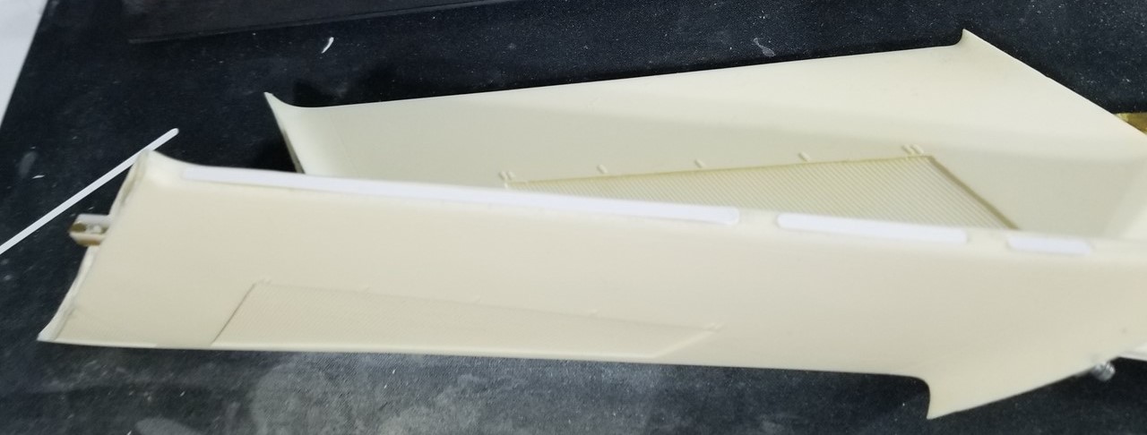

Got the little inserts popped out for the pylons, and started to test fit them. Still some work needed, but they are close on the E. Once they are in, I can finish cleaning up the edges of the holes, and then shim them out so they are all the same depth. Then, I get to wait until the pylon is painted out, then they go back in. Progress?
The other pic is of the new grills going into the nacelles. I had a heart attack drilling out the grill on the nacelle, and then, I told myself to be extra careful not to knock off the little sprue of resin left, and of course I dropped the nacelle, boooo, and it broke out. Soooo, another thing to patch. I need to get a little better making the grill replacements flatter, if that makes sense. There is a little curl on the outside, which shows some in the pic. Over all though, these are much better than what was on the casting.
Progress? Some.

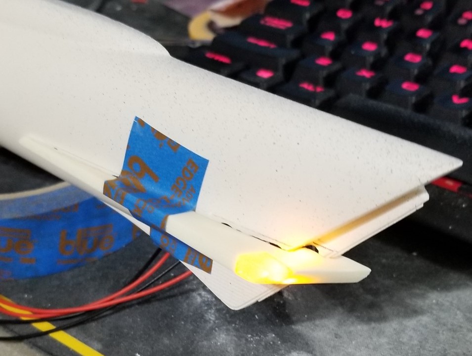

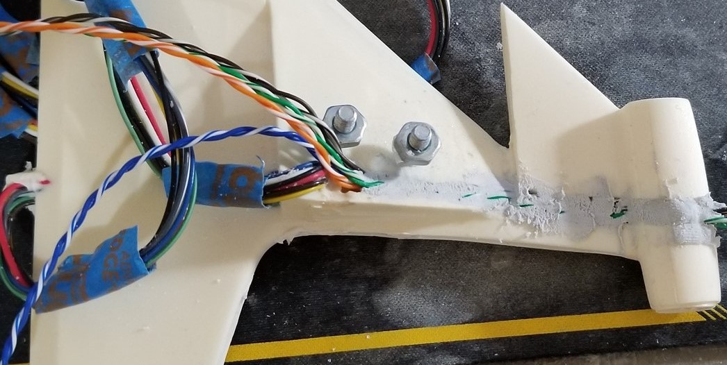

Woohoo, some real progress. Three of the four pylons are ready for primer, and the fourth one should be good to go tomorrow. Will get them all primed up tomorrow. The second Reliant pylon needed 8 additional wires added to it, so they were added. The two pics are of the trenching and gluing and backfilling of the pylon for the additional wires. I have spent all of last weekend working on a retirement box for a fellow Airmen. The pics are of the box and work in progress. The multi piece board is 11 different hardwoods jointed up and glued together to make a removable tray that will hold coins and will go inside the box. You can see the Es saucer providing support to the boards as the epoxy sets. The wood used was spalted maple, that had also been eaten by some worms. The worm tracks are really cool looking and add some unusualness to the box. The dove tails are half blind with Walnut inserts, first time my Dad and I were able to accomplish it, woohoo! So now I am sanding resin model parts and worm eaten maple!

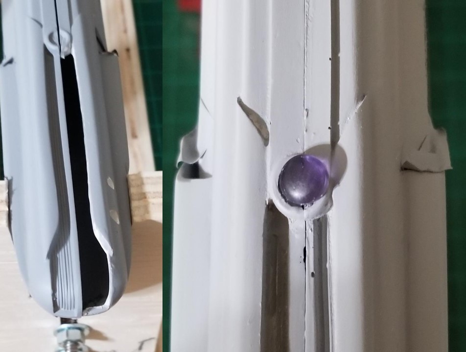

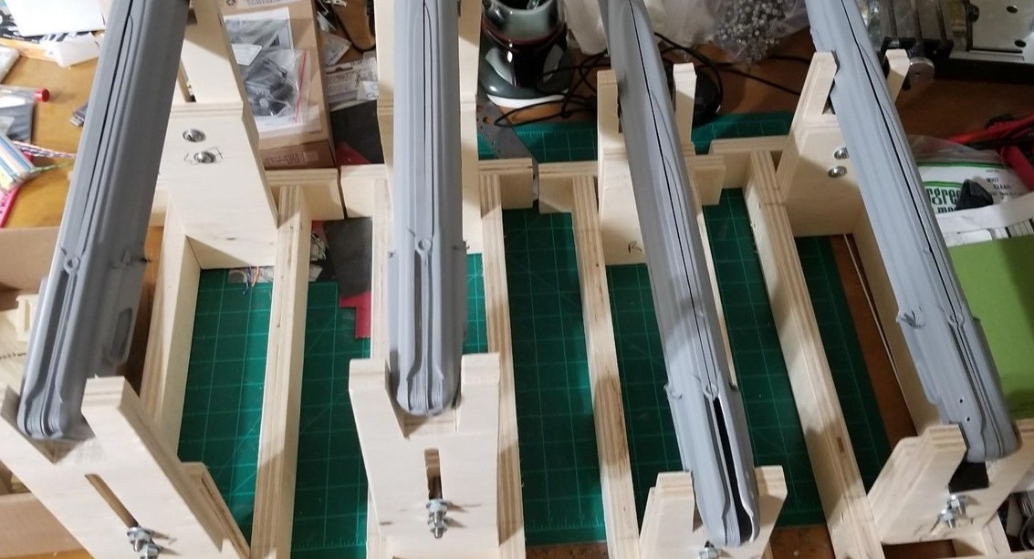

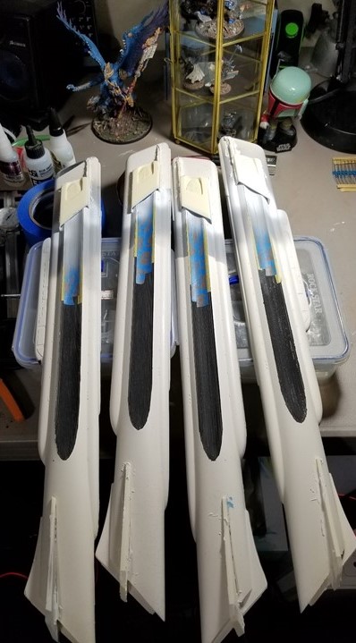

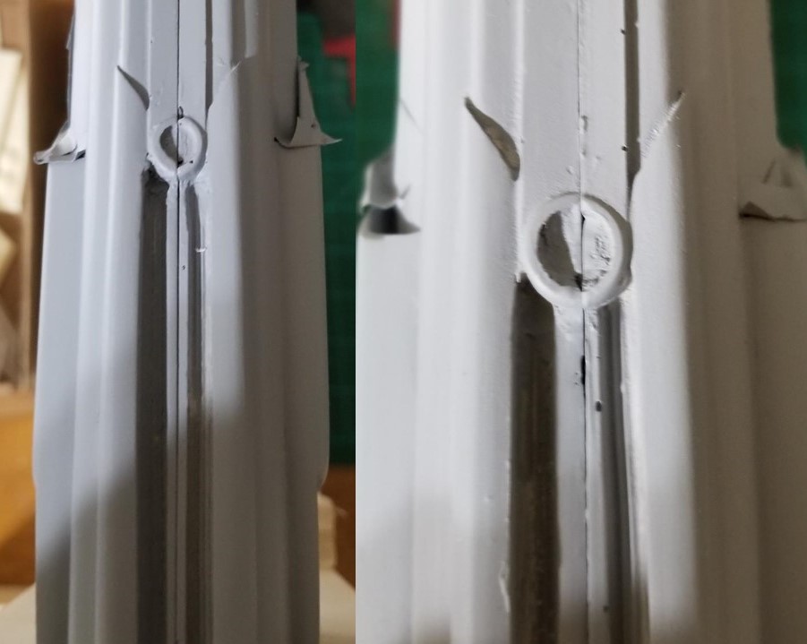

So I ran into a problem, took me a few minutes to realize what had happened. When I built the nacelle jigs, to align to the rest of the model, I did not have the chiller grill parts glued onto the nacelle. I actually LOLd when I realized that my jigs are not going to work to well. I will need to modify them a bit to get them super sturdy again.
So the actual model stuff. The first pic shows all of the nacelle component in the alignment jigs, they do fit, but not as well as I like. The amount of work that has gone into these guys is stupid, but there are a lot of parts glued up, modified etc in this shot. So, some internal happiness on my part. The second pic shows my current issue. The openings to house the colored crystals that go on top of the nacelles are sort of jacked up. So, I am going to sand them relatively flat, and cut out some plastic parts on my Silhouette that will house the crystal and glue that onto the nacelle. Will take pics, will make more sense when I do that. I also have a plan to house and protect the LED that will light up the crystal. Pics will show how that will work. That leaves the hole in the back, middle, top of the nacelle for the nav/strobe light. I will drill the 3mm hole and glue the LED into one of the nacelles. Will take some extra super duper care to reassemble. I had thought about cutting out some of the opposite nacelle and gluing that together, then fixing that area. I might do that, will think on it tonight. I am really tired and do not want to screw up the cut when I could do it tomorrow in better shape. Long day at work, ran 3 miles, super hot today, which is a first for the year, and a lot of work on the retirement box. I also need to drill out the holes for the spots and align them up and glue them in. Then the rest of the electronics and interior stuff goes back into the nacelles, then cut out the front part, square it up, install new grills, and glue the sucker up. I do not think I will get that done this weekend, but, these parts are close.
Oh, I will glue them on the pylons before I close up the nacelles, so that means Will not get done this weekend. Closing in.

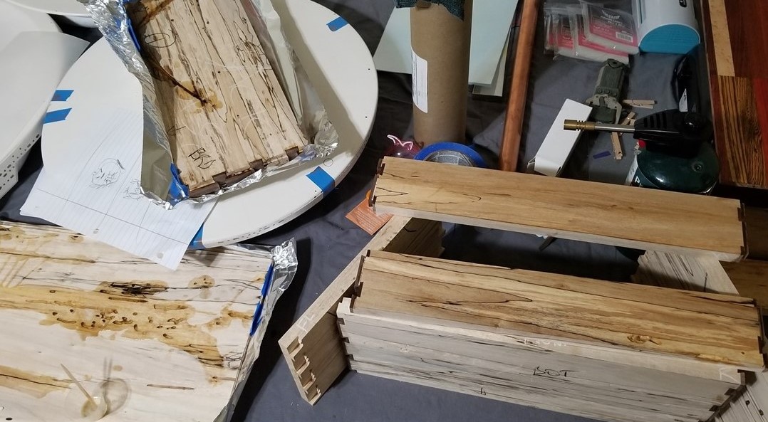

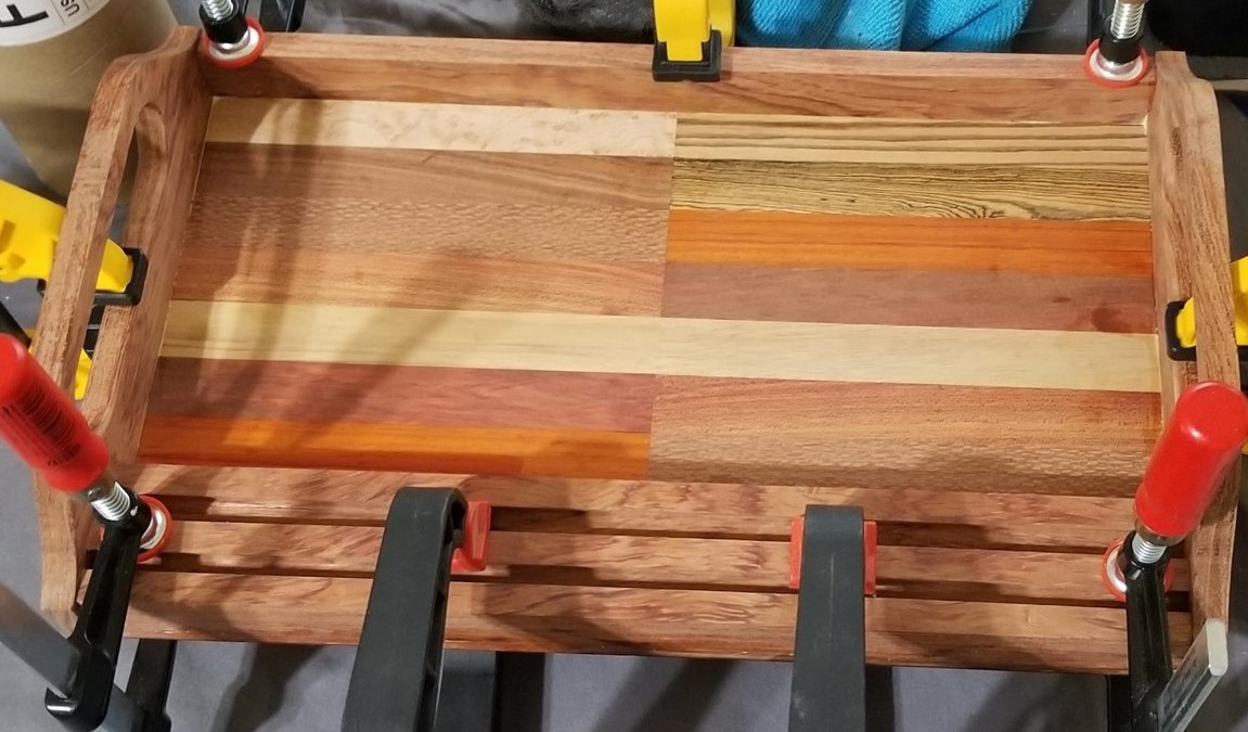

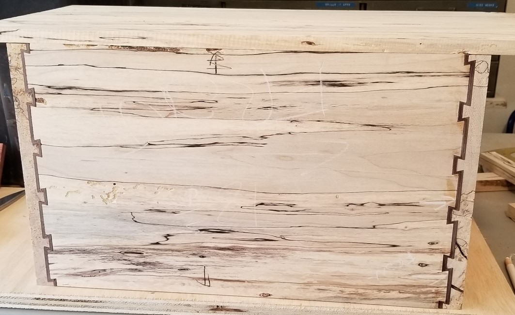

The wood shot is of the tray that is going into the retirement box. Will unclamp tomorrow and start the finish sanding needed. I am hoping to get the box done next week. Depends on the laser etch guy though. Look forward to sharing that when done.

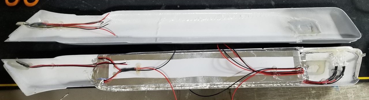

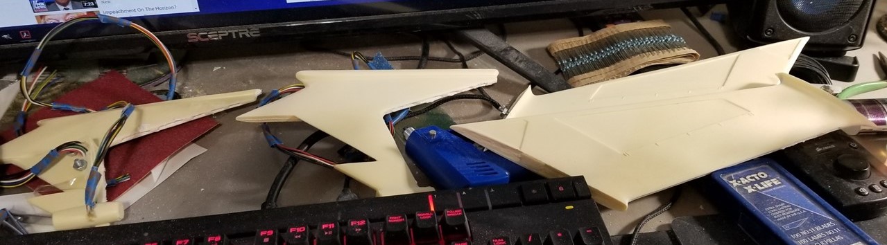

I got one of the Reliant nacelles with the electronics installed. Learned a few things. The main one being that I will need to remove the grills that are cast into the nacelle before I install the electronics into the rest of the nacelles. If all of the electronic dodads are in there, very hard to cut out, sand, and remove the excess material needed to make the new grills fit. Will not be doing that tonight, a little late. Another issue, the light box interferes with either the crystal light or will not fit into the nacelle. So I had to modify the light box somewhat to clear the crystal LED and still fit into the nacelle. Not that big of deal, took a while though. I decided to just drill the 3mm hole in the rear of the nacelle to house the NJAV/Strobe light. The wires that lead to the LED are glued in, and the LED is tacked down via super glue. When I hit some of the areas with epoxy, will put some epoxy on the back of the LED so you can not accidently push it into the nacelle. That would be a DISASTER OF EPIC PROPORTIONS. I could not imagine having to tear the thing apart to fix that error. That would be very demoralizing. I also will need to add some epoxy over the front two lights on the Reliant nacelle and some other points for reinforcement. I have also added a bunch of Apoxie sculpt to allow for more surface area in the future glue up of the nacelle, and to help flatten out the curvy grill area. All of the nacelles will need to be cleaned up and Apoxied like this.
Oh, another interesting tid bit. The Reliant nacelles are super nice, the Enterprise ones are not. Normally I would put the resin into some hot water to help straighten them out, but these nacelles are fiberglass impregnated, so, hot water is meaningless to them., Ultimately, these guys are super strong, but getting the joints flattened out on the Enterprise will take some effort, and I am concerned over the long term stability of the joint. I might allow some what of a gap, basically minimize the gap along the entire joint, and go back in and fill. This would have the effect of a slightly larger, maybe out of scale joint, but the model will stick together forever. I will take some pics of what I am talking about in a future update.

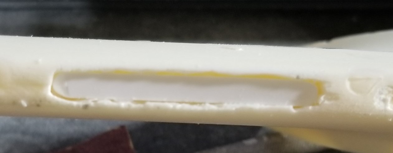

Have not had a lot of time to work on the models. The time I have had, has been spent on cleaning up the nacelles. Getting close to be done with straightening out the area that the inserts go into. Should be one last sanding, then back to electronic installation.

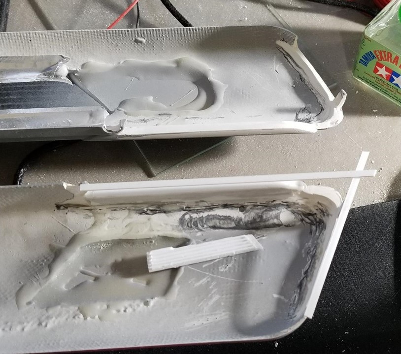

The cleanup/straightening out of the grill area on the nacelles is pretty much done. I need to come up with a new insert that goes in between the nacelle halves. I do not think putting this together via a bunch of strips is going to work. I think I will design a part and cut them out on the Silhouette. The problem and benefit of this is that the cutter can only really cut through 0.020 thick plastic. Looking at the studio model, this insert part thingy is really thick, thicker than what I will be able to put back in, due to the current unchangeable geometry of the nacelles. I think I will be able to get between 4 and 6 of the 0.020 thick parts sort of glued up like a laminate board. Maybe stronger than just strip styrene, I do not know, but will find out.
I got the other 3 light boxes for the warp engines done last night. I think I can install the electronics now while working on the inserts.
