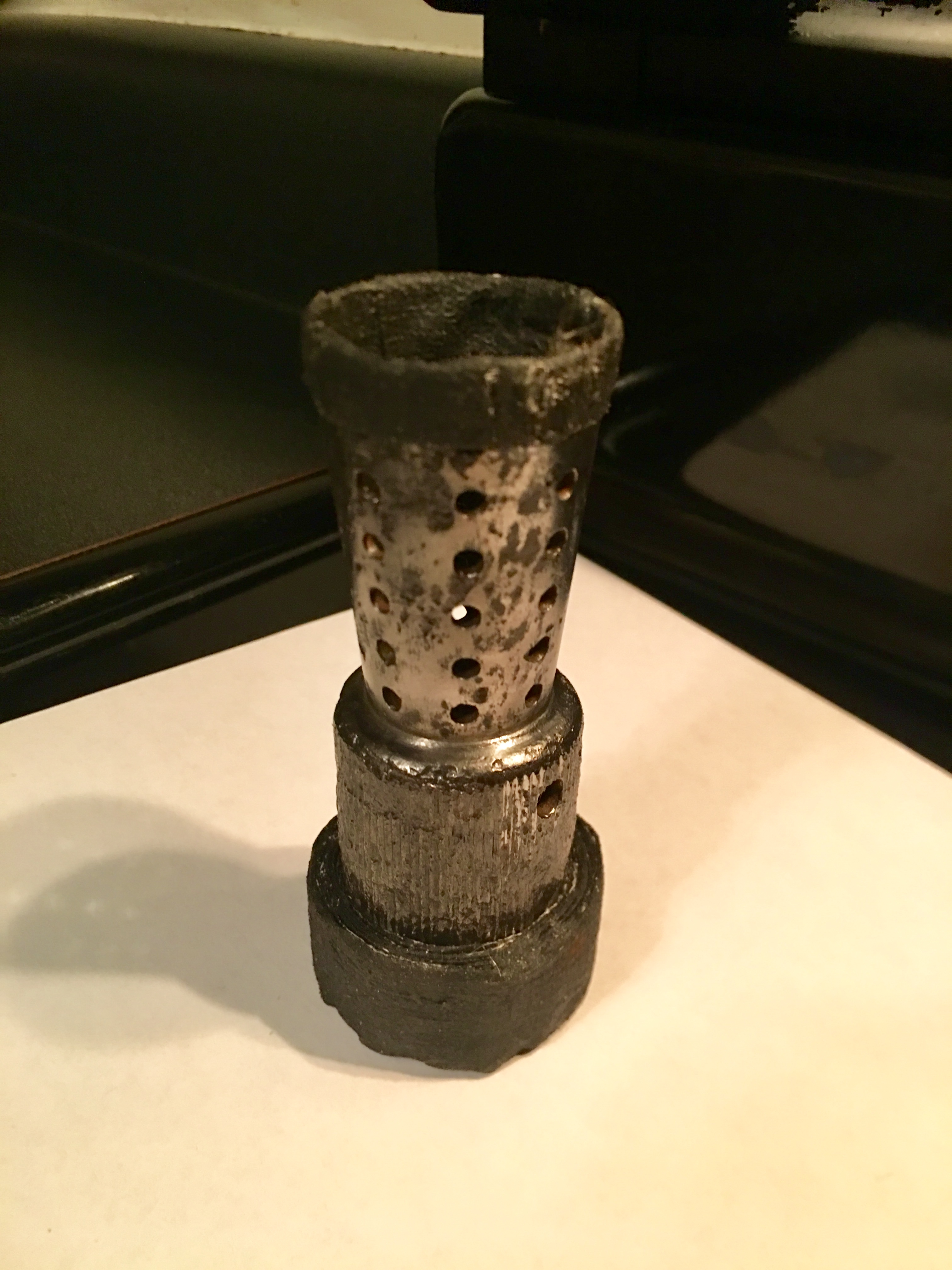

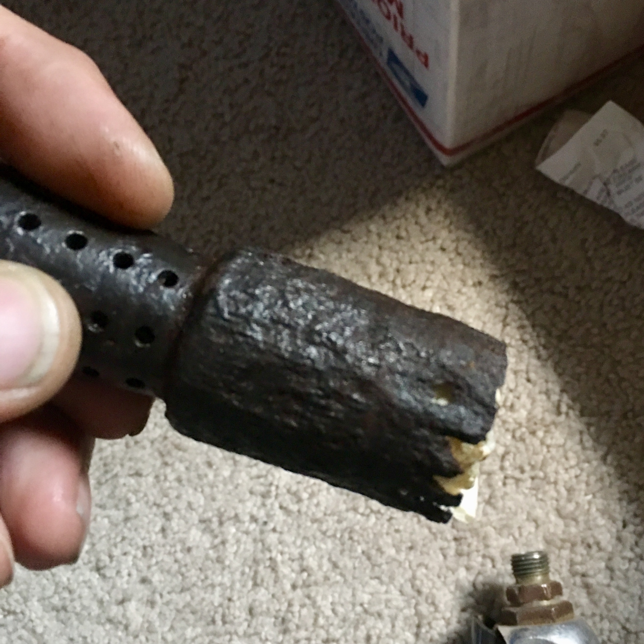

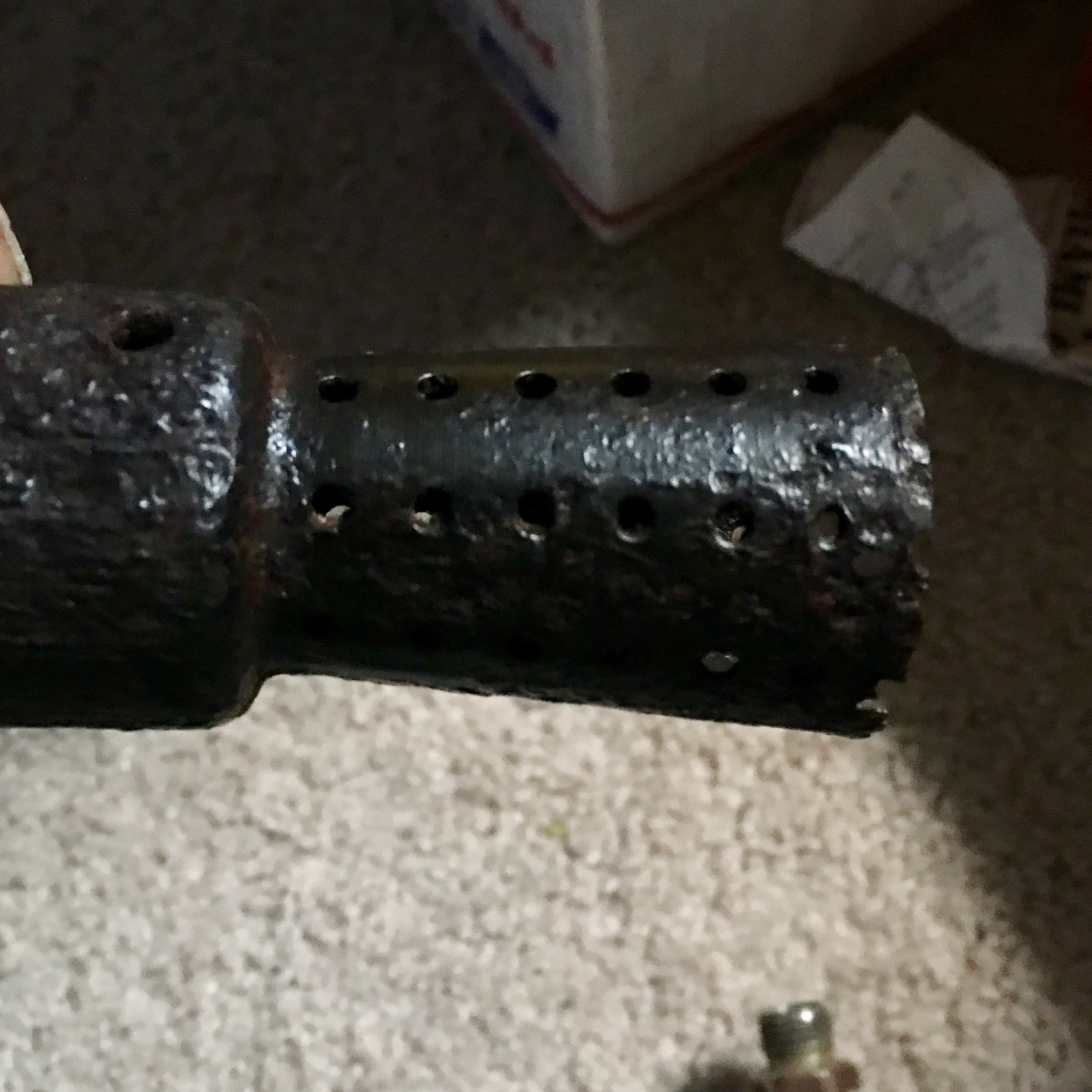

A month or two ago I received a fantastic collector piece from my friend OdiWan72, this MG81 Feuerdämpfer:

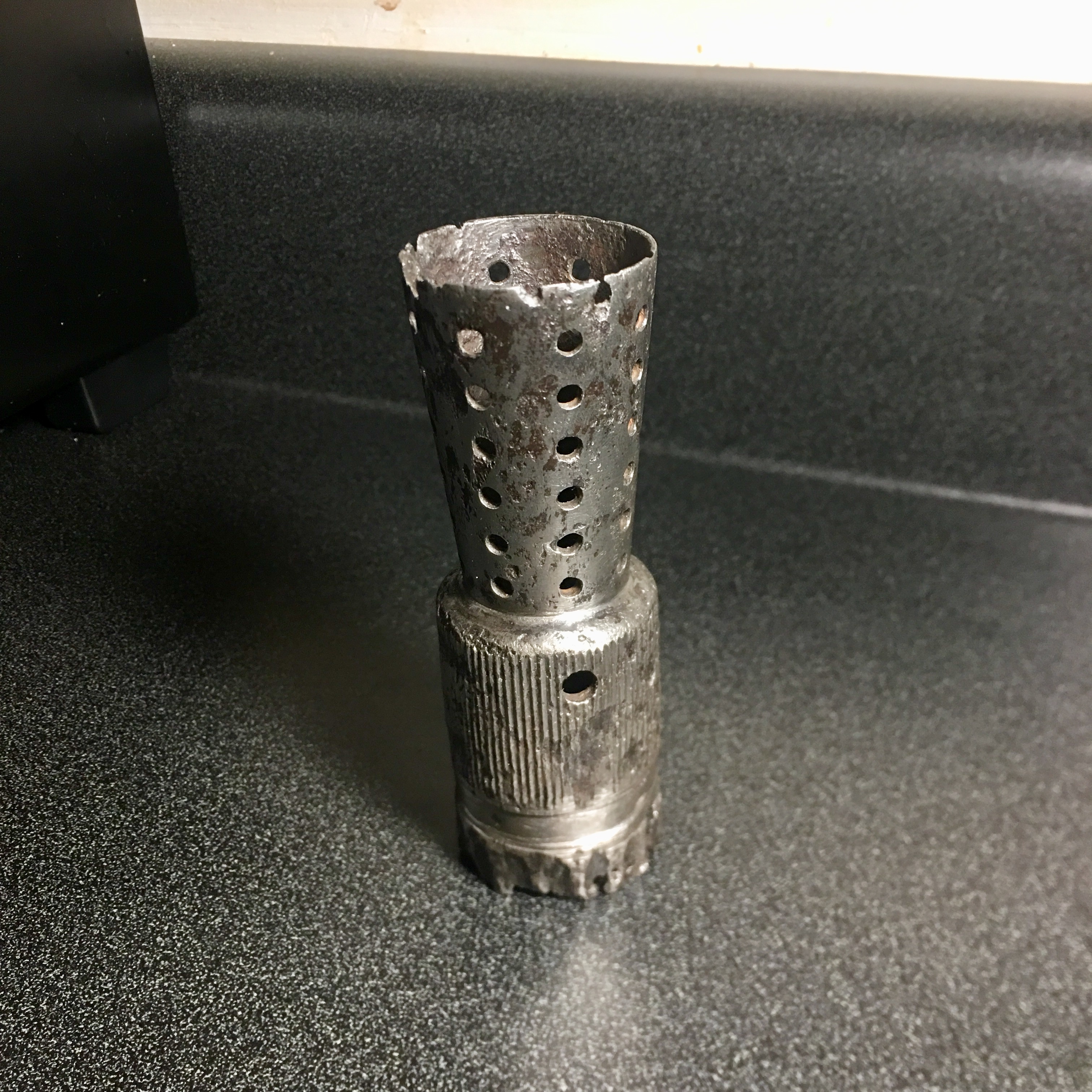

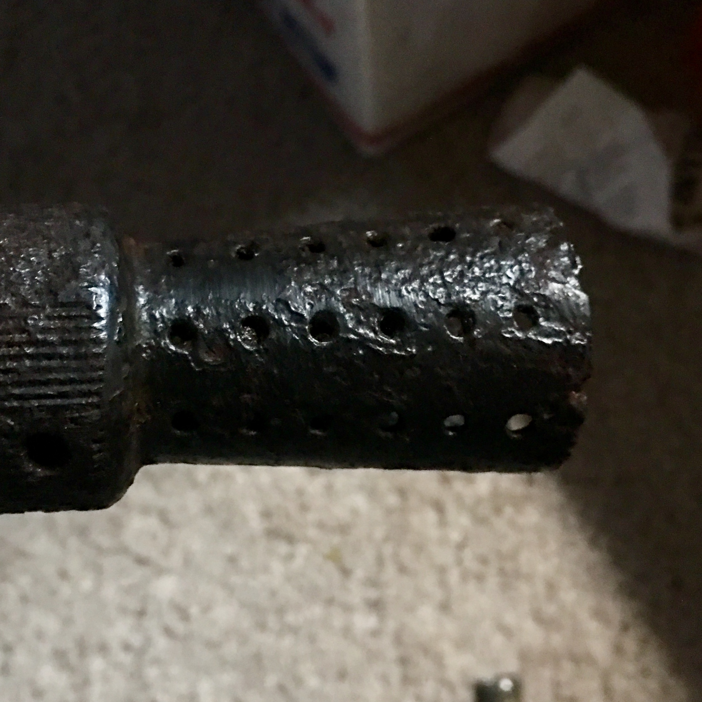

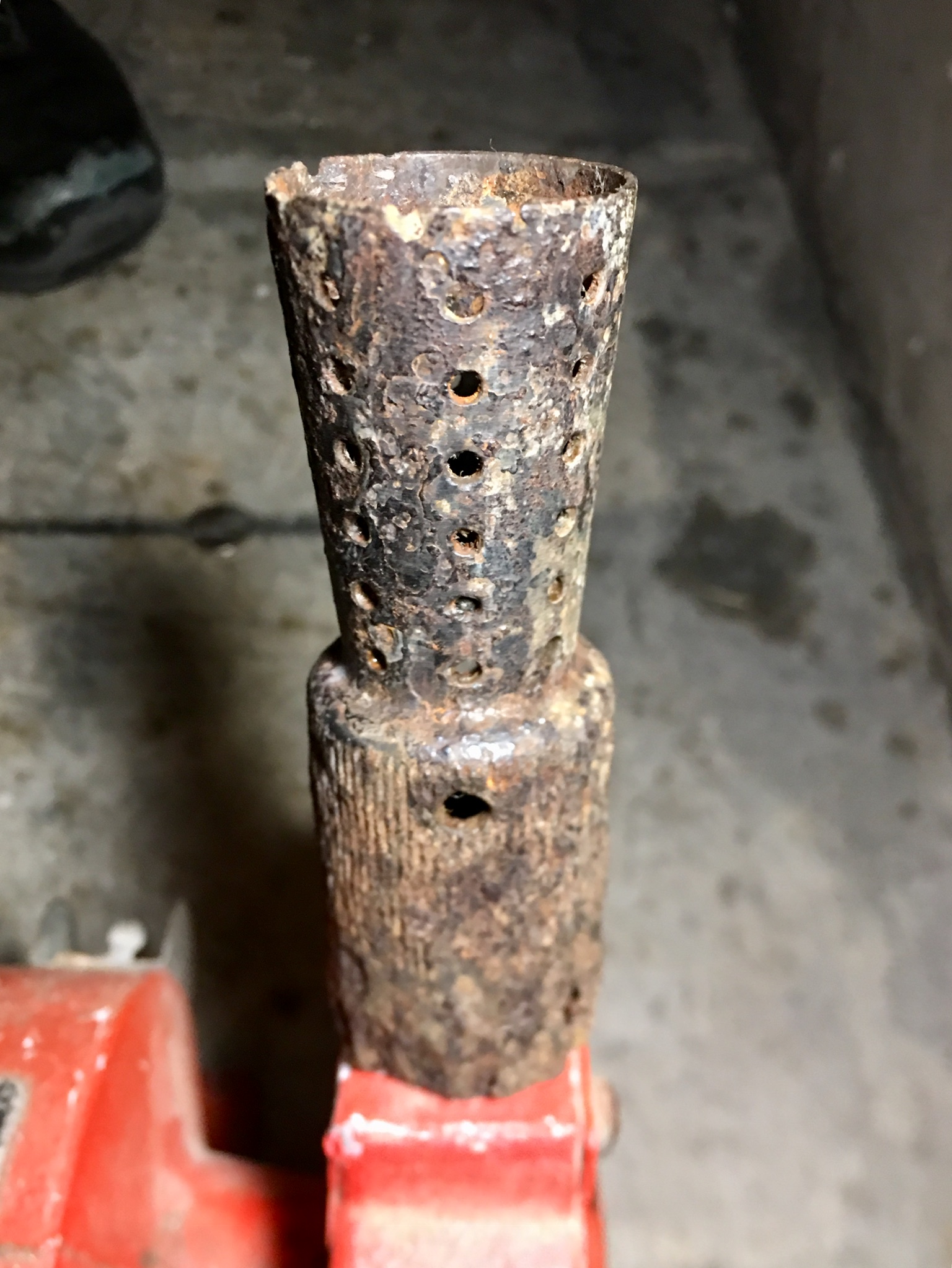

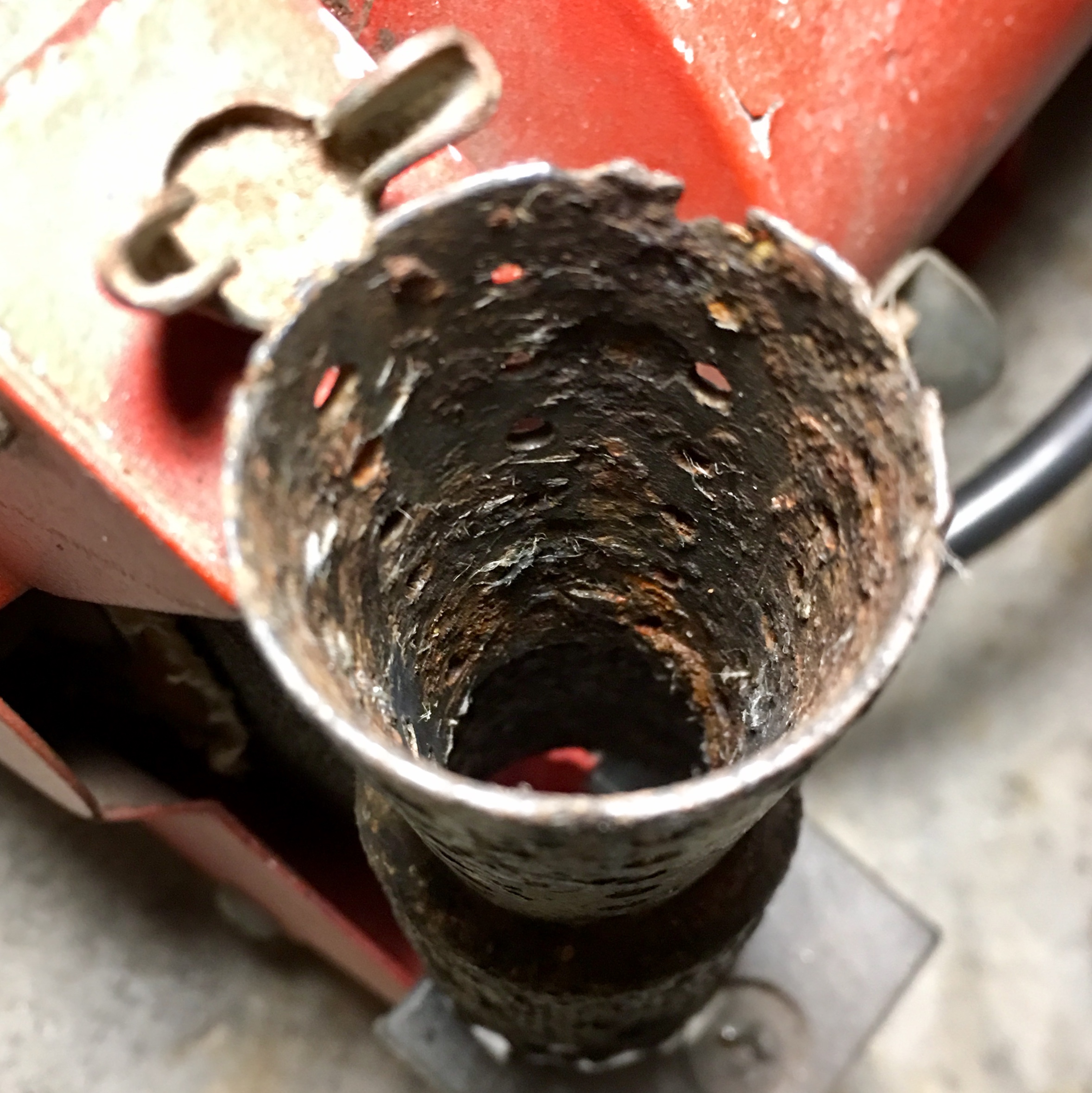

It is by all accounts in RELIC condition. Here it is under a “spotlight” as I received it:
You can see all of the rust build-up, the deterioration, and general mutation to the original piece’s physical shape.

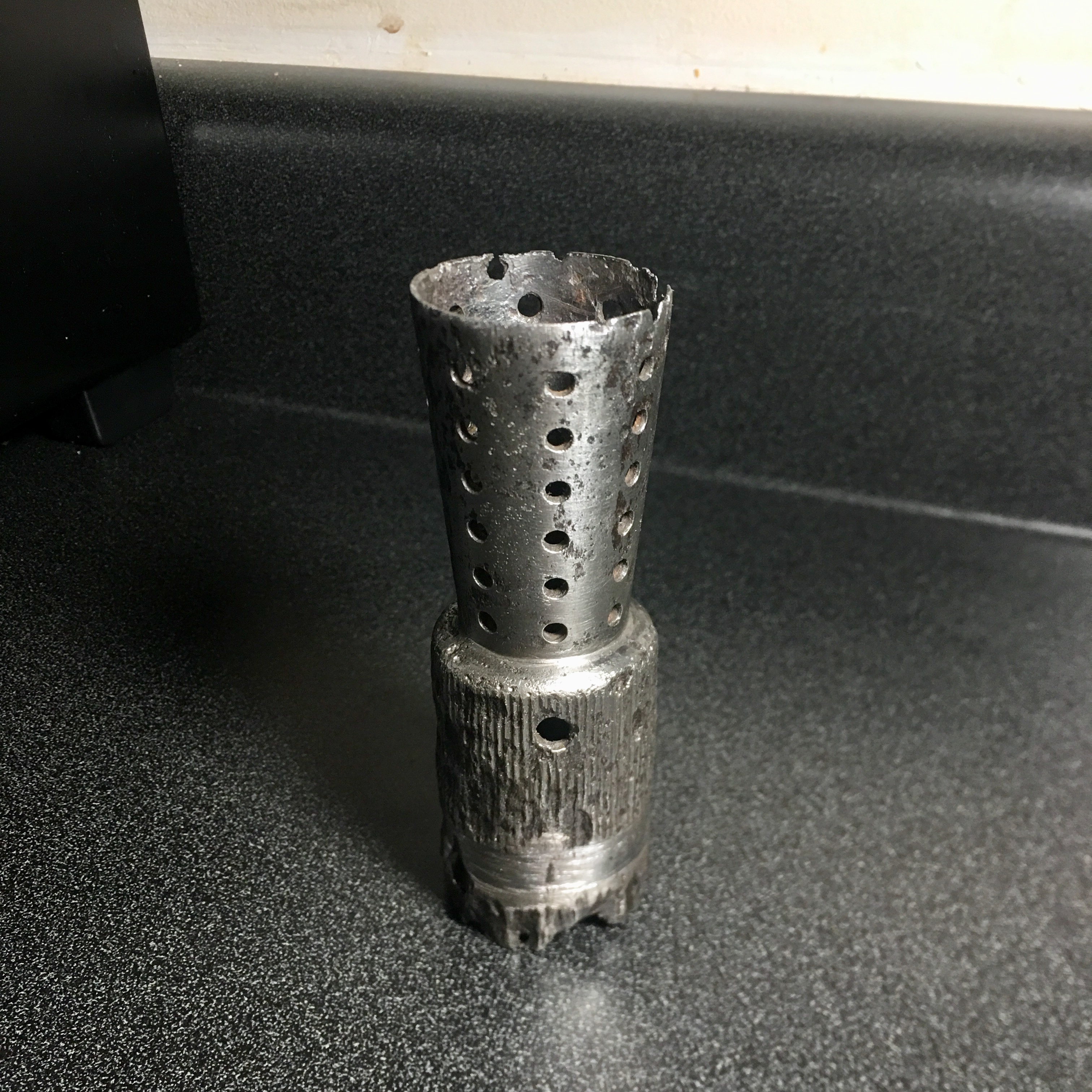

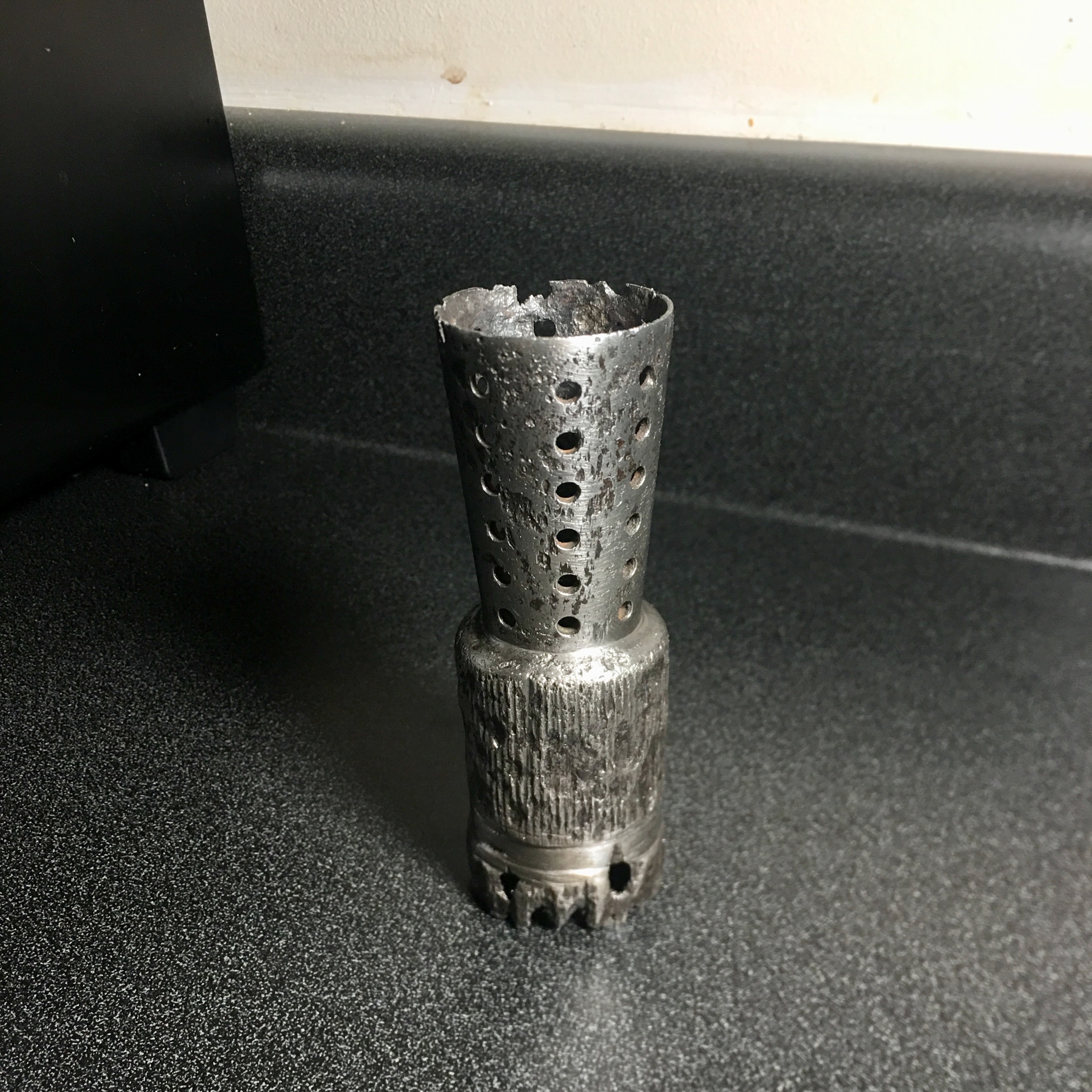

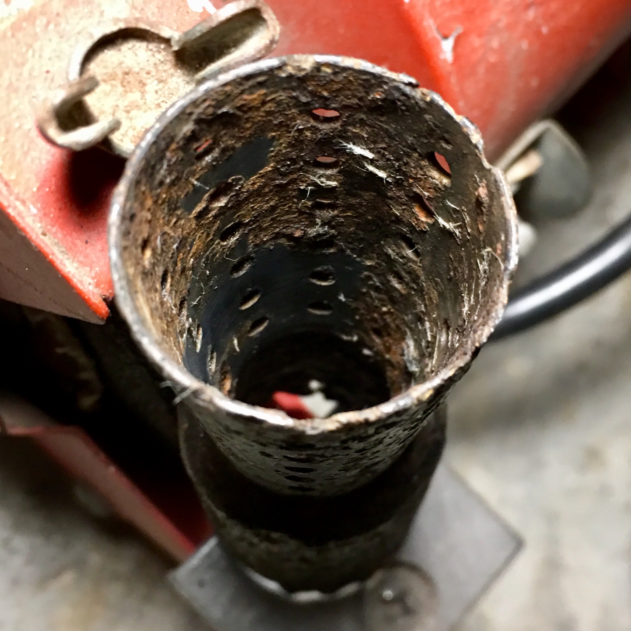

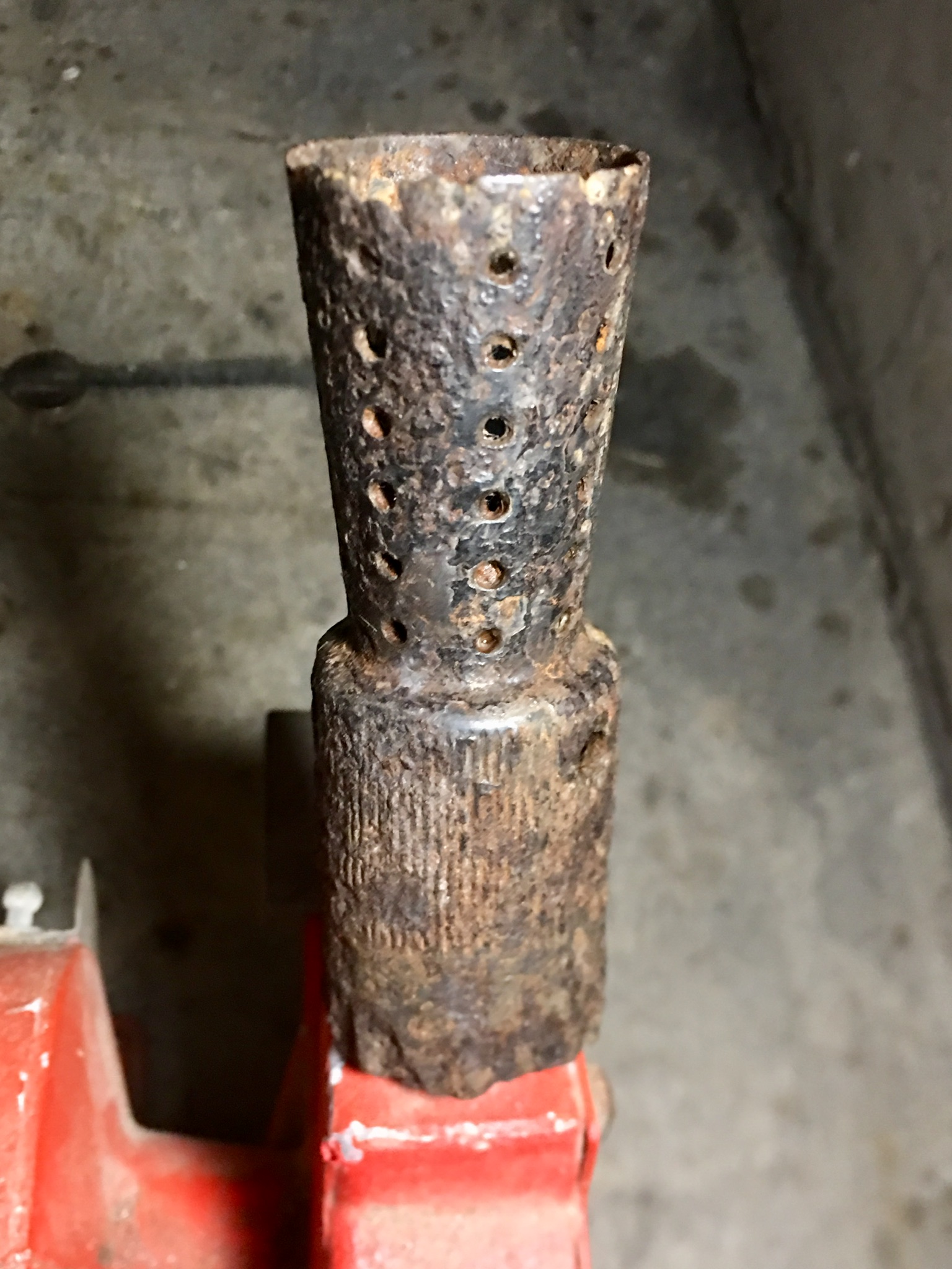

EDIT: Actually, here are some better photos of the pre-restoration process flash hider:
69B48DA7-31CA-4FC4-BDD5-5D4BF9DF6AE2.jpeg 63FDE59C-DCE2-4B92-996E-55F15B83819D.jpeg E9742466-AB22-42F1-90DB-2020CFDA4C42.jpeg 05FE3192-F150-4920-AC55-3860B9040980.jpeg
65519376-9117-401A-BFB1-290E197CE8D0.jpeg 5E0AA98C-033D-4E6D-AF8B-EC4F066B5A82.jpeg E9770C4C-E38B-4DC6-BA5E-FAF32E8DE3A8.jpeg 5A6BB6DB-FFE8-49B8-938C-869BEEE48897.jpeg

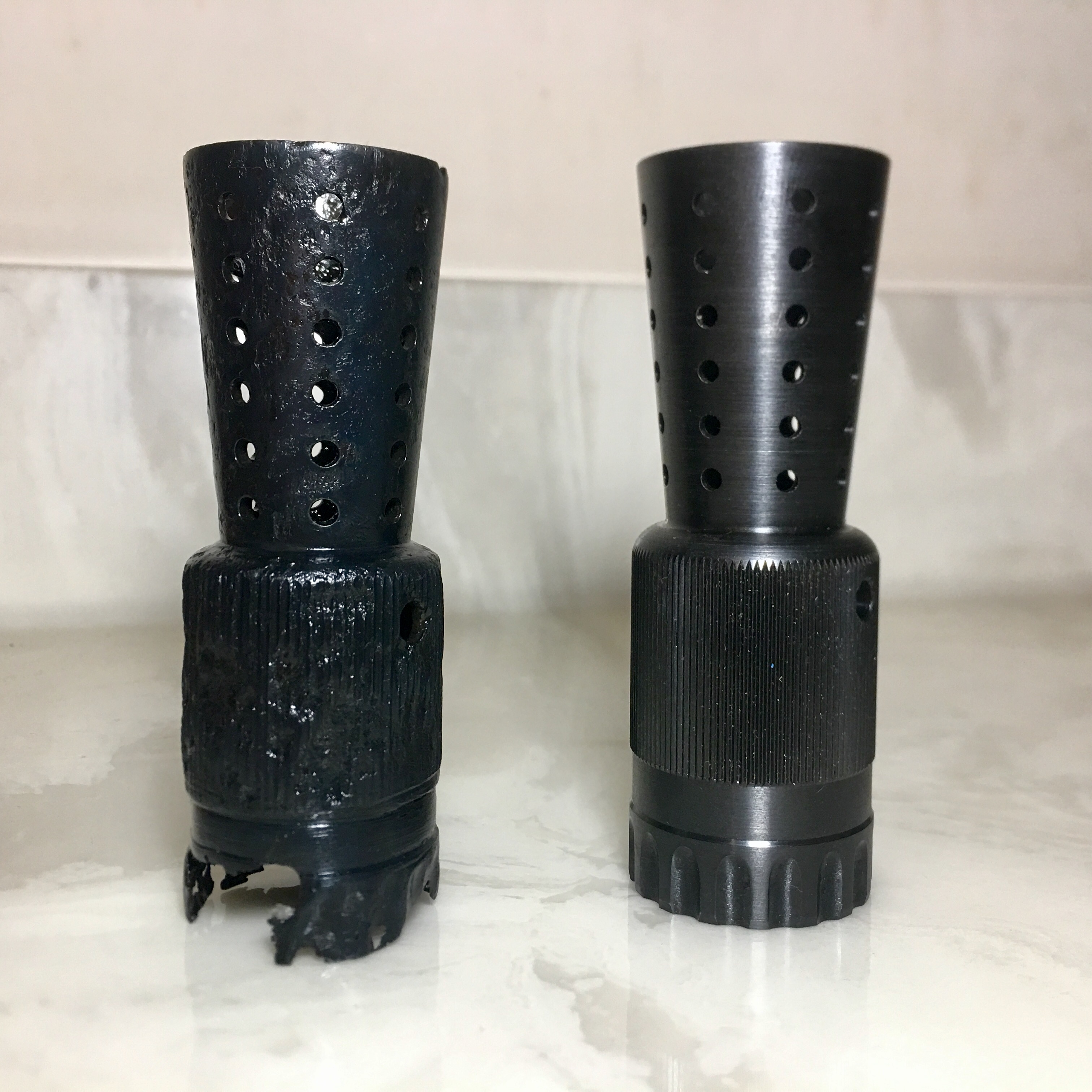

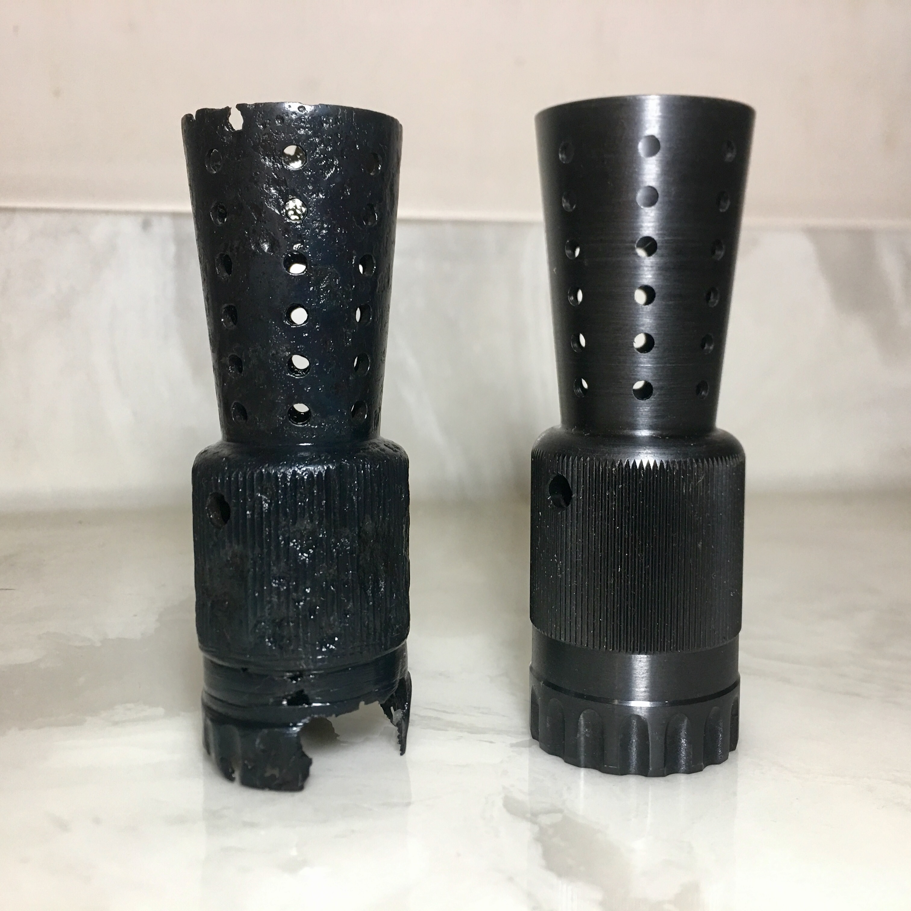

Being inspired so much lately by the several restorations completed by newmagrathea at the Prop Chop Shop I decided to try my hand at this monumental task.
My process is very much like newmagrathea ’s process, although on a much smaller scale.

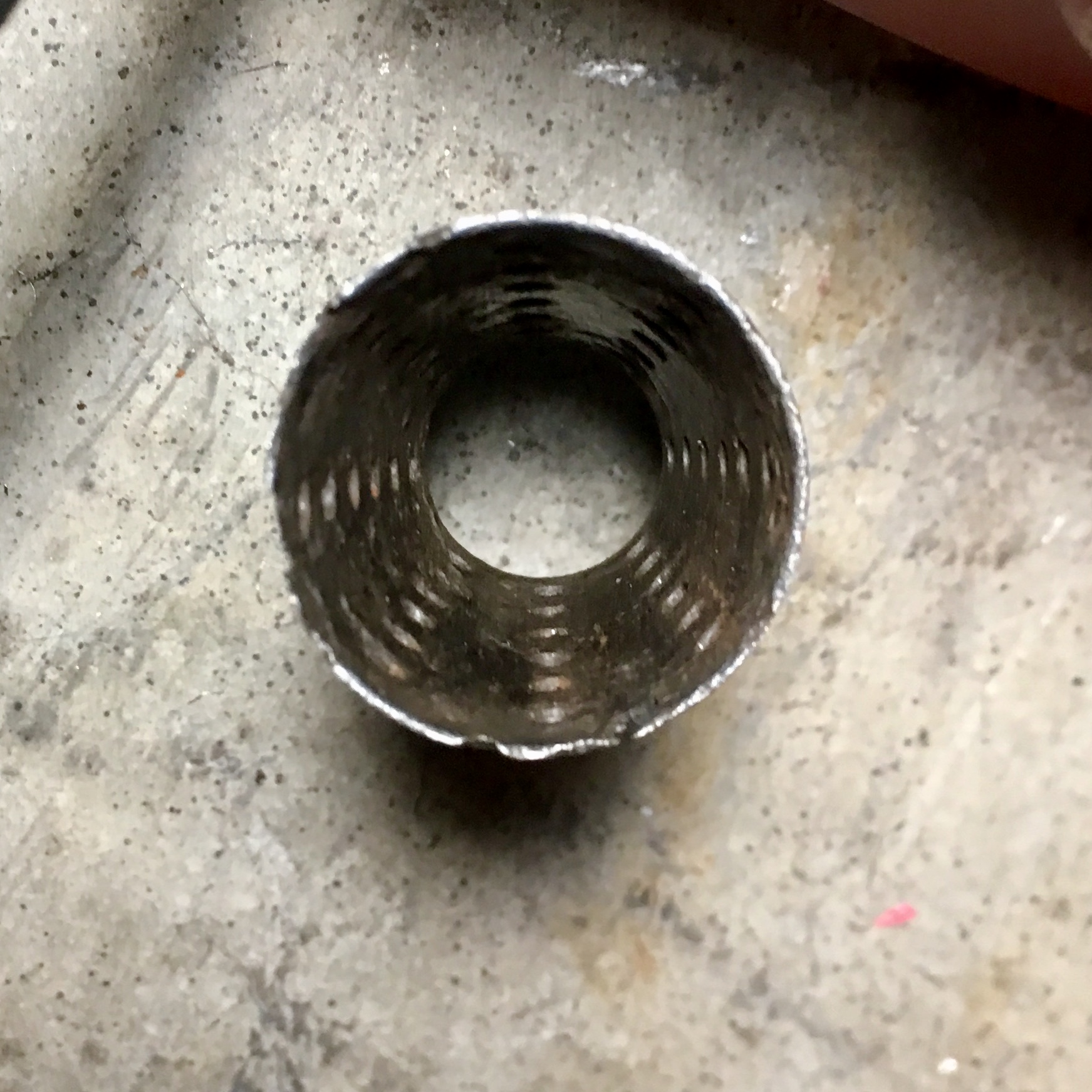

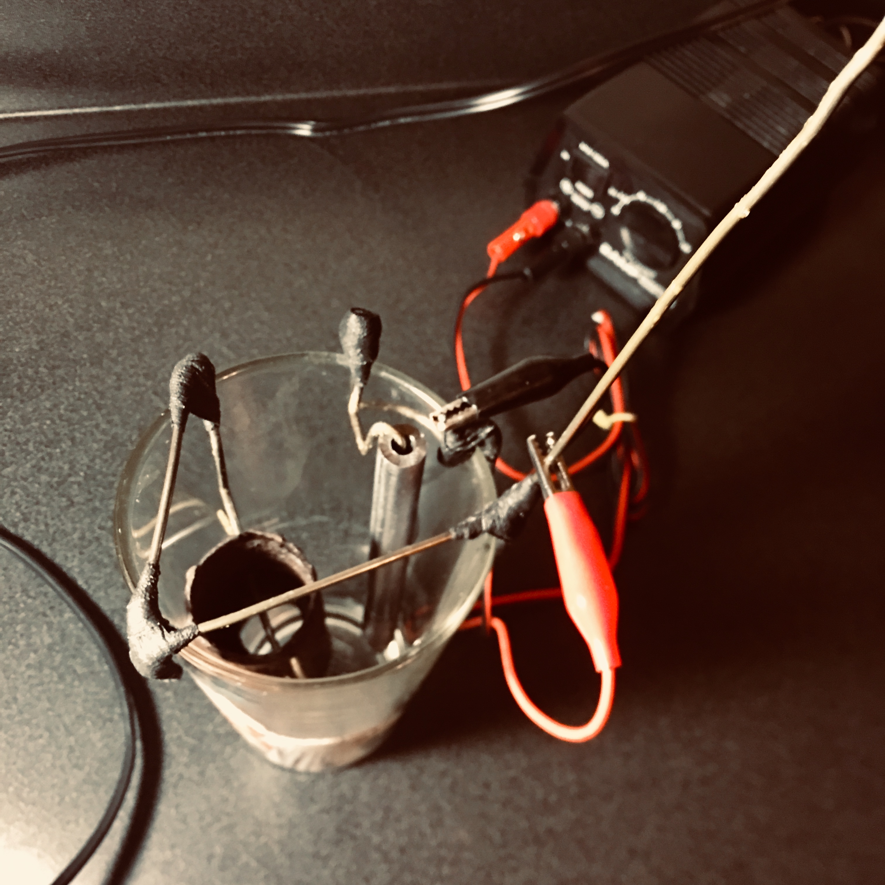

I put the flash hider through several sessions of electro-cleaning rust removal using an old Star Wars pint glass, white vinegar, the Mommy Dearest Special, alligator clips, and a current generator:
Lots and lots of rust was removed from completing this process 6 or 7 times.
***WARNING: Doing this process as I have it set up, will create a biproduct of Hydrogen gas, which is toxic above very low levels. ONLY DO THIS IN A WELL VENTILATED AREA! WARNING!***

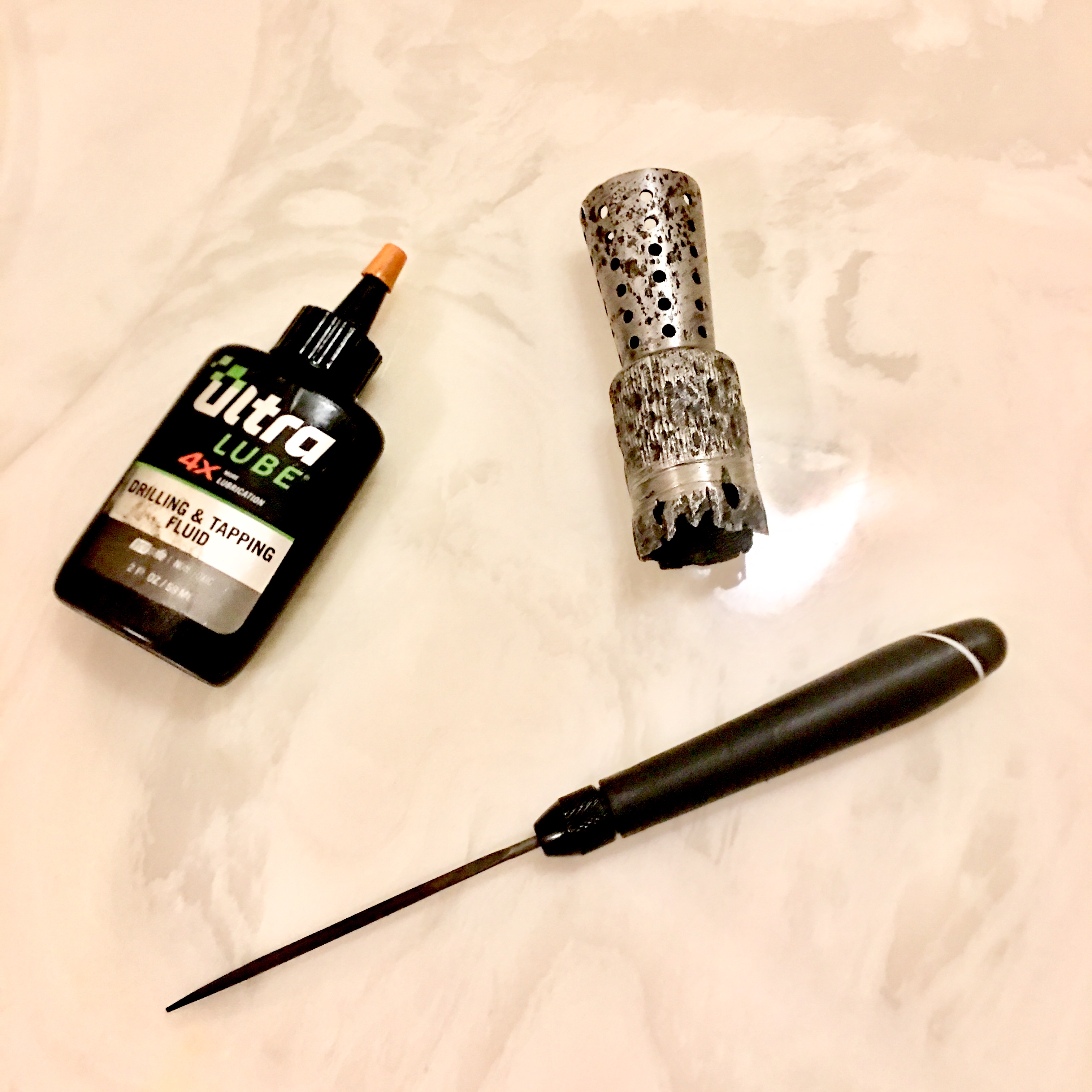

From here I did about 30 minutes of hand filing on the cone along with about another 30 minutes of delicate wire-wheel time on my bench grinder leaving (after this first filing session) this result:
***WARNING: For those newly using a dremel, rotary tool, bench grinder, etc. EYE PROTECTION MUST BEEN WORN! FACE PROTECTION is also a GREAT IDEA! Also, I HIGHLY RECOMMEND some sort of BREATHING MASK or RESPIRATORY APPARATUS! Don’t believe me? Blow your nose a few times after a session! WARNING***
From here, multiple multi-hour sessions with a watchmaker’s triangular hand file to sharpen up those knurl lines on the base of the flashhider, leaving the following (I added tape to the ends of the fh in order to stop cutting my fingers with it while handling and rotating the piece):
CD82A93F-37B4-4273-8694-3160CCEA480F.jpeg BC398458-9908-4EFA-AA8D-D3B52A52AFE7.jpeg FFE6268C-214D-420B-B86E-4AFA38D749B7.jpeg F8C46D27-7C65-414F-A071-A5460DA91E46.jpeg
Hey! Want to know what crippling arthritis feels like for a few days? Just pick up a set of these items:

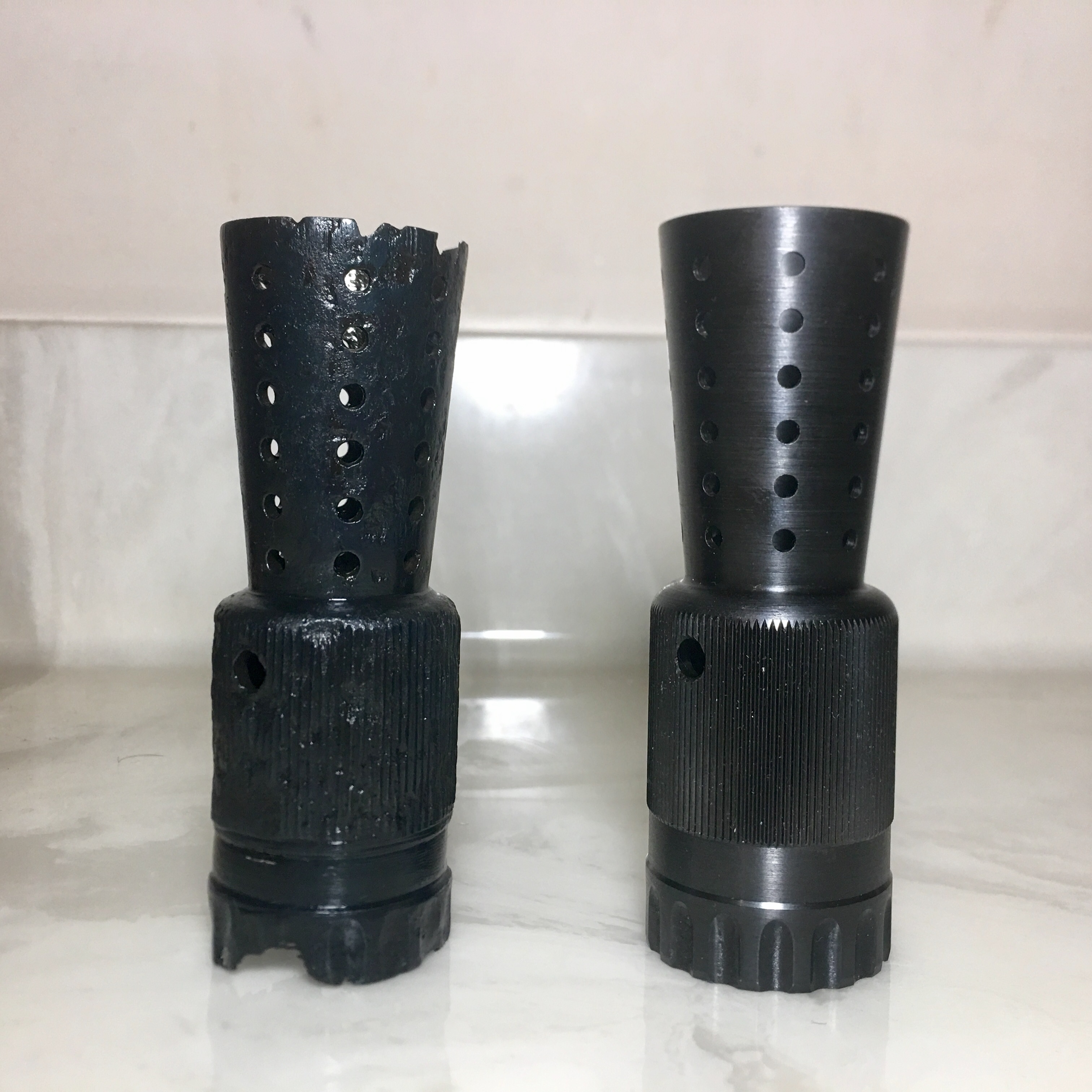

After an additional two multi-hour hand-filing sessions to reshape the lower protion of the flash hider (as well as even more knurl-line re-working) I was left with this:
455F0524-83FA-4AF4-BAA0-1E5973654972.jpeg 9F8EEA60-98C7-430C-A3C6-A0CD1AA7B32B.jpeg F385652C-3690-499E-BE19-19B8D93BA194.jpeg
From here, I completed another 30 minute de-rusting by the white vinegar electro-bath. Now it was time to reblue this badboy:
I elected to use Brownell’s Blueing agent for this. I washed the fh thoroughly, then degreased it, rubbed the flashhider with steel wool, and then applied the blueing agent to it. This process was repeated again and again (okay, like 4 times) until I was able to obtain a fitting rich darkness for the flashhider:
22627B23-2FFA-4239-AF03-A75BC7B66699.jpeg E6B2A86B-E681-459E-8F9B-C771426F91D6.jpeg E0BCA2F3-E28A-4CCF-85A4-78EAAB7364E5.jpeg 1B7EC39B-8708-4EB1-958F-205F3C1A9663.jpeg
And here she is... this is as far as my throbbing fingers will take her:
And now I need just a few more parts:
Here are some comparison photos next to a Todd’s Costumes DL-44 Flash Hider:
Thank you checking this out.
Of course the bottom is a bit worse for the wear as are some of the knurl lines more than just a bit over the line of acceptability (especially the band edges near the bottom of the flash hider) but it definitely is much better than it was at first arrival.
This probably will remain among my collection but not on a live fire due to its condition, but just holding this in my hands really gets the wheels turning about where and what all this flash hider has been through. The world has certainly gone through many changes since those days... or has it?

I really enjoy seeing these restoration threads and videos on original parts. This flash hider is definitely a relic of world history, and you've brought it back to its best possible condition. Thank you for sharing. Outstanding work!
Wow!!!
Maybe you should consider to back up the lower section with black Aves Epoxy putty and rebuild the missing areas....just an idea to improve the look even more.
I am so glad you have this
Holy crap! If this is the same one Im thinking of that was sitting on ebay for a while I really regret not picking that up. What a transformation!
Thank you for the kind words.
I don’t believe it is that one as I think this was found some time ago, but I could be wrong as this was a gift.
Amazing job at restoring this flash hider.
Thanks, Dustin, but we all know who the restoration king is here, buddy.
Thanks, Chris. I wasn’t even going to post this, thus the skipped steps and left out photo documentation, but after literally 10 hours (combined) of filing by hand... well, my fingers were not going to let me slide this one under the rug.
Wow!!!
I am glad I have this too. Thanks, my friend, it really means a lot to have this.
Also, I agree with trying to build up the bottom. I have been experimenting on another build with some cold-steel resin. It seems to work well but not entirely as advertised. I still think the steel stick works better for long term security, but I will try out what you have suggested. I literally couldn’t have done it without you!
I had this dug relic in my collection for many years...got it from a collector in Poland, so no...it´s not the one that was sold recently

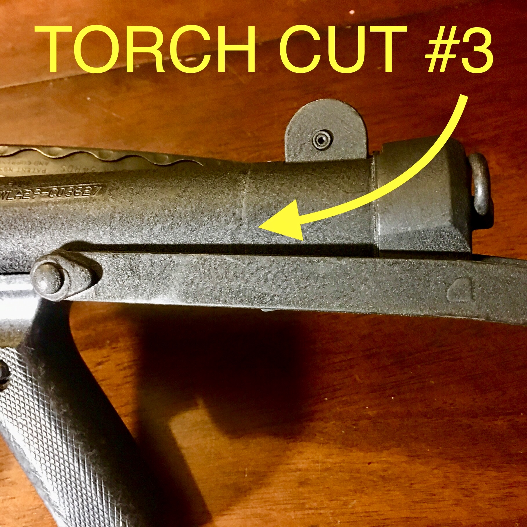

Making a Parts Kit From a Firearm
This is formerly a British Sterling MK IV SMG, which is a submachinegun. In order to be imported into the US after 1986, the MK IV needed to be converted into a Sterling parts kit, which this particular one was.
Making a Sterling MK IV into a parts kit involves cutting the received tube into 3 or 4 sections, typically done by torch. You can see the spots where this feller was torch cut.
Once the parts kit makes its way into the US, someone needs to put the parts back together, but not as a Select-Fire firearm, rather a semi-automatic rifle.
Simultaneously, a certain number of parts used in the firearm must be made in the USA for the to-be-built rifle to be legal. The statute or law governing this is called 922R (pronounced “nine two two arrr”).

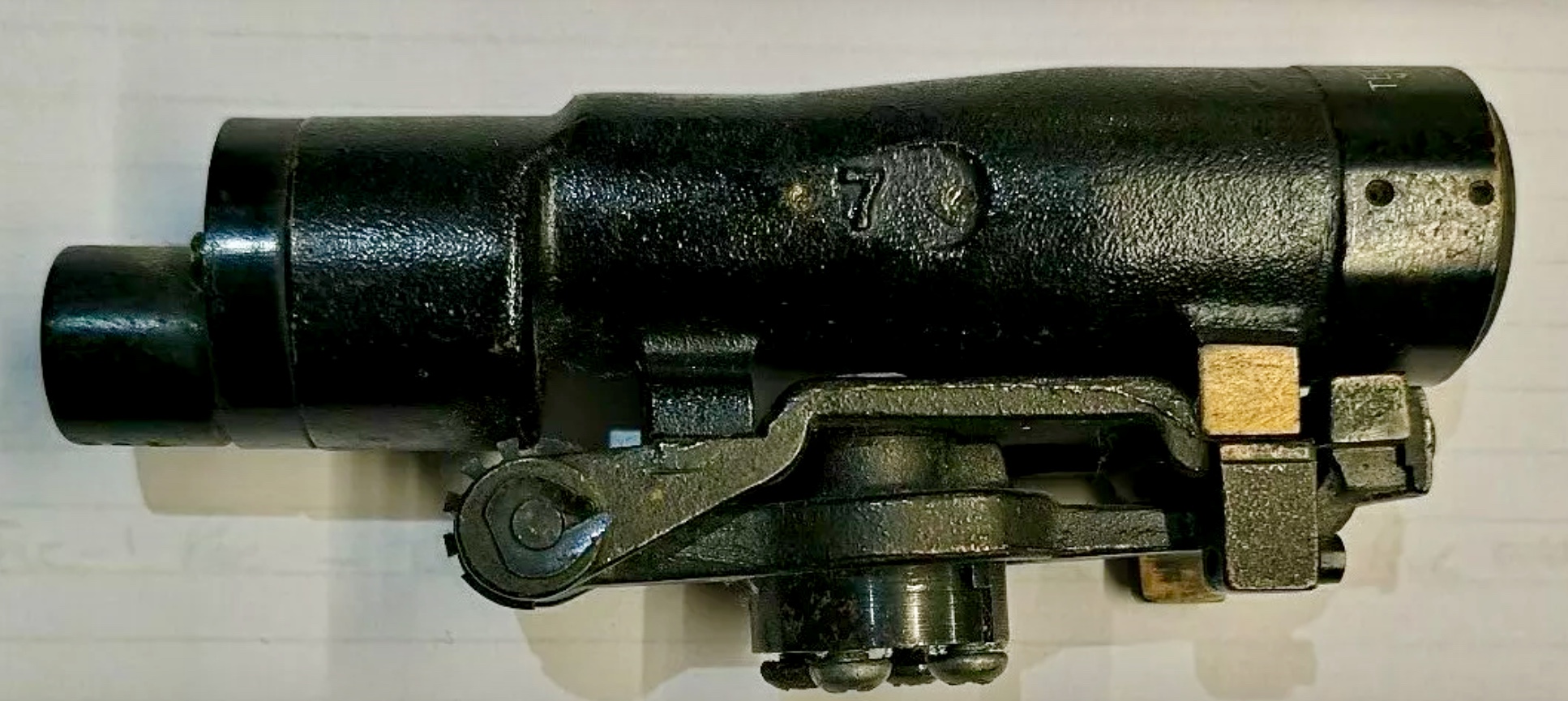

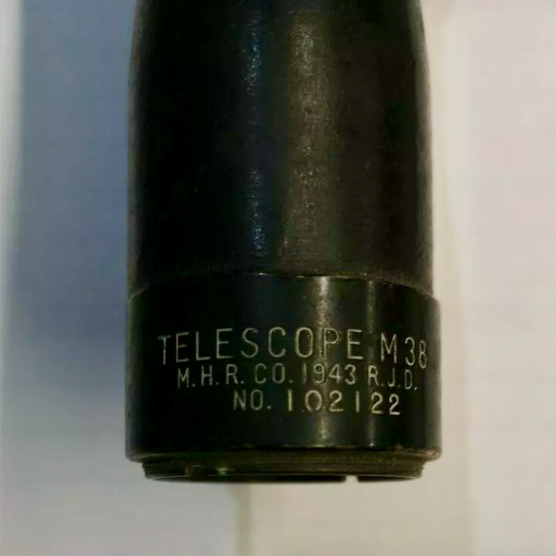

A. 1943 MHRCo M38 Telescope (thanks to Marv for your unending help, my friend )
E8DA5DC7-7890-4A3E-92A8-9E0AAE2CFFFC.jpeg 6E979A71-5114-443F-86F4-A8C3E4959F91.jpeg

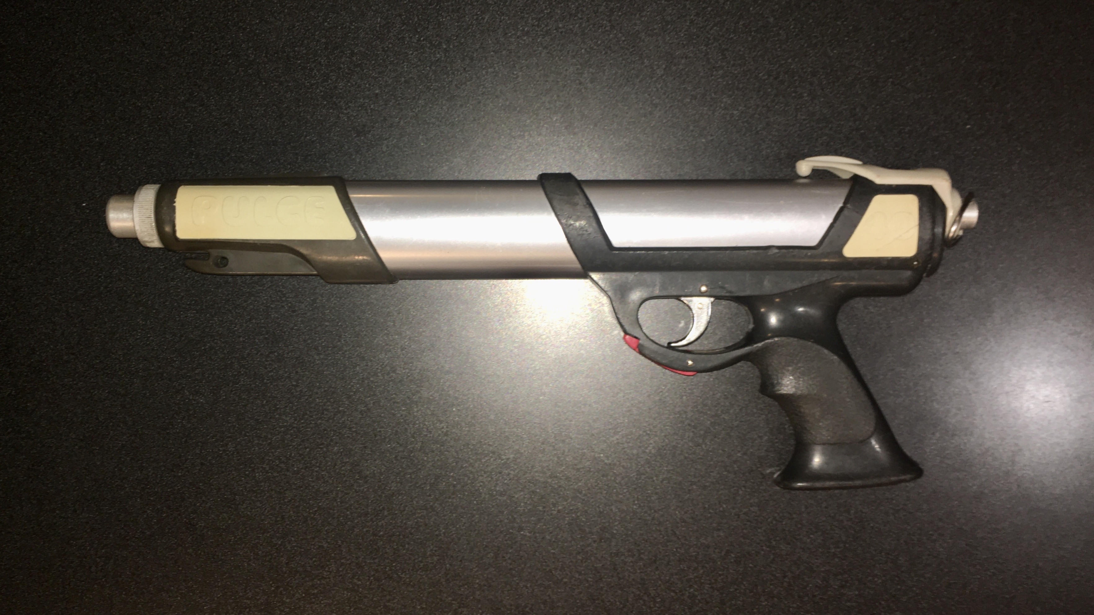

Technisub Pulce 40 (Boba Fett’s pistol in ESB)

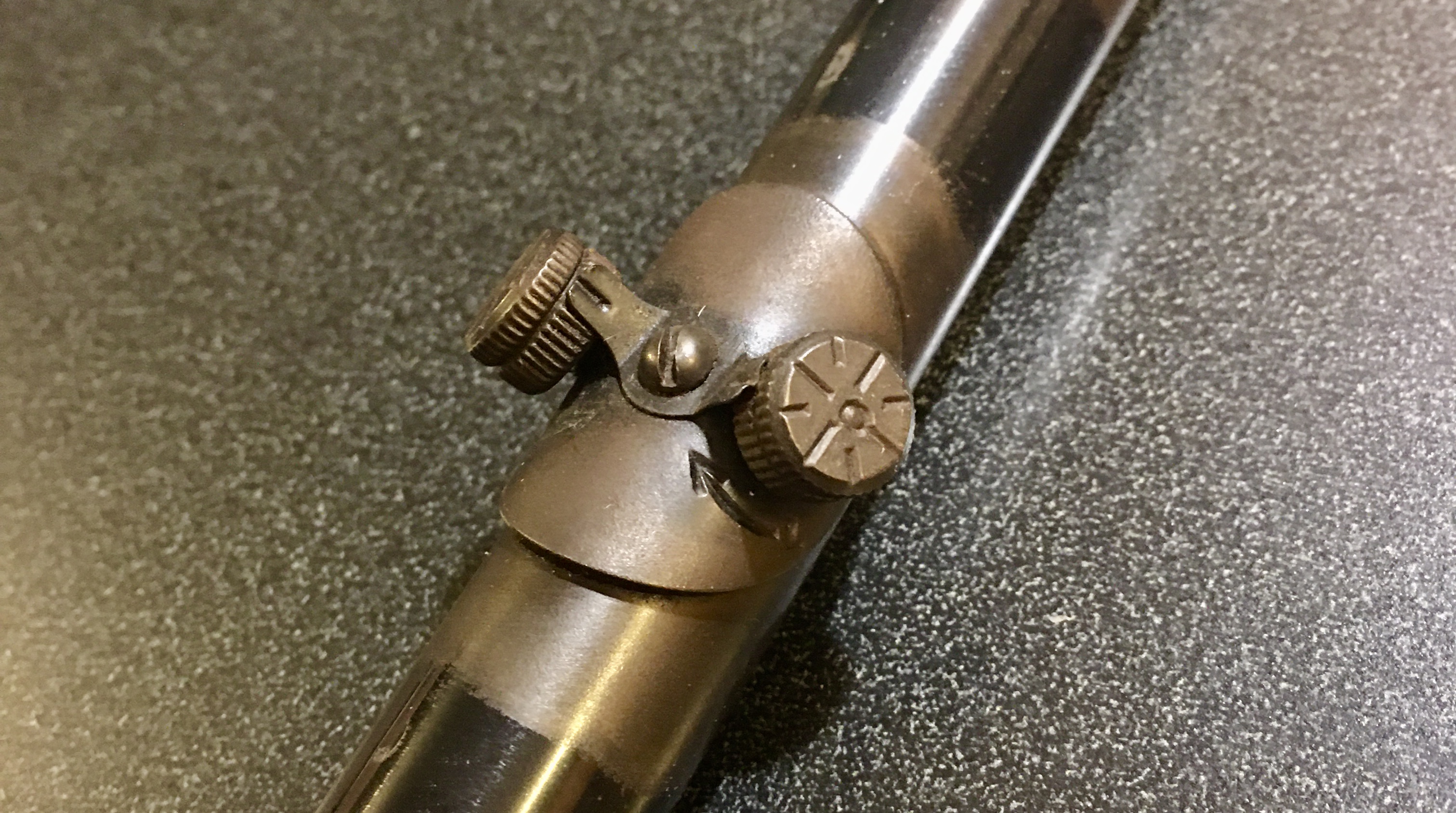

Weaver scope knobs (from a stateside package) for my BR Blaster build

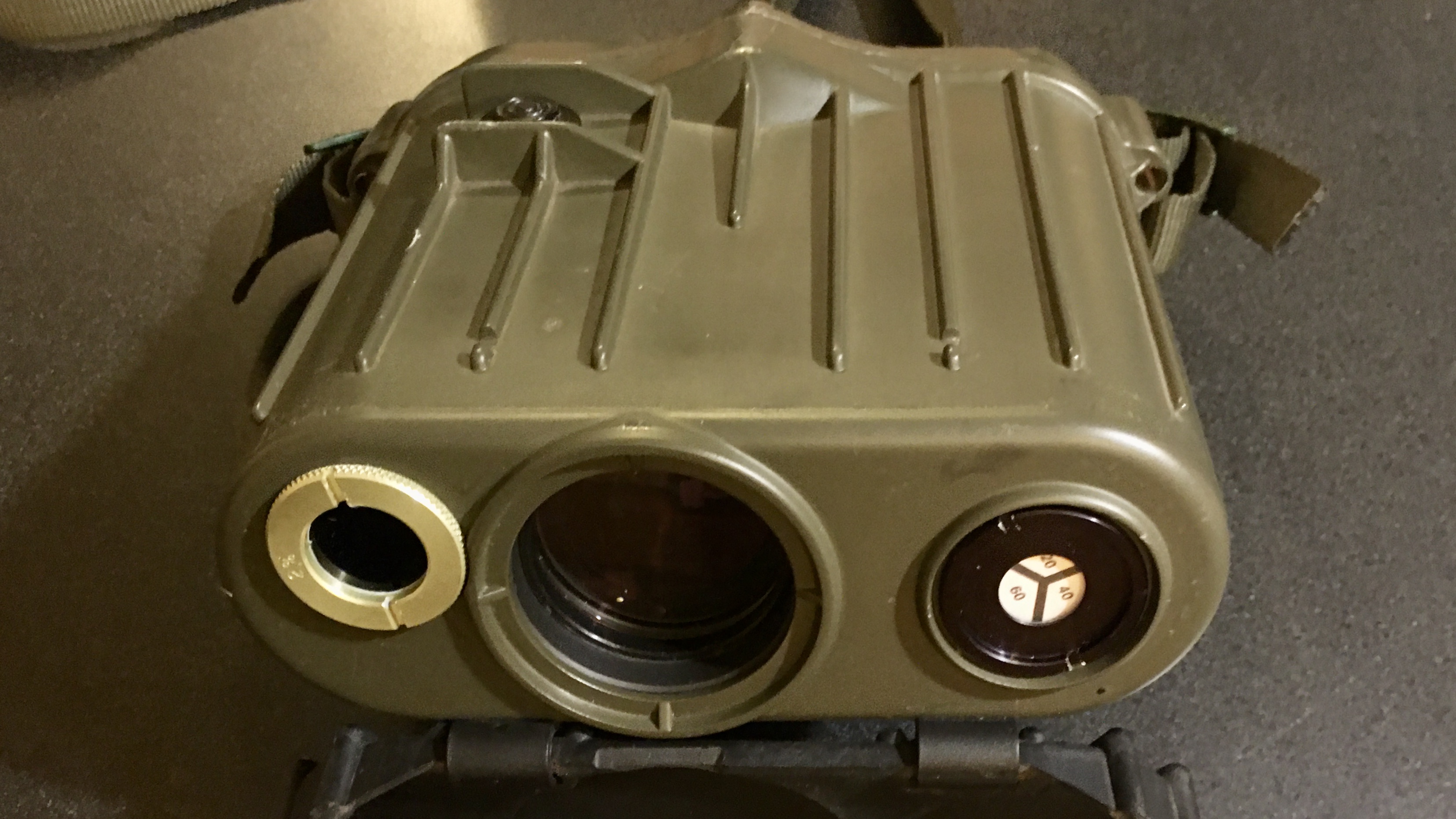

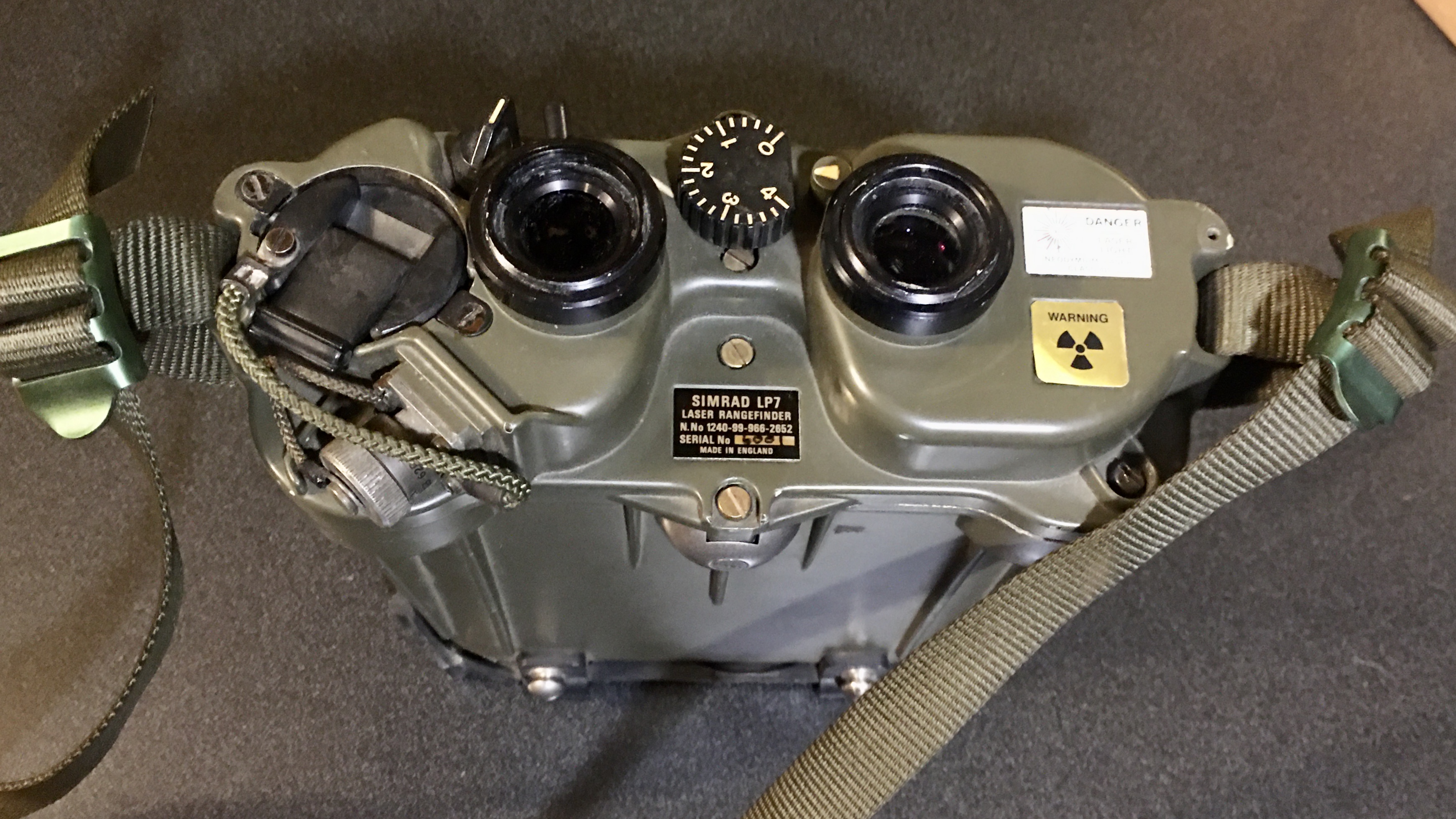

The real deal Simrad LP7 Laser Rangefinder for Luke’s Hoth Electrobinoculars
Special thank you to my good friend across the Atlantic for taking care of me AND these pieces. I owe you a lot, my friend!
