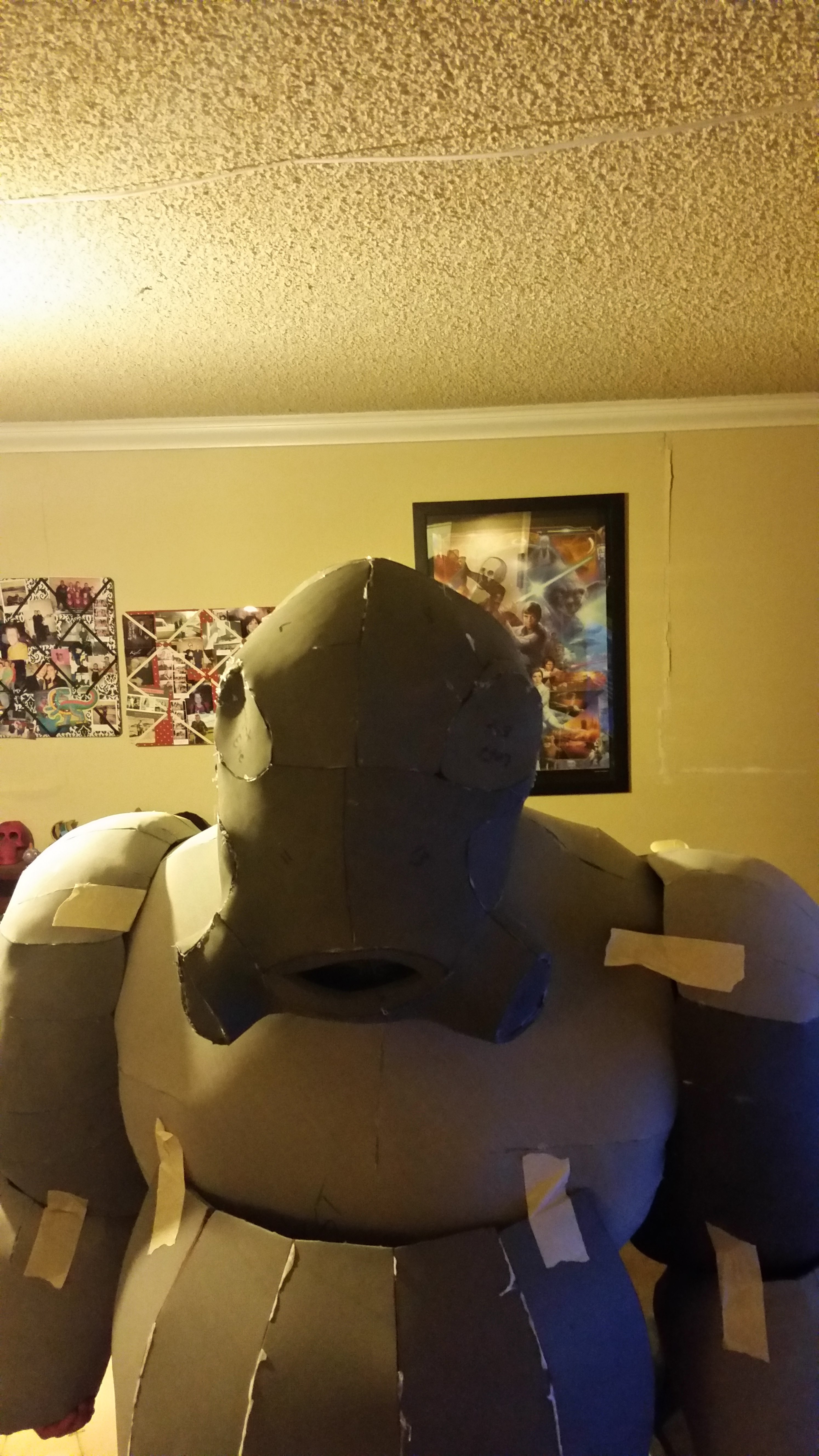

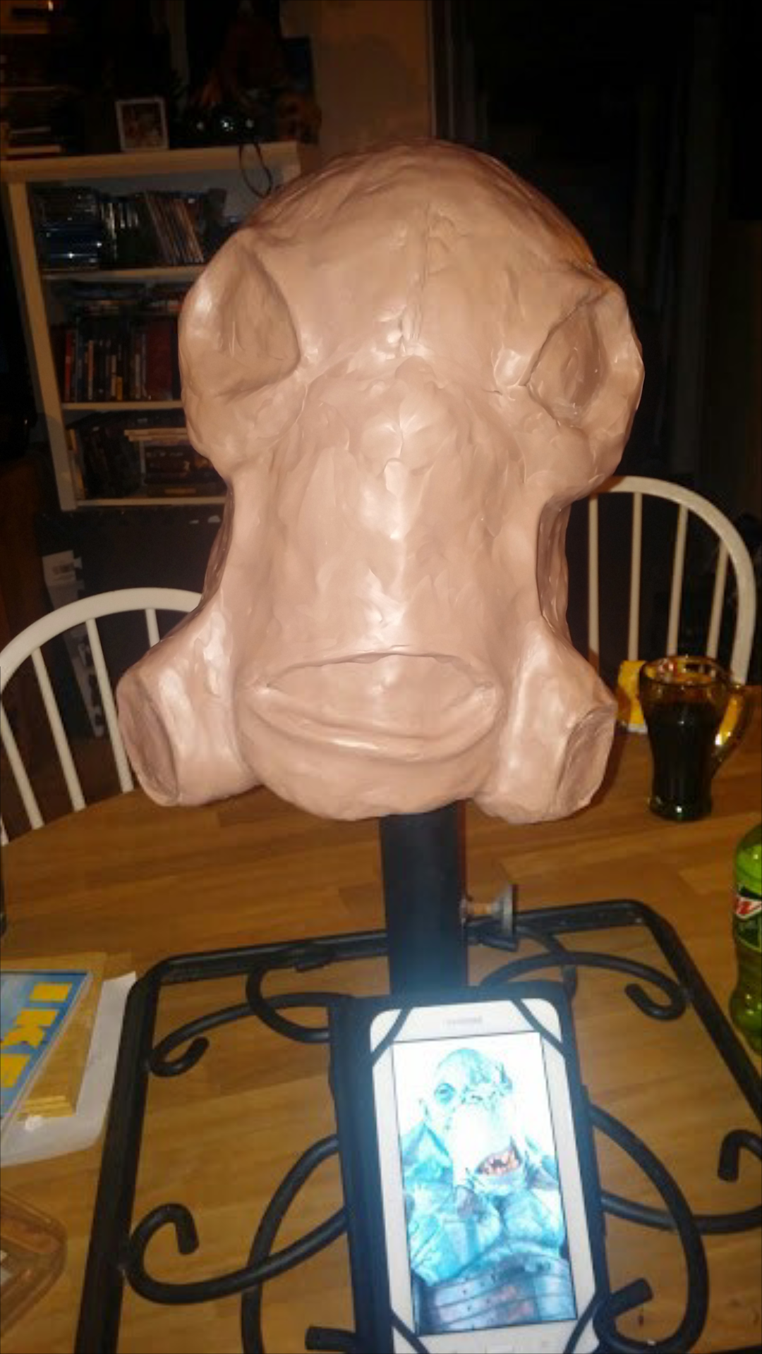

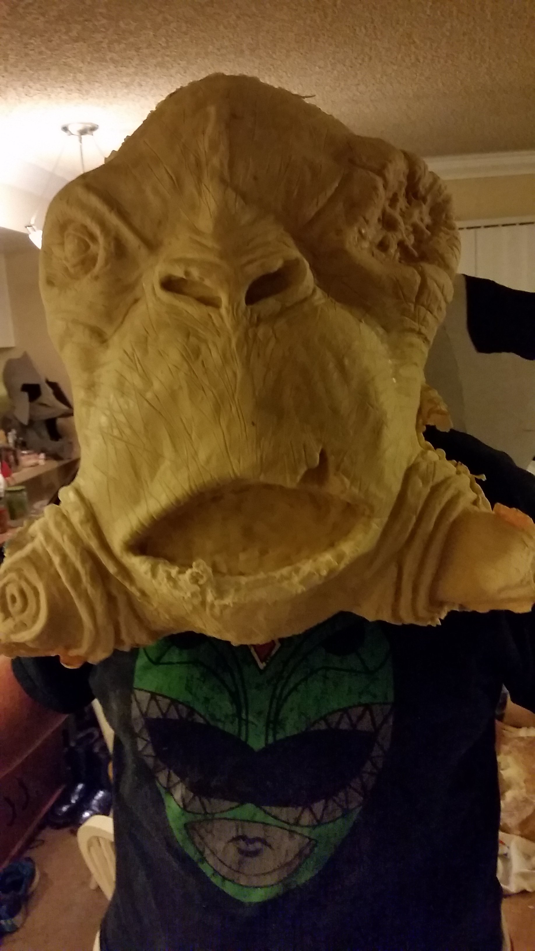

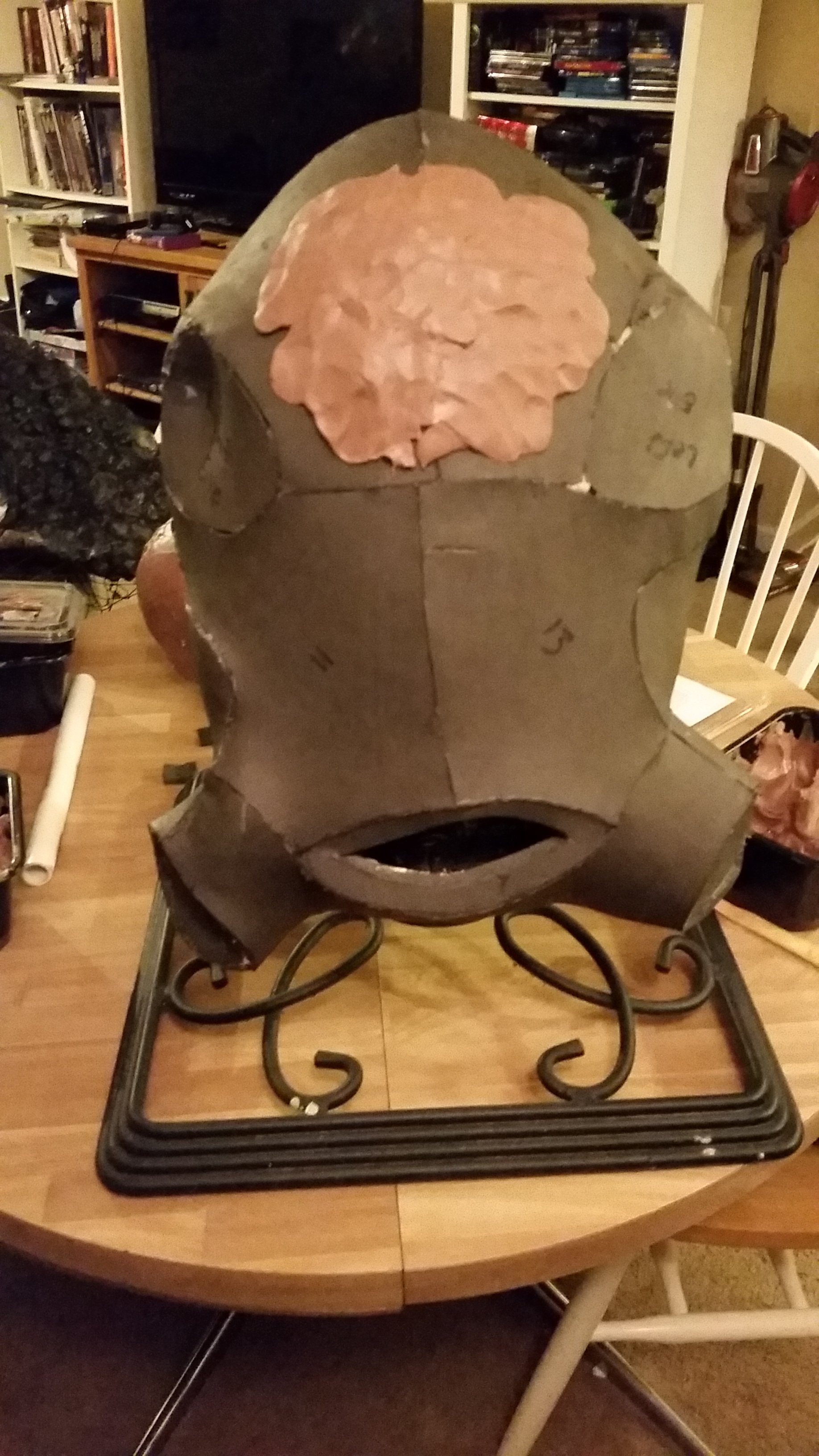

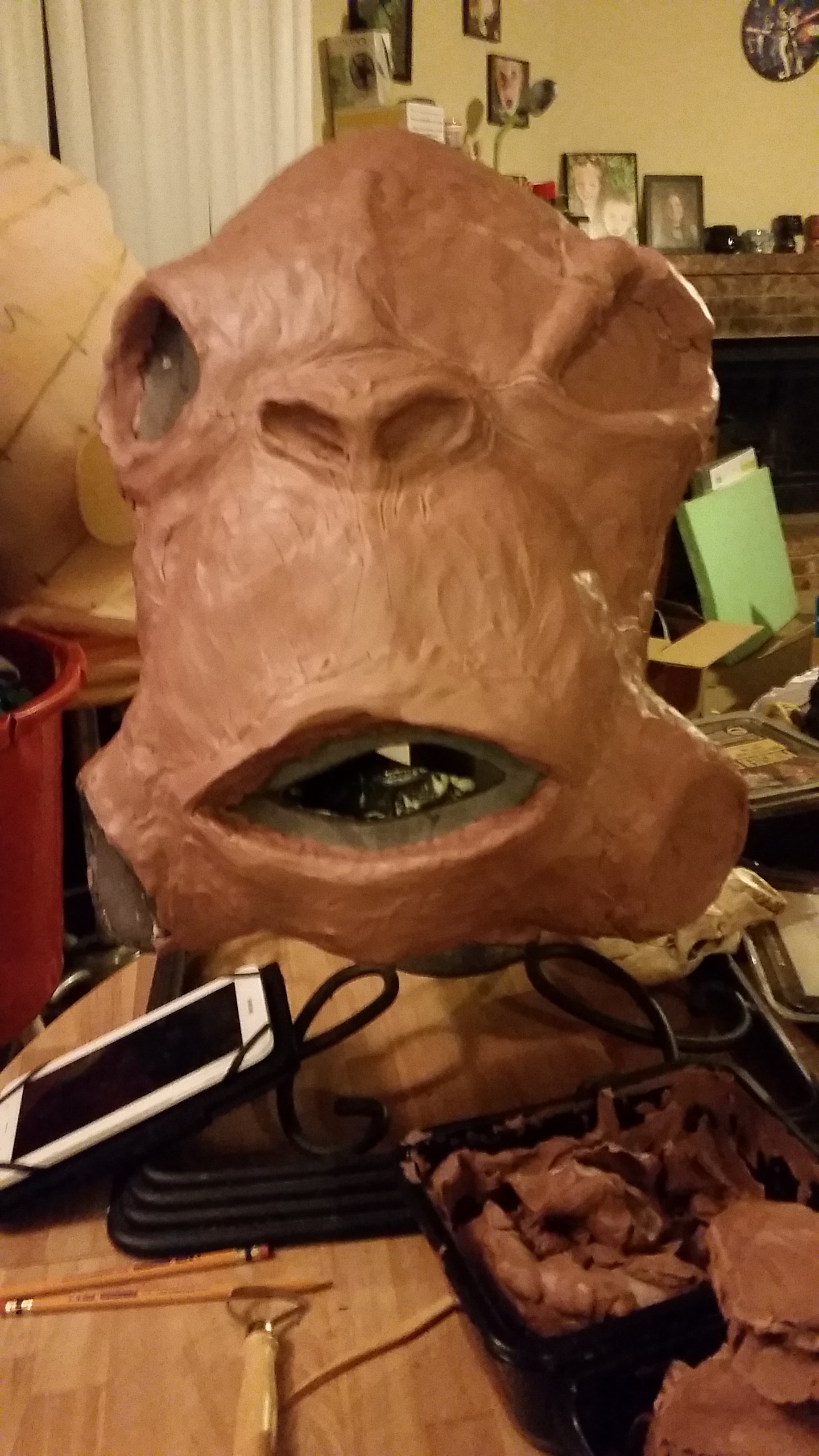

Ok this had been in the works for a while, I work on it when I can. First off this is one of the first facial sculpts I have done. I'm using monster clay and I have a few Arizona about some different techniques, first off I only have 20lbs of clay so I made a rough sculpt of the head and body and made patterns and transfered to foam and started slinging clay this is what I have now I'm happy with it I'm just curious on how to make finer and larger wrinkles amy suggestions 20141001_203124.jpgScreenshot_2014-11-05-20-35-44.png20141117_195717.jpg20141123_201804.jpg20141221_225328.jpg

For finer wrinkles I'll use a sharpened pencil (or something similar) and then mute the edges, left by the tool, with a small paint brush.
For larger wrinkles, put a piece of plastic wrap on the area to be detailed and tool on top of the plastic wrap. The plastic wrap helps
to 'soften' the marks left be the tool. A dull pencil can be used to dab detail into a large wrinkle. Also, keep on the lookout for things that
can be used as texture stamps, like different types of sponges. Even an orange peel can be used as a 'skin' texture stamp.
I wouldn't worry about making details too fine, by the time it's moulded, cast and painted some of those details might be lost anyway.
I also use a small paint brush dipped in water to smooth out any harsh tool marks.
Forgot to mention a little tool I made for lip wrinkles.
A frayed end from a bicycle cable. Flattened and fanned out makes some fine details.

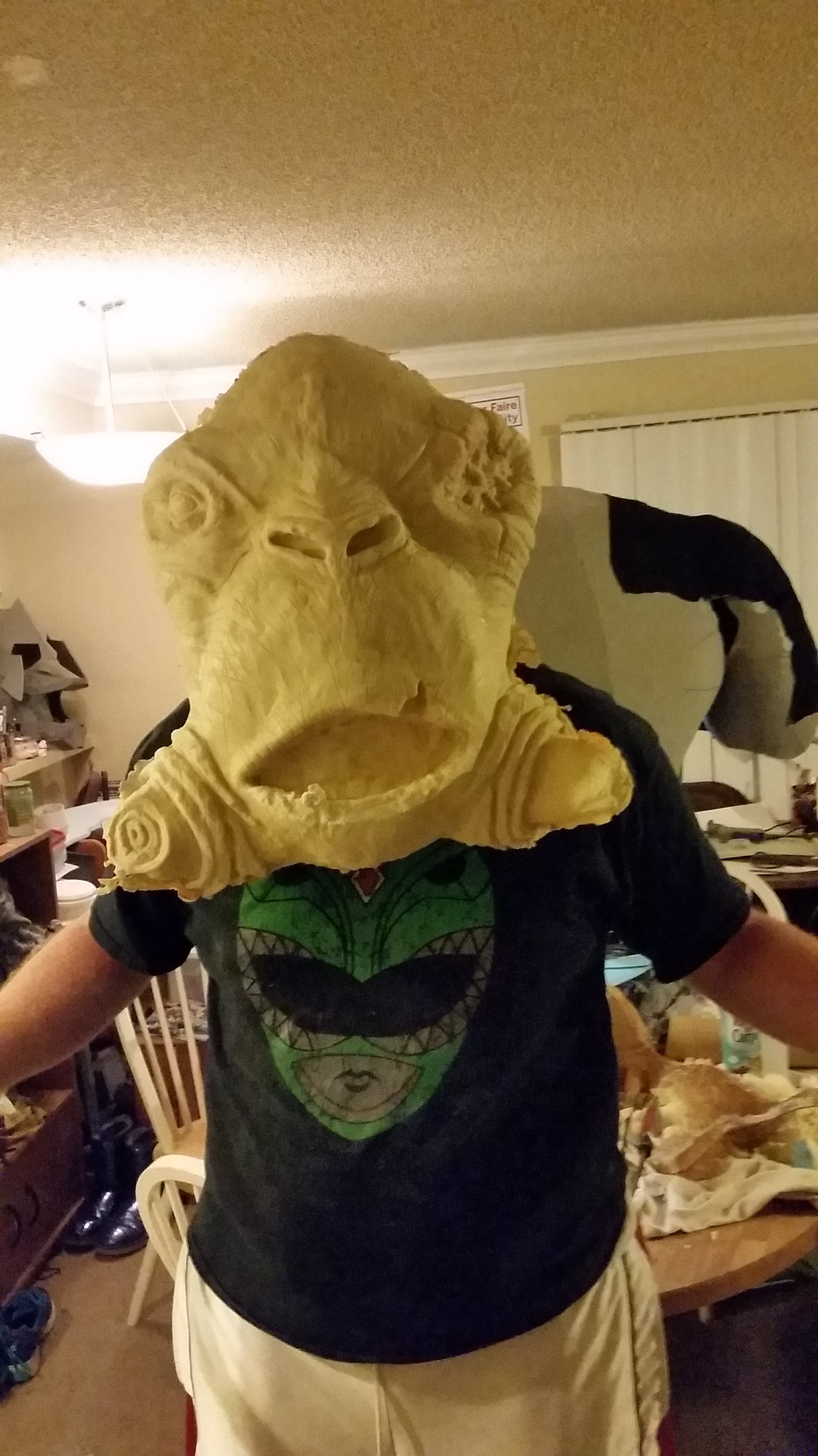

Ok sorry for the lack of updates. Anyways i got him molded and cast in latex and foam filed i have a little patch work to do on the mask but he's coming along pretty good i also purchased a elephant eye from a taxidermy shop and out looks awesome
