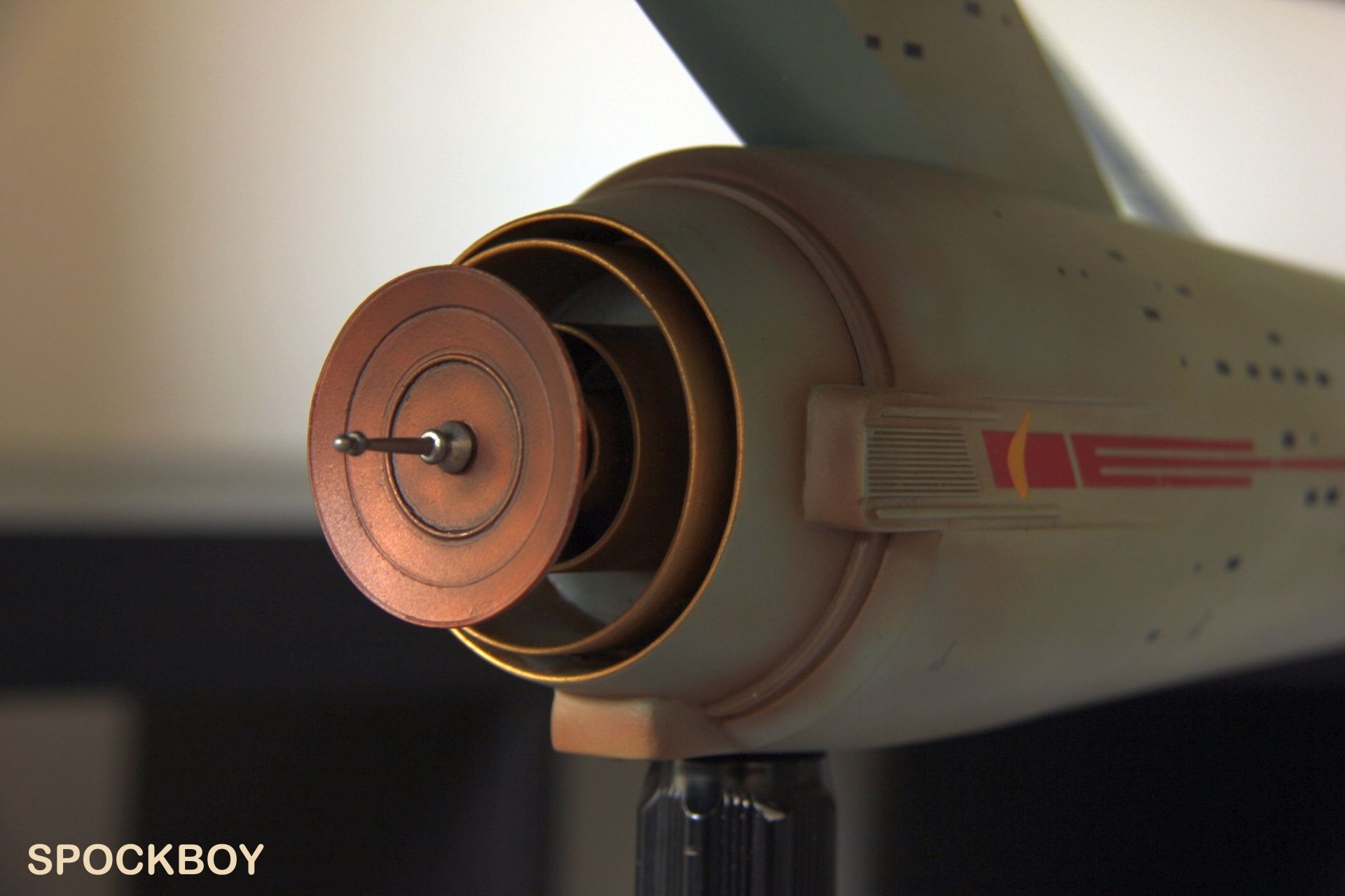

A few years ago Rylo produced an excellent replica of the deflector dish using actual copper, but I doubt he has any left.
If you can get your hands on one of these , you won't be disappointed . It just adds another level to the MR Enterprise .

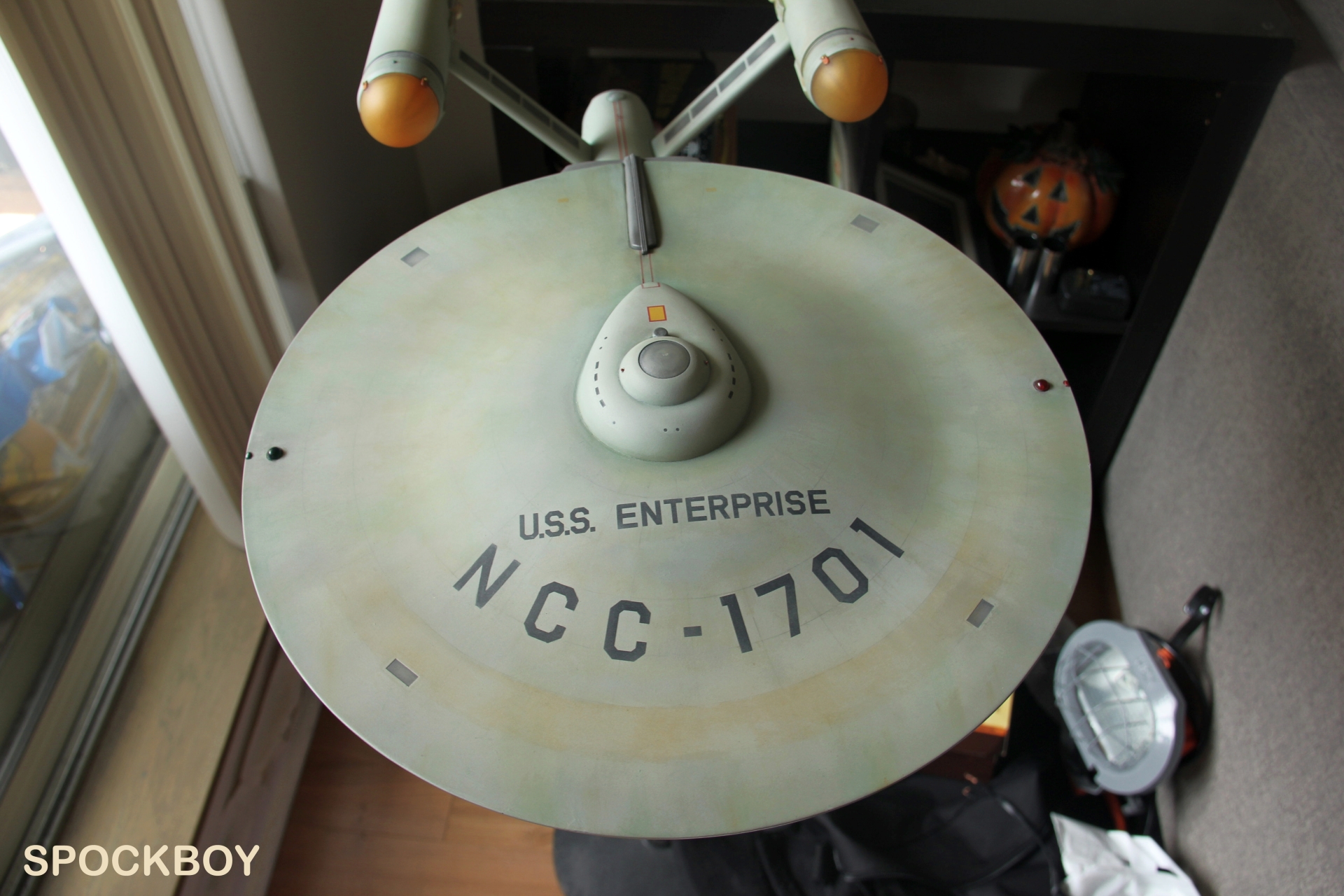

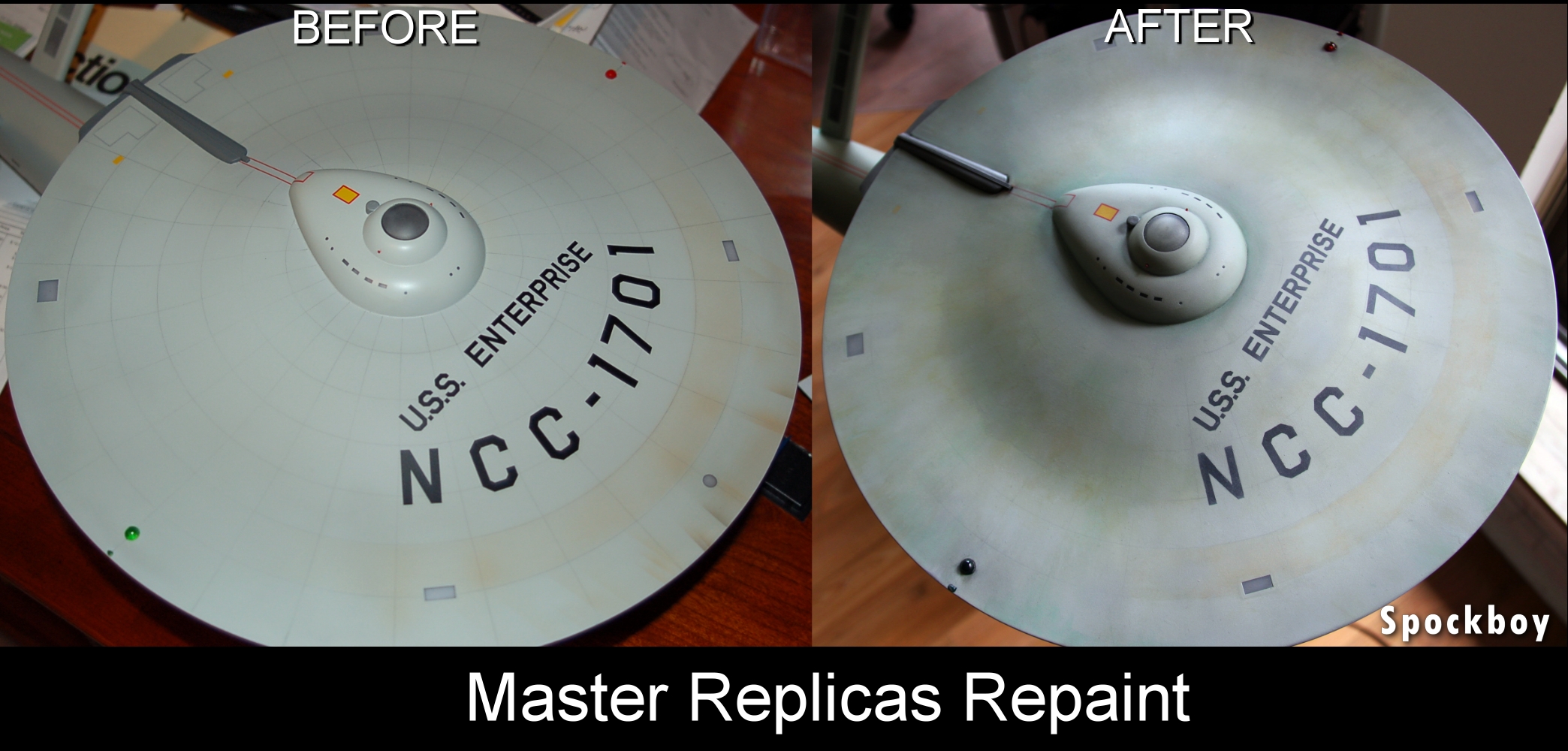

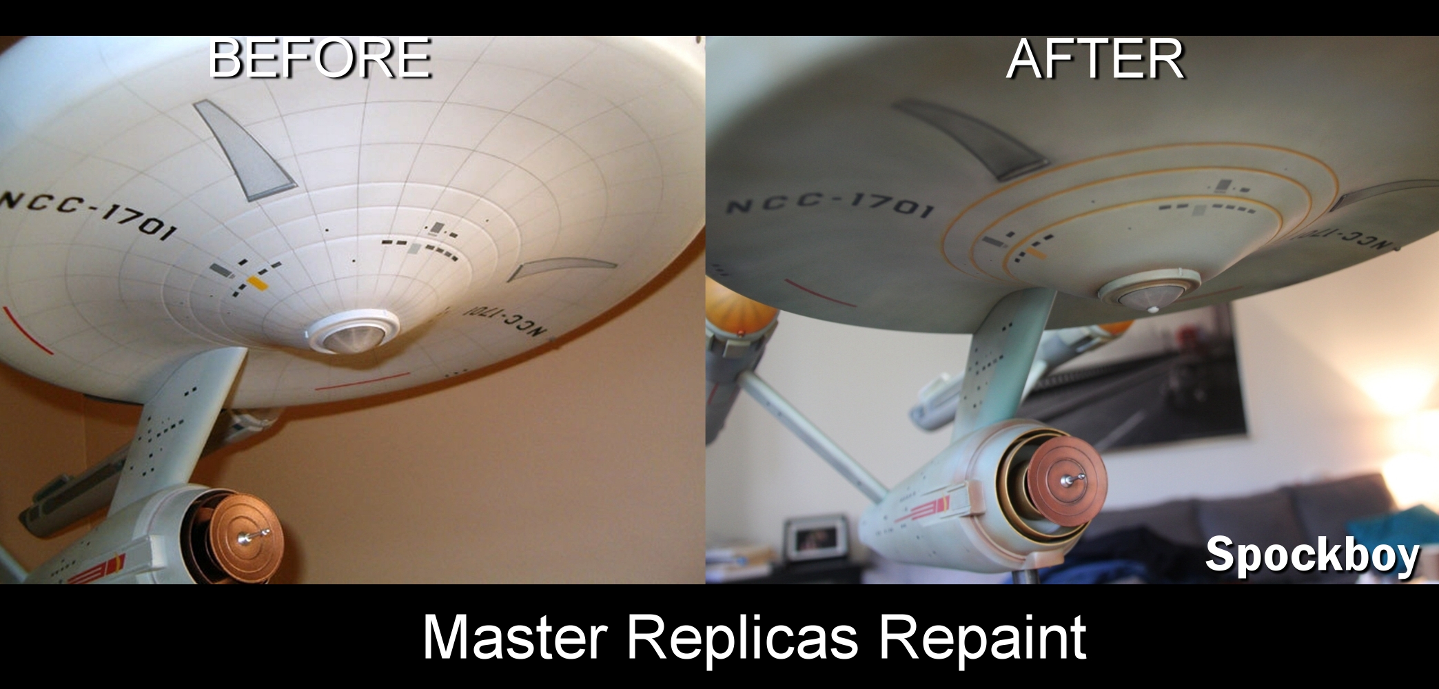

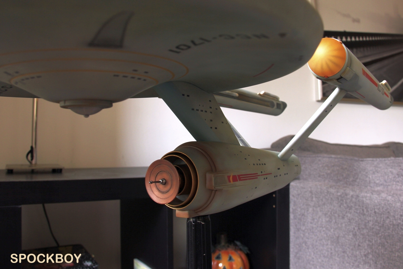

I'm in the process of completely repainting mine anyway to reflect the new Smithsonian information.
So far...
:)Spockboy
Thanks :)
The colors were green, rust, and yellow.

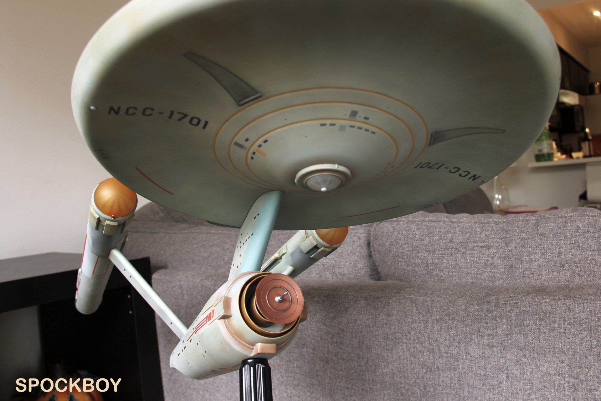

It took about a week (off and on) to do the saucer.
To me the dirtying on the Big E is like a painting. You don't just put a few marks here and there. It takes time.
There are many layers to blend into each other.
It was a great deal of fun.
:)Spockboy

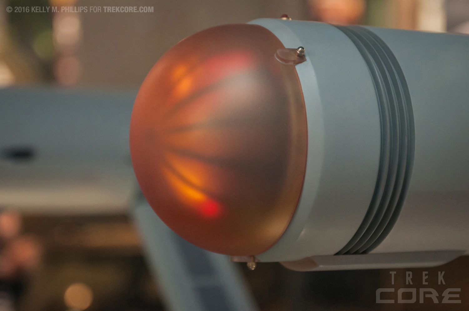

Fantastic, what did you use on the domes to orange them up?
I have that damn oil residue blotching them up, thinking an orange treatment could help cover it up and make more accurate.
Thanks :)
I just airbrushed them with orange ink.
According to Gary Kerr, that's what was done with the original model.
The ink is translucent so you can still see the lights.
I did a very light coat, turned on the lights to see, then did another coat.
Then I sprayed them with acrylic matte finish to make sure they weren't shiny.
Don't forget, the little tabs are orange as well, with brass colored nuts.
Hope this helps.
