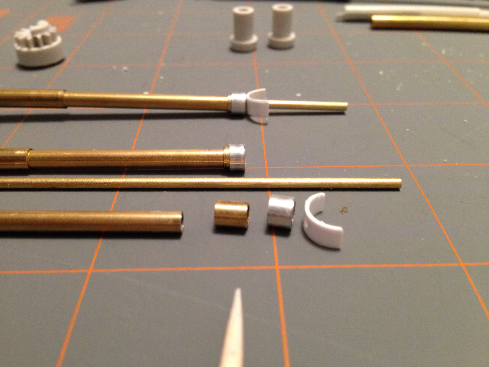

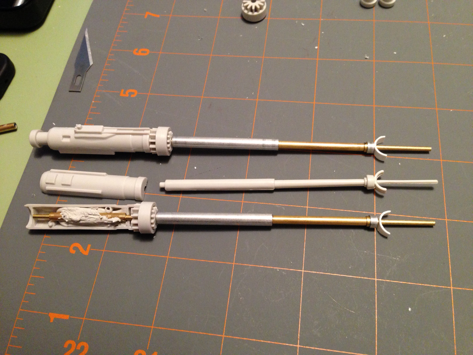

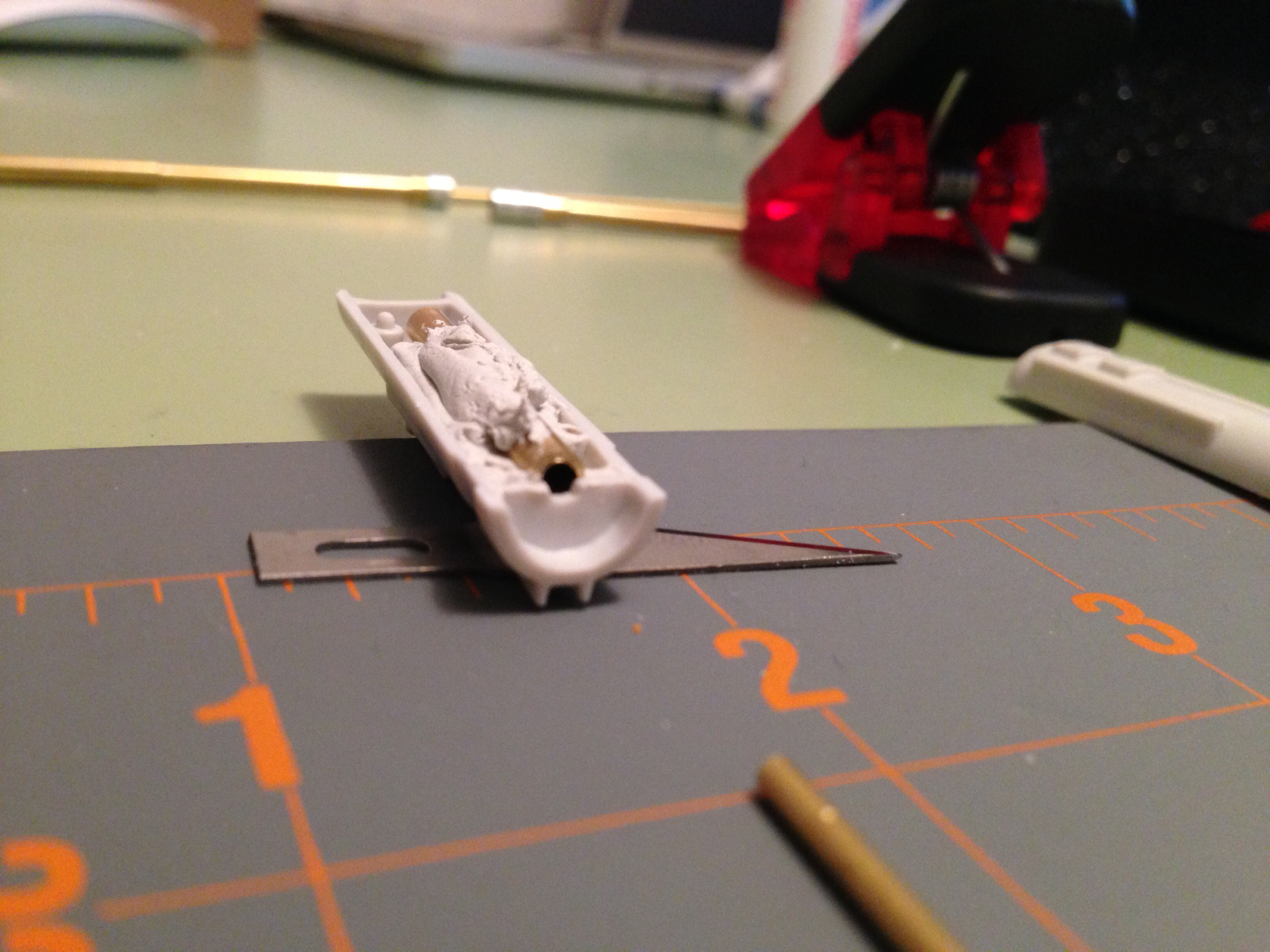

Rebuilding the guns in brass.
I mounted a brass tube inside of the part that attaches to the wing with squadron white putty.
View attachment 277516View attachment 277517
Could you tell me what tool you use for cutting the brass tubing??
Is it just a small pipe cutter from a hardware store or is there a specific modelers one??
I'm using a regular hardware store pipe cutter. It's a smaller one though, it's marked 3-28mm O.D. or 1/8 - 1 1/8 O.D.

Looking great! I replaced my barrels with brass on mine too and it really improves the look. They are heavier than the wings are designed to carry however and mine have drooped a bit over the years. I'd consider reinforcing the wing hinges a bit, maybe strengthening the wings themselves slightly (I'd added trenches to the back edges of the wings too, to match the details on the studio models, which added a bit of structure to the wings).
